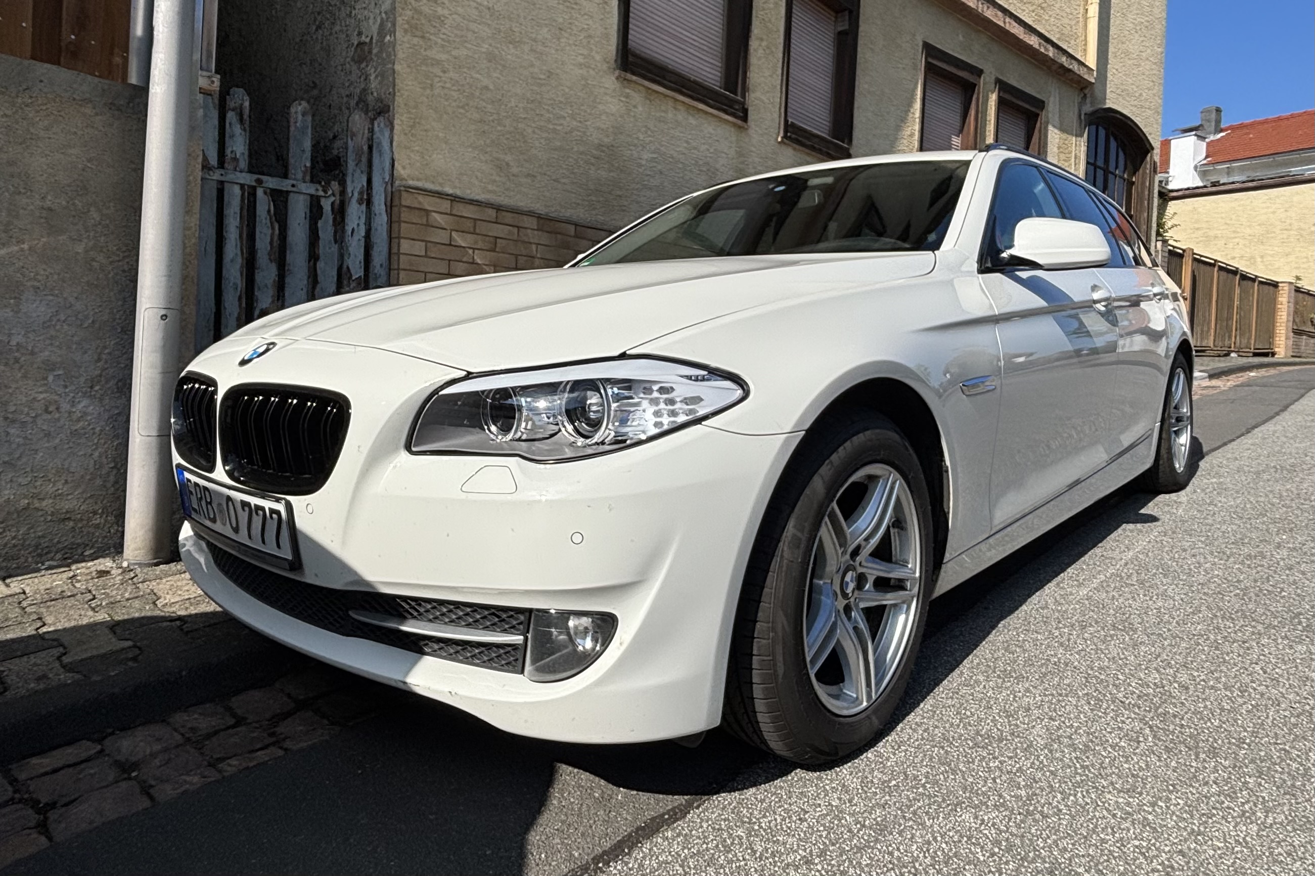

I start the conversion of my BMW 525d now officialy
My prioritys are:
- range over power (daily use)
- seamless integration (using existing gauges and handles)
- AC and DC CCS2
- V2L
- using OEM (roadlegal easy)
Driveprofile:
- city
- countryroads
- rarely on highways (max. 150 kph is OK for me)
My first ideas:
- placing the drivetrain in the rear subframe as replacement of the differential gearbox and custom made driveshafts, to get as much space that I can get (enginecompartment, gearboxcompartment, tunnle, and fuletankcompartment) for batteries charge- and V2L-Equipment.

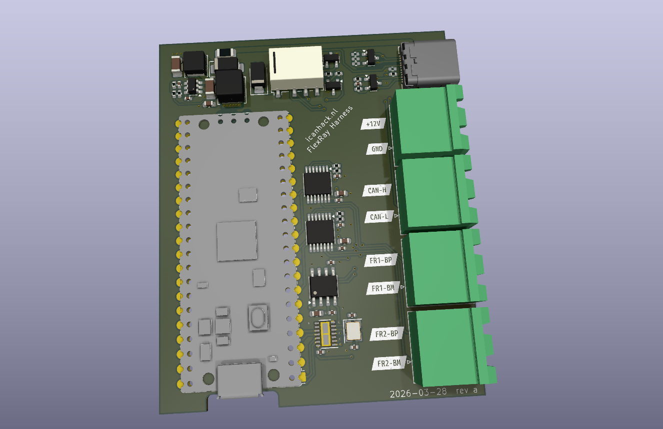

Emulating a fully functional Flexray node with a Infineon TC277 / TC297 TriCore Evaluation Board (used in any BMW-ECUs) or a FPGA solution to bring the needed parameter like engintorque from the EV-VCU directly to the FR-Bus. Like a Flexray interface for the Zombiverter.

Posts: 4000
Been thanked: 1115 times
Re: BMW 525d F11 conversion
Interesting project. imho it depends what you want out of the project. If you want to get running and driving option 2 is the way. If you want to have fun and learn it's option 3. This might be some help : https://github.com/dynm/pico-flexray

Maybe i bring it backk on the road with 2 and then i work on 3.
I found a similar Project from 2020 on github where they moved the steeringwheel of an Audi Q8 with a joystick. But they didn't use "cheap" hardware, when i remember it right. But thats can be a good alternative with a Raspi pico and two flexraytranscivers. Thanks for that.

Posts: 4000
I don't want to pollute your build thread but I've been down quite a rabithole on flexray and it seems the folks working on various openpilot and others have gone a long way to making flexray more accessible. I'm gonna try and source an F10/F11 dme and see if I can listen to it on the bench.

Post by cavok »
I ordert the TJA1082 Flexray-Transceivers with DIP-Adapters and a Raspi Pico 2 is still in any Box. First try is with a breadboard. If that works, i‘ll solder it on a pervboard. Thank you all (especially to Damian) for your suggestions.
