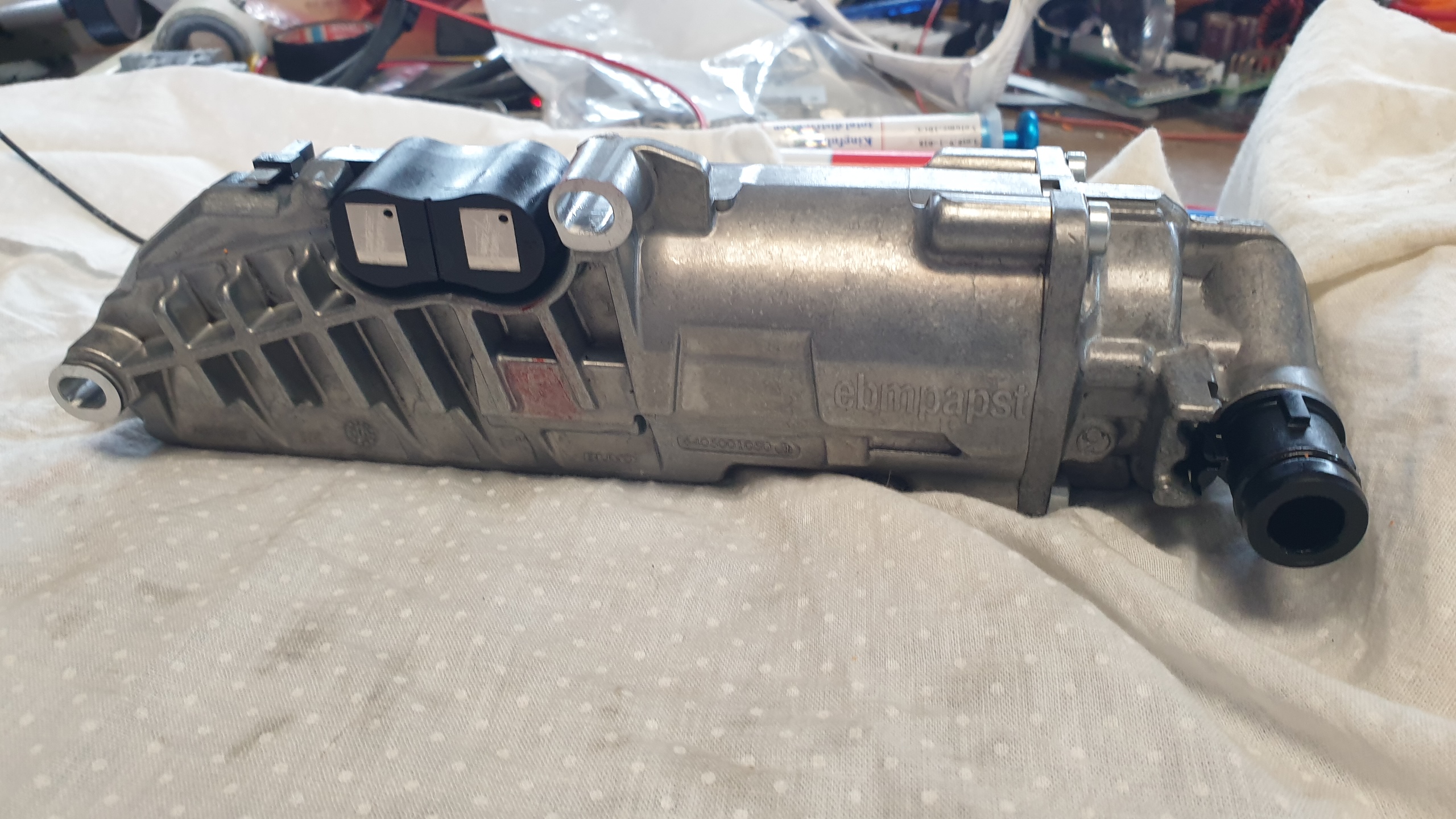

The Pump Of Doom

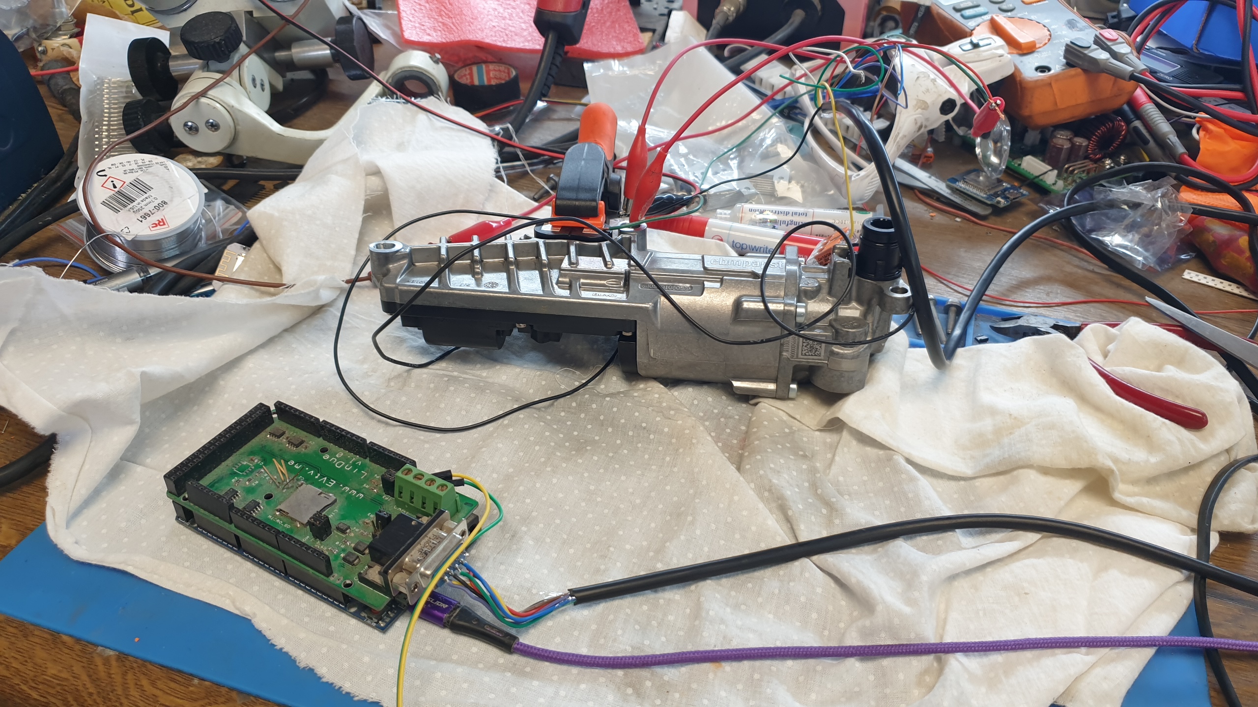

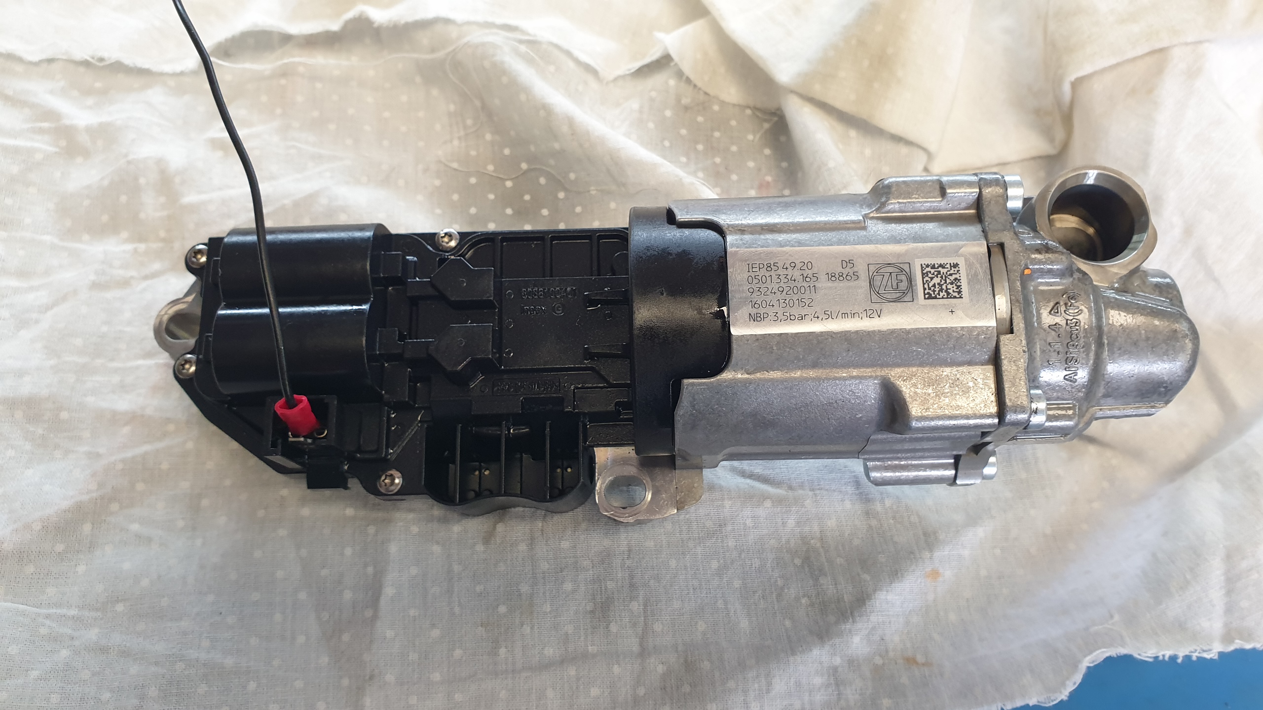

Welcome folks to my nemesis, the pump of Doom!! also know as the auxiliary 12v oil pump in the phev version of the ZF 8hp gearbox. I'm 4 days in so far and have managed the amazing feat of making it run reliably for 300ms! I know I'm amazing. In an attempt to help others who may be foolishly following along here is a breakdown of learnings to date :

Run procedure used
• TCM sends 0xAA, 0x00, 0x0A, 0x00, 0x00, 0x00, 0x73, at first.
• Then switches to 0xAA, 0x00, 0x42, 0x00, 0x00, 0x00, 0x73, after approx 900ms.
• Setting 0x55, 0x00, 0x42, 0x00, 0x00, 0x00, 0x73, will cause a spin for approx 300ms then pump faults until next power cycle or LIN pause for approx 5 seconds causes the pump to sleep and reset.

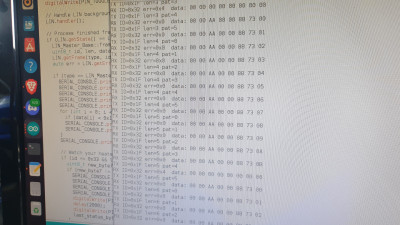

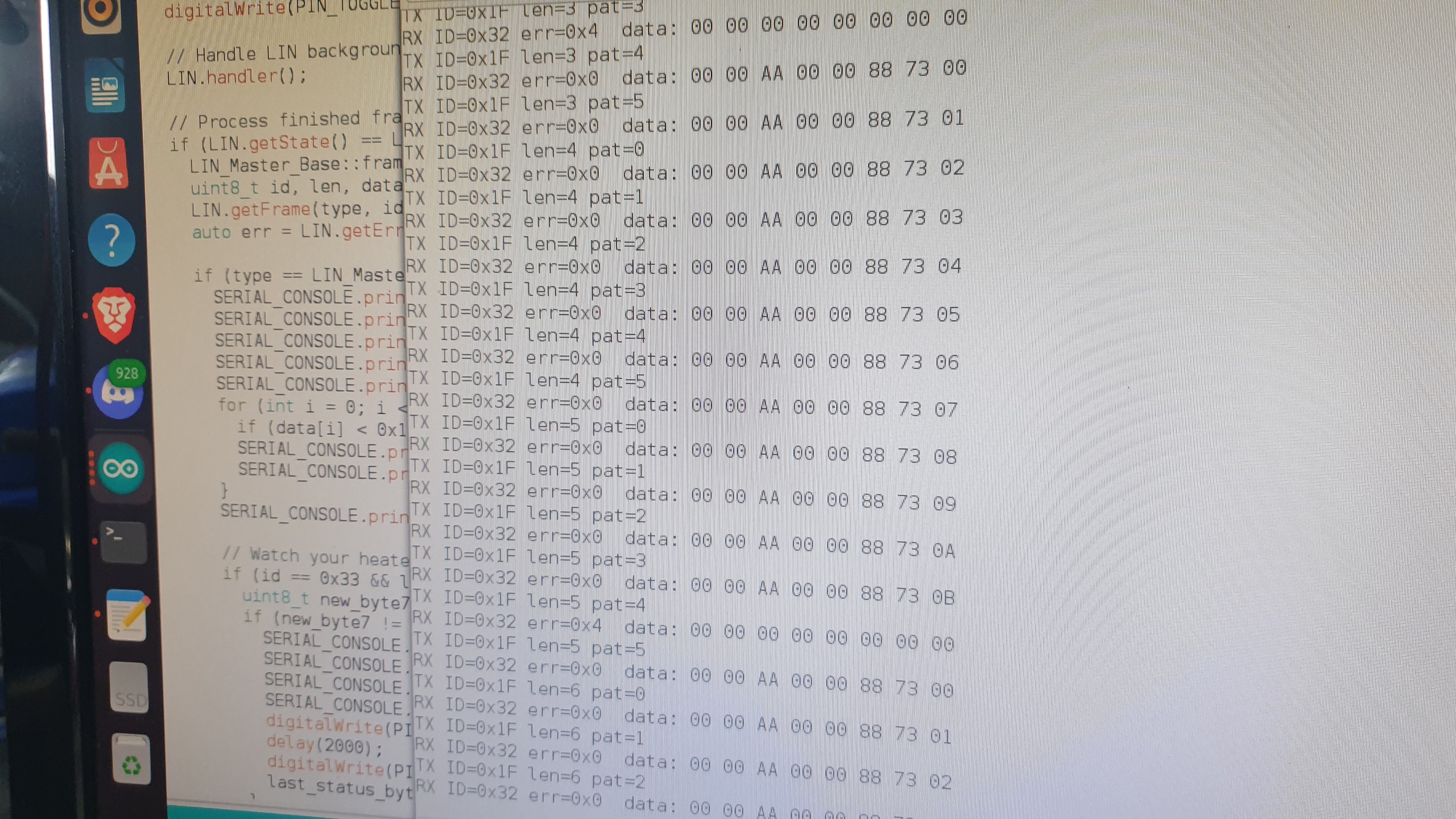

Core behavioural pattern we see every time
1. Coldstart finishes (AA 00 42 …)
2. First good 0x55 command arrives → 0x32 instantly becomes something like: 00 00 55 2A 14 xx xx xx ← motor spins briefly
3. Second (or any subsequent) 0x55 frame arrives → 0x32 immediately changes to: 40 00 AA 00 00 xx xx xx ← fault + reset
4. Pump makes the rapid ticking sound and goes silent (“Slave not responding” on PeakLIN)
→ The pump accepts exactly one valid 0x55 frame before its internal safety watchdog kills the command.
