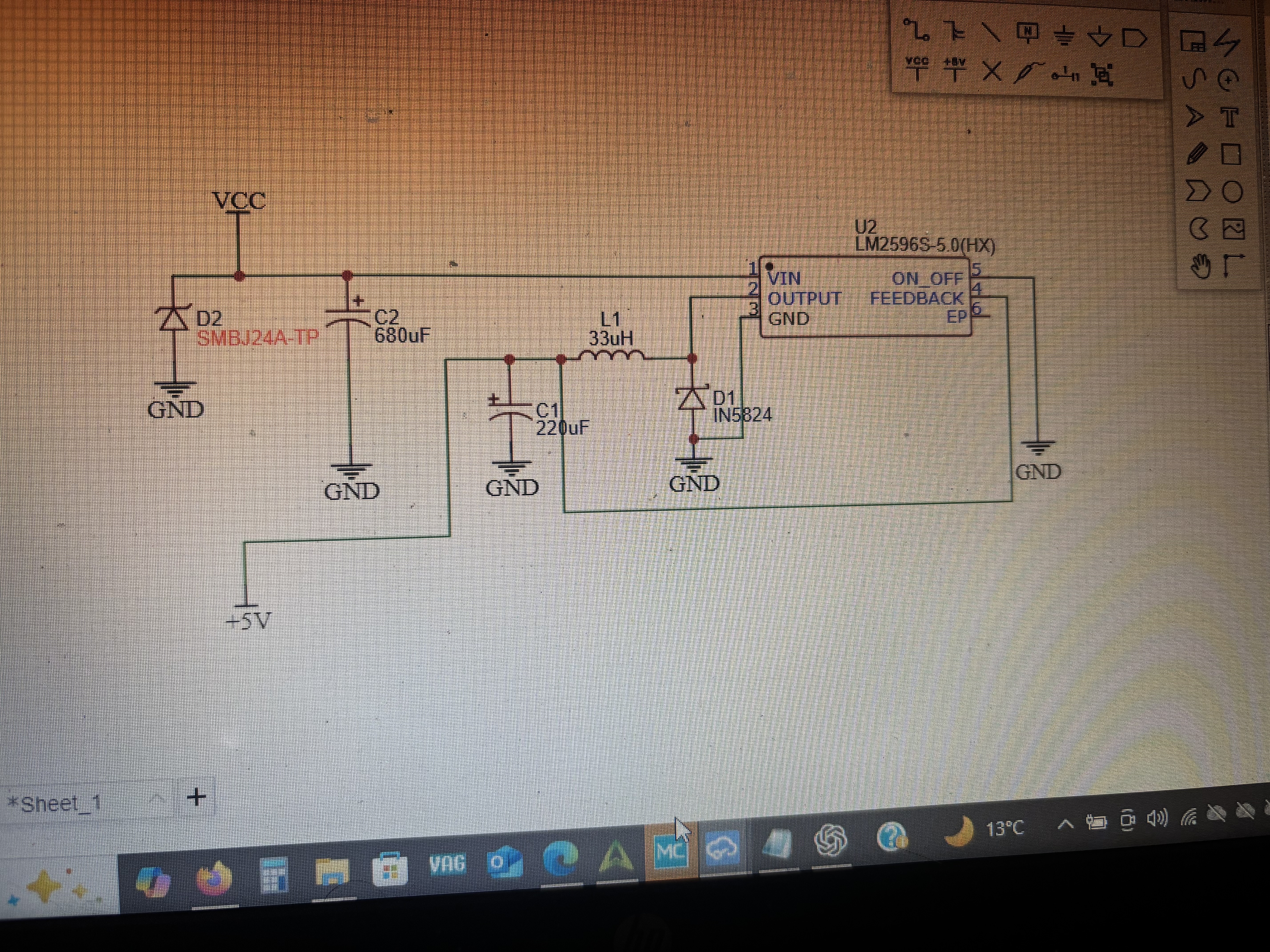

Why do you need a buck converter? The nano has one onboard. Vin is 6 - 21V.

I figured a more powerful one was in order to power 5v sensors ect, I have actually looked at the specs of the onboard one!

Automotive 12v systems can regularly see 80v spikes, how long will it last?
This is doing throttle to can? Need to be thinking about safety, not just make it work.

So stick with my power supply section then, is the tvs diode protection sufficient

I'd be looking at something like this, a little pricey but most of the sourcing and layout headache is taken care of inside the ic, being new to this, consider de-bs-ing the design
https://jlcpcb.com/partdetail/54689569- ... /C51957001
Automotive rated, pretty efficient, and has low power modes too.

jrbe wrote: Thu Apr 23, 2026 10:36 pm Automotive 12v systems can regularly see 80v spikes, how long will it last?
Is it still the case with alternator and starter gone?
Don't want to argue against surge protection of course, just wondering.

I've been running with an IC without protection with a maximum input of 18v for over 2 years of daily use. Maybe some of the relays/solenoids could cause spikes still?

johu wrote: Fri Apr 24, 2026 11:08 am Is it still the case with alternator and starter gone?
My understanding is any large relays like contactors, fan, etc. can do this. Large motors like power steering, vacuum pump, etc. can as well.

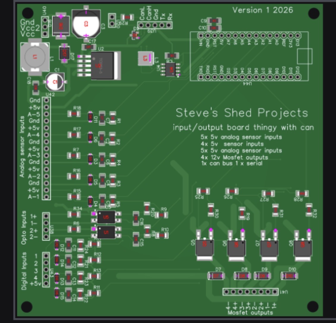

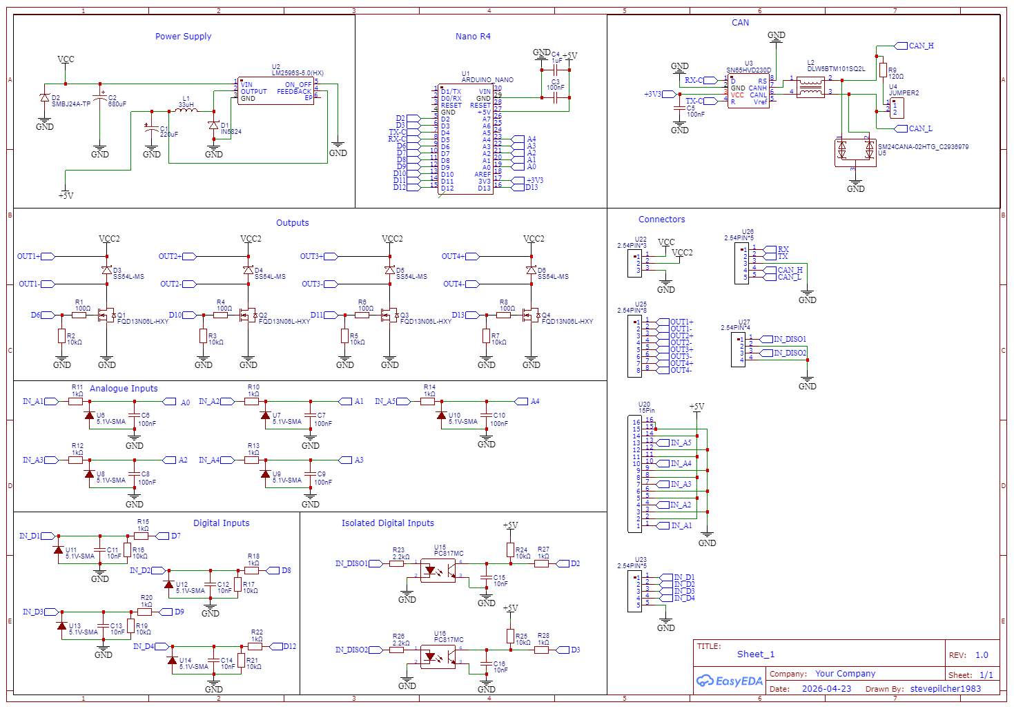

OK have ha a better play with easy eda, Schematic more or less there (open to tweaks) so much easier chosing components than kicad
jrbe
Posts: 766
Has thanked: 363 times
Been thanked: 249 times
Re: Anyone interested in designing a pcb for me £$¥
Post by jrbe »
Ev8 wrote: Sun Apr 26, 2026 1:35 pm OK have ha a better play with easy eda, Schematic..
Consider adding 100k-220k pulldowns on analog inputs. Letting them float is sometimes ok, but having them pulled low in case something is disconnected and logic being able to see this pulled low below normal range = disconnect / fault in logic vs floating / erratic signals on disconnect.
The 1k series resistors may be a bit high, just a reminder to check that it wont block too much current for say your optos. Your optos look to be out of stock.
Your power supply and optos have chinese datasheets, you able to read these / find ones you can read to verify they will work? 1k on the rpi2040 at 3.3v / 12ma max seems like maybe too much without being able to see specs.

I have updated the opto to TLP281 as the pc817 was a through hole I just happen to have a bunch of here! Will add pull down resistors to the analog inputs so they don’t float if disconnected so my twin pot throttle differential code actually works!

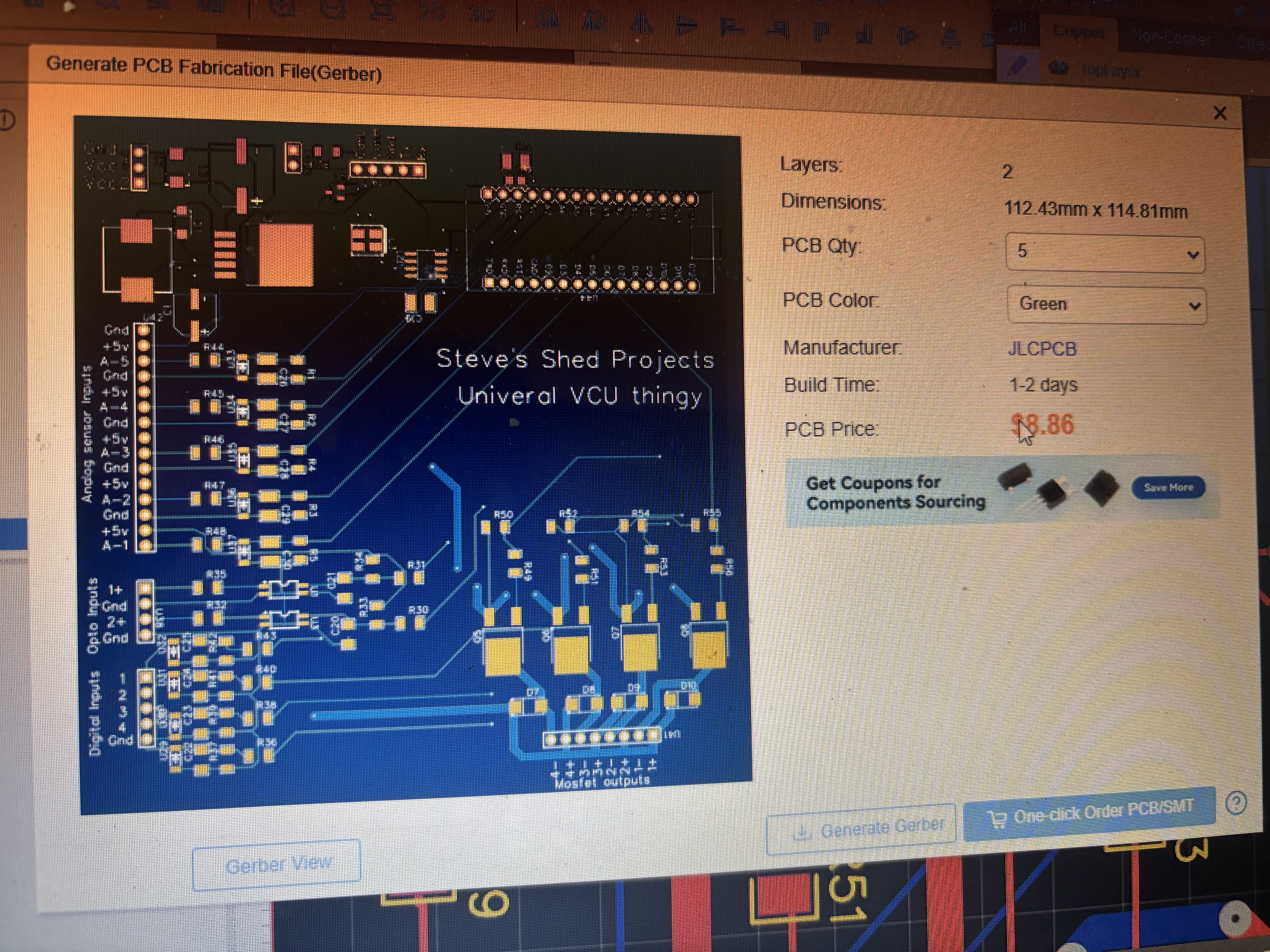

So it would seem easyeda isn’t too bad to learn, have managed to get his far thanks for the recommendation

Post by Ev8 »
Every days a learning day, today I learned how to use the bottom of a 2 layer pcb as a ground plane and still route signal paths through it as needed, yesterday was the day I ordered my first boards! lol well it’ll be better then perf board in any case
