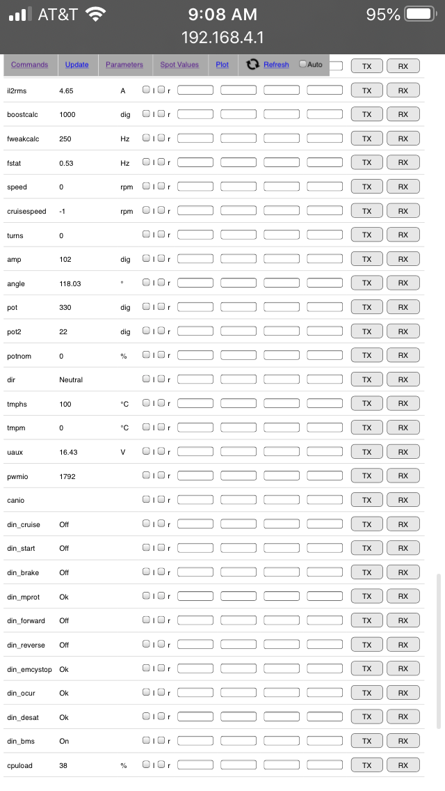

I changed udcnom to 0 and boost to 1000. The inverter will make a quiet whine when put in drive or reverse but the motor will not spin. This has been the case in all parameter settings where udcnom is 0. That's why the motor only spun when I loaded the E30 parameters.
Attached is the current parameters I have for testing.
Also there are the spot values when the ignition is turned on and the start signal has been sent with the main contactor closed and in neutral.

Your heat sink is reading 100C, please stop overloading the drive unit and smashing changes in it without figuring out what is going on.
The inverter is limiting hard due to the temperature reading.
I would advise for extended testing to get coolant flowing. Your settings do not look miles off from what it takes to spin a motor.
If you follow other posts you will see there was a temp sensor errors with MUX. There was an open task created and Johannes posted revised versions that fix that problem. The actual heatsink temp is 23c. Besides that the other versions fix the issue, you can graph the temp on this version and see it toggle from 23 to 100 over and over again due to the programming error. Unfortunately the newest version won’t even close the main contactor so I’m using the version my board came with for testing.
That being said, the inverter is derated with this version, but it’s not even spinning like it was previously. If you read my previous posts, I actually got the motor to spin the correct way with the newest revised version once. 5 minutes later I turned it on again without changing any settings and the main contactor wouldn’t even close. I really don’t think this is a software or parameter issue.
The main thing I don’t understand is why my board came with a single encoder setting and not AB since it was a built and tested board. Also, the board came with a bad solder joint causing an overcurrent code that would have given the same code had the board been tested before it was sent.
