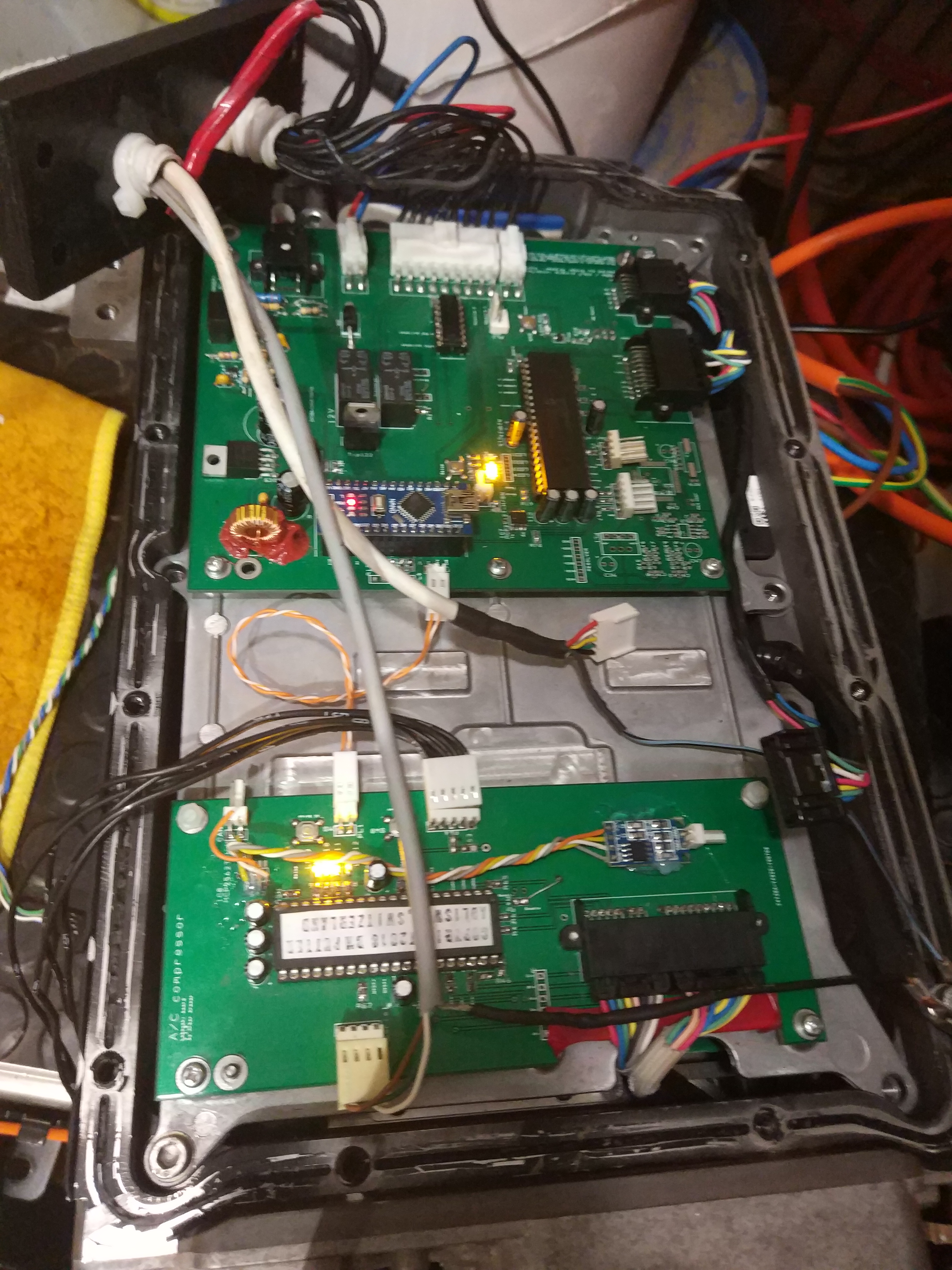

While i was trying to decypher Leaf AC compressor serial bus or whatever it uses i was getting nowhere. So i decided to just build me a compressor drive.

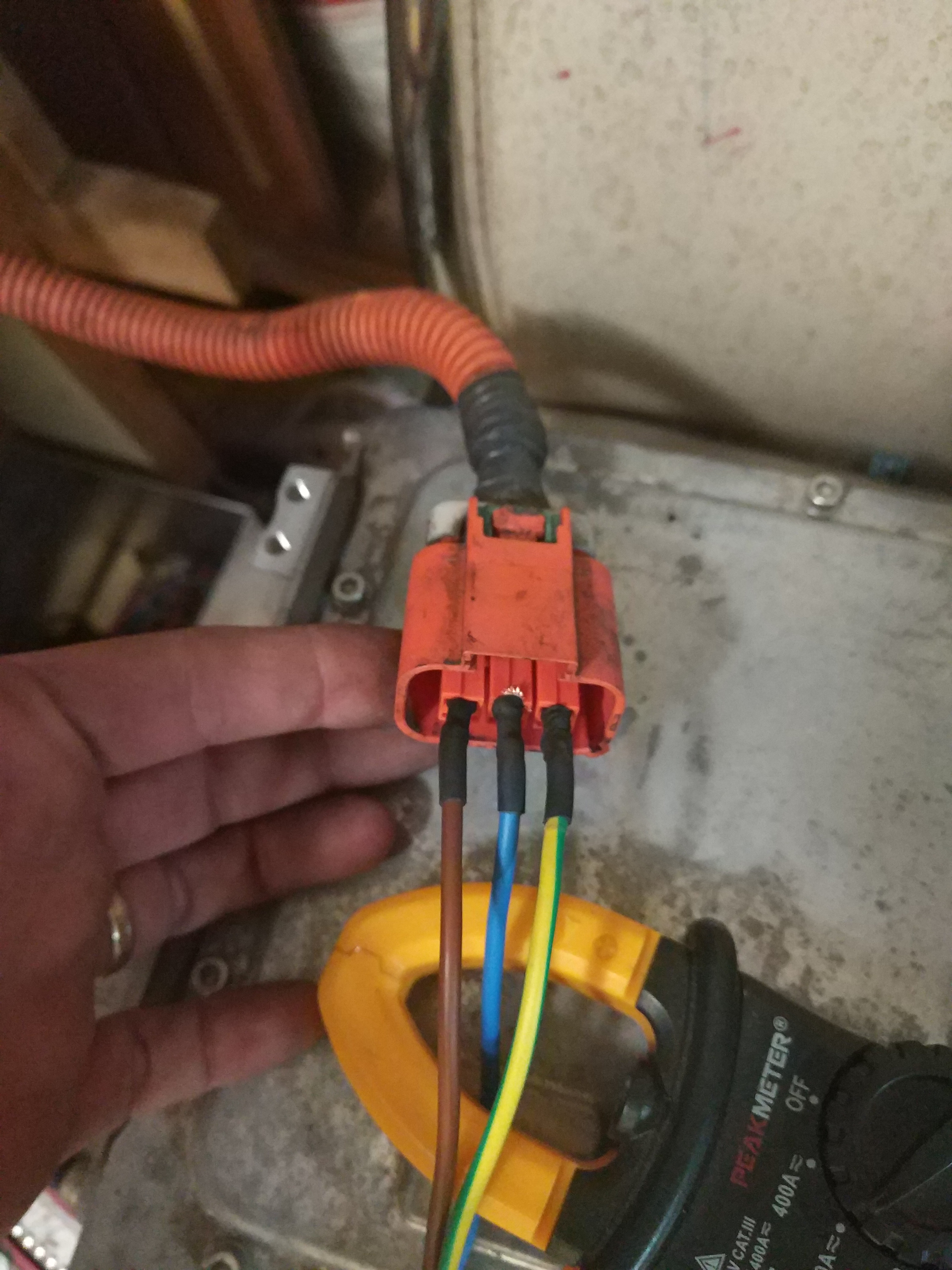

I will use Volt inverter, so inside is one Aux controler with enough power to drive compressor. It was originaly intended to run Aux hydraulic pump to keep transmission under pressure when car is stationary. When Tom and I inspected this drive we figured it has 50A sensors and while i was putting 10A load onto it it didnt get too warm. https://www.diyelectriccar.com/forums/s ... stcount=84
Now i have one Lebowski board inside inverter connected to AUX drive connector and Leaf compressor on the other side. I must say cables on that compressor are tiny. Just two strands of 0.20mm2 wire. I think max power on compressor is actually 10A.
Look at it running. Noisy boy!
Also Lebowski measured motor parameters... 5100uH and 600mOhm per phase.

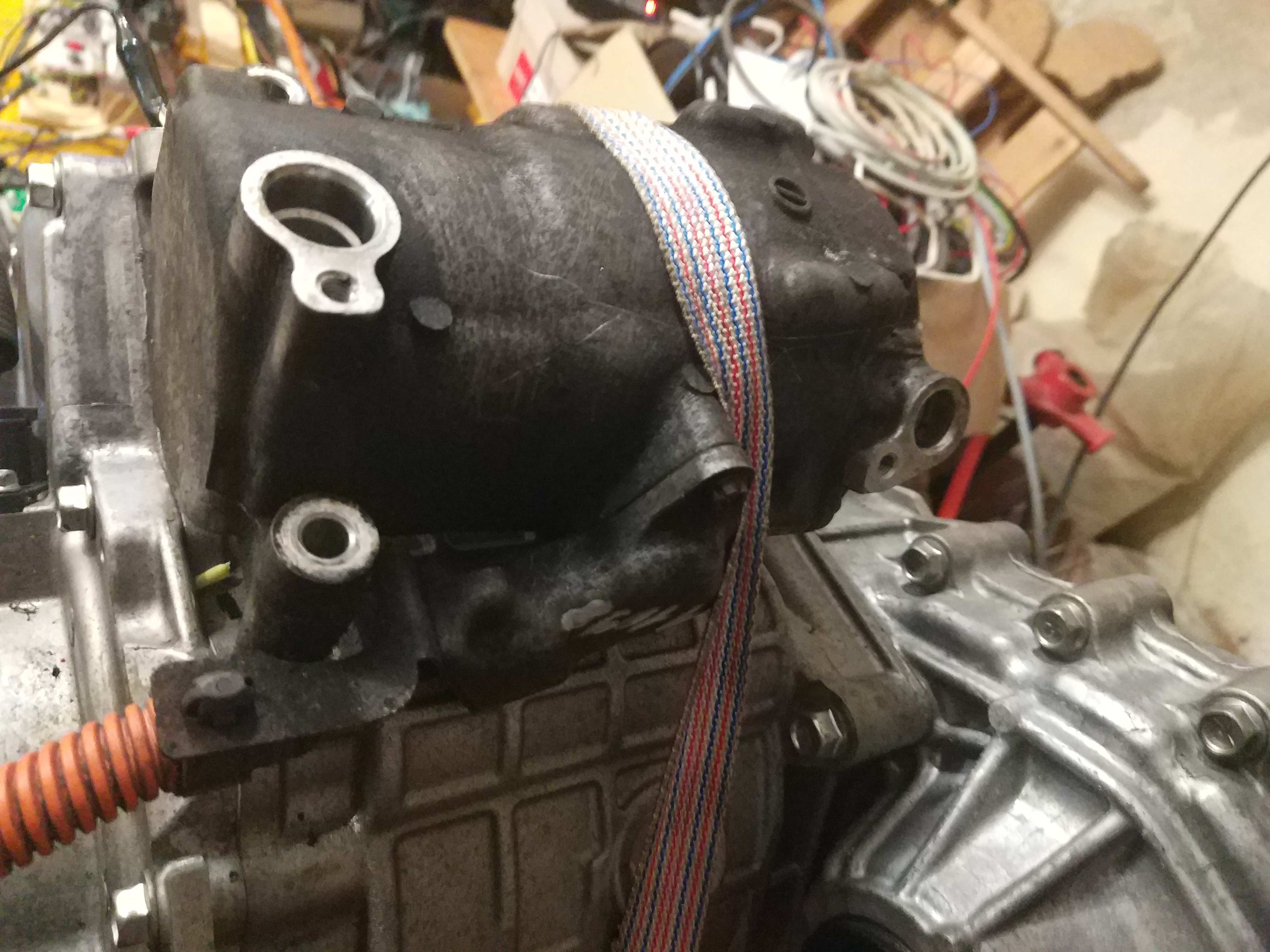

Well i got Prius gen2 AC compressor here. I love it. It is a simple motor on scroll compressor. It has exterior 3phase cables that one can connect to any inverter. I spent like 5 minutes on Lebowski inverter calibrating motor resistance and inductance. And it ran!
While i think other compressors are more powerfull, this one lends itself better to DIY use.
Prius AC compressor Lebowski parameters:
Motor Inductance: 2550uH
Motor phase resistance: 500mOhm
Voltage used 360Vdc

I bought compressor with both tubes. They are alu pipes with flanges. In the middle there is a section of rubber hose. I will do the same as i have done with my power steering hydraulic pump.
I will cut the hose 3/4 from the compressor and take it alu pipe and all to a hardware machinist store where they have propper pliers to crimp hydraulic and pneumatic hoses. If you have sufficient length of rubber hose they can crimp an extention onto that.
I will also take the opposite hoses from the car. They will then make me a fitting to join both sides hoses.
Now it is not that simple as you first think. You have to prepare and measure how much hose you need.
Also you need to be carefull of orientation which hose goes to which port inside cabin. There are some non-return valves there...
I am still thinking of asking them to make me a dissassembly, so i could took the hoses apart if i wanted, but a friend said it is one more point of failure...

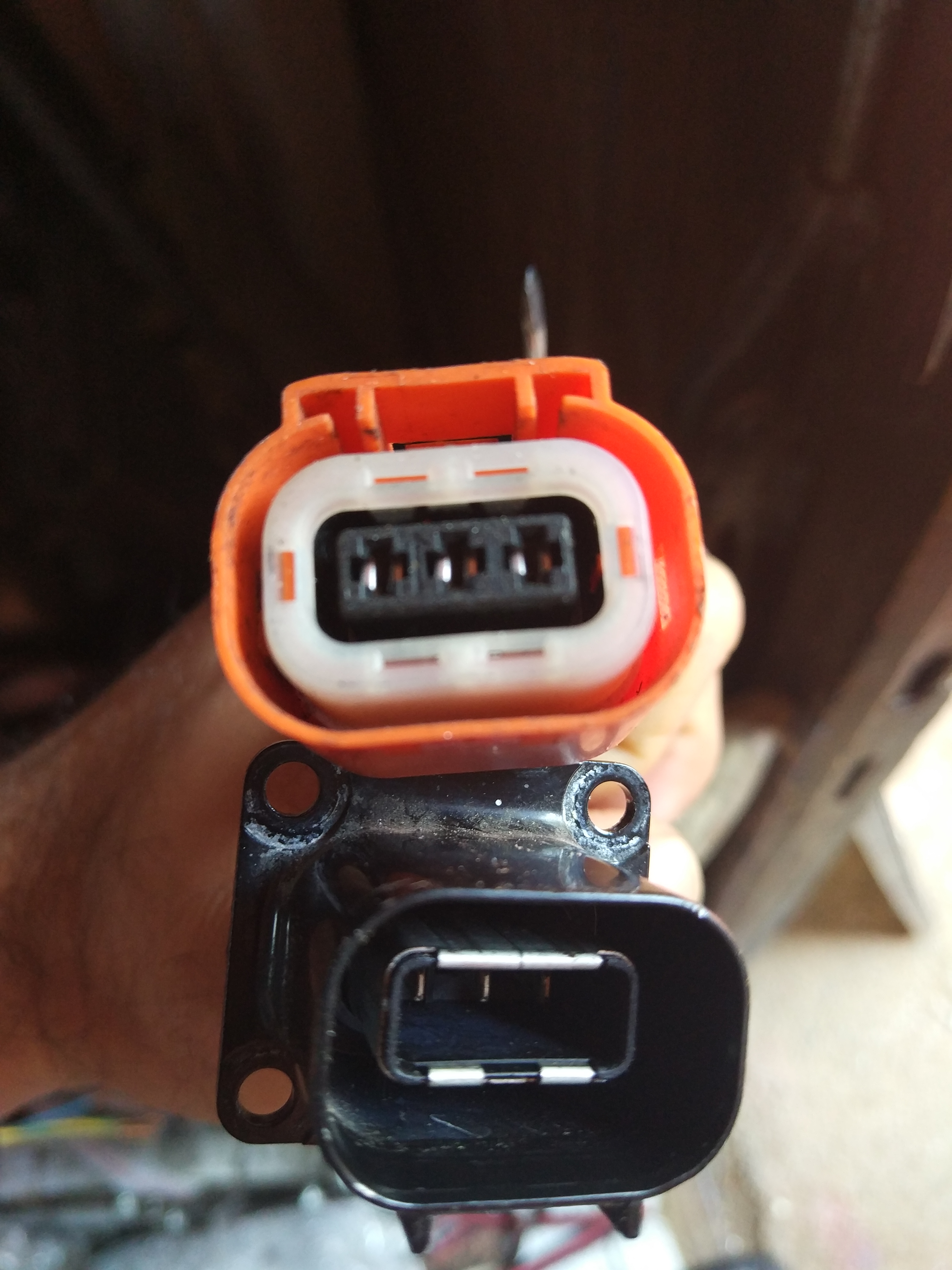

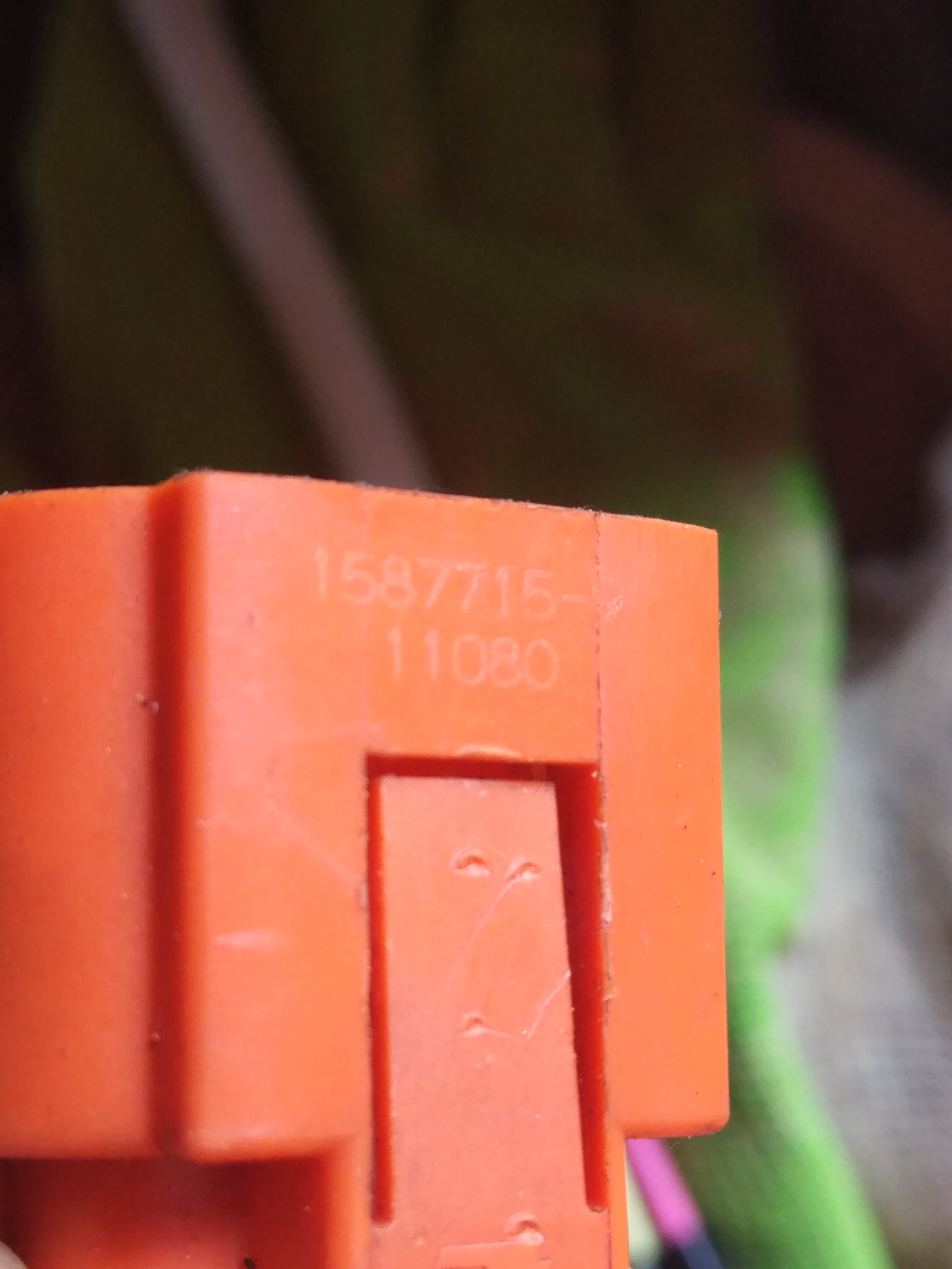

I went to search for Toyota 3PH connector from compressor, but i couldnt find any data. Then i tried to find the connector on the side of Volt inverter where i will connect compressor.
It seems like it is YHVA280-3PXM connector and can be get at Mouser. Contacts are 2.8mm AMP MCP female. I may yet pull this off without sacrificing cables and plugs. Datasheet of assembly is attached. It seems to be quite complicated assembly.
I also attach Mouser basket with P/Ns
