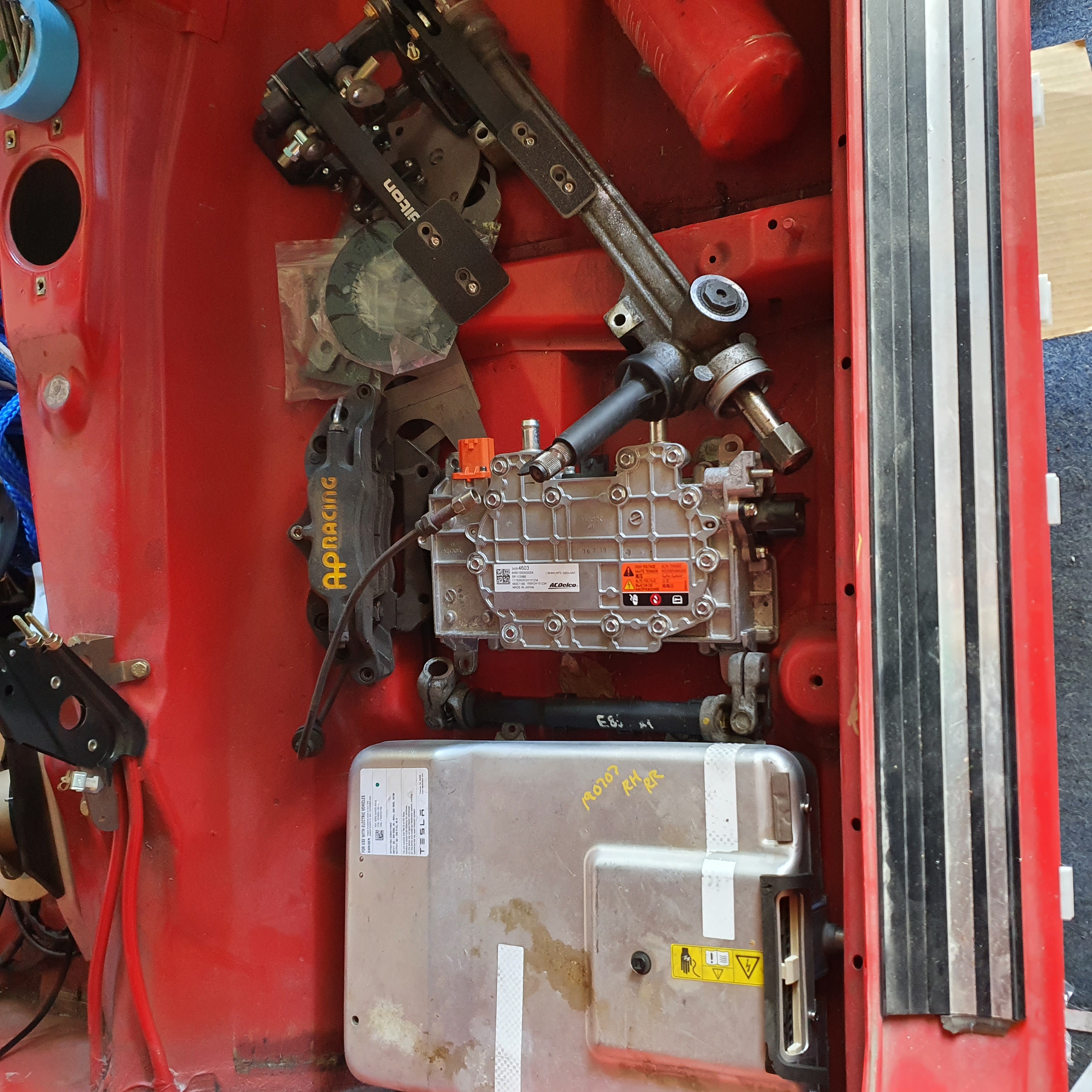

Been a while but have been doing lots of research and reading through posts all the time. Am getting closer to finally starting more on this project, so to date I have brought and had delivered
Gen 2 Tesla charger with EVBMW board fitted
Chevy DCDC charger
Kilovac EV200 contractors with econimizers built in
New set of brakes for the front
BMW Z4 manual rack
Tilton pedal box
Strengthening plates for weak parts of the car
IVT-S current sensor
And lastly a Tesla M3 rear drive unit
Have also ordered most of the connectors and terminals to suit the chargers, bit still on back order so just waiting there. Still to order and sort out the PDM so the cat can be rewired to get rid of all the original heavy BMW wiring.
If anyone could help out I am still looking for rear CV joints or whole axles to suit the M3 drive unit and also plug part numbers for the drive unit so I can order those and get them on the way as well.
Will hopefully be putting more time into this once I get some axles so I can mount the motor in the back end and remount the rear suspension at the same time.

Re: Another BMW E36
I don’t suggest you need to be cutting big holes in the car. Use the drive shaft and mount the Tesla motor side ways
- Posts: 656
Re: Another BMW E36
This can work but it comes with tradeoffs. First, you gain the weight of the whole diff.
Second, your gear ratios become extremely messed up.
Do you hook the Tesla diff output to the BMW diff? That won't break 60mph and you'll need to lock the diff.
Do you hook the Tesla motor output to BMW diff? You'll have 1/3 the torque and need a custom case for the motor.

Well hopefully in the next few months I'll have some more photos to share, I have the tesla axles and the rear motor loom so just need time to get it into the workshop to get rid of some of the rear floor and subframe to mount the engine.
Because it's being used for motorsport mainly I thought it made a lot more sense to remove all the weight that's not required and tie the roll cage into the new motor mounting points. Also by the time the motors in the back the rear of the car should be about original weight.
