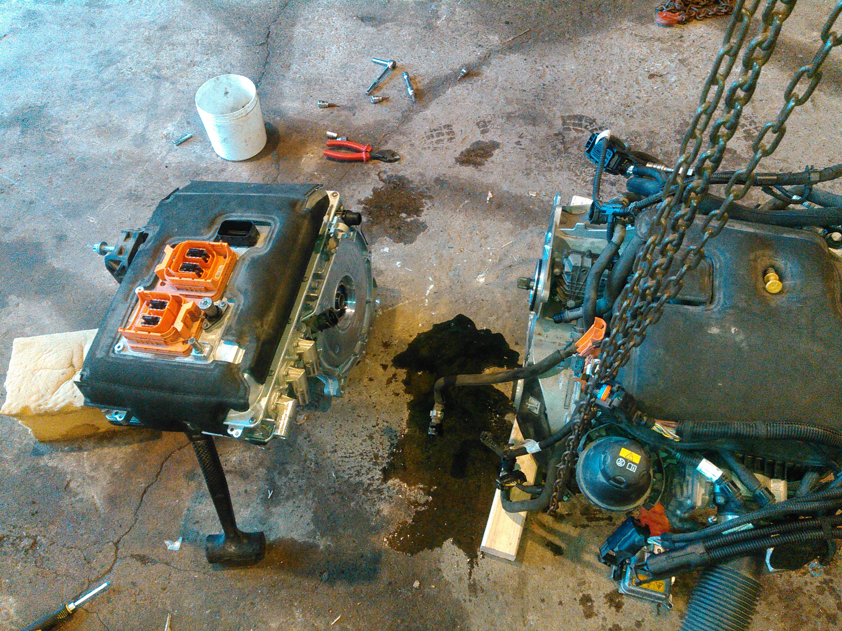

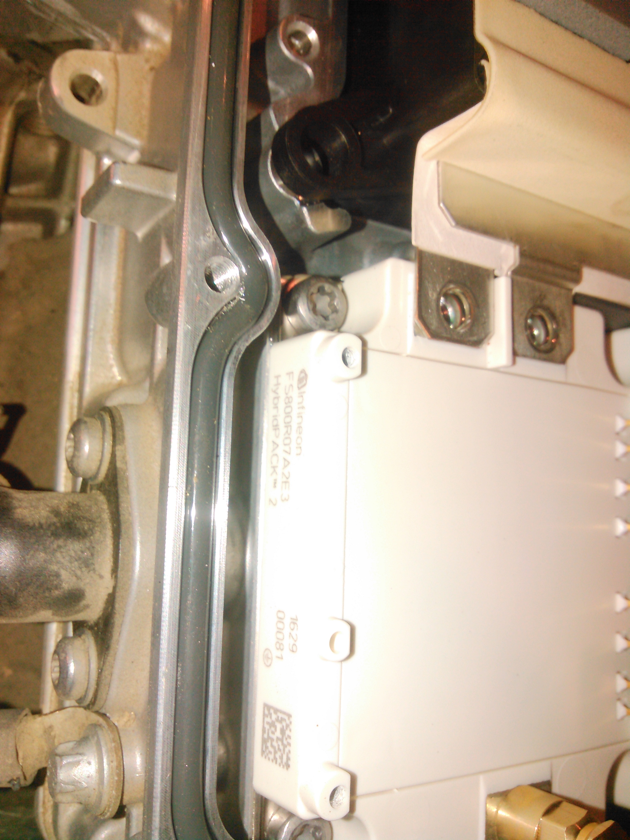

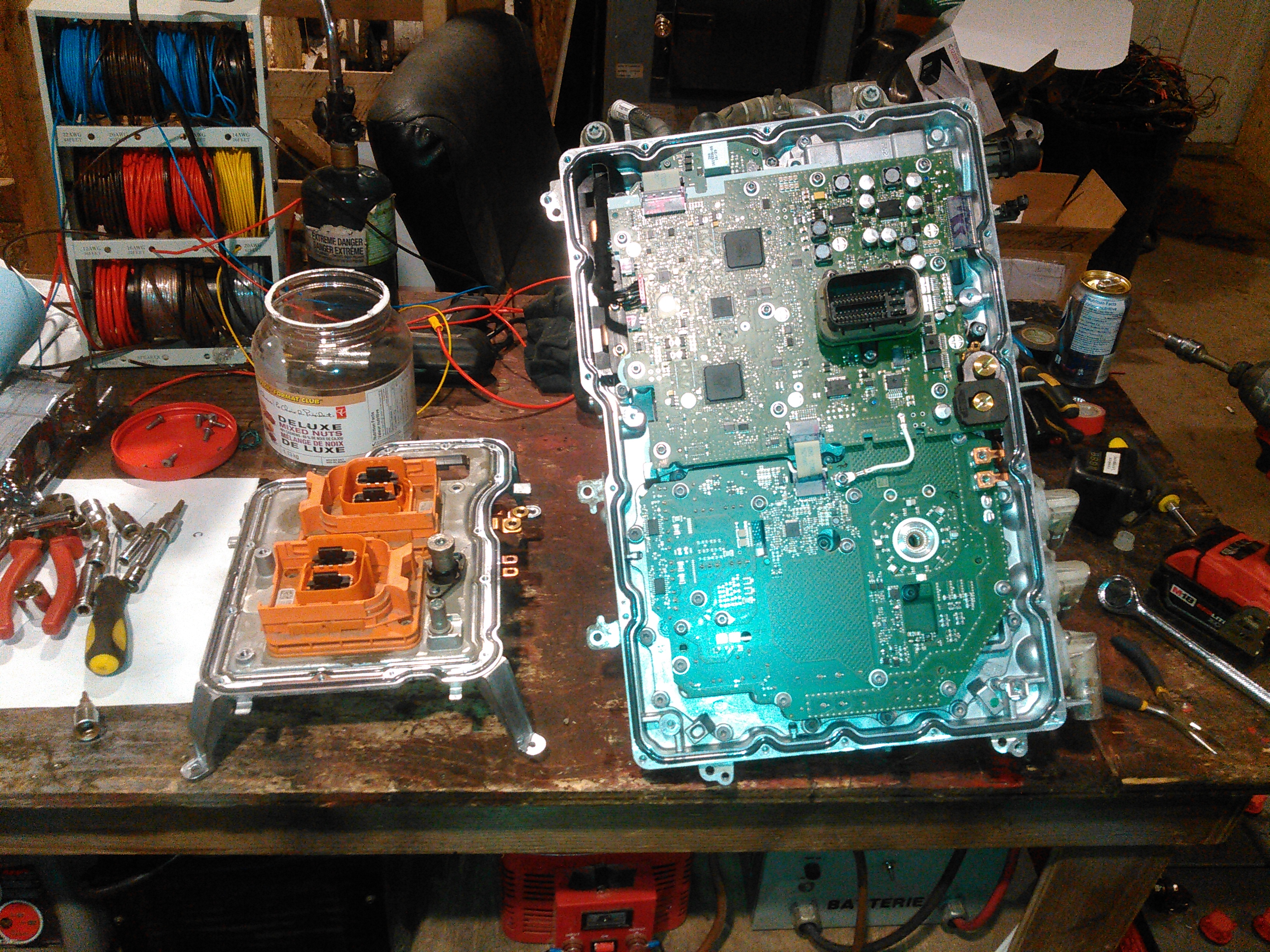

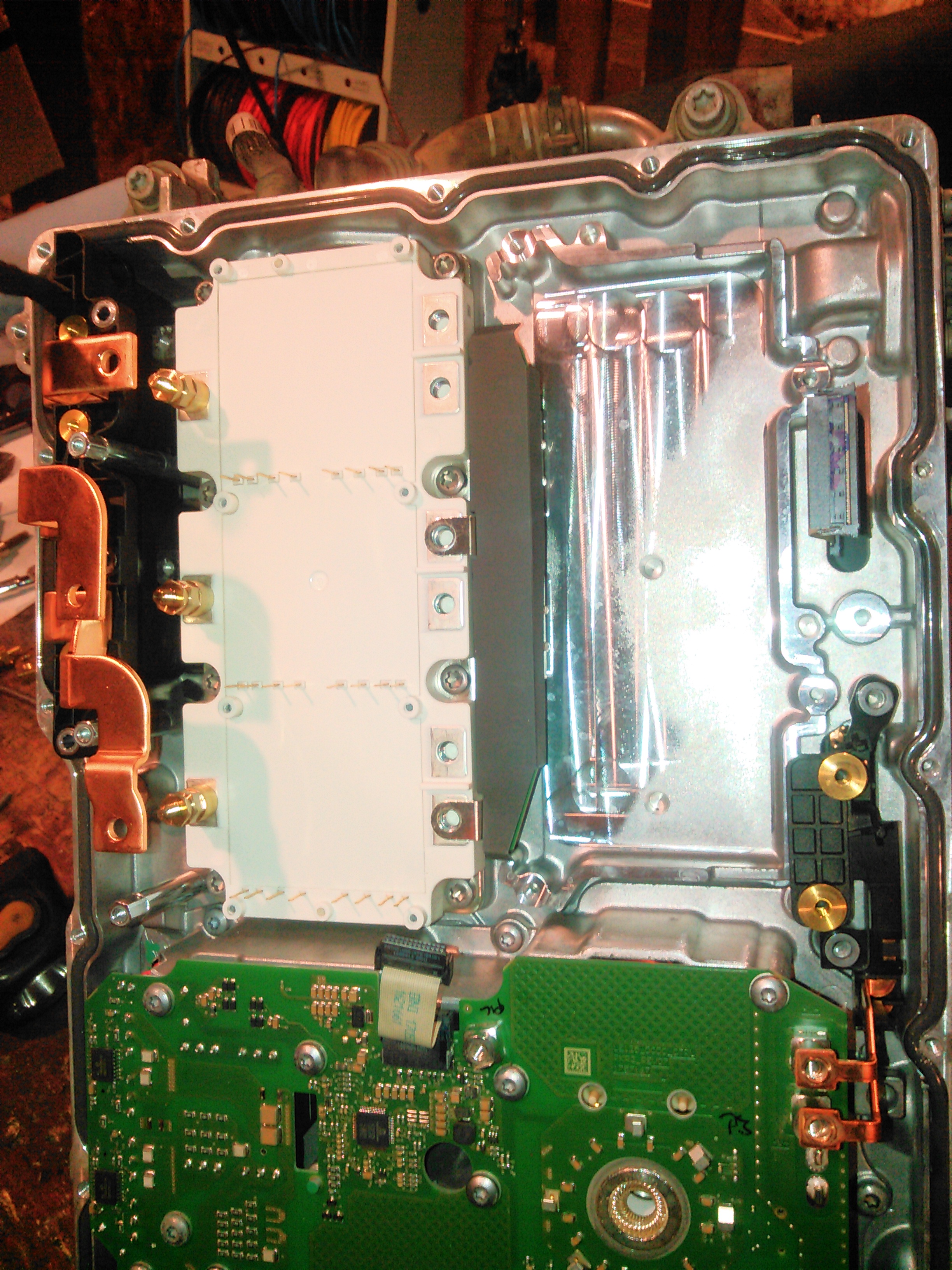

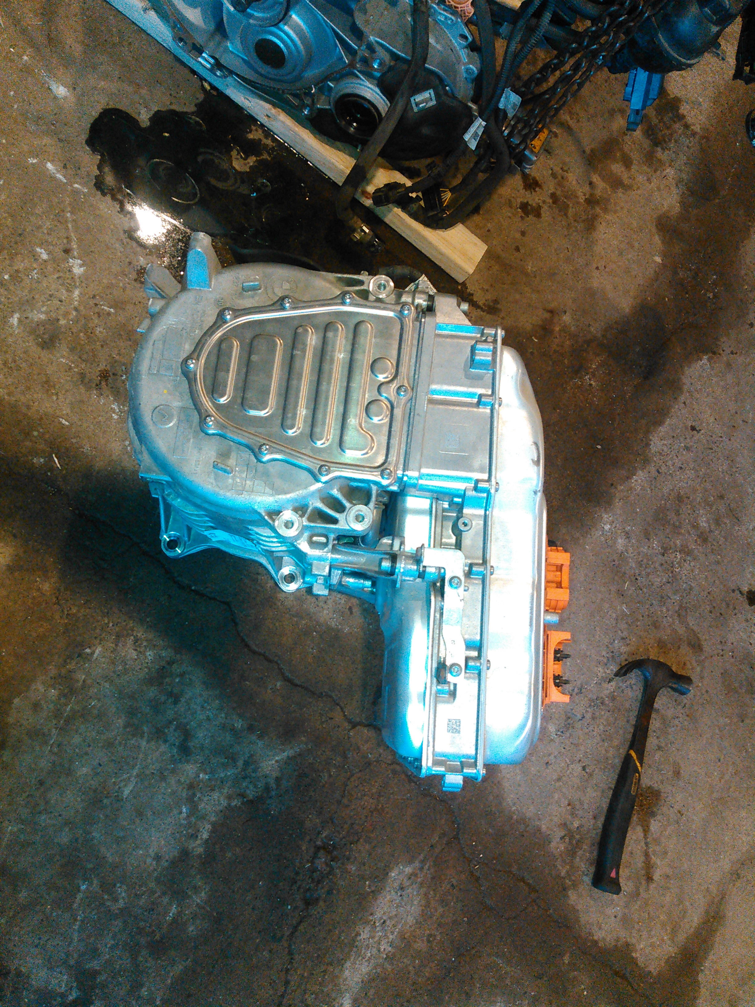

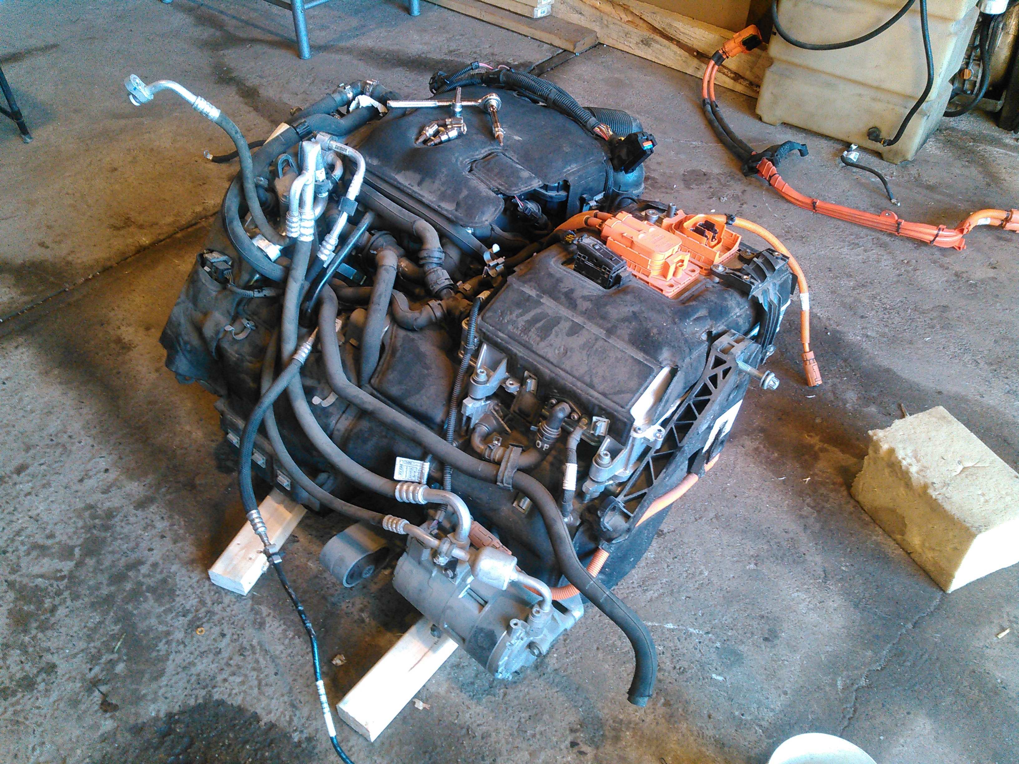

Today we have removed all the guts from the car and dismantled the controller, what a surprise... A single bloc 3 phases IGBT... here is some pictures of the progress

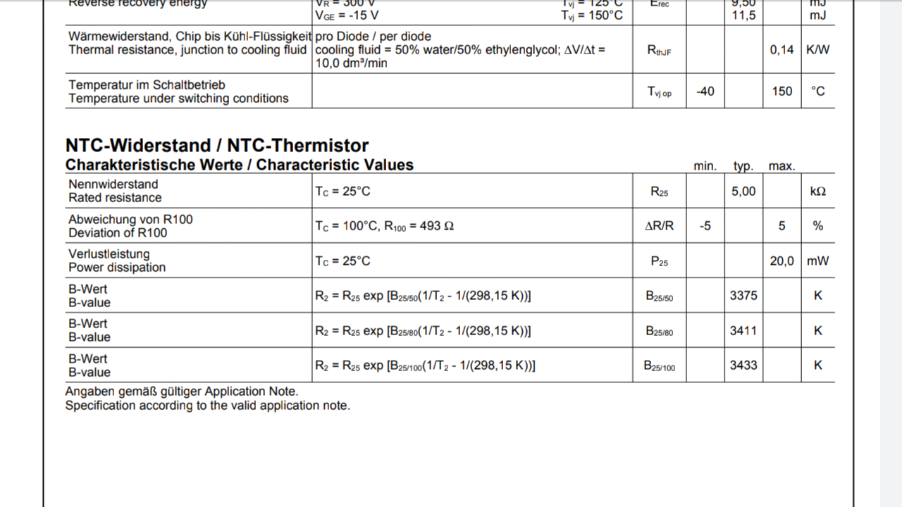

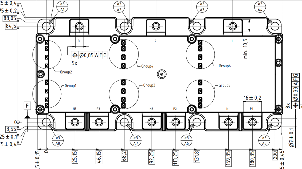

IGBT specs, they have 3 NTC thermistor built-in!!!

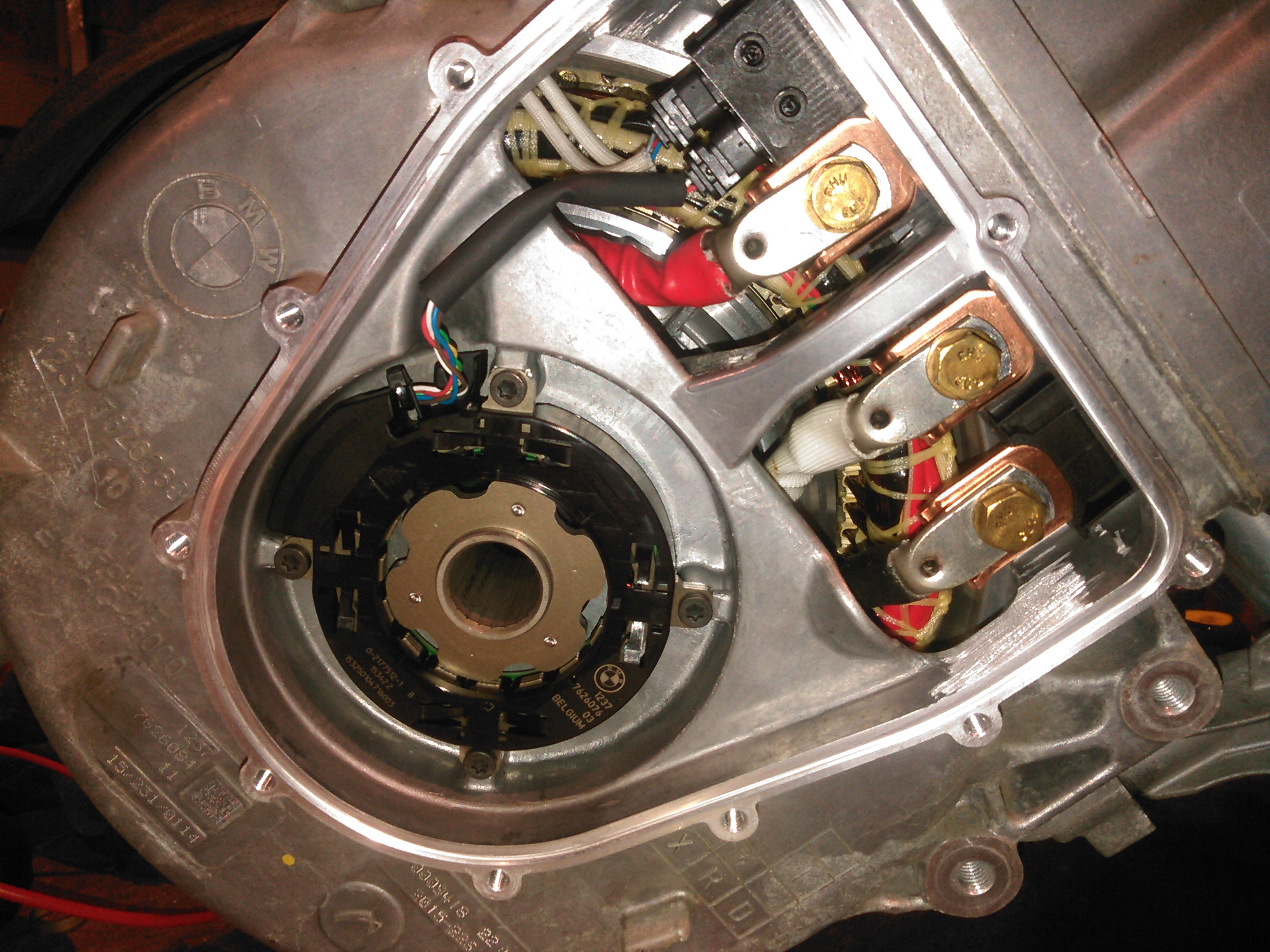

I have mapped most of the required signal from the original BMW inverter, here is a quick reference if somebody need it
The RESOLVER signals
Resolver
Resolver
Yellow and green pair (16 ohms) = EXCITATION
Red and white pair (26 ohms) = SINE or COSINE
blue and brown pair (26 ohms) = COSINE or SINE
The motor Winding signals
(Look like to be 10K NTC... more testing needed)
Bleu and gray pair = 10K NTC thermistor
Red and gray pair = 10K NTC thermistor
The complete signal cable pinout (resolver and winding thermistor)

IGBT module
IGBT
IGBT
LEFT TO RIGHT (AS PICTURED)
1= E+ (output+)
2= G+
3= C+ (input+)
4= T1 (5K NTC thermistor)
5= T2 (5K NTC thermistor)
6= C- (output-)
7= G-
8= E- (input-)
IGBT SPECS SHEET
Infineon-FS800R07A2E3-DS-v03_02-EN-1226878.pdf
IGBT specs sheet
(705.12 KiB) Downloaded 241 times

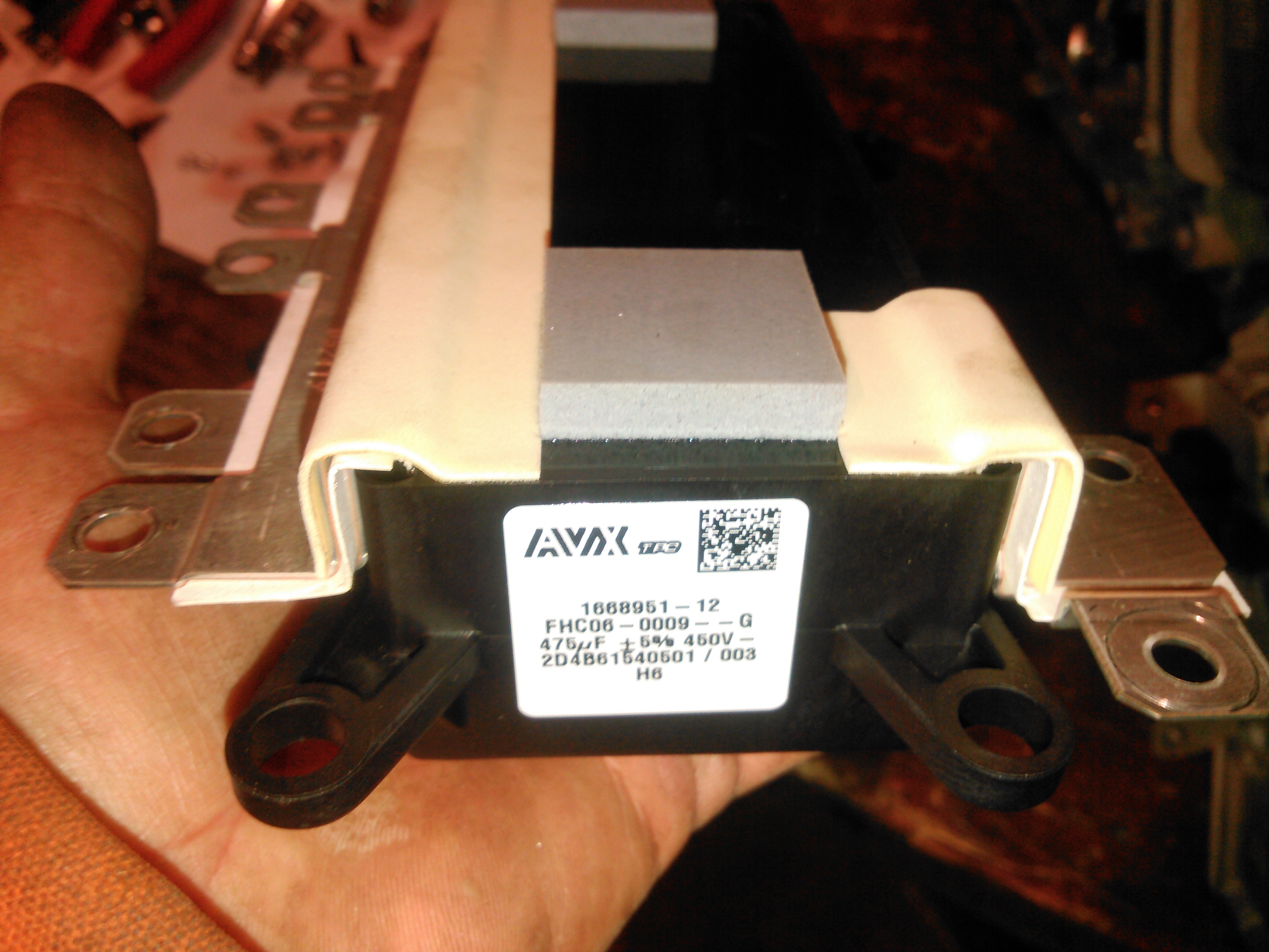

Went through my notes on the i3 inverter. Attached what I could find.
Here is my old thread over on diyelectric :
