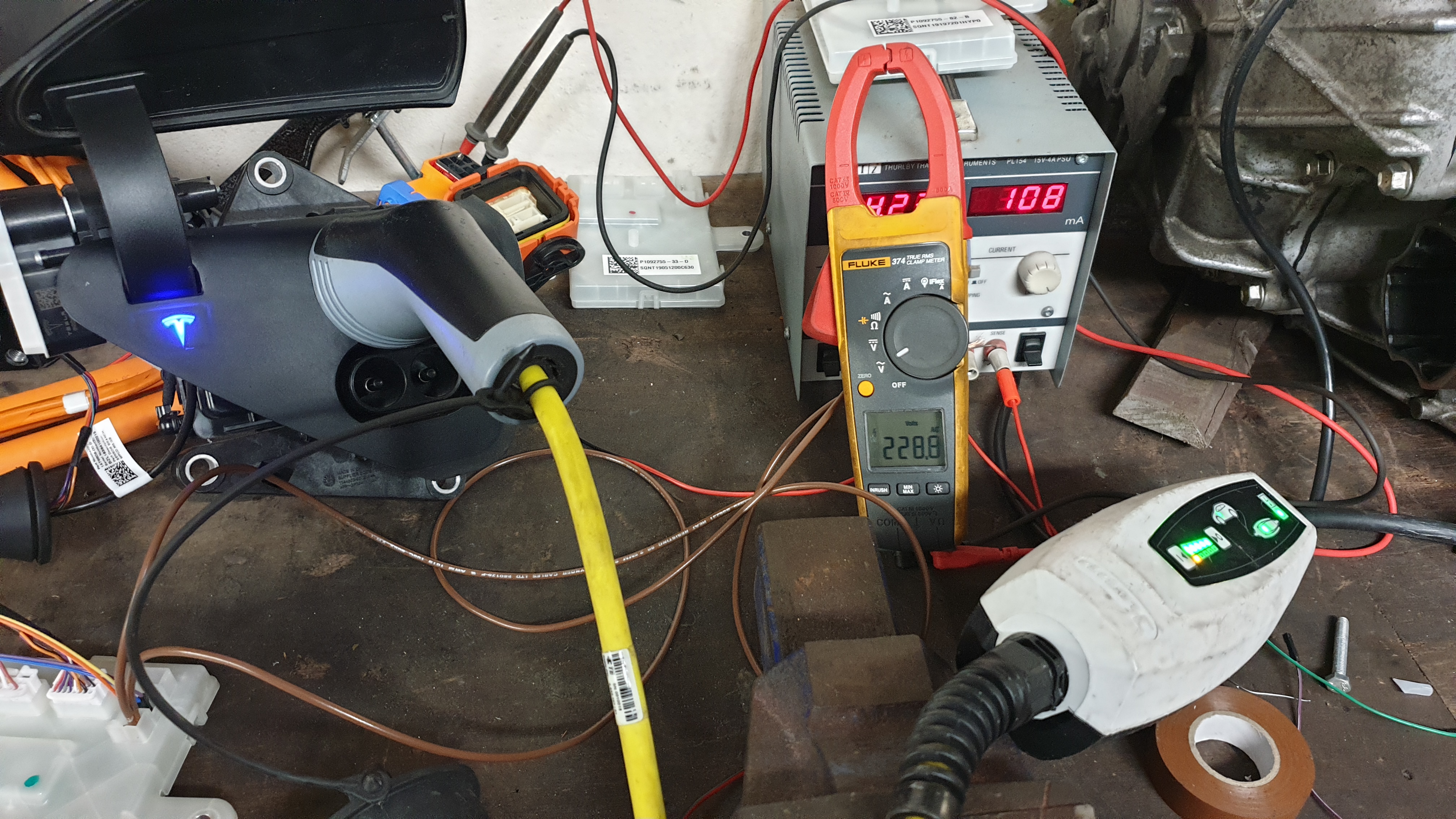

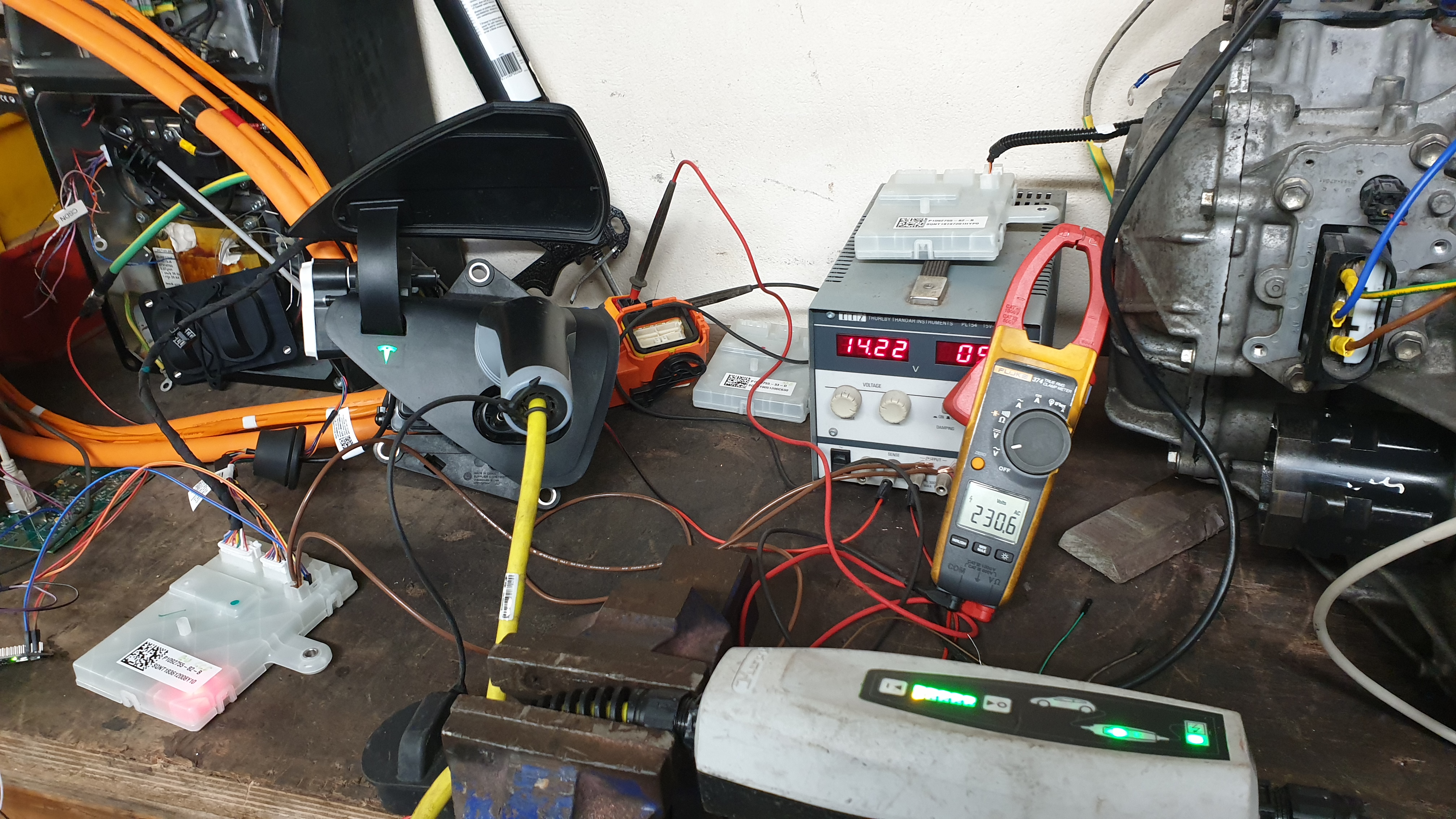

Re: Tesla Model 3 Charge Port Controller Standalone Development
We are charging! I couldn't sleep tonight without knowing:) But....my elon is solid blue when charging. I want a green pulsing elon :)

mdrobnak
Posts: 692
Post by mdrobnak »
Awesome! Yep, something is odd, gonna work on that today. :)

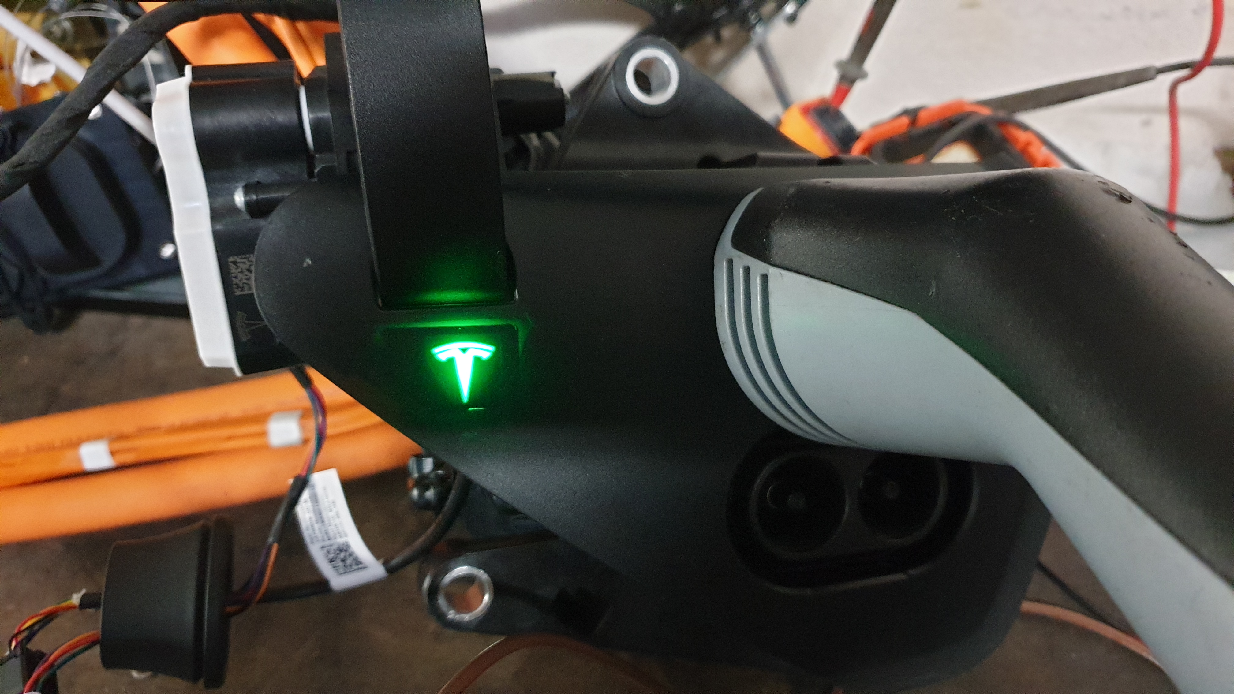

The pulsing green T of happiness:)

mdrobnak
Posts: 692
Post by mdrobnak »
I'm curious if the pulsing speed is fast like in my previous video, or more slowly like that of my newer firmware unit. I just saw Instagram, looks like yes it is a quicker pulsing.
Glad to see that we're one step closer.
Updated first post with state of world.
I have a small bug that I'm going to try and fix with the state machine not going from Standby -> Charge Enabled, and then I think I might start messing with the DC stuff. I'll look over the CCS log I have, but will mess with CHAdeMO first.
-Matt

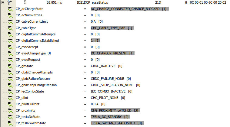

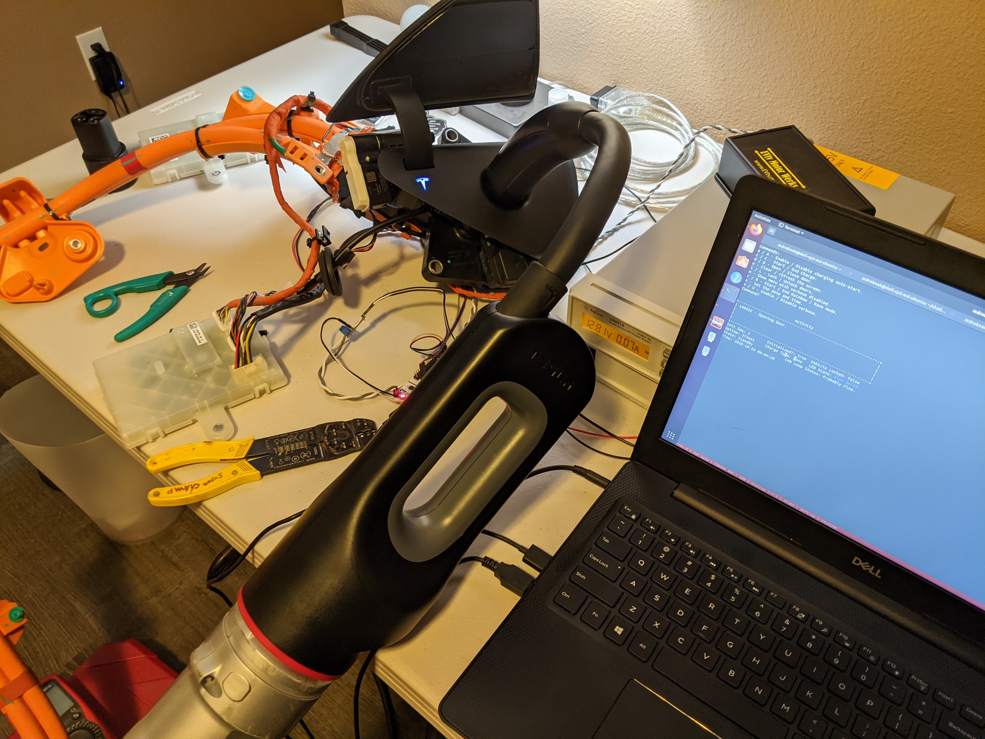

mdrobnak
Posts: 692
Post by mdrobnak »
I got it attached. I attached CAN wires to the STM32F7 board, and just sent 0x108 and 0x109 on there. That ran to the CHAdeMO cable. I ran 12V from the terrible Best Buy 12V adapter to pin 1 and 2. The adapter has a green LED on it, so I don't think I screwed up anything on that side. (It's usually powered by the station) However I didn't capture messages on that side, so I'm not sure what was sent out on the adapter.
On the CP side, I see it says "PILOT_FAST_CHARGE"...and then fails, and does it again, about 5 times. Then gives up completely, and sits with the blue LED. So, the good news is I think I got it wired up right. The bad news is it doesn't work yet. :D
-Matt
