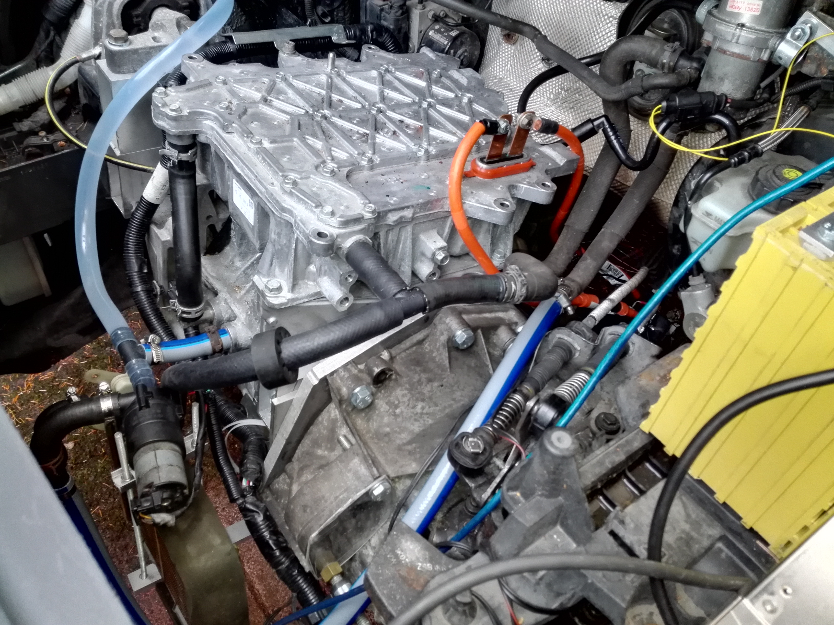

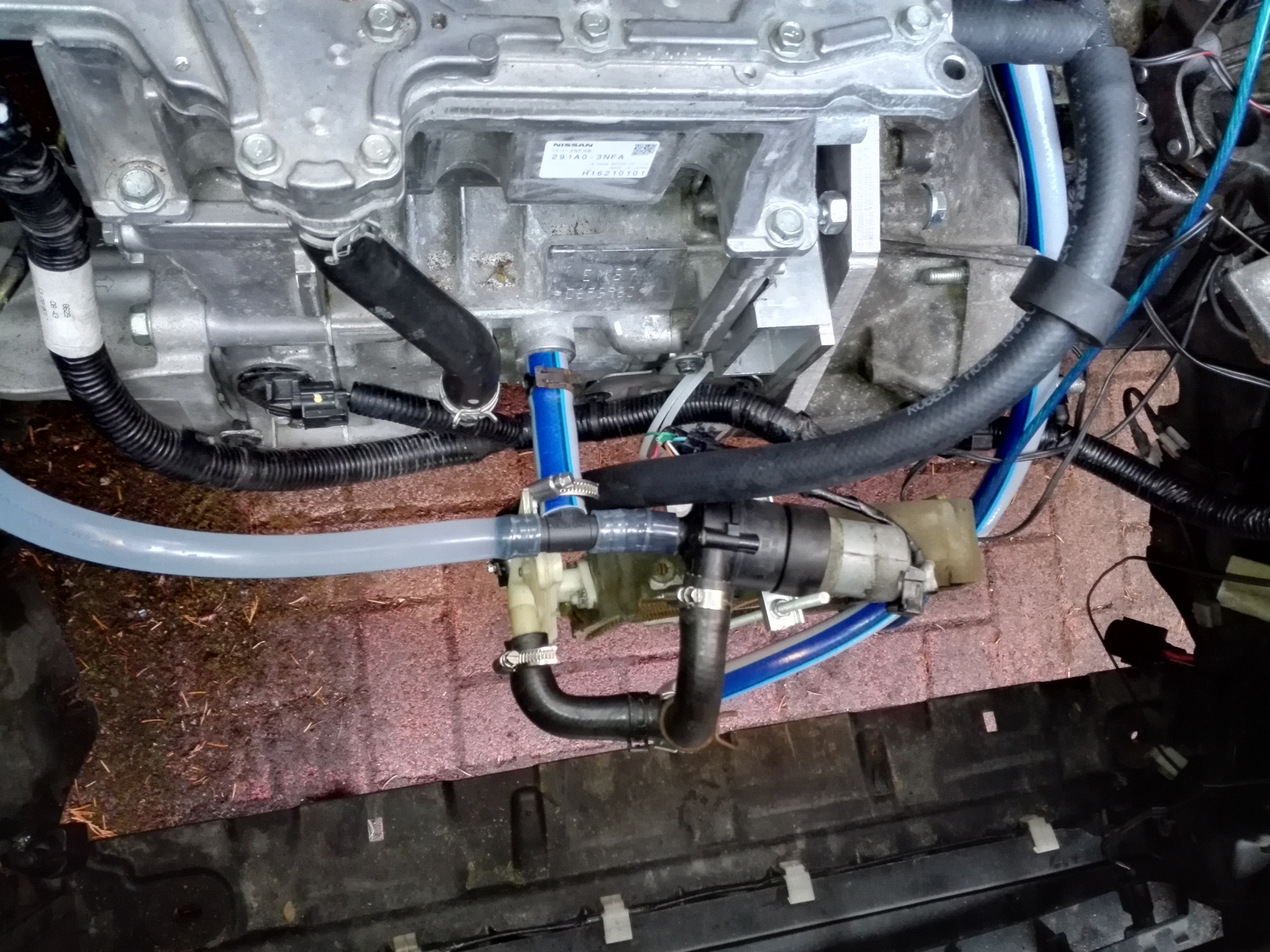

Now, here some pictures of my cooling system tubing in Touran.
Been thanked: 1914 times
