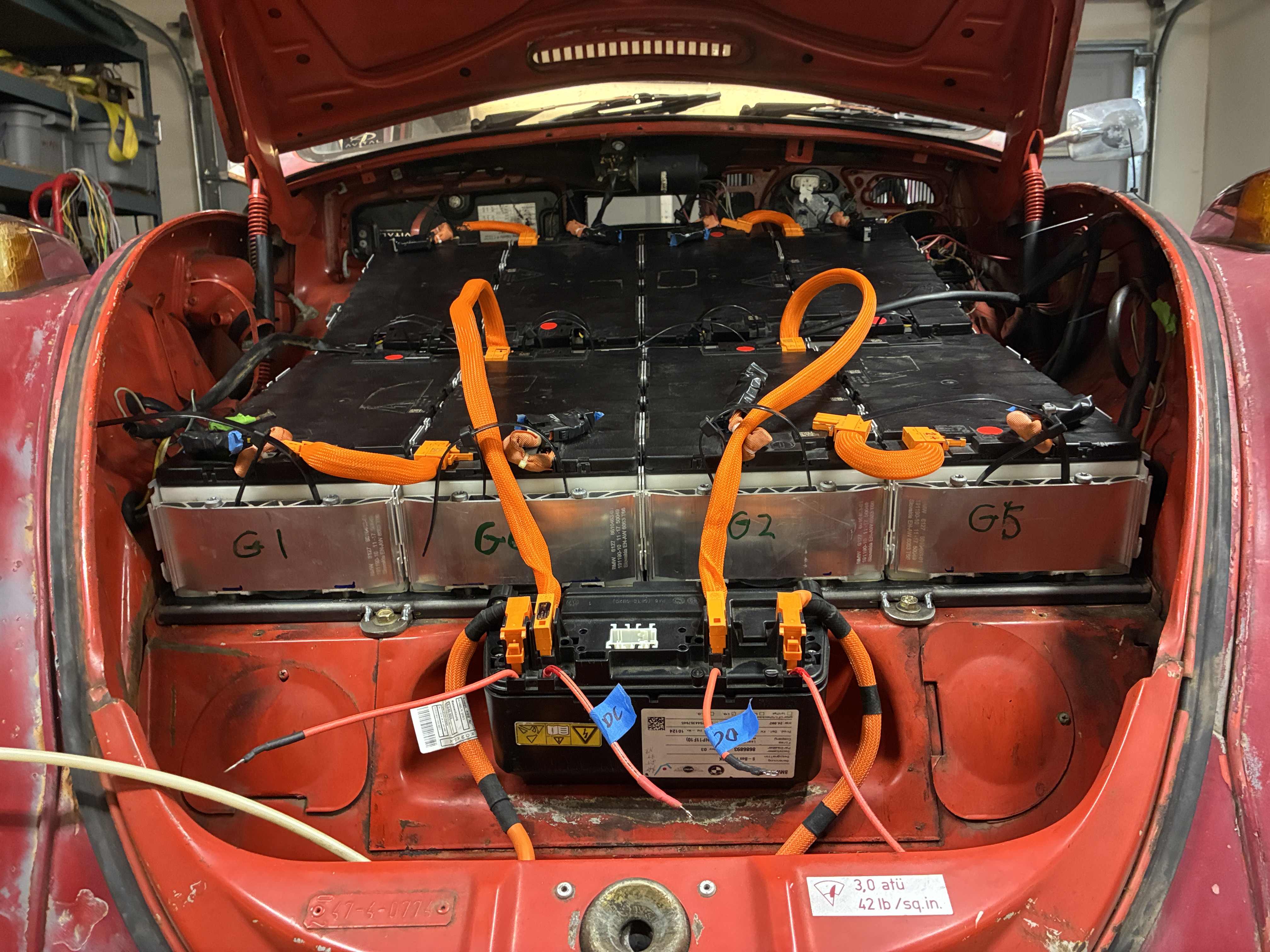

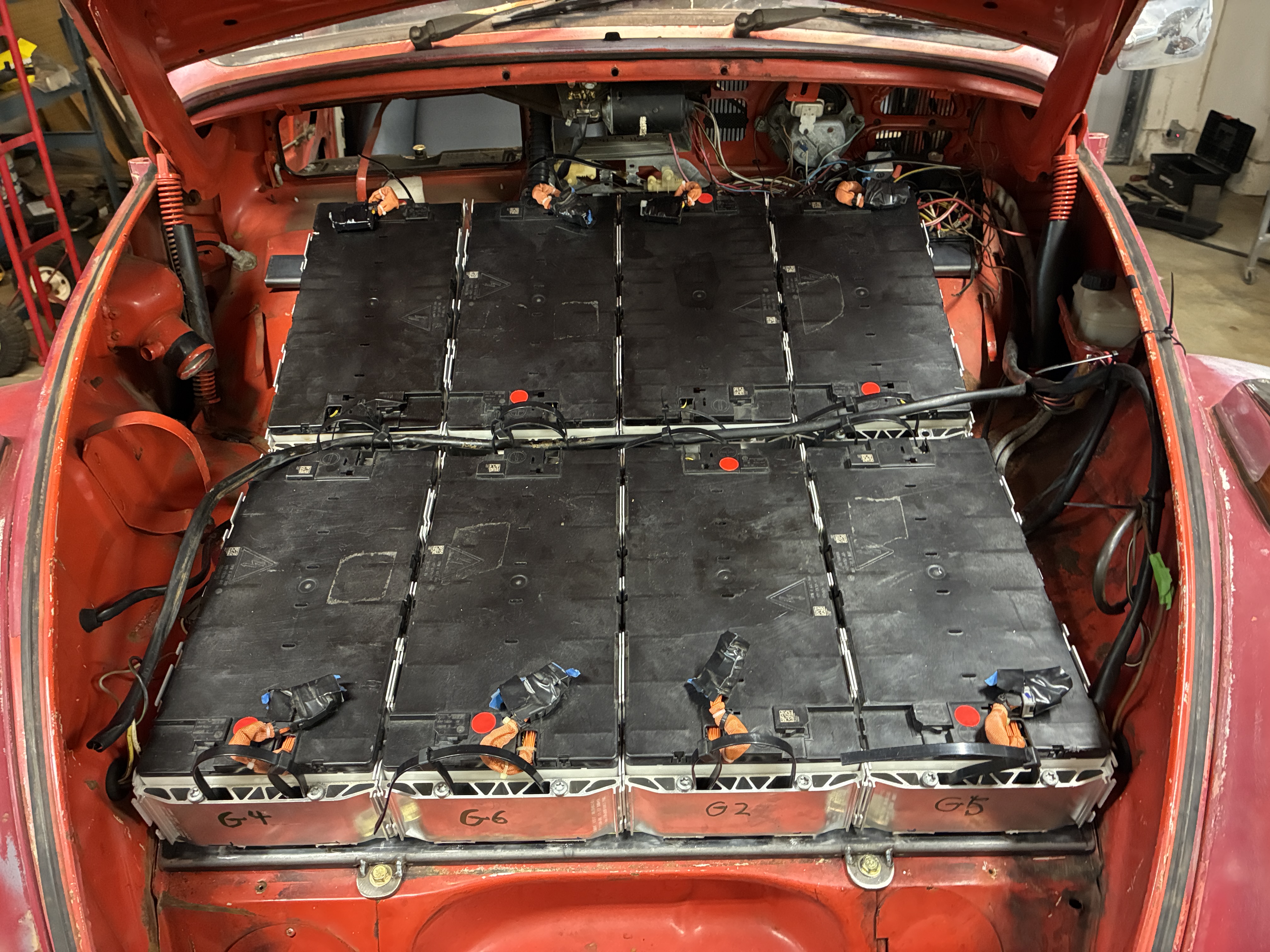

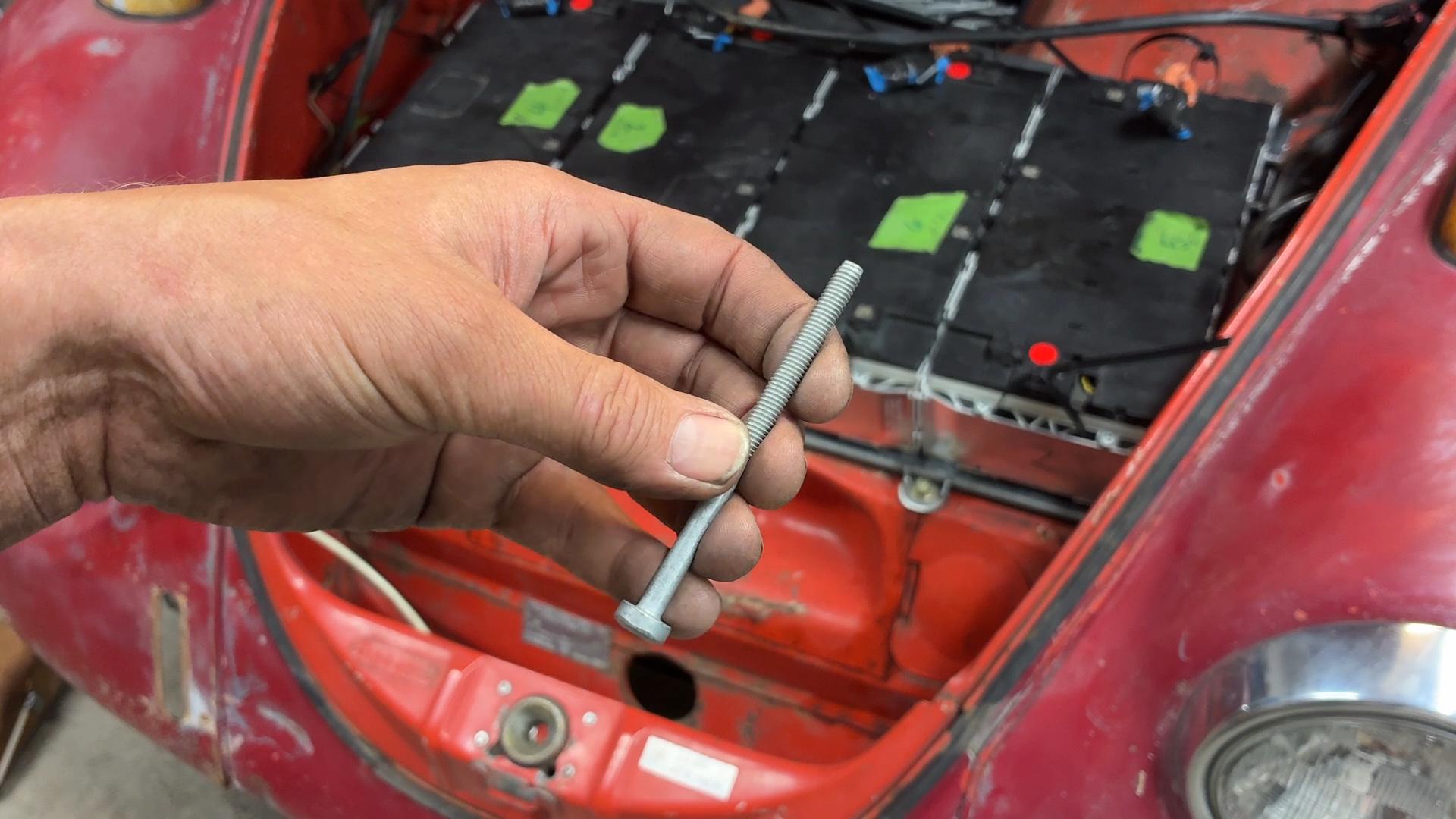

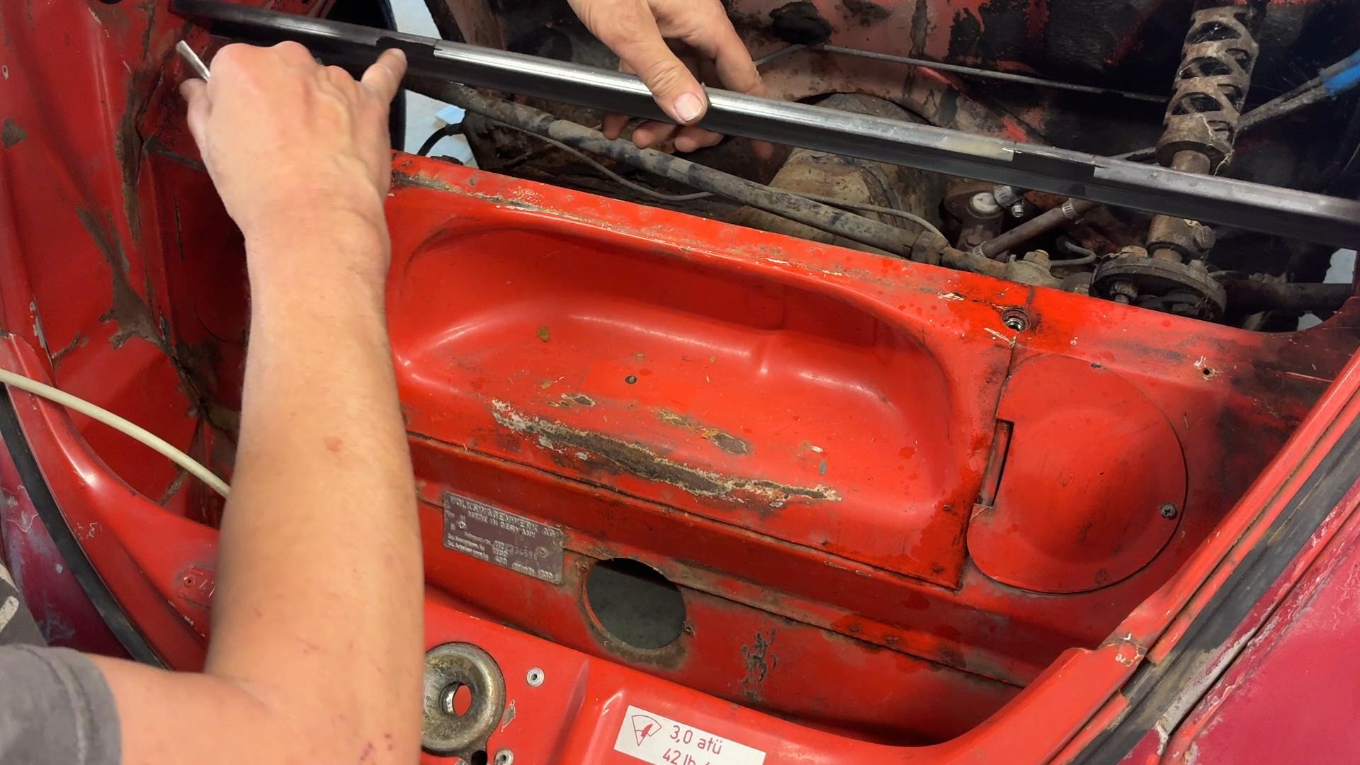

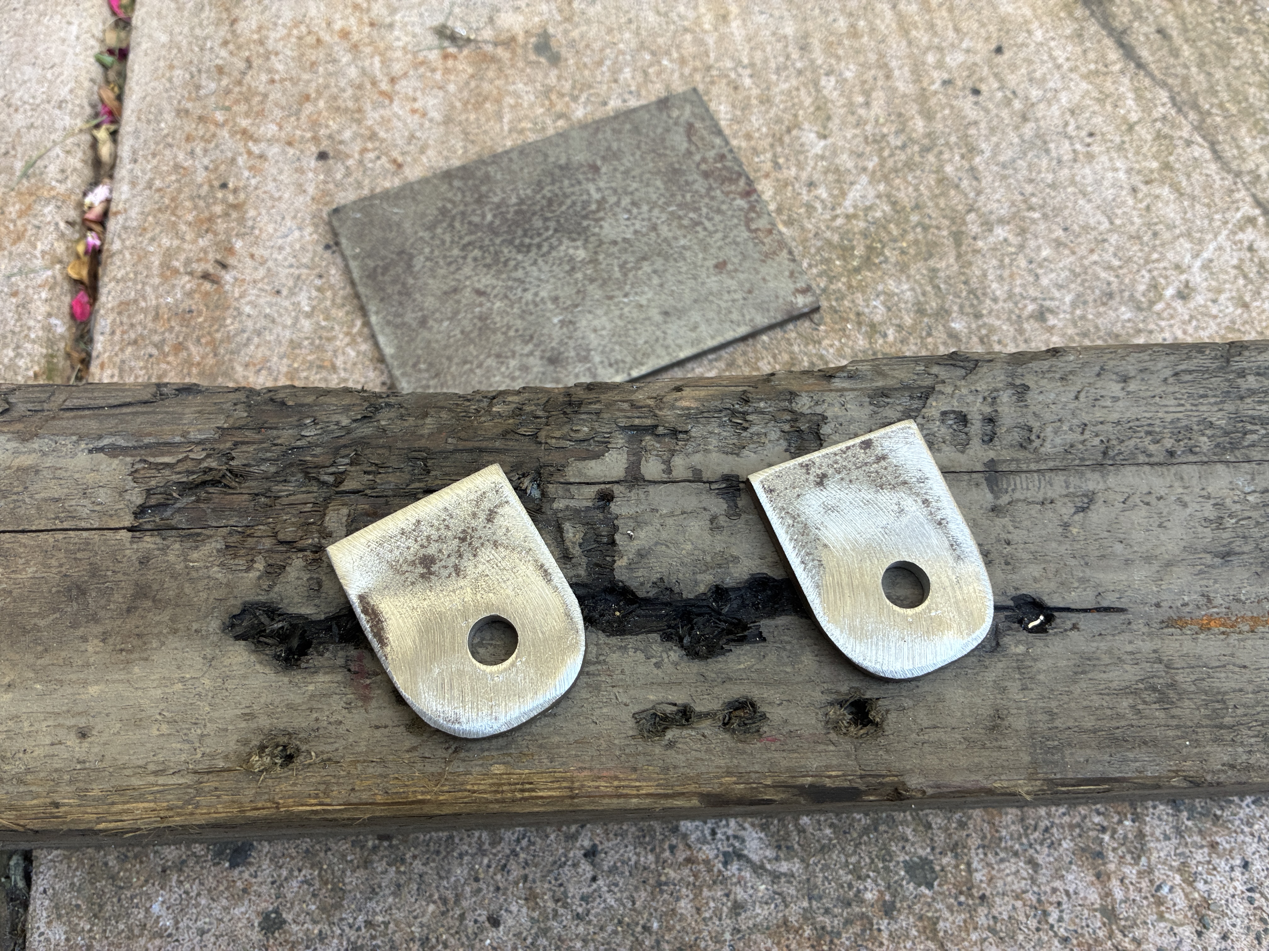

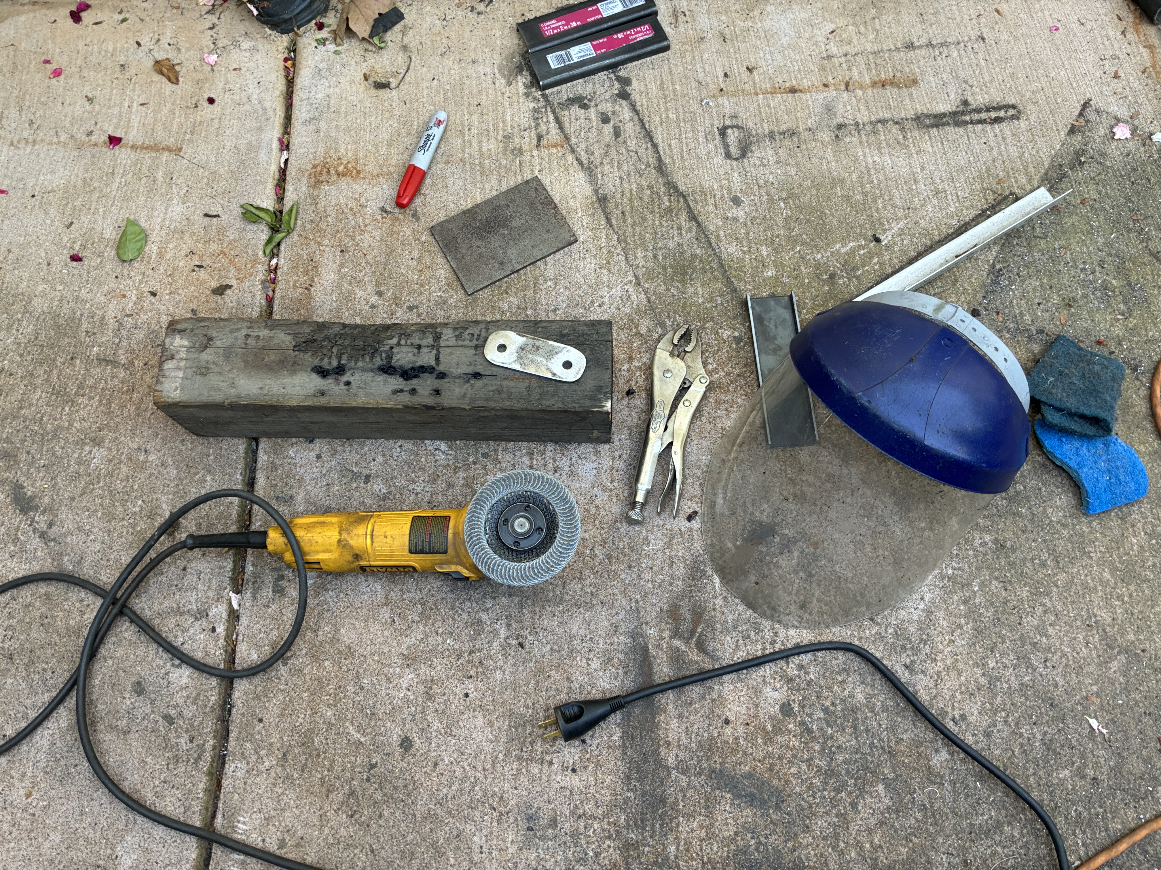

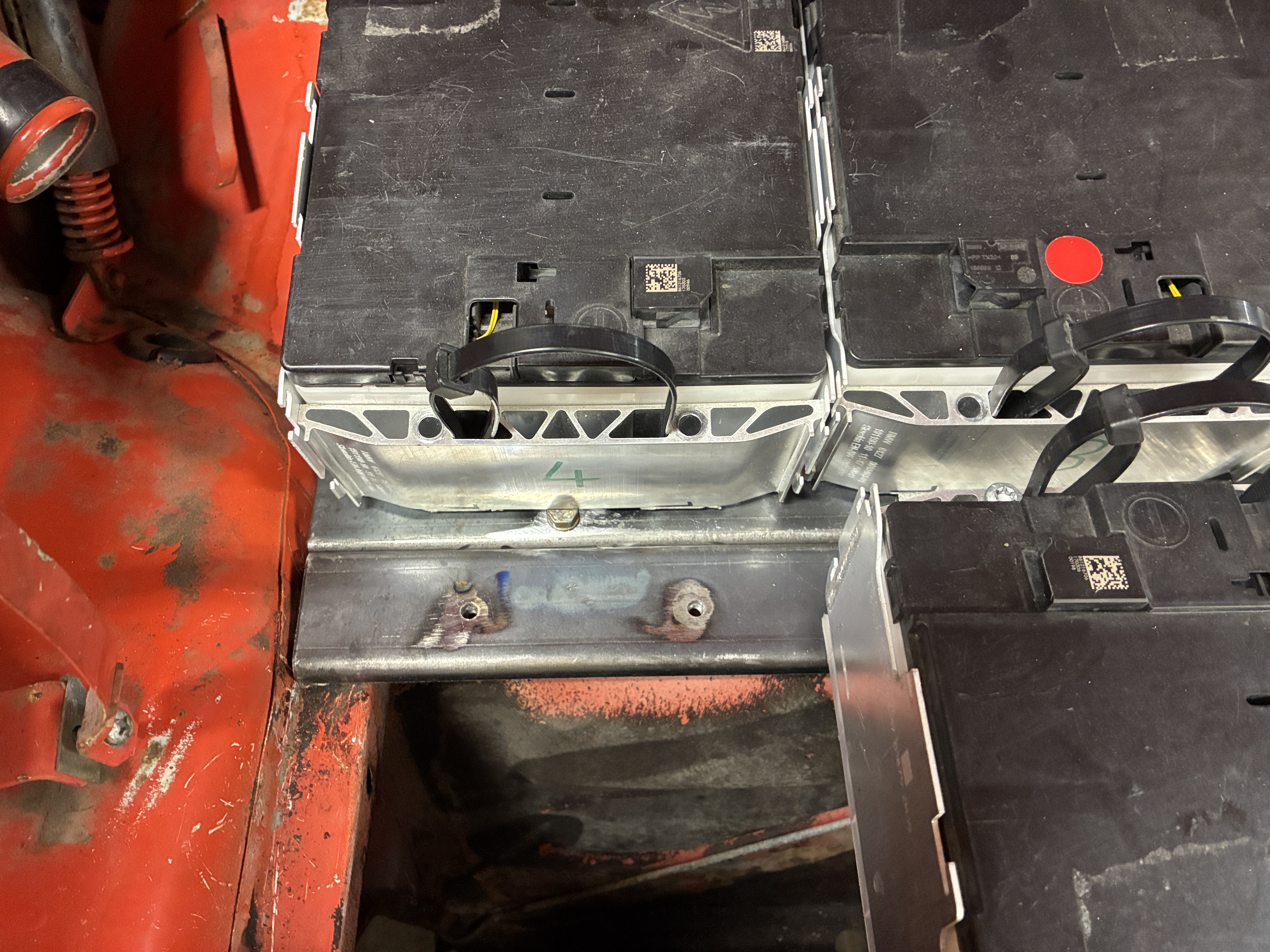

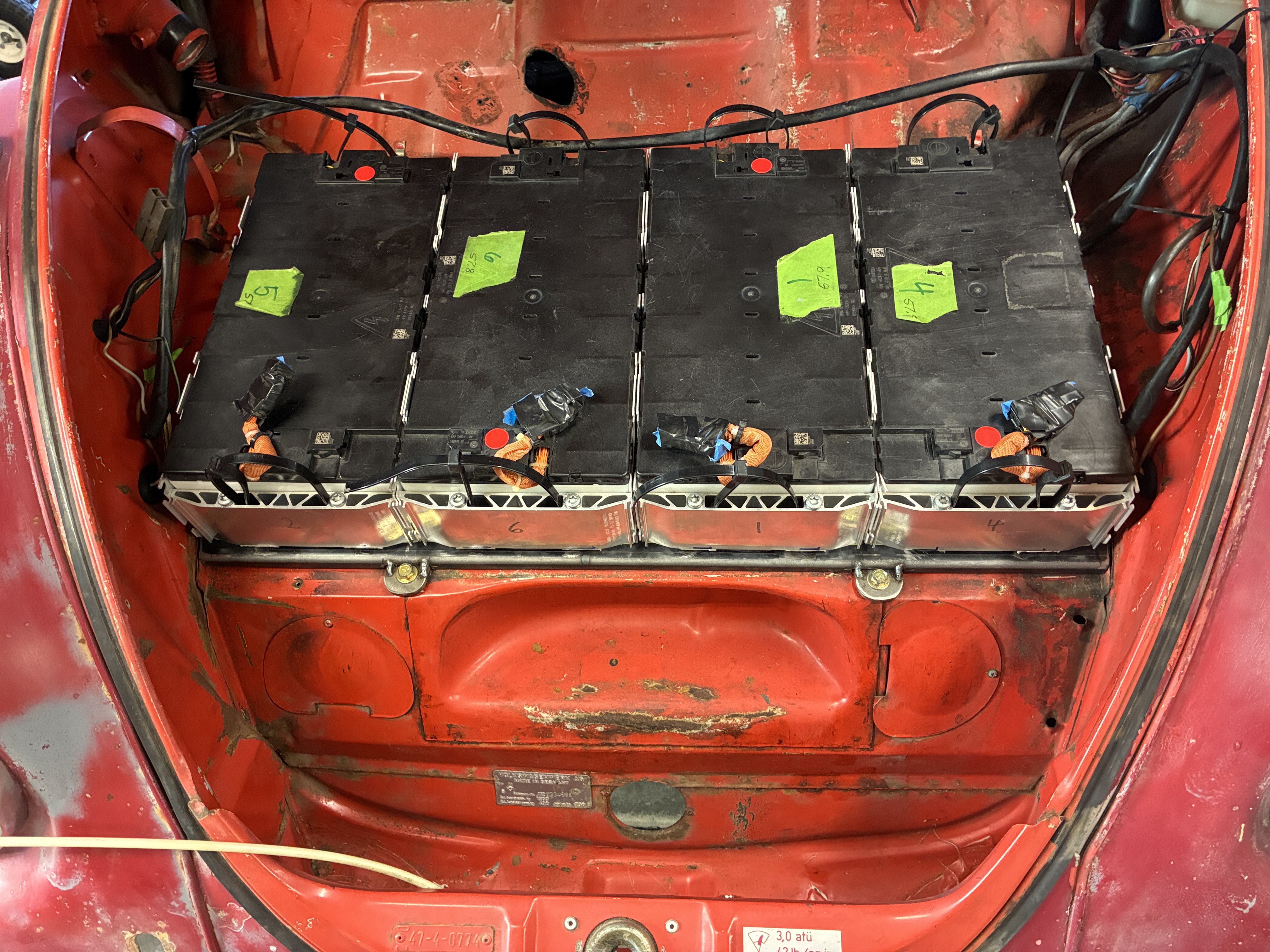

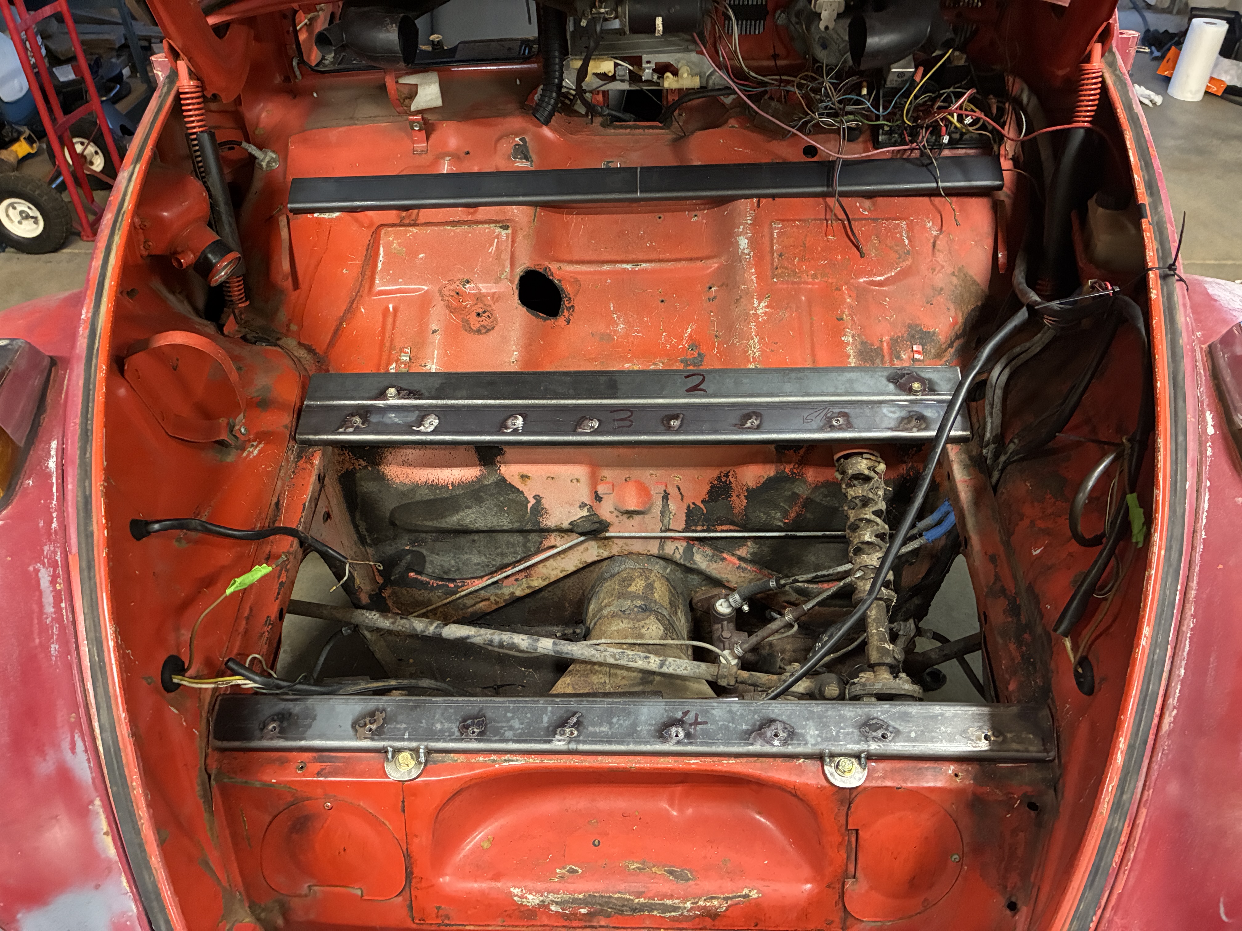

5th weekend of the build was spent on mounting the battery pack, eight BMW 530e hybrid modules
here is the general idea (four sticks across, and eight modules up and down, sardines style)
so we make the mounting brackets to take advantage of the fuel tank mounting points
sometimes you have to spend time doing nonsense like this
Gregski
Posts: 3157
Has thanked: 628 times
Been thanked: 1606 times
Re: Bunky the eBug: A 30 Day EV Conversion
Post by Gregski »

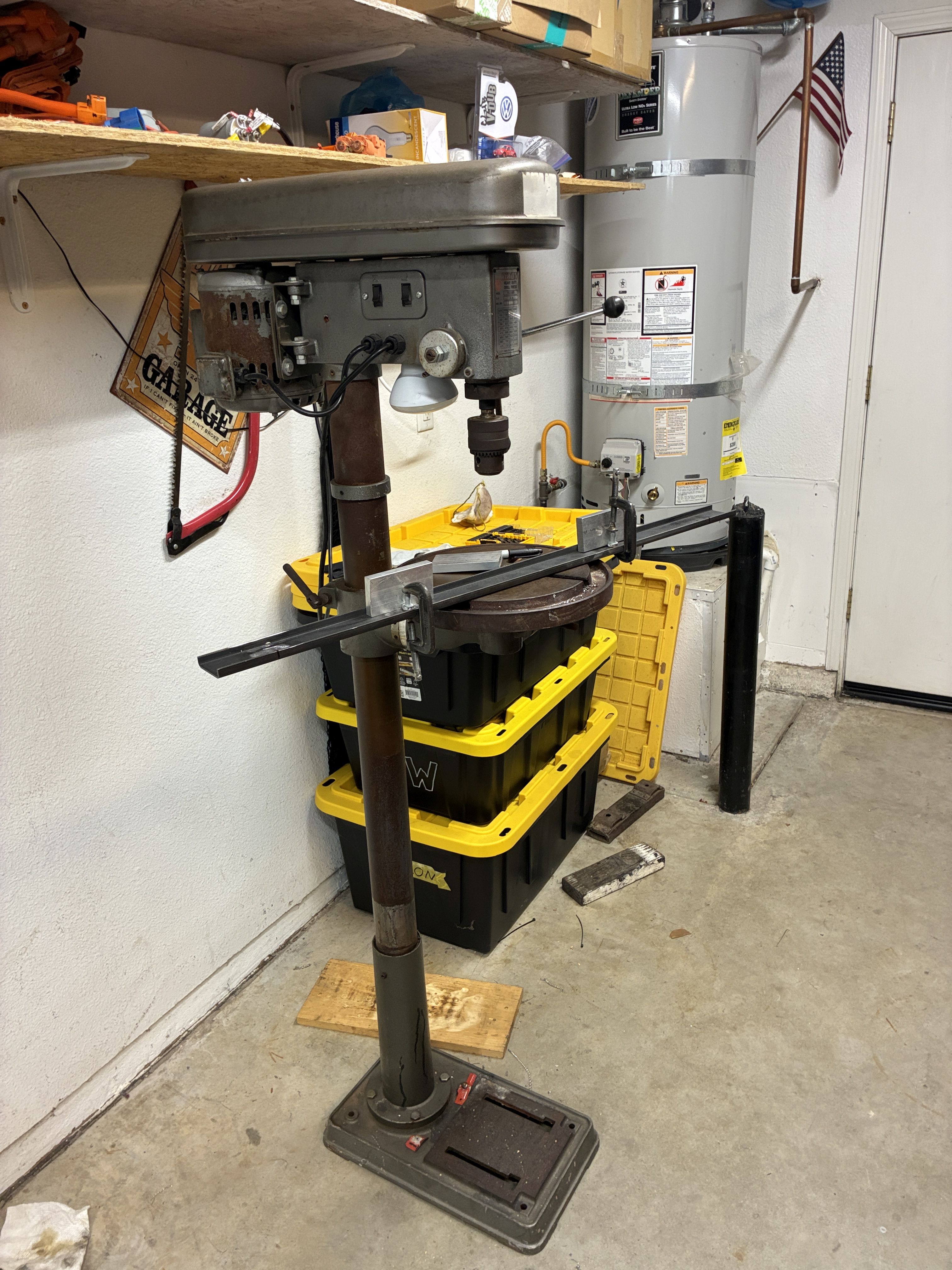

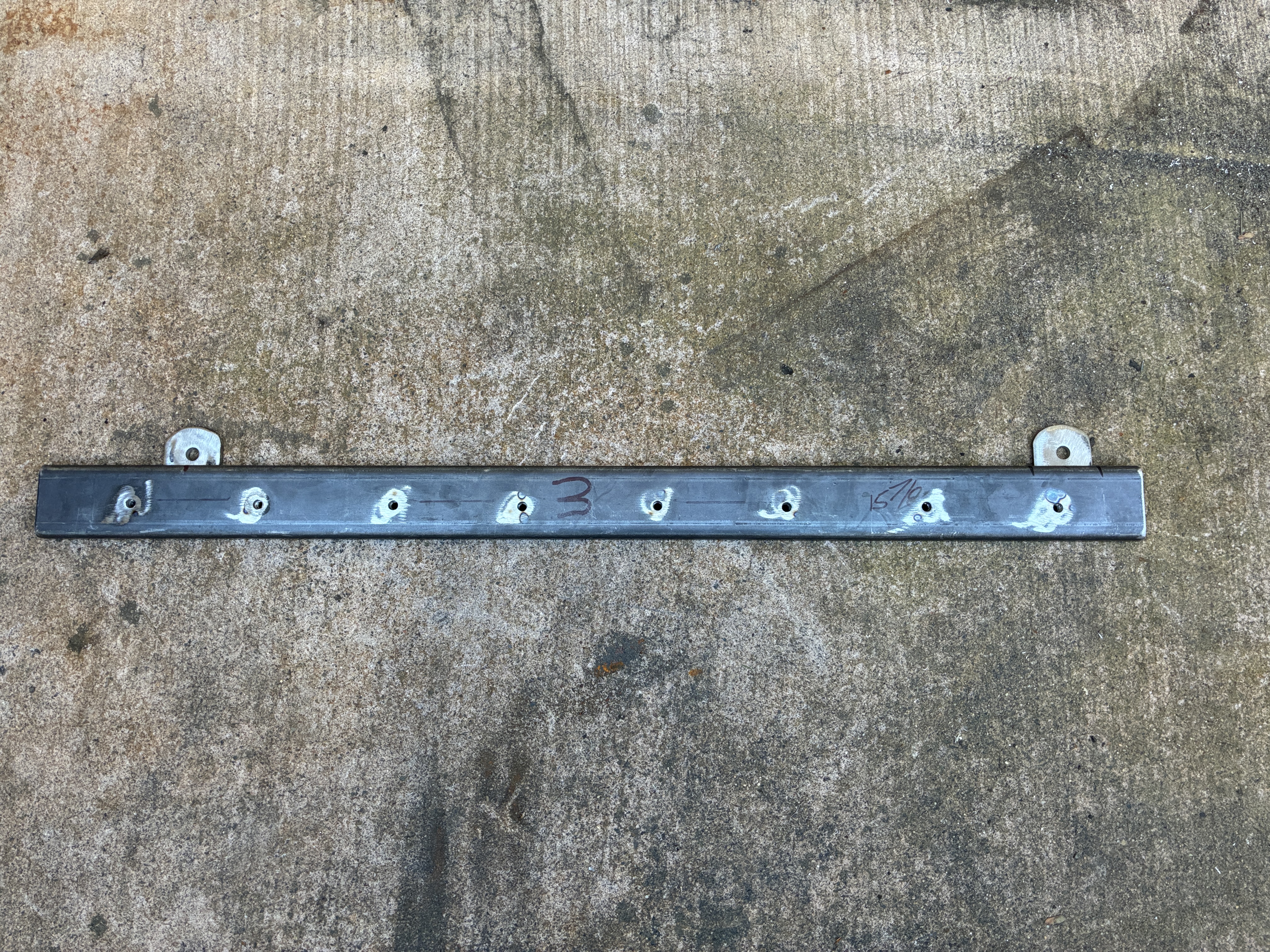

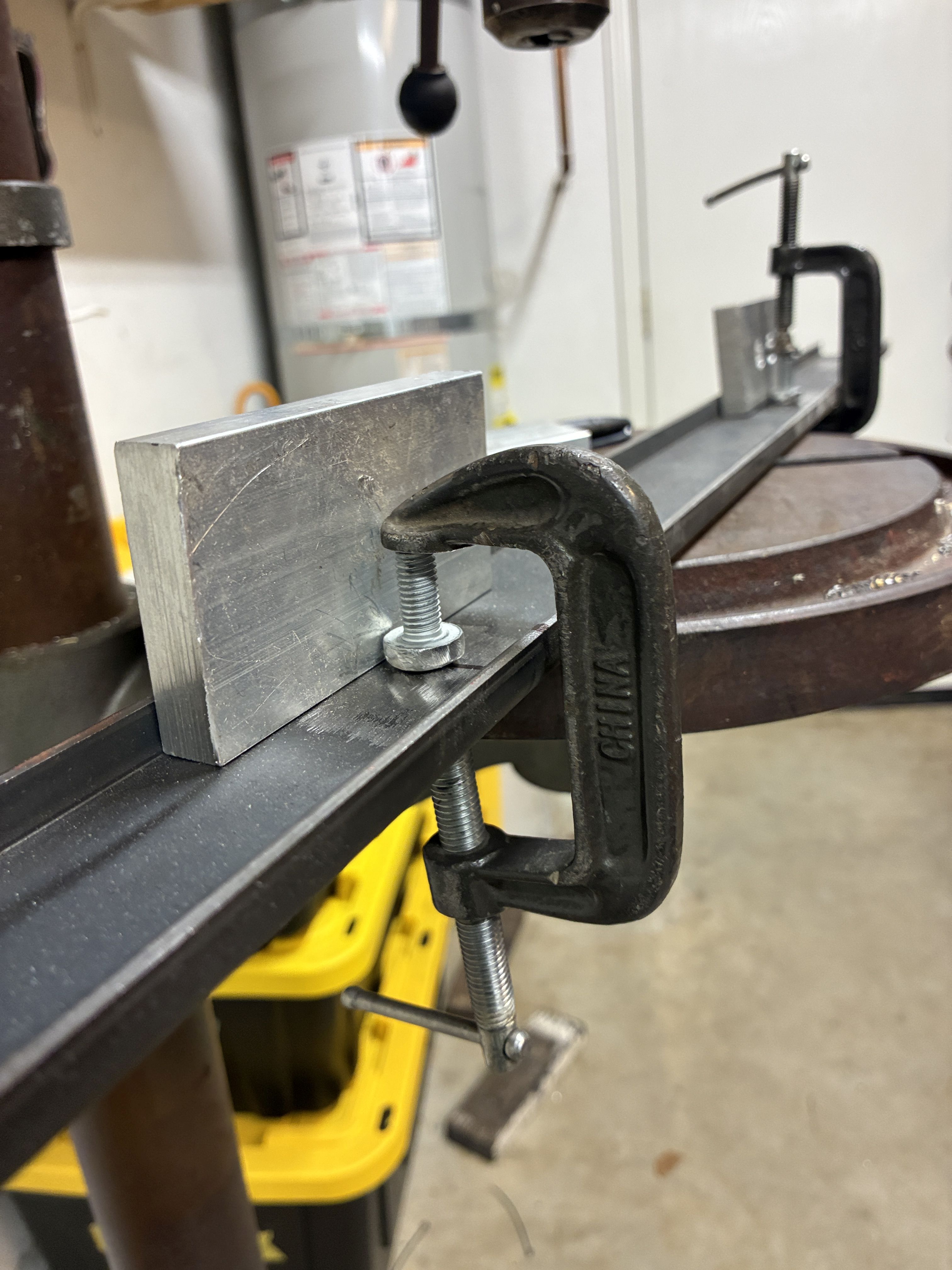

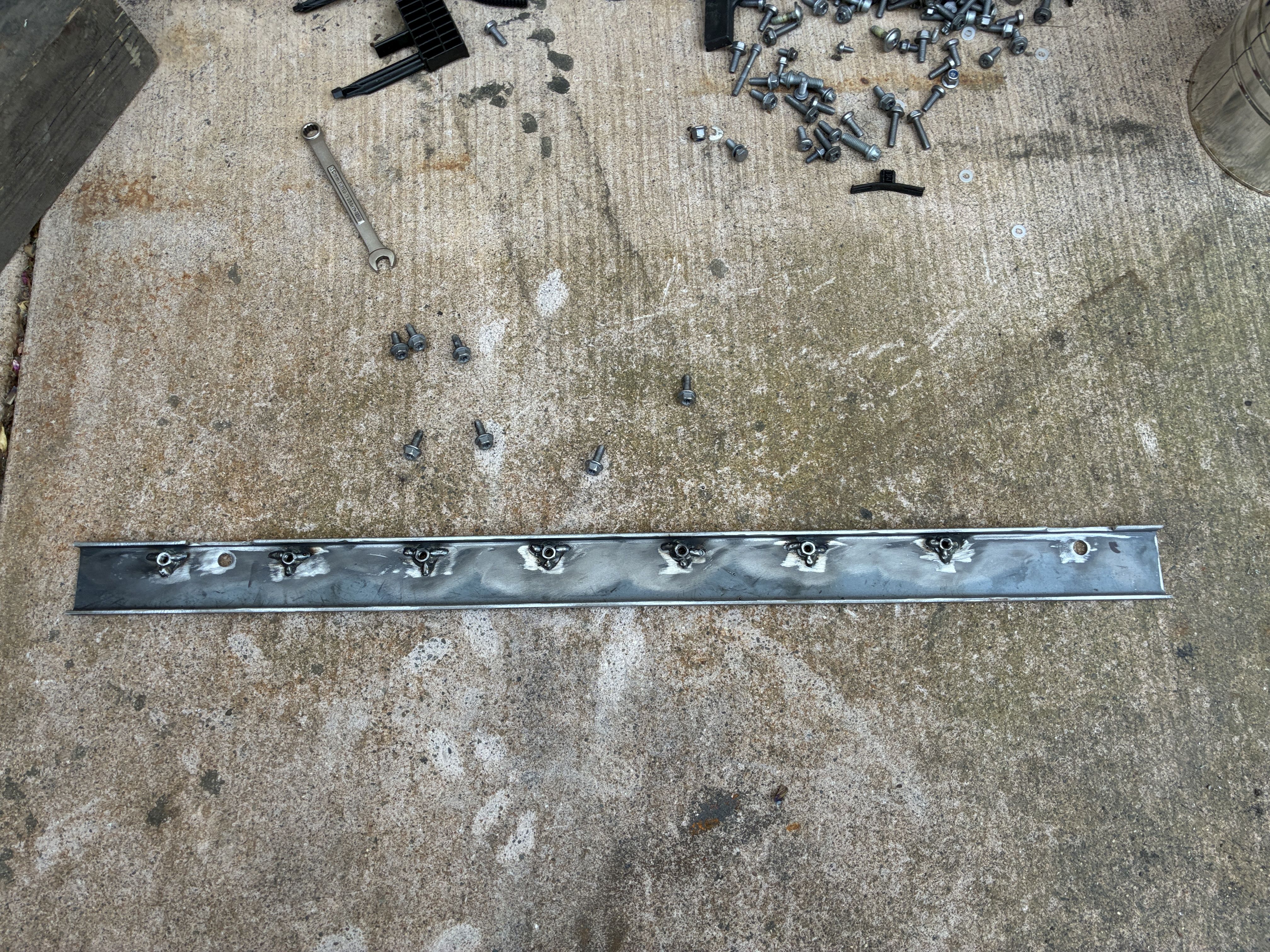

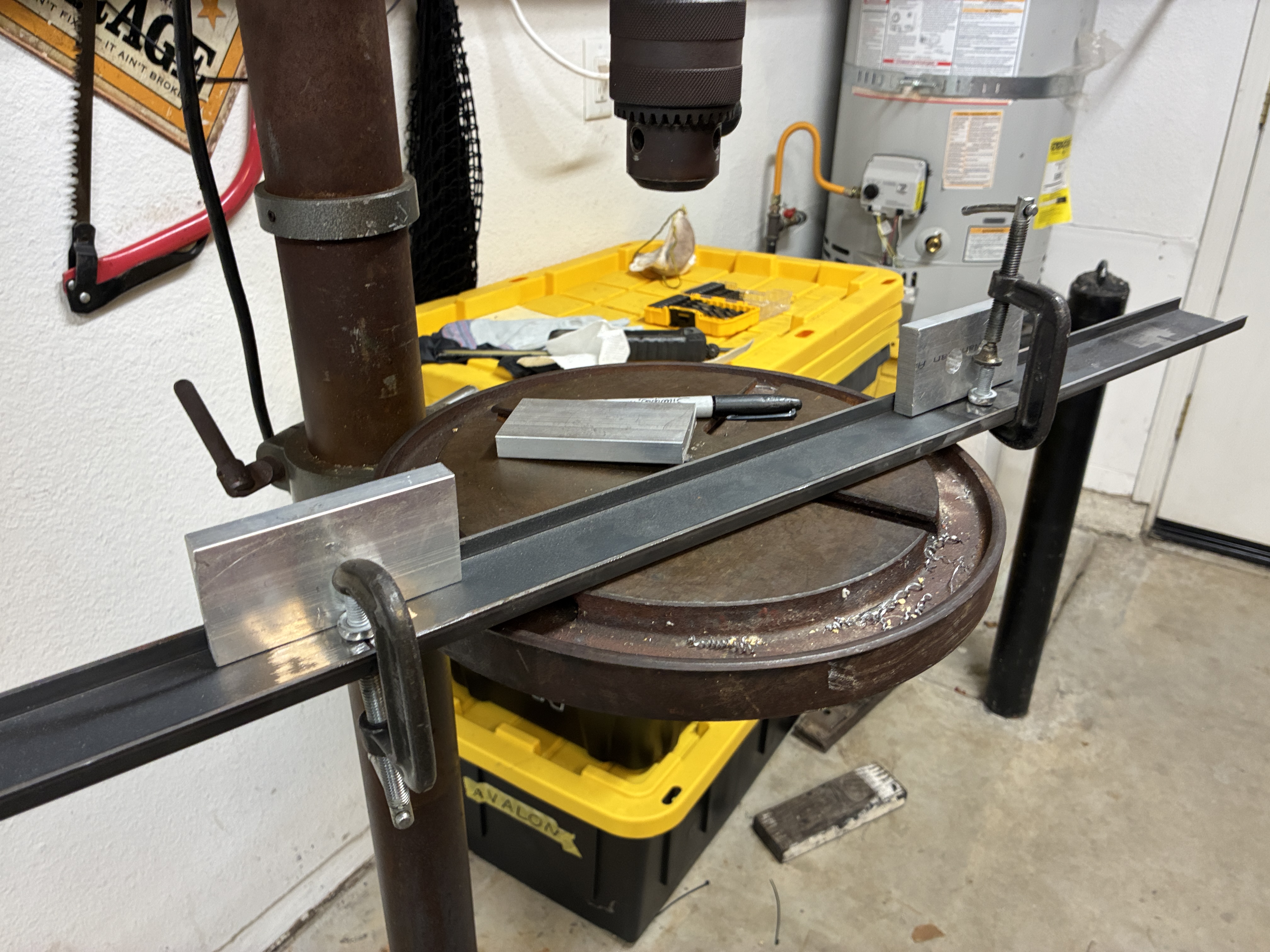

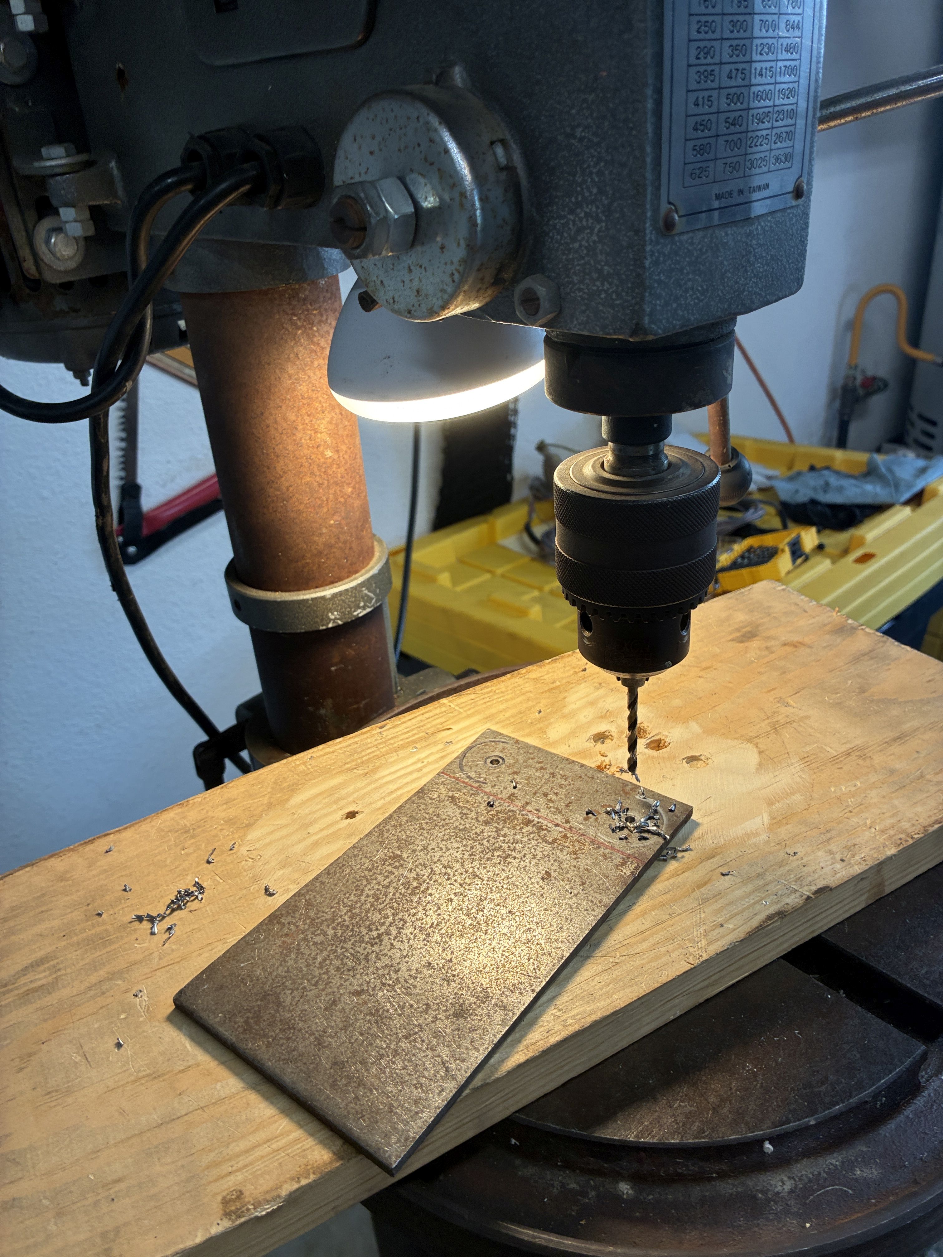

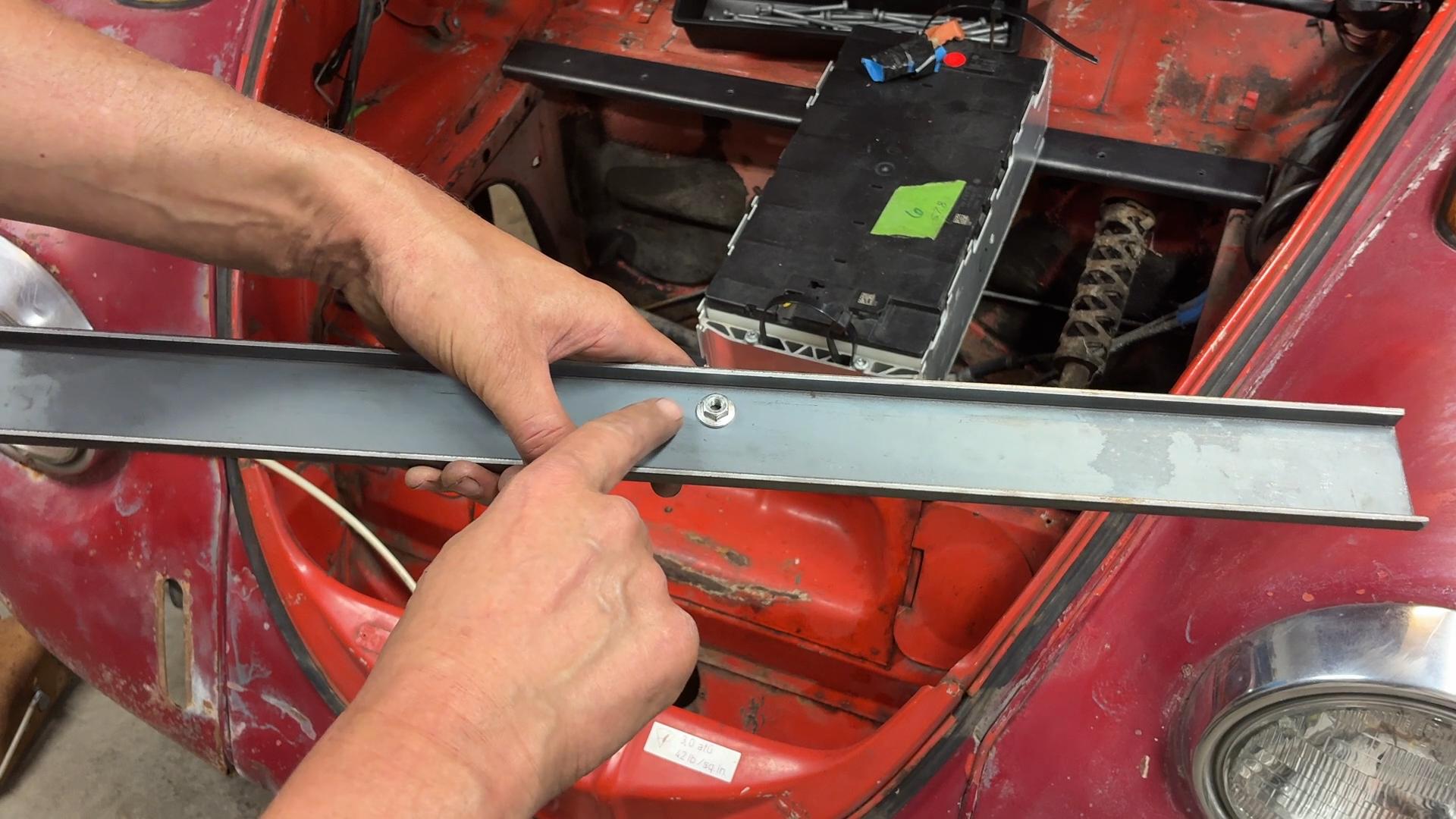

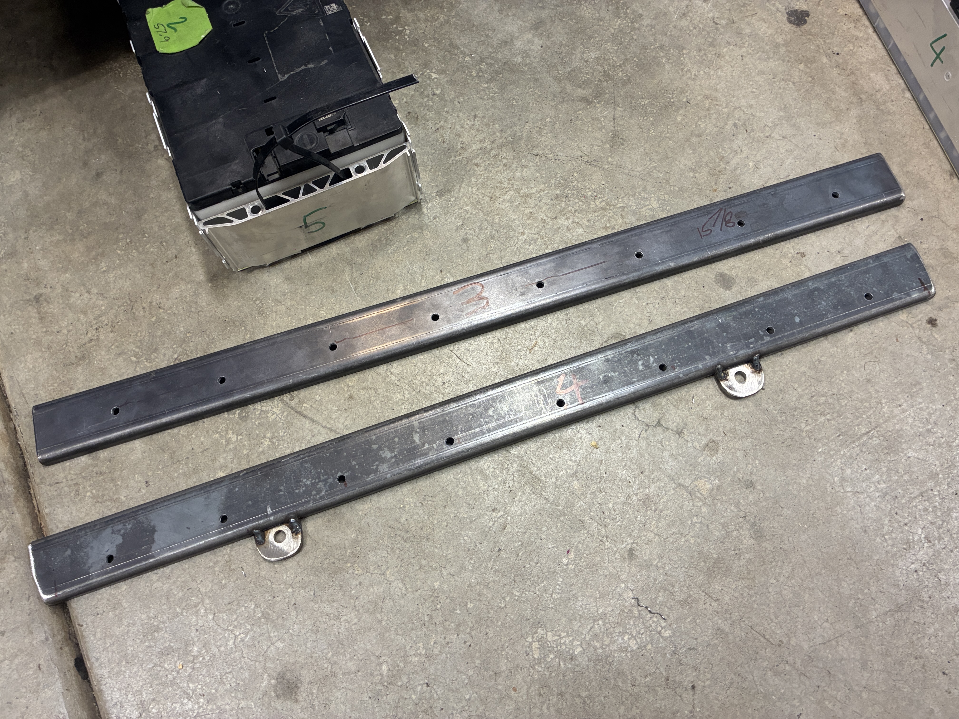

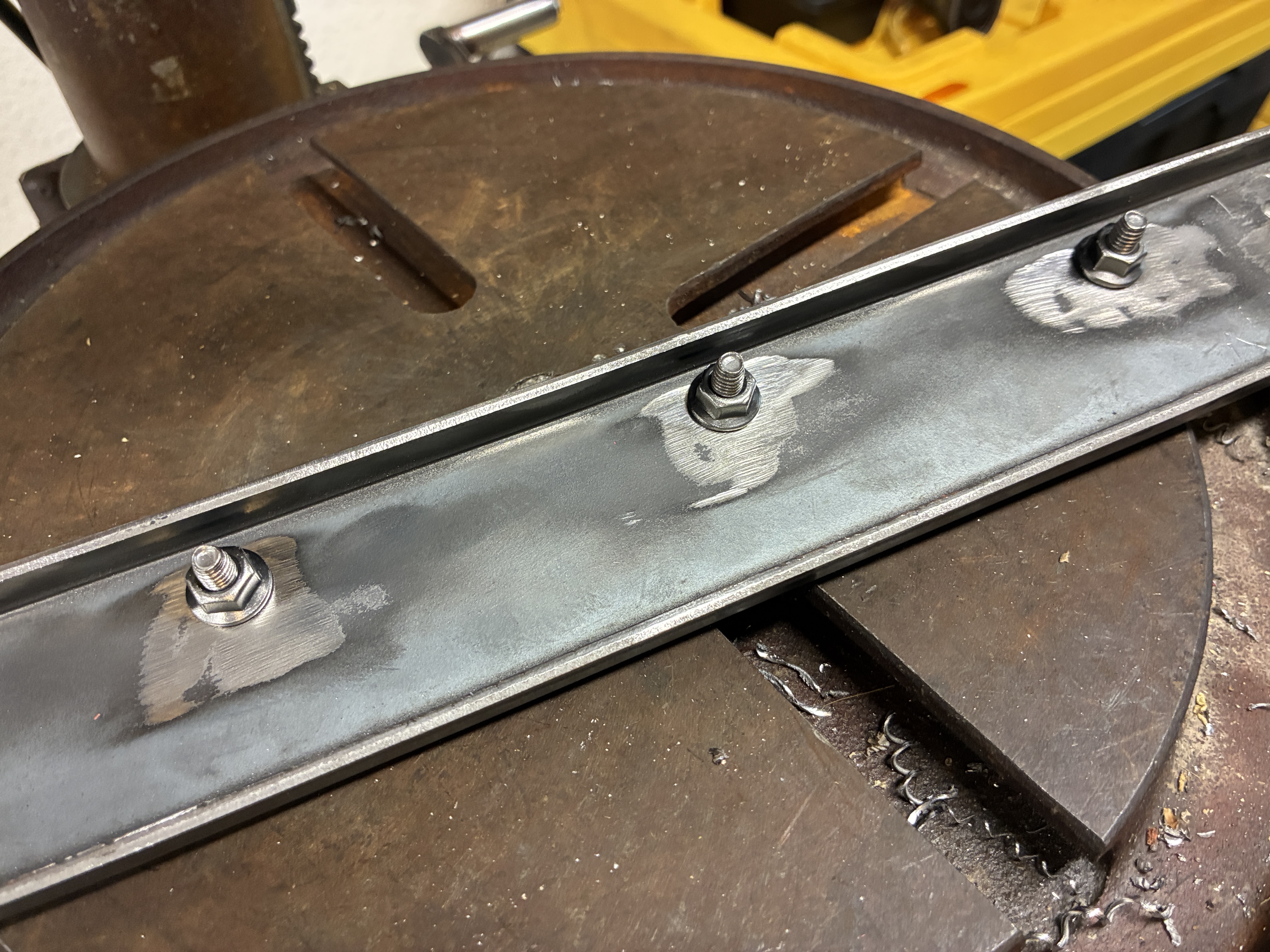

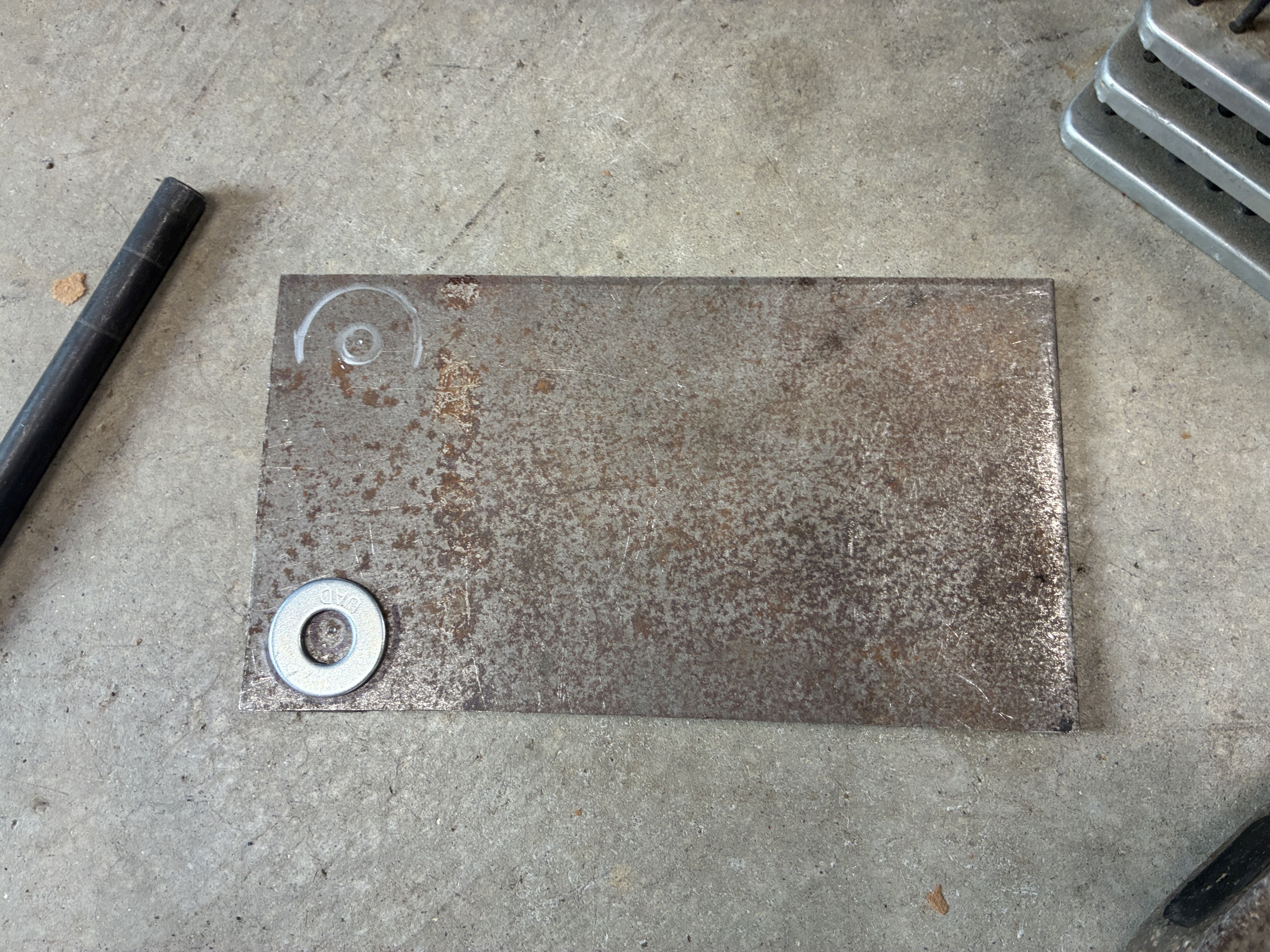

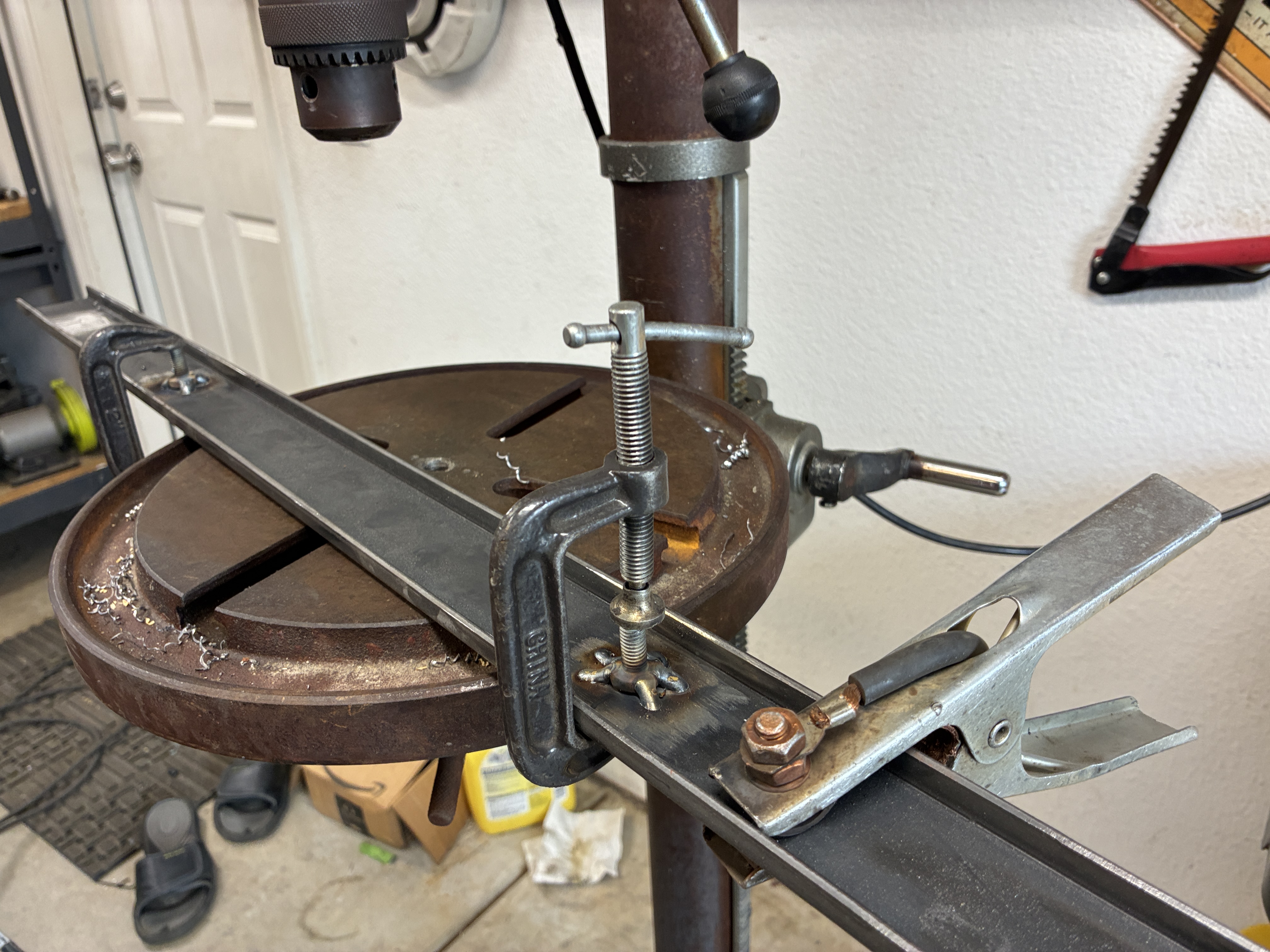

this C channel was notched so that the mounting tabs would sit in it flush
drill baby drill
I plan to weld these types of nuts under the C channel
and fingers crossed maybe we'll finally get to use the stock OEM fancy BMW hardware, but at 85mm they seem a tad short

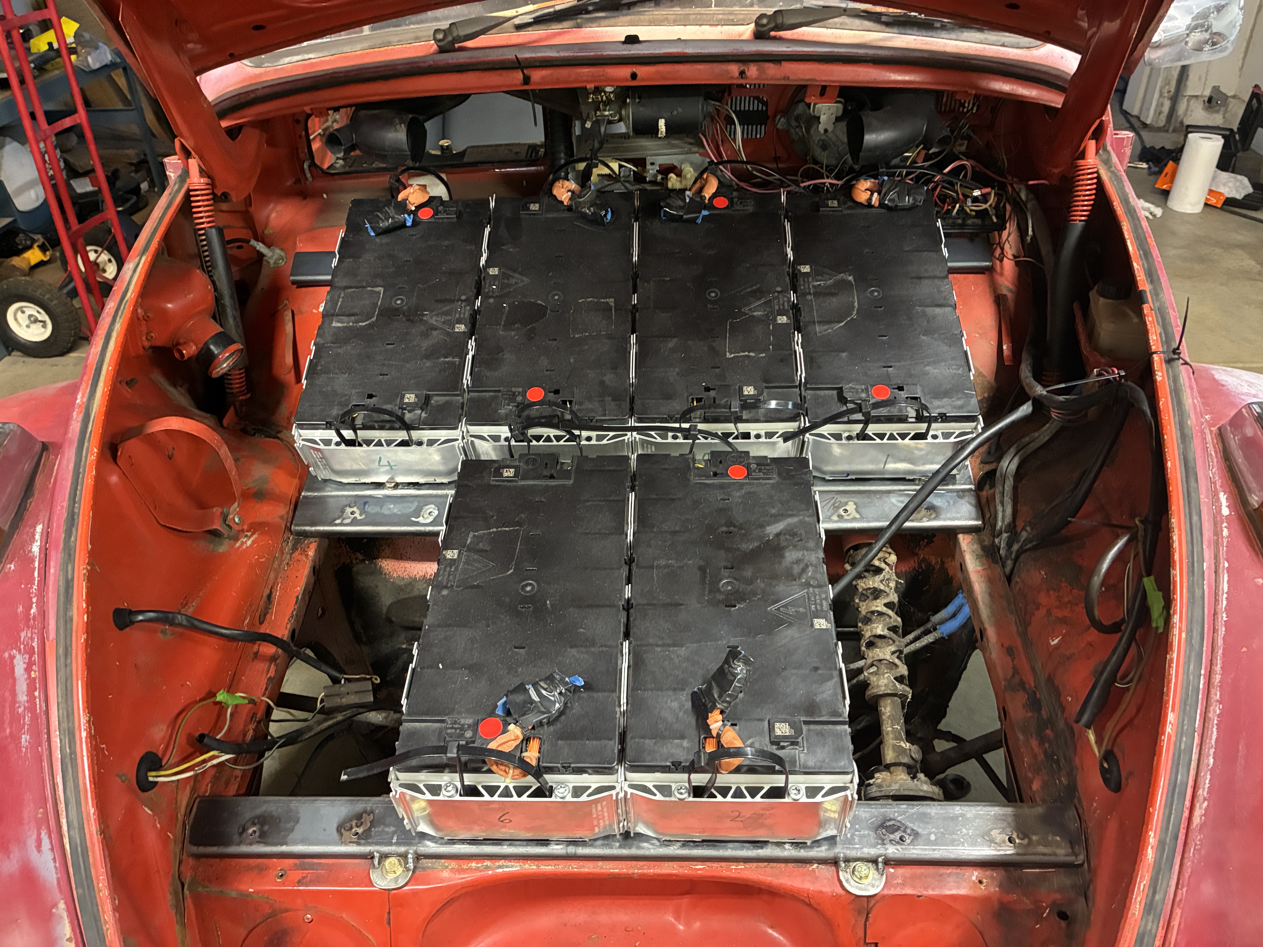

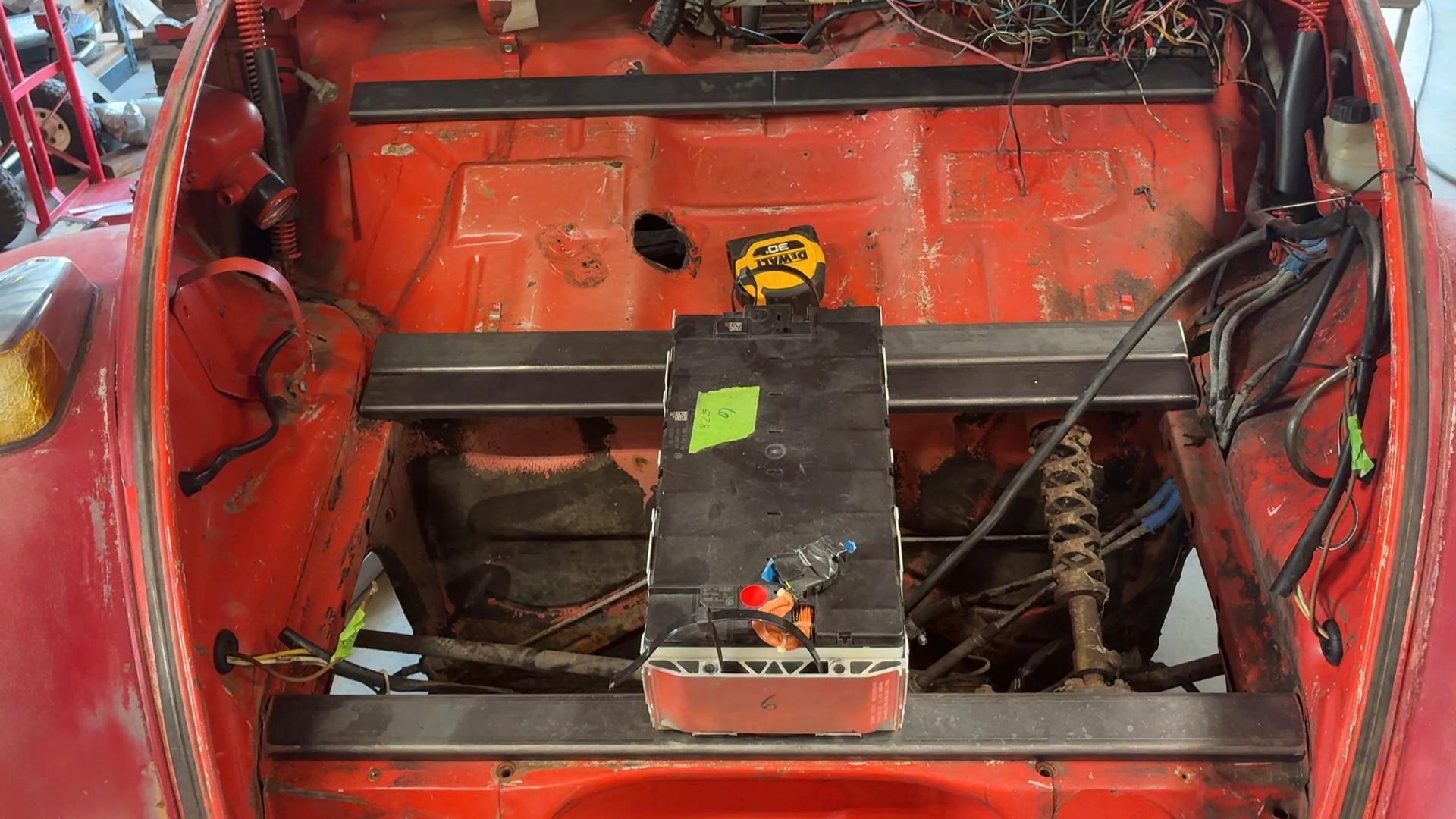

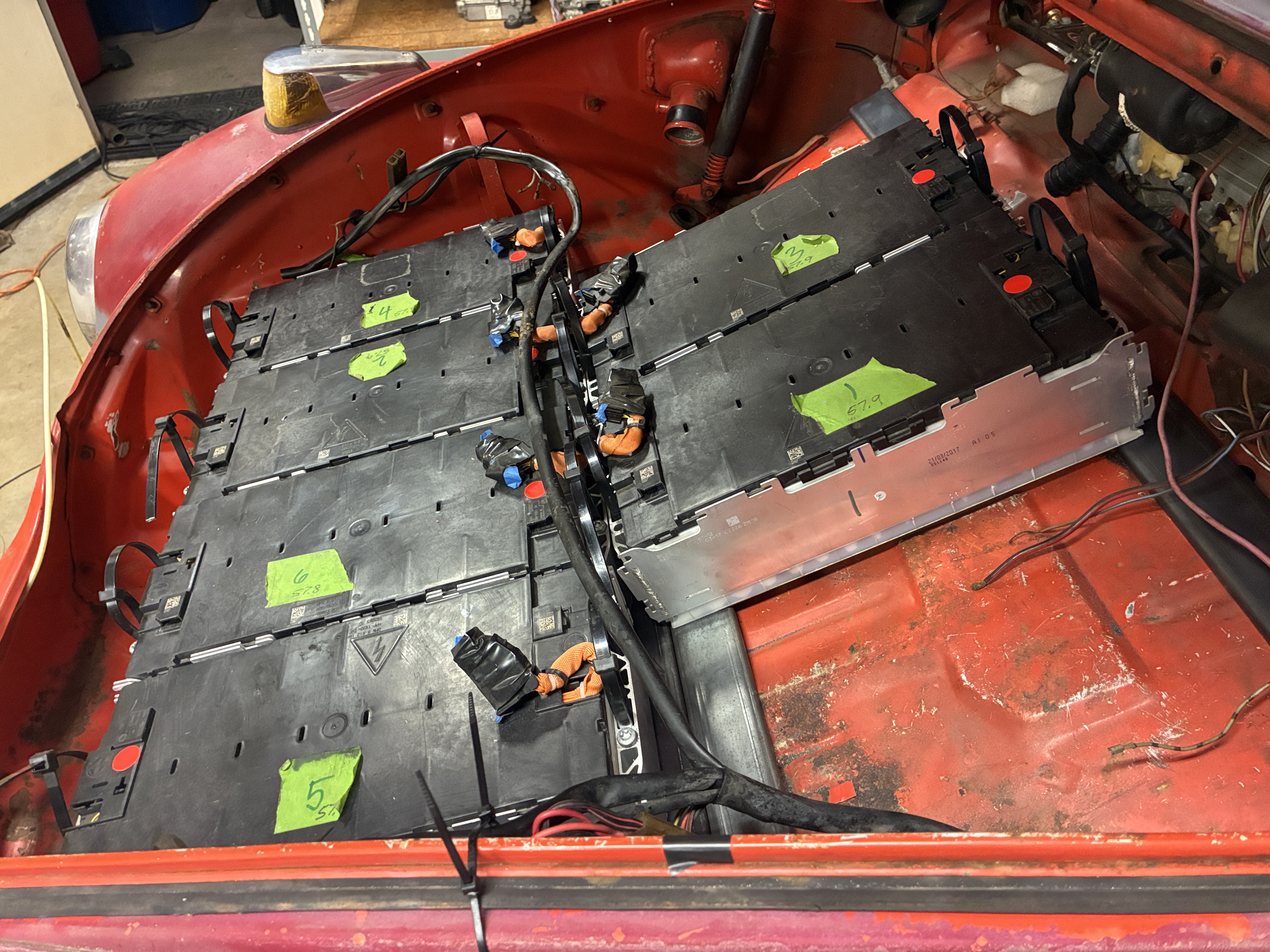

tomorrow I hope to handle the top row, notice how it has a slightly different pitch

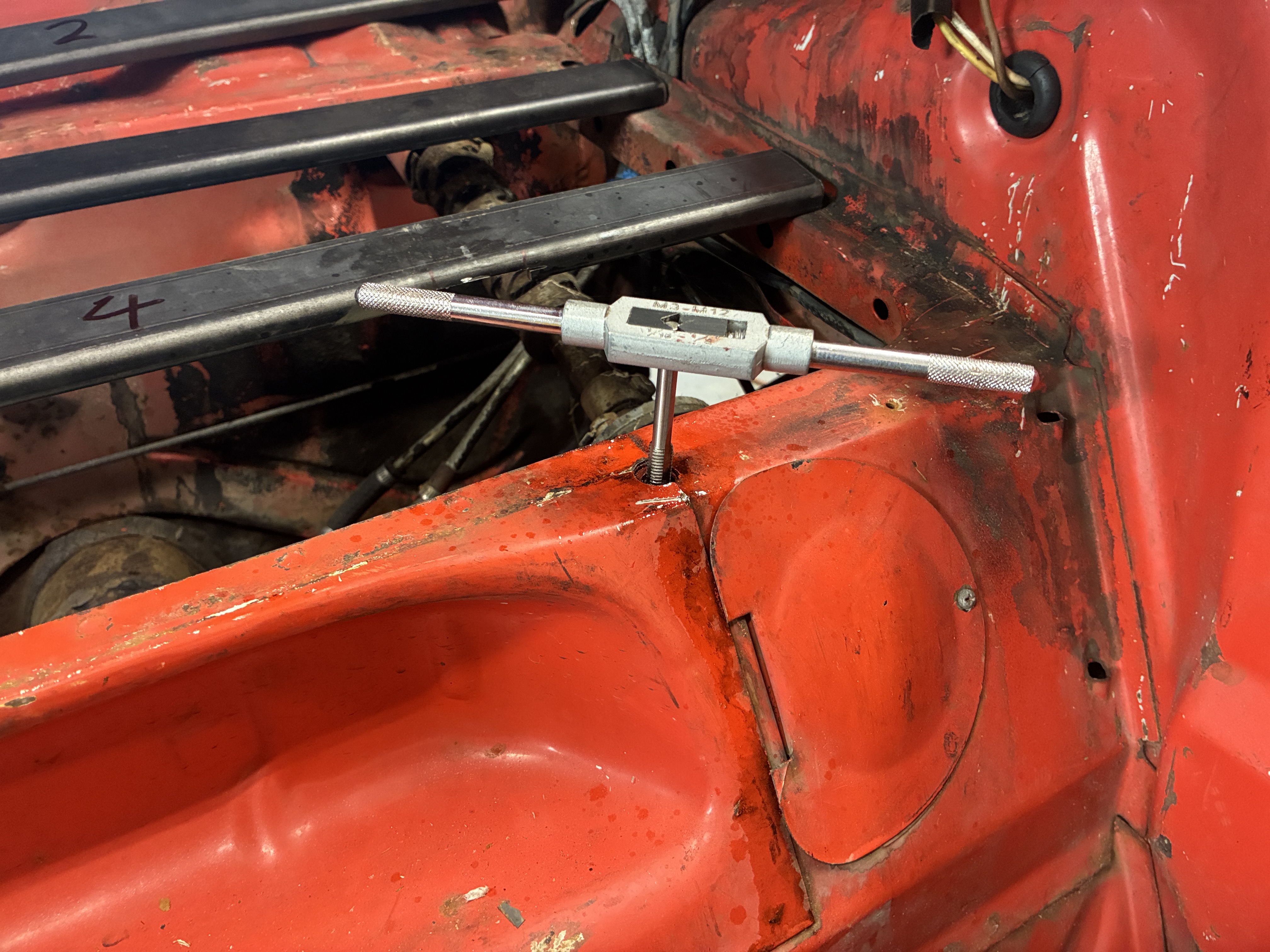

Gregski wrote: Sun Apr 05, 2026 3:44 am 5th weekend of the build was spent on mounting the battery pack, eight BMW 530e hybrid modules
Tapping out those old threads really pays dividends! 🙂

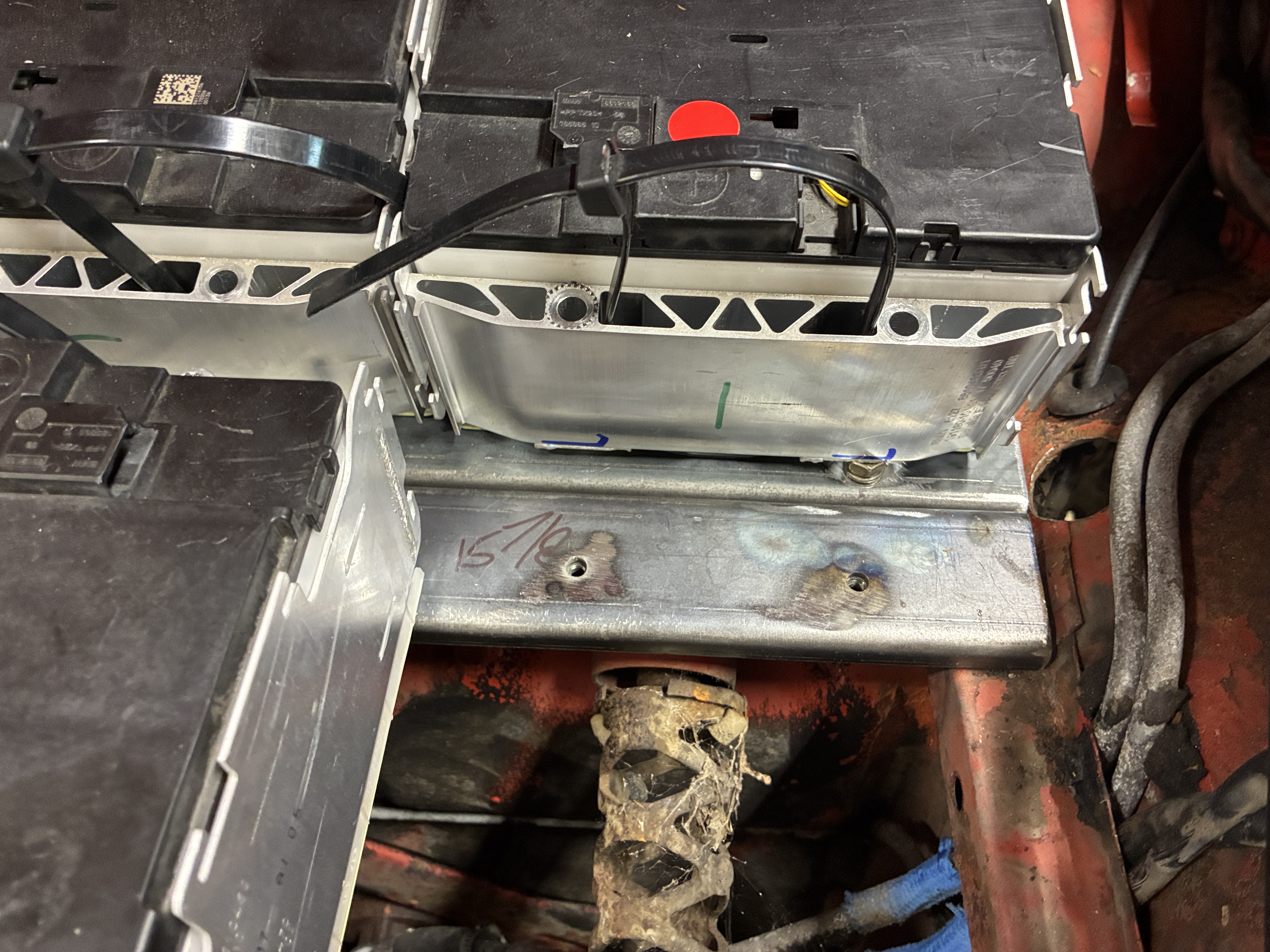

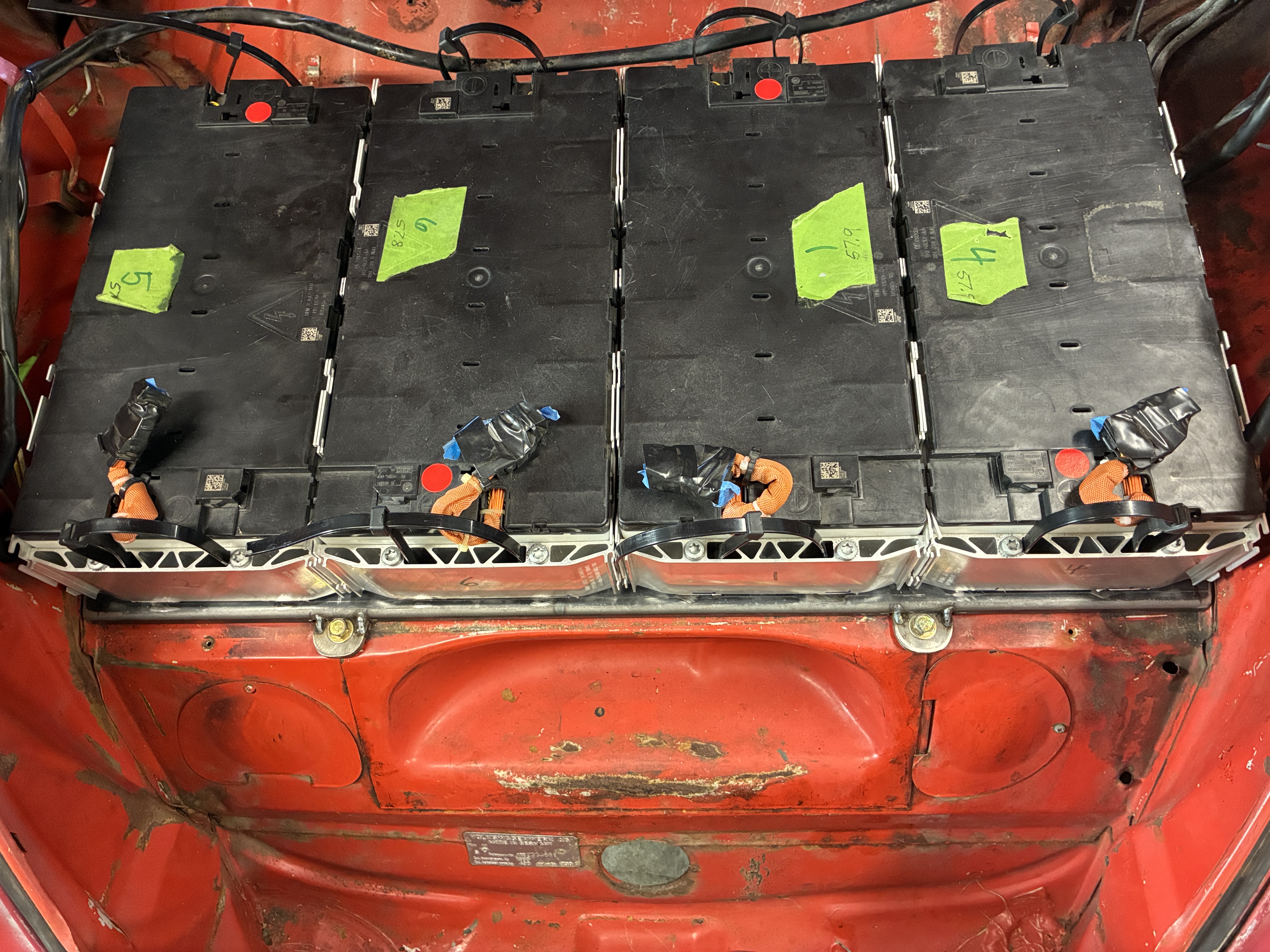

so here is the bottom shelf with all four modules bolted down using the 85mm stock BMW M6 bolts, when I feel underneath with my finger the bolts are just about even with the nuts, I wish they protruded out about 5 M&Ms

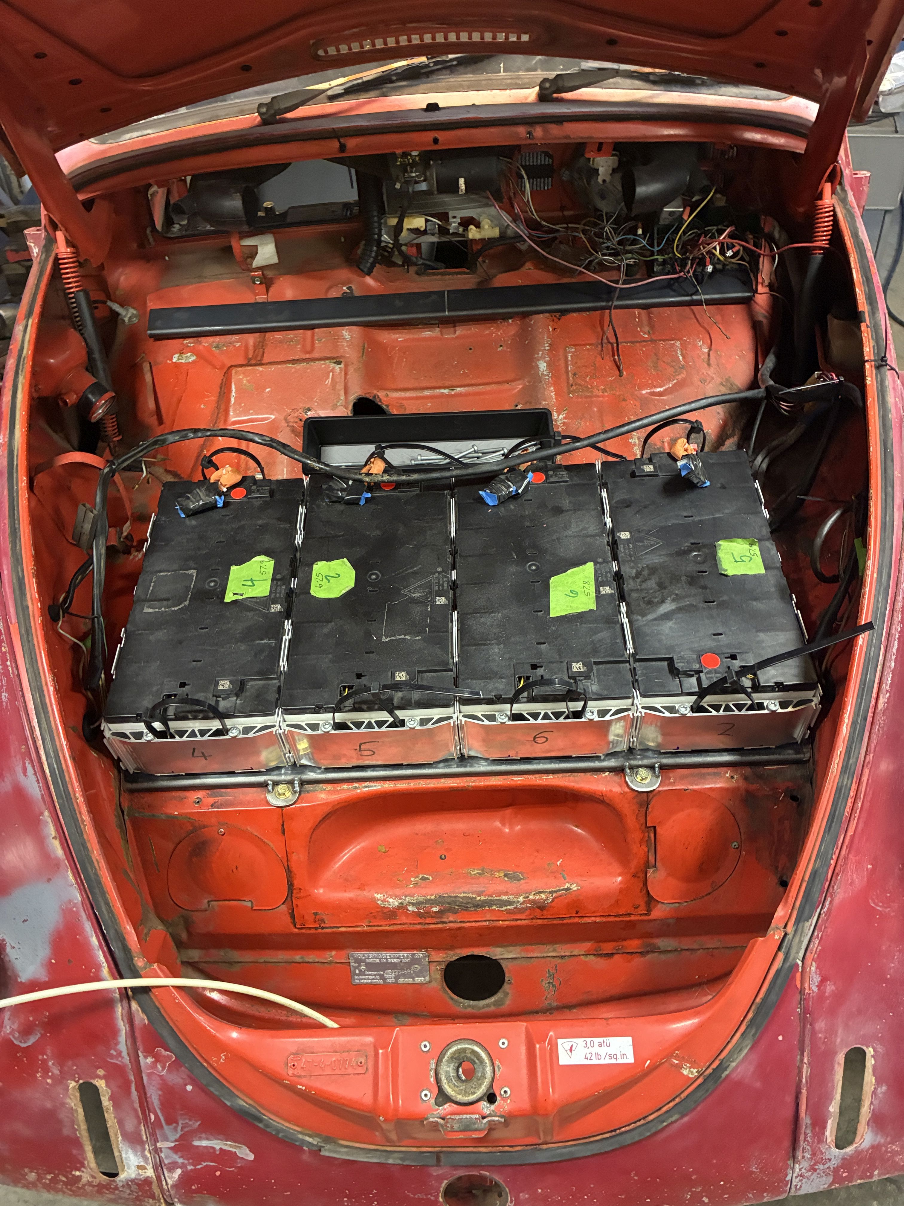

progress not perfection, here I was working on the mounts for the upper bracket for the bottom shelf (huh ?)
and the lower bracket for the top shelf
pretty happy that these two siamese twins won't need to be welded together after all and can be removed individually
Gregski
Posts: 3157
Post by Gregski »

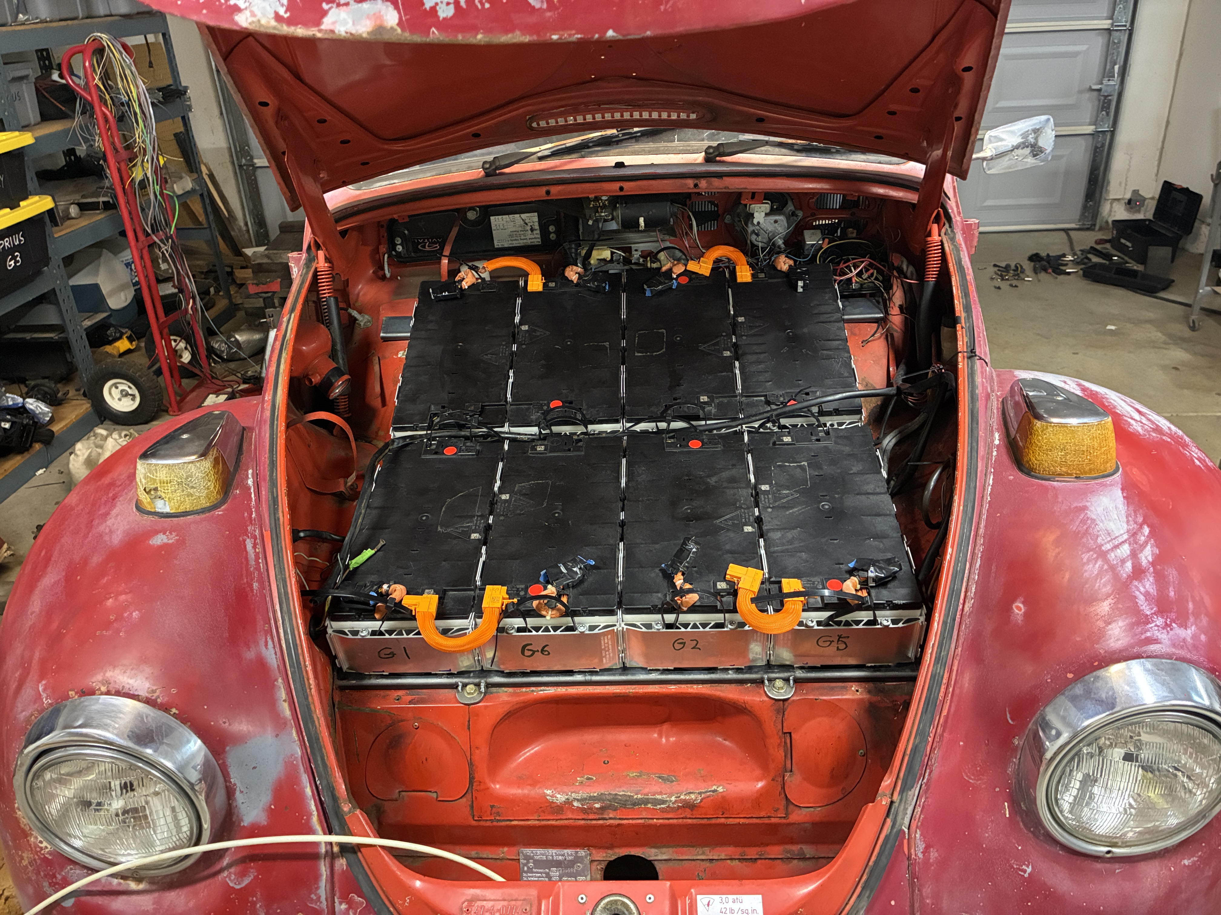

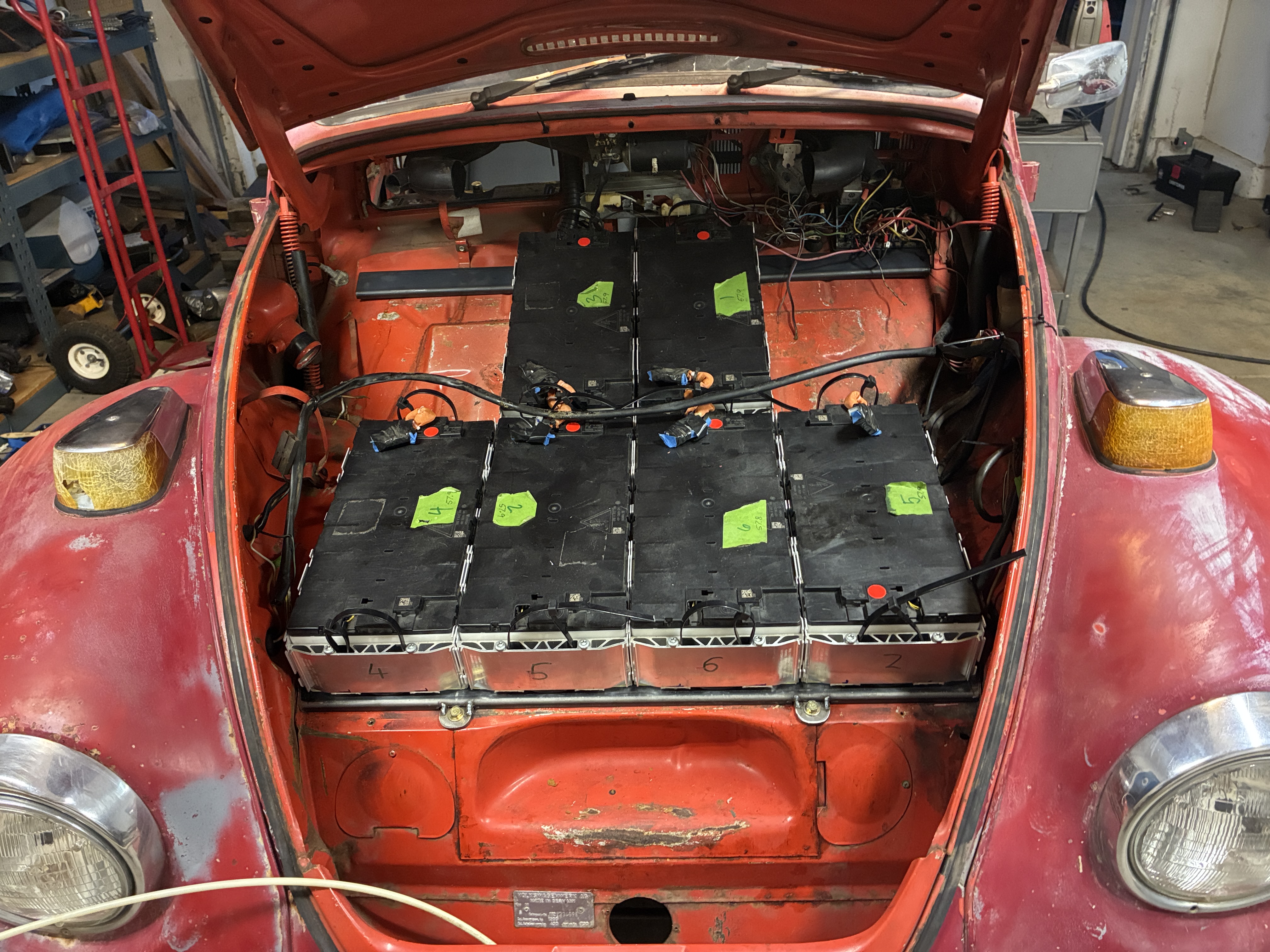

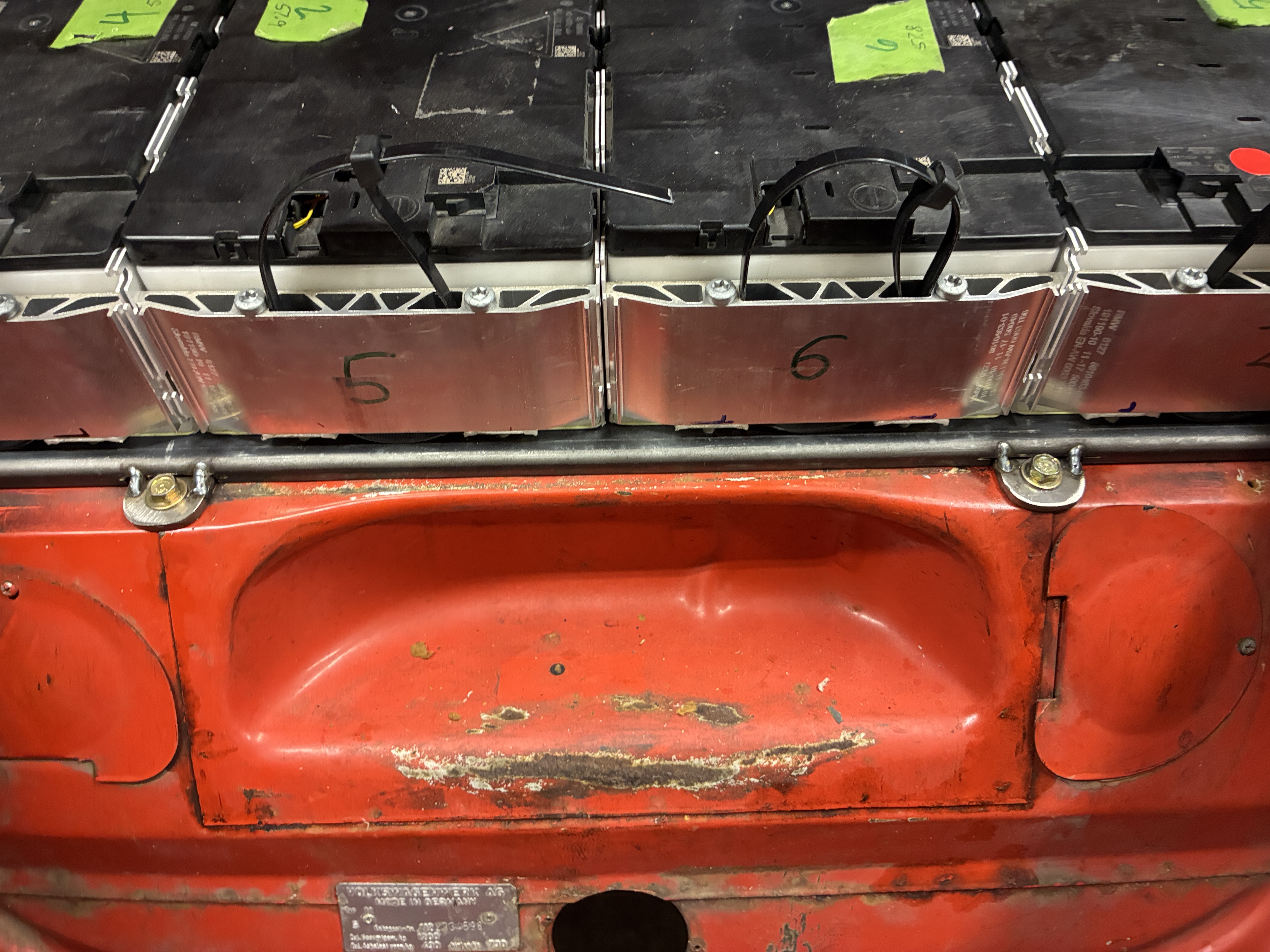

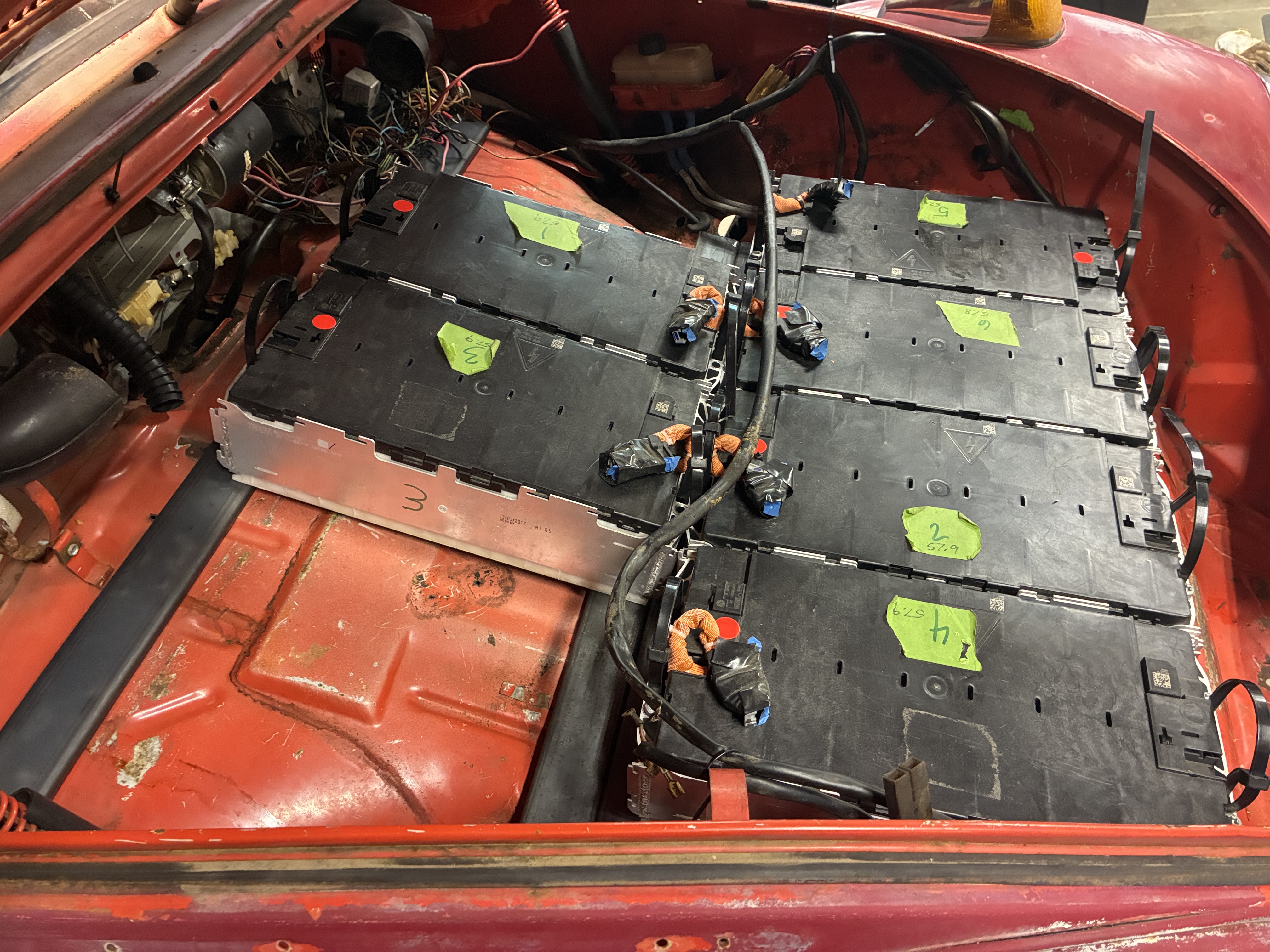

so the bottom shelf is done and I started on the top one
looks like the modules will clear the bracket mounting bolts, so happy

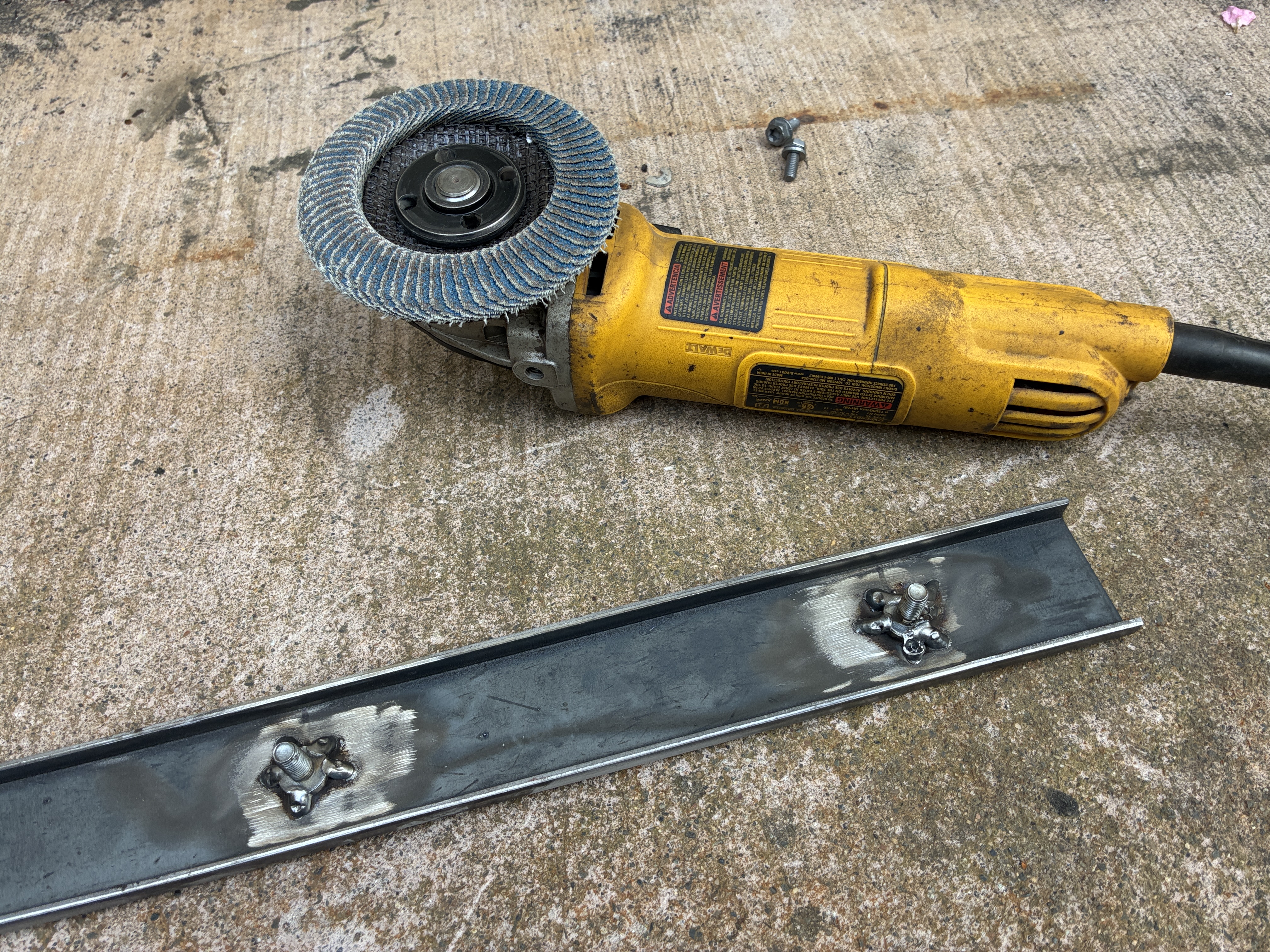

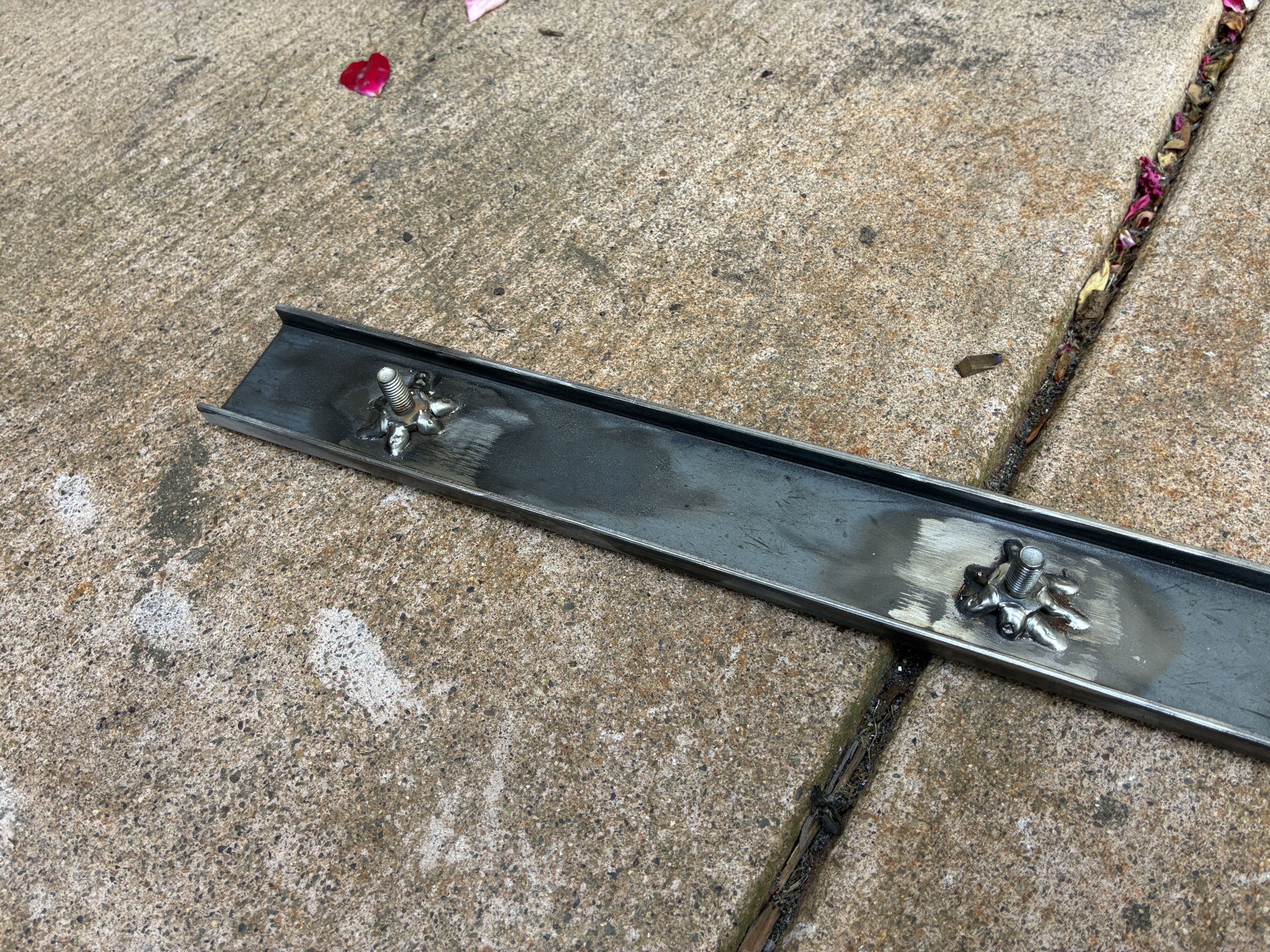

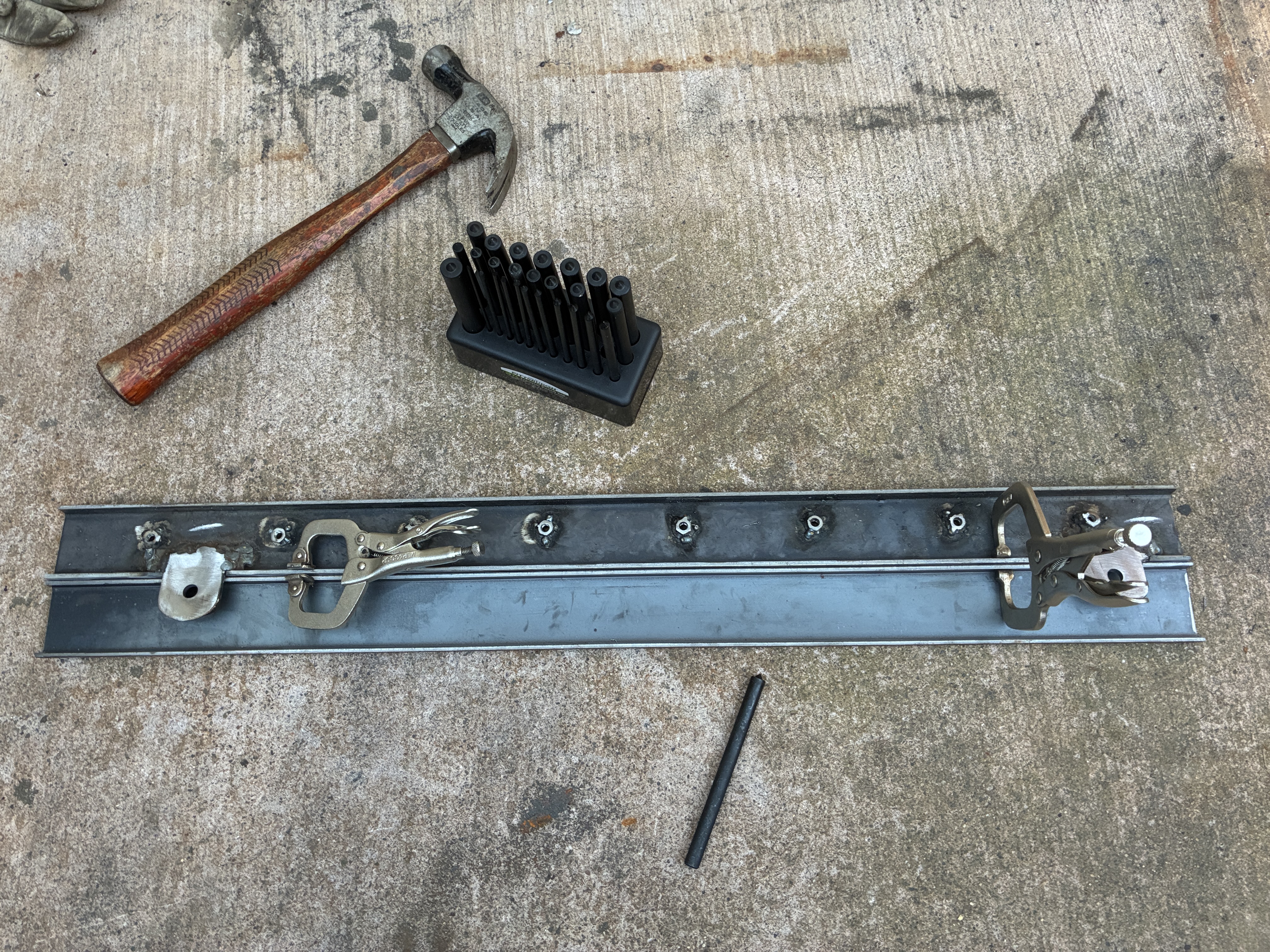

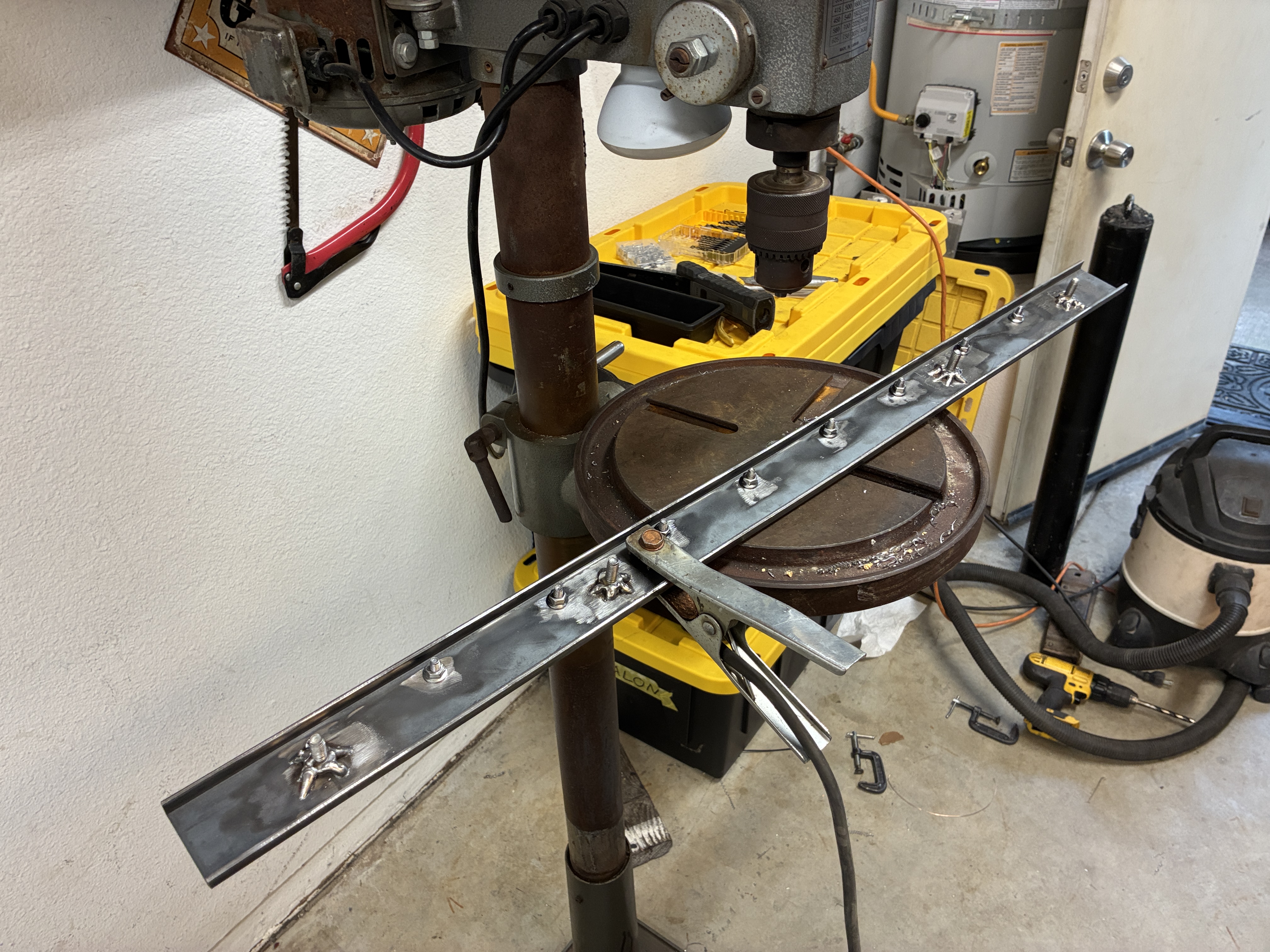

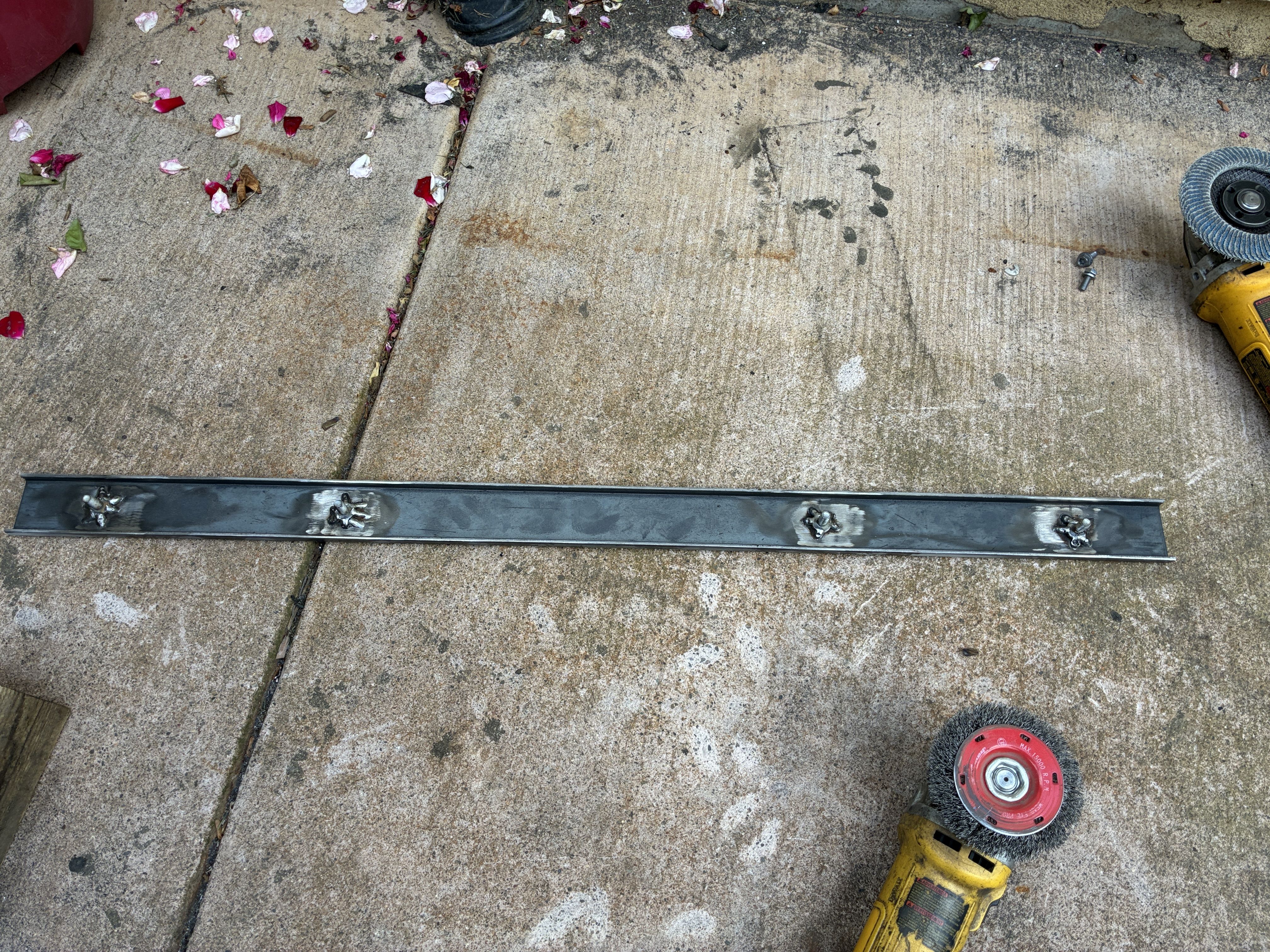

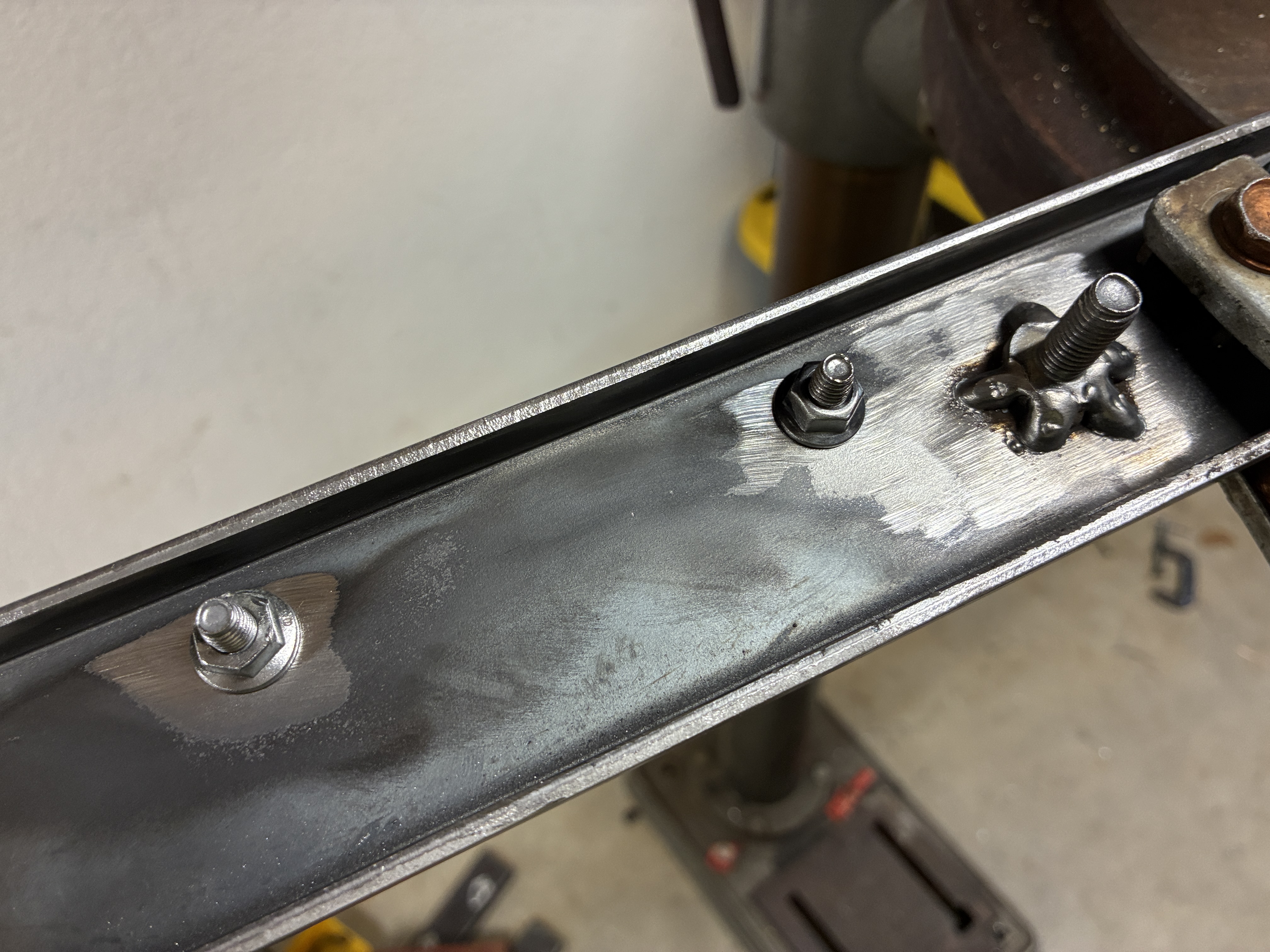

here I am welding on the studs for the top battery shelf bracket

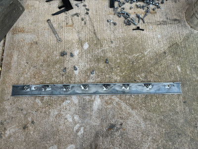

and welding on the backing nuts for the battery bolts
also welded the backing nuts to the bottom bracket of the top shelf

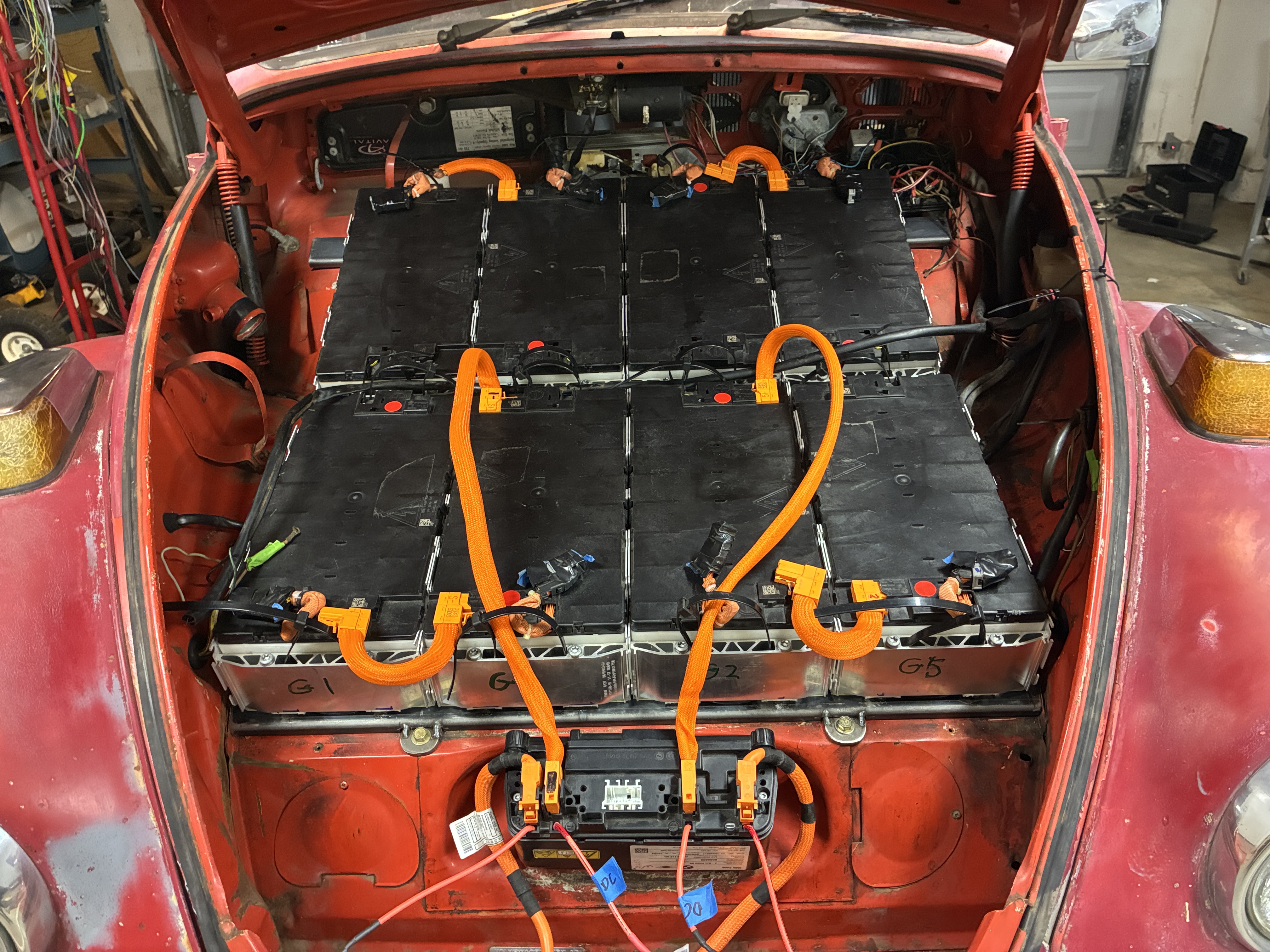

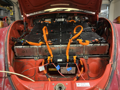

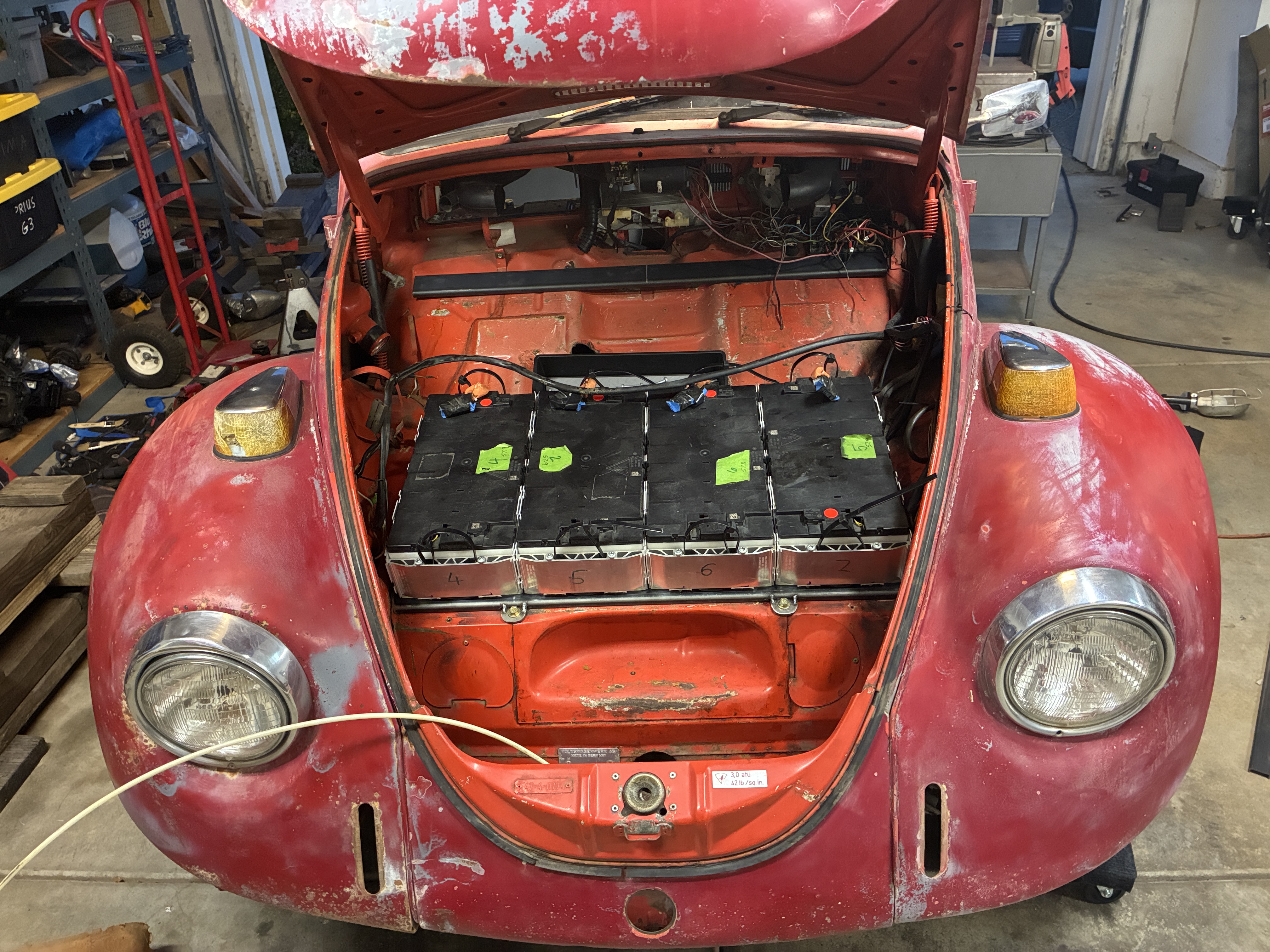

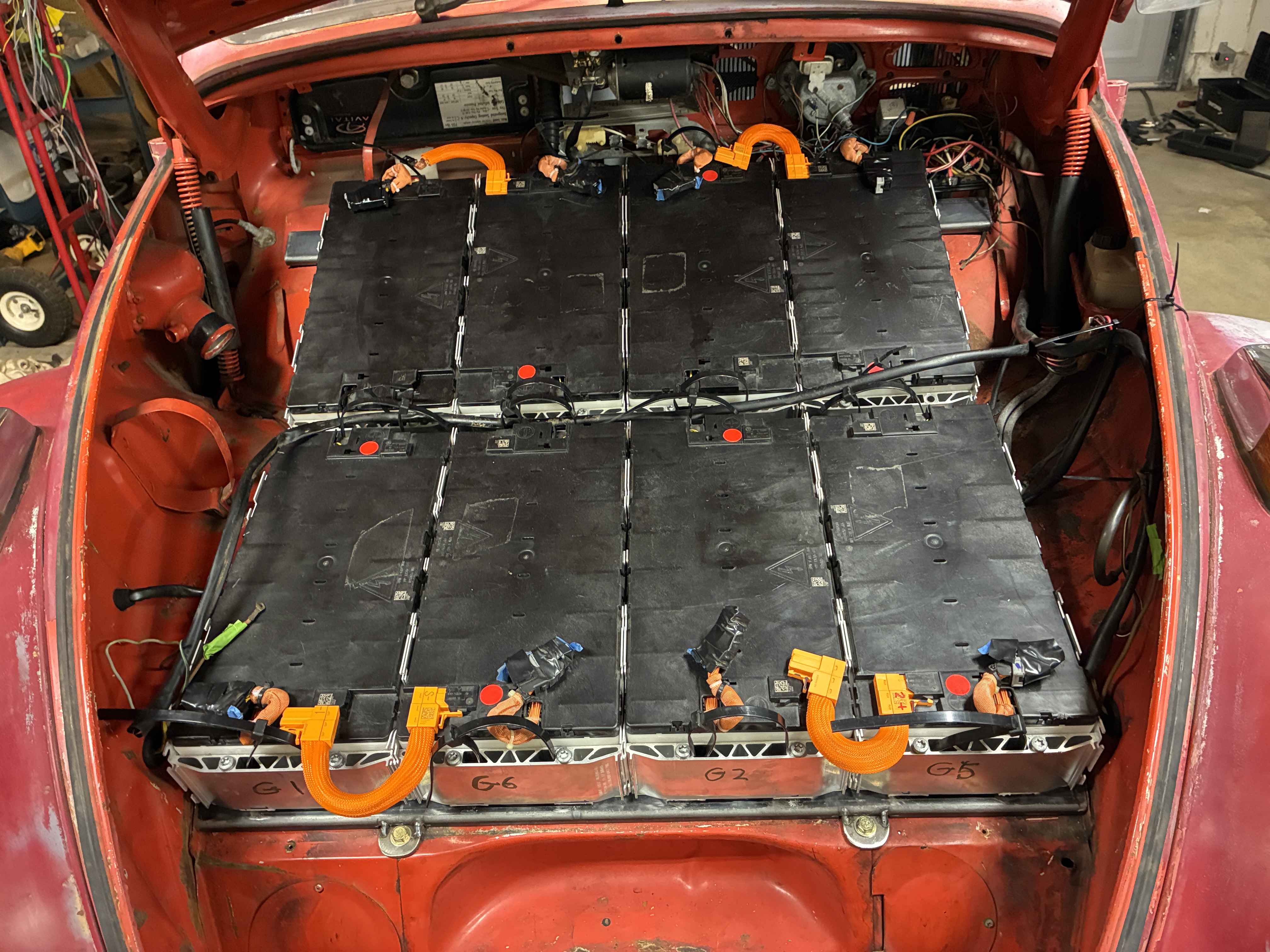

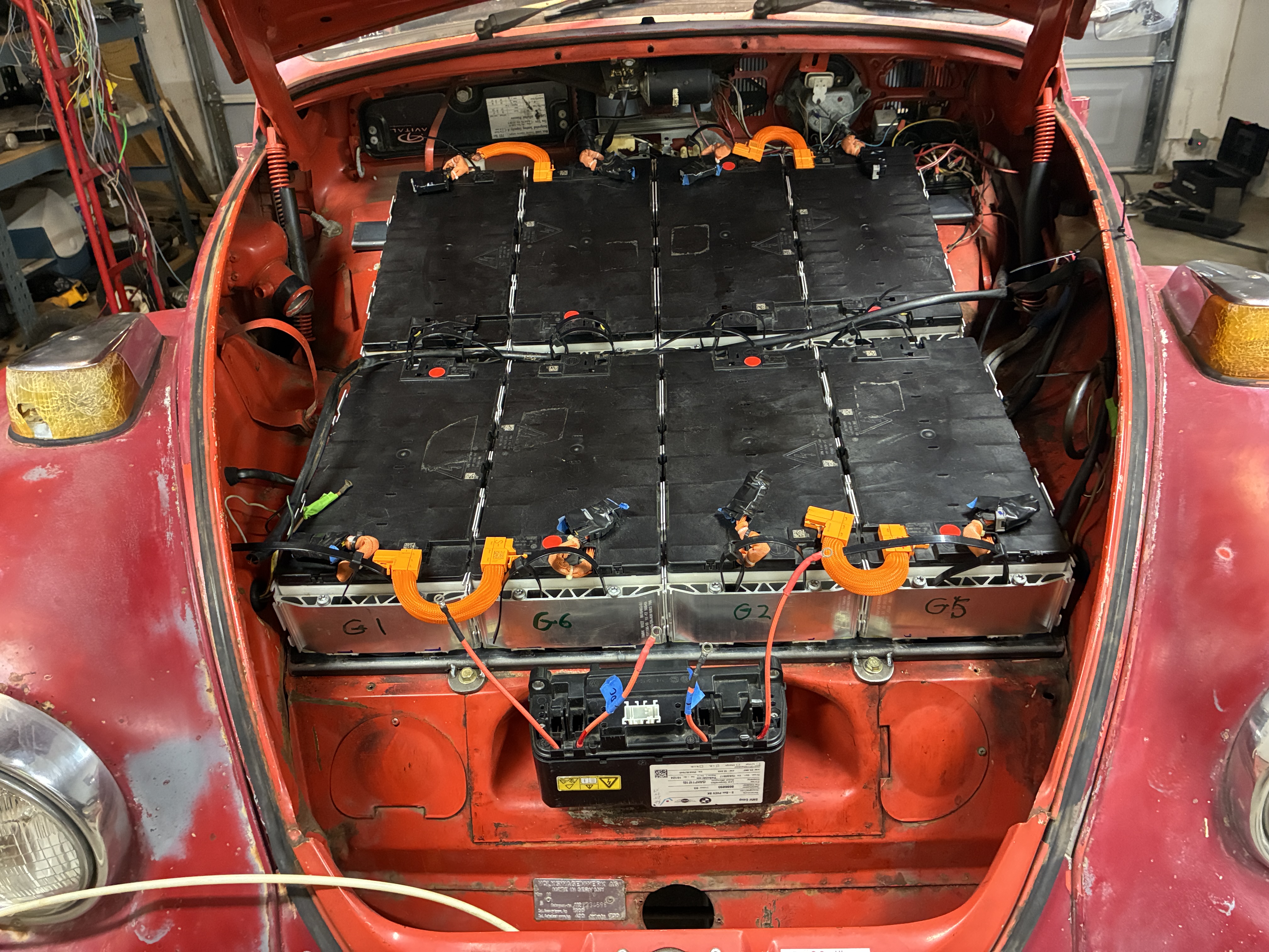

and the battery pack is in, I even started farting around with the high voltage connections a bit

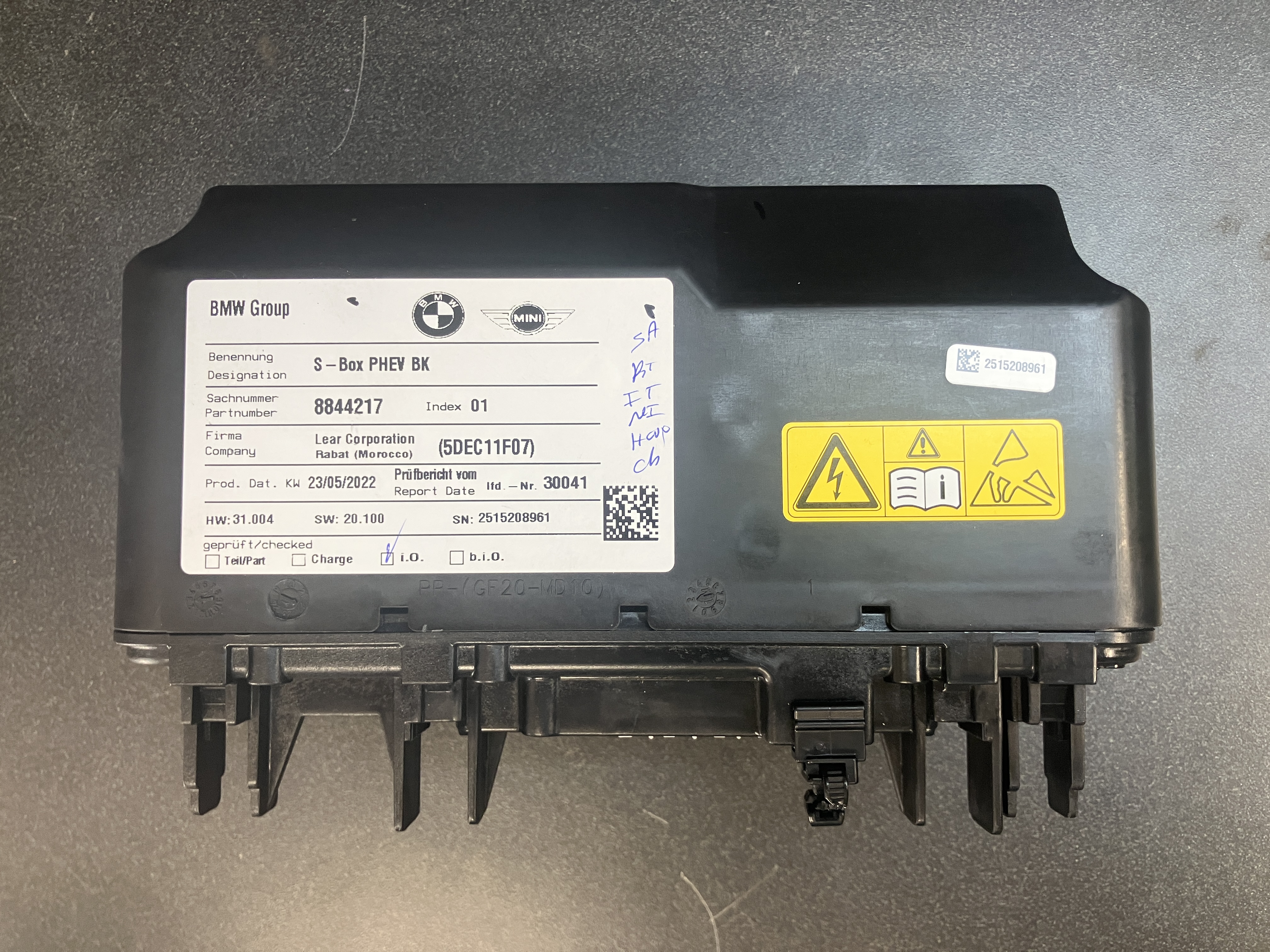

here I am planning the sBox aka contactor box install
Ghia66
Posts: 170
Has thanked: 749 times
Been thanked: 65 times
Post by Ghia66 »
So tidy! Looks like it was meant to be from factory! 🙂
Posts: 2962
Has thanked: 328 times
Been thanked: 847 times
I would suggest you review the specs of all the components in the Sbox before utilizing them with 8 modules instead of 6.

Gregski wrote: Fri Apr 10, 2026 4:04 am here I am welding on the studs for the top battery shelf bracket
What was you reason for not using rivnuts? I used them in my battery box and they were very quick and easy.
Gregski
Posts: 3157
Post by Gregski »
Alibro wrote: Fri Apr 10, 2026 9:09 am What was you reason for not using rivnuts? I used them in my battery box and they were very quick and easy.
all my drill bits are standard not metric, and for the M6 rivnuts you need a 9mm drill bit, so when I ordered all the stuff, the rivnuts showed up but the drill bit did not till I was almost done, but mostly it's because I had horrible luck installing them, so I think it's mostly me

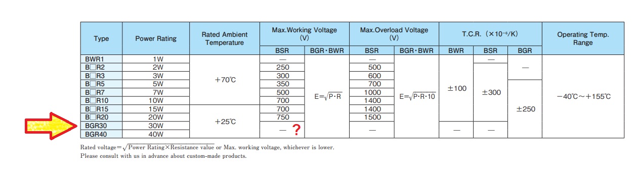

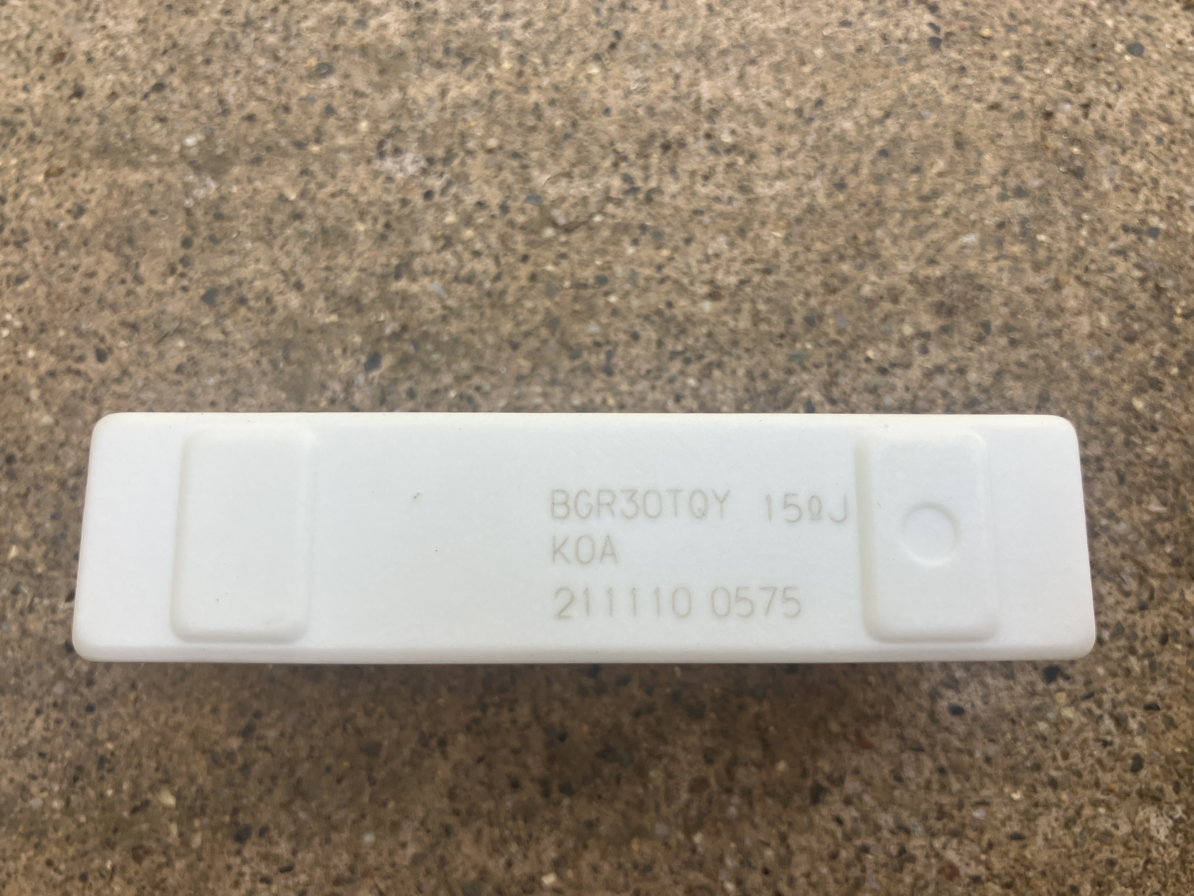

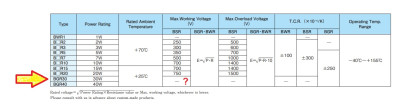

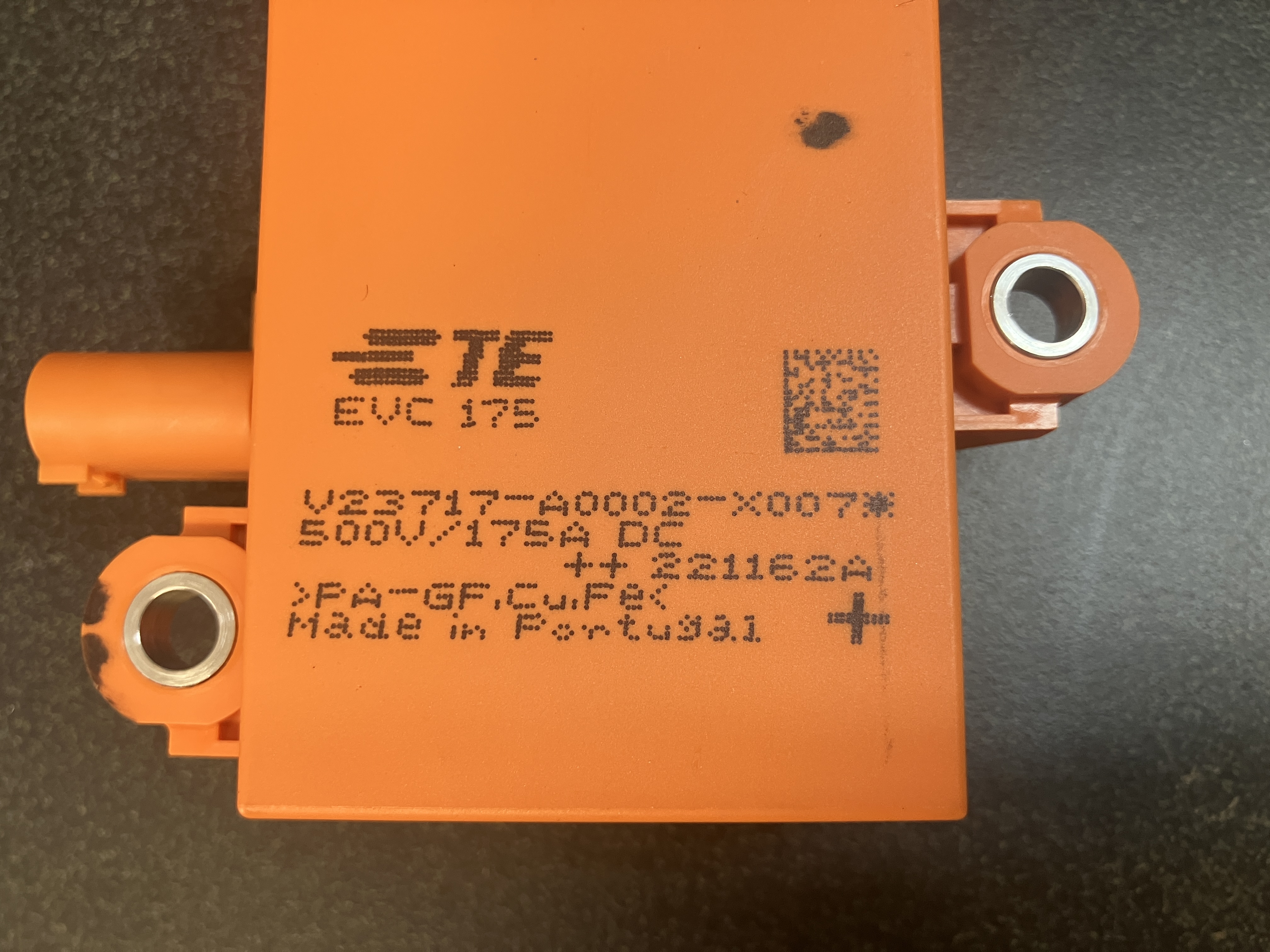

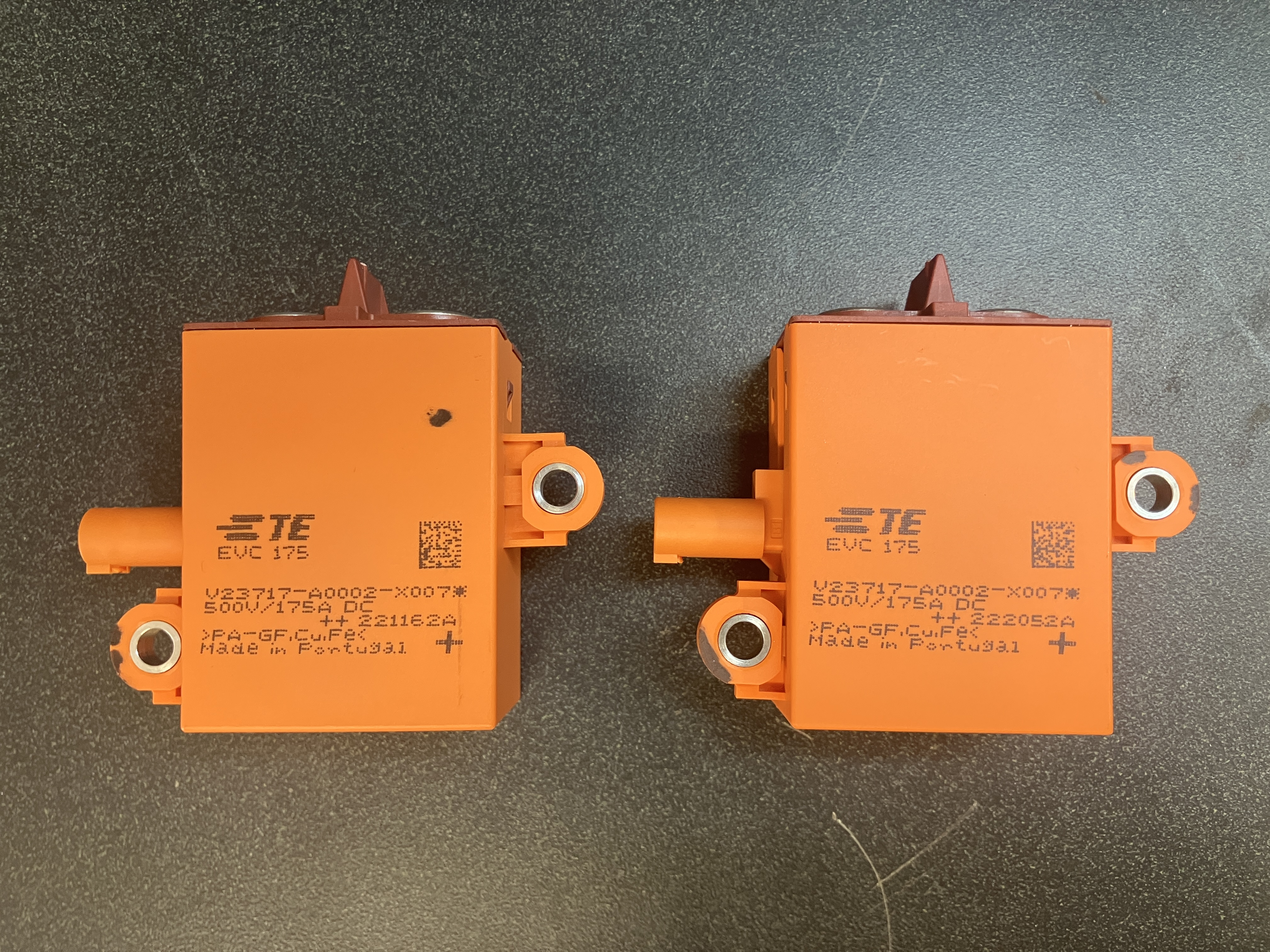

tom91 wrote: Fri Apr 10, 2026 7:38 am I would suggest you review the specs of all the components in the Sbox before utilizing them with 8 modules instead of 6.
well Donkey Kong I thought the contactors were rated for 600 volts, but looks like only 500, in my defense the plan was to start off with six modules and if decent top speed was not achieved then expand to the additional ones, so I may be able to go to seven modules but not eight, unless I upgrade them orange cubes, good looking out Tom, you passed the test (wink, wink)
Could someone please help me with this BGR30TQY resistor voltage specs and translate this table for me to fork lift terms?
bgr resistor specs.pdf
(243.34 KiB) Downloaded 2 times

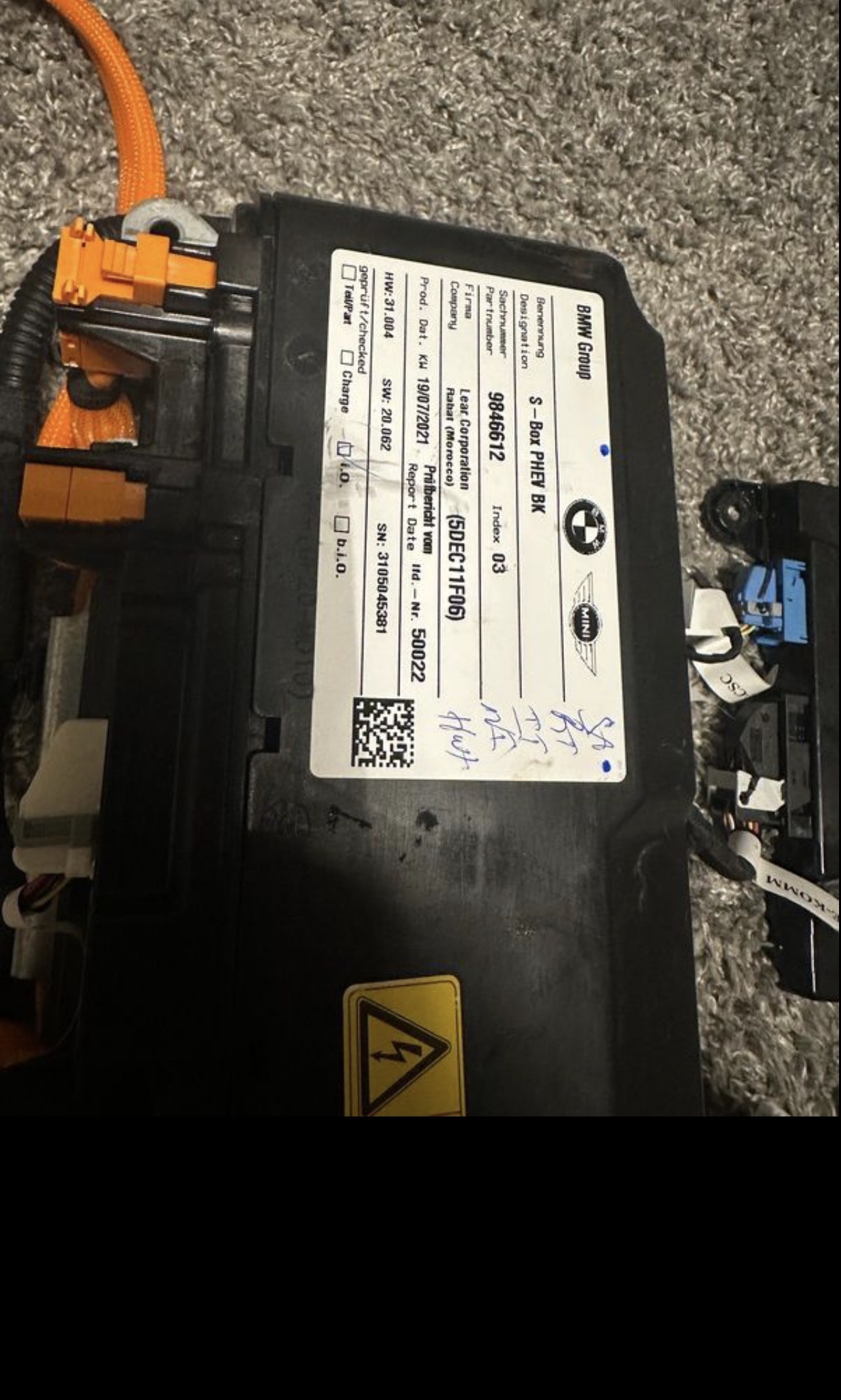

Posts: 2962
Resistor will be fine. Have a look at precharge relay.
I would in all fairness be most worried about the OEM BMW electronics, they likely will have an overvoltage limit in them. Probally around that of the contactor voltage.
Gregski
Posts: 3157
Post by Gregski »

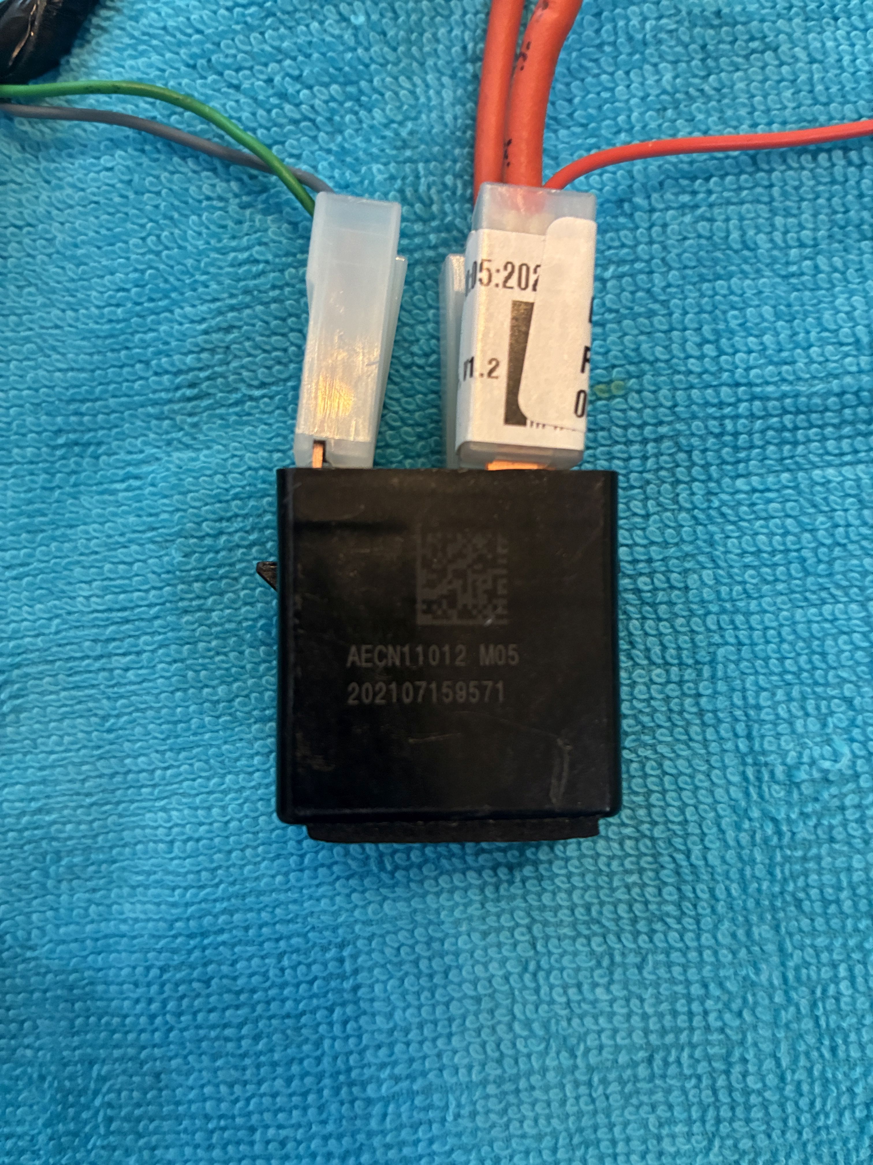

tom91 wrote: Fri Apr 10, 2026 1:01 pm Resistor will be fine. Have a look at precharge relay.
Ah yup the AECN 11012 precharge relay in the 2nd Gen aka 12 kWh BMW battery pack sBox can only handle 400 volts

How about using the BMW SP44 HV Battery (G05) Sbox?
Posts: 2962
Ghia66 wrote: Fri Apr 10, 2026 3:32 pm How about using the BMW SP44 HV Battery (G05) Sbox?
Same architecture so same issue.
