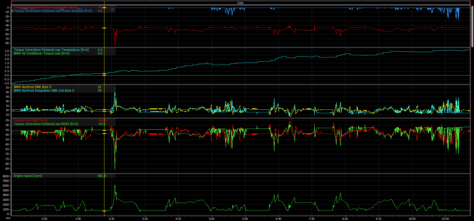

* Engine Coolant Temperature "Firmware ##" value was completely wrong - because it was in use by the Bosch Racing integration module. Moved it to Firmware 31 (max value) and now I have coolant temperature readings.
* As a result of coolant temperature readings now being correct, friction from temperature should be closer to correct.
* Base values are much, much closer now.
Is it perfect? Nope. Is it a lot closer? Yes!

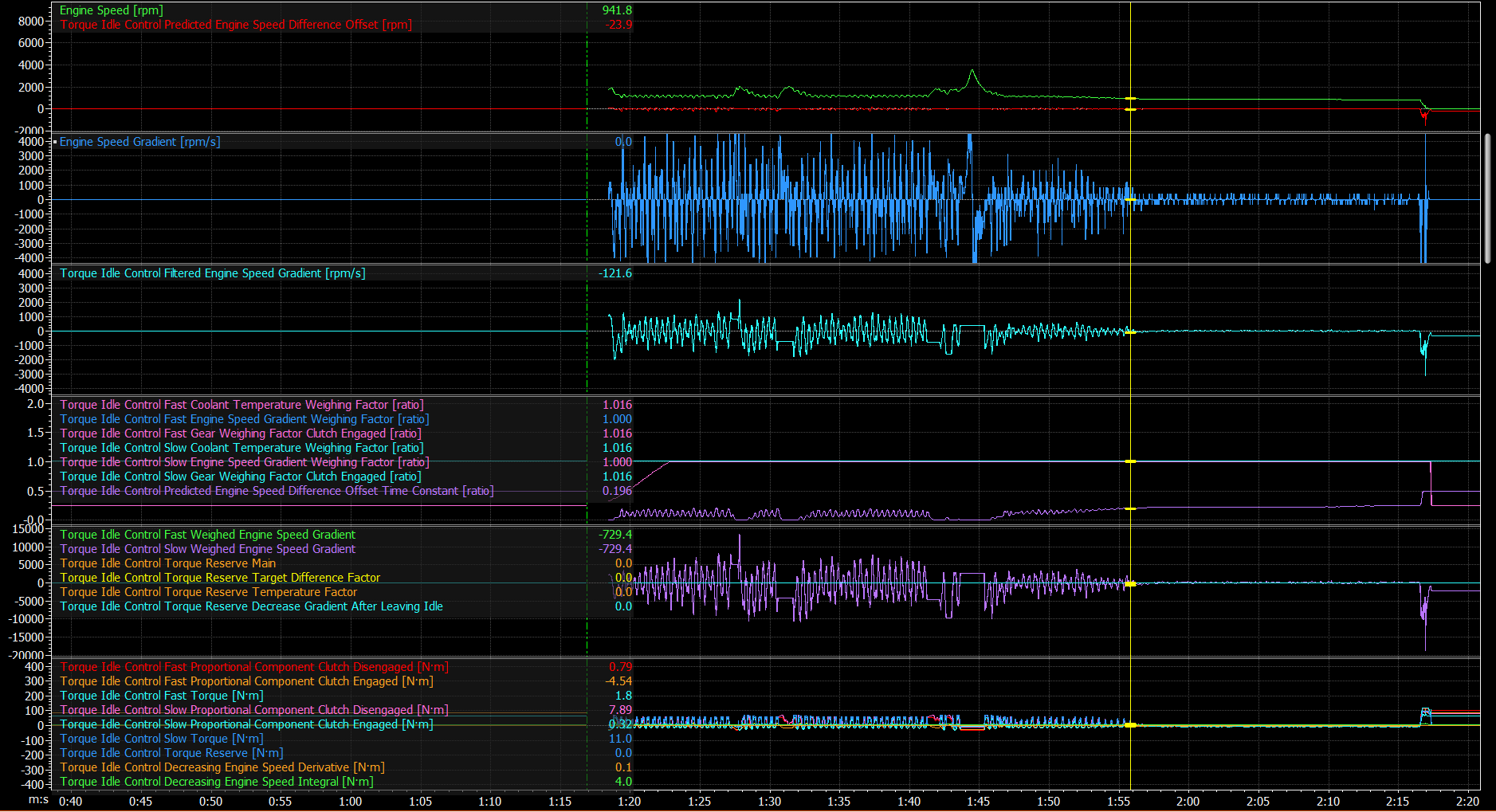

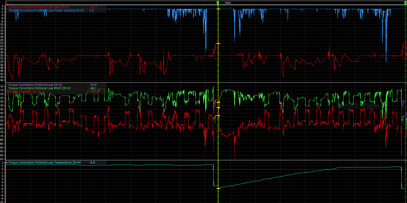

Ok so the missing item is...the alternator. Apparently there's a table which correlates alternator torque / output to the friction losses. Since I have no idea how much power is being generated, my initial guestimate of 15 Nm is going back in. But now accounted for in the right spot. :)
Now on to idle control. That'll be a bit more involved.
-Matt

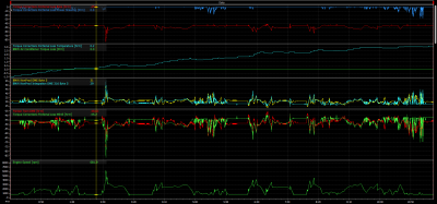

Just drove around a little.
* Values until warmed up seem quite incorrect. Table should be correct, so I wonder if my Oil Temp values are wrong...
* Warm-up values match quite well.
* Torque values are within 10%, which is the approximate error of the stock ECU at the moment, so that looks good.
-Matt

More precisely - values at _idle_ aren't quite right. No other new info yet. Still need to unbox the PCS. I made an inventory of all my wiring parts and I need to order some more.
So much to do :)

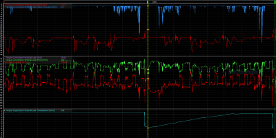

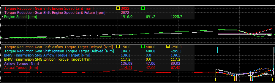

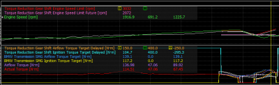

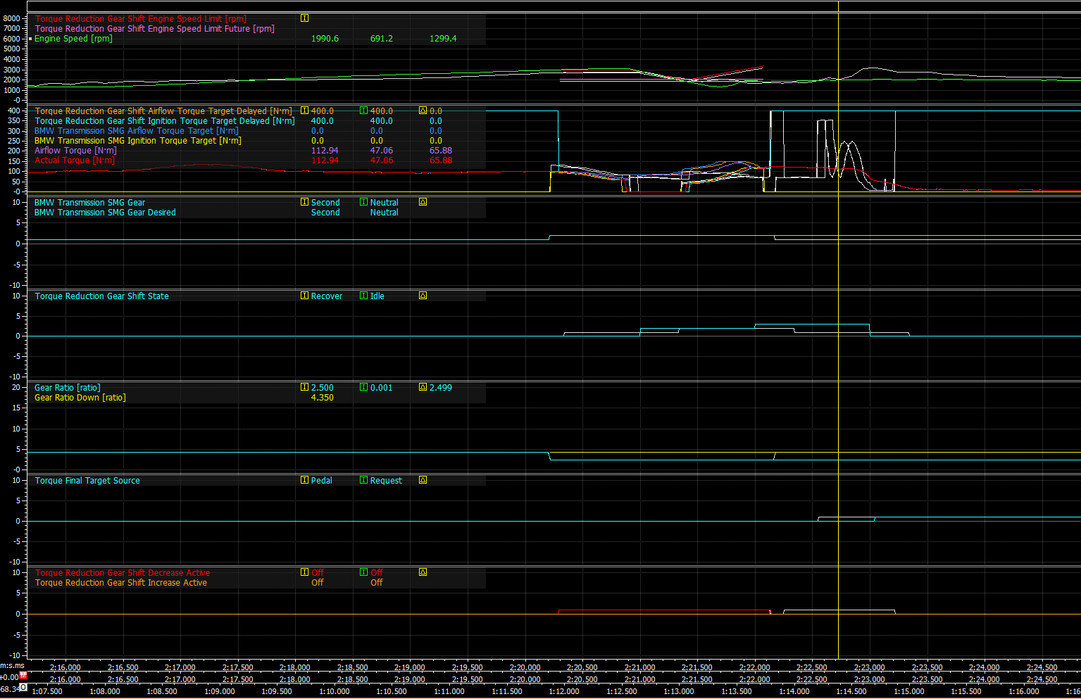

Ran the car on the Motec today. Ehhhh. So looks like some of my MAF math was quite bad. Super rich at idle. Oops.
Shift from 1 to 2 still fails. I think the main issue is the RPMs are falling too rapidly.
So close:
The lines in white are from a run on my code.
But..just kidding.
I'll have to take a look at this more closely, per channel, to see what is going on, but...yeah, not quite there yet.

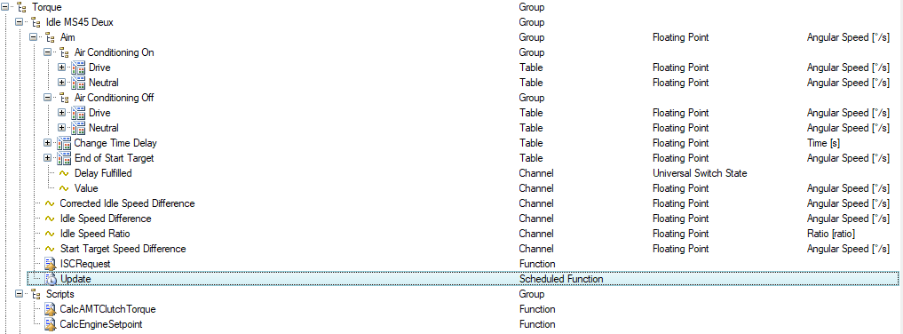

I think I need to step back, look at the code and try and generate a general flow of the stock ECU.
I need to break up my existing code into functions, and then fit in whatever I'm missing (like controlling the rate of engine RPM fall, that's a problem.)
I think I want to decouple the torque model calculation to be different from the implementation piece. I have two different airflow models, one for the M3 and one for the 330, ideally I could control with one and calculate the other, so that I can unify it into one.
So it's one of those things where lots of quiet background work, then hopefully a large leap forward.

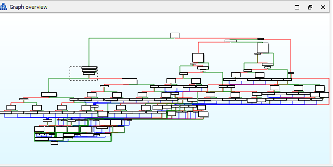

For my torque management script, the previous build was 417 lines, and I've put things into enough functions that it is down to 94 lines, of which the first 20 or so are various setup fluff. Now it should be easier to compare to the stock (Siemens MS45) ECU setup.
I also started looking over the MS45 assembly:

Gone through more. Not done yet lol.

Well, I got everything integrated and flashed. I turned on the option to use the new code, and...
A. What a difference a little filtering makes. ;) (Engine Speed Gradient vs Filtered version)
B. I wasn't sure the car was going to idle at all. So, quite happy.
I took a spin around the block and I need to fix the fueling first, it'll stall sometimes coming to a stop. Still doesn't shift to second gear yet. :( But I haven't touched any gear shift stuff recently, so not entirely shocked there.
Still more to go, but goal for today (start car, get it to idle) - achieved.
