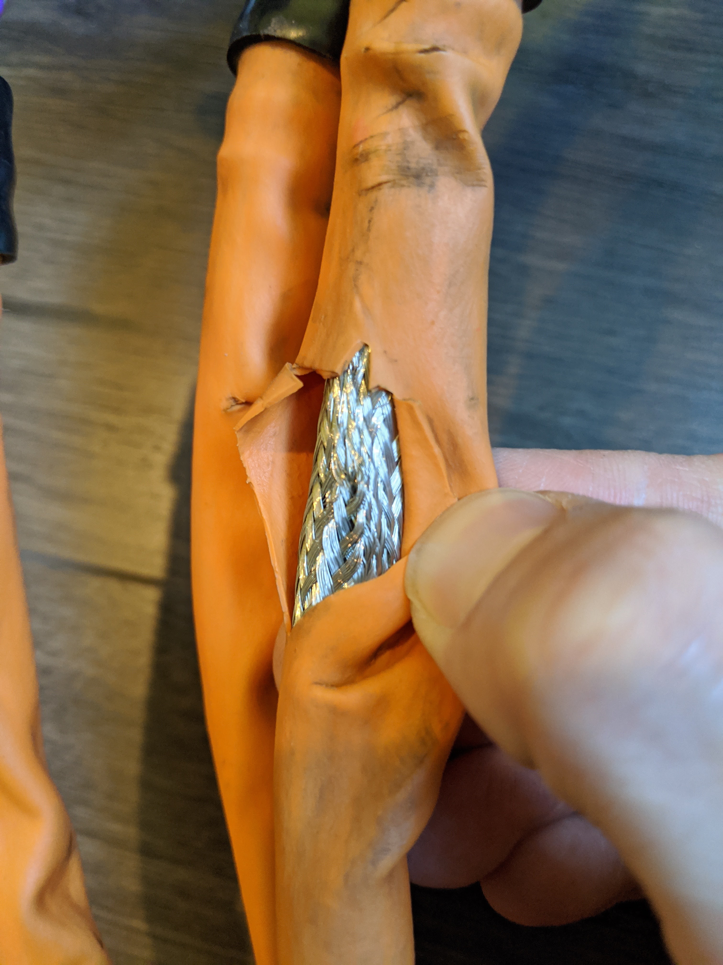

* UUC Dual-Disc clutch + lightened flywheel (what's on the car currently)
* SMG/SSG 6-speed BMW gearbox
* Stock differential

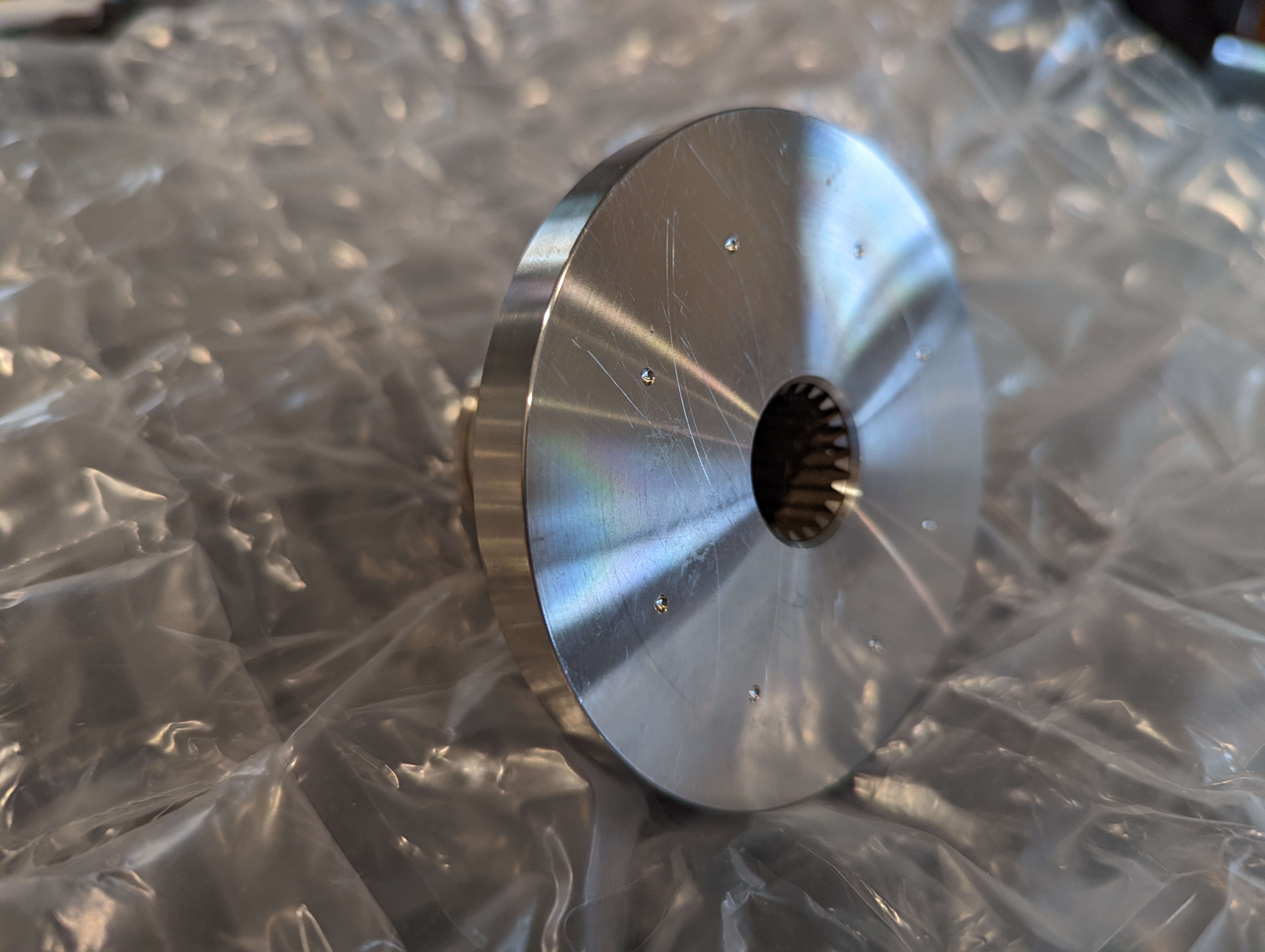

* Adapter assembly $250 ???
* Leaf spline adapter $300 including shipping
Inverter:
* Chevy Volt Inverter (part # 12643810) - $81!
* Chevy Volt HV Cables (part # 24274910 and 24274911) - $235
* Ampera control board from Damien - 100 Euros (~$112) value.

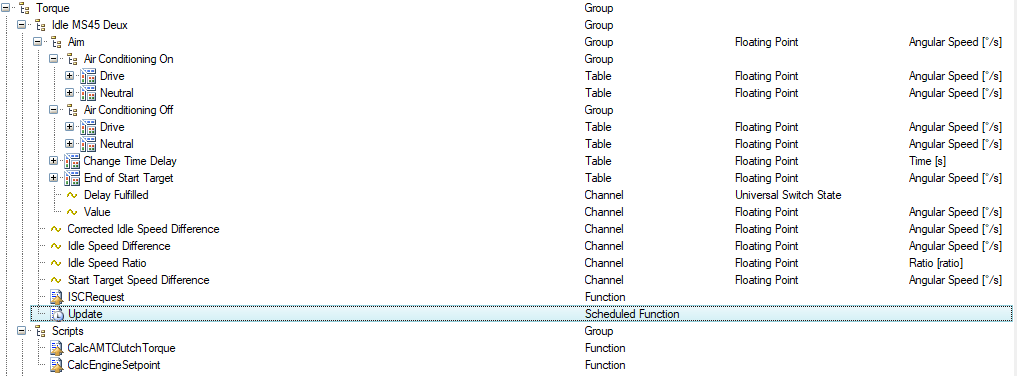

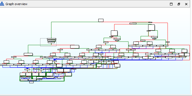

MoTeC M130 with custom software. Will control SSG gearbox, and contain torque -> demand calculations to keep everything running happily.
Purchasing from business partner from the first car I did development for MoTeC M1 on.
* M130 ECU
* Logging Upgrade (Up to 2000 items, and up to 1000 Hz rate (not both!))
* Analysis upgrade (Motec has standard and "Pro" edition of their i2 software, I accidentally purchased this upgrade, oops, had to eat the cost..)
* Development package (run your own software on it)
Value: $6487
Cost: $750
Sane configuration: M130, Drobnak Software "DS BMW E46 OpenInverter EV" package, Level 2 logging (200 channels at 200 Hz) - $2295 + 650 + 329 = $3274

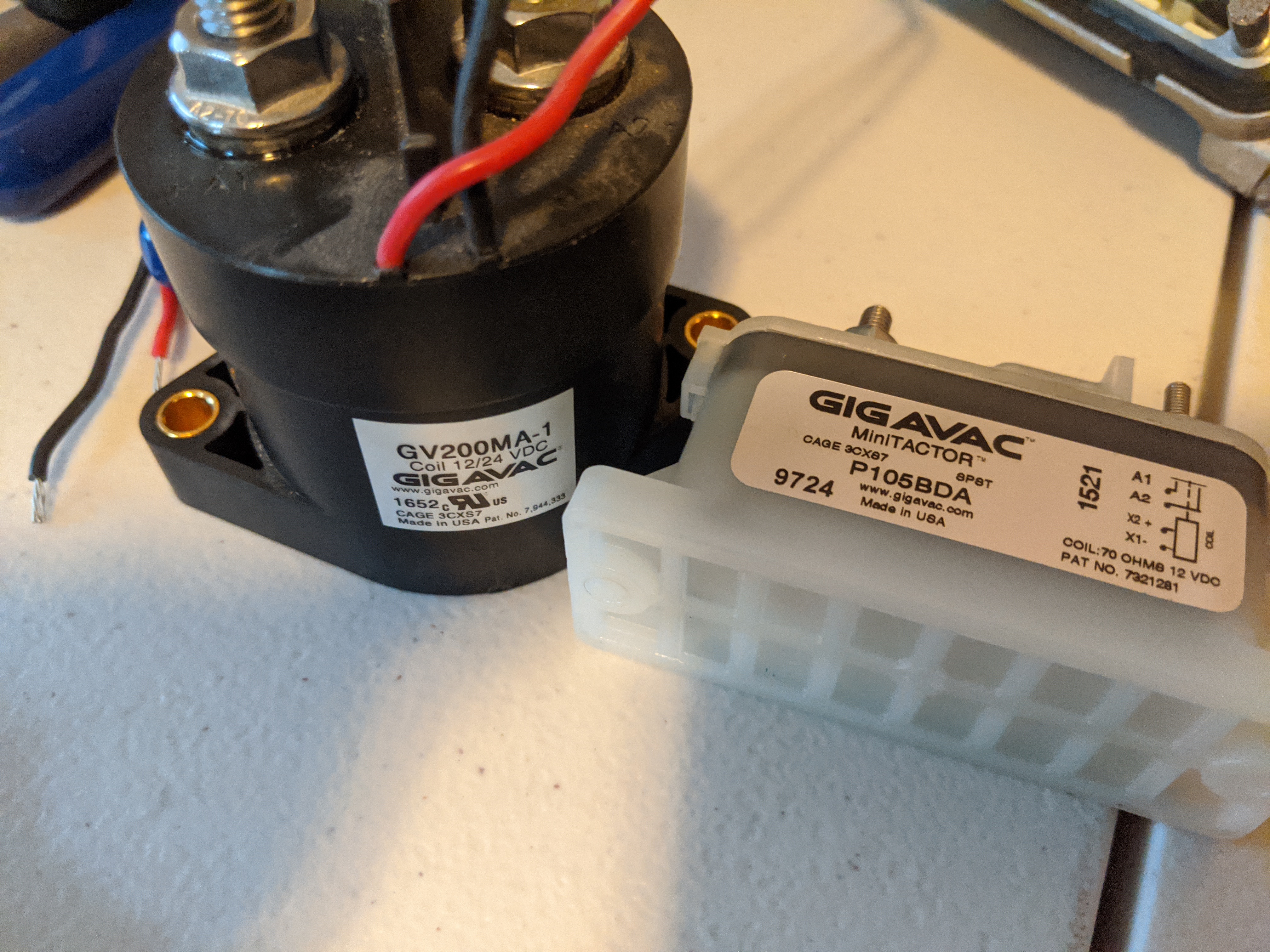

* 2 GigaVac GV200 Contactors - $140
* 1 GigaVac MiniVac Contactors - $40
* 1 400A 500V A50QS400-4 Fuse - $30

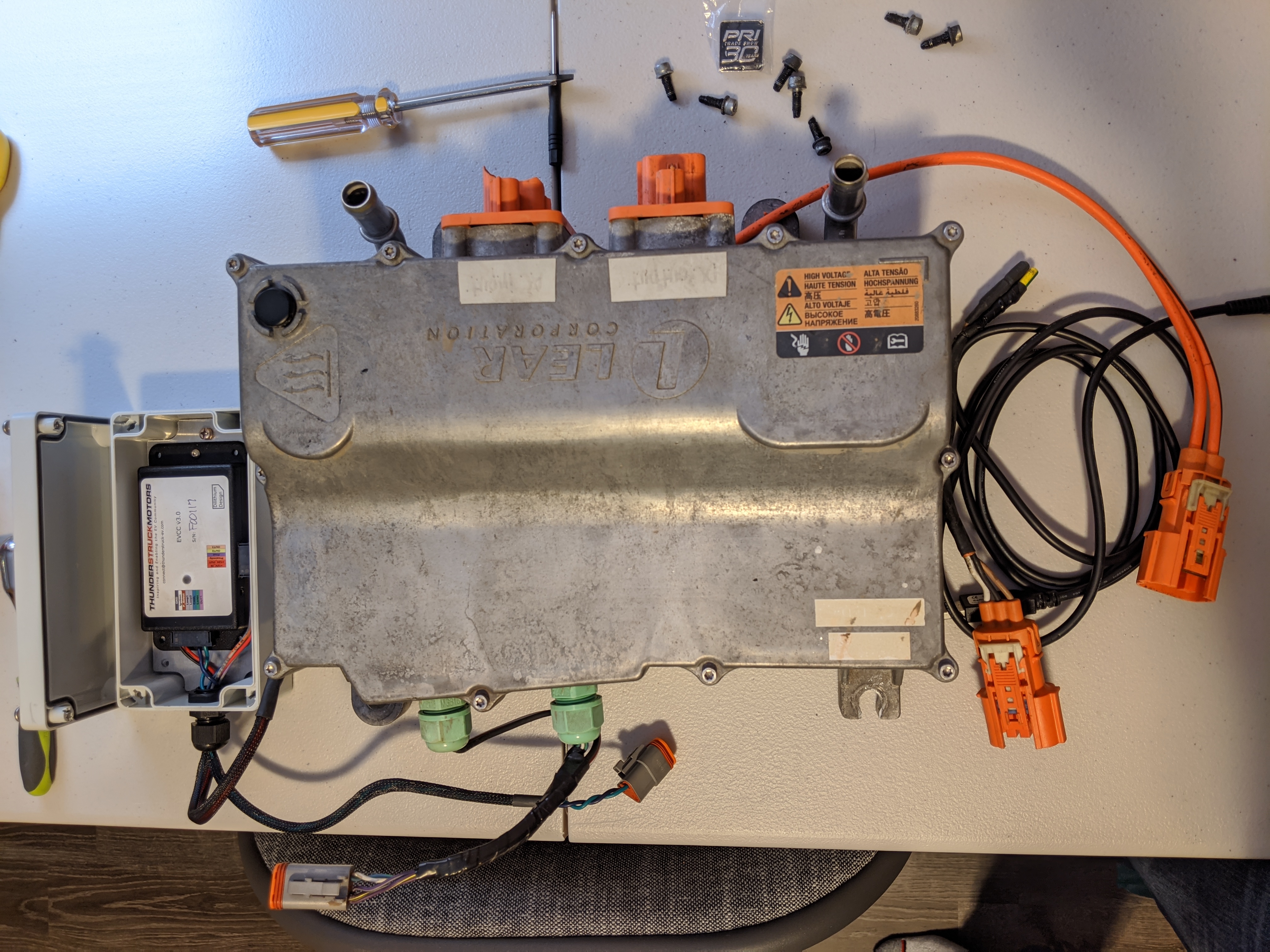

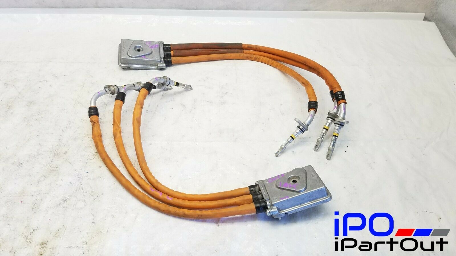

Charging:
* Tesla Model 3 Charge Port ECU $45
* Tesla Model 3 Charge Port + HV cable $210
* Tesla Model 3 Charge Port Door $54
* Tesla Model 3 PCS $265

Edit 2021-03-23 - Add Tesla Model 3 PCS, Leaf motor, Leaf spline coupler, remove mystery motor reference for now.

Charging:

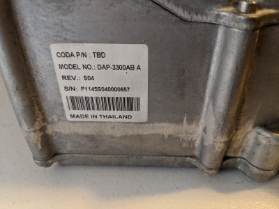

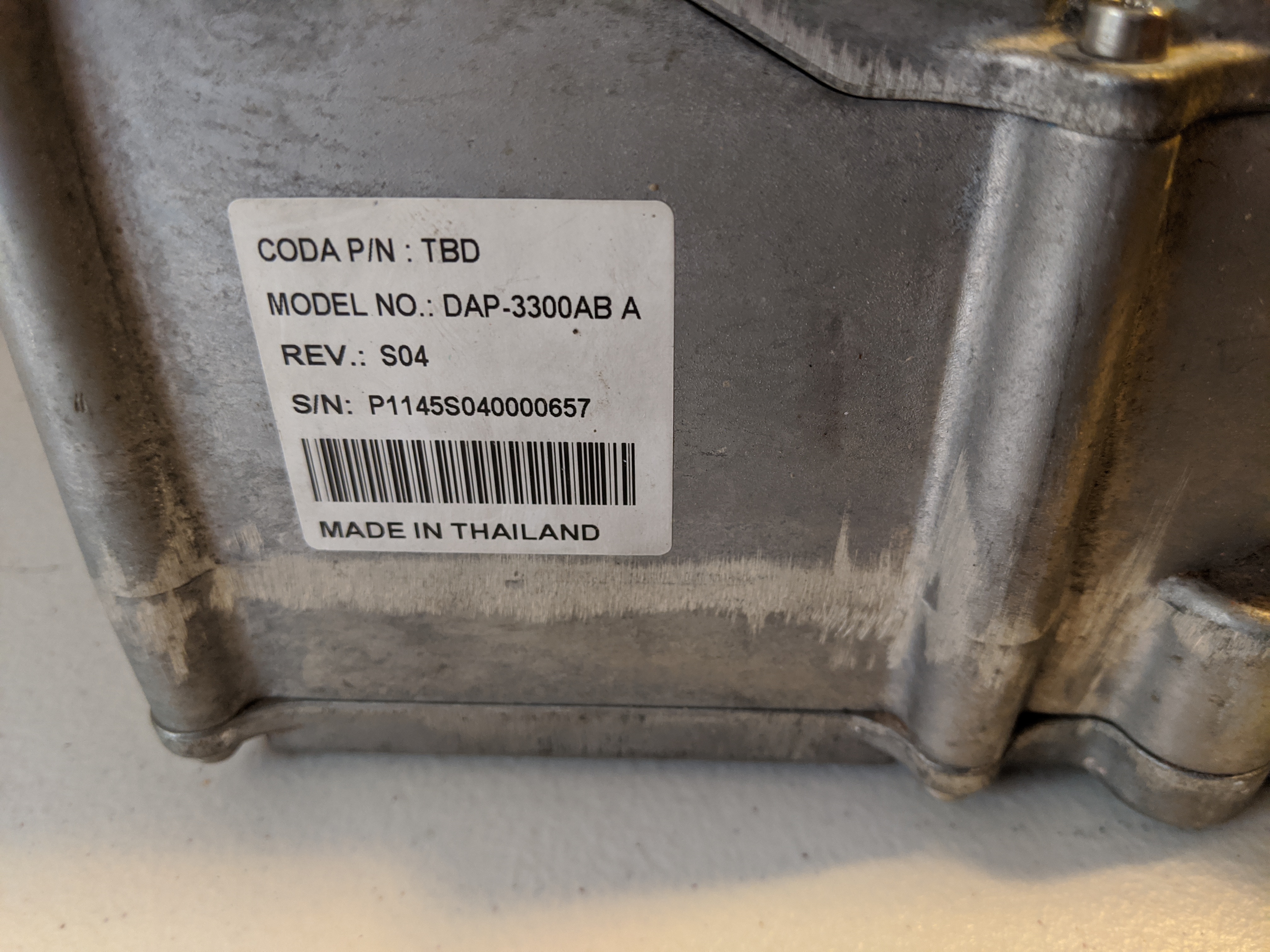

* Chevy Volt / Lear charger w/ DC-DC - $475 from Jon Volk [ Actually from CODA car ] - Going to use this on the M3 or the bench instead...
* Sell the EVCC charge controller that was included for $???
* J1772 AC charge socket + CHAdeMO socket from LEAF - ~$250 - Round one - $255 inc shipping
-- Need to see how badly the CHAdeMO one is messed up in real life. Bad. Only good for some reverse engineering work.

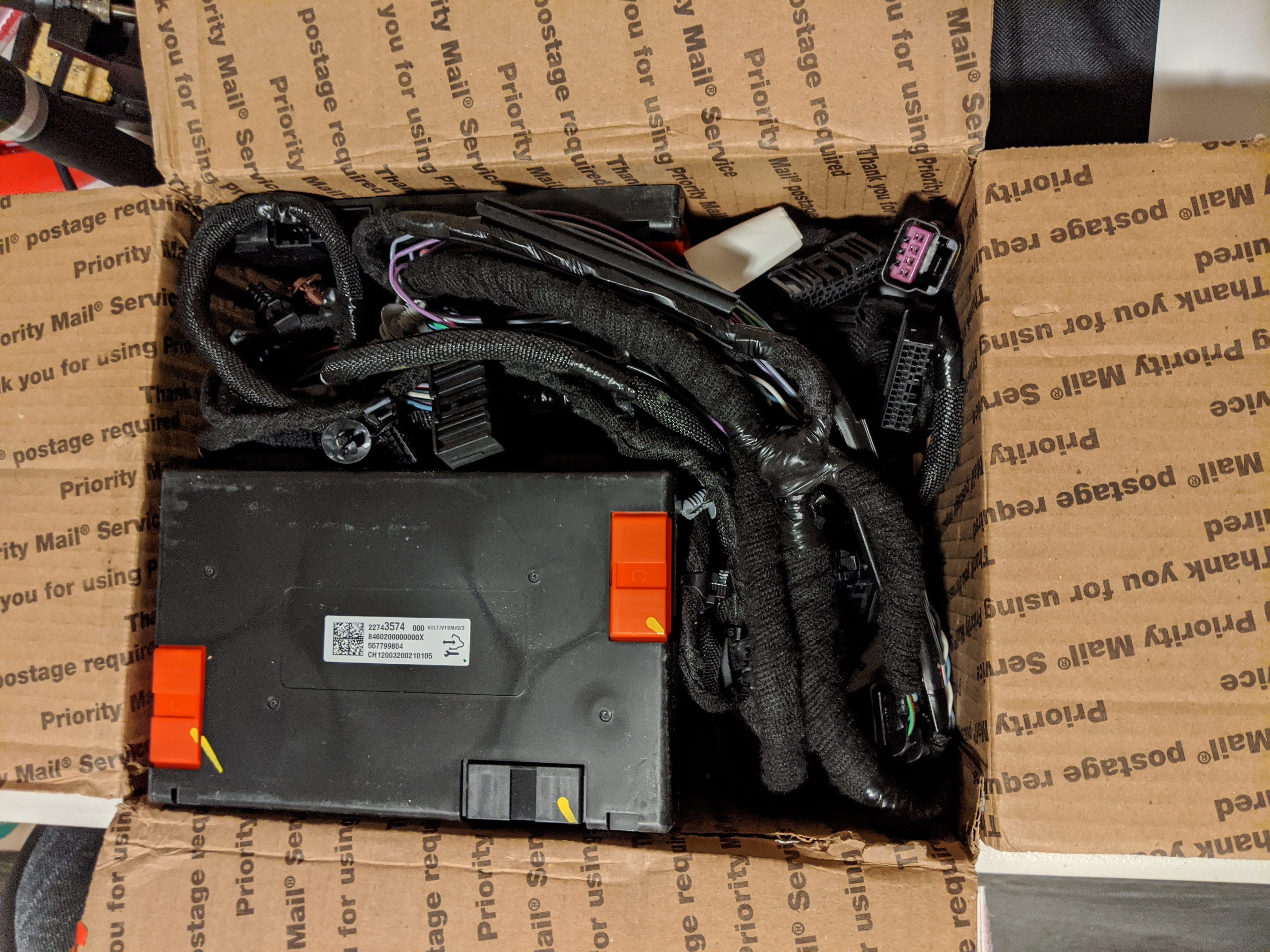

For reference here is the vehicle in its natural habitat, bundled with laptop. :-D
And two complete Volt BMSes:
-Matt

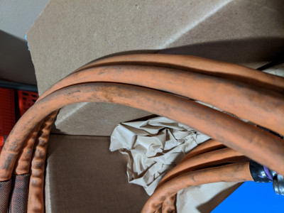

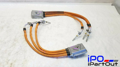

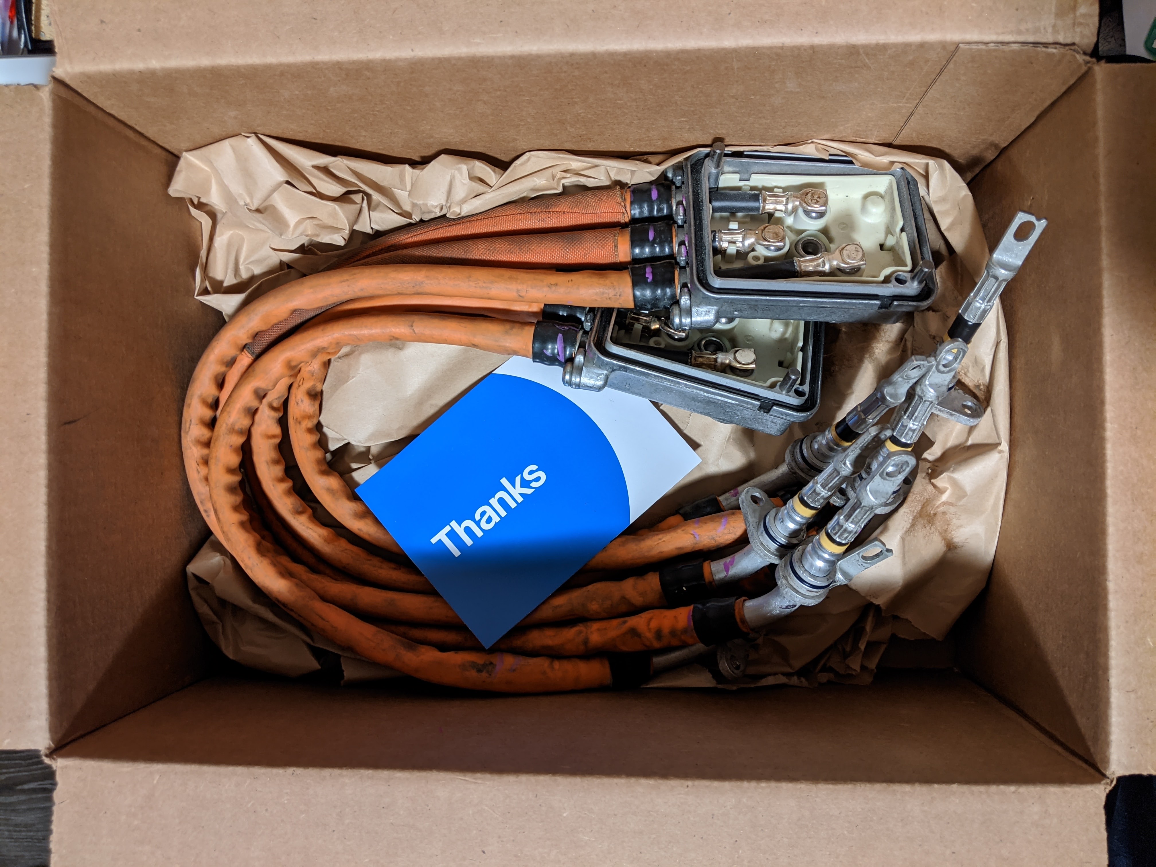

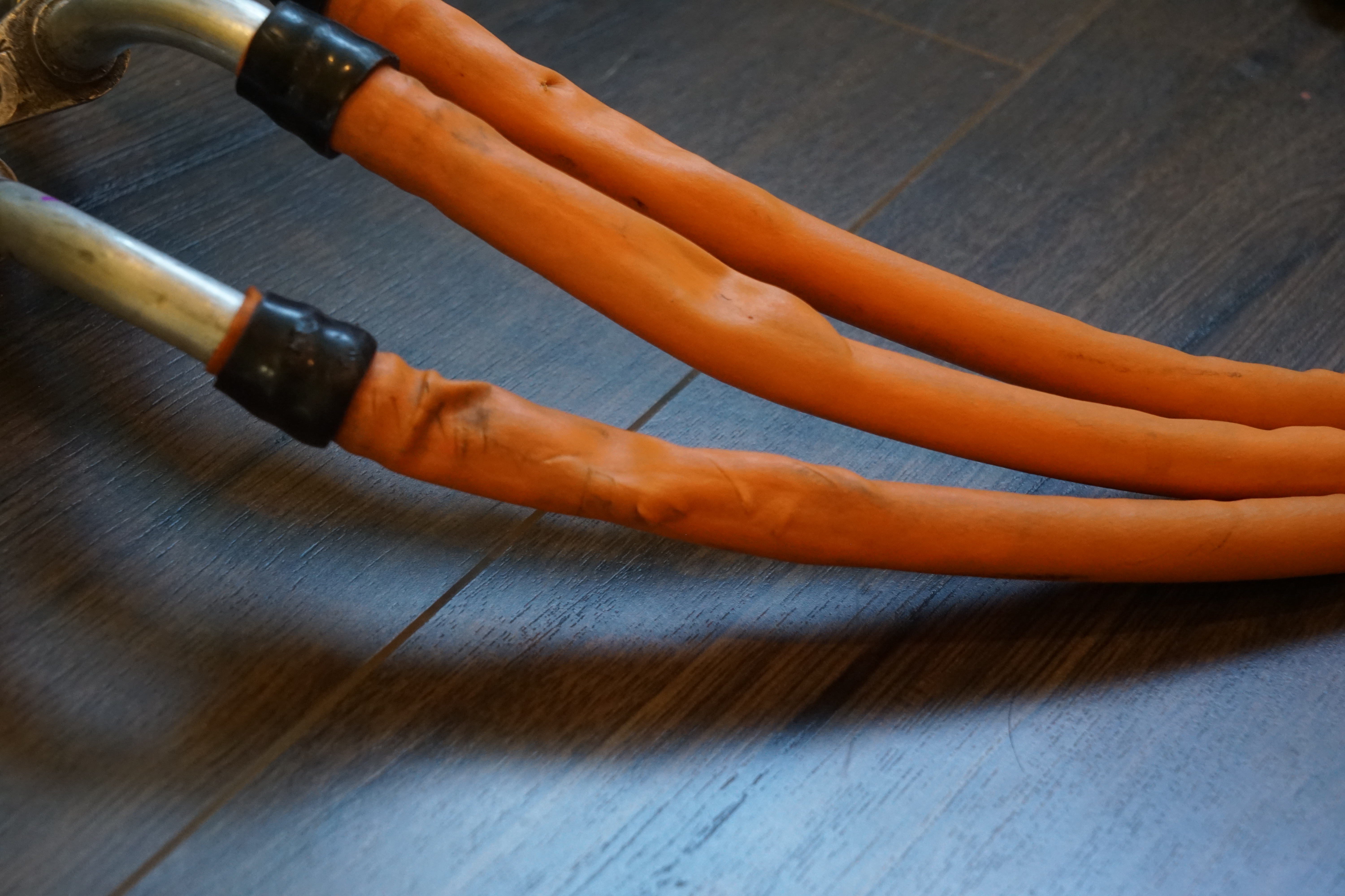

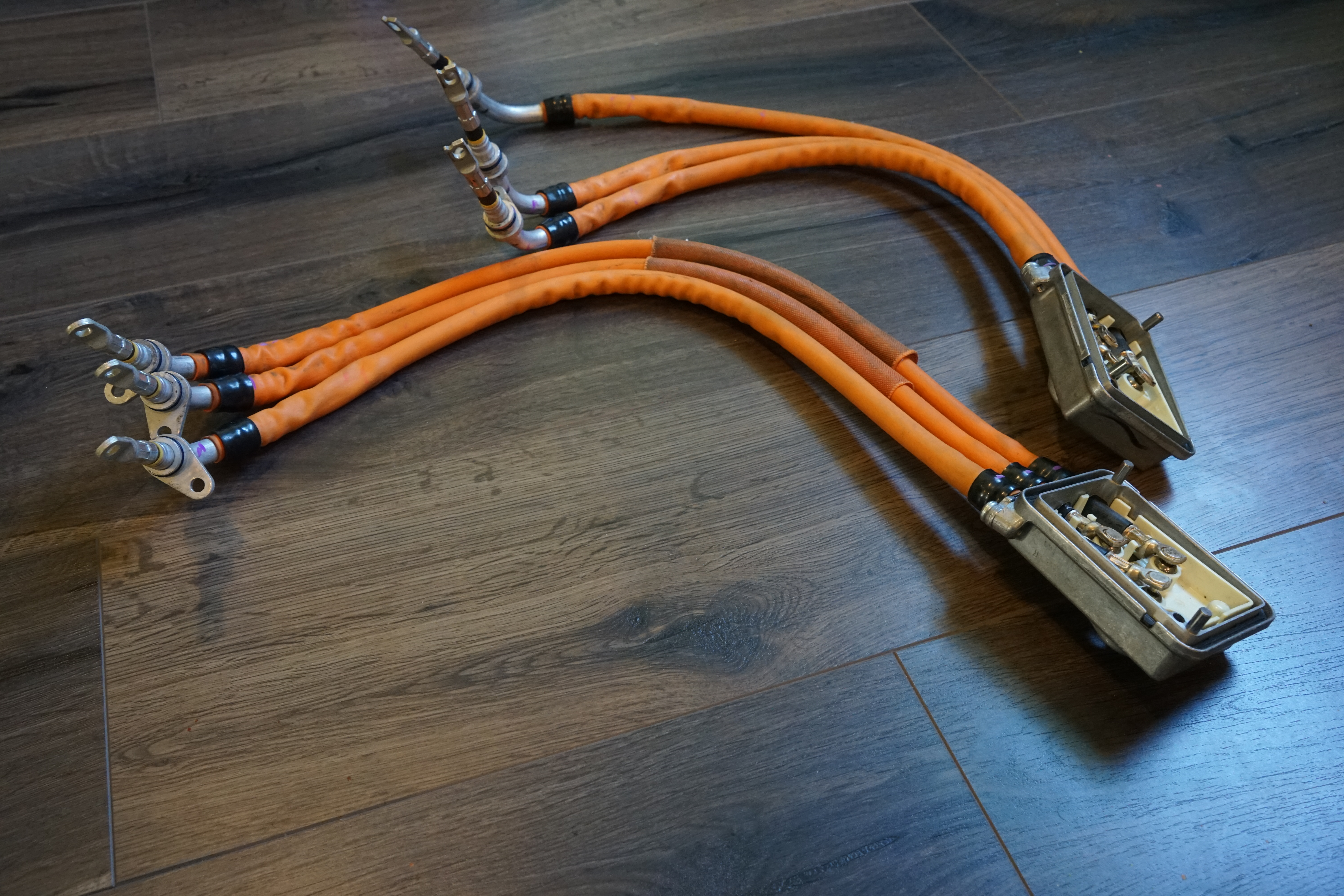

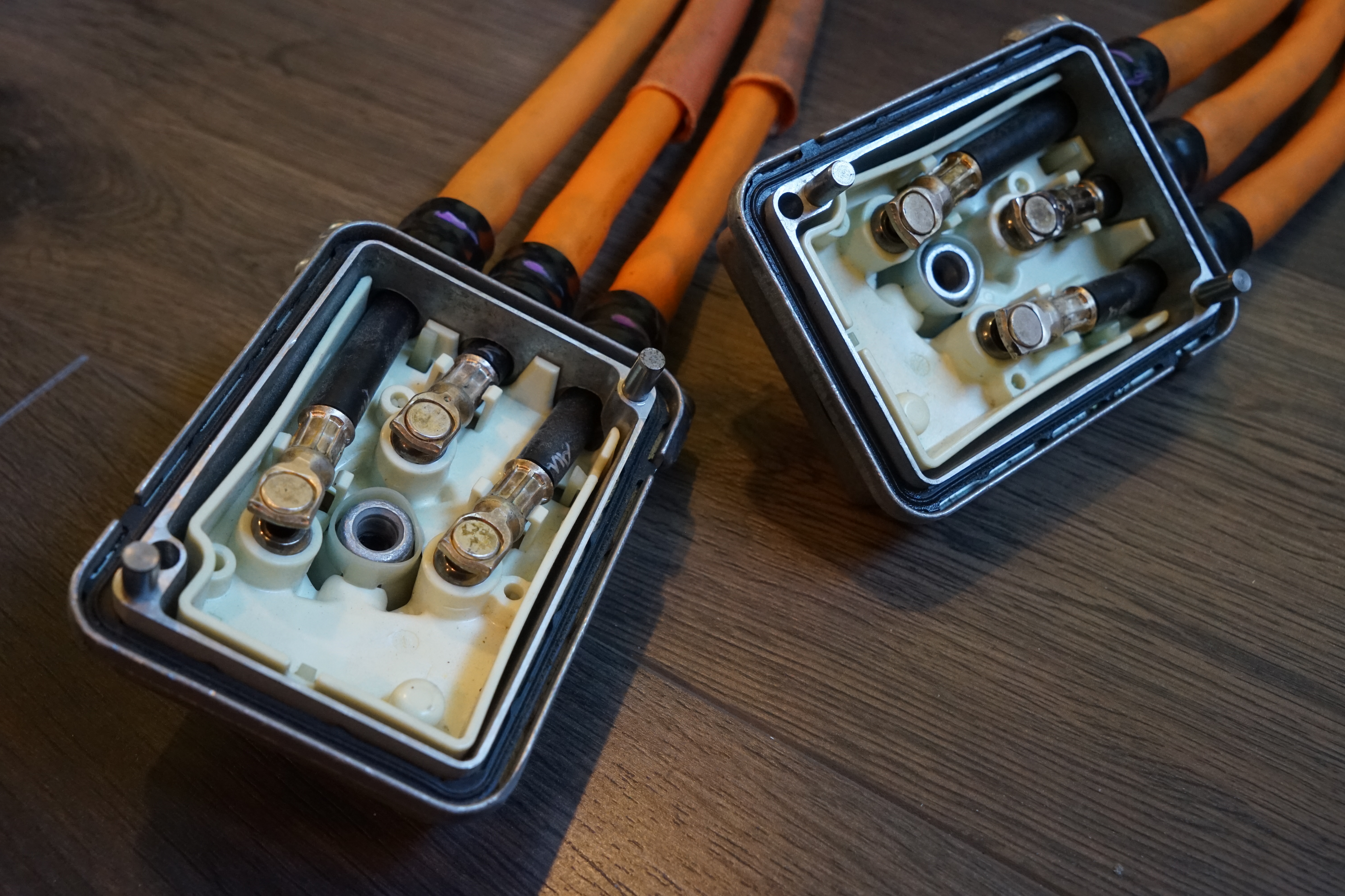

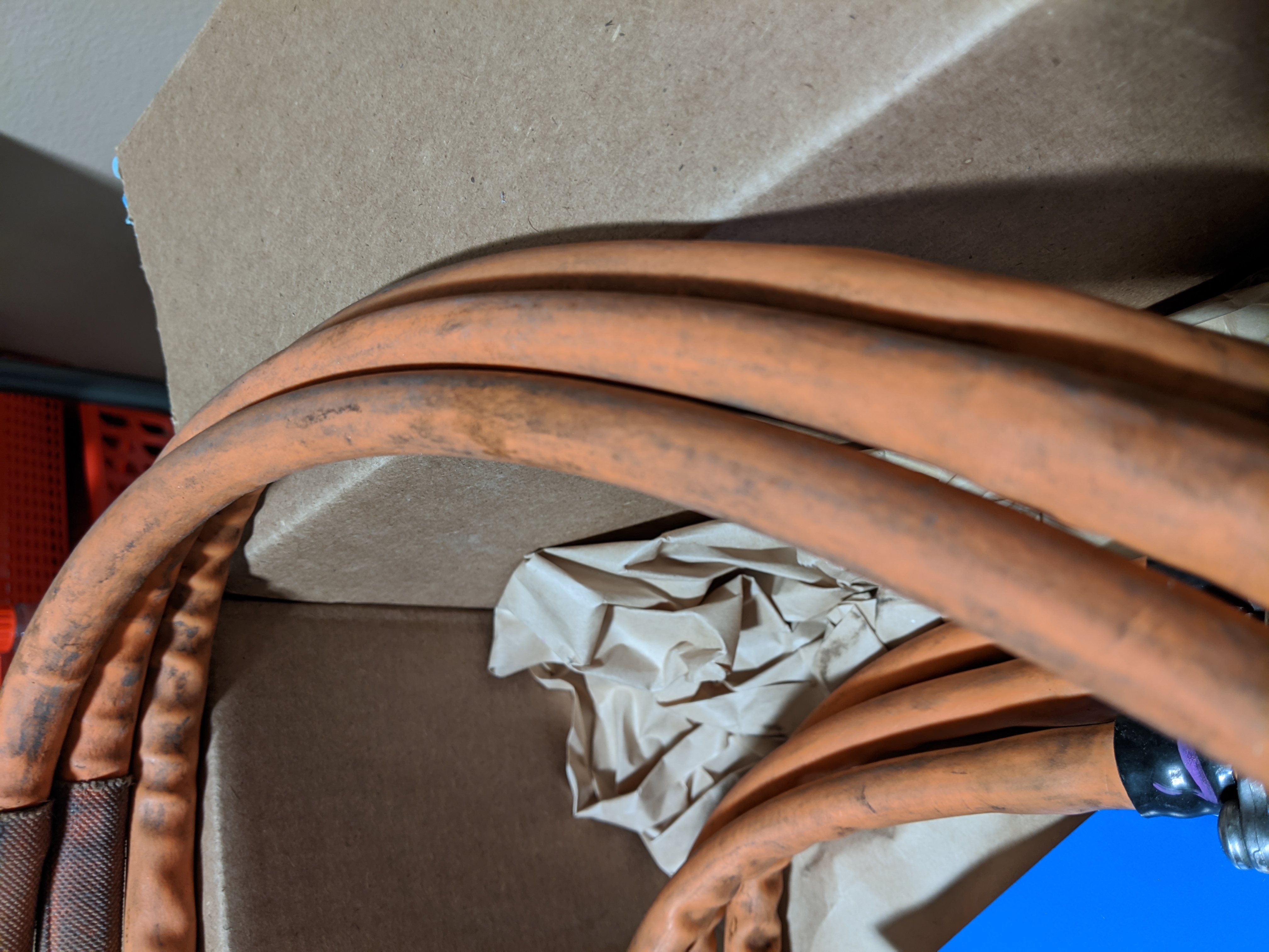

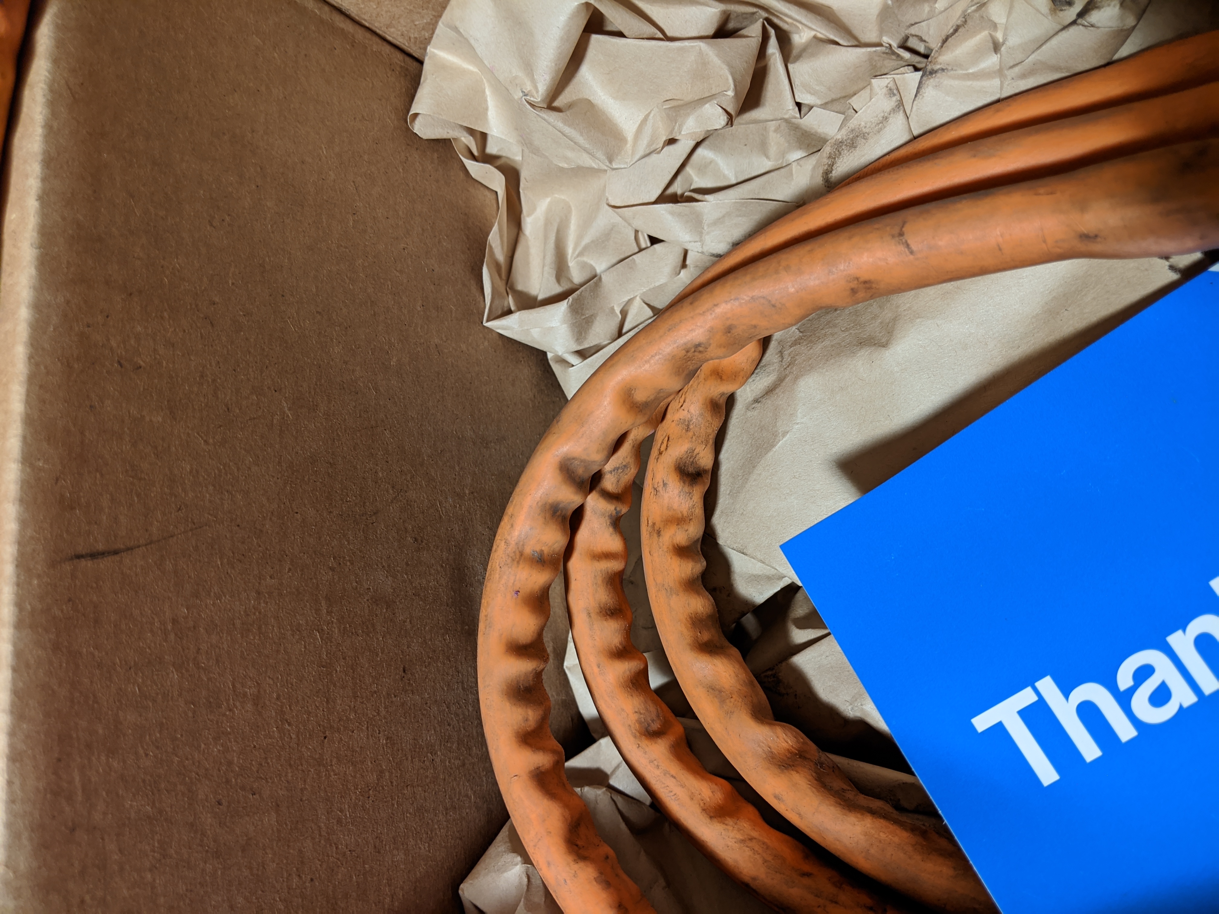

Just ordered this:
$215 + $20 shipping = $235. Usually they're like $260 a piece. It makes the inverter less of a deal, but still decent!
Added price to first post.

mdrobnak wrote: Thu Apr 30, 2020 3:43 pm Just ordered this:
Yeah, but any DMV inspector seeing this will just look for other things. This is totaly foolproof as phase wiring is considered. I remember now i have seen measly 16mm2 also on Remy motor. Your contacts may be beefier, but still you only need some 30kW to drive on level road. Anything else is for acceleration and it is over fast :).
Also if you intend to use that BMW transmission you may build Alu casing on the bell to put motor inside with lubricating and bearing seals and everything. This could be a nice compact unit.

arber333 wrote: Thu Apr 30, 2020 4:40 pm Yeah, but any DMV inspector seeing this will just look for other things. This is totaly foolproof as phase wiring is considered. I remember now i have seen measly 16mm2 also on Remy motor. Your contacts may be beefier, but still you only need some 30kW to drive on level road. Anything else is for acceleration and it is over fast :).
Yep, it's why I'll pay a little more to get it to OEM as possible. :) More than OEM performance is always welcome though. :D
Yes, I'm using the 6-speed that comes with the car. I'm not sure of how it will end up aside from I know I'm going to use the EVWest coupler:

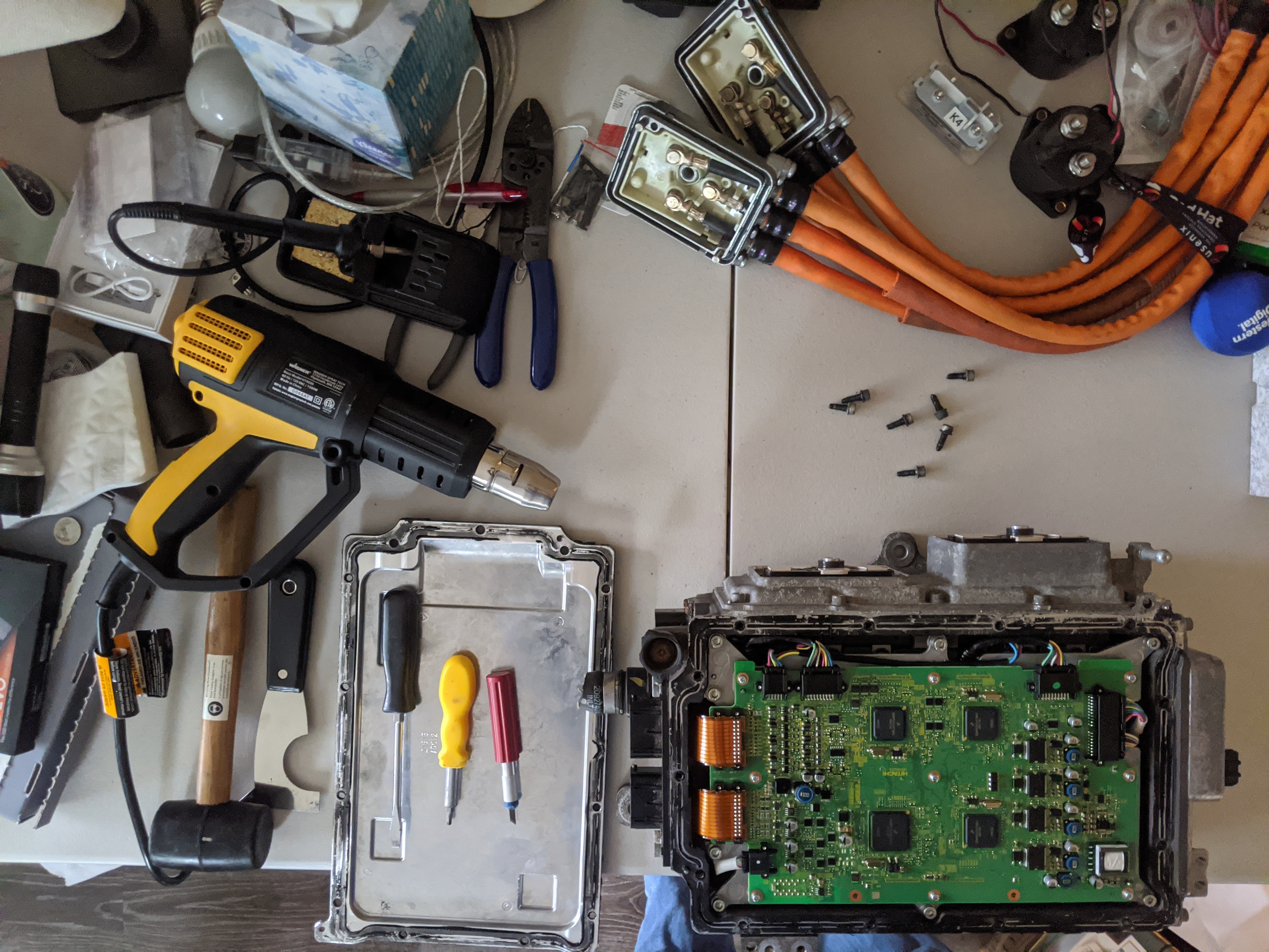

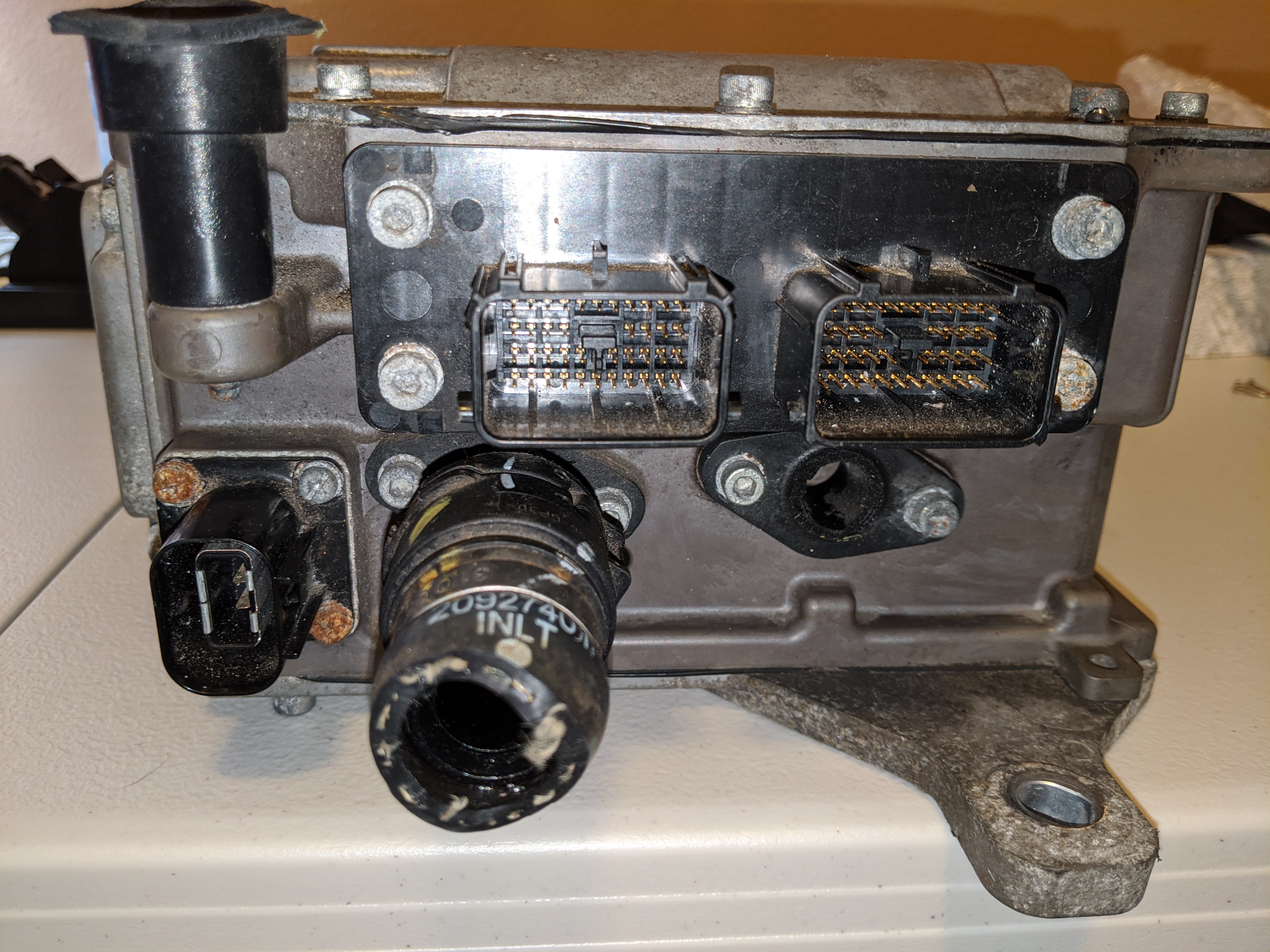

Post by mdrobnak »

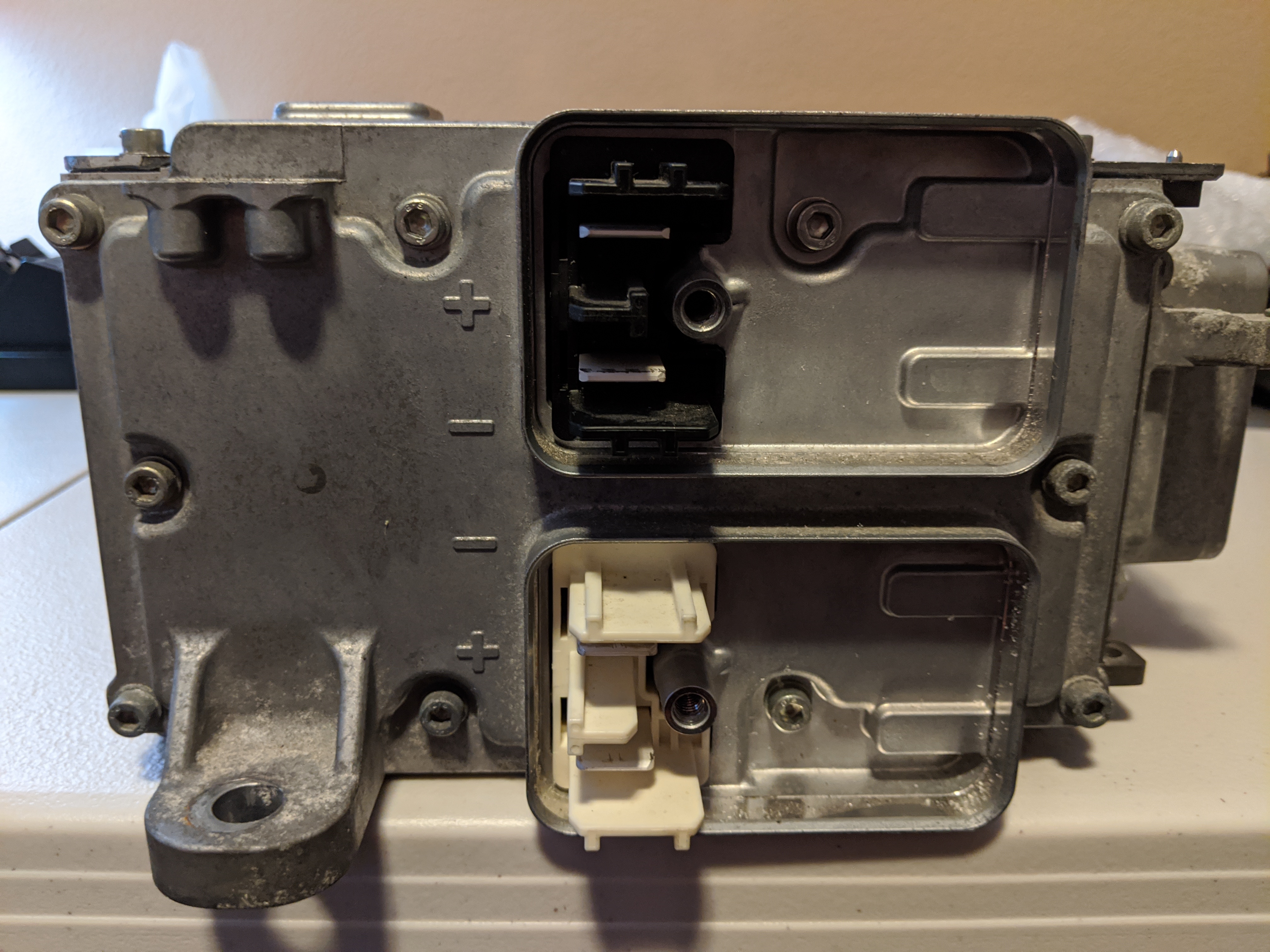

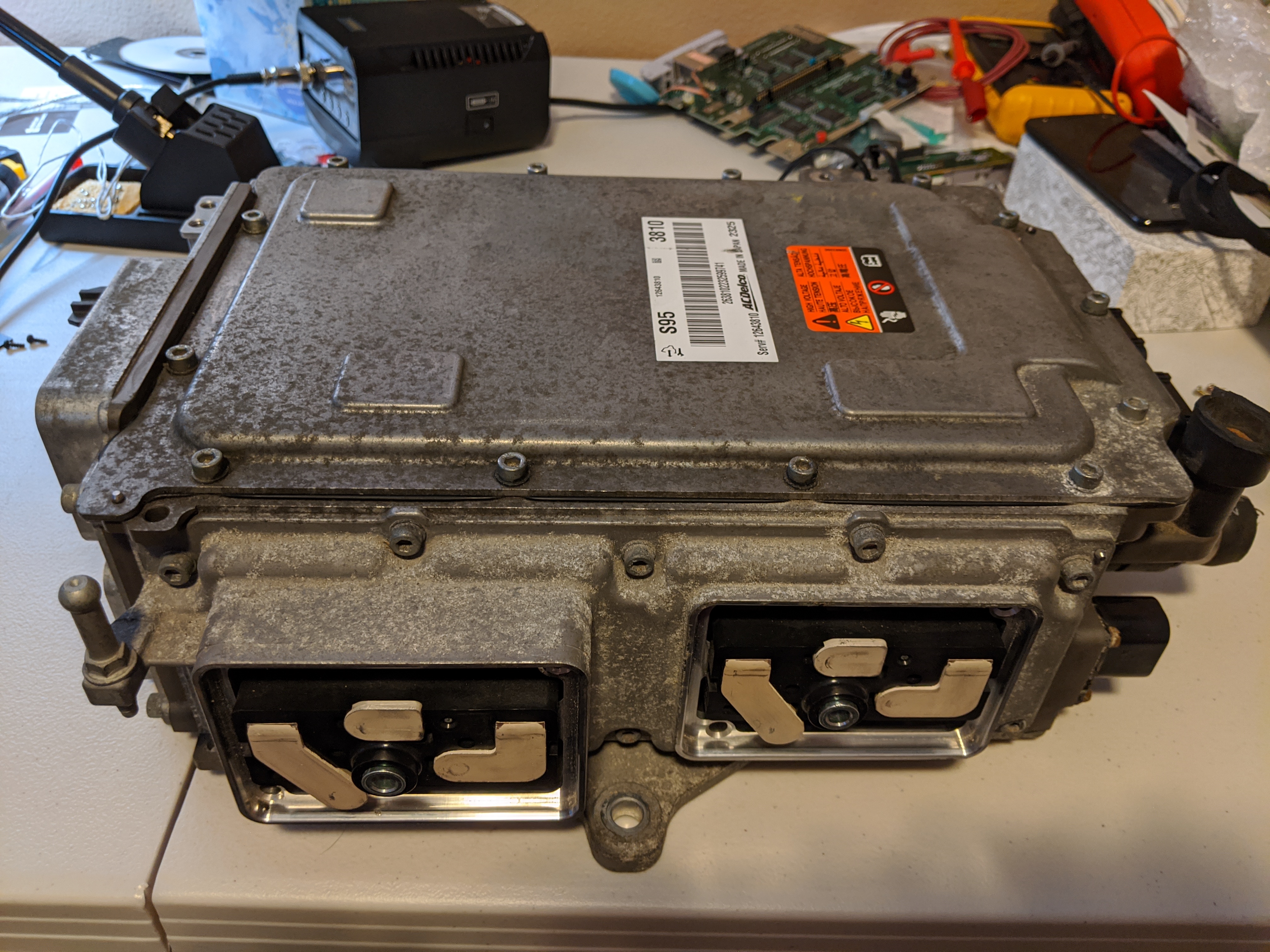

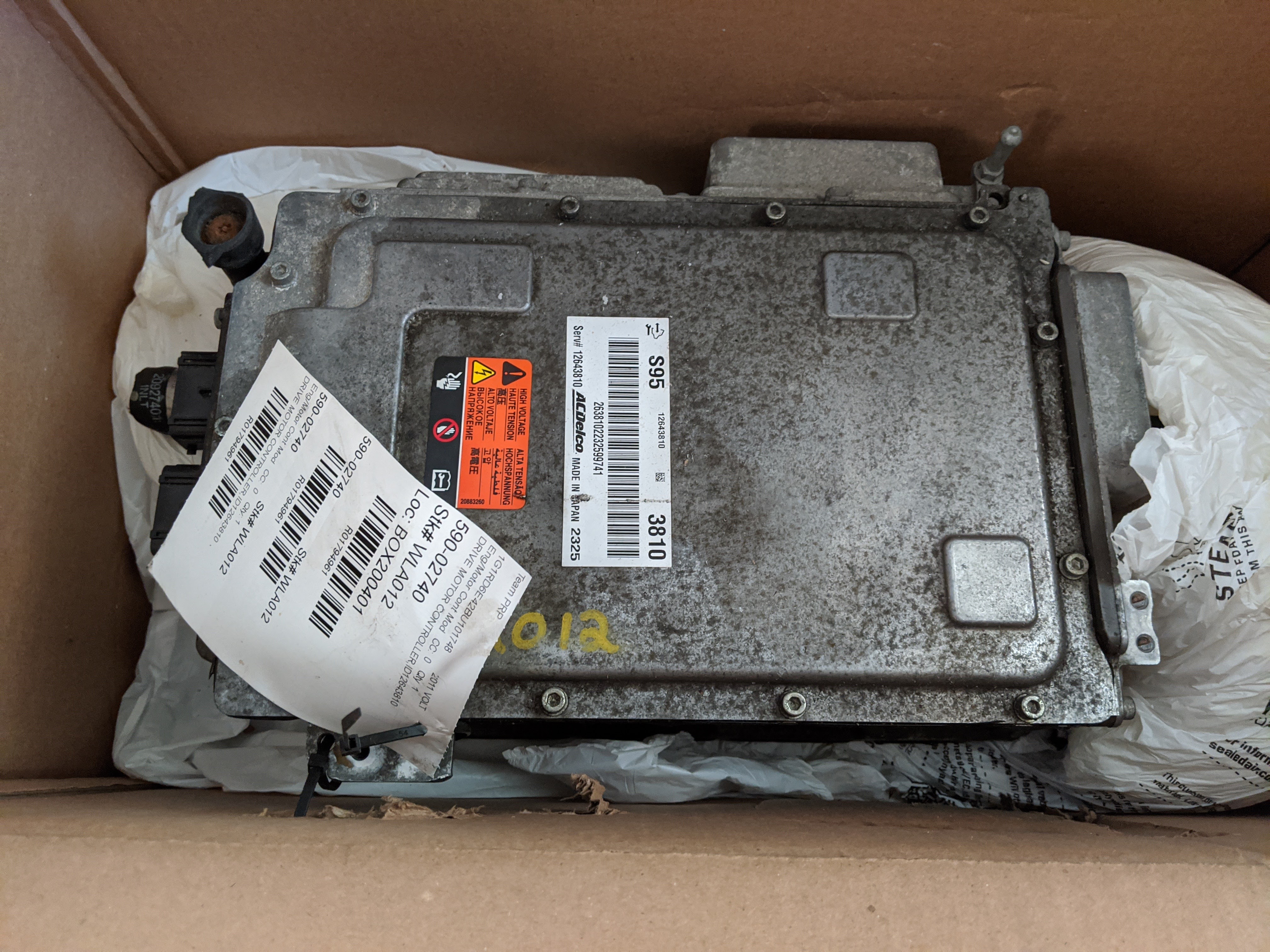

Inverter arrived today. Metal was more pitted than I expected, but.. $81..sooo..
Next step is to get it opened up.
-Matt

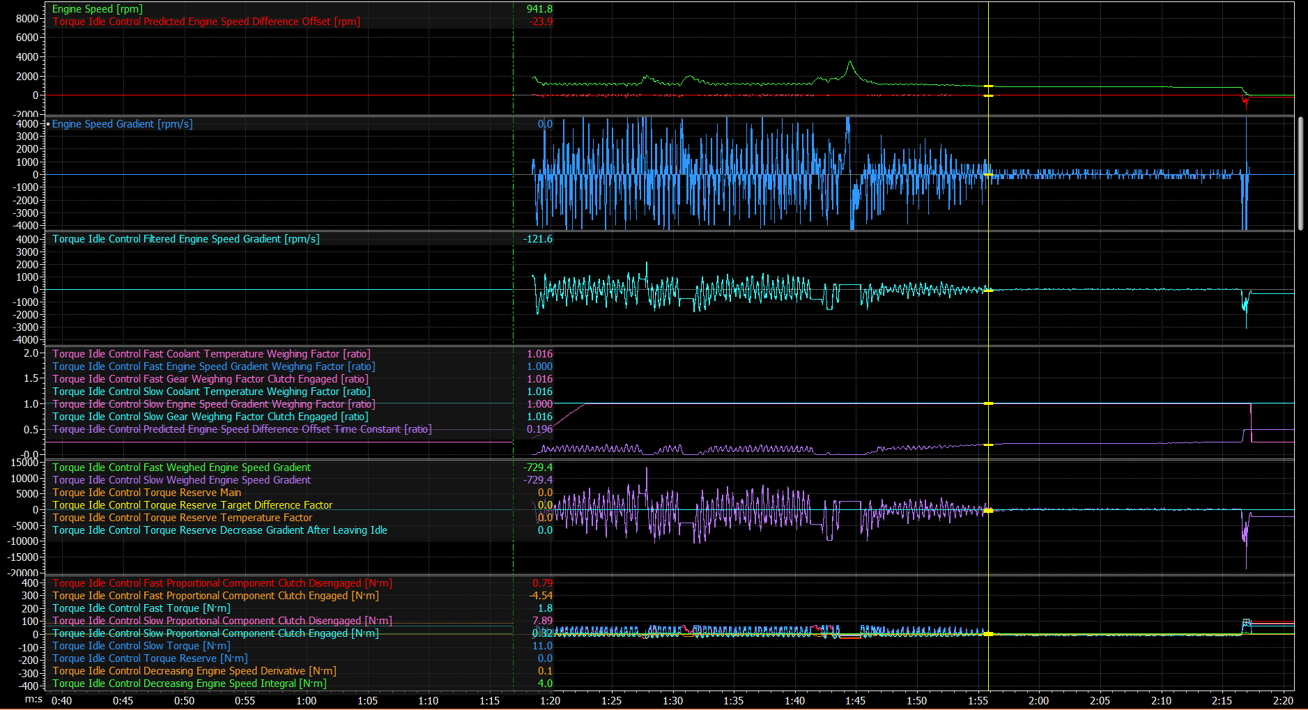

Pre-req progress:
Commanded torque is torque delivered, for the most part. I had a hack that I forgot about that was throwing off my calculations. Now as long as airflow calculated = airflow delivered, then torque is the same as well.

Received the HV cables a few days ago:
Packaged well:
Two cables, with thank you card:
And...they're a little rougher than in the pictures (I'ms seeing a trend here.):
I used some Simple Green on them, and that cleaned it up quite a bit. I haven't attempted to take them apart yet:
There are some tears in the orange sheathing:
Looks like it was just in the shielding:
The connector themselves are indeed weird as others have noted:
Questions at this point:
1. Best way to ensure the second set of cables is ok and not cut into? The other set looks to be fine.
2. It looks like the pins sit against some sort of ball with a hole in the middle? Are they supposed to be separated like that, or do I have to completely disassemble these connectors? (I'm probably going to anyway...)
I hope to get the inverter cover off tonight or tomorrow.
-Matt
Posts: 3578
Has thanked: 134 times
Been thanked: 342 times
Re: 2004 BMW 330 with SMG/SSG Gearbox
mdrobnak wrote: Fri May 08, 2020 11:15 pm Questions at this point:
-Matt
1. Go and measure continuity from phase contactsd to its shield. There should not be a beep or any ohm measurement.
2. Why would you want to dissassemble them? Pins sit against a spring because they need a good contact in high vibration enviroment. Still i dont trust just friction contacts. I wont them bolted down. But those 16mm2 measly cables are good if you want to go assembly like OEM. I will just go for larger contacts and cables....
You can just use the casing part that bolts to inverter and cut cables downstream and splice them to your choice motor cables.
mdrobnak
Posts: 692
Post by mdrobnak »
arber333 wrote: Mon May 11, 2020 9:32 pm
-Matt
1. Duh. Thanks for that. Sometimes I think too hard. :)
2. Ah, didn't think of it like that. Ok, good to know it's not an issue. I was going to disassemble to ensure they were as clean as possible. For now, stock diameter is fine I think.
-Matt

mdrobnak
Posts: 692
Post by mdrobnak »
It's free!
Finally got the Volt inverter opened. Wow, what a pain in the butt.
Needed to use my Wagner heat gun at about 600 degrees F, the scraper that comes with it, a flathead screw driver, and a mallet. I tried using a knife to cut the seal initially but that failed miserably, don't bother. :D
You can see the two main contactors and the minitactor in the top right of the picture, too. Not sure where I put the fuse.
On the upside, looks definitely intact. So that's a score for $81.
-Matt

mdrobnak wrote: Fri May 15, 2020 12:59 am You can see the two main contactors and the minitactor in the top right of the picture, too.
If they're Tesla parts then don't forget to add an economizer.
Here's the Model 3/Y versions but the issue is the same for Model S/X;
https://openinverter.org/wiki/Tesla_Model_3_Contactors
mdrobnak
Posts: 692
Post by mdrobnak »
Kevin Sharpe wrote: Fri May 15, 2020 11:23 am
Not from a Tesla, as far as I know.
GV200MA-1 for negative and main contactor. That has an economizer built in.
As far as the MiniTACTOR, doesn't look like it. But on the flip side, I should be able to kill that current path once the cap is charged, no? If that's the case, do I need external circuitry on that?
-Matt
Kevin Sharpe
Posts: 1339
Location: Ireland and US
Been thanked: 8 times
Post by Kevin Sharpe »
mdrobnak wrote: Fri May 15, 2020 2:42 pm Not from a Tesla, as far as I know.
The Tesla GIGAVAC part is a custom GV200 and the ones shown in your photos are the stock part with "PWM" coils which I think are ok. Maybe test on the bench at 12V and check the temperature rise?
mdrobnak wrote: Fri May 15, 2020 2:42 pm As far as the MiniTACTOR, doesn't look like it. But on the flip side, I should be able to kill that current path once the cap is charged, no? If that's the case, do I need external circuitry on that?
Not sure about the MiniTACTOR specs (Maybe test on the bench at 12V and check the temperature rise? ) but worth remembering that Damien's designs typically wire the precharge contactor in parallel with the Negative HV contactor so are on whenever the battery is powered up. Check your inverter controller for details of the precharge/main contactor control scheme.
mdrobnak
Posts: 692
Post by mdrobnak »
Kevin Sharpe wrote: Fri May 15, 2020 4:09 pm Not sure about the MiniTACTOR specs (Maybe test on the bench at 12V and check the temperature rise? ) but worth remembering that Damien's designs typically wire the precharge contactor in parallel with the Negative HV contactor so are on whenever the battery is powered up. Check your inverter controller for details of the precharge/main contactor control scheme.
Oof, I may have goofed on buying that then. I'm holding off on retrofitting a board to the Volt inverter until Damien is finished up with his design. Although for that inverter its basically a collaboration between Damien and Arber, so I'd have to look more closely at the schematics again.

Based on a reply from Damien, the current code turns off the contactor after precharge. So I'm OK there.
I finally unpacked the charger today. Here's what we have:
EVCC controller, charger with the 3 phase AC input receptacle needing some work, a weird 1/8" jack to USB cable, and AC / DC pigtails.
Also found out that it's a CODA charger:
I love that the part number didn't even exist.
-Matt
Luckily the SimpBMS should directly work with a CODA charger, canbus is slightly different then the LEAR variants.
Good thing these chargers open up easy and make changing the plugs on them quite straight forward so you can fix the AC side to a pigtail or another panel mount connector.

tom91 wrote: Thu May 21, 2020 9:25 am Luckily the SimpBMS should directly work with a CODA charger, canbus is slightly different then the LEAR variants.
Man, CODA seemed like they wanted to change stuff just to obfuscate things. Glad to hear the integration will be straightforward at least.
Jon Volk ran the charger like that for some time, so the connector is OK enough to work if checked often, but yes I definitely want to replace it.
