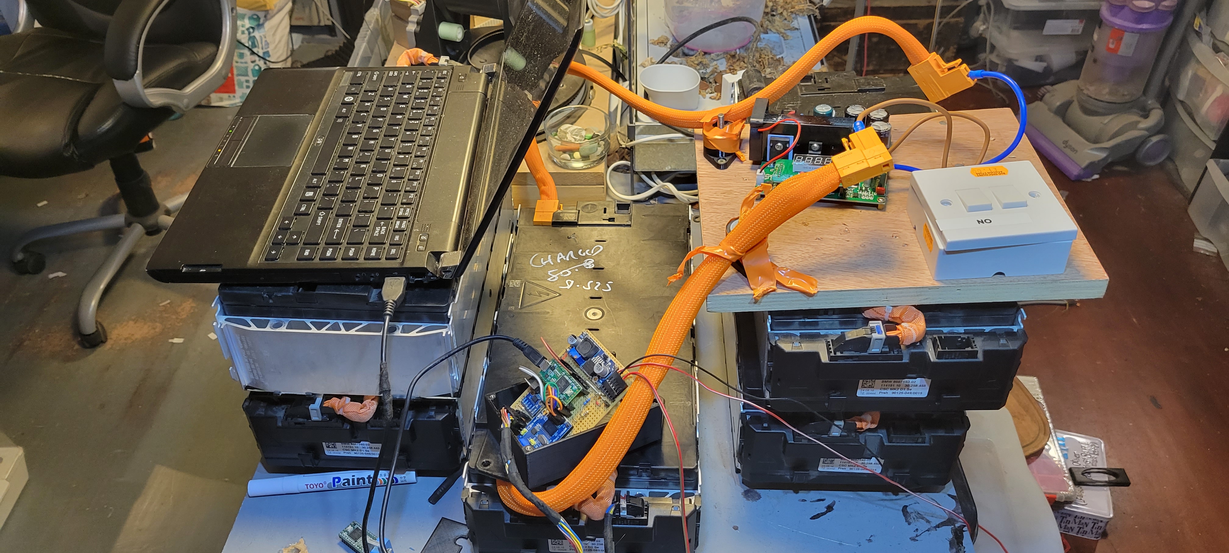

After a bit of a rollercoaster over the last two weeks, including another failure, the project has finally passed its MOT. Now the grin-wearing owner of a fully electric BMW Z3. Full story to come when I get a chance. Short version: brake flaring is a PITA, and always use PTFE on threaded hydraulic connectors.
Anyway, thanks everyone for the support and advice, hugely appreciated. Very happy man.

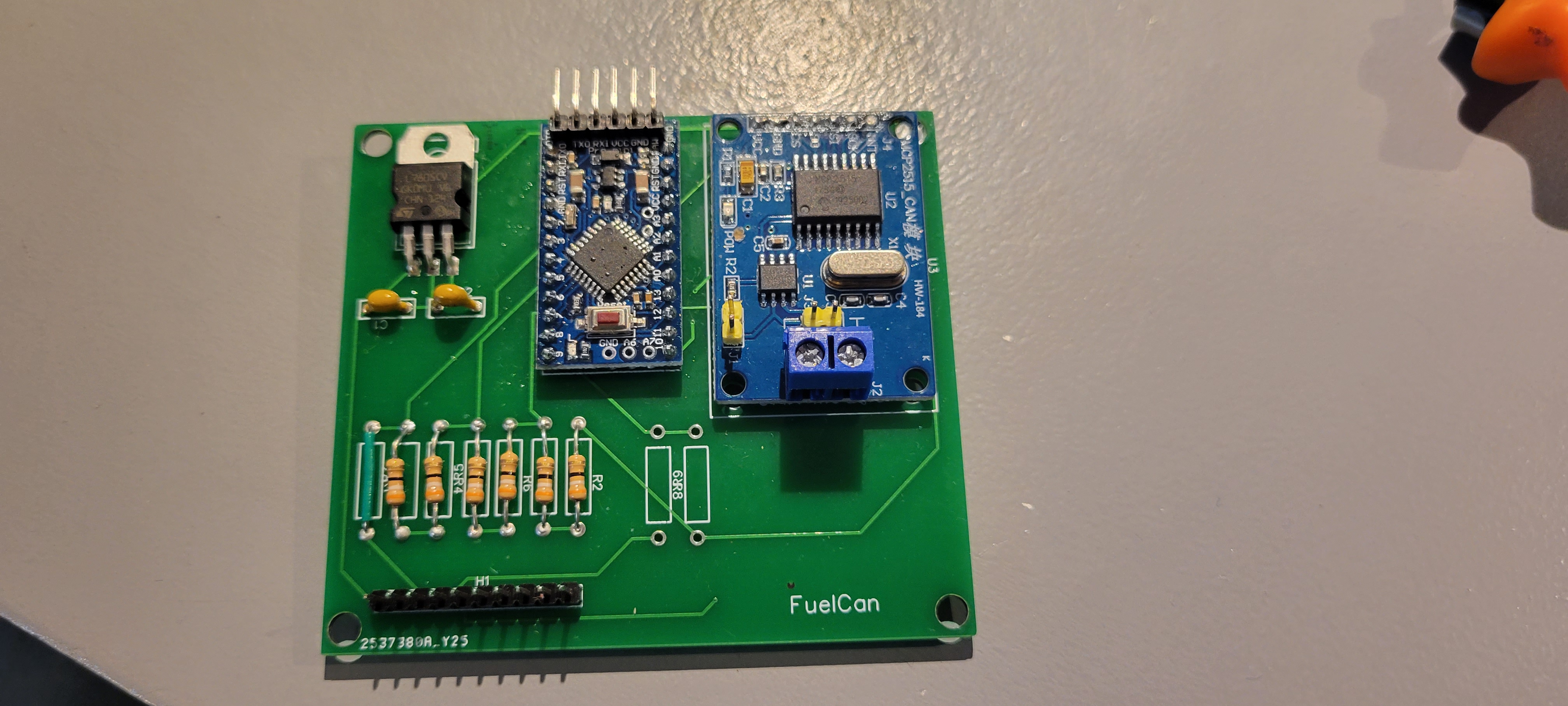

My first full week as the driver of a DIY EV was…eventful.
Let’s start with the bad. On Tuesday, I did what you might call an ‘accidental full range test’. As in, I ran out of juice on the way to collect my daughter from a class and had to dump the car and jump in a taxi to get her. Because I haven’t really worked out the range yet, and nor do I have a real gauge in the car for how much juice is left in the batteries, this was perhaps predictable. Hope is no substitute for electrons.
In order to recover the car I had to swap the modules for spares on the side of the road. This attracted a few comments and interesting conversations. Big thanks to my friends and neighbours Brook and later Owen (who has a very cool YouTube channel) for helping me to push the car to safety.
I was worried I hadn’t done the batteries much good, running them down to about 2.8V. But actually with some gentle charging on the bench, hooked up to a variable power supply and a bodged version of the battery management system, they came back up to voltage with very little persuasion.
Turns out 2.8 is about the minimum specified for the pack so I hope there’s no lasting damage. Unfortunately, I killed yet another Teensy – the microcontroller running the BMS – in the process. These are parts that should not be consumables.
Gauges and charging
So, a ‘fuel’ gauge is something of a priority. This is a work in progress, using a CANbus-controlled variable resistor hooked up to the original sender lines (thank you Jamie). I could put this behind the dash but I’m trying to avoid taking that out for now.
FuelCan by @Bigpie – CANbus controlled variable resistor

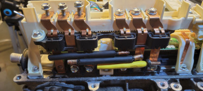

In the meantime I’ve been working on some other upgrades, starting with the inverter.
To date I have only been using half of its outputs – so called ‘MG 2’. But my control board supports me driving MG1 as well and bridging the outputs. This requires some simple soldering of jumpers on the control board (done) and then bridging the phase outputs on the inverter itself (half done).
I’m using short lengths of 20mm2 wire for this, and fabricating copper connectors on each end. This is a bit of a pain of a job, but I’m getting there. Five connectors down and one to go. And some tidying. I want to clean up all the connectors and maybe add some more insulation, assuming it will fit inside the case.
Hi!
Did you fix the problem with inverter shuts-off due throttle kick-down?
You see effect after MG2+MG1 power gate paralleling?
Wich maximum current do you have?
Why you don`t paralleling MG1 busbars with MG2? Here is only 20mm2 per phase - it`s not enough

UStas wrote: Wed Nov 10, 2021 11:40 am
bobby_come_lately wrote: Sat Sep 11, 2021 1:33 pm
Moar POWAH!
Hi!
for 400+Amps phase current
So, to take those in order:
- Did you fix the problem with inverter shuts-off due throttle kick-down?
Not yet. Working on it. May still be temperature related. Experiments ongoing and a new video to follow in a week or so.
- You see effect after MG2+MG1 power gate paralleling?
Hard to say at the moment. I think the motor is the limiting factor not the inverter.
- Which maximum current do you have?
We recorded over 500A on Jamie's beetle last week with the same setup
- Why you don`t paralleling MG1 busbars with MG2? Here is only 20mm2 per phase - it`s not enough for 400+Amps phase current
Not sure I understand. That's what I and others have done without issue. The dimensions aren't much different to the busbars themselves. And you're not seeing huge current on those connections.
