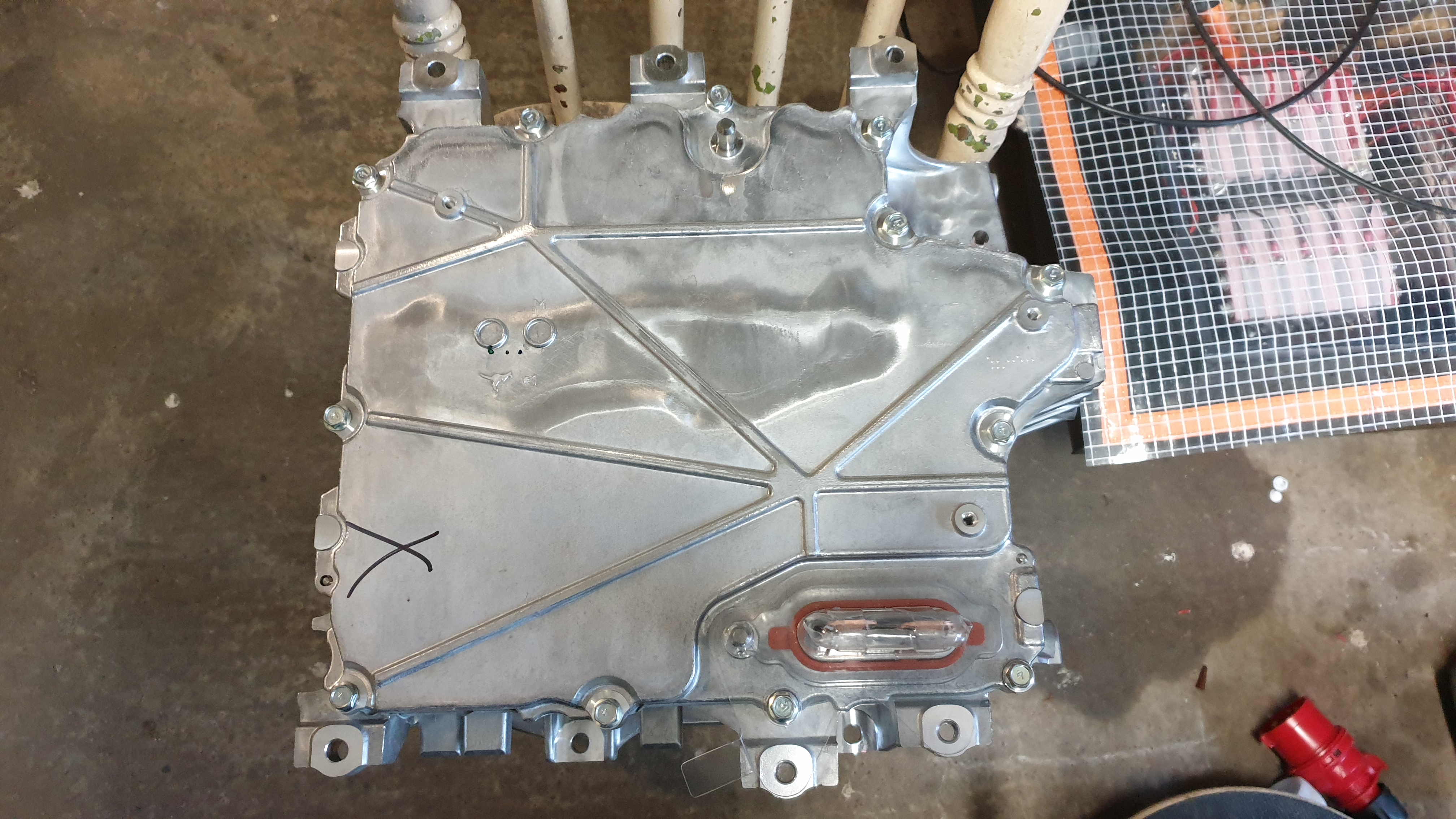

Is this inverter also with 800amp igbts?
I am wondering, is it the inverter or ecu that limits the motor to 110/130kw power?

Yes, this one: https://rocelec.widen.net/view/pdf/bt5e ... e&u=5oefqw
We will see how they tuned the desat (overload shutdown) as soon as somebody actually puts it in a car with a sufficient battery pack.

With an adequate cooling for both motor and inverter it should be possible to push this drivetrain to 300kw or more just using a plug in brain board, or 3rd party Vcu if the inverter doesn’t have factory limits, but I doubt that... should be a number of security fail safe option is place, I hope they are not so insane, like those used in Toyota inverters.
My drive train is coming from Japan by truck, another week to wait until I can dismantle it.

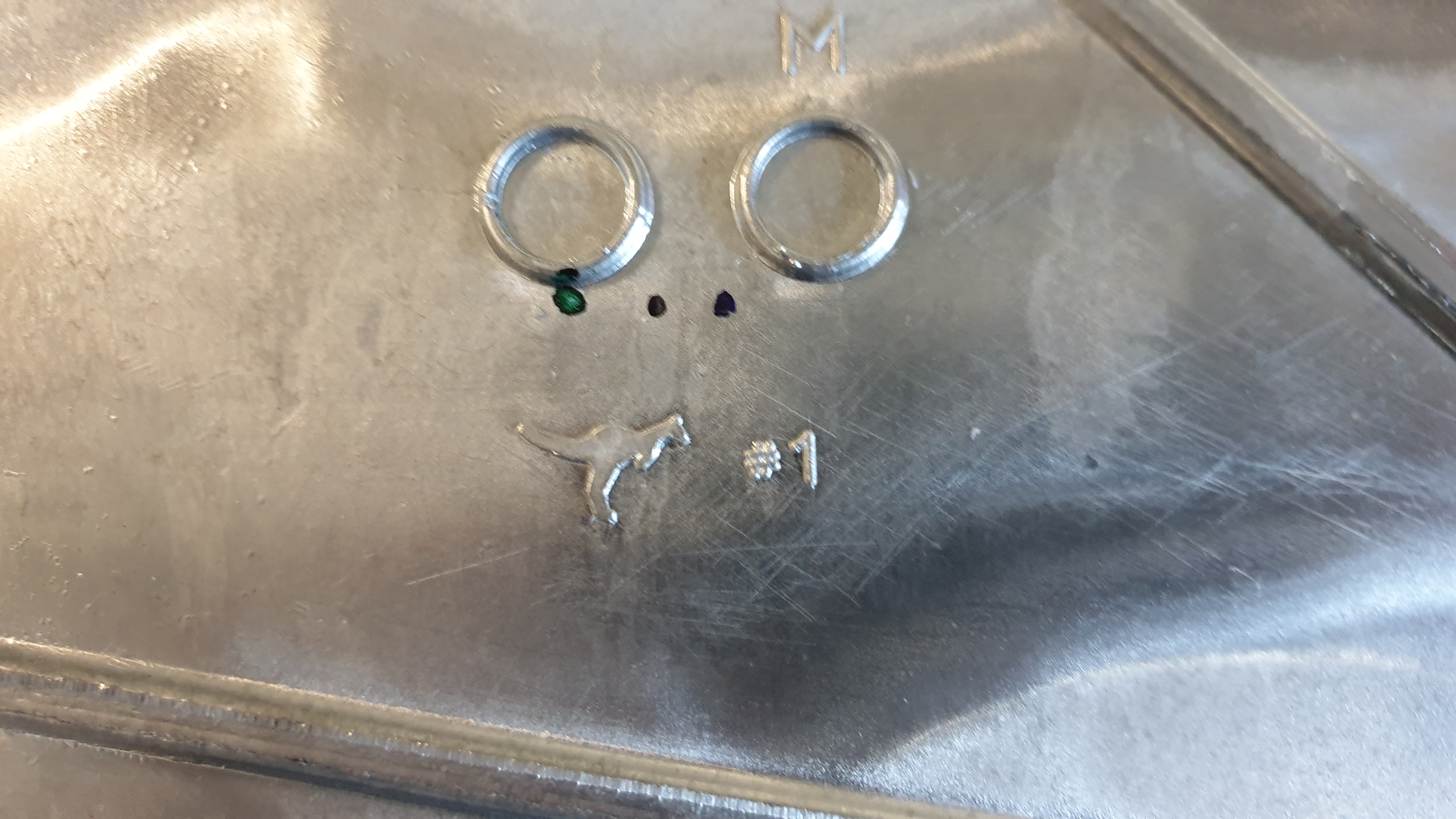

Just got a delivery of a gen 3 inverter. Mine has a kangaroo stamped into it for some reason...
Anyway, I'll be trying to run this via can so (assuming i am successful) will take measurements of the oem igbt drive signals to aid modboard development.

Re: Nissan Leaf Gen3 inverter
Mine is kangaroo #2
Same stamp on the Gen2

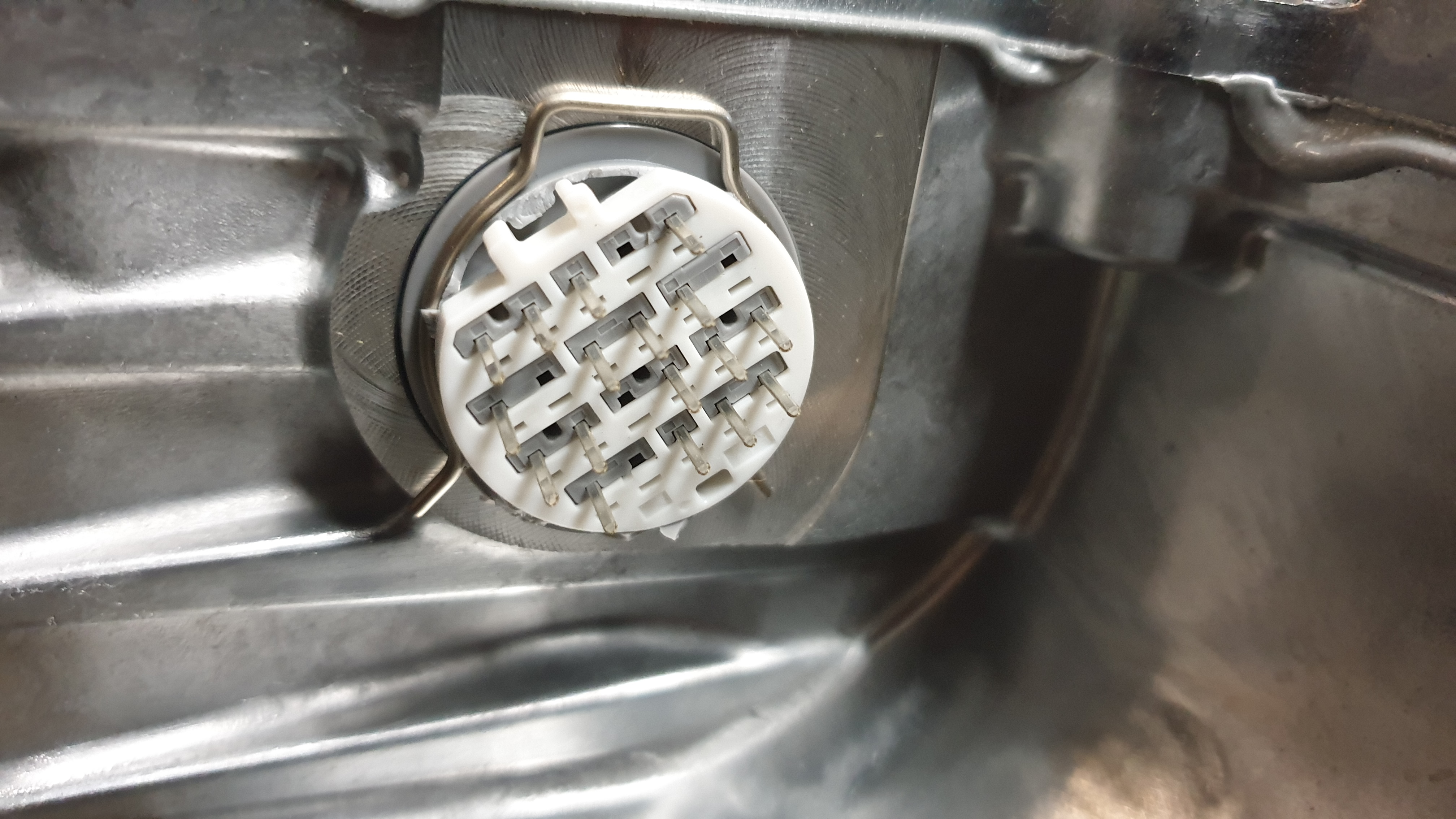

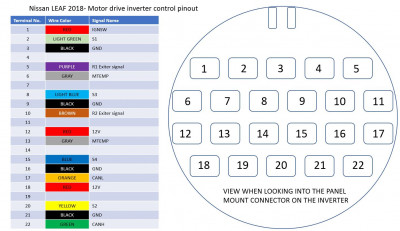

Sounds good. I have had the same intention after facing serious issues with running the motor with the V3 mainboard, just have not got around to it.
Anyway, here is the pinout as far as my reverse engineering is correct:

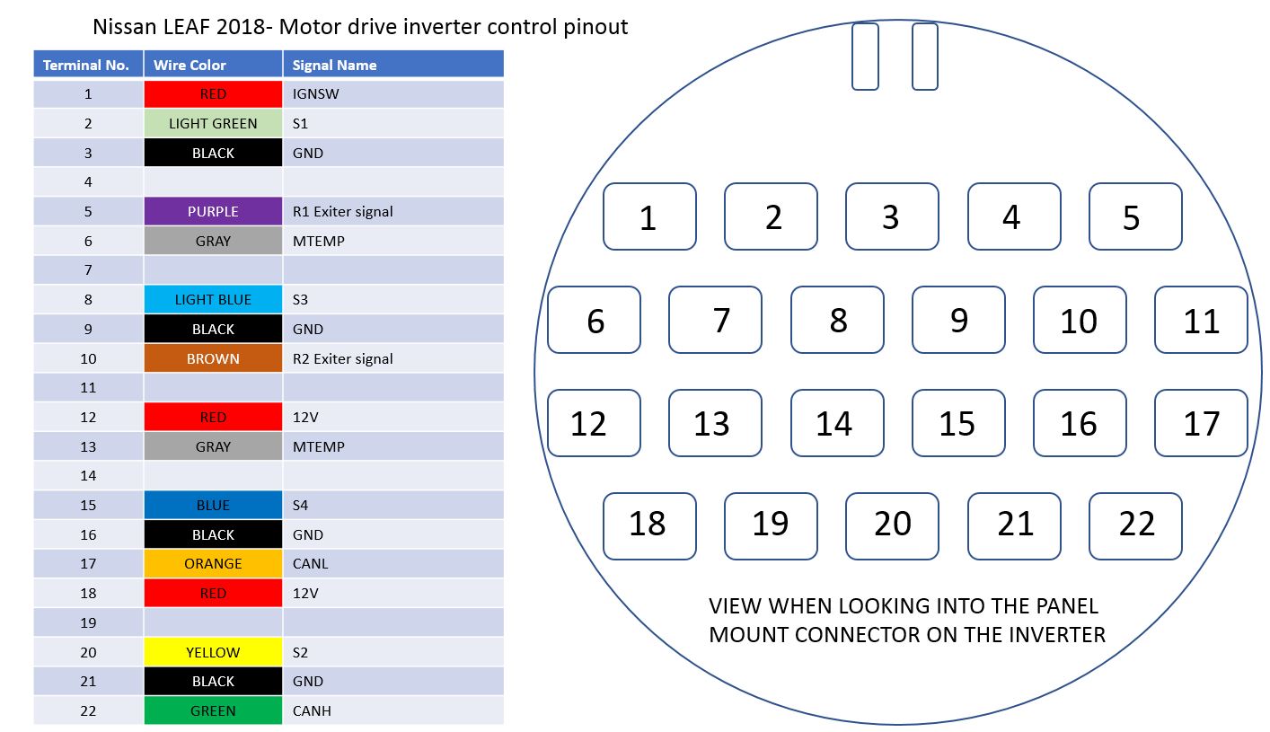

Cool. I grabbed a few bits from nissan tech info last night. Abomination of a website. Had to use windoze and ie11 to even register
Anyway I don't want to post the actual doc the forum just in case but here is the pinout :
1-12v battery pos
2-nc
3-resolver s2
4-gnd
5-can h
6-12v supply (ign?)
7-motor temp sense
8-nc
9-resolver s4
10-gnd
11-can l
12-coolant temp sensor
13-nc
14-resolver s3
15-coolant temp sense gnd
16-resolver r2
17-nc
18-power on power supply
19-resolver s1
20-motor temp sense gnd
21-nc
22-resolver s1
Nissan are notorious for mirroring the pins in their diagrams (don't ask how i know!) so I think your diagram is correct but nissan diagram is mirrored.

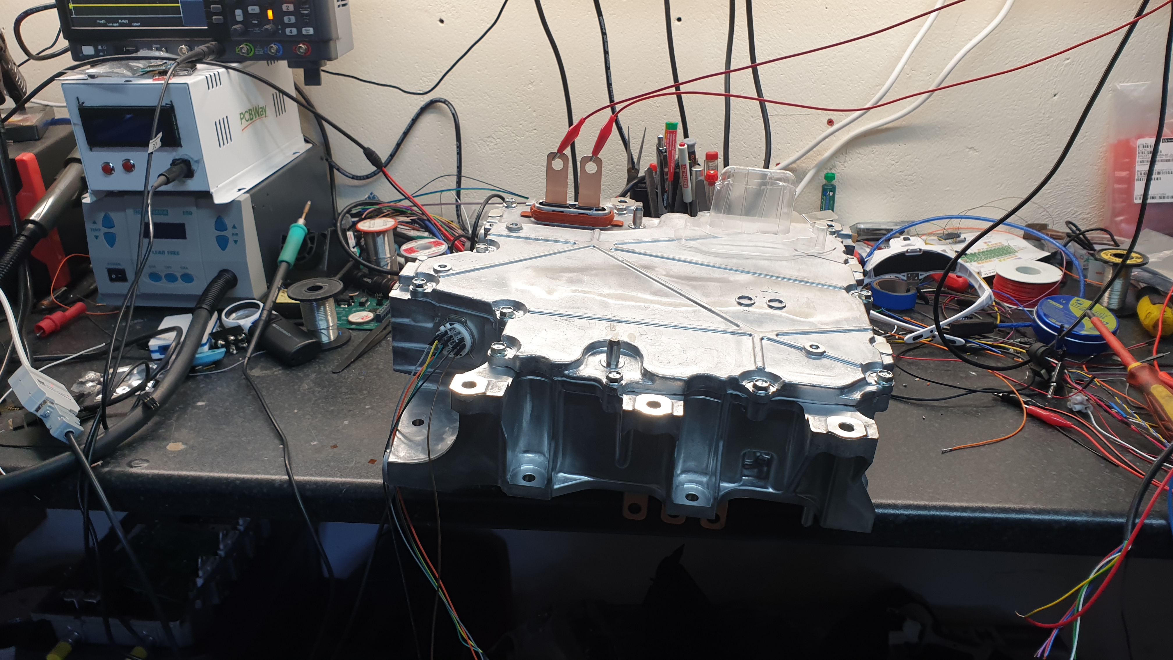

Got the gen3 inverter on the bench today and did a can log :
https://github.com/damienmaguire/Nissan ... 3/CAN_Logs
This dbc from Dala does decode some of the info:
https://github.com/dalathegreat/leaf_can_bus_messages

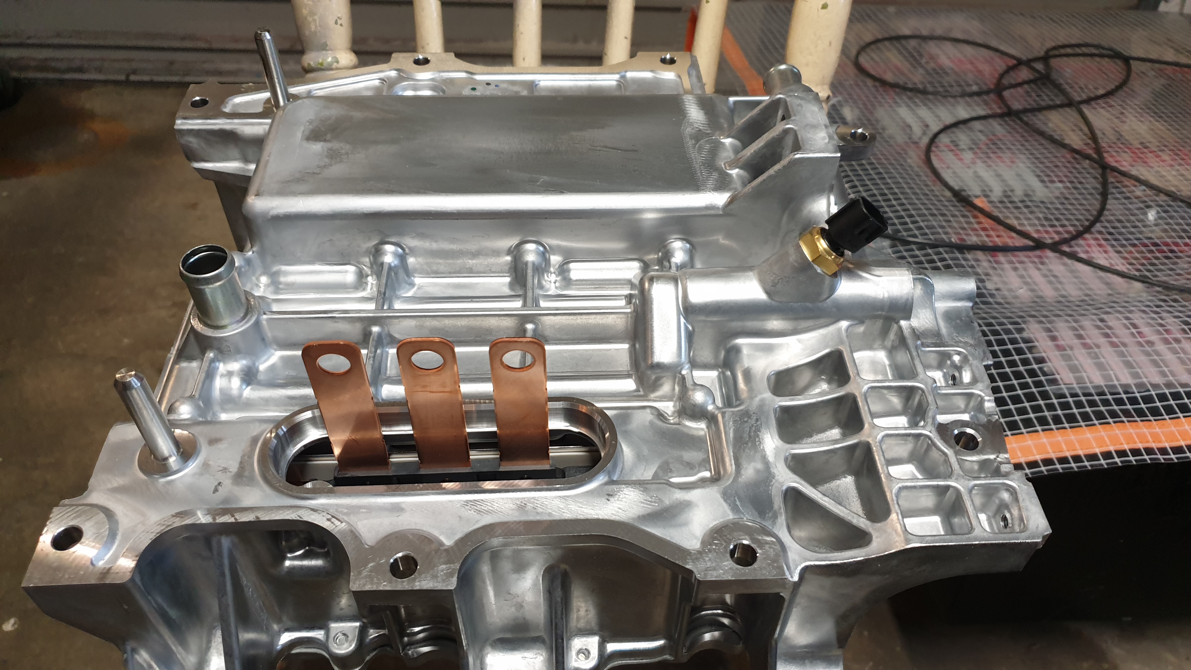

Interesting. The PDM looks electrically the same, but they've moved everything around including PCB locations and shapes. Maybe to make it a bit flatter?

Some good weather today to I went out to the shed. Powered up the inverter and supplied the DC bus with a humble 40V/5A power supply. Connected an asynchronous motor and spun it up in open loop mode to 20 Hz. That pretty much maxed out the supply but I can say at least that worked.
Next I'd have to find the resolver connectors for the Prius transaxle, use batteries as supply and then run the Prius motors back to back. I should also at least fill the inverter with coolant.

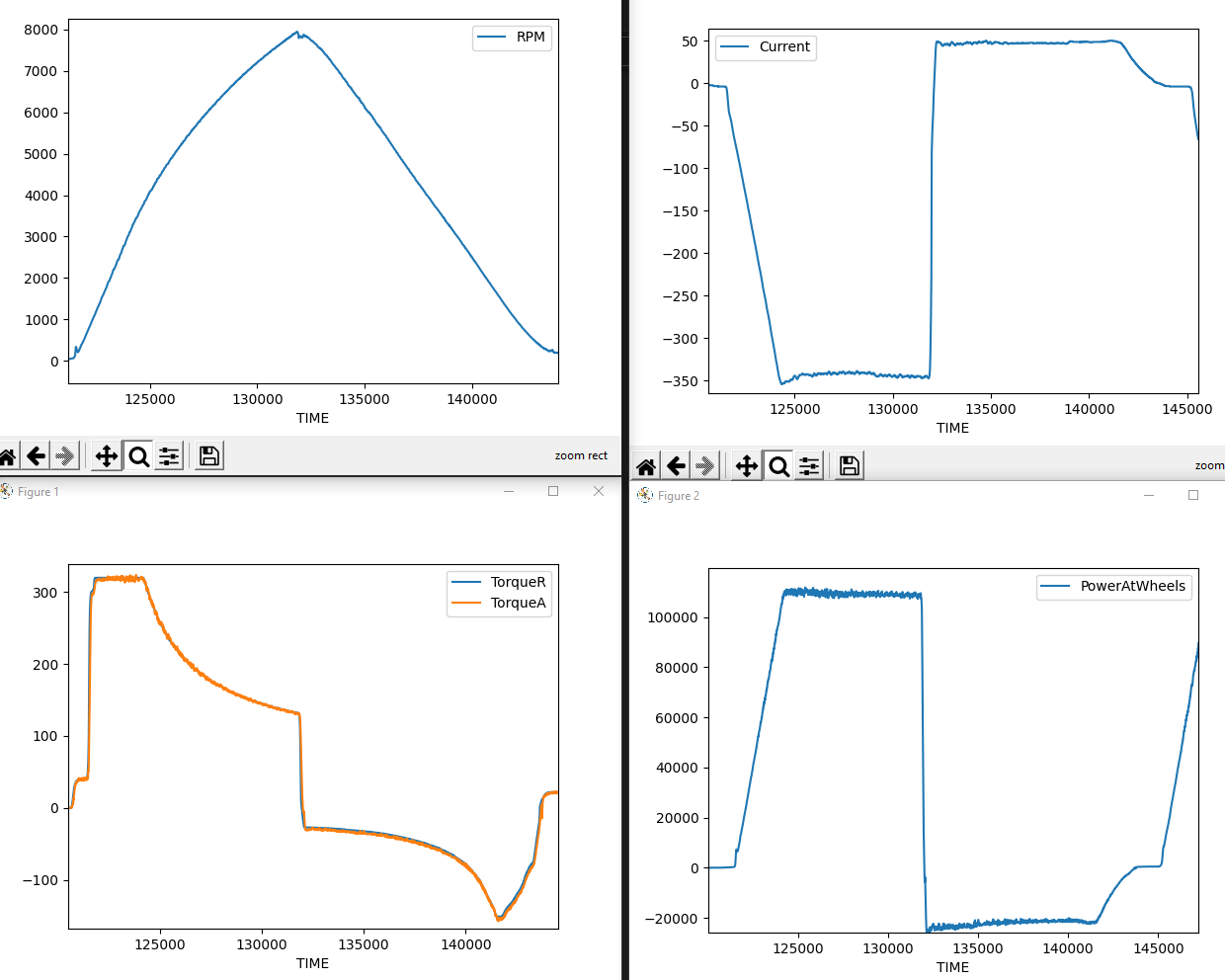

Got some more logs today of both AC and DC charging.
File size is too big for Github so just need to find an alternate. Any suggestions?
In the meantime, I plotted a nice acceleration to give a bit of an idea of what the torque/power output of this motor/inverter combo is. It seems torque limited up to about 3500rpm. Not sure what that is in vehicle speed yet, probably around 30mph.
Pretty consistent at 110kW output as rated, with approx 120kW draw on the battery.
