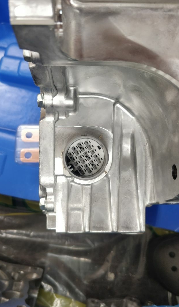

I recently bought an inverter (along with an accompanying M57 motor) with a circular connector. Any idea if this is the so called gen3 or something else? Model year is 2018 and it bolts right on the motor with the phase busbars connecting directly to the motor.
Is there a pinout for this floating around somewhere?
Also, any idea if the CAN db is the same as for the more common inverter version with the rectangle connector?
I would like to start by trying the control of the OEM control board via CAN before hacking inside.
Any help is much appreciated. Thanks in advance!

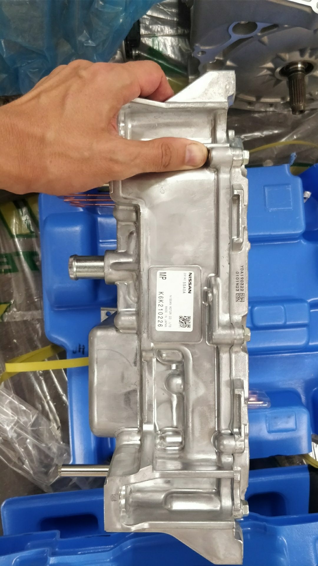

Photo's of the inverter and any labels would help identify the parts.

Re: Nissan Leaf inverters Gen3?
That sure looks like a Leaf inverter with a weird connector. I guess it must be gen 3.
Looks like they dropped the connector Toyota uses and switched to one from the round connector series they've been using in the PDM for all this time.
Interesting. Will you open it? Would be cool to have a drop-in board for that as well

291A0-5SA1A is from the 2018-19 Leaf (see here)

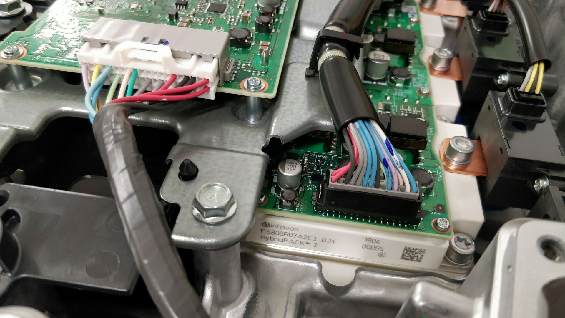

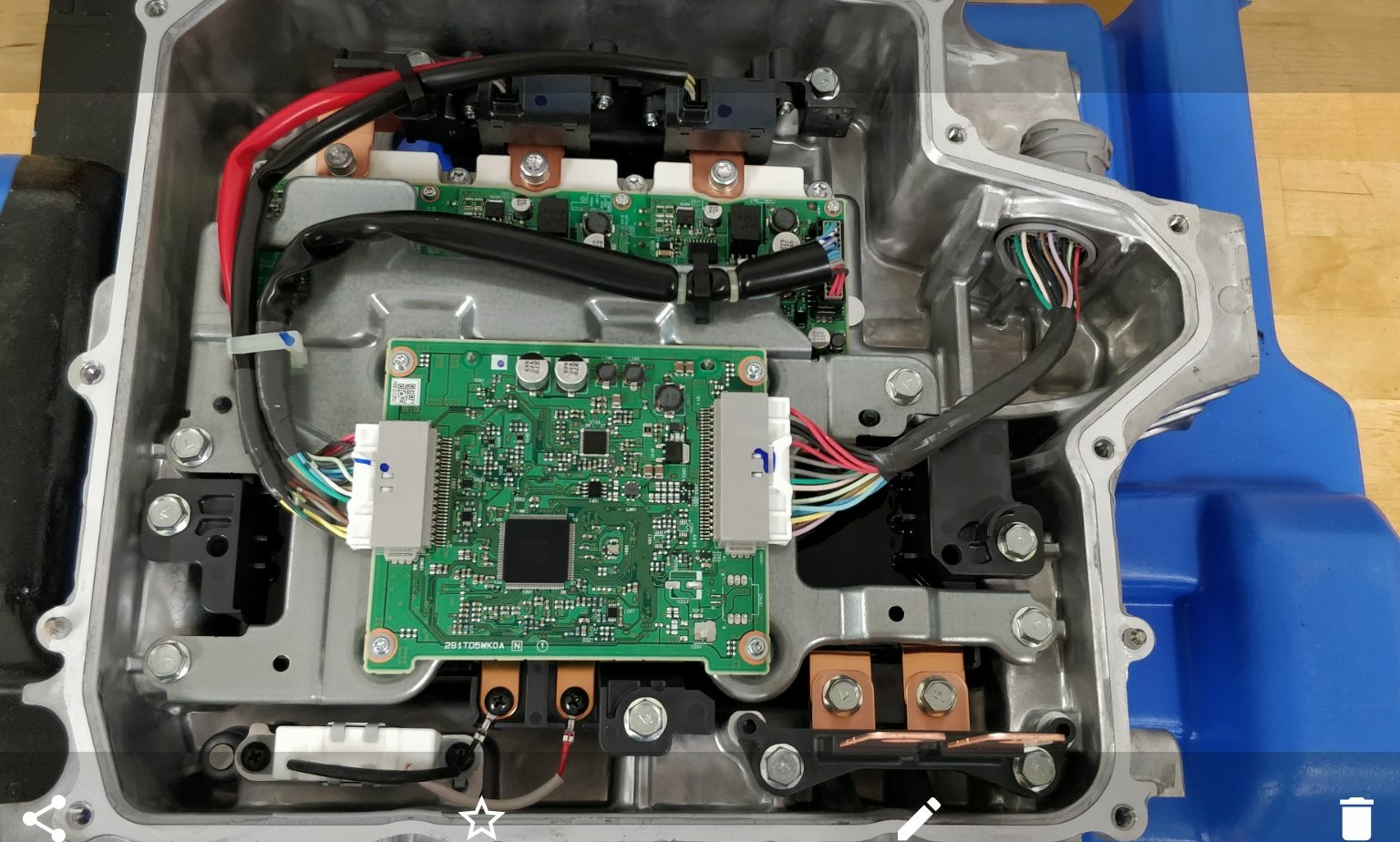

Here you go! I popped it open and took a few pictures.
Looks like a DIY-friendly assembly to me.
Just let me know what you need.

Very neat. 650V/800A IGBTs. Otherwise I see 2 current sensors, I assume 5V models as earlier. For designing an adapter board I'd need an inverter on the table. Unless you want to do it using the Gen2 adapter board as a template
EDIT: relevant signals on the inverter side are
- 6 PWM channels
- 2 currents (easy)
- Bus voltage
- Heatsink temperature
- Fault signals
To the outside world you mainly need to find the 6 resolver wires, motor temperature, CAN and power supply.
Would the adapter board with V3 mainboard on top physically fit inside the enclosure?

Wow they really redesigned the entire thing. Looks simpler, cheaper to manufacture and more repairable.

Cool, it looks simpler. Allmost like ready to take a openinverter board. Nice IGBTs

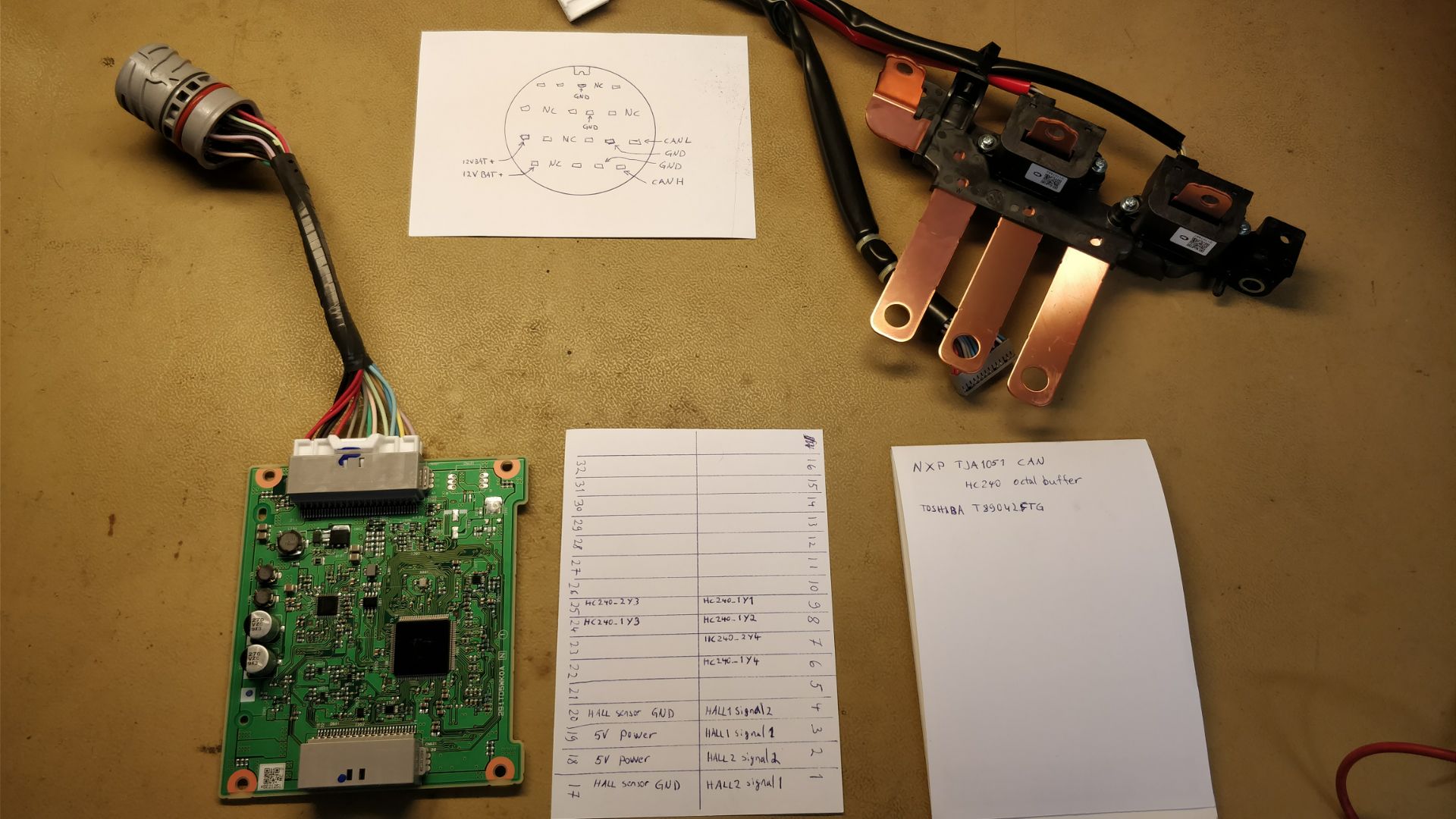

First session of reverse engineering done tonight.
I am quite confident about the current sensor pins.
There is a HC240 octal buffer with 6 channels occupied and two left NC. I assume these are the IGBT control signals. I will try to track the wires down to the driver board next and figure out the specific channel allocation along with what is Hi and Lo.
Quite difficult to find the IGNSW at the VCU connector.

Re: Nissan Leaf Gen3 inverter
I have not been able to put so much hours on this so the progress has been slow. Anyway, there is progress!
I was able to reverse engineer everything needed, except the IGBT temperature.
There are three isolation amplifiers on the IGBT drive board and one of them is measuring the DC-link voltage. When measuring from the control board interface connector, the ratio is 122V/V.
I have not figured out what the second one is meant for.
The third connects to the middle IGBT NTC. The problem is that I have not found where the temperature is routed on the interface connector.
There are three unknown pins left on the interface connector.
One seems to be high impedance and floats at 0V.
The two others seem to have a weak pullup to 5V.
I have not yet heated the board to see If the voltage starts to drop.
I just thought that at room temperature the voltage would not sit so high...

Good work!Kelju wrote: ↑Thu Sep 10, 2020 6:53 pm I have not figured out what the second one is meant for.
Your NTC might go into some comparator chip and run to drivers as a digital Fault pin?
Also high impedance pin is usually used for Fault pin as a failsafe input. In case of normal operation fault transistor would pull this down and grab it. When fault would happen transistor would release and signal would float even in the case of main uC brownout.

Gen2 has IGBT temperature as PWM signal

When placing the V3 board upside down, 1.75mm of clearance is left between the pins and the cover.
The distance between the V3 board PCB surface and the cover will be 3.15mm. This will not be enough to fit the four fixing crews to the corners of the V3 board.
So here comes the final outcome of the analysis and probably the way forward to choose.
The V3 board will be placed upside down on the adapter with the pin header and the receptacle lifting the V3 PCB bottom surface to 11mm.
This gives a total height of 11mm+1.6mm+1.4mm=14mm and a clearance of 1.15mm to the top cover of the housing. No fixing screws are needed as some elastic gap spacer like a piece of poron can be applied on the V3 board.
I measered 14mm clearance from the original PCB top surface to the housing top cover fixing flange surface. On the top cover inner surface there is a lot of casting texture/features to make the part rigid. I measured the distance between the lowest extensions of the cover and the flange surface with a clearance gauge and found that there is an additional 1.15mm of clearance.
This all means that I have a total of 15.15mm to play with.
- Posts: 6735
- Has thanked: 378 times
- Been thanked: 1559 times
Yes that sounds good, can't spot errors on your calculation.
