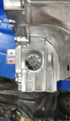

I recently bought an inverter (along with an accompanying M57 motor) with a circular connector. Any idea if this is the so called gen3 or something else? Model year is 2018 and it bolts right on the motor with the phase busbars connecting directly to the motor.
Is there a pinout for this floating around somewhere?
Also, any idea if the CAN db is the same as for the more common inverter version with the rectangle connector?
I would like to start by trying the control of the OEM control board via CAN before hacking inside.
Any help is much appreciated. Thanks in advance!

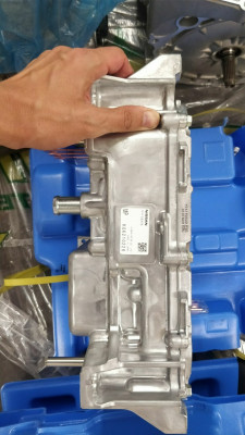

Re: Nissan Leaf inverters Gen3?
Here you can see the label on the Part and how the connector looks.
- celeron55
- Posts: 804
- Has thanked: 38 times
- Been thanked: 136 times
That sure looks like a Leaf inverter with a weird connector. I guess it must be gen 3.
Looks like they dropped the connector Toyota uses and switched to one from the round connector series they've been using in the PDM for all this time.

291A0-5SA1A is from the 2018-19 Leaf (see here)

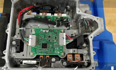

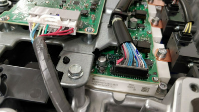

Here you go! I popped it open and took a few pictures.
Looks like a DIY-friendly assembly to me.
Just let me know what you need.
- Posts: 6772
- Has thanked: 385 times
- Been thanked: 1594 times
Very neat. 650V/800A IGBTs. Otherwise I see 2 current sensors, I assume 5V models as earlier. For designing an adapter board I'd need an inverter on the table. Unless you want to do it using the Gen2 adapter board as a template

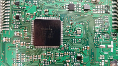

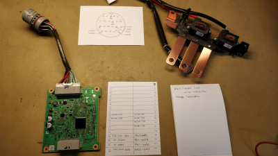

First session of reverse engineering done tonight.
I am quite confident about the current sensor pins.
There is a HC240 octal buffer with 6 channels occupied and two left NC. I assume these are the IGBT control signals. I will try to track the wires down to the driver board next and figure out the specific channel allocation along with what is Hi and Lo.
Quite difficult to find the IGNSW at the VCU connector.
