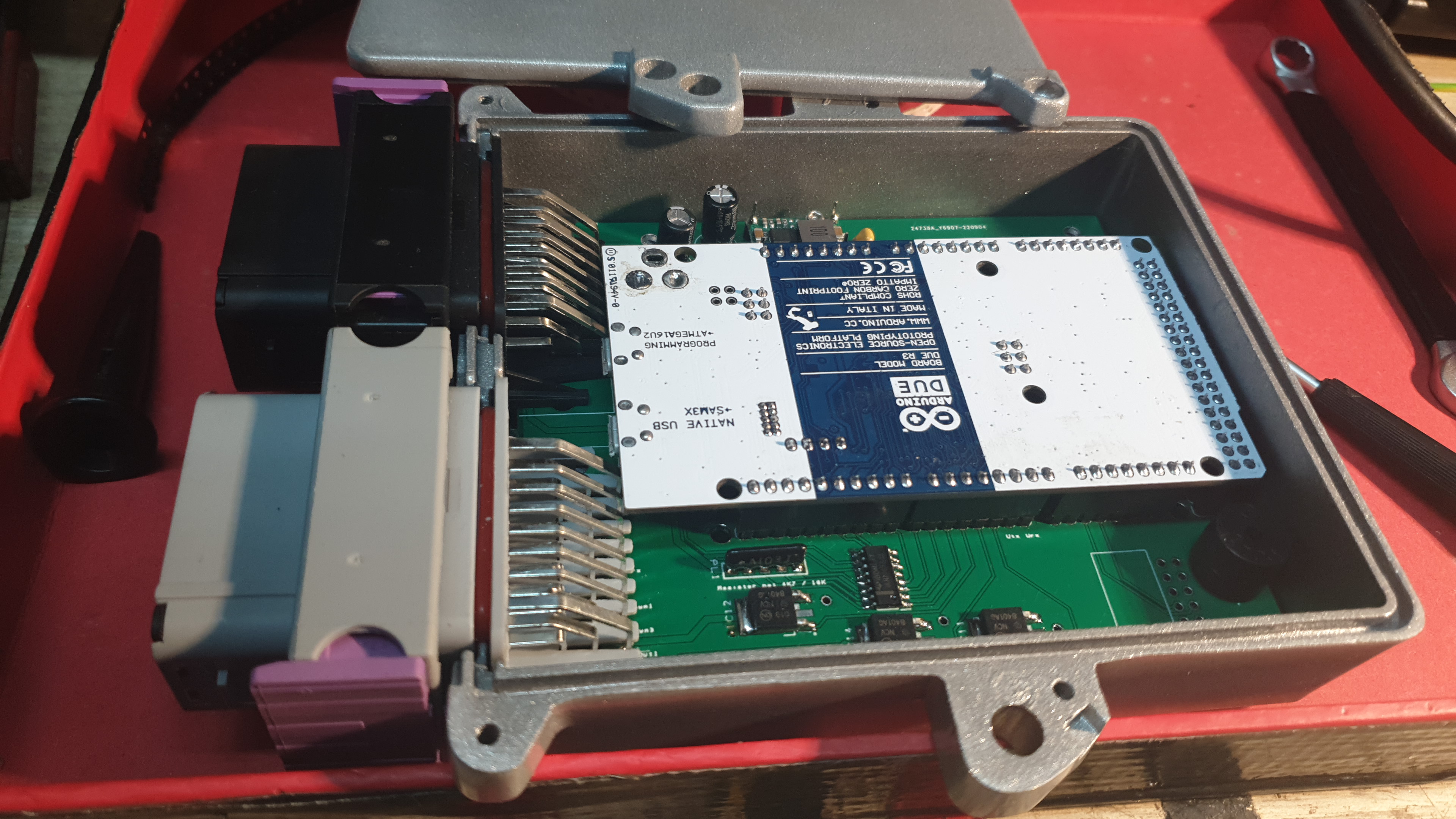

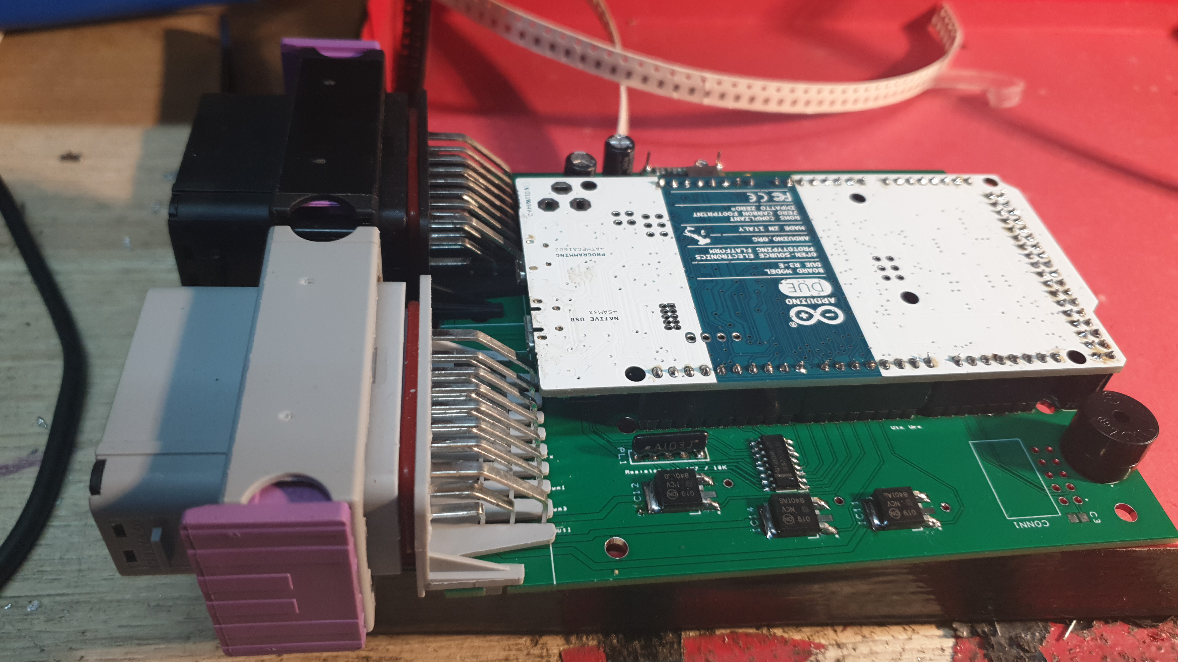

PaulUdrea wrote: Sat Oct 29, 2022 11:14 pm Hello Arber, great work. Do you intend to sell the controller? From what I read, it should be useful for my conversion. I am at the stage of selecting a charger and a BMS. Finally I’ve got the batteries, Kokam 75Ah (used). Before purchasing the BMS and the charger I want to make sure that all the equipment will work with each other. I would be interested to know if it will be available for purchase.
Well yes i can offer it for sale when i have tested it thoroughly. I intend to use it primarily as Chademo controler as well as a separate BMS control similar to SimpBMS. Price will have to be low, near the 130€s since the ESP32 low value. I hope i can manage that.
For now all components are setup for hand assembly as is my phylosophy.
I dont want to fit ESP32 chip directly on to the board since this can create all sorts of headaches with ground loops and wifi etc...
This board for now drives only one CAN transciever. I consider it enough for now. Later i will add another SPI if need be, but i see quite a lot of development to do that. For now the code itself is enough of a challenge :).
My BMS plan includes those active JKBMS modules and its 250kbaud CAN output to make a complete system. Zero user involvment into BMS while battery is working properly and very simple UI via WIfI or BT to identify individual cells gone astray. Or just to observe situation.
Buzzer is there to provide audial warning in various cases.
I intend to make use of a simple BMS pulldown pin which would signal stop of (fast) charge and turttle mode in case of low battery.
Will see how that goes... hopefully i will have enough time theese days to develop the code for my VCU to read BMS report. From then on i can learn myself some html programming :).
Or i can make a BT app? What do you think would be more convenient?

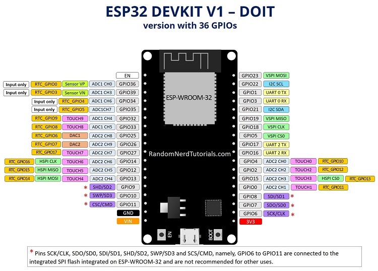

ESP32 VCU with analog and CAN control
arber333 wrote: Mon Dec 12, 2022 8:33 pm Ah ok... i didnt setup any analog channel to measure 12V level. I will hardwire it to next VCU revision.
I tested ESP32 12V signal sensing on one of my analog inputs. Rather cubersome, using throttle input for that but it works :).
On the more important note i managed to setup watchdog function so it does not reset the chip every so often...
CAN bus signaling works within function now. I had to use flags as conditionals do not work with yet undeclared parameters (can values).
VCU would read Mitsubishi charger/DCDC aux voltage from CAN and decide to start it up if it drops too low. On the charge side VCU would read HV voltage and stop charger from going too high. There are AC compressor and heater functions too.
Tesla DCDC CAN signal i tested too.
Eltek charger commands.
I think it is time to publish the details :).
Links to schematic and design are in github
https://github.com/arber333/ESP32-VCU
VCU pinout.pdf
(288.11 KiB) Downloaded 462 times

arber333 wrote: Fri Feb 24, 2023 8:39 am Huh i would love to, but i never made schematic :(
Ok, did you find datasheet of the casing and dimensions for pcb? And did board fit nicely to connector and case fixing holes?
Posts: 3795
Been thanked: 411 times
Re: Arduino DUE VCU with analog and CAN control
evMacGyver wrote: Mon Feb 27, 2023 7:24 am Ok, did you find datasheet of the casing and dimensions for pcb? And did board fit nicely to connector and case fixing holes?
Well my design is on the github https://github.com/arber333/Arduino-DUE-VCU
I will add schematic later this week.
Photos of my built example. It just clears theconnector pins and casing.
