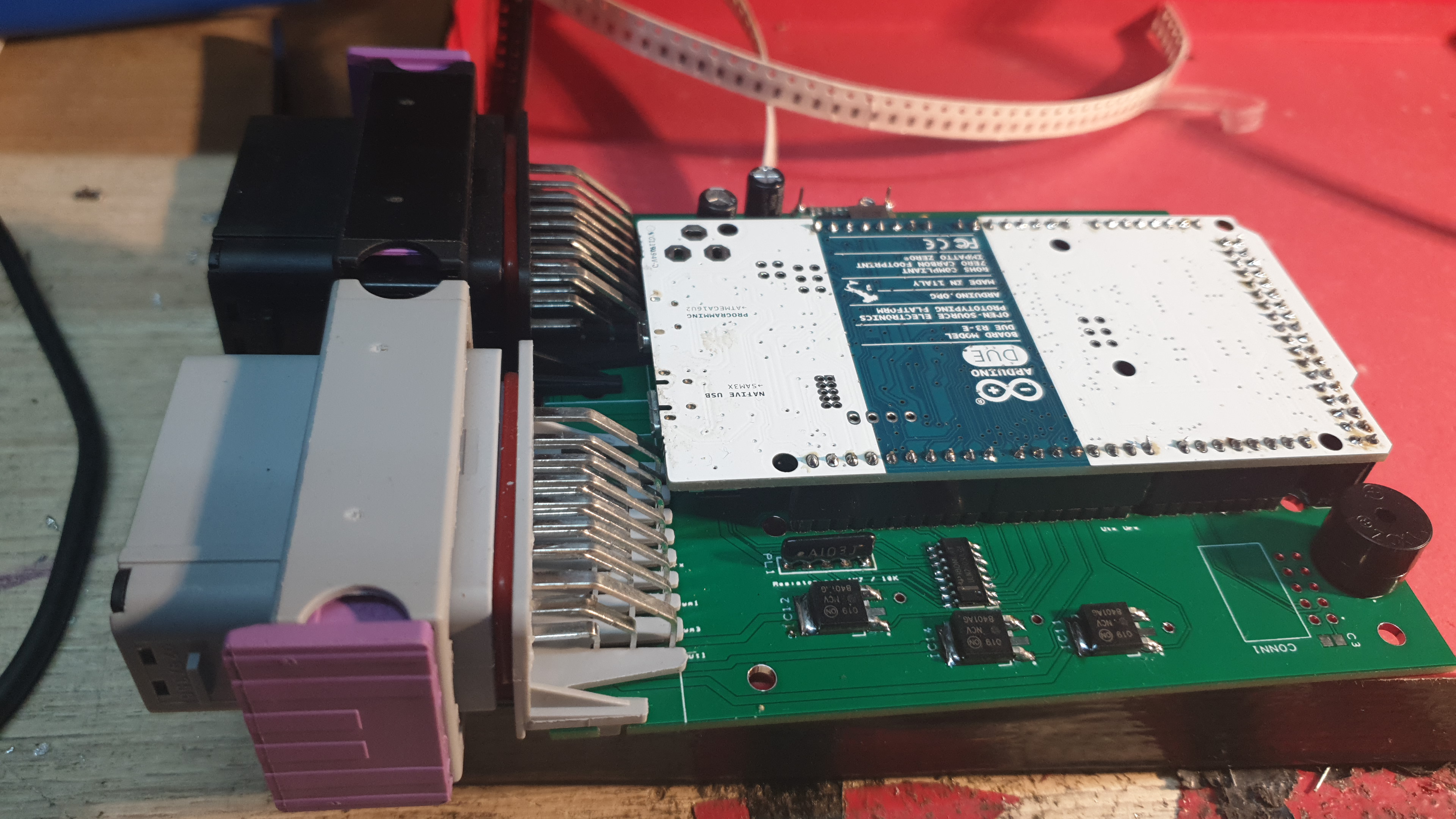

I am posting here so not to clutter the original Chademo VCU thread
I cant get the ISA shunt just yet and in my EV it is a bit redundant because i already have SOC and Voltage measurement/display in a closed system.
What i need is a capable conventional charger controler with CAN bus and chademo charging capability.
Isaac, what if i used an ISO124P opamp with isolated supply and feed its signal to VCU on throttle input? I think this would be a linear input easily setup in a code. Would you be willing to input that possibility in your code? If Throttle would be pulled to GND priority would go to ISA shunt and data through CAN bus whereas if there would be voltage on throttle line you could use it to determine HV voltage. Since current is not so important we could get by with only voltage? Or i can still make a use of 5V LEM sensor with another input?
I am thinking of using chademo VCU as AC charger and DCDC controler also and i need to know inputs that i could use.

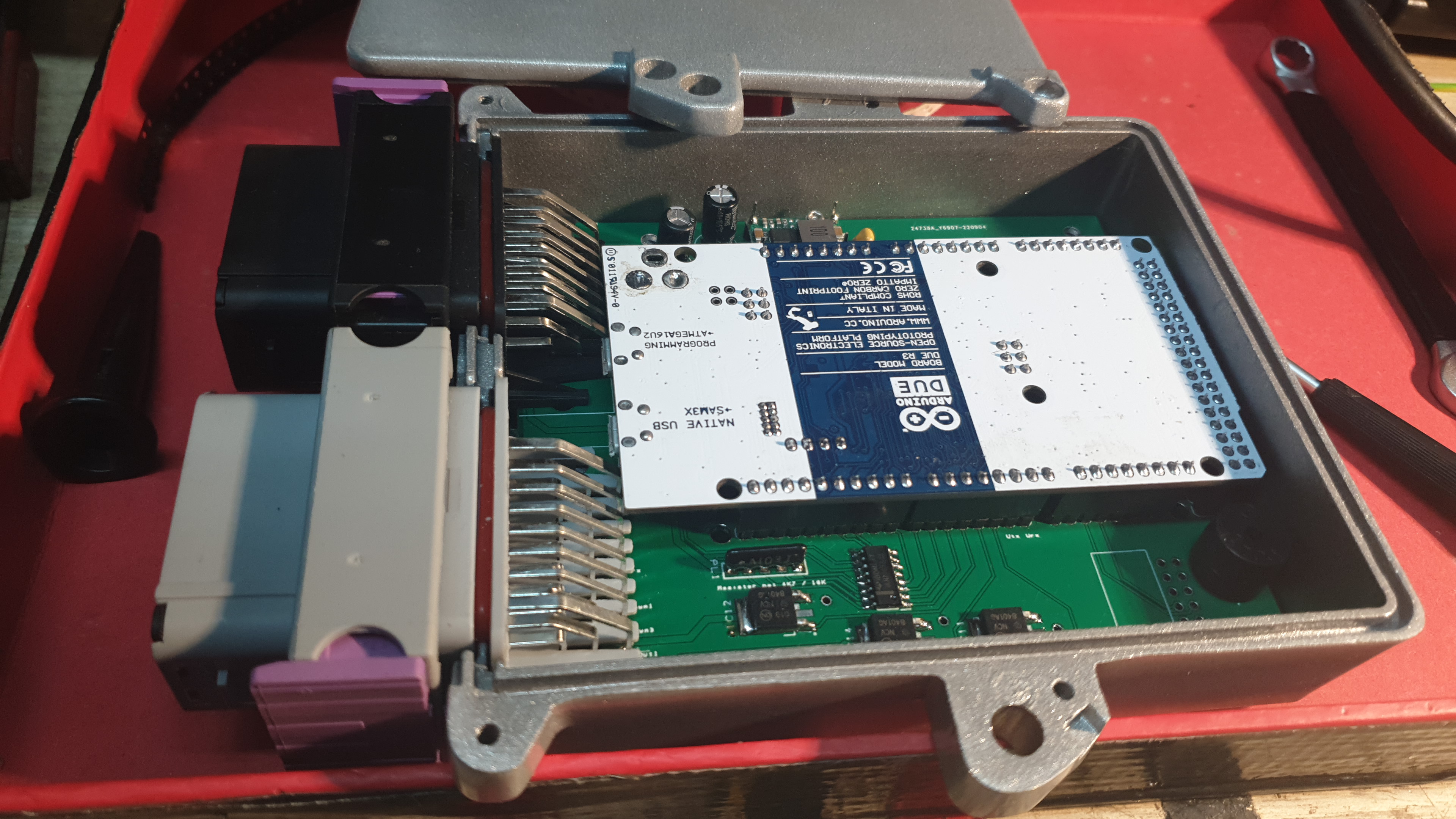

I am revisiting this thread since i have built a VCU shield for Arduino Due. A form of control unit which is capable of running several digital/analog inputs vs CAN and digital or PWM outputs. Such VCU is good for experimenting with CAN systems and integrating them together.
In my case i intend to use it to drive Outlander motor, inverter, charger, DCDC and heater with one board.
Untill now i have 4 revisions, while i am actively using rev3 in my Pug.
Main points with latest V4.1.
I have corrected the issue with CAN chip 3V3 power supply.
I added B2P-VH header for CAN1 output which is more robust header. It will hold 3.96mm pitch connectors with wires up to 1mm2.
I have routed 12V power to relay contacts and provided solder points to connect either to GND or 12V. Also i power relais with 12V. This releases poor Arduino 5V regulator which had difficulties to cope with increased demand from 5V relay.
I added 3 mosfets to PWM outputs and connected them to 12V. So now i can directly connect PWM signal to drive chargers, DCDCs or car fans with that signal.
I also eliminated position for 12V regulator as a diode can perform some voltage aleviation as long as we use ordinary 3A diode. Pleaase let me know if someone has other suggestion.
I will update design with rev. 4.1 and post it on github opensource here: https://github.com/arber333/Arduino-Due-CAN-shield

IC8 chip is the ULN2003 darlington driver which is there to drive relays and amplify several digital outputs. It was not meant to drive hardware PWM since it is only NPN drive, but you could use it with suitable 12V pullup and generating software PWM.
My idea was to use hardware PWM ports since they run on interrupts.
And darlington is not very good at amplifying square signal. Mosfet is much better at that. I choose SOT23 chips because you can use Nchannel or Pchannel mosfets and it will just change PWM polarity.
I corrected some typos that happened to 4.1 version. I will not make another version. I will just repost the new one.
I am also thinking of making another shield to be put on top of the first one which would add LIN bus or SW CAN functionality. But would sacrifice CAN1 for that. It could add additional digital inputs and outputs to be used. Any ideas?
EDIT: does anyone know how to reliably read PWM duty? I mean directly on DUE chip.

Let me tell more about the board.
I must say i solved the problem with DUE 5V regulator brownout. I simply wired everything important to 12V plain with 3V3 and 5V remaining for logic and AD sensing only. I learned to use flags and state machine with it and it still has way more capacity CAN wise.
I setup current V4 to also serve as chademo interface triggering relais with UL2008 chip pins.
There are 3x analog input interfaces setup. One is meant for throttle, second for regen signal and last one is simply input and GND.
There are 4x Nmos transistors wired to PWM pins. They are meant for signalling PWM to a charger and other systems in a car. It is widely used control to drive pumps and fans.
A single PWM pin is reserved for input and that has its own transistor to amplify a CP signal and read it directly on DUE.
There are serial pins available for connection as well as I2C pins.
Of course EEPROM chip spot is available.
2x CAN bus transcievers
Also there is still a lot of digital pins available at the rear end of the board. I could make an addon board that would express more of digital I/Os for various applications.
- Posts: 3572
- Has thanked: 134 times
- Been thanked: 339 times
Arduino DUE VCU with analog and CAN control
OK! I have tested the board with PWM signal to Volt gen2 DCDC and it works! I tested it with PWM to D6 pin from a library here https://github.com/arber333/DuePWM
I also tested other pins.
I will probably make another 4.2 mod, which will be final revision as i see from the library shield works with pins from D2 to D6. Library only works from D6 to D13. So i will have to change my PWM signals more towards higher pins.
As i have several other PWM pins wired to transistors they should be used with different library.

This shield uses ULN2008 chip with 7 transistors. Two are used for Cp relay and Enable relay which can each drive 2 devices each. Onboard there is also connector with 5 pins. Each pin can sink 0.5A for driving relays etc... So you can decide how to drive those. You could also pair up those pins for 1A capacity.900 wrote: ↑Mon Oct 04, 2021 7:57 amHi, I am very interested in it's use as a VCU to control an inverter and also to control 3 sets of contactors - precharge and main contactors and another contactor to send HV to dcdc converter when ignition is turned on. I plan to trigger contactor closing off certain CAN messages that comes in. Do I need 3 relays on the shield for that do you think? For contactor control I would have contactor signal positive always wired to 12 V and I would be switching grounds on with relays on your shield. Does this sound right?Those relays are now controlled off 12 V volt directly right?
Also i built in two relays so you can choose to connect 12V or GND to relay common contact in order to have different options.
