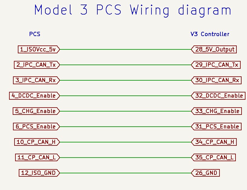

Put this magical document together by using information from posts, my last post had CANbus wires on 34 & 35 mixed up. Attached original V3 document from Damien's repository.
Using a North American 2018 Early released charger, and it's not functional using V3 board.
PCS_Controller_V3Pinout.pdf- (24.54 KiB) Downloaded 239 times
Book2.pdf- (171.8 KiB) Downloaded 280 times

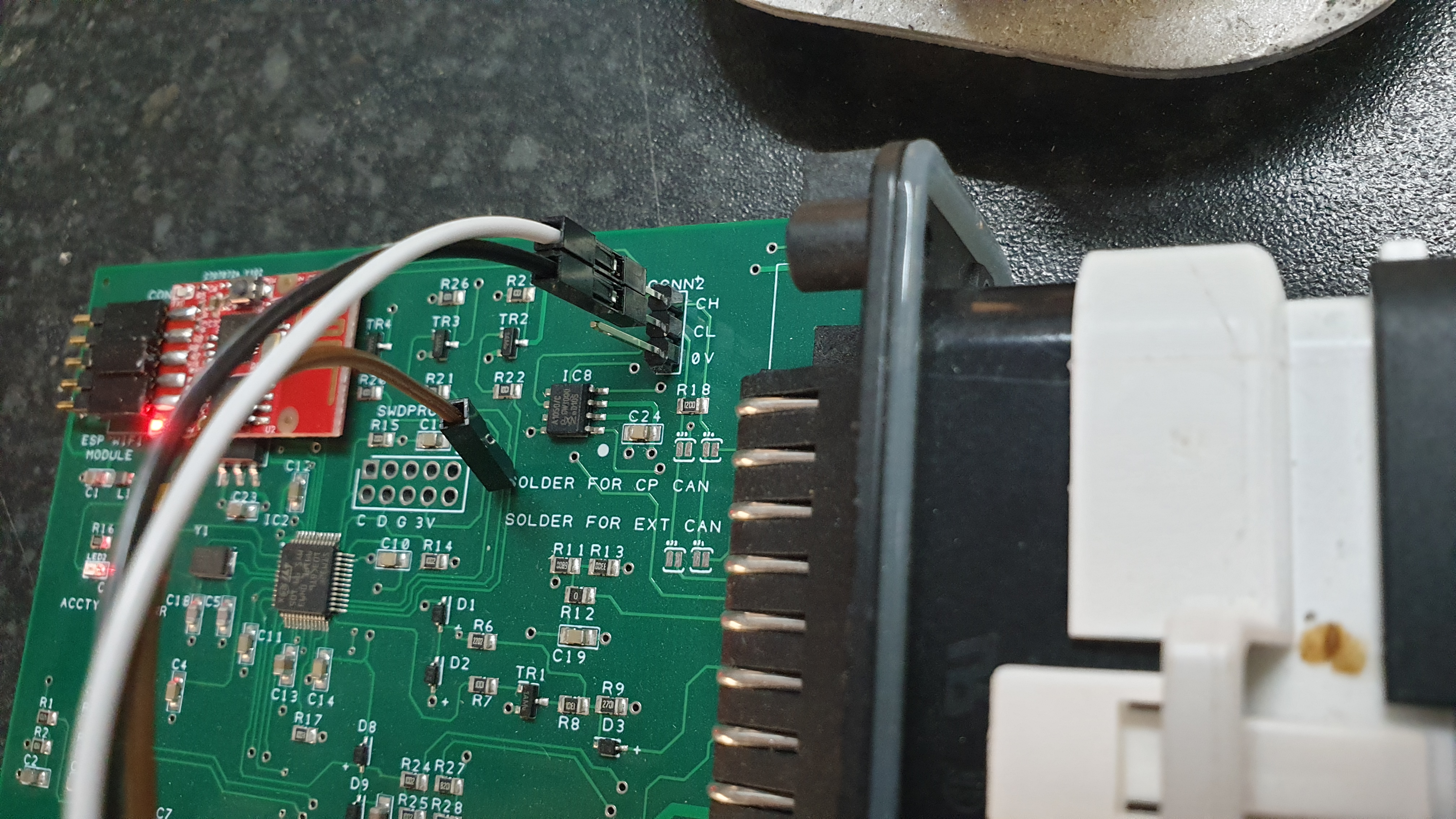

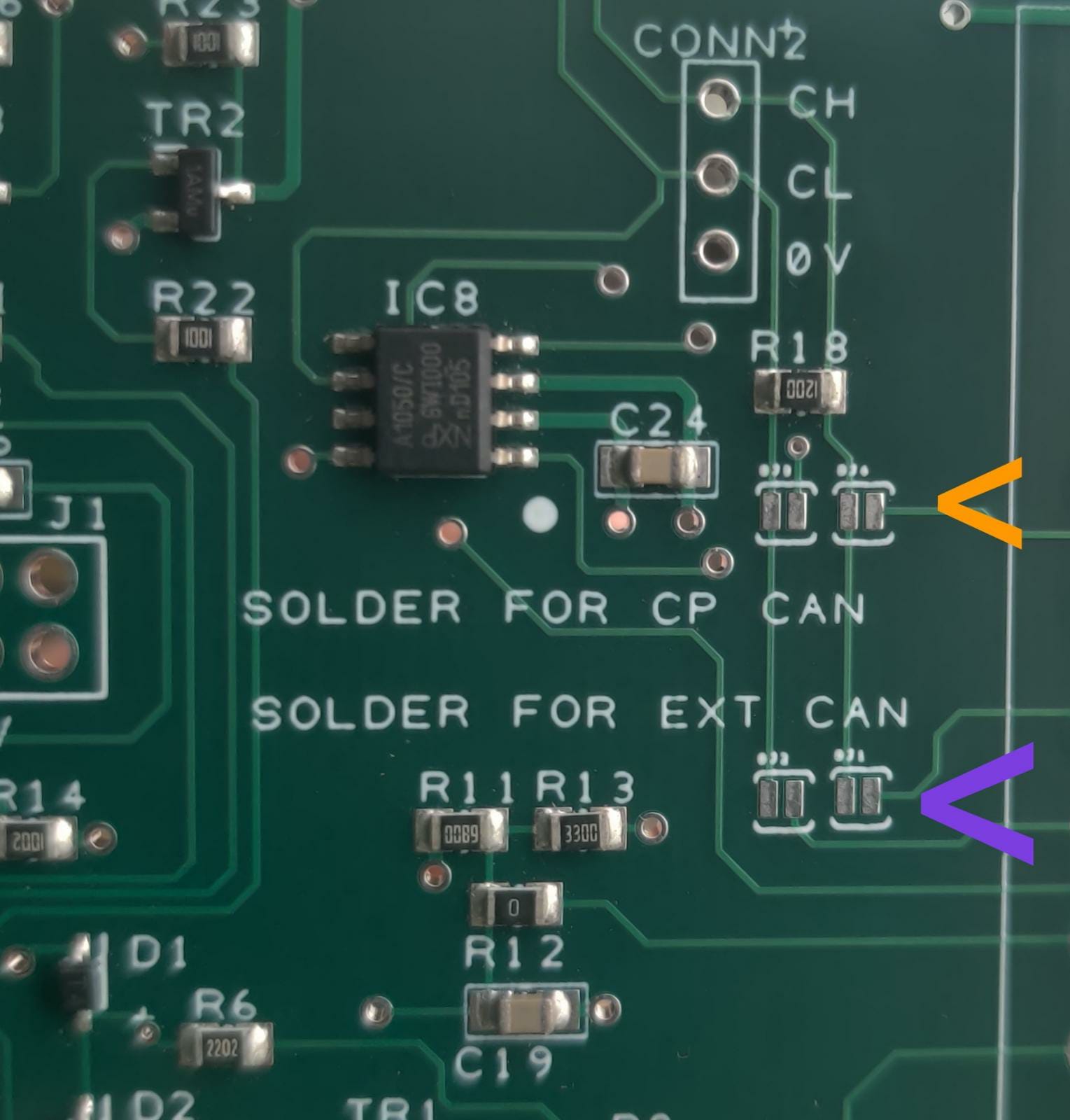

Before shipping, quick question about the 4 double Rabbit Teeth that are by this writing, please explain this process as its not in the other versions.
SOLDER FOR CP CAN
SOLDER FOR EXT CAN
Also on this charger we can set the maximum charge voltage, but was expecting to tell it how many cells we have in series, how many amps per cell, but I don't see this type of parameter. Would like to tell it the size of our battery pack.
SOLDER FOR CP CAN
SOLDER FOR EXT CAN

I have a Model 3 PCS on the bench, PM an address and will gladly ship out.Jack Bauer wrote: ↑Thu Jul 28, 2022 7:53 am I have offered to anyone with a non working pcs and controller to send it over to me here in Ireland
Looking forward to having the charger saga operational.

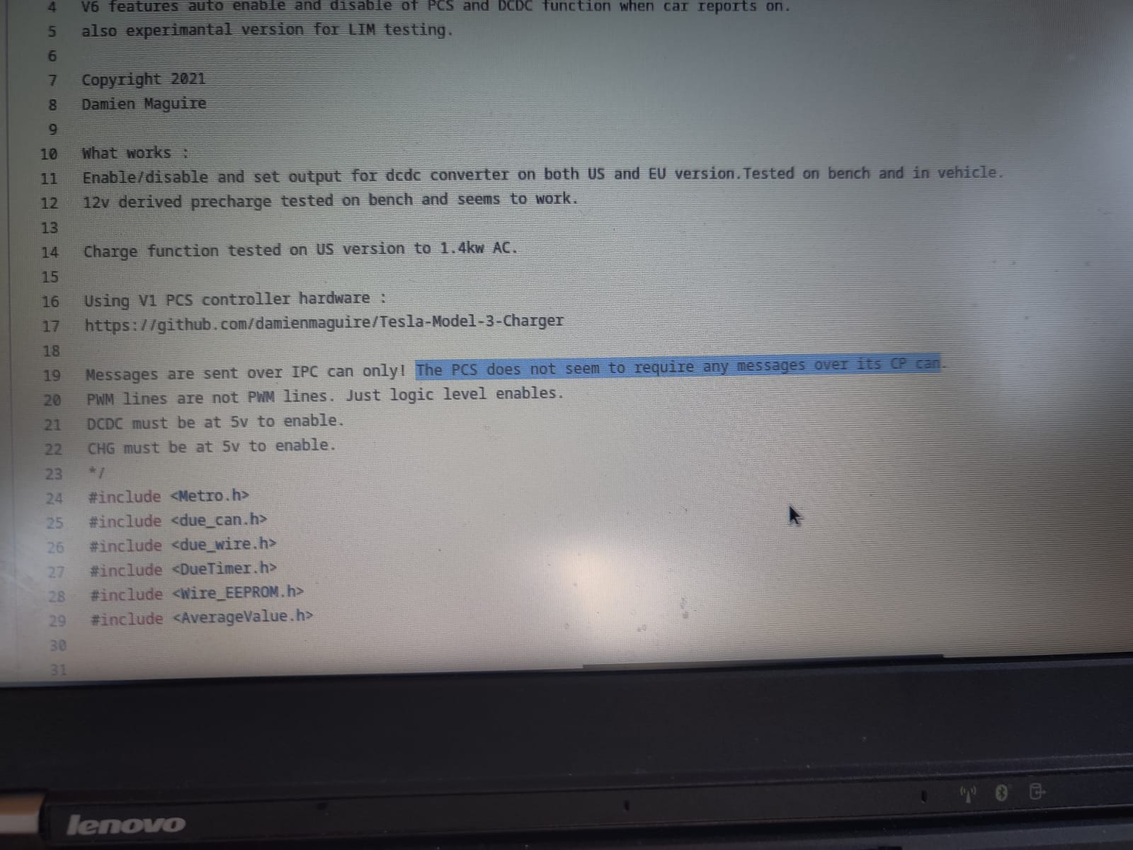

EXT CAN was soldered on 1st board, CP CAN was not soldered, upon further investigation noted the following: pins 34 & 35 for CP CAN are not used
[Github file M3_PCS_V6.ino]

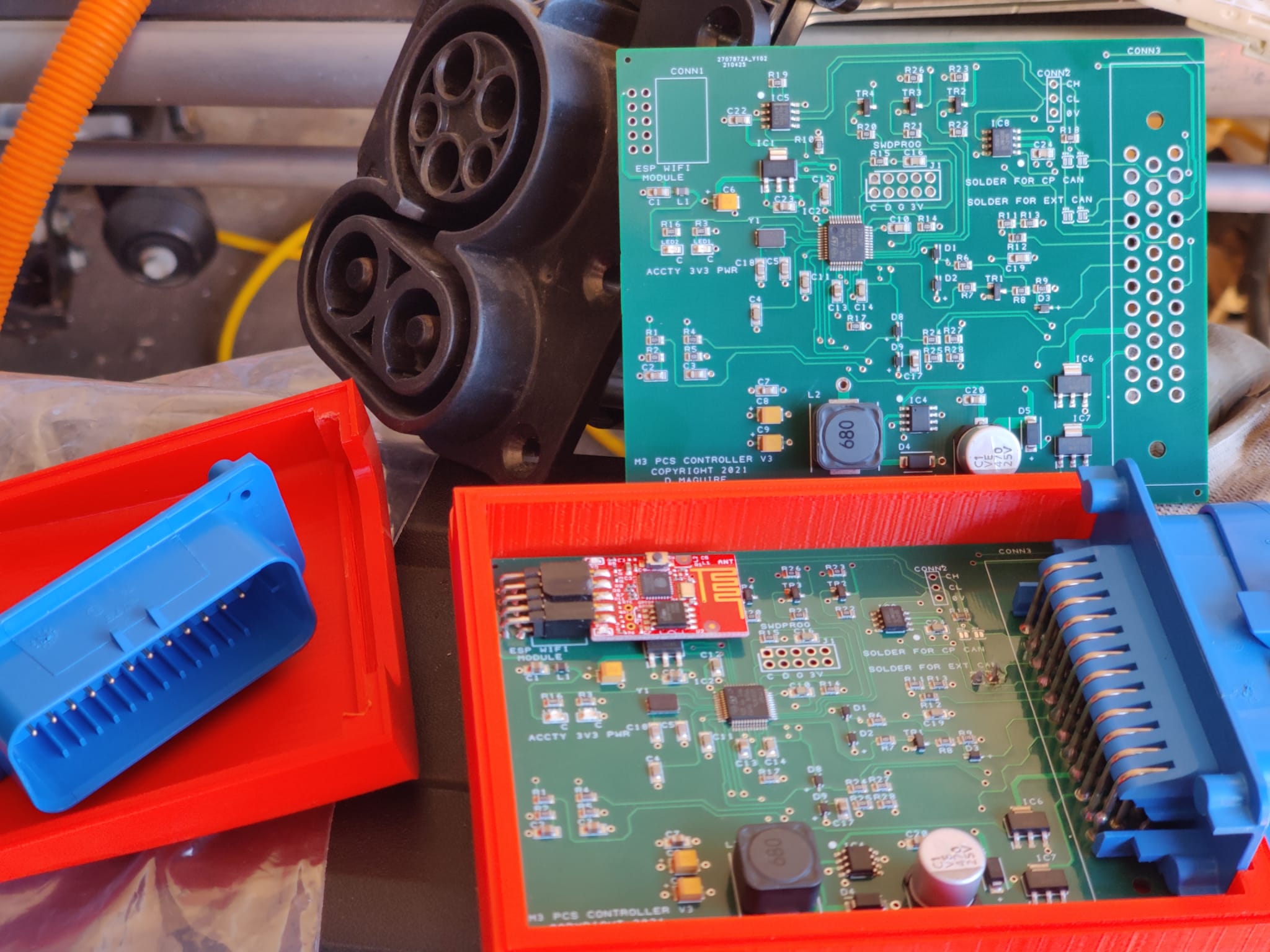

We have controller board v3 and it did not boot up the PCS.
Board was sent 109 frames, it did not respond. The 109 and 108 controller replies did not correspond.
We also observed board's IPC CAN msgs were sent over EXT CAN. On the github, the software wasn't supposed to send IPC and EXT msgs on same CAN. Wondering if this is a v3 design choice or bug.
Would love clarification or any ideas, we'd like to get our electric saucer up into space.

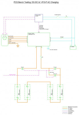

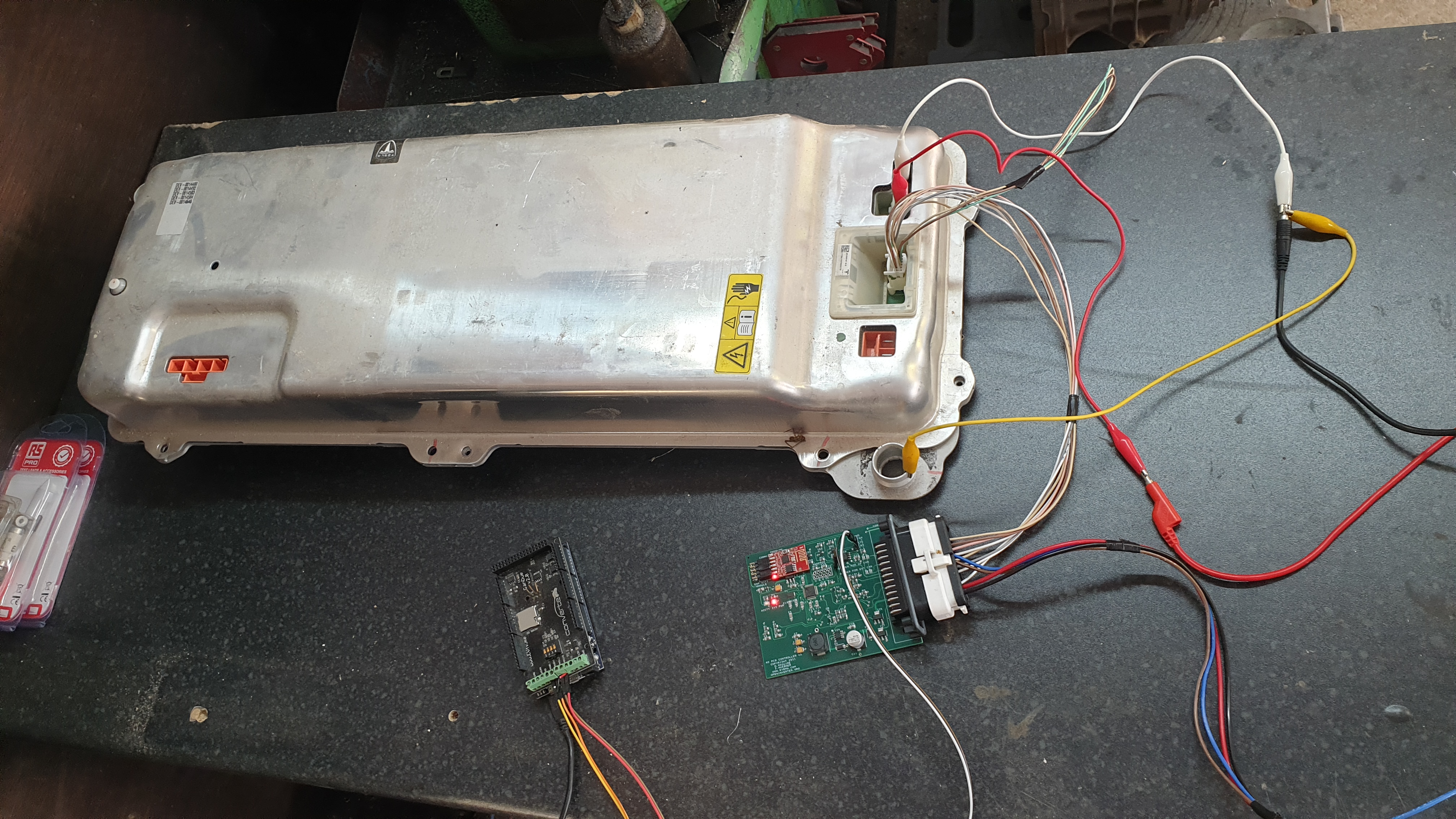

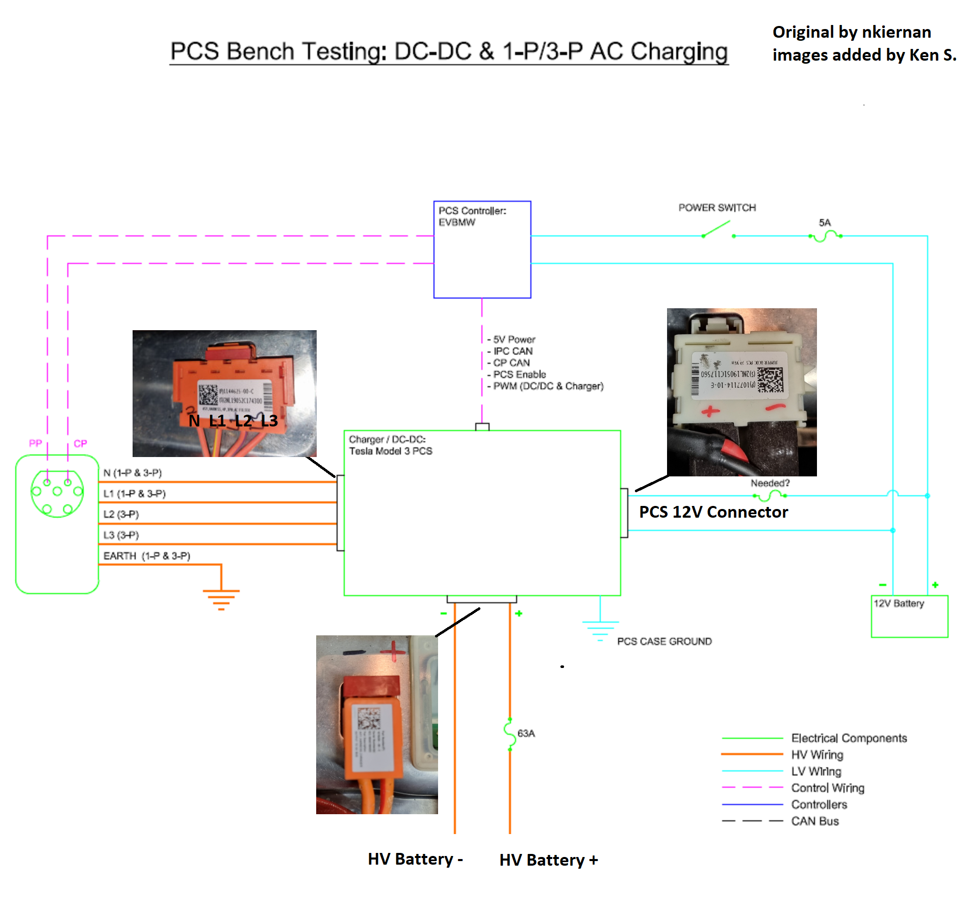

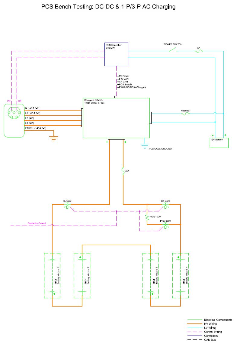

As there's some discussion on testing if PCS's are working with the PCS controller, I'm setting mine up to check. If its not working I can get it to Damian quickly if needed.
To play it safe, I wanted to get some confirmation on the safest setup for testing as some of the group have already worked through this and looking through the thread and wiki there are a couple of things I'm still not sure on, others have asked but I can't find all the answers. I'm hoping to keep the setup as simple as possible to rule out adding in issues with too many components. Once I get this sorted I will do a layout for DC fast charge testing with the i3 LIM.
Attaching the same quick layout in image and pdf below in case it needs blown up to read.
Queries:
1. My understanding is that pre-charge is needed for the PCS. Some chargers do not, but the PCS needs this. In the HV controller thread the pre-charge system has been working via CAN, but I've drawn in a typical contactor and resistor setup as a straightforward option. Query is if this is definitely needed and what is the simplest way to implement? I don't see that the PCS controller is set up to control the contactors and then a shunt is needed to measure the pre-charge voltage so to me its looking like I need to introduce the VCU as well?
2. For the charge port ground/earth pin, this goes to chassis ground, so the 12V system ground, same as the PCS case ground?
3. I expect a fuse is needed on the 12V positive line from PCS to 12V battery, but this wouldn't be typical in an alternator to battery set up, just extra precaution?
4. Can the PCS firmware version be read from the web interface or in the CAN data to help share what versions might work or not?
5. What CAN data is useful to capture to help troubleshooting, CP, IPC, both?
Queries:

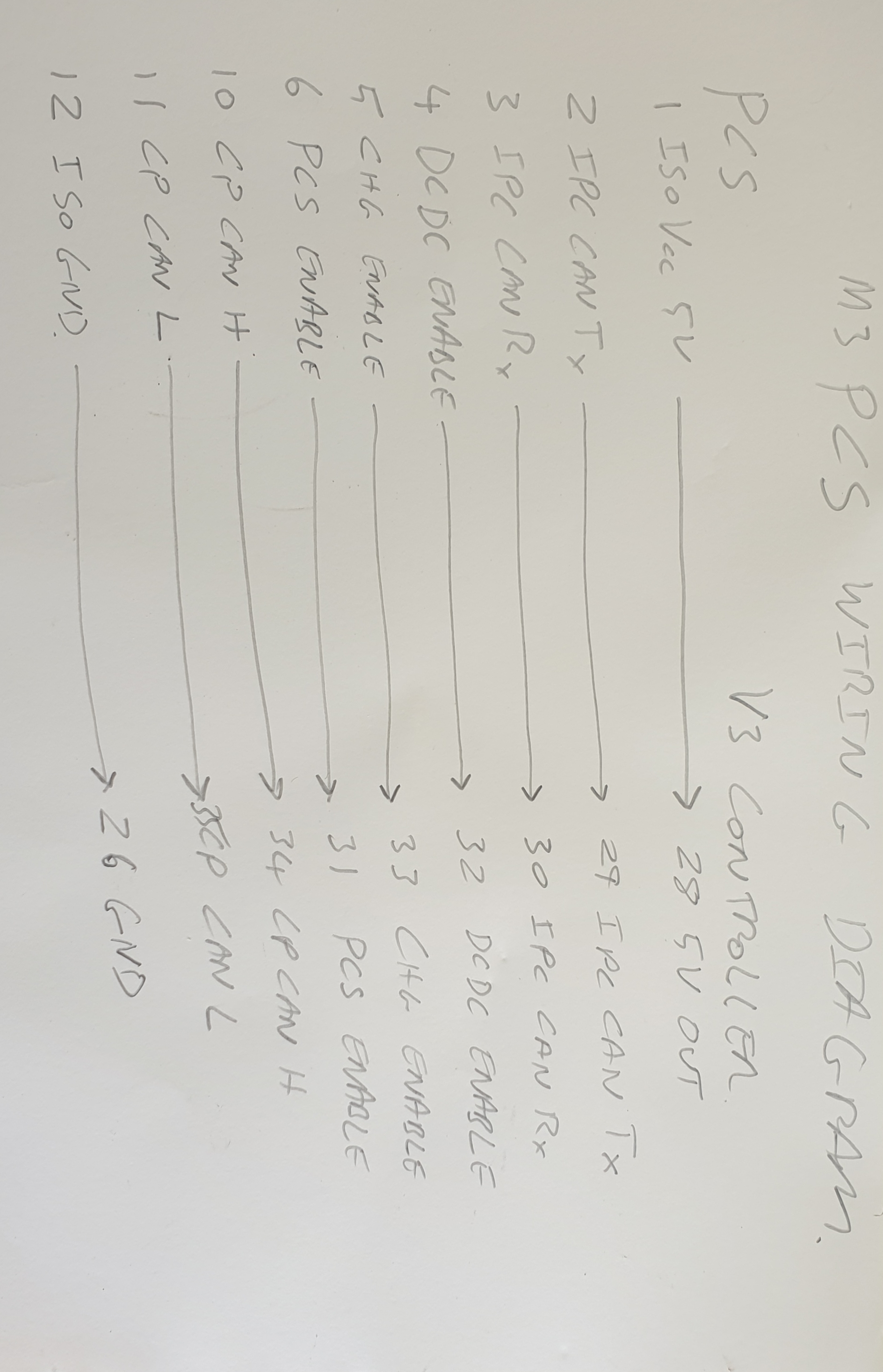

I was going to add this directly to the Wiki but having never edited the wiki here before I don't know the ettiquete, and upon second thought I decided to share here first so that my work can be checked.
I put together the attached diagram in preparation for bench testing my PCS before installation in the truck. It is just a rollup of snippets of information shared by others in this thread, including the helpful diagram from nkiernan and labeled connectors from fredd90... good thing I did because I was confused about which connector was the HVDC and which was the 12VDC! I am glad I didn't get to see that fireworks show. If anyone sees anything else wrong, please share! There is one remaining question I have: What is the minimum DC pack voltage needed for testing functionality? My vehicle pack is currently disassembled, but if I can use just 1 (92v) or 2 (180v) of the model 3 modules in series, I will use them... if I need a higher voltage, I have a large number of new 18650 cells and a spot welder... my backup plan is to assemble a temporary 96s1p pack

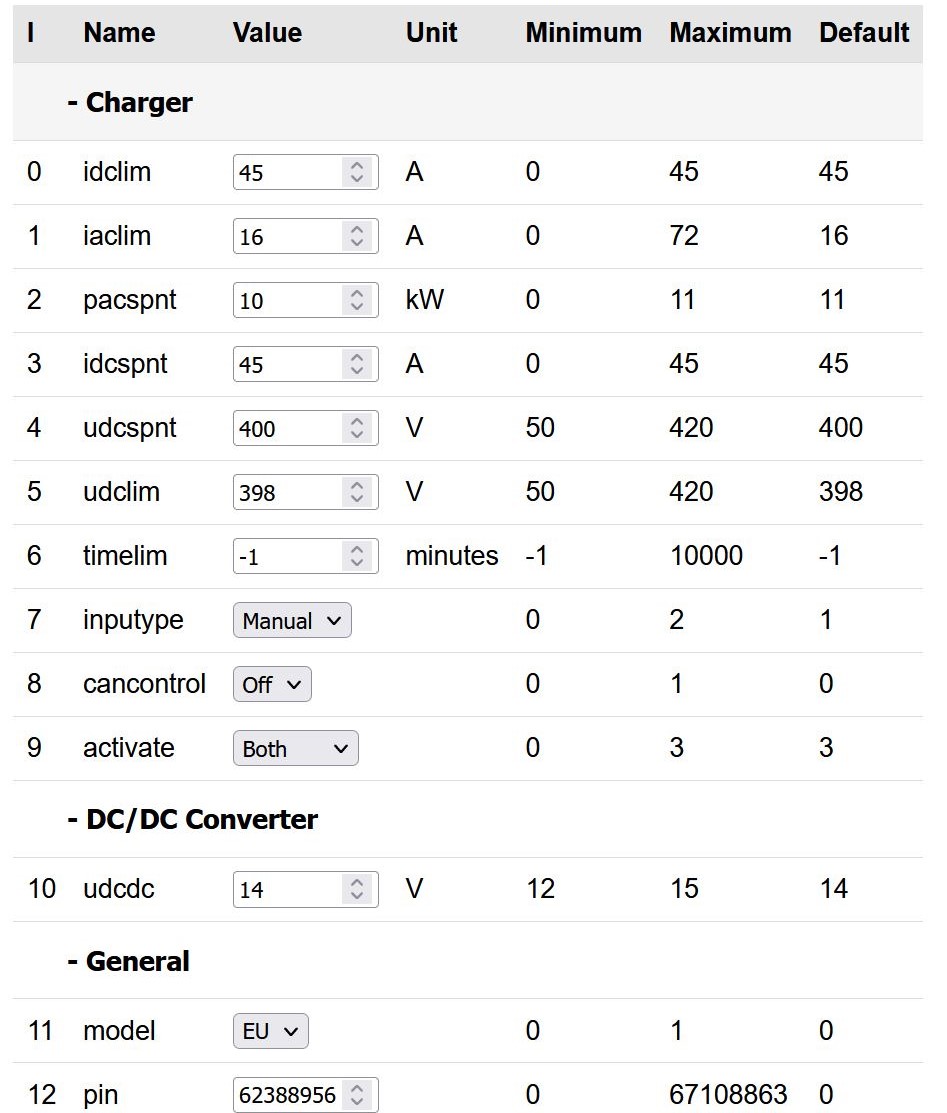

Ken_S wrote: ↑Wed Aug 17, 2022 4:39 am What is the minimum DC pack voltage needed for testing functionality?
According to V3 parameters min battery is 50V. Set the max voltage for the charger to a conservative lower number this is to verify the charger is functional. Once you verify that it functions as intended, set the normal charge voltage. Remember to "save to flash" with each parameter change.
- Posts: 4000
- Been thanked: 1116 times
Given past experiences with Tesla chargers I would not try using the PCS with anything under 200v (250v to be safe) but I could be wrong. Finally got around to building up a controller and connecting up to my first non working PCS. Noticed the wiki page is very sparse so a few diagrams on there would help for sure. I drew out a rough diagram showing the pin assignments from the PCS data connector to the V3 controller. Perhaps someone more artistically inclined than myself could make it look nice. First order of business is a log from IPC can with just 12v connected to the pcs. No need for HV DC or AC at this point as there is no point trying to enable the unit if it is reporting faults due to CAN in the error matrix previously discussed. To that end CONN2 on the controller provides access to IPC CAN and the white and black wires in the picture can be seen connected to a logger running SavvyCAN. If anyone genuinely wants to help with the process then a log from IPC CAN under the circumstances described along with as much info about your particular PCS would be ideal.

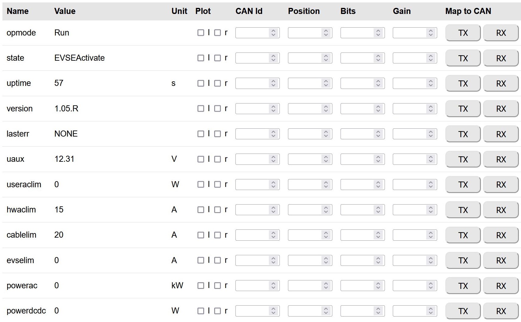

Logging setup : 12v only, connect Input 1 on the v3 controller (pin 5) to 12v. Commence log recording, On the web interface set "inputype" to manual. Record log for 30 seconds , power off and save log then post here.
I'll get the ball rolling and post the first log : 2019 EU PCS removed from car after accident approx mind 2020.

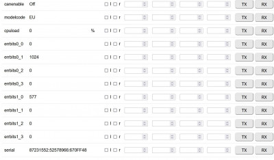

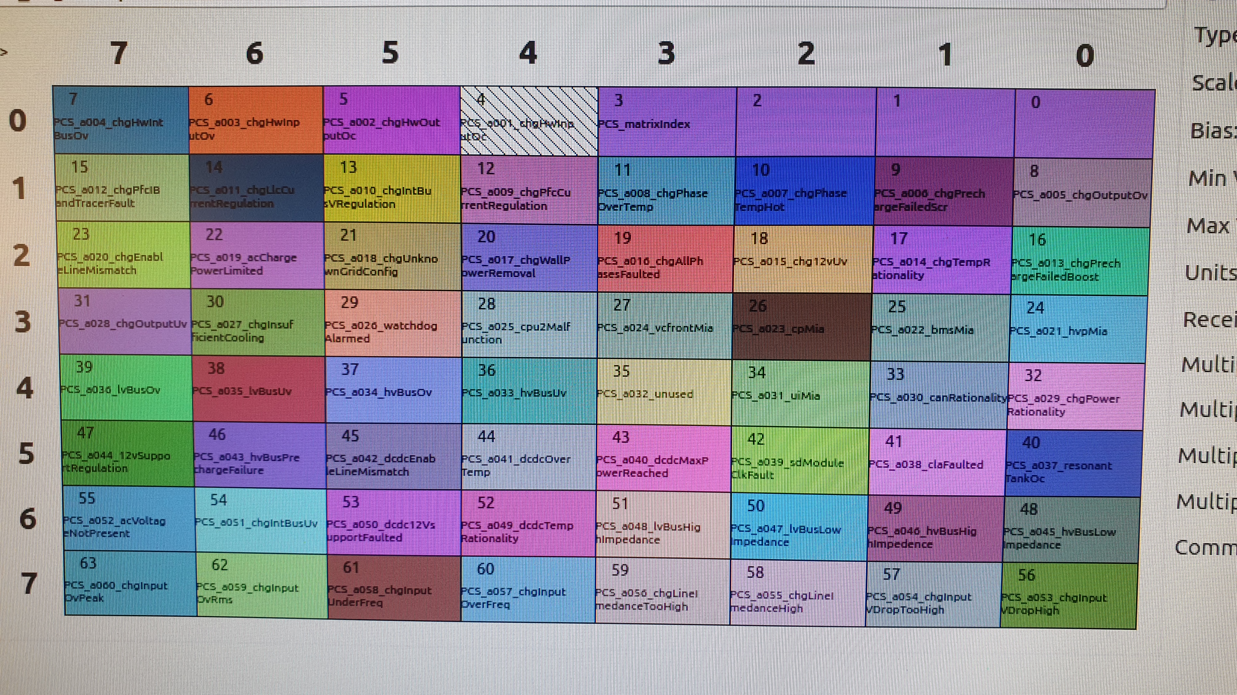

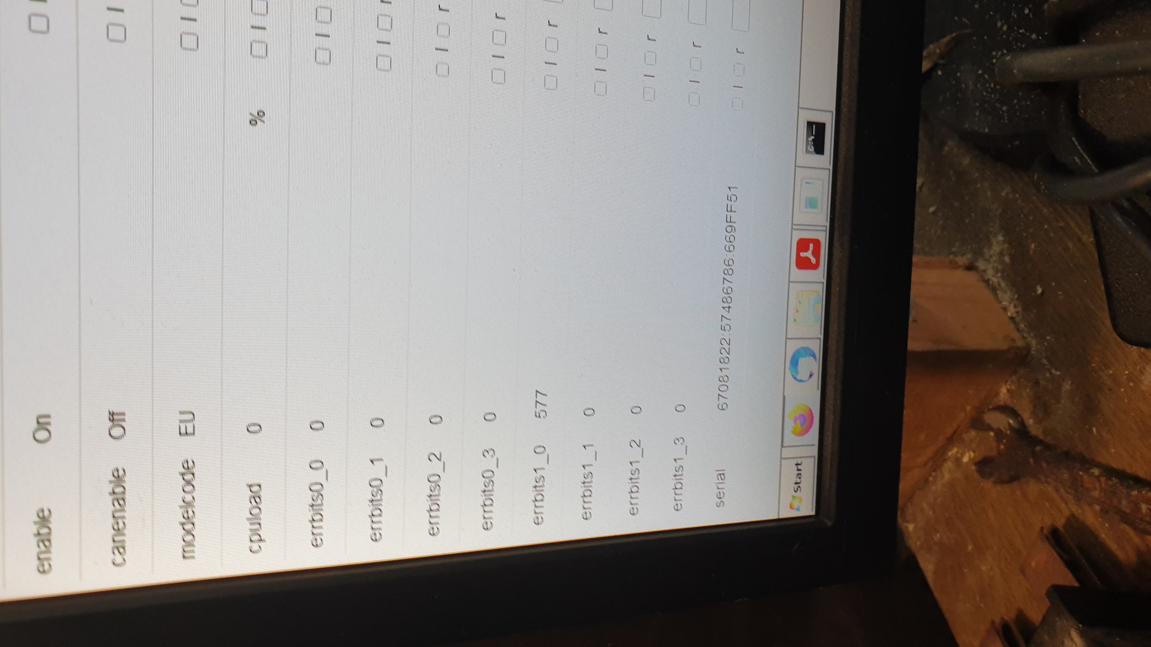

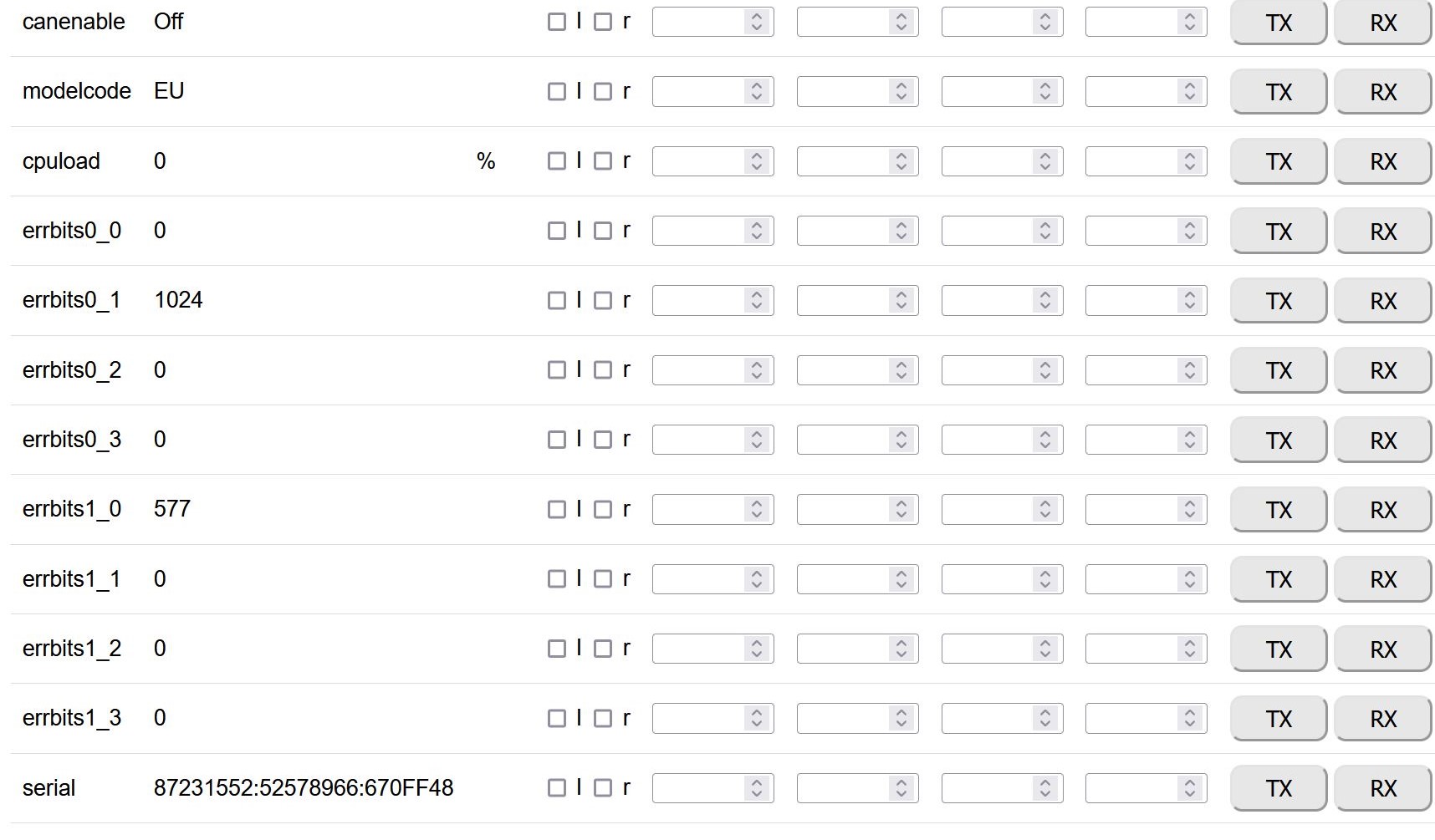

So lets examine what 577 in errbits 1_0 means.
The 1 tells us its in page 2 of the alert matrix. 577 is a decimal representation of 0x0241 so byte 0 of page 2 of 0x3a4 = 41 and byte 1 =02.
Looking up our matrix this tells us that the following alerts are set :
chgVoutRationality and dcdcHVRationality. Basically, the musk brain in the pcs is concerned I have no HV connected. No other alerts are set so I'm gonna bet this pcs will burst into life when given some hvdc and ac.
Thank you for the advice, I think I will just assemble a test pack at 250V.Jack Bauer wrote: ↑Thu Aug 18, 2022 12:14 pm Given past experiences with Tesla chargers I would not try using the PCS with anything under 200v (250v to be safe) but I could be wrong.
I am not in a position to collect CAN logs (yet) but I can make diagrams.

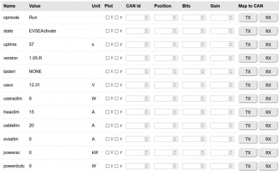

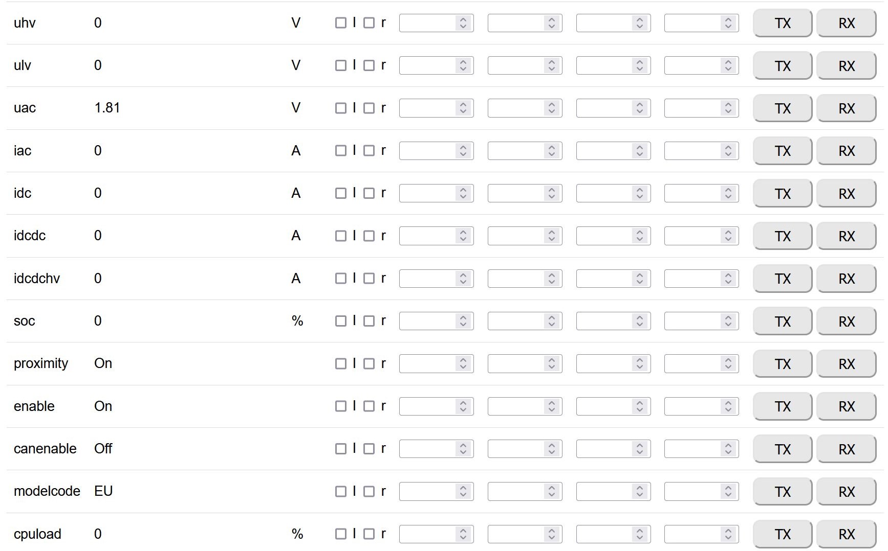

Just carried out the quick test as per post above. Same 577 error code and a second one. I'm away to figure out what this is on the error matrix

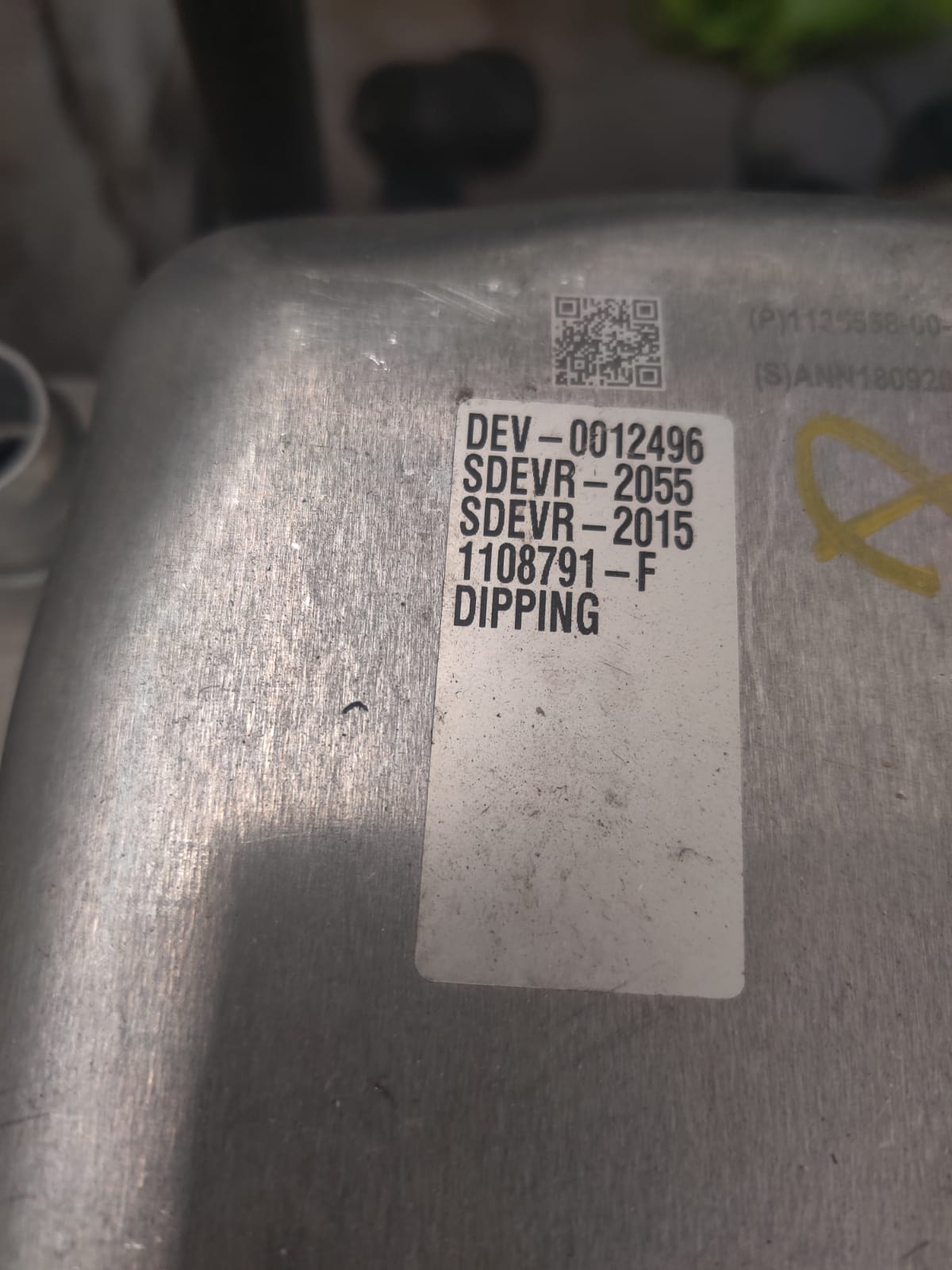

2019 EU PCS removed from crash damaged car early 2021

Easy. 1024 dec = 010000000000 binary. So bit 1 in page 1 byte 1 is set. Looking at our alert matrix this gives : chgPrechFailed. Interesting. Your Elon is angry because he failed to precharge the hv bus from 12v even though we didn't (knowingly!) ask him to do this. Thanks for taking the time to run the test. Anymore volunteers??

Just a check, for this I keep getting chgPhaseTempHot instead. Took me a while to see how it works so am I still making an error? Earlier example works for meJack Bauer wrote: ↑Fri Aug 19, 2022 7:51 am Easy. 1024 dec = 010000000000 binary. So bit 1 in page 1 byte 1 is set. Looking at our alert matrix this gives : chgPrechFailed. Interesting. Your Elon is angry because he failed to precharge the hv bus from 12v even though we didn't (knowingly!) ask him to do this. Thanks for taking the time to run the test. Anymore volunteers??
Edit: Actually, as it shows errbits0_1, does that move it down to the next two bytes (vs errbits0_0), and would that give cpMia?
- Posts: 4000
Byte 1, bit 1 is bit number 9.
