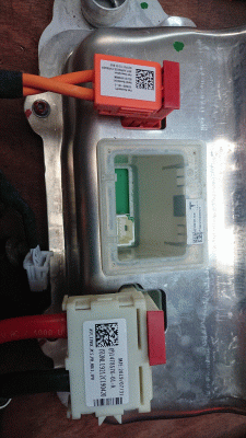

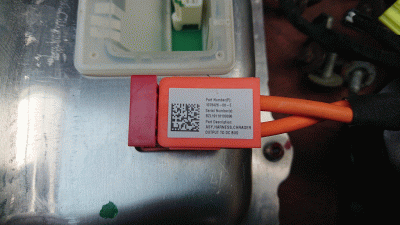

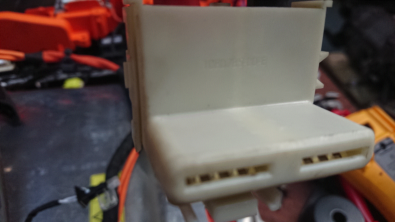

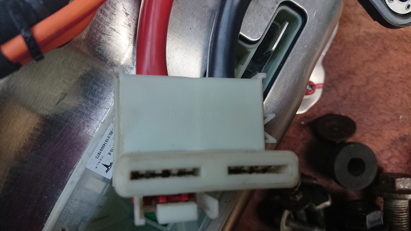

Are the connectors for plugging in the 4x HV from charging port, DC to/from HV battery and to charging to 12V battery available online anywhere, as my PCS didn’t come with any.
- Posts: 3663
- Has thanked: 11 times
- Been thanked: 345 times
I'll see if I can find any id markings on mine.

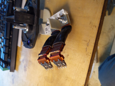

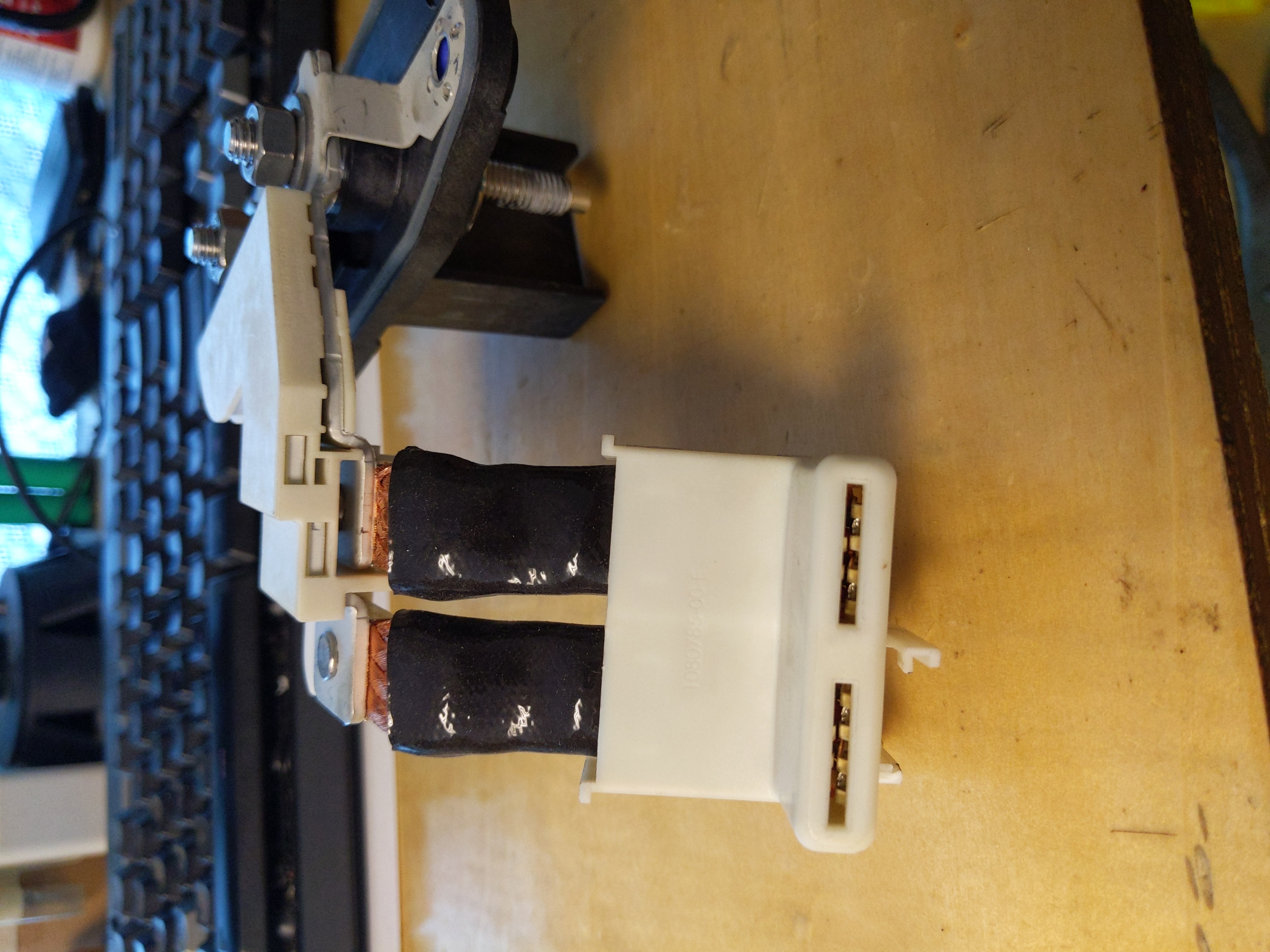

I disassembled my pack myself, so hopefully I can help here. This is the HVDC connector into the PCS.
I think it is either made to spec for Tesla or it is a Tesla made part, none of the numbers turn up anything other than identical salvage parts.
EDIT: Some searching on Digikey turned up these TE contacts that look similar, and based on their drawings would fit. I choke on 14$/pc
https://www.digikey.com/en/products/det ... -2/2327759

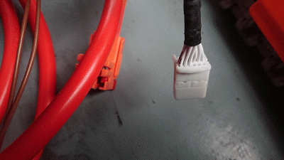

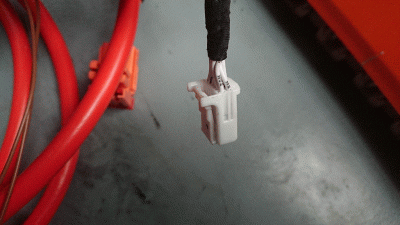

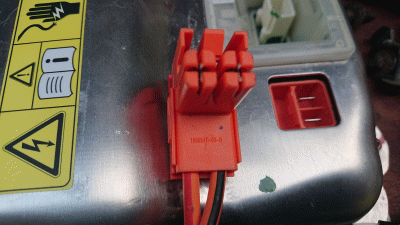

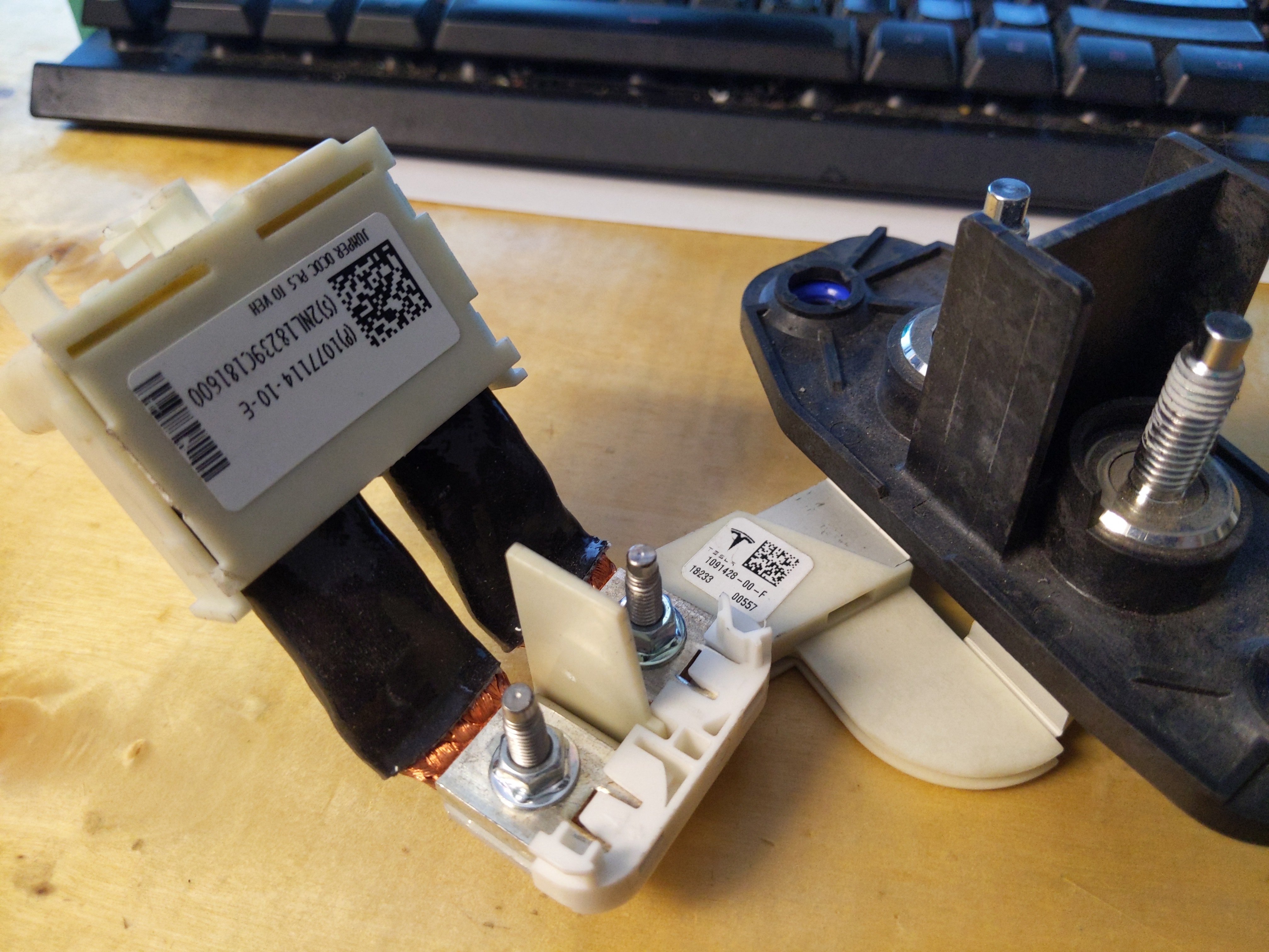

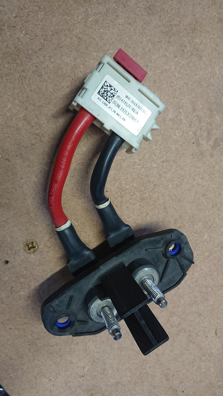

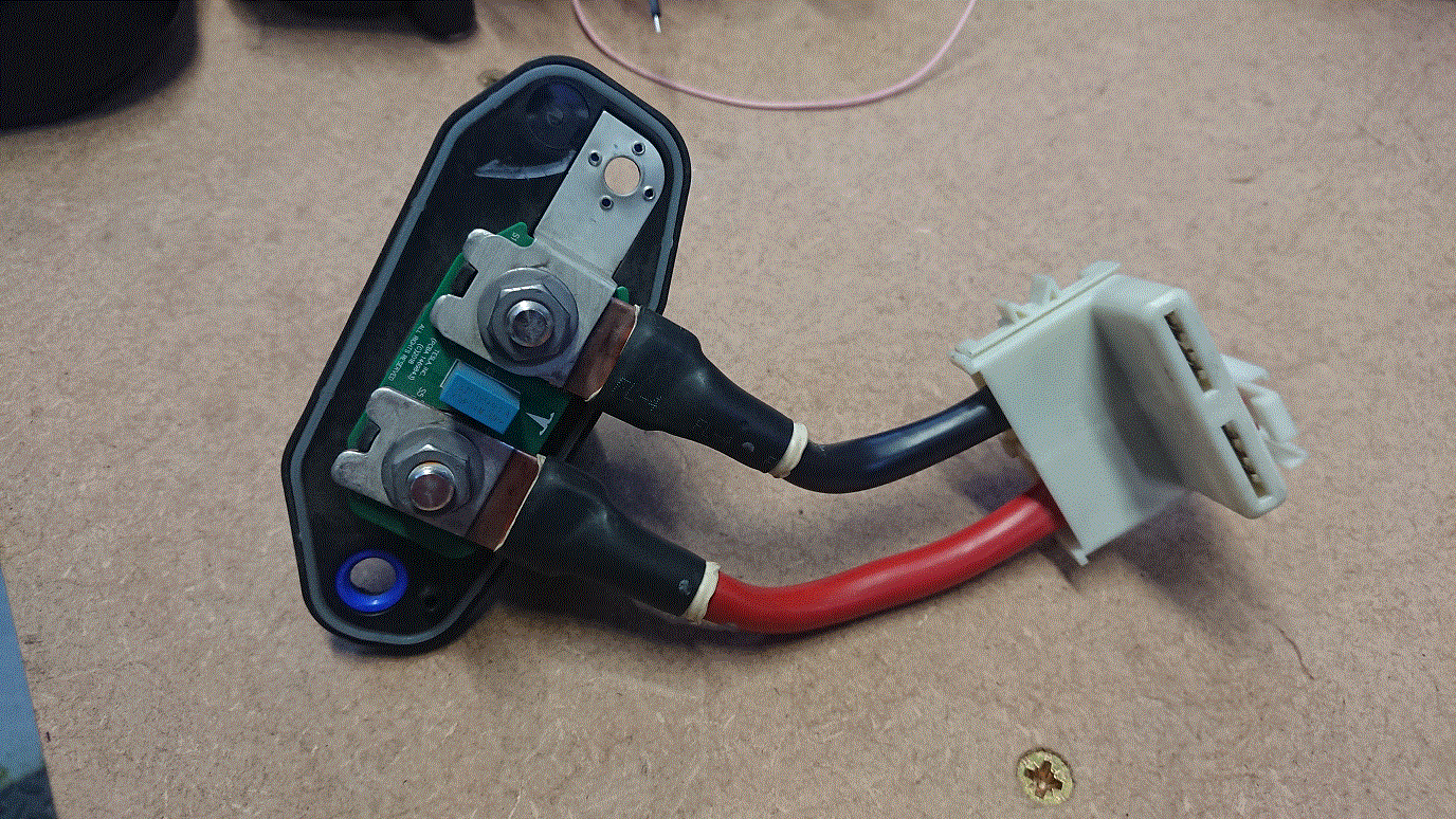

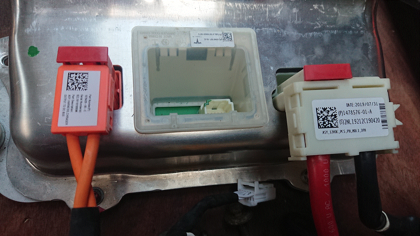

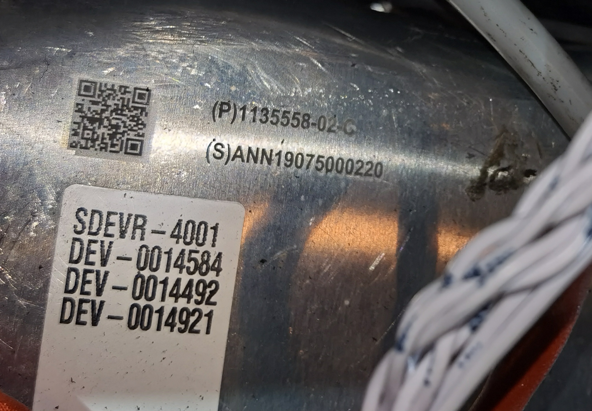

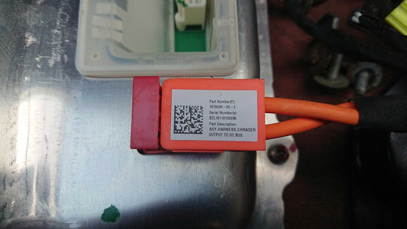

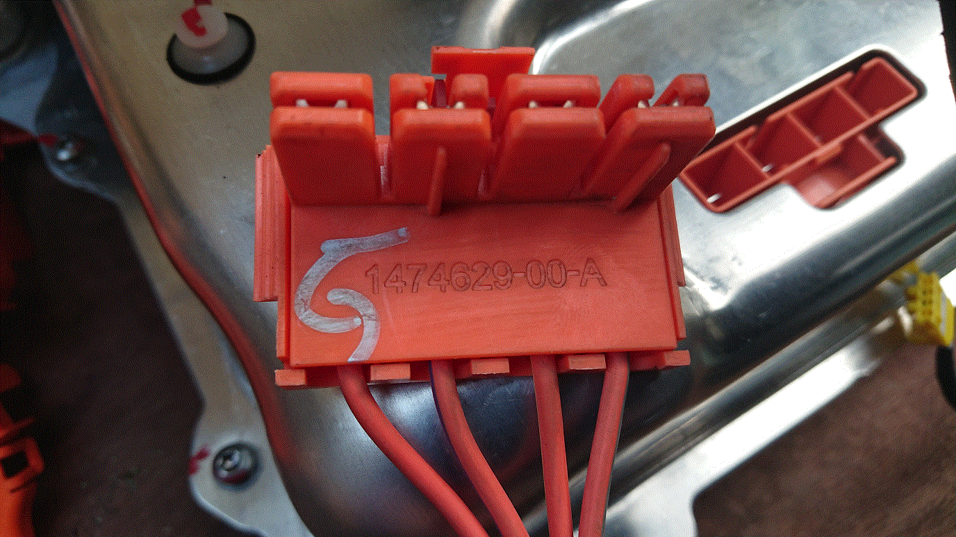

Just checked the connectors I have and slight differences. See photos and the stamped codes on the plugs:
Did your connector come from the factory with red and black cables?
- Posts: 560
- Has thanked: 385 times
- Been thanked: 81 times
- Posts: 3663
There are 3d print options available :
https://github.com/muehlpower/EV-FFB
Very interesting. That looks considerably easier to deal with than the busbars mine came connected to. What year/region/model was your donor, if you know?
- Posts: 560
Sourced in an Irish EV breakers, an EU 2019 car is all I have on it

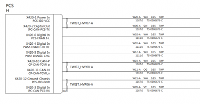

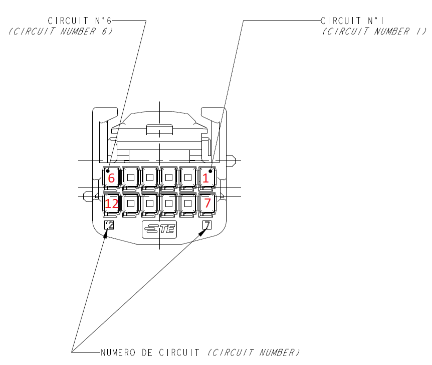

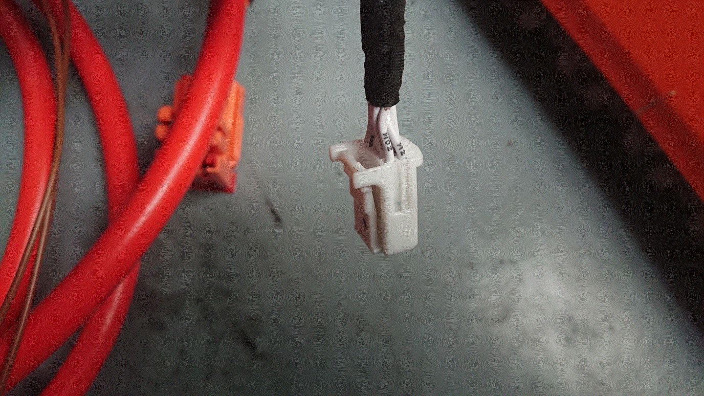

Can you double check the X420 pinout in your PDF? I only ask because I am re-using the harness from my pack, and in the harness connector to X420, there are no wires in the sockets for pins 10,11, or 12, at least according to the pin numbering defined in the connector datasheet. What pin numbering are you using?Jack Bauer wrote: ↑Mon Apr 19, 2021 8:16 am
Update : 20/04/21 : attached pinout and connector data document
- Posts: 3663
That's interesting. So pins 10 and 11 are cp can that is not used by the pcs anyway. Sounds like they deleted them from the loom. Pin 12 is a ground that actually needs to be connected to the case of the pcs so I would also suspect they deleted that in favor of just using the case ground. My pin numbering is as per the service manual wiring diagram. The Wxx numbers are actually printed on the wires so you could check those.
Thanks for confirming. I wasn't aware the service manual was openly available, I should have googled it a year ago:) Attaching a screenshot here for others to reference. /wrong At a glance it does seem like Tesla isn't using the connector manufacturers suggested pin 1, I will confirm in the morning. /wrongJack Bauer wrote: ↑Mon May 24, 2021 9:09 am That's interesting. So pins 10 and 11 are cp can that is not used by the pcs anyway. Sounds like they deleted them from the loom. Pin 12 is a ground that actually needs to be connected to the case of the pcs so I would also suspect they deleted that in favor of just using the case ground. My pin numbering is as per the service manual wiring diagram. The Wxx numbers are actually printed on the wires so you could check those.
EDIT: After further review, Tesla does in fact use the manufacturers suggested pin numbering scheme in X420... I incorrecly assumed the connector used a "snake" numbering pattern, which was incorrect. Below is a clip of the connector datasheet with the suggested pin numbering schemed Tesla uses.

where did you find the service manual?Ken_S wrote: ↑Tue May 25, 2021 7:12 amThanks for confirming. I wasn't aware the service manual was openly available, I should have googled it a year ago:) Attaching a screenshot here for others to reference.Jack Bauer wrote: ↑Mon May 24, 2021 9:09 am That's interesting. So pins 10 and 11 are cp can that is not used by the pcs anyway. Sounds like they deleted them from the loom. Pin 12 is a ground that actually needs to be connected to the case of the pcs so I would also suspect they deleted that in favor of just using the case ground. My pin numbering is as per the service manual wiring diagram. The Wxx numbers are actually printed on the wires so you could check those.
I found a manual here, have not bought it myself yet.muehlpower wrote: ↑Tue May 25, 2021 8:12 amwhere did you find the service manual?Ken_S wrote: ↑Tue May 25, 2021 7:12 amThanks for confirming. I wasn't aware the service manual was openly available, I should have googled it a year ago:) Attaching a screenshot here for others to reference.Jack Bauer wrote: ↑Mon May 24, 2021 9:09 am That's interesting. So pins 10 and 11 are cp can that is not used by the pcs anyway. Sounds like they deleted them from the loom. Pin 12 is a ground that actually needs to be connected to the case of the pcs so I would also suspect they deleted that in favor of just using the case ground. My pin numbering is as per the service manual wiring diagram. The Wxx numbers are actually printed on the wires so you could check those.
https://servicemanuals.online/tesla/140 ... grams.html
- Posts: 560
Attaching photos of the X420 connector I have for info, last three pins not used on this one either. Just got hold of service manual and wiring diagrams, send a PM
I just went though the wire labels and the connector datasheet again, turns out I was wrong. Tesla is using the manufacturers pin numbering scheme, I just mis-identified the unused positions 7,8,9 as 10,11,12.
I edited my post above with the correct pin numbering scheme, so as to minimize future confusion.

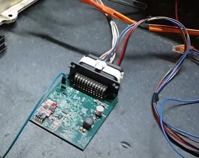

PCS controller up and running and connected to web interface

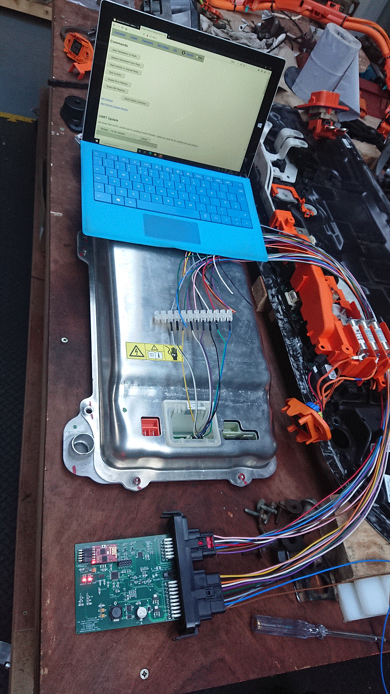

Got in to problems, I think
Everything wired up according to the pinout supplied at first post.
Can't get any pcs values from Web interface, connecting and logging in went great
I have selected eu version,
Is there any more changes to get things working?
Got 5v at pin one and pcs is mounted in penthouse,
Also got 13v at pin6(pcs-enable) with or without communication cable connected.
Attached a picture of my pcs:
