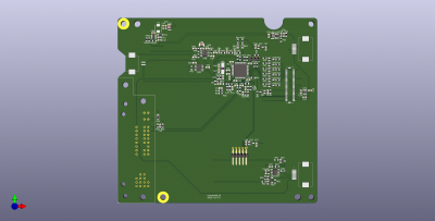

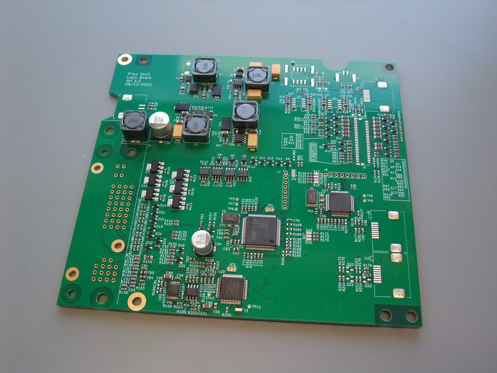

Progress (well hopefully - if it all works!):
Forgot how much of a pain hand assembly is! I've left all the difficult to replace bits off for now (mainly the Toyota connectors) until I know whether it works. Couple of slight problems, one diode on backward which stopped the -5V rail from working and there are a few components that I managed to miss when ordering but it generally looks OK.
Power supplies are coming up, resolver to digital converter IC is clocking and generating the resolver drive waveforms and I can talk to both processors with the debugger. I've tried putting the code on the STM32F407 processor and it programs OK and in the debugger it single steps through main and completes all the initialisation code but when allowed to free run it ends up in the blocking_handler interrupt so I'm guessing I've messed up an interrupt configuration somewhere. Hopefully spend some time on it in the evenings, get it all tested and if it's OK get the rest of the bits ordered and look at hooking it up to the inverter and HSG.

Looks good!
I see you have gone for the all in design with a lot of capabillities. I have started my own design for a Yaris logic board but with the bare minimum capabillity. Looks silly sparse compared to yours.

I thought this was fairly stripped out compared to the first design (viewtopic.php?p=39624#p39624)!
I've moved most the VCU related stuff out to a second unit. The contactor control bits are only there temporarily to allow the car to be used before the VCU is in.
What else are you cutting out of yours? Are you using Kicad for it?

Started testing the board, code is on and running and have a blinking LED and comms via RS485 (so the Tx/Rx direction switching and Tx DMA are playing nice which is good).
Going to be a fairly slow job as this is commissioning both the hardware and the ported OpenInverter firmware so going to keep track here of what has been tested and what is remaining to test:

Quick update, so far all the bits I've commissioned seem to be working fine!
The missing bits have now arrived so it should be possible to finish populating the board.
Only bug to date is a missing pull up on the RS485 Rx line which meant that it received a bogus character when transmitting (receiver disabled so Rx line dropped low). Enabling the IO line pull up on the processor has fixed it though (a hardware pull up would be better but this will do for now). I do need to figure out a way to use the continuous streaming commands though. RS485 is unidirectional so once the streaming starts there is no way to send a command to stop it; will have to add a pause every now and then.
The main control loop is running in around 15us (that's with the standard 5.24 fixed point code). If my memory serves the F103 runs in ~35us so the F405 looks to be about twice as fast which is about what you would expect. Next is to convert all the fixed point math to floating point and see what difference it makes. Hoping to get all the MTPA/MTPV calculations back into the main loop which is looking doable.

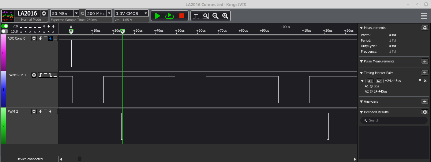

Have now got the resolver/ADC sampling, control loop execution and PWM reload working the way I wanted - an analyser screenshot:
The top trace is showing the resolver sampling point which is coincident with the start of a burst of Il1 and Il2 ADC conversions (because of the way the interrupt I'm using to drive the IO line works the analyser is only seeing every other capture, there is another happening at around 44us). This is set to be exactly mid way between PWM reload events.
The middle trace is showing the execution of PwmGeneration::Run (main control loop), it is running when this line is low. The start of this is triggered by the completion of the last ADC conversion of the Il1/Il2 burst.
The bottom trace shows one channel of the PWM output. The reload value is set to the extreme so that it is a low pulse the middle of which is the reload point. There is another reload at around 73us that isn't visible on the trace.
What can be seen is that this is giving a latency from motor position and motor current measurement to the new PWM value that is based on these being output of 25us, down from 180us on the F103 processor - happy with that
It will be a bit slower than that in reality (as the PWM frequency for that test is set a bit high), 30us is more realistic.

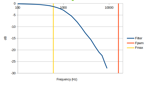

So the missing components arrived today and have now been fitted. One of these was the op-amps for the Il1 and Il2 motor current measurement filters.
These are there because I'm a little worried about the low inductance of the Outlander motor (0.15mH) causing excessive ripple. The idea of the filter is to allow the commutation frequency components through while blocking the PWM frequency components. It should also block switching frequency components pretty well.
First problem, I didn't put pull down resistors on the filter inputs (becoming a bit of a theme!) which meant that the op-amp bias currents pulled the outputs up to full scale when the CTs isn't connected; luckily I had included some schottky protection diodes in the circuit so the processor ADC inputs survived. Also luckily there was a suitable ground pad next to the filter input so 100k pull-downs are now bodged on.
The measured filter response looks like this: The yellow line is the max commutation frequency for the Outlander motor (running up to 10krpm) while the orange line is the PWM ripple frequency (assuming PWM running at 8kHz). While it doesn't look too bad I'm not sure it is quite right, the filter cut-off was chosen when I was planning on running 4.4kHz PWM so it's a bit low now. I have also just measured the phase delay and at 100-150us it is enough to lose all the latency gains made moving to the stm32F4.
I'm now wondering what the best compromise is. I had planned to sample the resolver/current at the mid PWM timer reload point which would minimise the measure to output latency (30us) but doing that means that the ADC is sampling at points of the PWM waveforms where IGBT switching is occurring. If the sample point and a switch event coincide there will be lots of noise on the signal. Also, depending on PWM duty cycle, the motor current could be rising or falling so adding PWM frequency noise. Hence the filters, but if the filters add another 125us latency I'm up to 155us which is not much better than the 180us starting point (but hopefully with lower noise current samples).
It's possible that a better compromise is to sample at the reload point. Now this means that it will be 60us till the measurement has an effect on the PWM duty cycles but because it is guaranteed that there will not be a switching event you can get away with a much worse, and lower phase delay filter. Say I could get the phase delay down to nearer 40us that would give a total latency of nearer 100us. It also means that you are always measuring on the same point on the PWM ripple so there should be no beating effect. So the latency isn't as low as I'd like but the current sampling should be very clean.
Not sure what the best compromise is? It's either change the cut-off from 2kHz to 4kHz and stick with mid-point sampling or change it from 2kHz to 8kHz and go with reload point sampling. Both will be pretty similar in terms of total latency at ~100us but the later should give cleaner current signals so currently erring in that direction. Comments welcome!
Edit - think I'm going to move to sampling at the PWM reload point. The filter cutoff frequency will be lifted to ~12kHz (chosen because I already have the cap values needed!) which should drop the phase delay to around 20us while still giving a bit of attenuation to PWM frequency (~9dB) and good attenuation to switching noise (which will still help with data logging via the non synchronised sampling on the other ADC). Total latency will be around 80us. Not as good as I'd like but still a worthwhile improvement.
Edit2 - Re-measured the phase delay of the filter concentrating on the area below cutoff (the actual operating region) and it is worse than I thought - 190us. Looks like the cutoff frequency will need to increase by a factor of 10 (to 20kHz) to have a low enough delay so will definitely have to move to reload point sampling. The question at that point is it worth keeping at all? Do I bypass it completely (can be done by fitting zero ohm links) and save the power consumption and reduce component count or leave it in but set to a higher freq to remove any other noise that may be present?

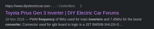

I agree with celeron55, the buck-boost is very noisy, even at 10kHz but at 4kHz you need hearing protection to stand close...
The buck-boost in prius gen3 seem to run at 7,45kHz. When I google it I find this, but if I click the link I can't find the post containing that information?
It would be very surprising if it's not possible to run the inverter at 8kHz.
