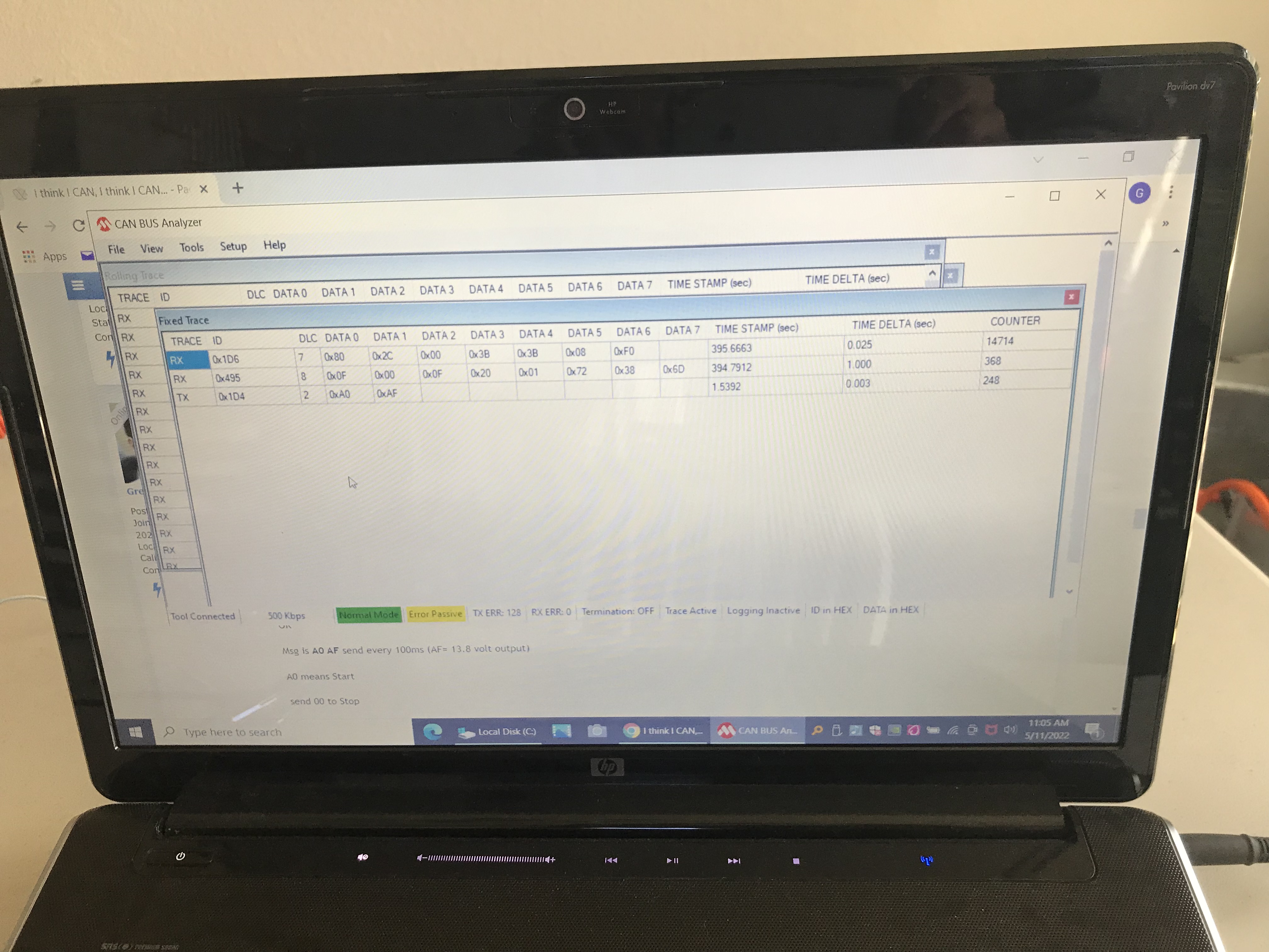

so I wanted to let you know that I also gave the Microchip a second shot (wanted to test and see if it will work with only sending one command) this time with the Chevy Volt first gen DC-DC converter and it still did not work

Pete9008 wrote: Sun May 15, 2022 4:44 pmThat's a shame, it looks like it should be a good option.
Have you tried connecting it up to one of your other CAN dongles to see if that sheds any light on what it's doing (or not doing!)?
the darn thing itself claims to be sending CAN messages, I have a case open with Microchip Tech Support and they have replied and asked me to try it with a different device, so I emailed them back and said now I have tried it with both the Chevy Volt first gen charger and the first gen DC-DC controller, neither seem to work

I had the opposite problem, SavvyCAN claimed it wasn't sending anything but I could see 1000s of messages on the canbus lines! You need to able to see what's actually happening on the bus to diagnose it, fortunately you happen to have a few other canbus dongles!
I'd connect the Microchip one directly to one of your other dongles (with nothing else on the network). That way you can see exactly what it sends out by monitoring it using the other dongles software and also send messages back in to see if it receives them.
Might be a faulty unit?
Got to say the more I use SavvyCAN the more it impresses me, you can tell the software was written by someone who also used it.

Just noticed from your pictures that it's reporting an "error passive".. I think this means that it's not getting an ack back from the charger (same problem I had), is it definitely set to the right baud rate and are the can bus wires the right way round?
Edit - passive error can be caused by the Tx seeing bit errors as well as missing ack, appears to mean it can't get a message onto the bus - no real surprise there then!

Pete9008 wrote: Sun May 15, 2022 5:50 pmJust noticed from your pictures that it's reporting an "error passive".. I think this means that it's not getting an ack back from the charger (same problem I had), is it definitely set to the right baud rate and are the can bus wires the right way round?
I believe so because it reads messages just fine, which makes me think the high and low wires are connected properly and the termination is on, this guy has software controlled resistor terminator thingie and I tried it with both on and off, it is on in this case

If it receives messages then that suggests it is connected right, comes back to not getting an ack back from the charger. This could be the dongle isn't actually putting message on the bus or it is getting it onto the bus but the charger doesn't like something about it. In the later case connecting it to another dongle might give more information,
It's starting to sound like a duff transmit line on the unit (given that the chargers work with other dongles). Don't suppose you have a scope handy?

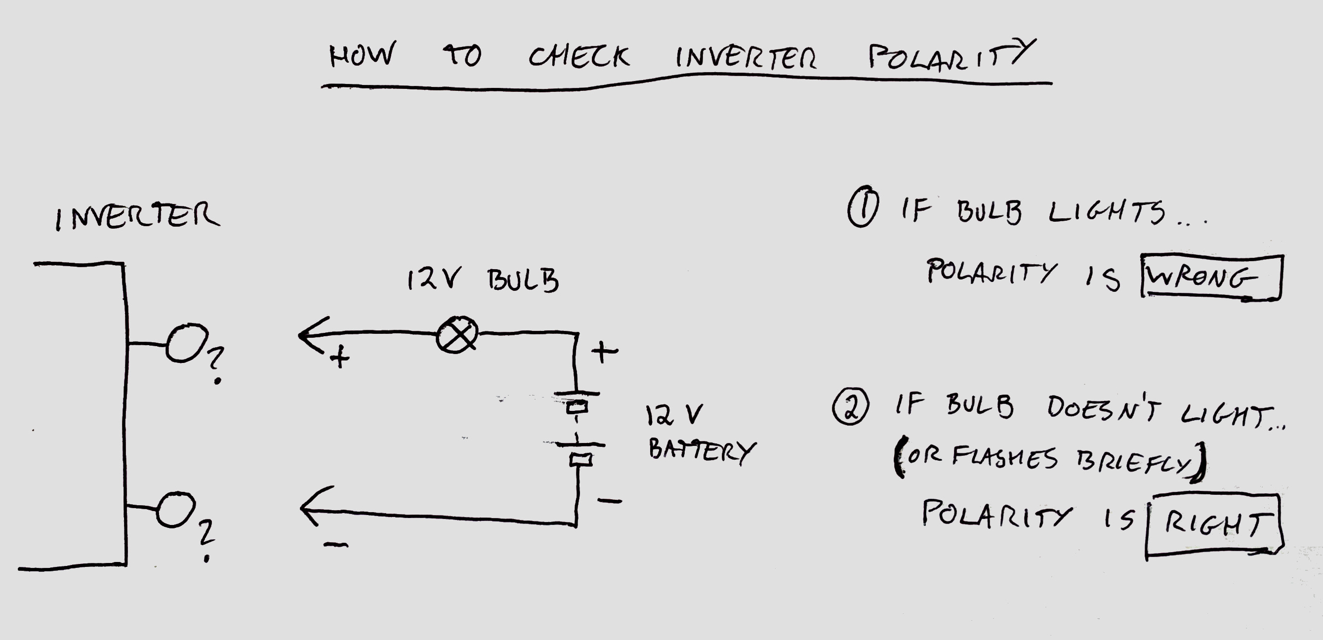

Hm... now that you mention. I did in that order:
1. I simply connected complete HV battery from Chevy Volt i had in my workshop. Do be carefull and make sure + and - lines are correct with a polarity test! viewtopic.php?f=4&t=632&p=8198&hilit=polarity#p8215
2. I connected AUX battery to output.
3. I commanded my Canalyst with ID 00 00 01 D4 msg A0 B2 at 100ms
4. I connected enable to 12V battery and i saw the light! Actually 12V light bulb got really bright :).

First you determine if reverse diode inside DCDC is working. Perform polarity procedure i mentioned before:
viewtopic.php?p=8215#p8215
It works for chargers as well as for all HV device connections that have reverse diodes in their boost stage transistors.

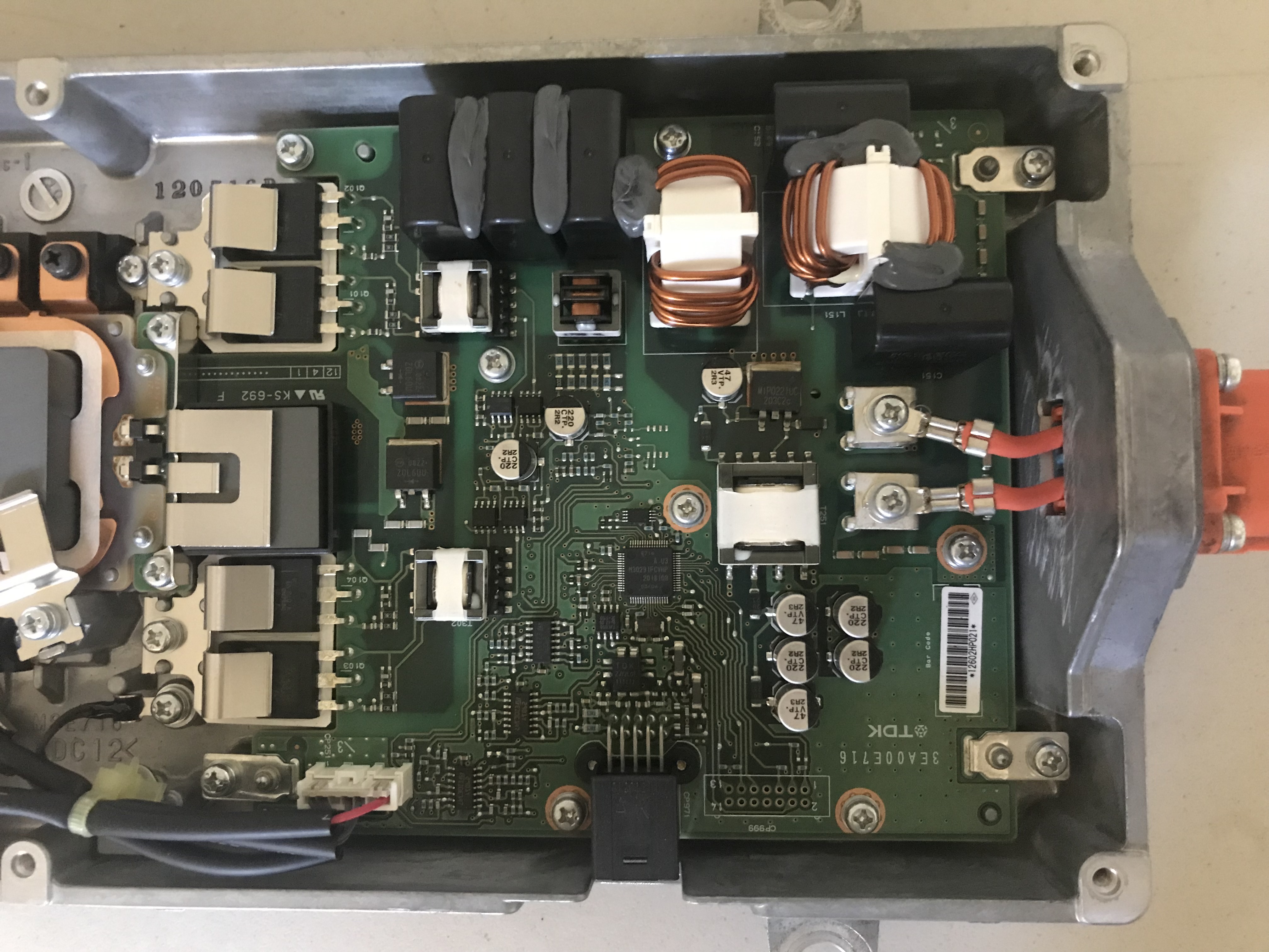

I also found photos of its insides
https://www.gm-volt.com/threads/apm-pictures.144298/
If you open it you can inspect input stage for any damage...

arber333 wrote: Mon May 16, 2022 7:06 amI also found photos of its insides
wow what an awesome find, thank you so much
so here are the guts of mine, and although I don't know what I am looking for at least nothing seems smelly or black burned

Looks pretty much the same as any automotive 300VDC->12VDC converter.

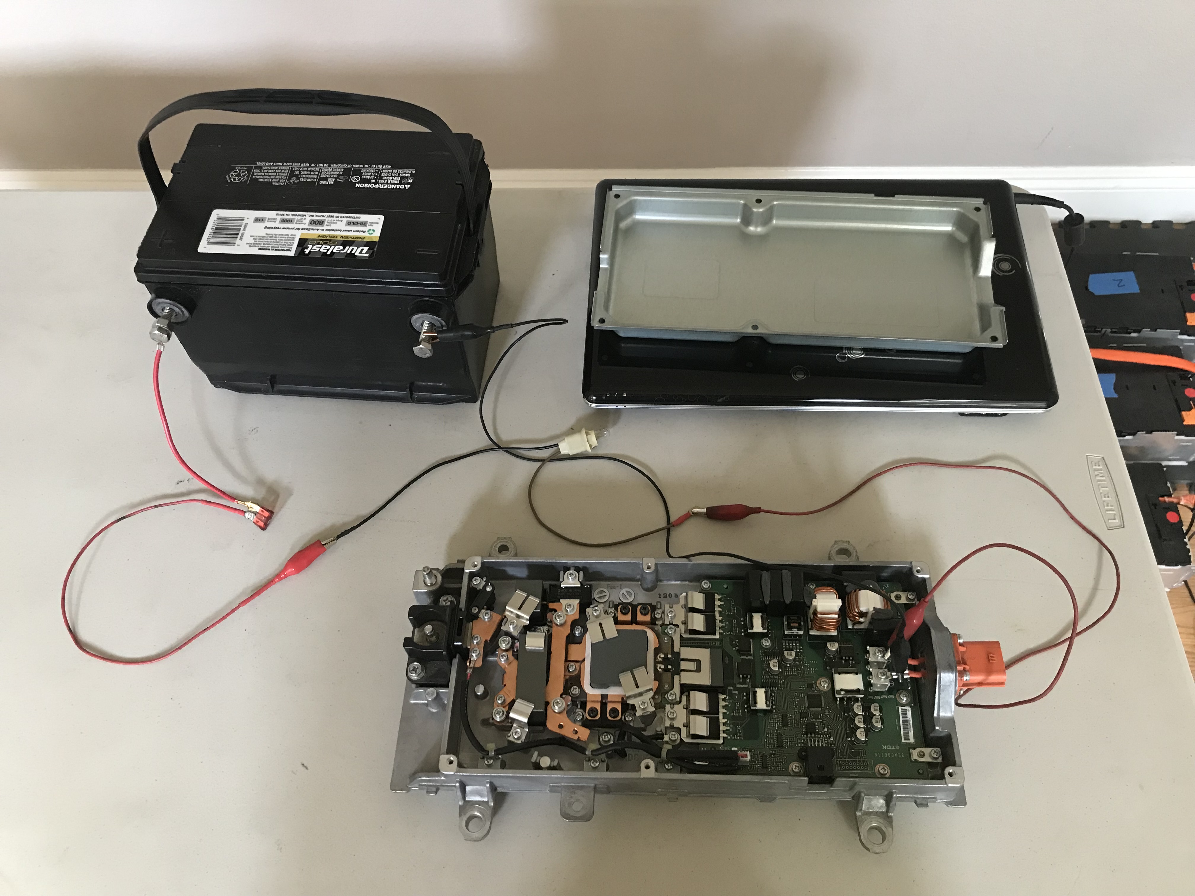

arber333 wrote: Sun May 15, 2022 7:26 pm1. I simply connected complete HV battery from Chevy Volt i had in my workshop. Do be carefull and make sure + and - lines are correct with a polarity test! viewtopic.php?f=4&t=632&p=8198&hilit=polarity#p8215
I'm sorry I totally missed this the first time, so here we go
but, But, BUT !!! hold on a second...

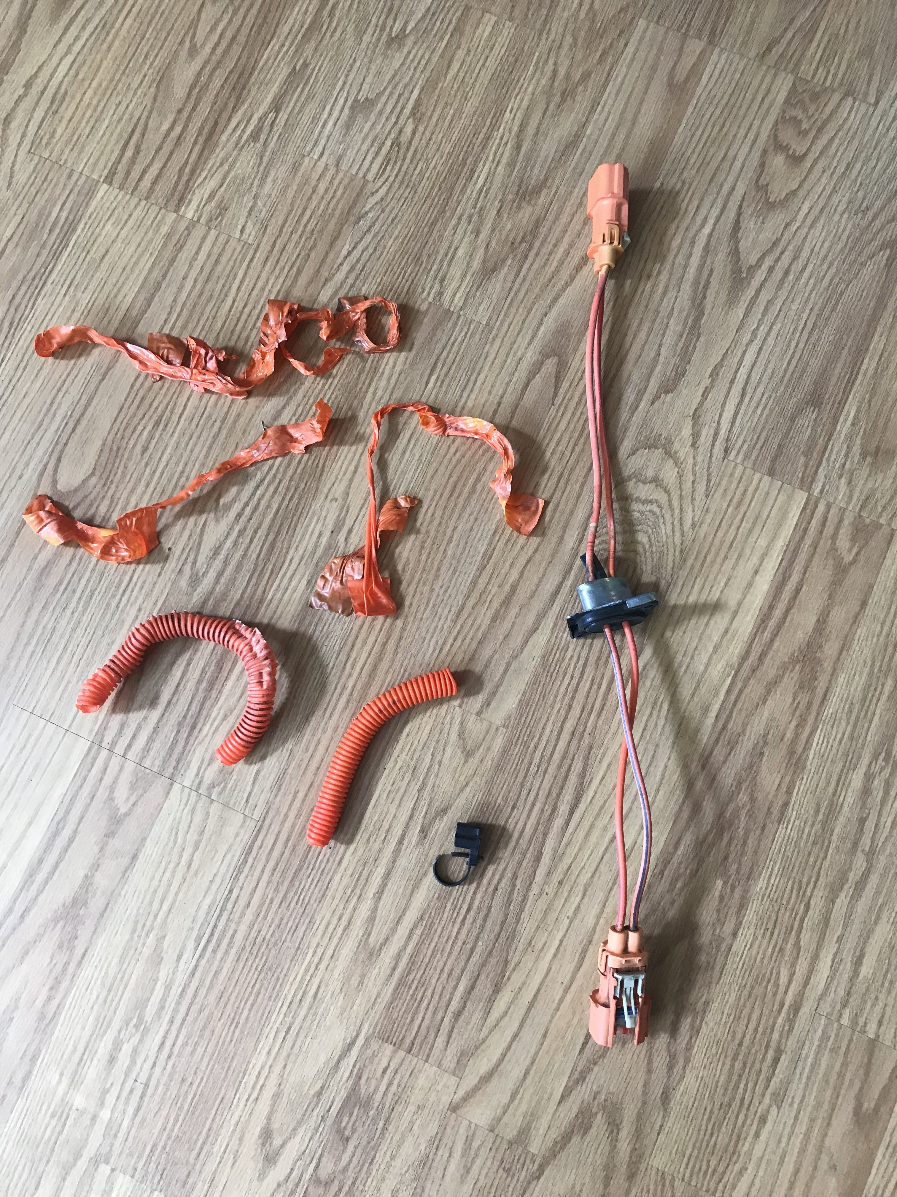

Re: I think I CAN, I think I CAN...
Posted: Mon May 16, 2022 10:25 pm
by Gregski
the General makes us use an Intermediate Cable to run from the Converter to the Battery Pack
Posted: Mon May 16, 2022 10:32 pm
by Gregski
so let's unwrap this serpent
Can you see it???

Gregski wrote: Mon May 16, 2022 10:13 pm but, But, BUT !!! hold on a second...
OH, i am sorry, when i got mine it was the unit with the cable attached. It was clearly marked with color stripes, so there was no need to inspect for polarity then.
I guess lesson No. 1 would be to assert HV polarity with all units that you are going to use. If i would be smarter then i would save myself some burnt hands as well as busted charger :). I take that lesson to my DUE board too as i use a large diode to protect against polarity reversals.
