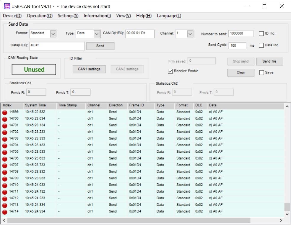

here is the screen shot and if I recall correctly even if you type in just a two byte ID it automagically fills in the other two bytes to make it a four byte IDarber333 wrote: ↑Wed May 11, 2022 3:54 pmYes in general you should be fine if Canalyst is blinking its leds. That means it is receiving CAN traffic. Can you post a screenshot of your send/receive screen? I dont have that DCDC with me anymore, but i can still help...
EDIT: that got me thinking... when you post ID into Canalyst you have to make it in 4 byte length for "standard" length (not extended).
So for ID 0x1D4 you would put it like 00 00 01 D4. Try it...
Msg repeats in 100ms intervals. Example from my AC compressor...

Type in : 1D4 (one byte and one nibble)

You do not receive anything from DCDC. You did not even open the interface. You need to open the interface in Operation menu.
Can you connect another component to the same bus that you know it transmitts some telegrams? Maybe a charger? It seems like you are having similar issues than me from the start.
Also try changing CANH and CANL cables position. Maybe you mixed them up. There is no danger in doing that. You just dont receive anything from the line.
I am not directly familliar with this interface. It is a different software.
When you connect Canalyst to your bus does its CAN1 port LED lite up and blink continuously? That means communication is being received regardless if you have connection open or not.
Also try opening CAN bridge between both channels at 500kbaud.

The interface was open as you put it, this was just a screen shot I captured of the traffic I was trying to send to show you the format of the frames
Question: does the converter expect a minimum voltage from the battery pack?

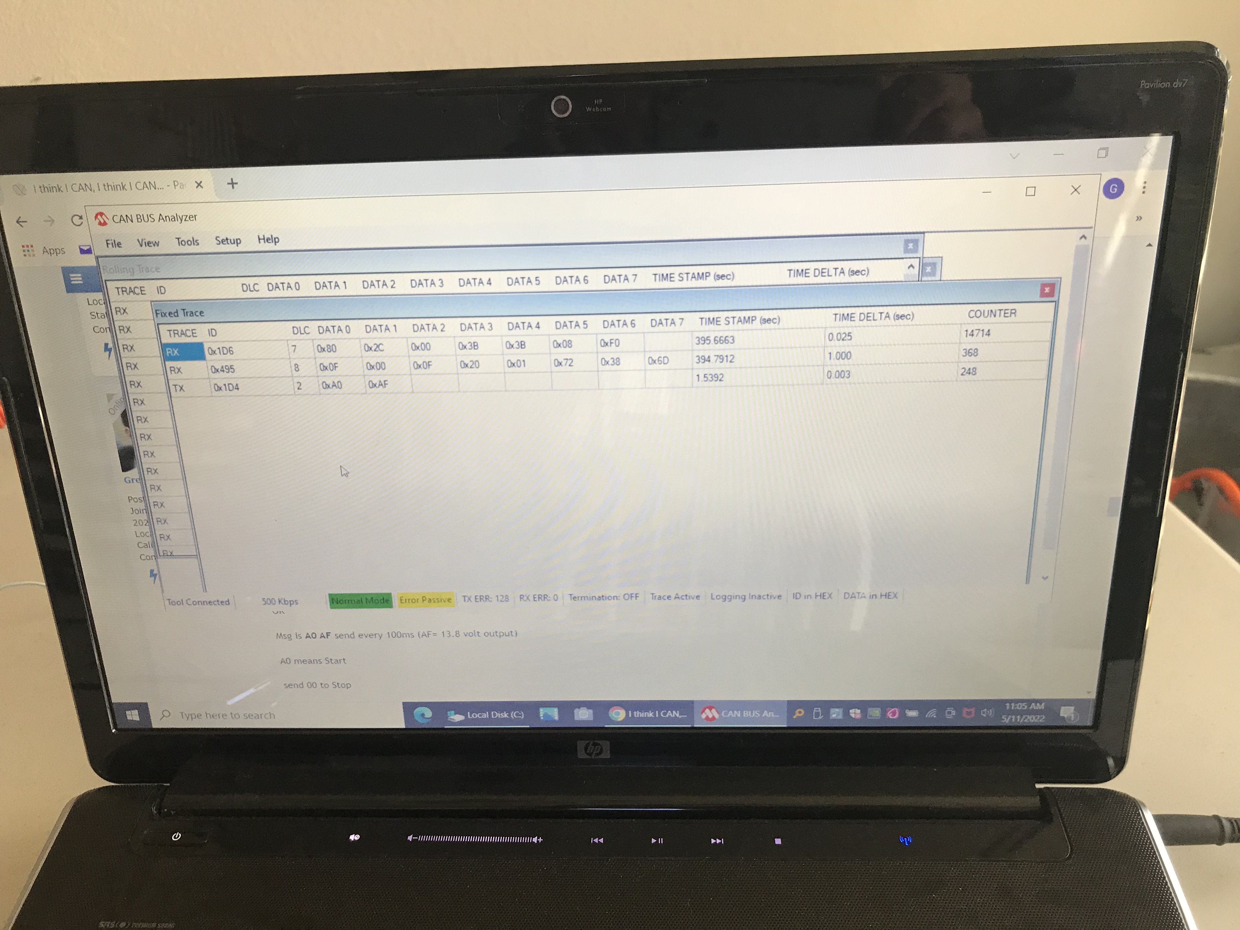

so I wanted to let you know that I also gave the Microchip a second shot (wanted to test and see if it will work with only sending one command) this time with the Chevy Volt first gen DC-DC converter and it still did not work

That's a shame, it looks like it should be a good option.
Have you tried connecting it up to one of your other CAN dongles to see if that sheds any light on what it's doing (or not doing!)?

the darn thing itself claims to be sending CAN messages, I have a case open with Microchip Tech Support and they have replied and asked me to try it with a different device, so I emailed them back and said now I have tried it with both the Chevy Volt first gen charger and the first gen DC-DC controller, neither seem to work

I had the opposite problem, SavvyCAN claimed it wasn't sending anything but I could see 1000s of messages on the canbus lines! You need to able to see what's actually happening on the bus to diagnose it, fortunately you happen to have a few other canbus dongles!
I'd connect the Microchip one directly to one of your other dongles (with nothing else on the network). That way you can see exactly what it sends out by monitoring it using the other dongles software and also send messages back in to see if it receives them.
Might be a faulty unit?
Got to say the more I use SavvyCAN the more it impresses me, you can tell the software was written by someone who also used it.

Just noticed from your pictures that it's reporting an "error passive".. I think this means that it's not getting an ack back from the charger (same problem I had), is it definitely set to the right baud rate and are the can bus wires the right way round?
Edit - passive error can be caused by the Tx seeing bit errors as well as missing ack, appears to mean it can't get a message onto the bus - no real surprise there then!

I believe so because it reads messages just fine, which makes me think the high and low wires are connected properly and the termination is on, this guy has software controlled resistor terminator thingie and I tried it with both on and off, it is on in this case

If it receives messages then that suggests it is connected right, comes back to not getting an ack back from the charger. This could be the dongle isn't actually putting message on the bus or it is getting it onto the bus but the charger doesn't like something about it. In the later case connecting it to another dongle might give more information,
It's starting to sound like a duff transmit line on the unit (given that the chargers work with other dongles). Don't suppose you have a scope handy?

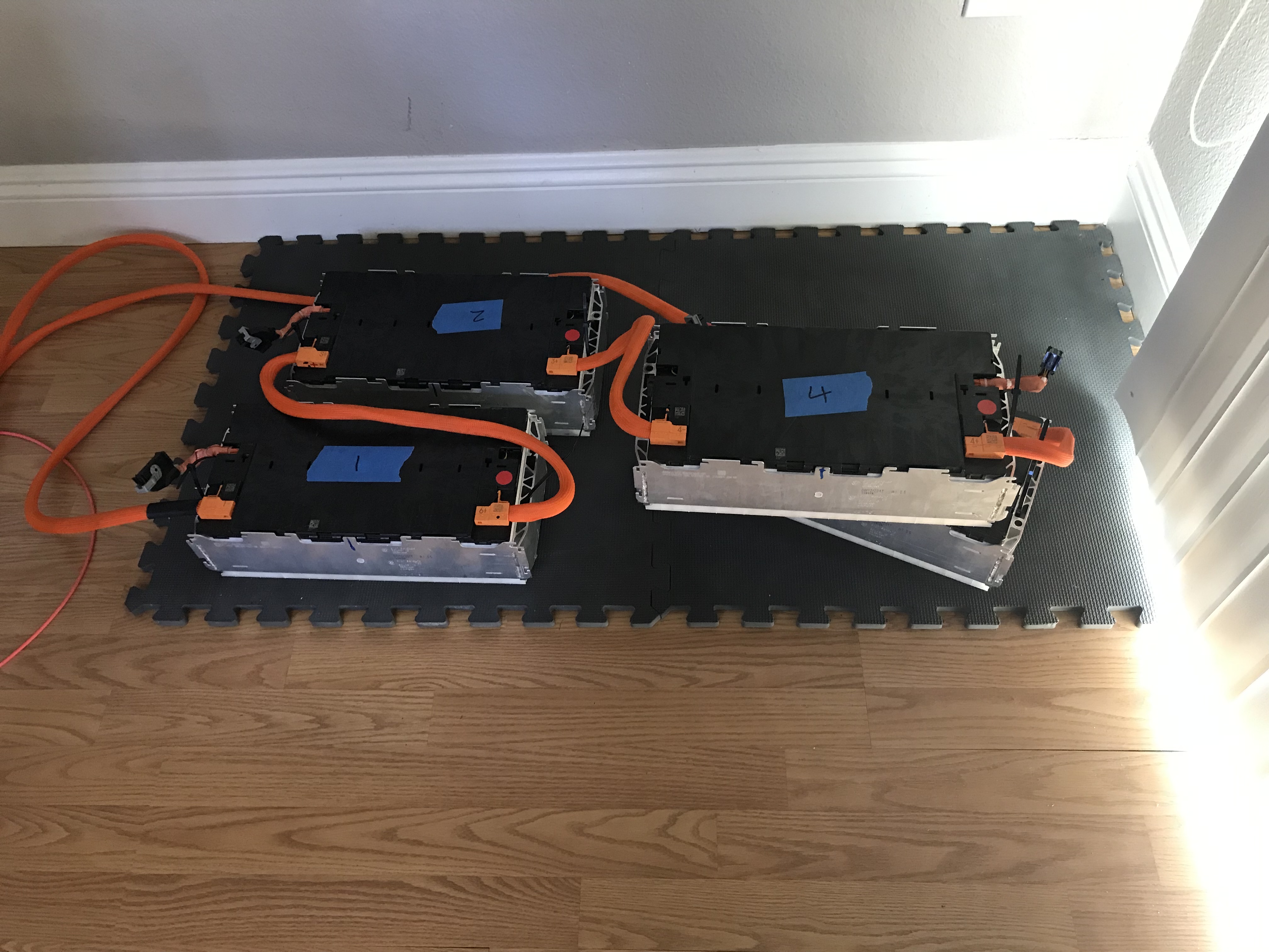

Full disclosure I am only using six 60 volt BMW 530e cell modules at this juncture [don't ask what happened to the other two] so a total of 240 volts going to the DC-DC Converter, could this be the issue?

True! I belive Volts charger and DCDC start to work from 280Vdc onwards. However i know for sure Volt inverter innards can work with 60Vdc just fine.

Alright I just tried SaavyCAN with five 60 volt cell modules and a measured 289 volts and no dice, still does not work. Is there a fuse inside the DC-DC Converter? If so maybe that is blown?
