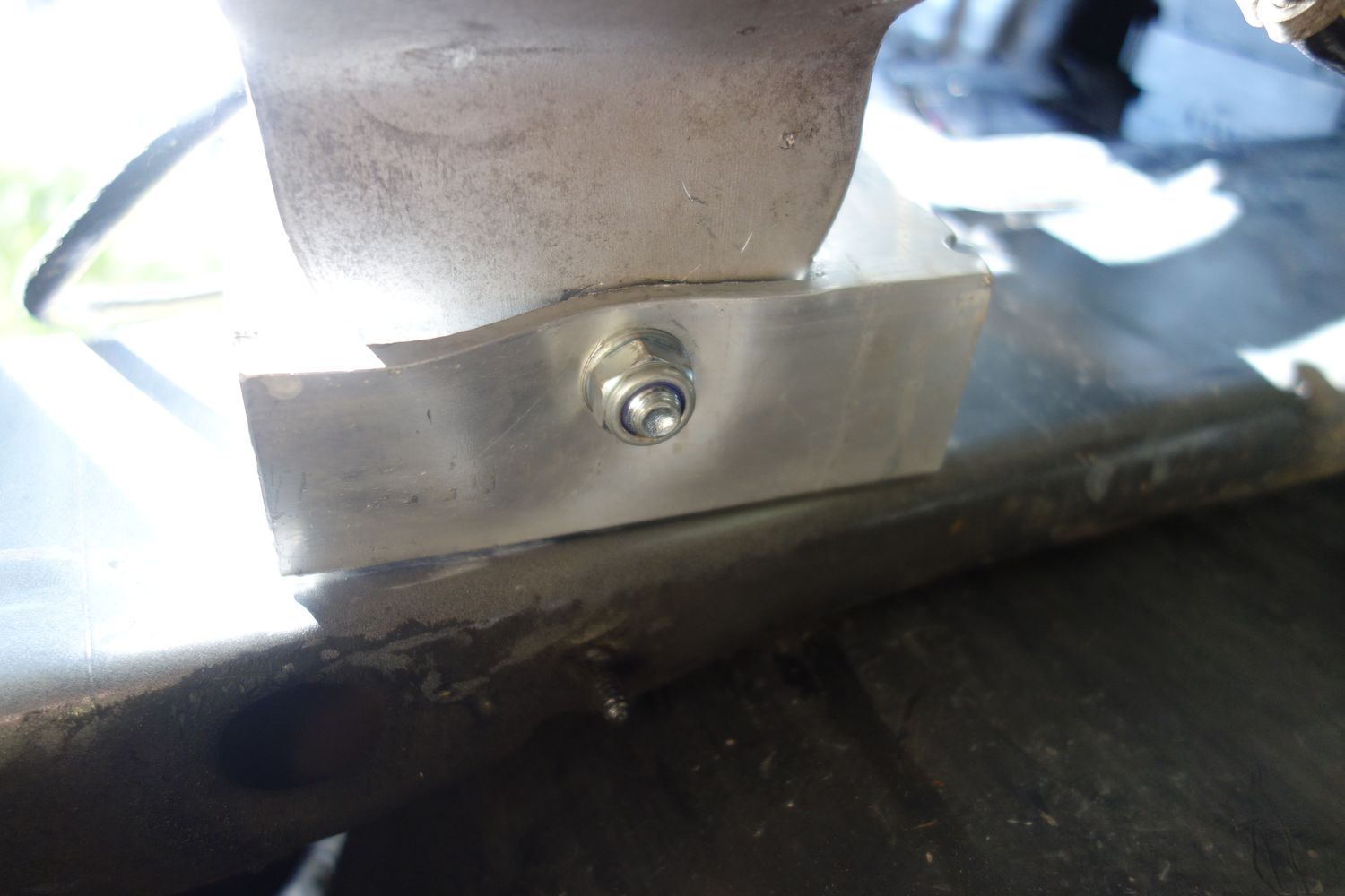

Too much torque!
Why didn't I extend that further to the front :twisted:

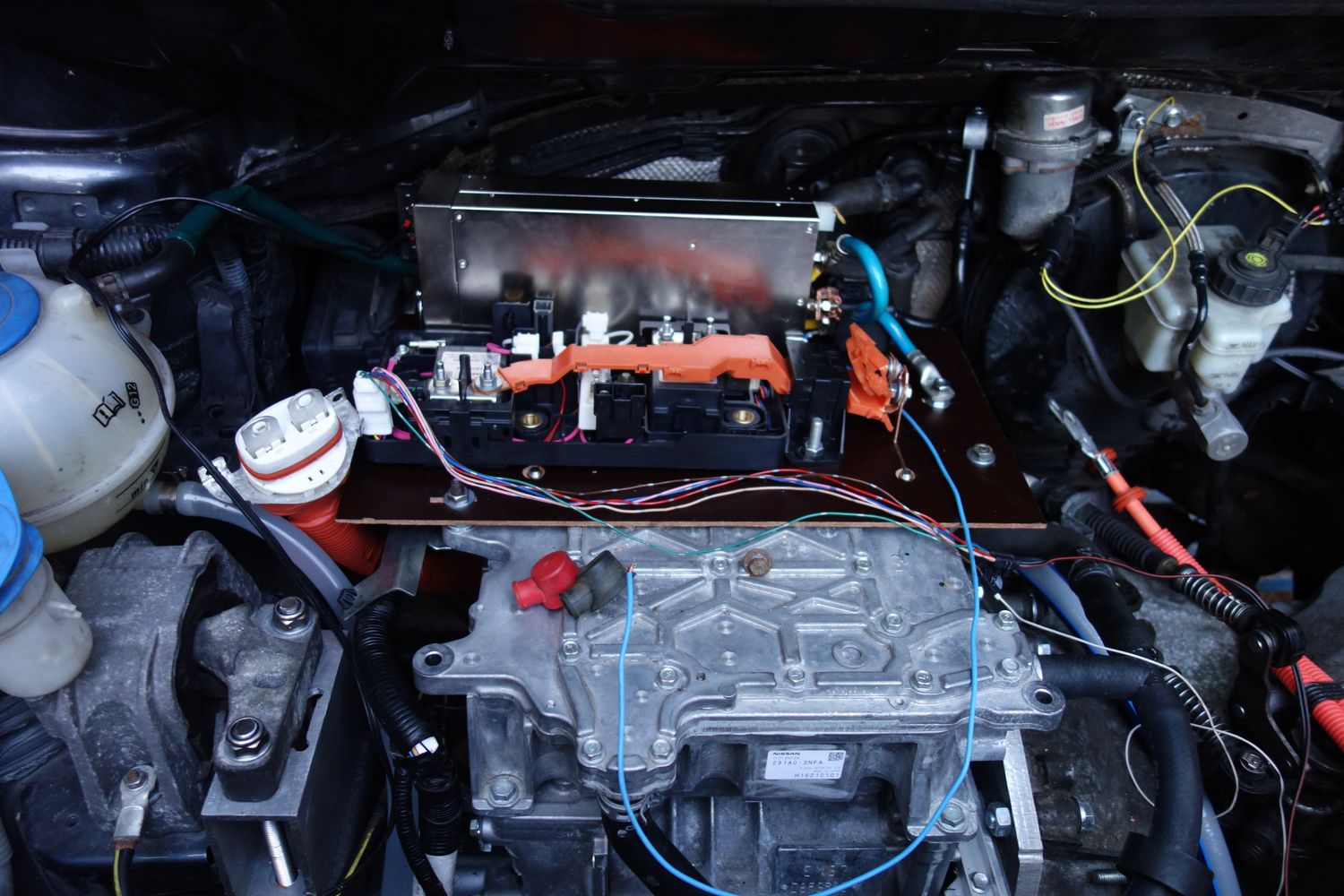

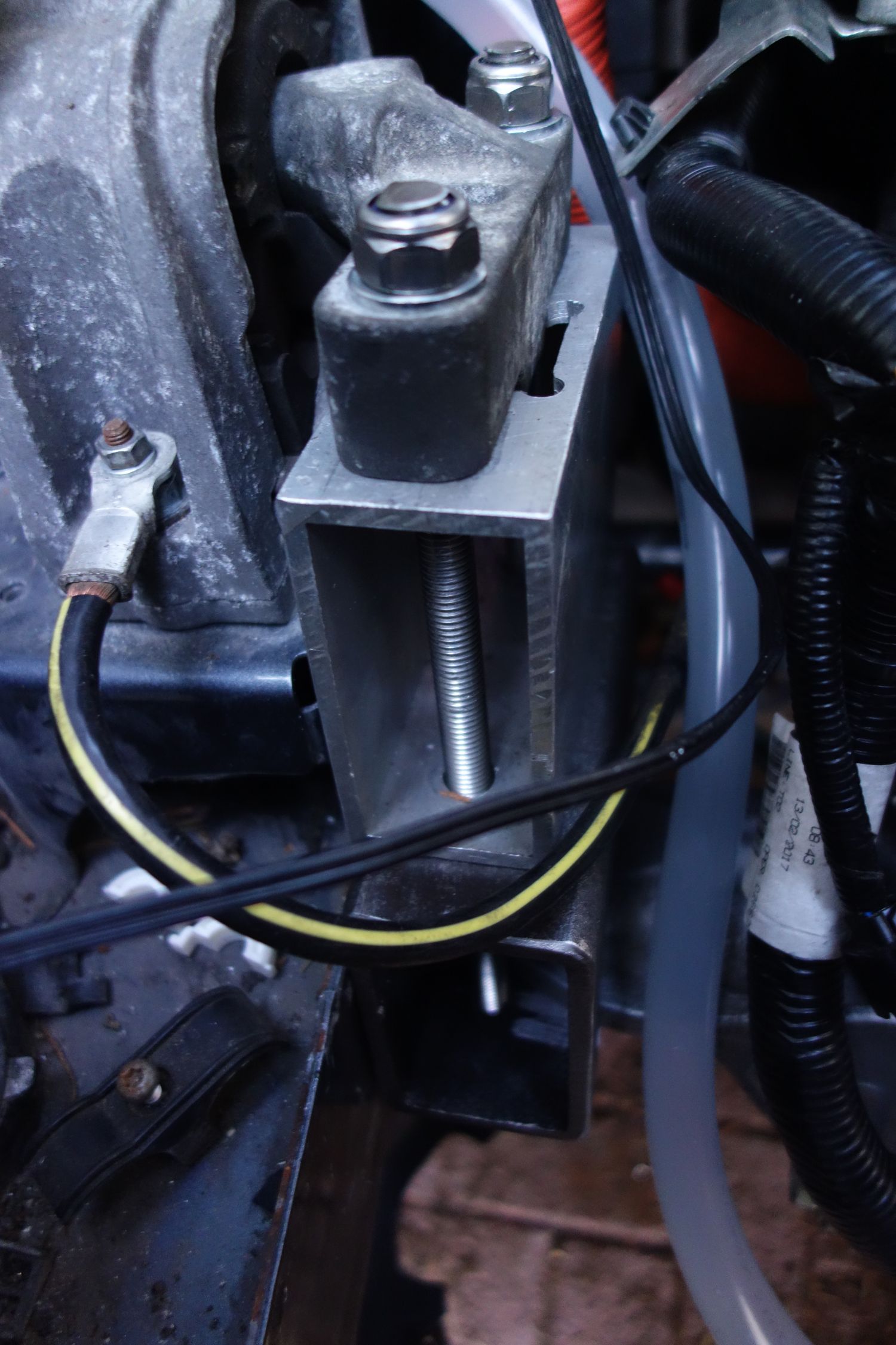

Yes, used steel now :) Same construction as last time but the lower box profile is steel and an M12 threaded rod runs all the way from top to bottom. The the remaining aluminium box acts more as a spacer now.
Also installed DC/DC converter and switch gear on to of the inverter. Plan is to mount another battery brick in front of it to sort of seal it off.

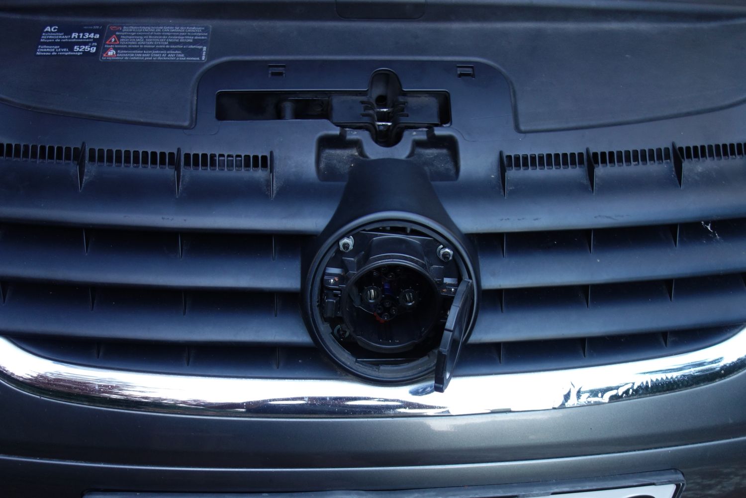

Some weeks before I installed the ChaDeMo plug where the VW sign used to be.

Have you tested the ChaDeMo charging yet?
I read somewhere that you and Damien are going to get CCS later on, is it possible to have CCS and chademo fast charging plugs at same time, without the chademo-tesla adapter?
Do you plan to make the chademo/ccs parts available in shop?

No Chademo plug is just mechanically fitted. I plan to implement the protocol on my custom SMT32 "ECU". The latter is a Rev 2 main board that I mounted in the case of the cars original ECU because there is access to CAN bus, throttle, etc.
I've dropped CCS plans for now but I'm sure you could implement both in one vehicle.

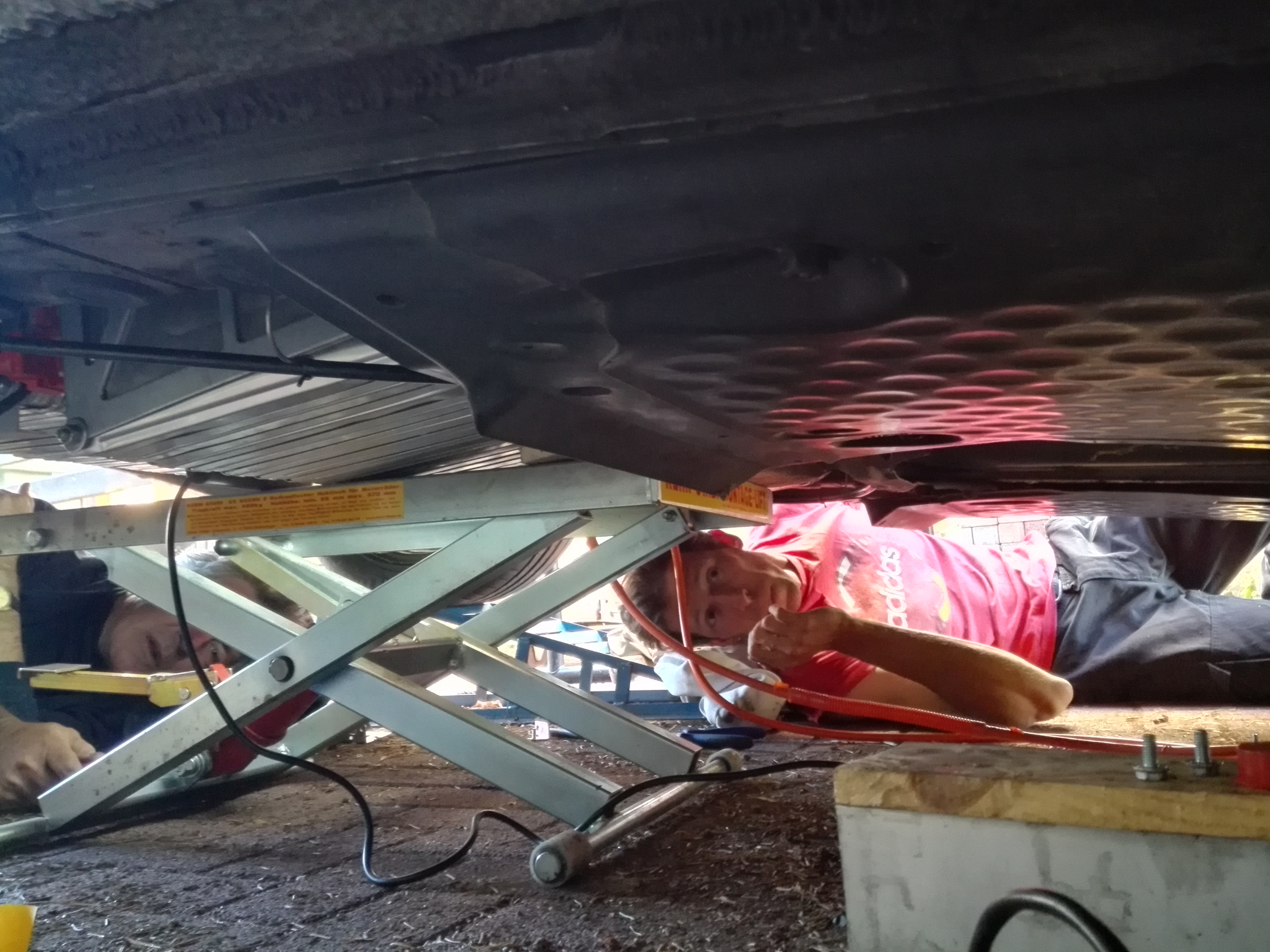

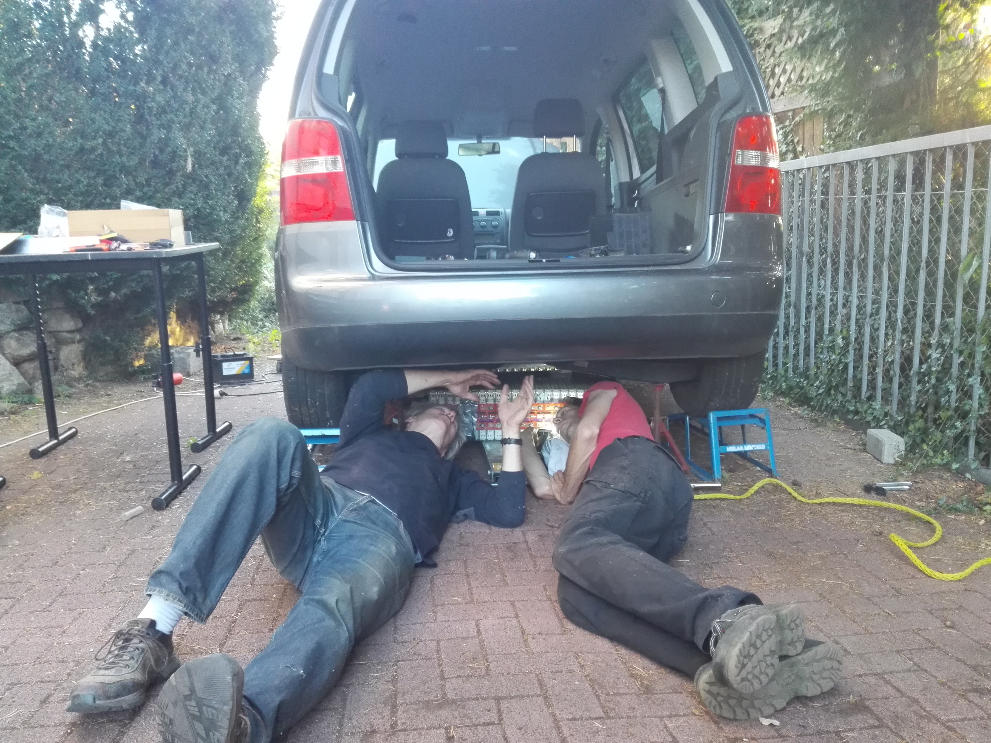

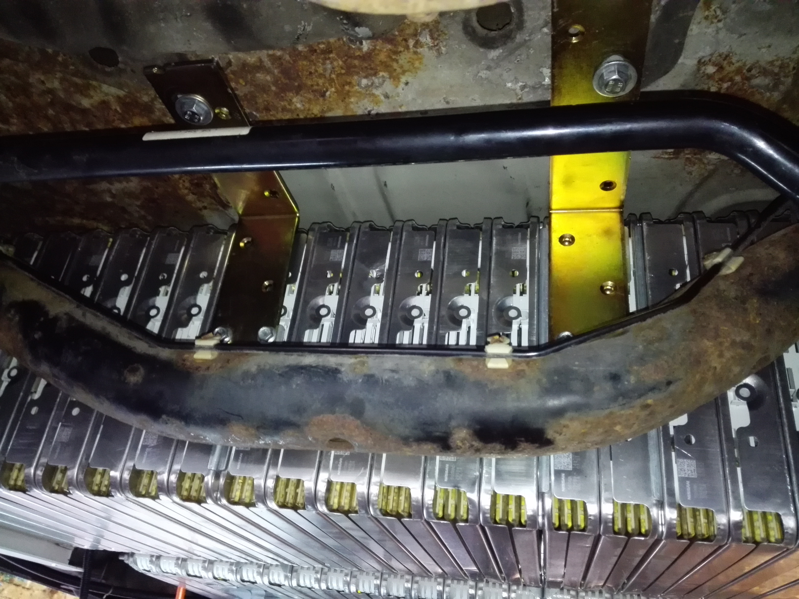

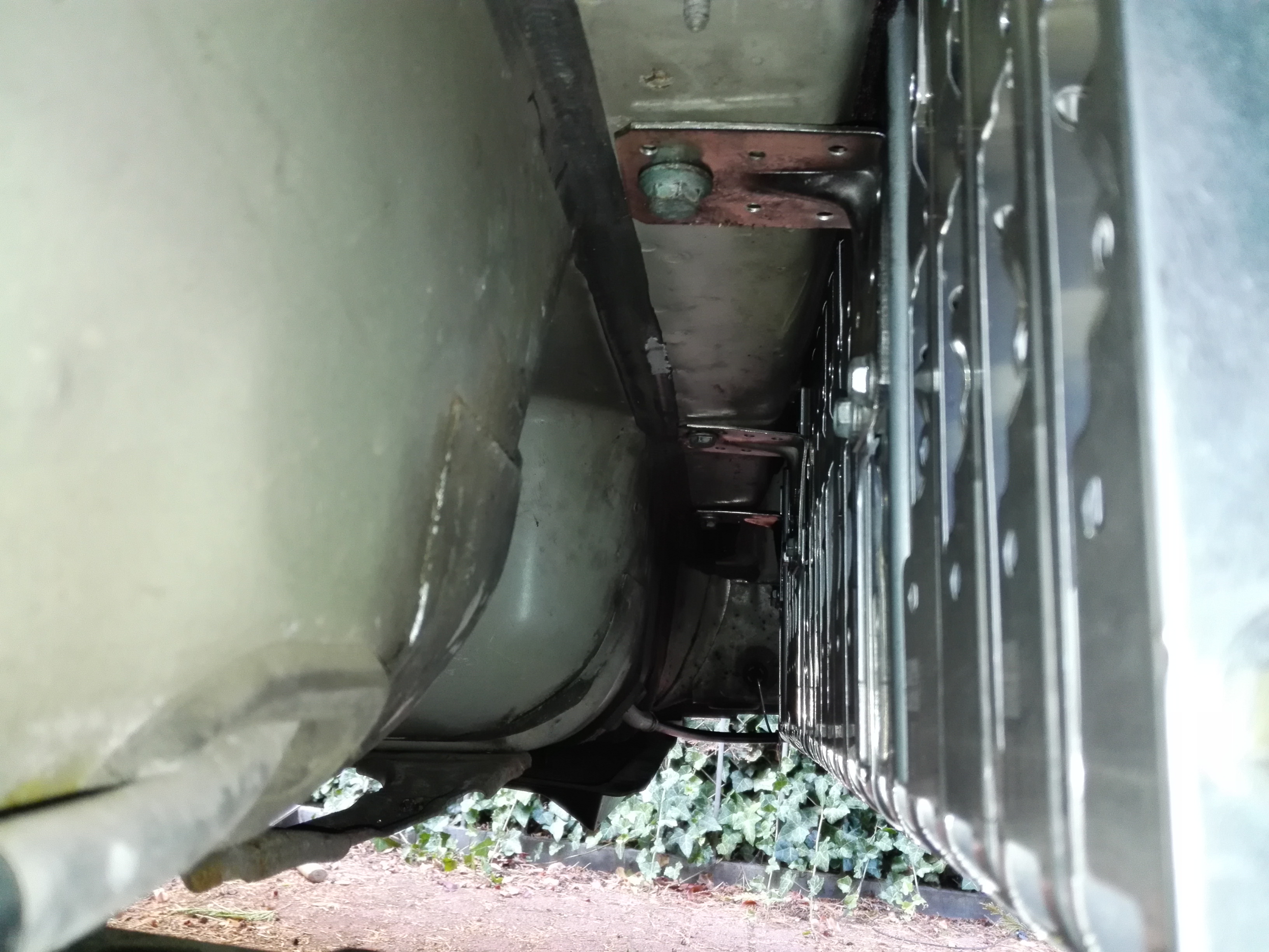

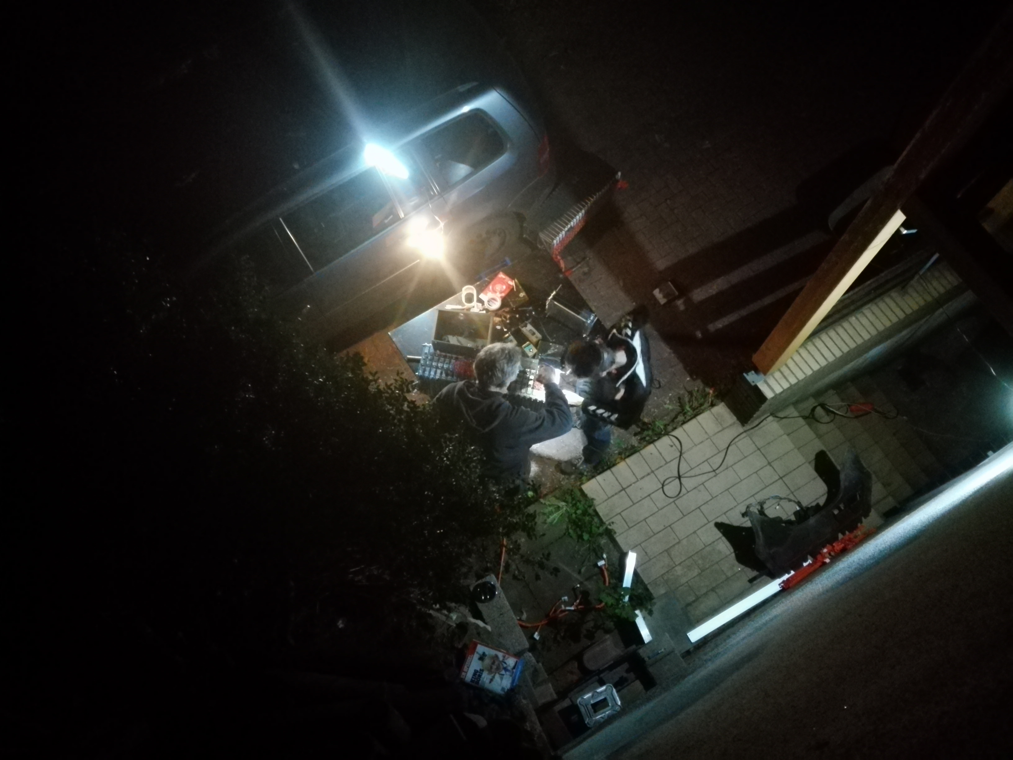

Big milestone reached today with a lot of help from my father: the second battery brick is installed in the fuel tank region :D Unfortunately no detailed pictures yet as my father accidentally took my camera with him and I just have the ones from my phone.
It took us 2.5 days straight work from dusk till dawn.
  • Arranging the modules so that the ones with fastening bolts are in the correct position
  • Taming the Leaf spaghetti wires for the BMS
  • Lift the module check, spot a problem, drop the module, solve the problem, lift the module, see the next problem, repeat...
It was about the ugliest and tightest thing I have ever done. Constantly something was in the way and in the end we found another 8mm that would move the modules further apart from each other. Now the screws from the module poles are spaced by about 15mm. I had to get between them with a 17mm nut while not producing any short circuit that would either melt my tool or set the car on fire. Of course everything was wrapped into duct tape but still it was not a comfortable situation to be in :twisted:
I like the end result though, now a full Leaf battery pack is mounted under the car with no interference of the cars interior what so ever. Even the spare wheel is still in. I will get the car road legal and then decide whether to permanently mount the second battery pack somewhere (engine bay, spare wheel well, exhaust tunnel) or just whack it in when actually going on long trips.
The fuel tank region will be fully covered with sheet metal and likewise the exhaust tunnel.

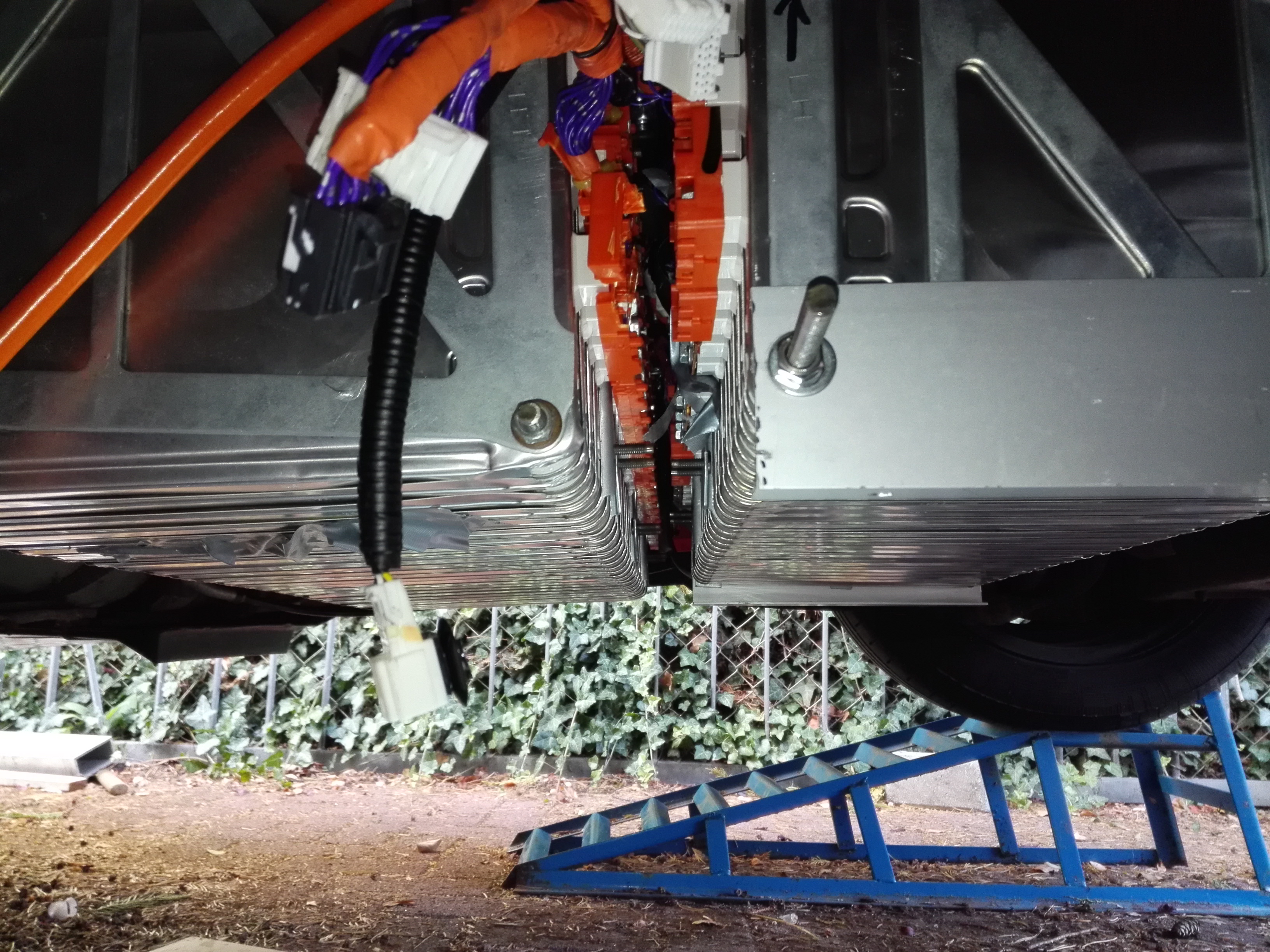

Took some more pictures today.
Also redid all the wiring. B+ and B- no exit cleanly via cable clamps and I also bolted Nissans service disconnect/fuse assembly to the side of the first battery. Switch gear now lives in the exhaust tunnel and from there Nissans original cable runs to the inverter.
The original charger would be a perfect fit now as all cables end up in the correct position. But I still find it too bulky and it seems it doesn't even handle the ChaDeMo protocol as I found nowhere to plug in the control signals.

Yes cell order would be great. I completely used the "harness" of the rear (as in the original battery case) battery brick but am not sure whether it is rotated by 180°. The cables exit at B+ so that would be an indicator. The two side packs contain two wire harnesses with 24 taps each. I started out at B- with the longest wires and worked my way to the shortest ones.
For puddle protection I will install sheet metal that will extent from the exhaust tunnel all the way to the rear axle at the full width of the fuel tank compartment. Between the two bricks I will put a rubber mat or something and at the sides will put some sort of plastic.
