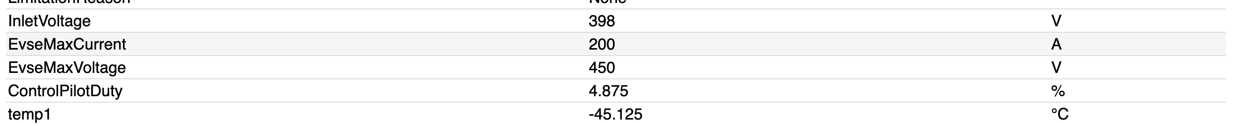

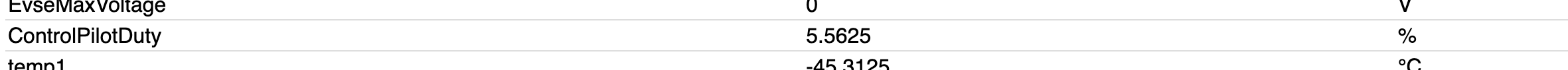

My first attempt at CCS charging, having successfully used FOCCCI as a charge interface for AC charging, resulted in failure.
I've attached my params and UART log, if anyone spots anything that might be causing it.

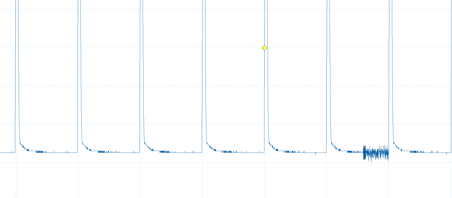

Re: QCA7000 Foccci+Clara User thread

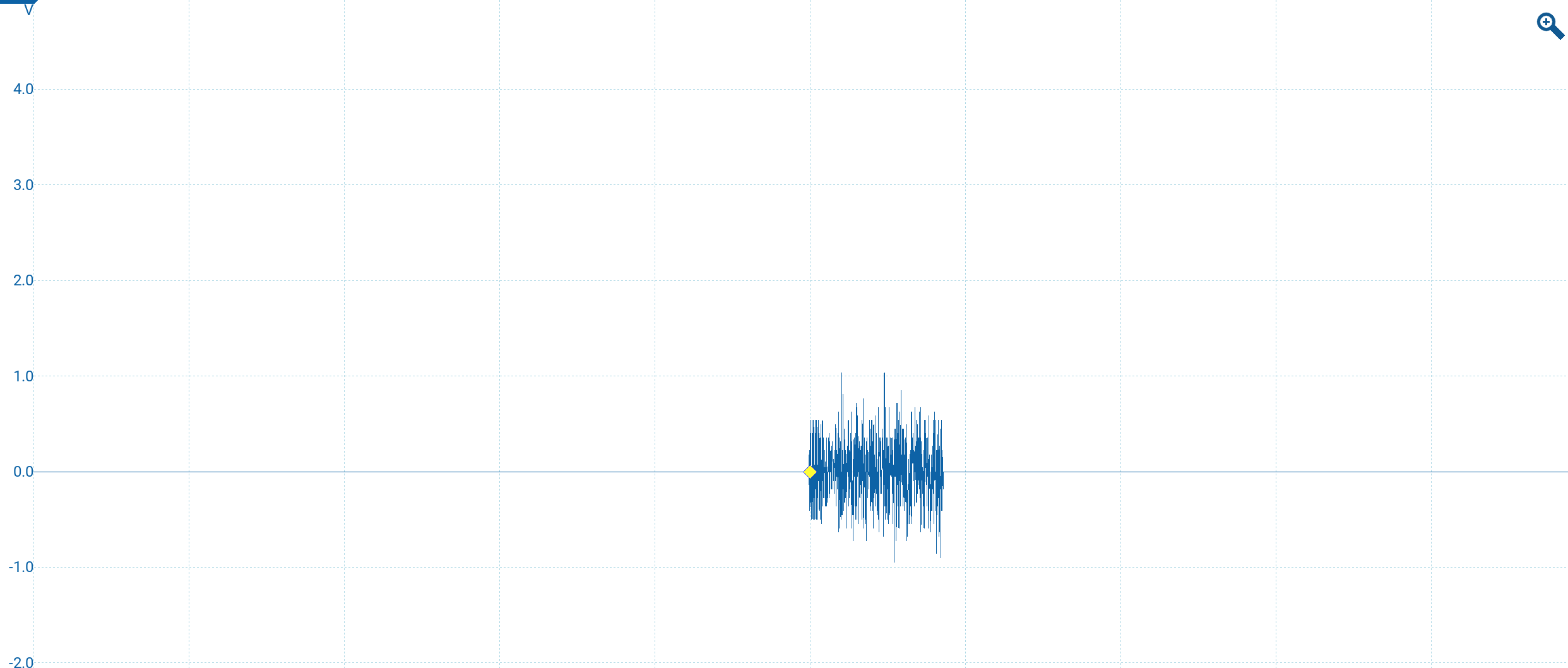

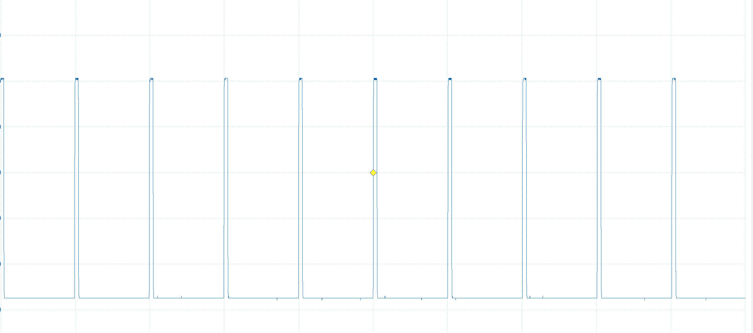

I've now setup pyPLC on an RPI to investigate further.
So with the scope attached to the EVSE side modem output I see this repeating signal. Bringing in the PWM with resistor and capacitor this is what I see, this is without FOCCCI connected. So looks like the EVSE side is working.

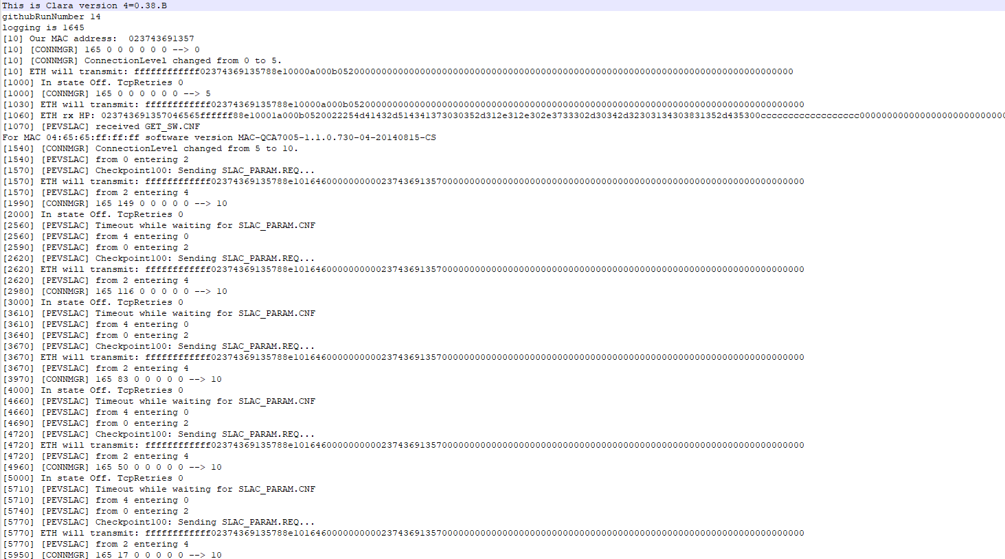

On to FOCCCI
We see the PWM, the UART log displays that it's sending SLAC_PARAM.REQ and timing out.
Without the EVSE modem attached the 5% PWM is clean, no sign of any signal modulation. So looks like I need to look further in to my board. It's a v4.2
EDIT*
so TX_N and TX_P are at 1.6v but 13kohm between them. RX_N and RX_P are at 0.3v and 500ohm between them. Any hints on where the shorts could be?
On to FOCCCI

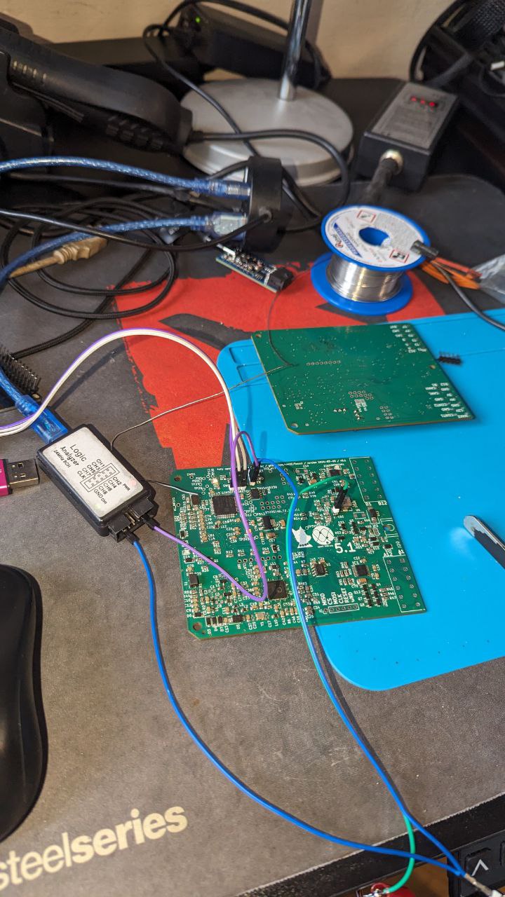

Have you manually placed the QCA? It is super tricky. My faults of the kind you describe were 100% caused by poor soldering.
- Posts: 1884
- Has thanked: 91 times
- Been thanked: 517 times
I did and I never want to do it again. I thought because it was reporting modem found I was good, but guess not.
Soldering attempt number 9000 did the trick.
