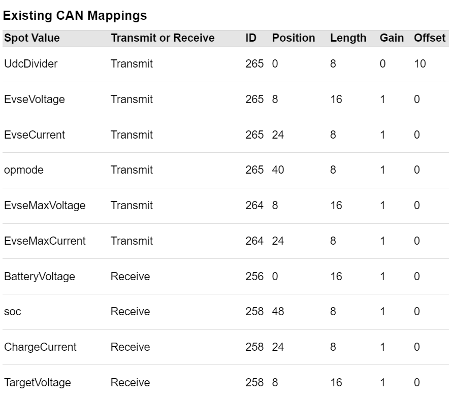

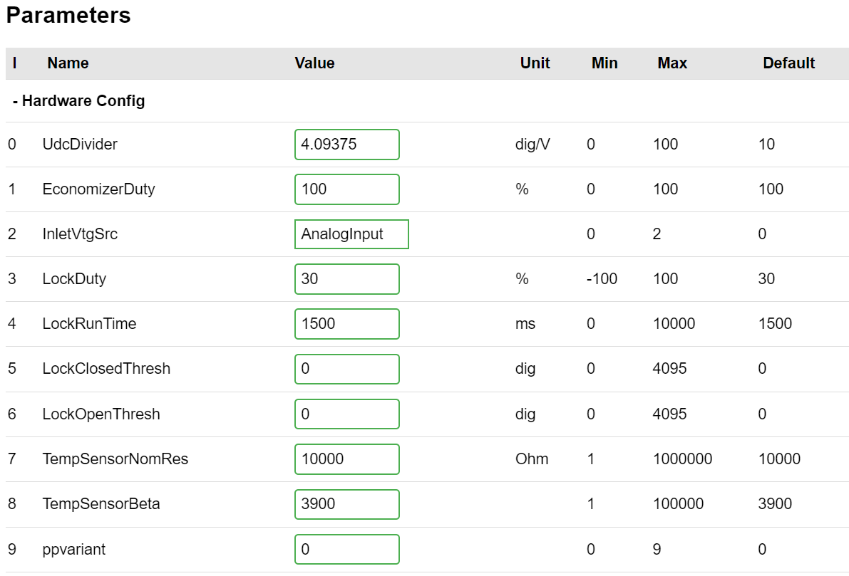

Can you post a screenshot of CAN mapping and Parameters page? And tell us the values you are sending and where

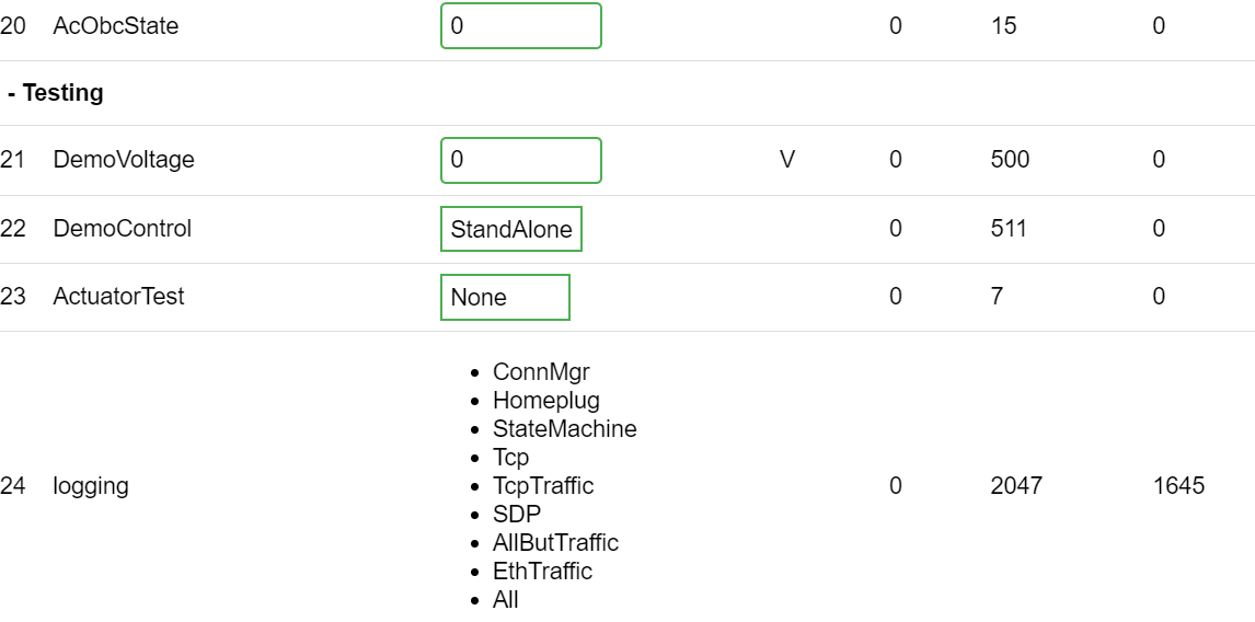

Screenshots attached. HV was off. Inlet voltage from sense board(charger side of contactors) reads correctly when contactors are closed and HV on via test. CAN messages batvtg, targeting, chargecur, SOC are being broadcast to the addresses mapped by my Orion2 and are being ready successfully by my datalogger.
- Been thanked: 1913 times
Re: QCA7000 Foccci+Clara User thread
looks correctly mapped. Are you seeing Clara messages in your CAN logger also (0x108 and 0x109)? Suspecting a physical issue
You configured demomode to standalone, this leads to ignoring CAN Input.
Overlooked that. But it wouldn't actively suppress reception (and display)?

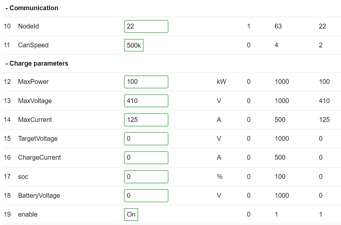

Hi All, I recently purchased, as part of a larger project, the FOCCI board as well as the esp32 interface board. Since removing them from the packaging, I have connected the can pinouts (with 120ohm terminating resistor) of the FOCCI to the esp32 and have wired a 12v connection to both. I have been able to access the web interface, however this is where my progress ends.
TLDR: What is the procedure for configuring the esp32 with FOCCI and does this documentation exist somewhere? Long story: Based on the existing screenshots/documentation, I have been unable to understand where the web-interface sources the spot values from, and therefore have been unable to configure the can mappings. In addition, I am being given a "connection problem between esp and stm" error on the page. Must I run some sort of demo/test session on the FOCCI board to expose the esp32 board to it's data points?

Where it says "Node ID" in the left navigation bar you need to enter "22". then wait a few seconds and turn on refresh. It was discussed before but even I can't find it right now
I see the parameters now, thank you again! (It's always the little things XD)

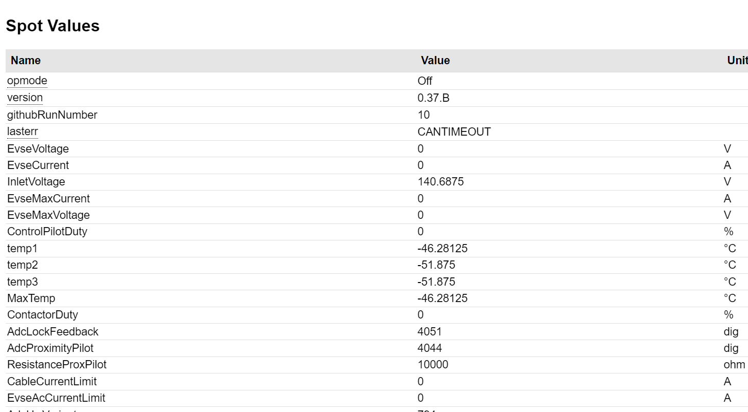

No CAN activity on 0x108/0x109 regardless of DemoMode setting. I'm assuming the CAN link must work though if the ESP32 board communicates?

Any further thoughts on avenues I can investigate on my board? If not, maybe I can purchase one of the new boards on the Web Shop. First race is coming up shortly and I dread the though of once again renting a big Diesel generator.
Well if the Wifi adapter has a CAN connection to Foccci but Orion does not then check the CAN Link between the two and connect your CAN dongle to various junctions to see where data is lost.

CAN communications are now working! Spot Values are updating and there are no time-out errors! Just a case of faulty troubleshooting on my part....! I'm ready to attempt a real charge session now.

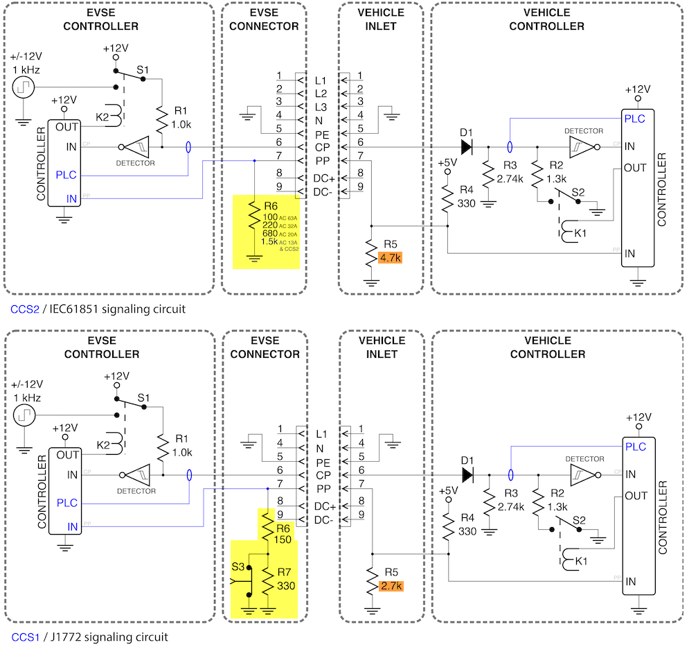

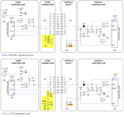

I suspect that it is the PP line. I'm in Canada and it sounds like the PP requirements are different between CCS1 and CCS2. I will try changing the pullup on PP to 330 ohms and 3.3V with a 2.7K pulldown to ground. I also so some other discussions on the forum about another 47K to ground? I don't understand the purpose for this and where it should be placed. Do I need to change parameters?
The connection attempt was repeated many times and the results were the same. Unfortunately, I do not have the luxury of trying a different station as I have a non-street legal race and need to connect to the PhiPhong charger at the track. If it's any help, I know that a Tesla M3 using a Tesla adapter charges at that station on a regular basis. I'm not sure if this is relevant, but the 1st time I connected, the charger reported EVSE Max Amps as 140 amps. For subsequent connections EVSE Max Amps was 32A.

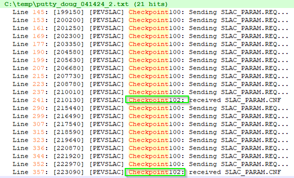

Did more testing today, but no success. I modified the PP circuit to add the 330 ohm pull-up to 5V and a pulldown to ground (tried a couple of values in the 2.2 to 3.2k ohm range). The charger faulted out very quickly. The Opstate stayed at 0 and SOC was not displayed on the charger. I did not receive any EVSE values. I confirmed that the charger had a 150 ohm resistance between PP and PE and 480 ohms when the release button was pressed. What value of ppvariant should I have been using? What does this variable do?
- putty041424_2.txt
- (31.34 KiB) Downloaded 1319 times
No communication this time, undo last change...
ppvariant is just relevant for calculating cable capacity for type 2 cables. Can't be the culprit. Have you checked your port contactors that they are not stuck? Iso resistance of port? Does CP measure fine seen from the port? Test also with ActuatorTest=StateC

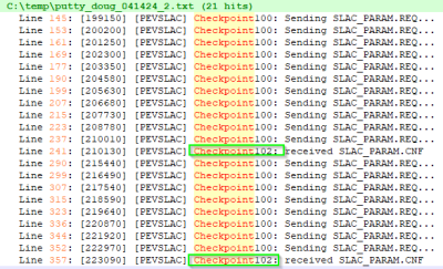

In this log, the best checkpoint number what we see is the 102, this is at the very beginning of the SLAC procedure.
For me this looks like that the communication on the CP line is nearly impossible, we only sporadically see a response from the charger.
This is much worse than the other test, were the high level communication was established and we ran until the cable check.
