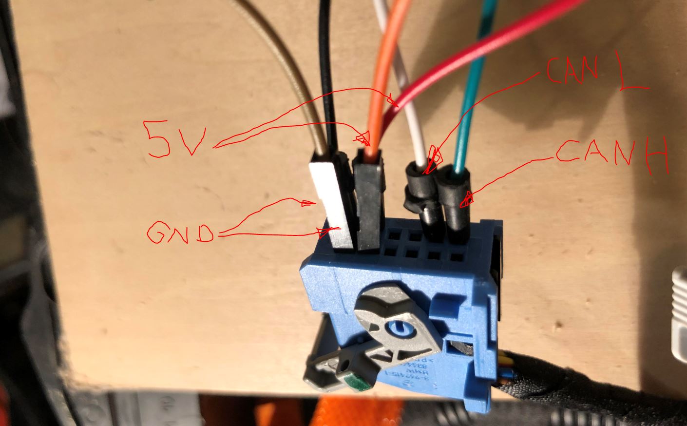

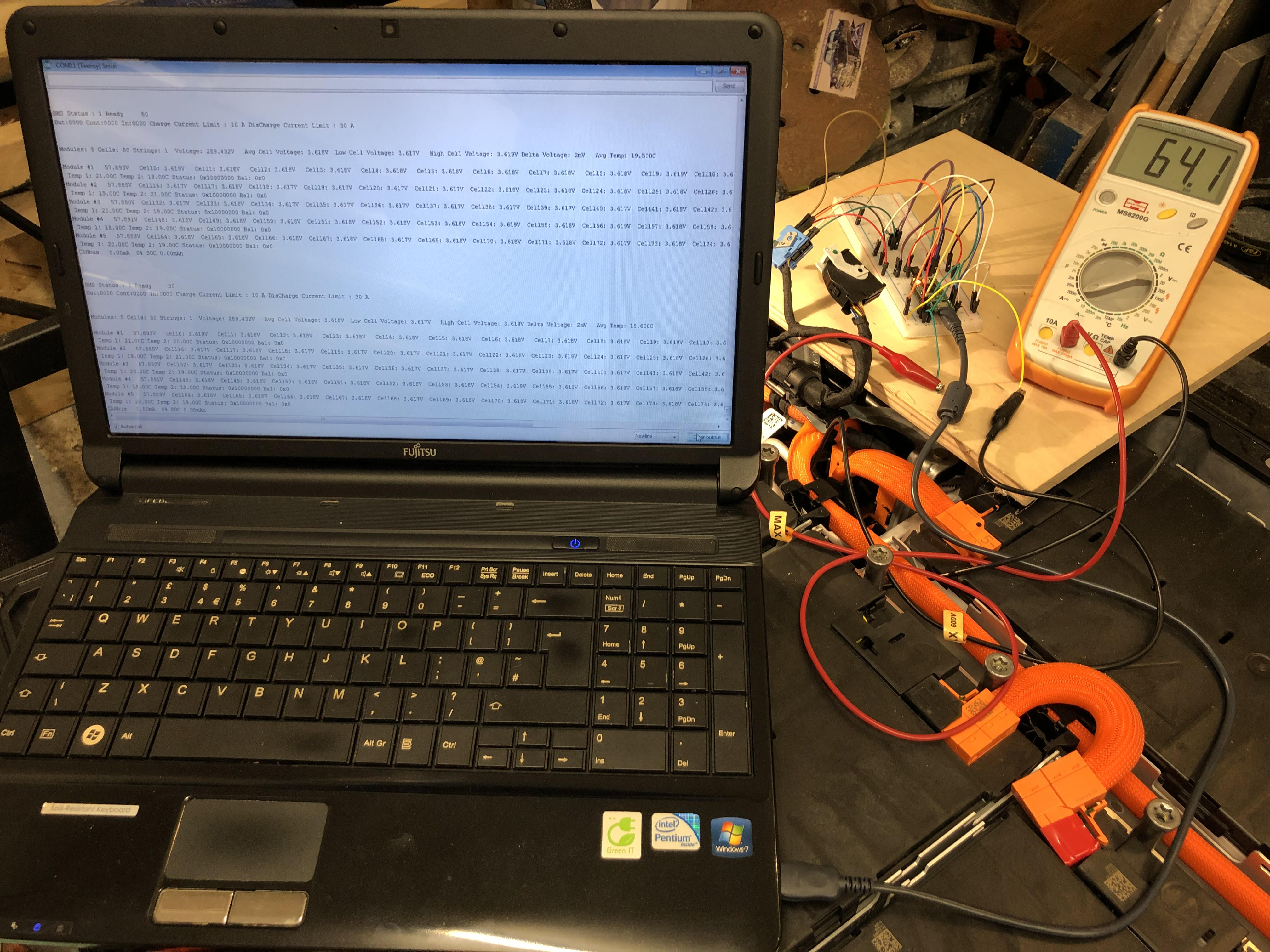

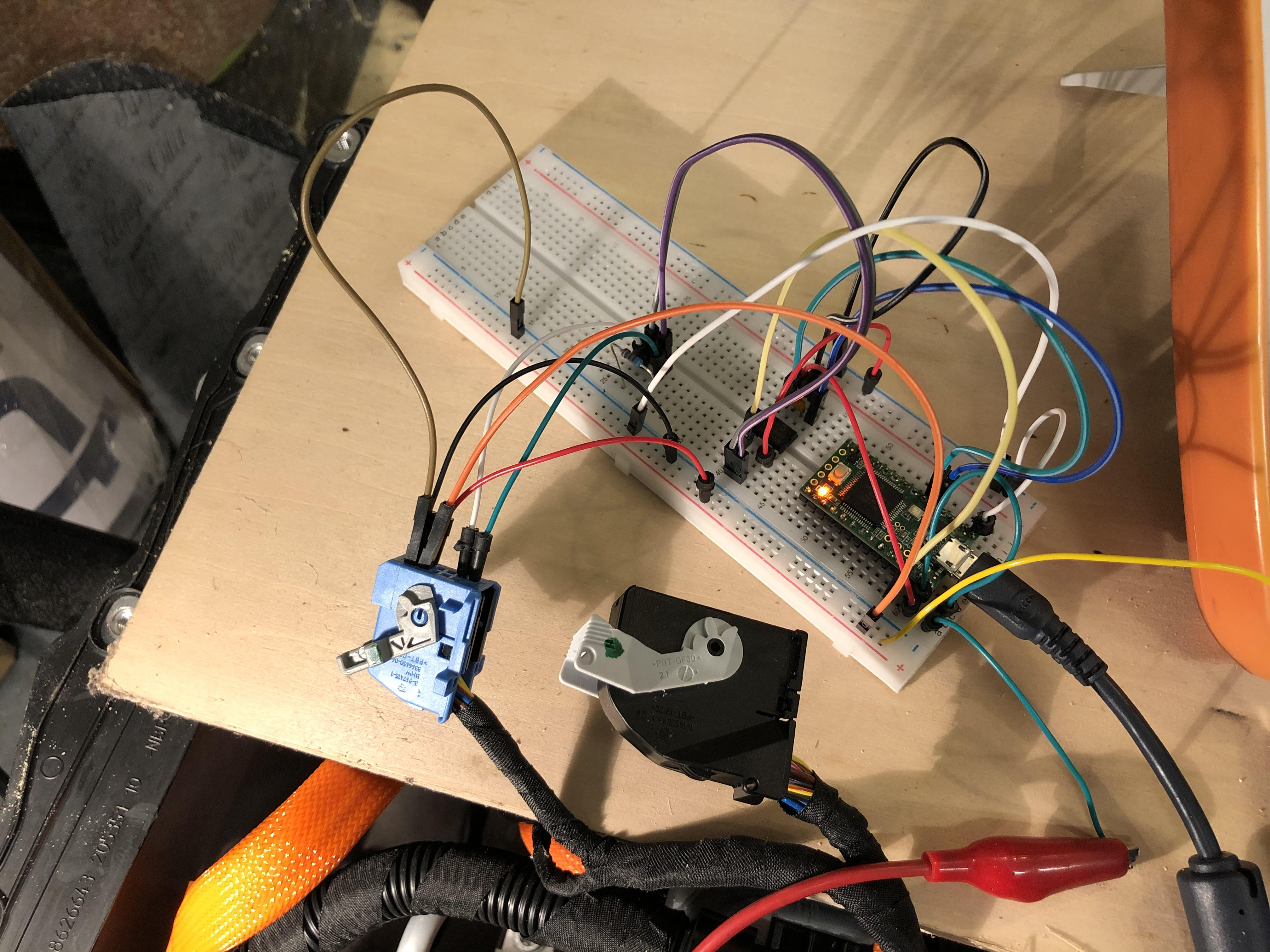

Got to my pack, connected a MCP2562 transceiver to a Teensy 3.2, loaded SimpBMS BMW PHEV as per Tom's posts above (latest version) and connected as below. Success!! I can see all the modules and cells and its a healthy pack. Couldn't test balancing as my pack seems well balanced (2mV delta), which was a surprise given it has sat untouched for many months. I assume it can't balance disconnected from the vehicle?
A few pics of my setup and links if that is any help to anyone below.
Transceiver (I used 2562 and connected VIO to 3.3V):
http://ww1.microchip.com/downloads/en/D ... 05167C.pdf
Tom's code:
https://github.com/tomdebree/BMWPhevBMS
I disconnected the BMW BMS and connected in to the blue connector:
You can see from this picture of my breadboard I had to terminate the CAN lines at the transceiver with 120R.
The 3 first modules power and CAN is separate from the last 2, so needs two sets of 5V connections.
The CAN lines for the 3 and 2 module sets also "seem" to be separate, measuring the continuity of the CAN lines to the modules and this connector, but only one of the CAN lines for the first three modules needed to be connected to be able to see them all on that CAN bus. No idea how/why, but seems to work fine and means termination is easier. Perhaps I measured it wrong.
The 5V line takes about 64mA when enabling all 5 modules, so probably also powering some of the logic of those boards.
The output I recorded was:
BMS Status : 1 Ready     80
Out:0000 Cont:0000 In:0000 Charge Current Limit : 10 A DisCharge Current Limit : 30 A
Modules: 5 Cells: 80 Strings: 1  Voltage: 289.420V   Avg Cell Voltage: 3.618V  Low Cell Voltage: 3.617V   High Cell Voltage: 3.619V Delta Voltage: 2mV   Avg Temp: 19.600C
Module #1   57.89V   Cell0: 3.62V   Cell1: 3.62V   Cell2: 3.62V   Cell3: 3.62V   Cell4: 3.62V   Cell5: 3.62V   Cell6: 3.62V   Cell7: 3.62V   Cell8: 3.62V   Cell9: 3.62V  Cell10: 3.62V  Cell11: 3.62V  Cell12: 3.62V  Cell13: 3.62V  Cell14: 3.62V  Cell15: 3.62V
 Temp 1: 21.00C Temp 2: 20.00C Status: 0x0 Bal: 0x0
Module #2   57.88V  Cell16: 3.62V  Cell17: 3.62V  Cell18: 3.62V  Cell19: 3.62V  Cell20: 3.62V  Cell21: 3.62V  Cell22: 3.62V  Cell23: 3.62V  Cell24: 3.62V  Cell25: 3.62V  Cell26: 3.62V  Cell27: 3.62V  Cell28: 3.62V  Cell29: 3.62V  Cell30: 3.62V  Cell31: 3.62V
 Temp 1: 19.00C Temp 2: 21.00C Status: 0x0 Bal: 0x0
Module #3   57.88V  Cell32: 3.62V  Cell33: 3.62V  Cell34: 3.62V  Cell35: 3.62V  Cell36: 3.62V  Cell37: 3.62V  Cell38: 3.62V  Cell39: 3.62V  Cell40: 3.62V  Cell41: 3.62V  Cell42: 3.62V  Cell43: 3.62V  Cell44: 3.62V  Cell45: 3.62V  Cell46: 3.62V  Cell47: 3.62V
 Temp 1: 20.00C Temp 2: 19.00C Status: 0x0 Bal: 0x0
Module #4   57.89V  Cell48: 3.62V  Cell49: 3.62V  Cell50: 3.62V  Cell51: 3.62V  Cell52: 3.62V  Cell53: 3.62V  Cell54: 3.62V  Cell55: 3.62V  Cell56: 3.62V  Cell57: 3.62V  Cell58: 3.62V  Cell59: 3.62V  Cell60: 3.62V  Cell61: 3.62V  Cell62: 3.62V  Cell63: 3.62V
 Temp 1: 18.00C Temp 2: 19.00C Status: 0x0 Bal: 0x0
Module #5   57.88V  Cell64: 3.62V  Cell65: 3.62V  Cell66: 3.62V  Cell67: 3.62V  Cell68: 3.62V  Cell69: 3.62V  Cell70: 3.62V  Cell71: 3.62V  Cell72: 3.62V  Cell73: 3.62V  Cell74: 3.62V  Cell75: 3.62V  Cell76: 3.62V  Cell77: 3.62V  Cell78: 3.62V  Cell79: 3.62V
CANbus   0.00mA  51% SOC 13260.00mAh
Very happy with that. The voltages all moved around a tiny bit over time, so they were "live". Now working on a very simple display to connect in to the Teensy to help with debugging on the bench and sorting out the contractors etc. and adding a simple mode change button.

Quick question to Tom, I notice when I remove power to the modules, the CAN comms stop, but none of the data displayed changes from then, its frozen, obviously. I've not had a chance to test yes, but what is your thinking around the status of the BMS when/if that happens? Does it indicate it has lost comms with the modules and suggest zero charge and discharge capability or some other mode change to warn of an unprotected pack? I could see no change in behaviour when I powered down the modules. Maybe I'm worrying too much for a home build!
Thanks.
No comms will result in a fault being thrown. Possibly in the PHEV Firmware it is not turned on yet, will have a look in my code.
The main questions around pulse discharges / charging ect. is in what setup will you be able to actively limit the power drawn?
Open-Inverter firmware does not really fully do this yet, the discharge voltage limit works great though so maybe making this value dynamically driven from by the BMS would be an option.
Usually you will find that the OEMs run a Current over Time allowance. So You are allowed a Peak draw of 'x' seconds but following it you cannot draw up to the continuous current rating due to only being allowed an average draw under the continuous rating.
OutlandishPanda
Posts: 50
Joined: Fri Jun 26, 2020 7:25 pm
Location: West Sussex, UK
Post by OutlandishPanda »
tom91 wrote: Thu Jul 09, 2020 8:33 am No comms will result in a fault being thrown. Possibly in the PHEV Firmware it is not turned on yet, will have a look in my code.
Thanks Tom, really appreciate all your work on this. OK makes sense, I will check for that fault status also.
I will be developing a Vehicle Control Unit which will obey a power limit as an output from the BMS, for motor controls on a second by second basis. My plan is to modify SimpBMS to provide this based on battery data, usage history and conditions. Sounds grand, but will be as simple as possible and conservative for the battery. If this does look in any way useful, I will, of course, share. I'm using an Outlander front transaxle and inverter, unmodified, using simple CAN torque controls (in the Outlander Hardware section of this forum) from my VCU. I've just spent the last two months building a park lock actuator switched reluctance inverter so I can use the park lock reliably and pass the UK MOT. But that is another topic altogether... I'll share that also when I know it works OK.
Thanks for your pointer on the current/time approach. Do you know how they typically decide to allow back peak power whilst delivering lower constant power levels? A slow filter essentially modelling the cells cooling back down?
Thanks.
