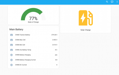

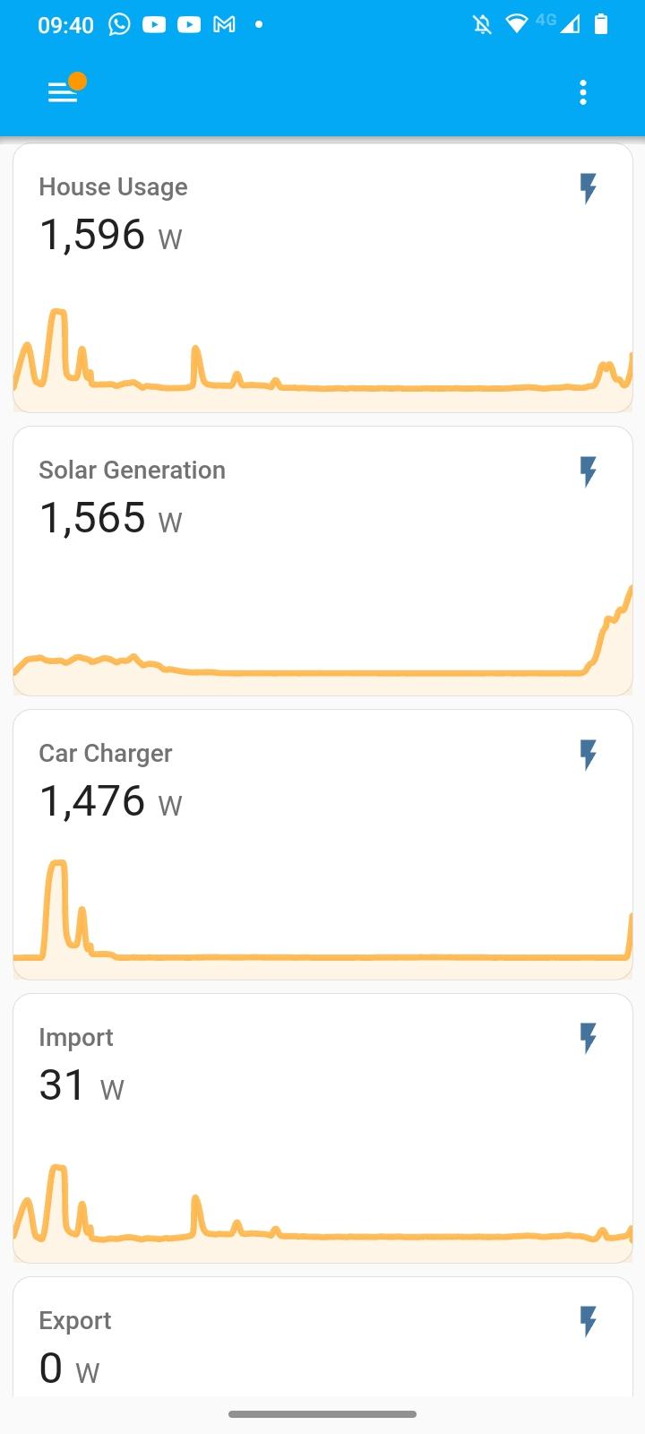

I've been faffing more with OVMS + Home assistant and now Home Assistant is controlling the car charger based on the spare solar capacity I have :D

The Home Assistant/OVMS integration looks good!

I need to get ovms it appears. Looks miles easier than what i was planning on using. Love my home assistant. This make ovms start to make financial sense.
Posts: 1782
Has thanked: 83 times
Been thanked: 429 times
Re: VW - Beetle 2003
mine was £50 used. It's open source so someone (cough @rstevens81) would design a board based on the schematics.
