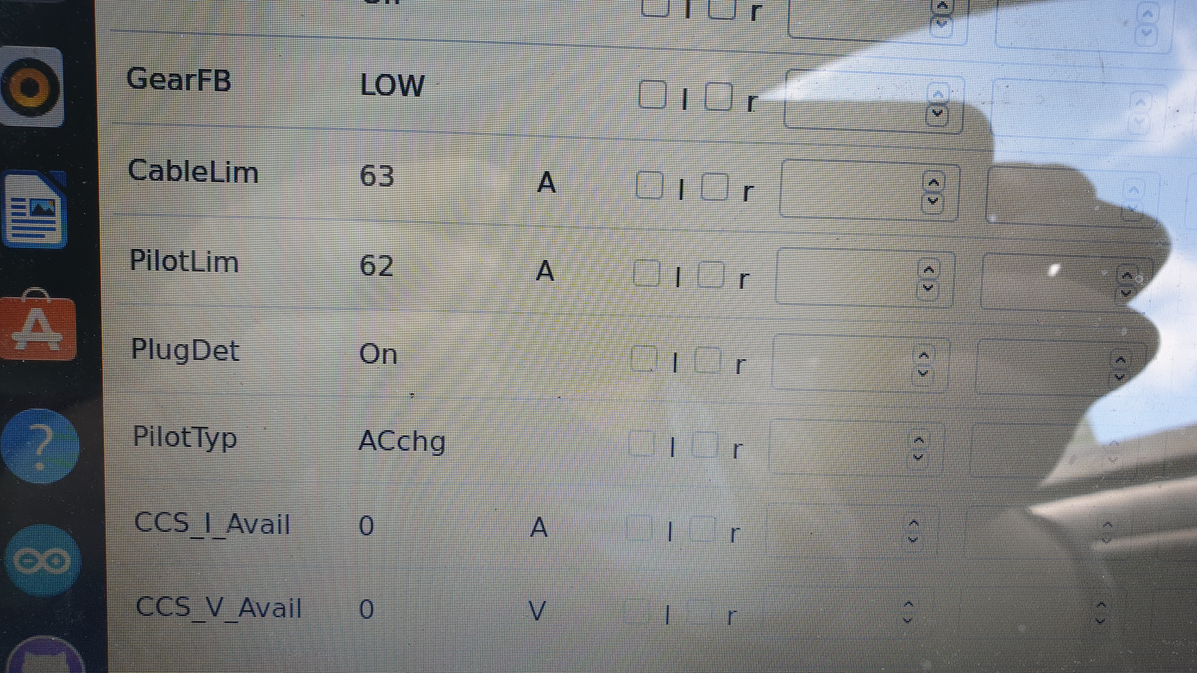

Posts: 4006
Been thanked: 1136 times
Ok folks here's where we're at : I'm beating the LIM class for the vcu down to something that should contain the necessary info to initiate dc charge. There are a lot more transitions needed in the dc side of the plan so I need some help here. I've setup a new branch on the vcu repo called ACDC_LIM. Here is my pathetic attempt so far:

void i3LIMClass::handle3B4(uint32_t data[2])  //Lim data
    uint8_t* bytes = (uint8_t*)data;// arrgghhh this converts the two 32bit array into bytes. See comments are useful:)
    CP_Amps=bytes[0];
    Param::SetInt(Param::PilotLim,CP_Amps);
    PP_Amps=bytes[1];
    Param::SetInt(Param::CableLim,PP_Amps);
    PP=(bytes[2]&0x1);
    Param::SetInt(Param::PlugDet,PP);
    CP_Mode=(bytes[4]&0xF);
     switch (CP_Mode)
        case 0x8:
        CP_Typ=0;   //No pilot signal
        break;
        case 0x9:
        CP_Typ=1;   //Standard AC pilot. Not charging
        break;
        case 0xA:
        CP_Typ=2;   //Standard AC pilot. charging
        break;
        case 0xC:
        CP_Typ=3;   //5% pilot requesting CCS
        break;
        case 0xD:
        CP_Typ=4;   //CCS greenphy comms
        break;
        default:
        break;
    Param::SetInt(Param::PilotTyp,CP_Typ);
    Cont_Volts=bytes[7]*2;
   // Cont_Volts=FP_MUL(Cont_Volts,2);
    Param::SetInt(Param::CCS_V_Con,Cont_Volts);//voltage measured on the charger side of the hv ccs contactors in the car

Posts: 4006
Tried this today on a ccs station. Got a pilot type 5 which the code doesnt understand so didnt go any further.
Proof I need a break from this. What could 5 mean DUUUHHHHHH!

Posts: 4006
Thanks Dave. Just pushed a mod to the pilot detection in 0x3b4. I'm an idiot. Its a 3 bit number not 4
Edit so it looks like the ccs station puts a static pilot out at first for some reason before going 5%.
