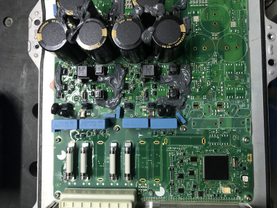

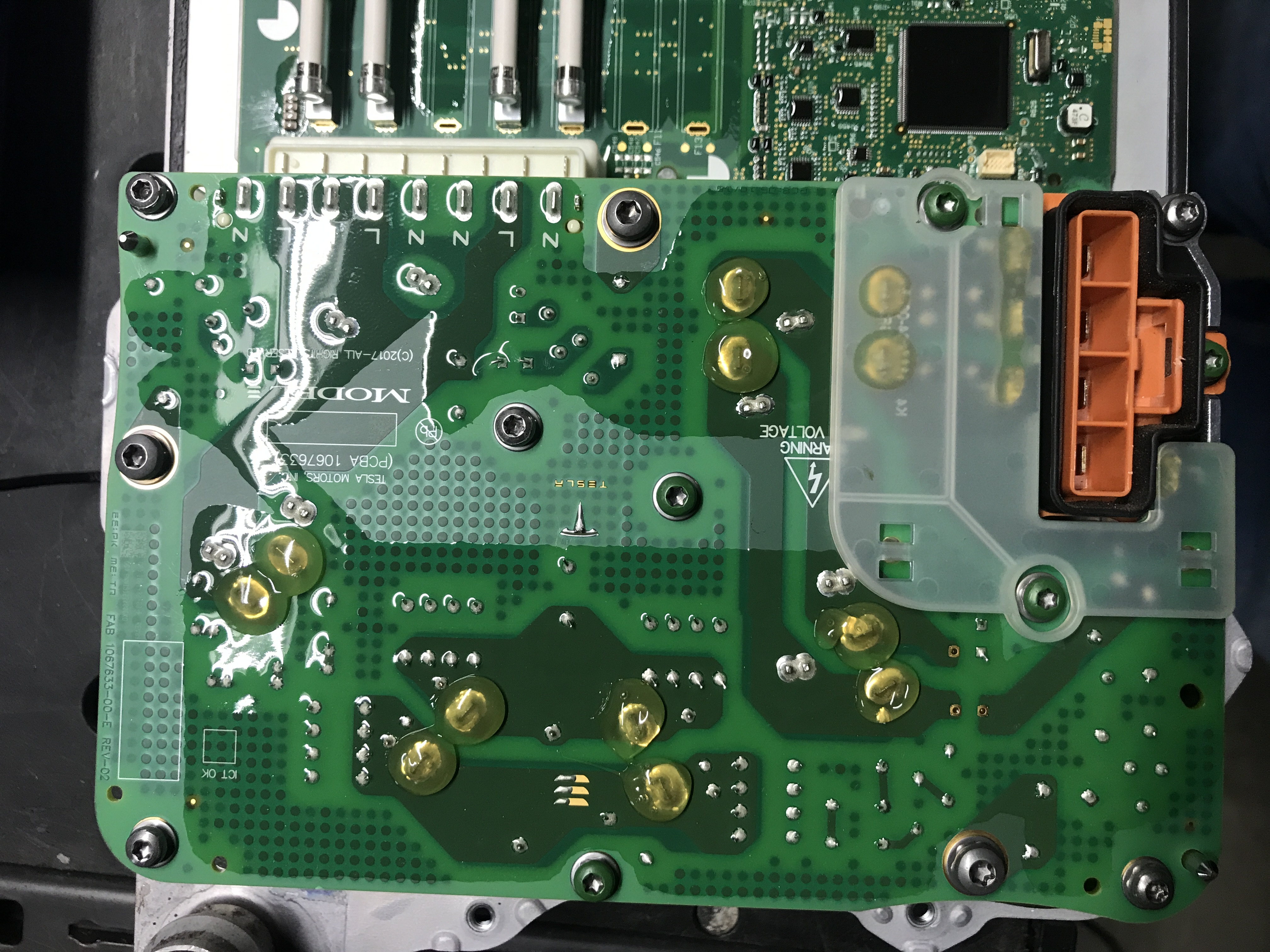

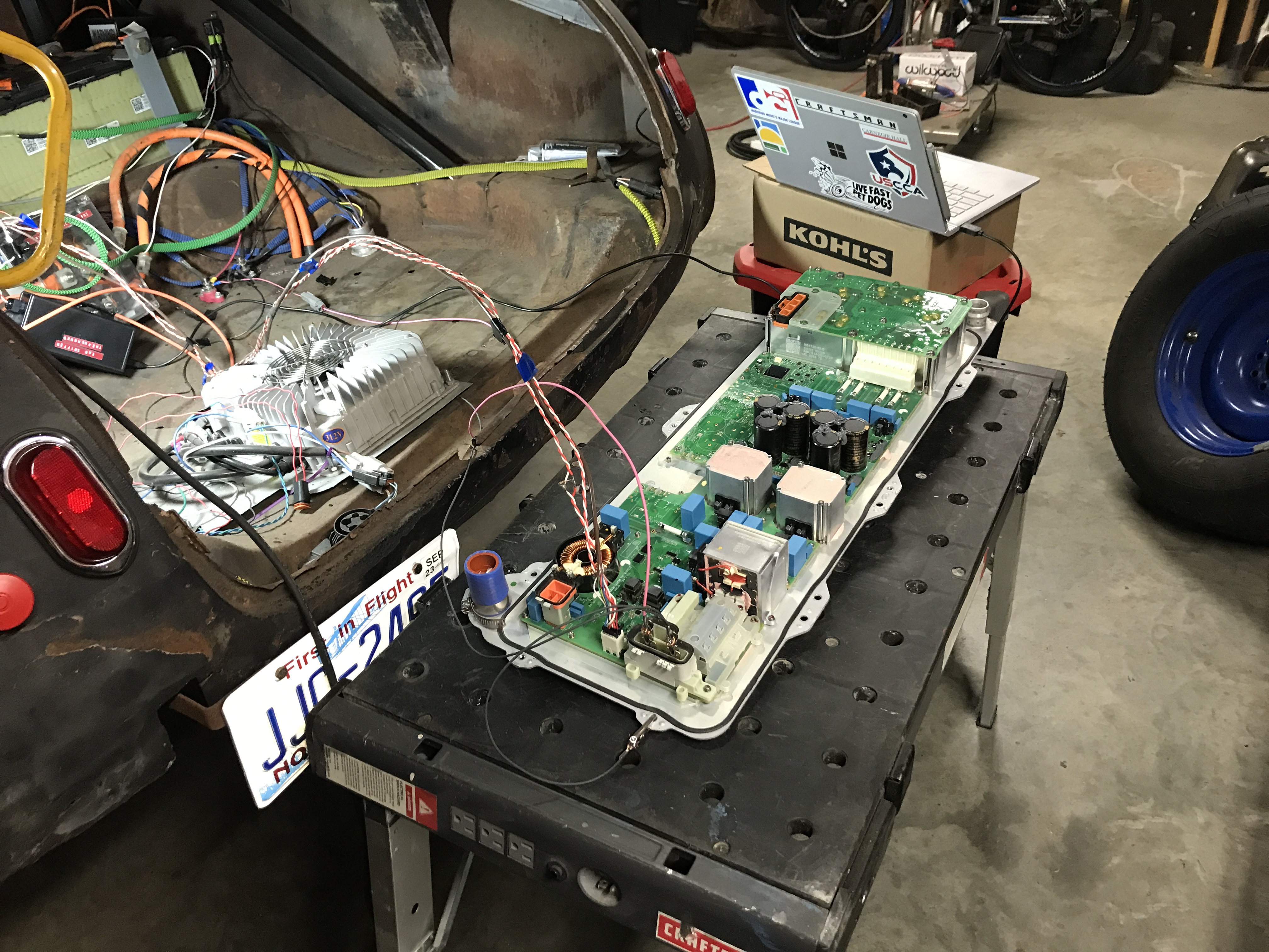

Update: I pulled the PCS out of the car so that I could test with the cover off. Appears to still not have any PCS messages in the log, the only thing I could see was a green and red LED alternating on one end of the board. I'll upload logs, photos, and video later today

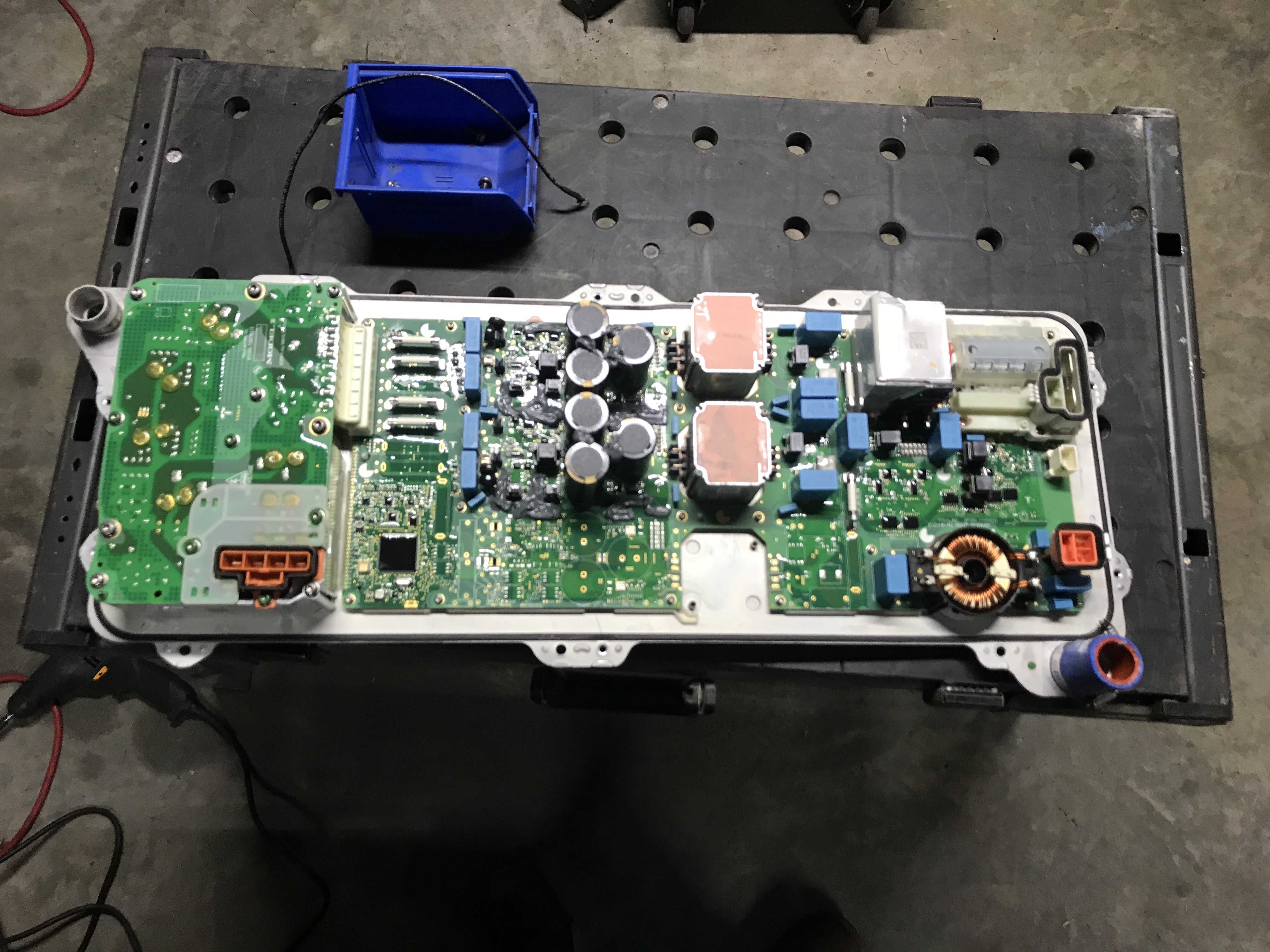

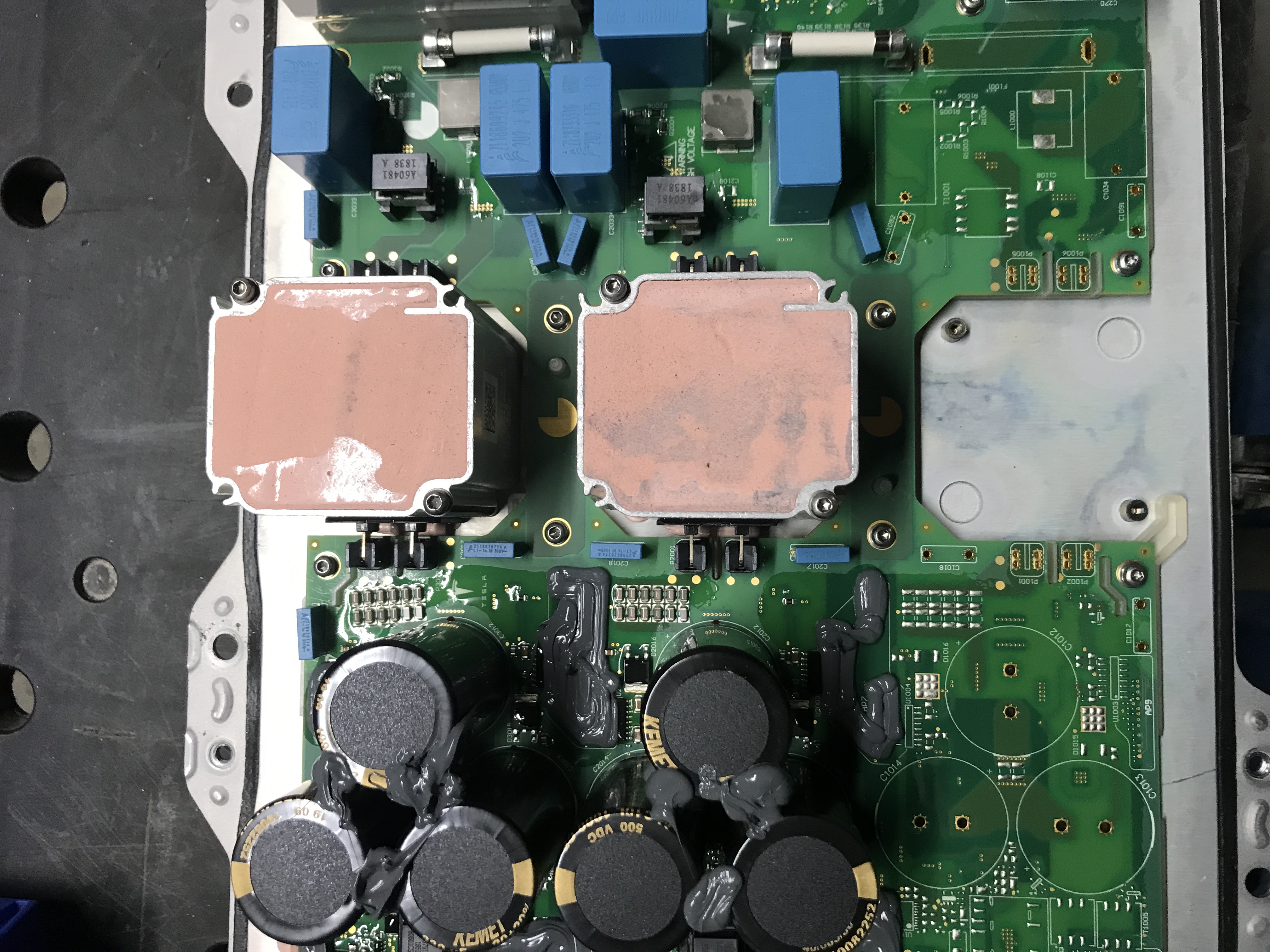

Log is attached, link to video below of the only thing I could see, and photos of the inside of the PCS.

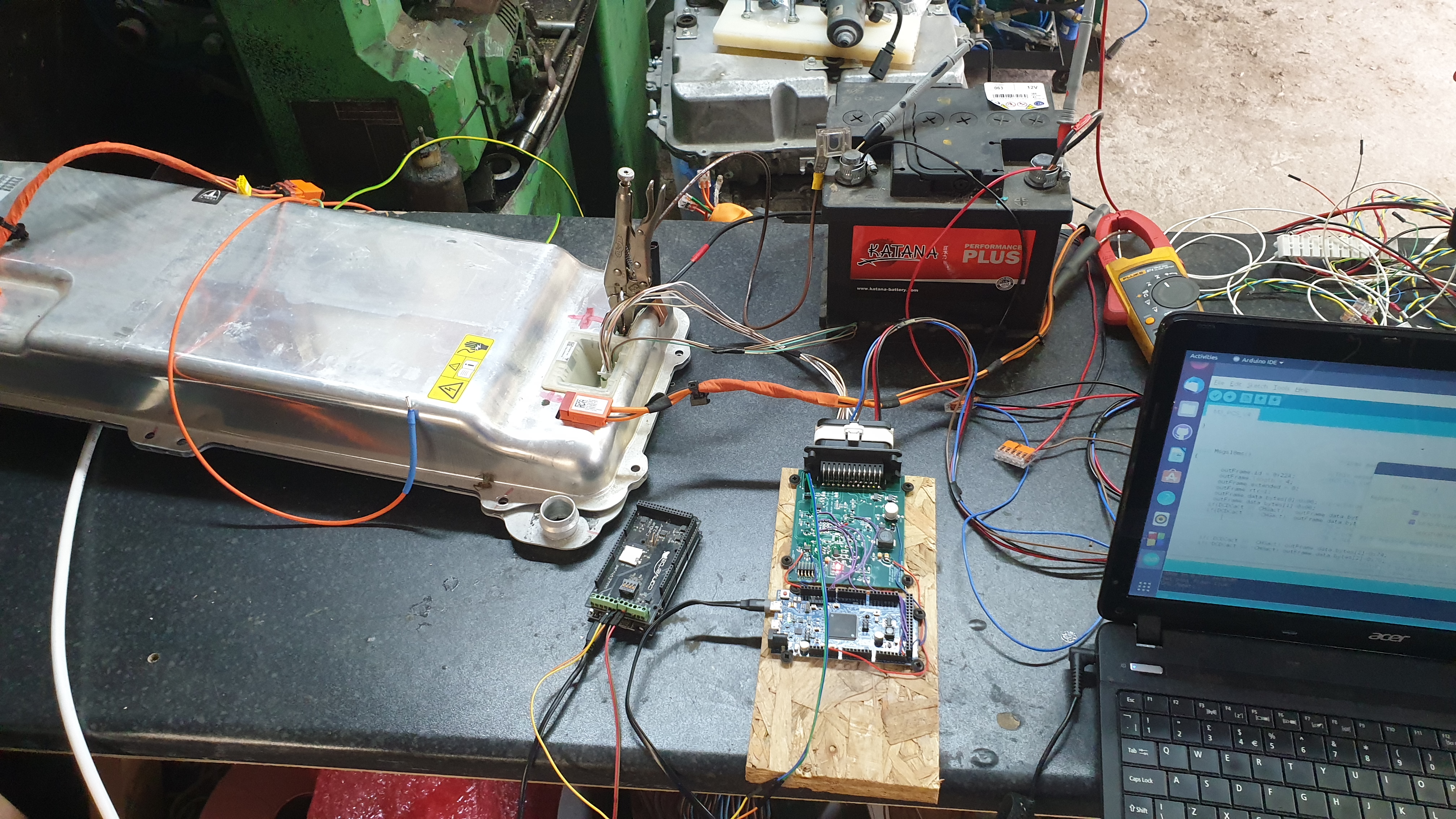

Just to give an update I now have a non functioning PCS on the bench and am deep into it. The problem is twofold : Some bugs in the STM32 controller firmware AND as suspected, the differences in firmware versions on the PCS. I don't want to jump the gun in announcing a solution but my gut feel is the STM32 controller will read the firmware rev over CAN from the PCS and adjust its own CAN message format to suit. This is where CAN logs from both working and non working controller and PCS combos will be vital. So do please keep them coming.

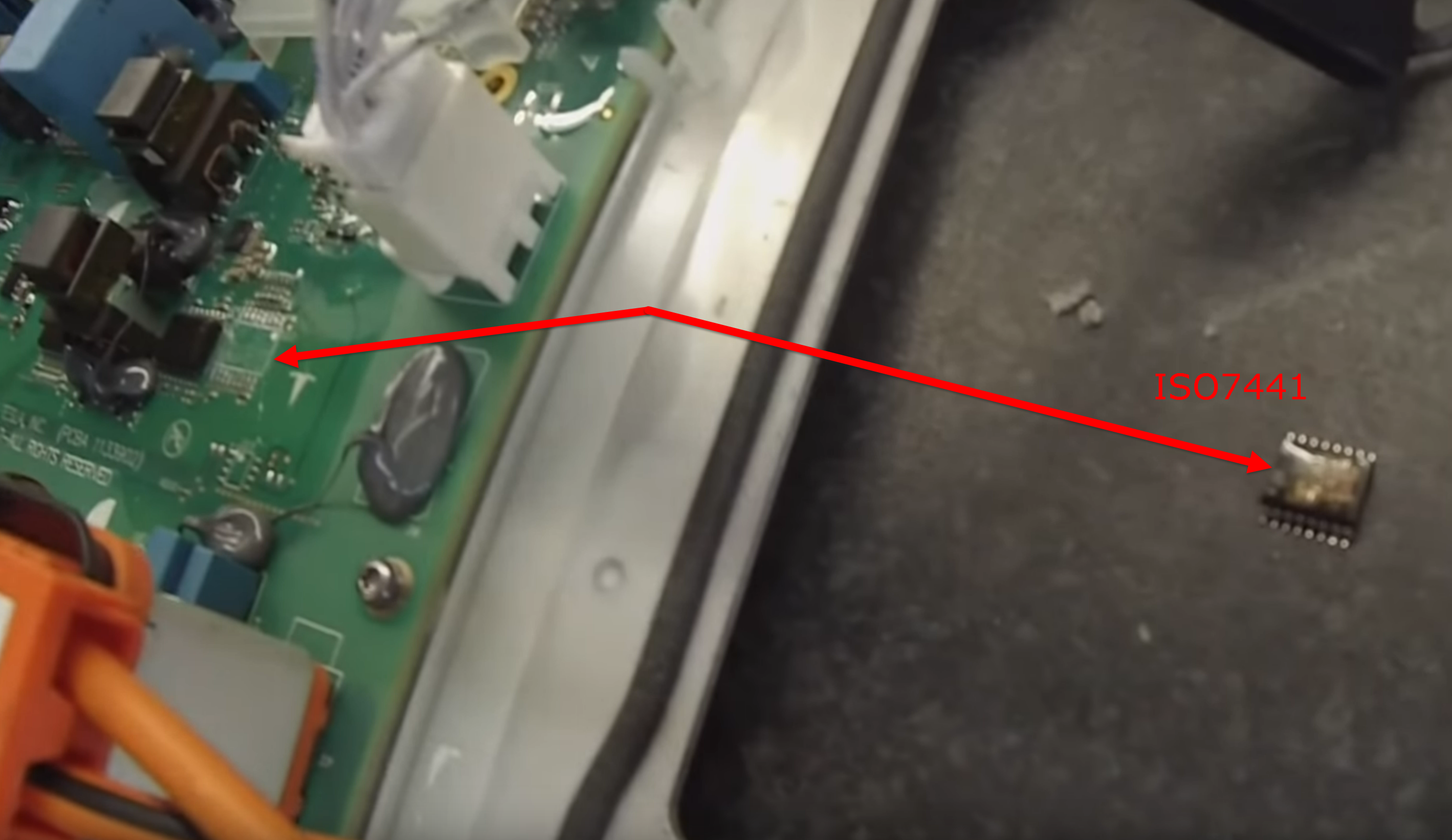

@P.S.Mangelsdorf thanks for your efforts. Sadly the log still has no pcs messages. In your video the pcs is awake so the only thing I can think of that has given me that behaviour in the past is failure of the digital isolator chip on the IPC can line. Did your unit come from a working car do you know? Also that is the first 32A PCS I have seen:)

Unfortunately this one came from evil-bay so I don't know if the car was working or not. If I remember correctly you did a video on fixing that issue correct? Or was that something else?Jack Bauer wrote: ↑Sun Aug 28, 2022 9:04 am @P.S.Mangelsdorf thanks for your efforts. Sadly the log still has no pcs messages. In your video the pcs is awake so the only thing I can think of that has given me that behaviour in the past is failure of the digital isolator chip on the IPC can line. Did your unit come from a working car do you know? Also that is the first 32A PCS I have seen:)

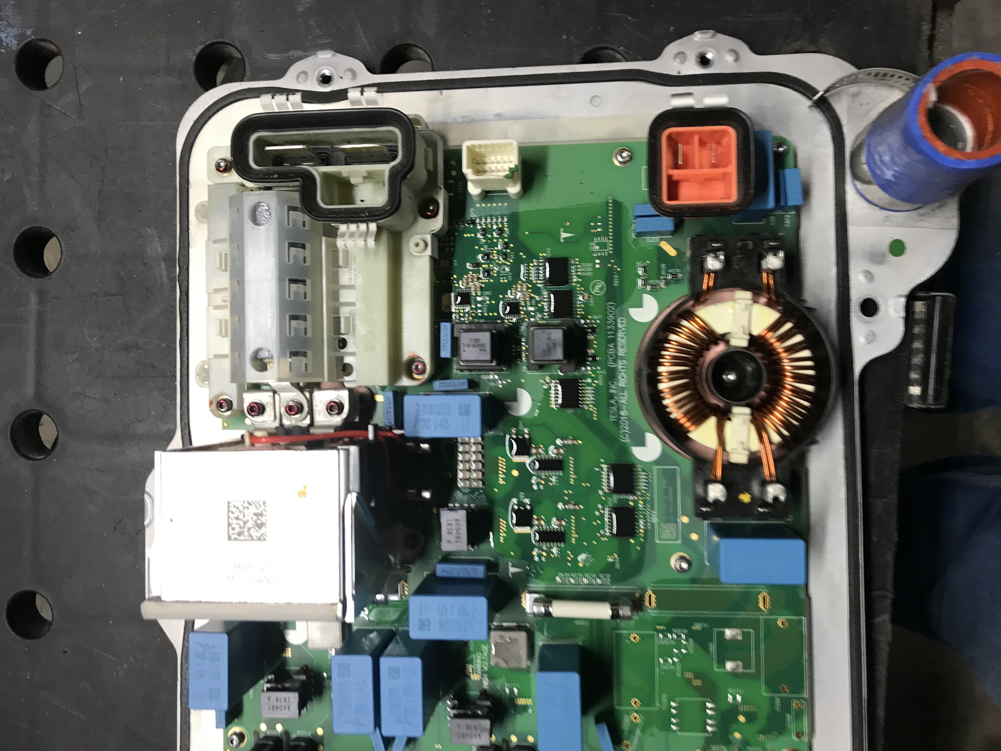

Damien could you mark on a photo which component is the isolator? I can do the soldering but identifying components is still just a bit out of my depth.Jack Bauer wrote: ↑Sun Aug 28, 2022 9:04 am In your video the pcs is awake so the only thing I can think of that has given me that behaviour in the past is failure of the digital isolator chip on the IPC can line.
Also, do you have the part number? It appears there are variations of the ISO7741
The one Damien blew was at U22 on the PCS board.P.S.Mangelsdorf wrote: ↑Tue Aug 30, 2022 10:49 pm Damien could you mark on a photo which component is the isolator
This video from the first page of this thread shows the ISO7741 removed from U22, and the location from which it was removed (about 30 seconds past where I've bookmarked it below, but for context it's best to start the vid where I've bookmarked it):
". . . about a fiver from Farnell . . . "
I can't help with any variations, though.

Thanks for that!. I'll take a few pictures tomorrow.

Thank you! I had searched the videos but kept missing it.
