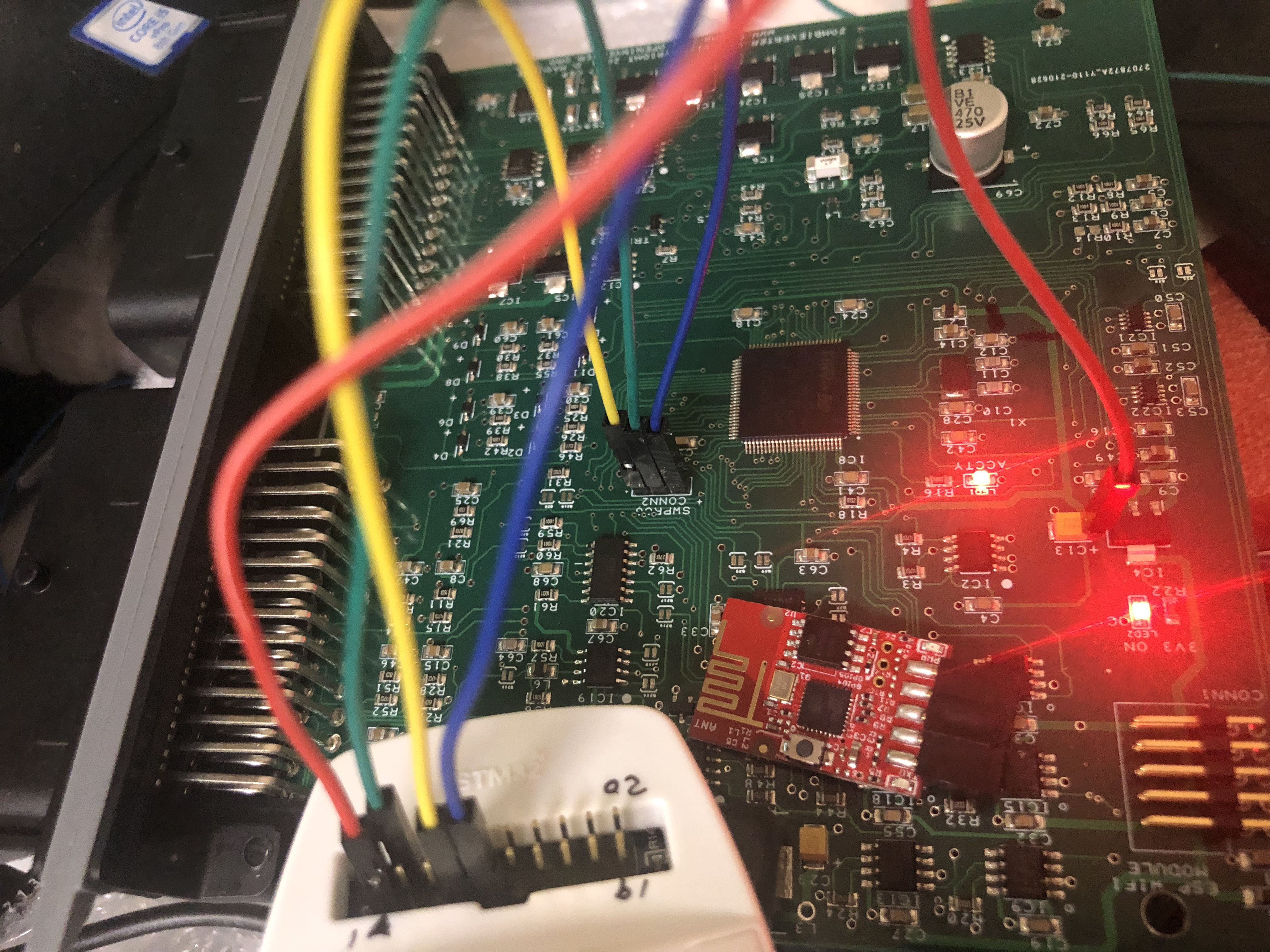

Re: ZombieVerter VCU Support
OK, it’s beginning to look a bit like Christmas - the bricked board is working again.
To get this I did a full flash erase and loaded the stm32_vcu.hex using st-link v2. That wasn’t super obvious so picture below for how I hooked it up.
So it’s working but I now don’t have a boot loader. I did try loading johu’s v4 boot loader .hex (from here viewtopic.php?f=7&t=1119) and then tried to update the usual .bin file via the GUI. That completes but doesn’t start blinking.
Is there a right version of boot loader to use, or any special option needed in the chip setup?

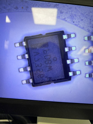

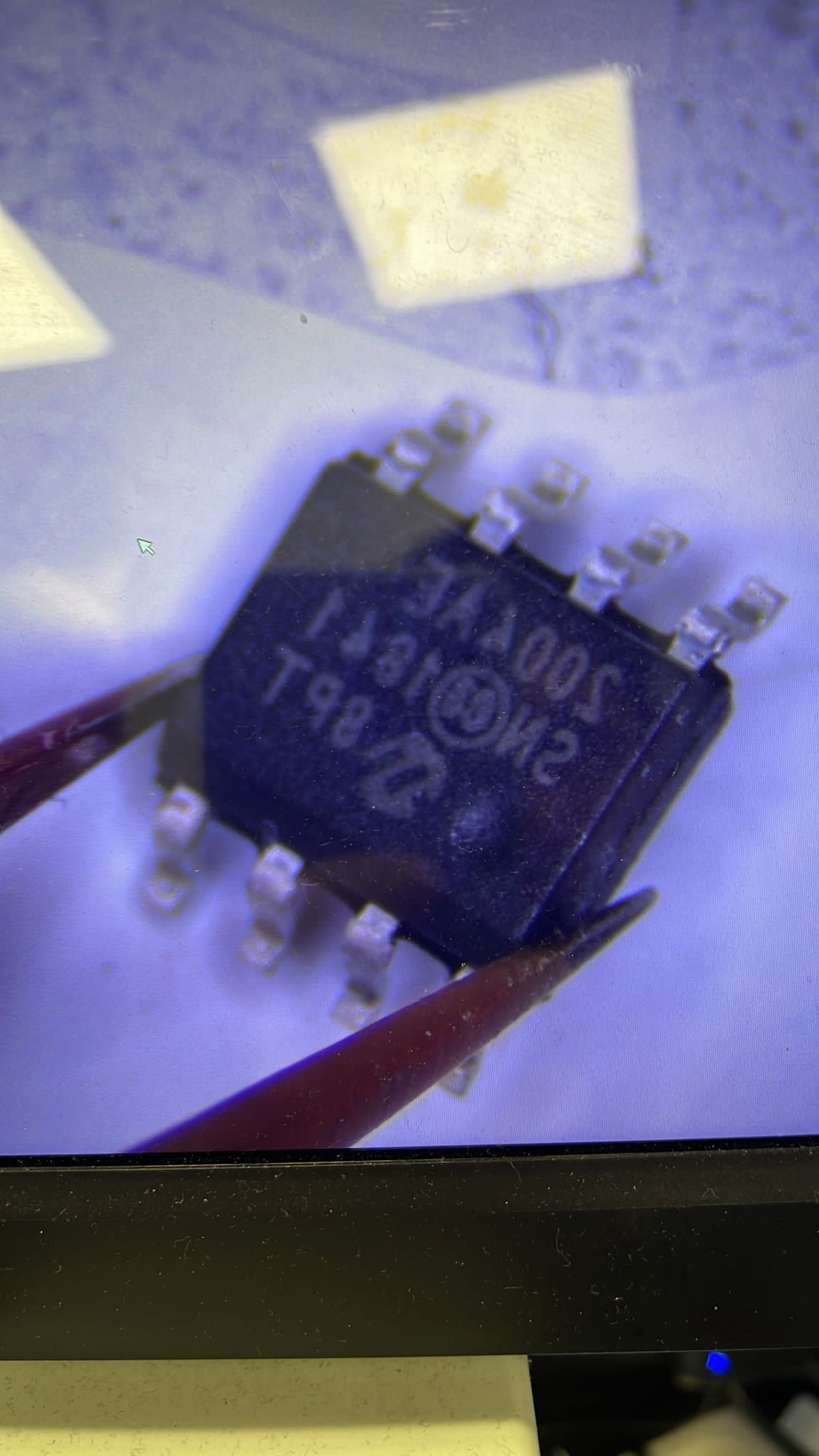

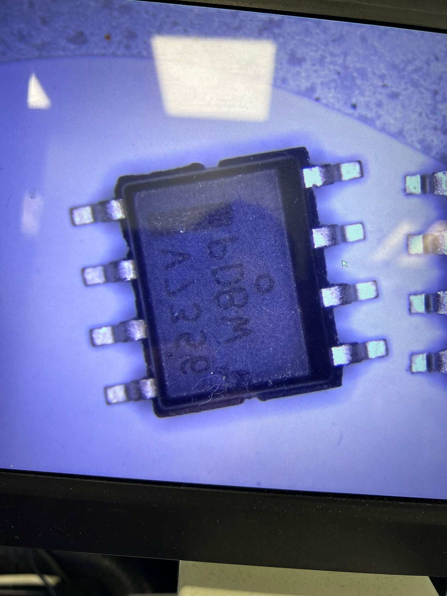

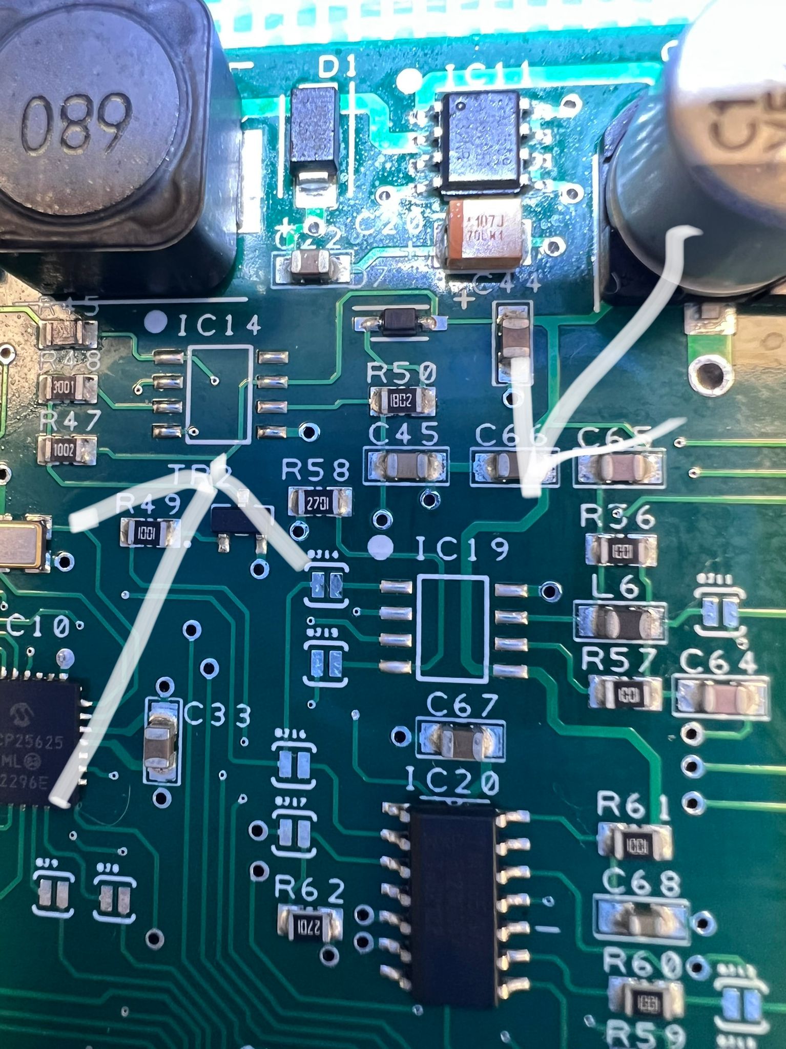

Quick chip query for the VCU. I'm getting some help soldering the IC's that came loose in the kit. There are two left, IC14 and IC19, and I might have a similar issue to a previous post.
This would be IC19, the NCV7356, but want to double check the orientation. No clear marker so which pin would align with the dot on the PCB, upper left pin as per the image below? That leaves this chip for IC14, tried searching to see what it is as its not the TJA1020 or MCP2004 suggested as a replacement. Am I right thinking this is just the wrong chip for this kit, or have I misplaced one of the others!?
Usually а chip has a slightly larger bevel on the side with the first pin (which is marked with a point on the board)

I have one of the GD based boards and it was working until I tried to update the firmware.johu wrote: ↑Fri Nov 05, 2021 6:47 pm Can any of you try to update a bricked board with a USB cable attached to the wifi sockets uart? Using the updater python script: https://github.com/jsphuebner/tumanako- ... updater.py
python updater.py -d /dev/ttyUSB0 -f stm32_vcu.bin
To be honest I've tried a bunch of stuff, so not really sure the state of the board at the moment.
I tried the updater scripts and got this:
python3 updater.py -d /dev/ttyUSB0 -f bootupdater/stm32_bootupdater.bin
File length is 2728 bytes/3 pages
Resetting device...
Sending number of pages...
Sending page 0... b''
Is there a guide for basically starting from scratch to get the board setup? I have a knockoff stlink-v2 and usb->ttl cable. The stlink seems works with the make flash commands once I update the script in the make file to point at the stlink-v2.cfg instead of parport.cfg.
- Been thanked: 1918 times
Looks like no loader running at all. Please don't test with the boot_updater anyhow. If you reflash stm32_loader.hex and stm32_vcu.hex and then listen on /dev/ttyUSB0 with a terminal program, you should see the "2D" bootup message when resetting/powering on.

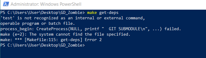

So I'm trying to get my head around Github and specifically how to compile a binary. I've down loaded arm-none-eabi toolchain, Python and chocolatey and installed them OK -I think, but I don't seem to be able to get any further and entering make get-deps in a shell results in this: can anyone tell me what I'm doing wrong and or point me at a complete idiots guide to this?
Cheers
Cheers
Easiest way to go: run Linux
Second easiest way: use the git shell supplied with Tortoise git. Or install cygwin.
But it can be made working on windows: replace all occurrences of "printf" by "echo" and retry.
EDIT: and remove the "ifneq .... endif" under get-deps for now
Thanks Johu, I only understand half of that but it's a start, I'll try this evening. Would a Linux for windows subsystem work or does it need a full Linux system?
Cheers
Cheers
Oh, yeah... I was talking about editing the Makefile
But nevermind, try running https://www.cygwin.com/
