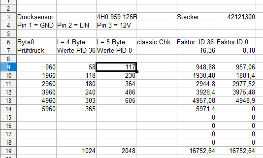

if you want to use the golf pressure sensor 4H0959126B to, you get an answer on PID[0] (0x80) 5 byte long and PID[36] (0x64) 4 byte long.
connector 42121300 1=GND, 2=LIN, 3=12V

I made a couple of measurements. In the first column is the applied test pressure in mbar, in the second and third the value transmitted by PID 36 and PID 0. 16.38 and 8.18 are the multipliers to get the results in the last two columns. I don't know why these are should these values, it doest'n make sense with any known pressure units.

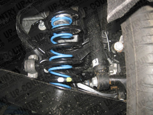

I have found a good spring enhancement system with TUV to fight the increased rear weight.
You put spring into spring and you can haul extra 90kg. I think i will buy one set for my Pug too keep it from taking off.
https://mad-suspensionsystems.com/en/
