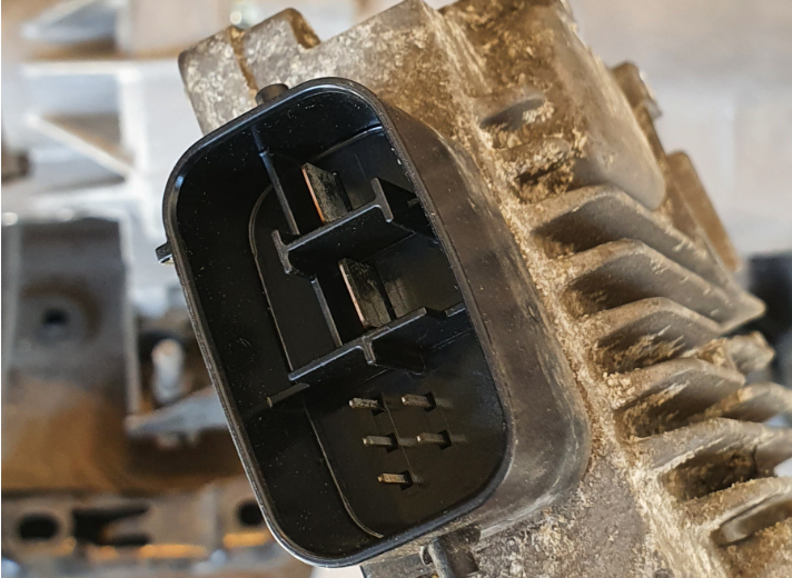

Does anybody know the Pinout of the Oil Pump connector?RE3Rotor wrote: ↑Sat Feb 29, 2020 4:40 amGreat information. Your second diagram shows an external connection for the temp sensor connector. I missed it in the loom the first time. I just confirmed it is there. Thanks for everything again. Now time to find that connector.xp677 wrote: ↑Sat Feb 29, 2020 12:05 am The black wire is for PWM control of the oil pump controller.
The brown wire is a feedback signal showing the oil pump rpm. PWM again. You can leave it unconnected.
See the attached diagrams, apologies if they aren't very clear, not sure what happened to them:
I should add, the only ground for this controller is the metal body of the controller itself, there is no ground wire. So the controller either needs to be bolted to something that's grounded, or you can add a ground wire to one of the bolt holes.
Also IIRC, only 3 of the bolt holes are threaded.

xp677
- Posts: 442
- Location: UK
- Been thanked: 15 times
The pinout is in the post you quoted!
Black is PWM in from your controller.
Brown is feedback from the oil pump. Do what you want with this or leave it disconnected.
The fat blue wire is 12V power. The metal case is the ground.
Edit: I updated the wiki to include this.

Robbertjanzen

Yes i see the pin numbers, but i do not have the connector, so don't know which Pin is which wire...xp677 wrote: ↑Wed Apr 29, 2020 3:11 pm The pinout is in the post you quoted!

xp677
- Posts: 442
- Location: UK
Are the pins not numbered on the unit? That's annoying. See here:
You want the 3 pins on the centre row as shown. The fat red wire is actually the Toyota blue wire covered in red heatshrink.

Here is pin numbering on connector
- Connector - A55 Oil Pump Motor Controller 90980–12483.PNG (6.71 KiB) Viewed 27355 times

Great stuff guys (oil pump pin numbering is already on there).
What I've gathered so far, is that the damn oil pump almost needs its own page. There's more info about the pump than the inverter
