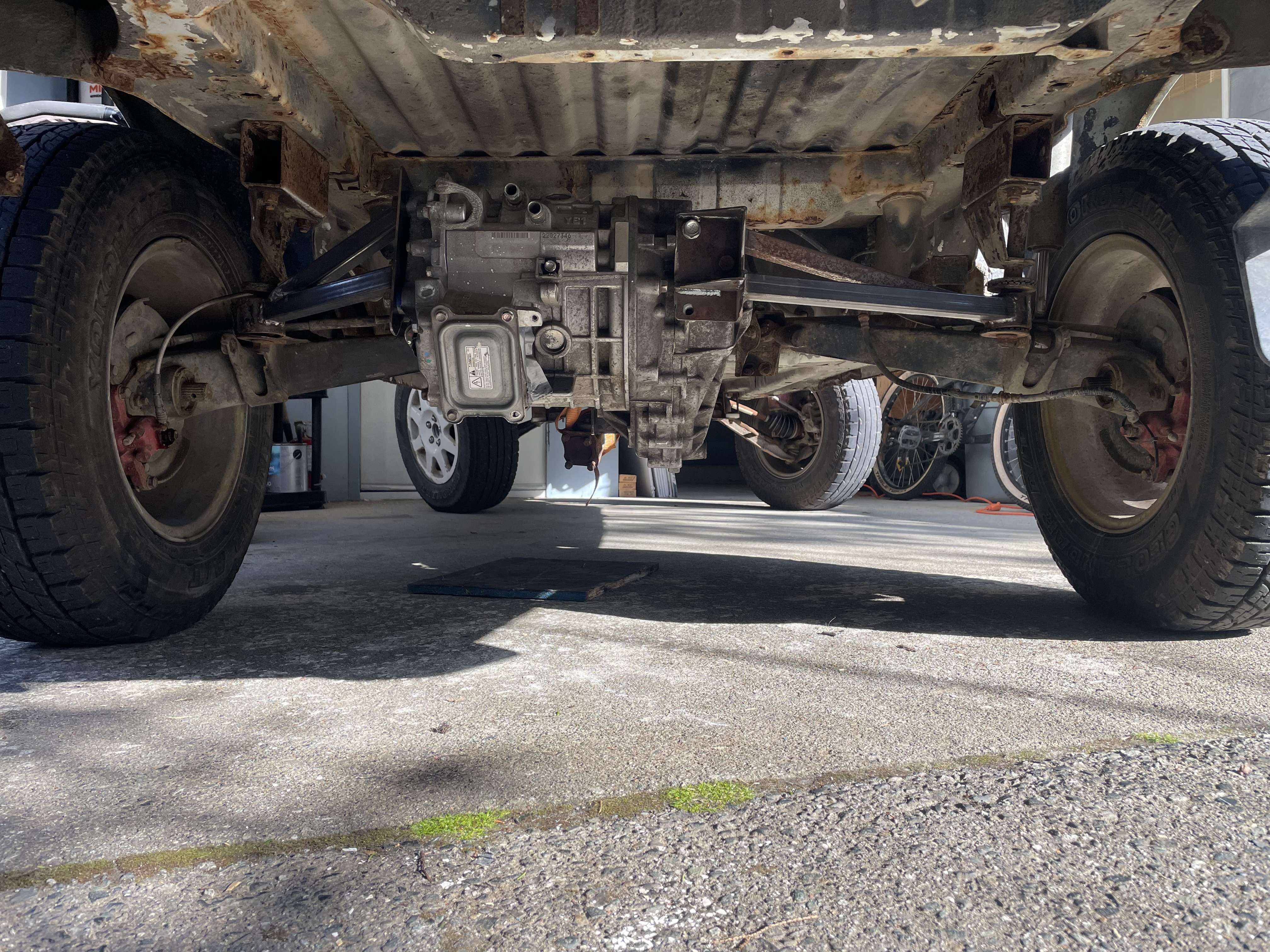

R160 rear diff is out, outlander DU is in!
Built a jig and welded up the new mounts remotely and then brought the parts to the brat. not perfect but it’s in. Next up axles, then I can pull the original gearbox and leaf motor and loose a couple hundred lbs!

unfortunately have had no time since to attend to the brat, but after measuring the required axles lengths, I found I need 19.5in axles shafts. Being I’m planning on using vw 100mm joints… very conveniently that vanagon axles are…19.5in long 😎
So now to just turn down and weld on some flanges for the outer stubs on the trailing arms. Then drive train is done!
