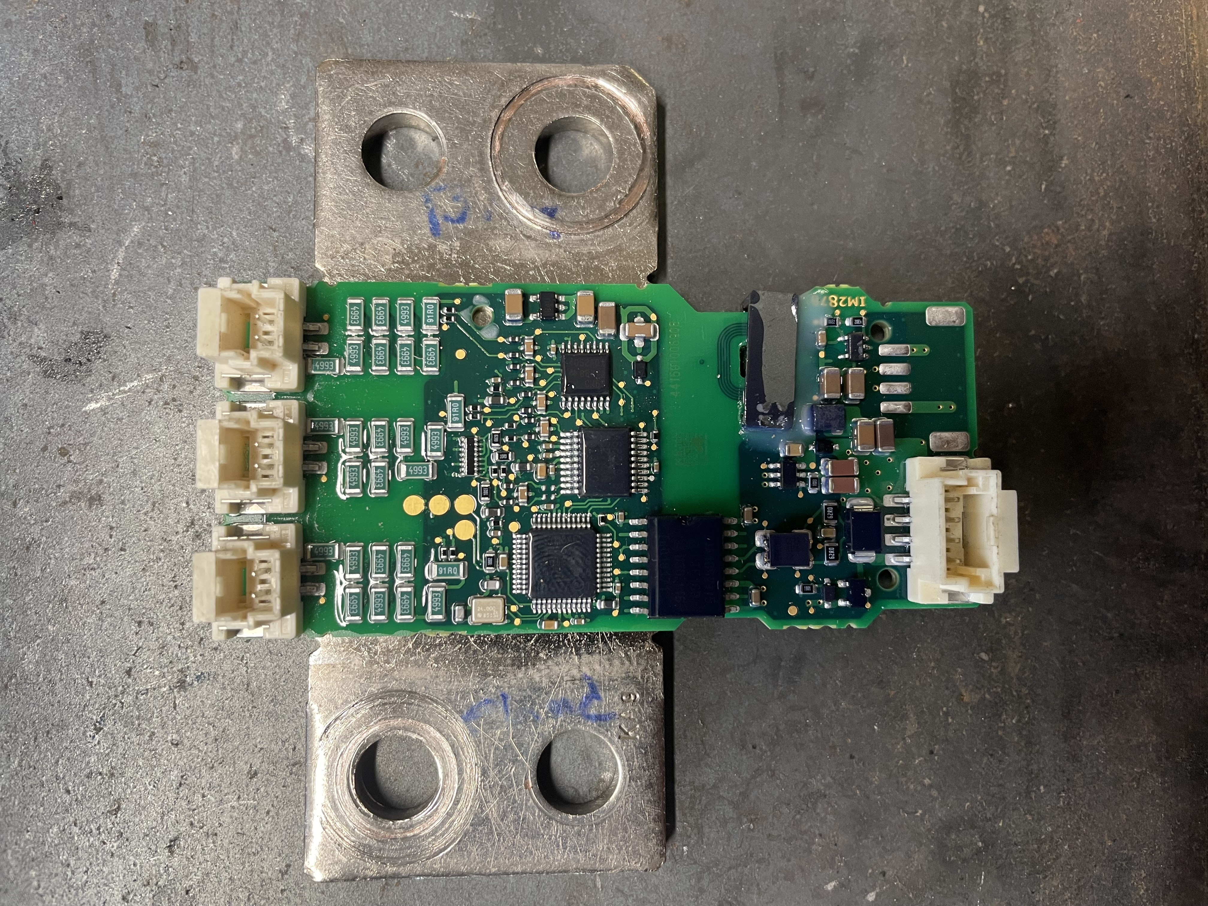

start everything back up....and precharge fail....hmm okay not getting proper reading in the web interface. opened up the contactor box, the shunt on the negative contactor terminal is a little loose. yikes.
tighten that back up, run the sequence and looks like i killed the shunt. its not providing proper udc data.

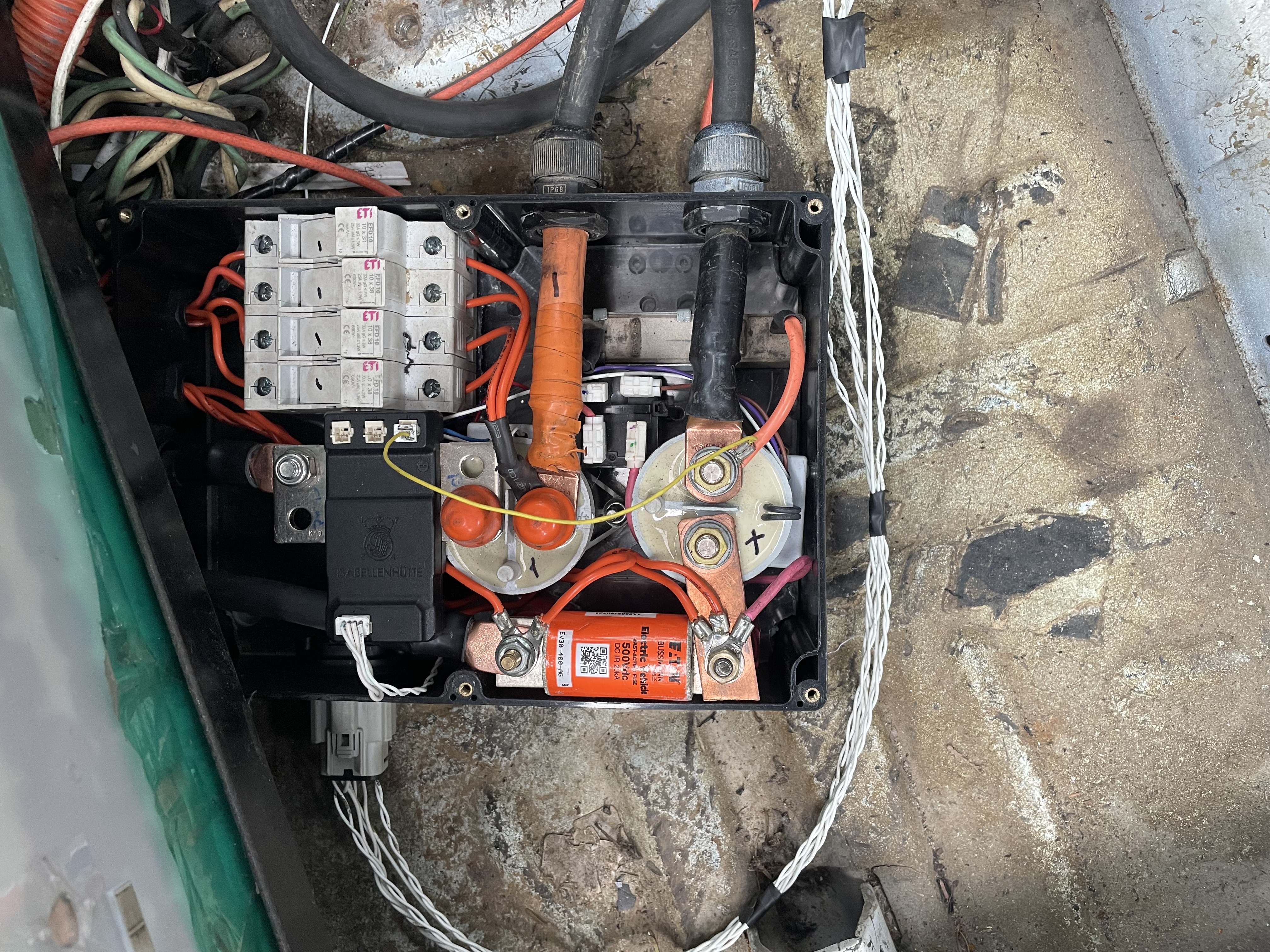

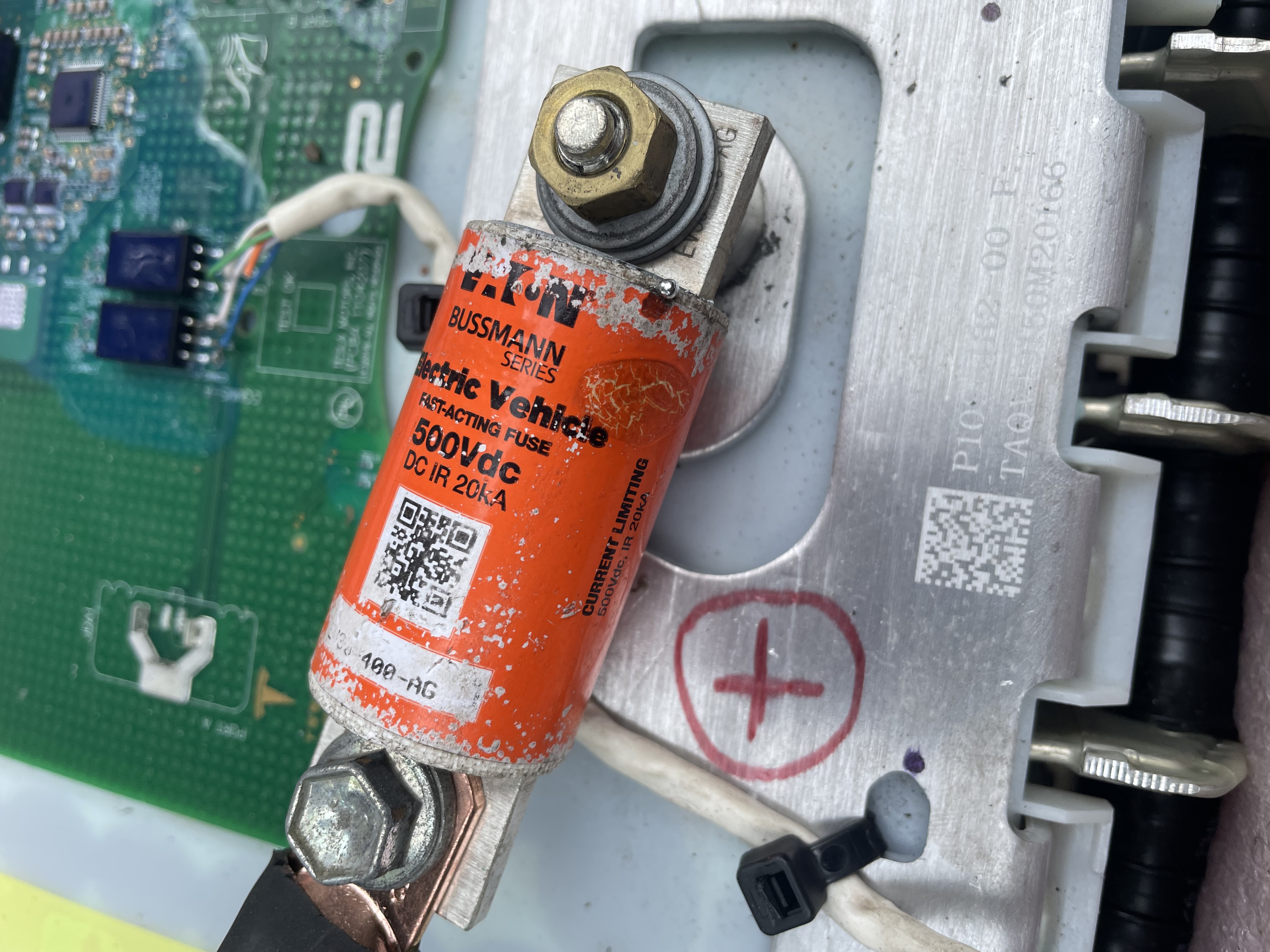

Re: [DRIVING] leaf powered 1983 Subaru BRAT (dual outlander WIP)
Okay so nope! I blew my mid pack fuse

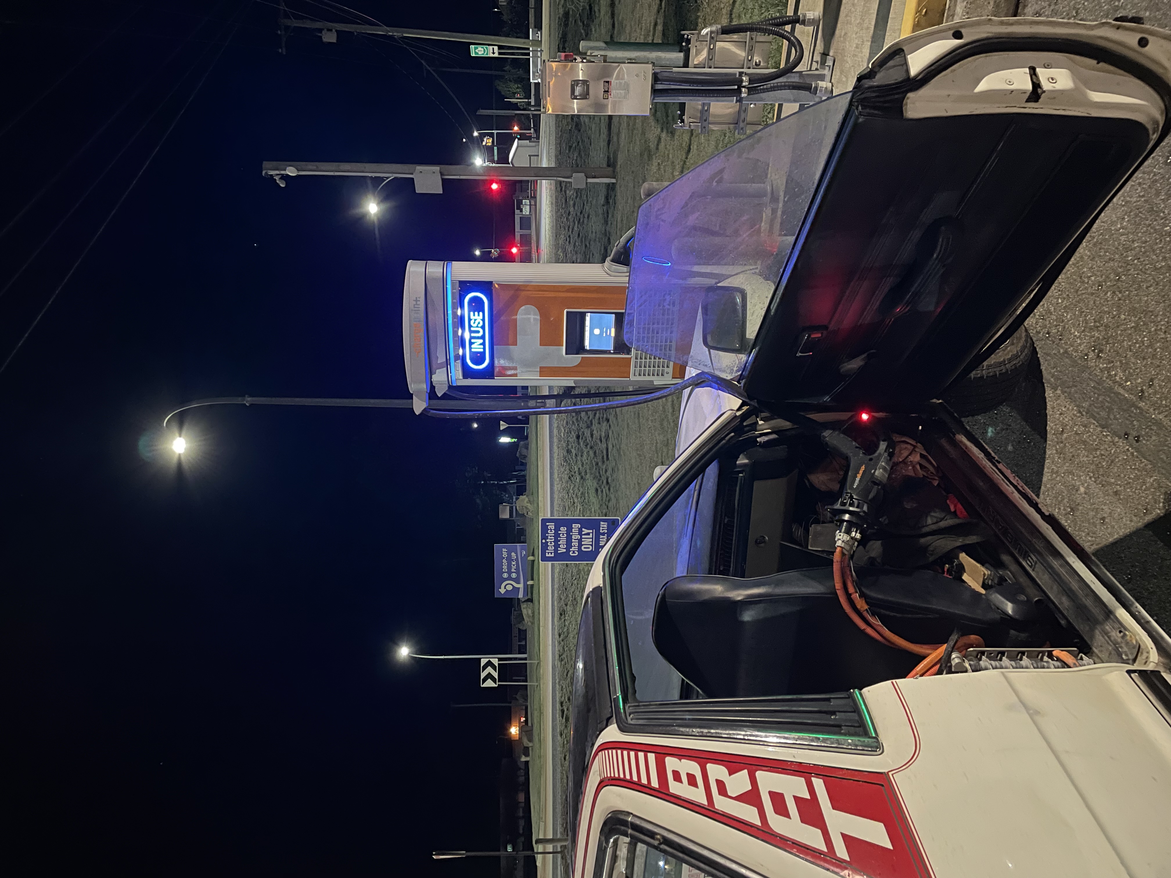

Just finished a 370km drive. Smooth driving.
And got CHAdeMO working with zombie.
First station (charge hub)charged me for time but provided 0 power.
The bc hydro dc fast charger(abb) worked great!
There’s a remote delta 25kwh fast charger at a rest stop. along with a 48amp level 2….
I feel like I’m cheating
When I arrived at the station I immediately thought “oh can I pull an arber and charge with both at the same time?!?” Gave me a good laugh
Some more CHAdeMO updates:
FLO dc fast chargers result in an over voltage fault.
I’m guessing this is a result of the isolation test?
During the charger start up udc voltage rises up to 650v.
Shortly after starting the charge, the zombie shut it all down.
some of the newer bc hydro station seem to do the same thing!

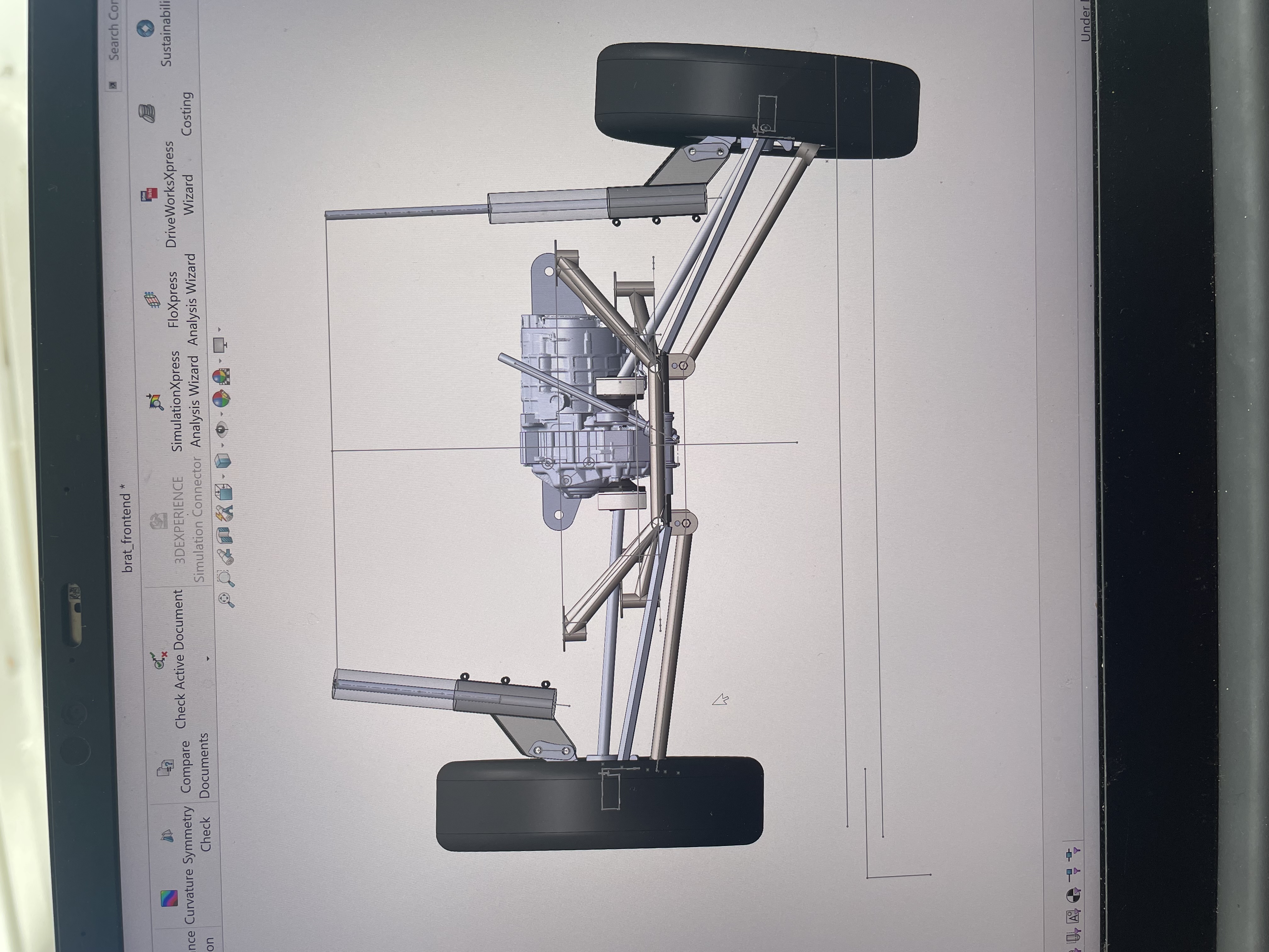

Brat is pretty beat up at this point. I’m slowly gathering the bits for v2.
here’s where I’m at with the new front end:
new subframe to accommodate the outlander drive unit and fixes the suspension geometry.
Packing is definitely getting tight be everything should fit where I’d like.
subframe will be 1.25 od .83 wall dom about 15lbs
Huge weigh reduction from the stamped steel Subaru subframe that’s around 35-40lb

unfortunately have had no time since to attend to the brat, but after measuring the required axles lengths, I found I need 19.5in axles shafts. Being I’m planning on using vw 100mm joints… very conveniently that vanagon axles are…19.5in longSteamboater wrote: ↑Tue Jun 24, 2025 3:03 am Couple months have passed, you been driving RWD or what!?
So now to just turn down and weld on some flanges for the outer stubs on the trailing arms. Then drive train is done!
