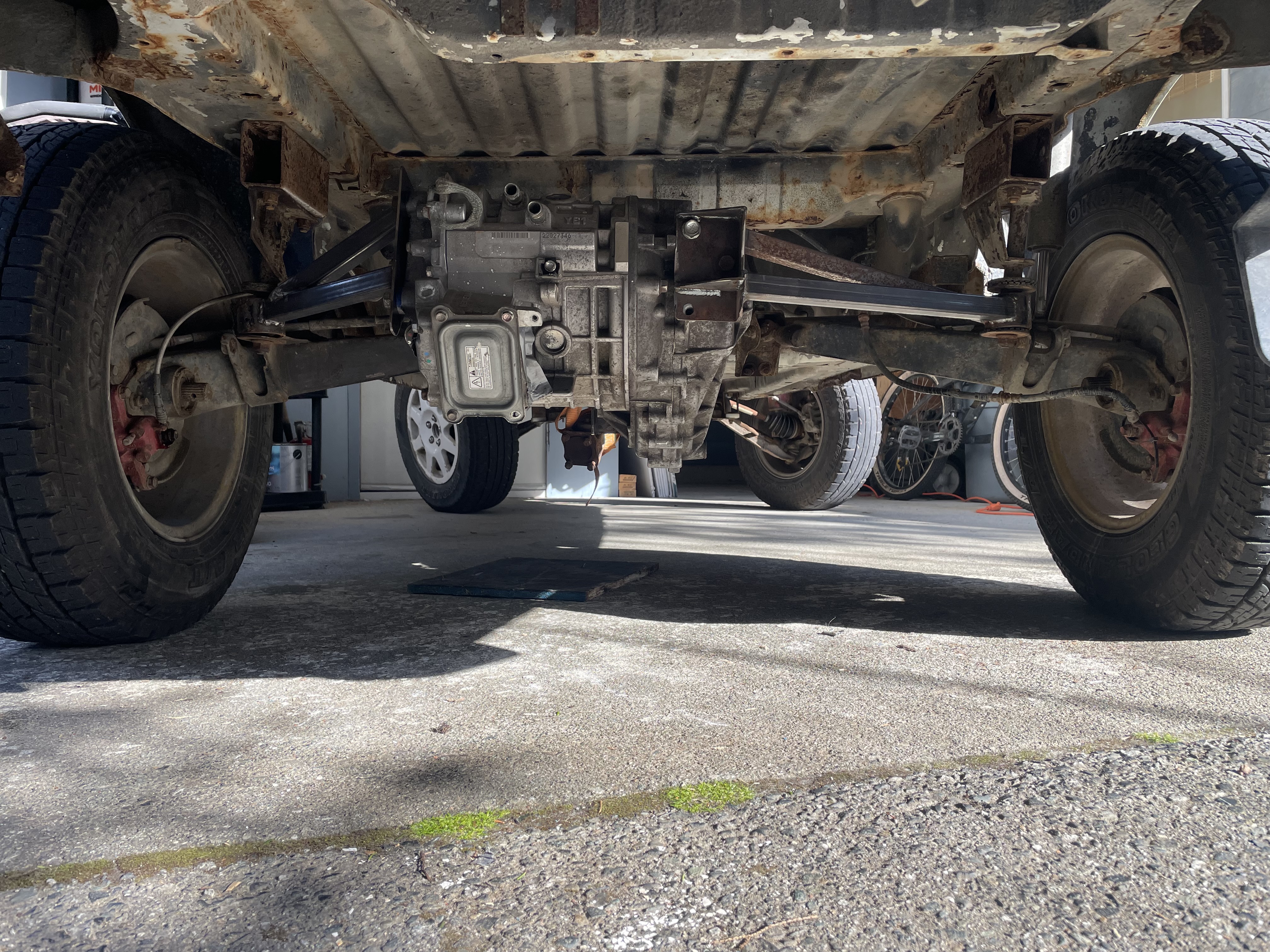

Been collecting parts and lurking here for long enough I might as well start a build thread.
converting a lifted 1983 Subaru BRAT on a sudo budget
So far I have;
Gen2 leaf motor +inverter+charger/jb 750$ cad
Gen2 chevy volt battery (18kwh)1000$ cad
Gen2 Tesla slave charger 600$ cad
2015 Tesla dcdc converter 245$ cad
Volt wiring/ j1772 plug 130$ cad
Goal is to get this thing driving under 5k

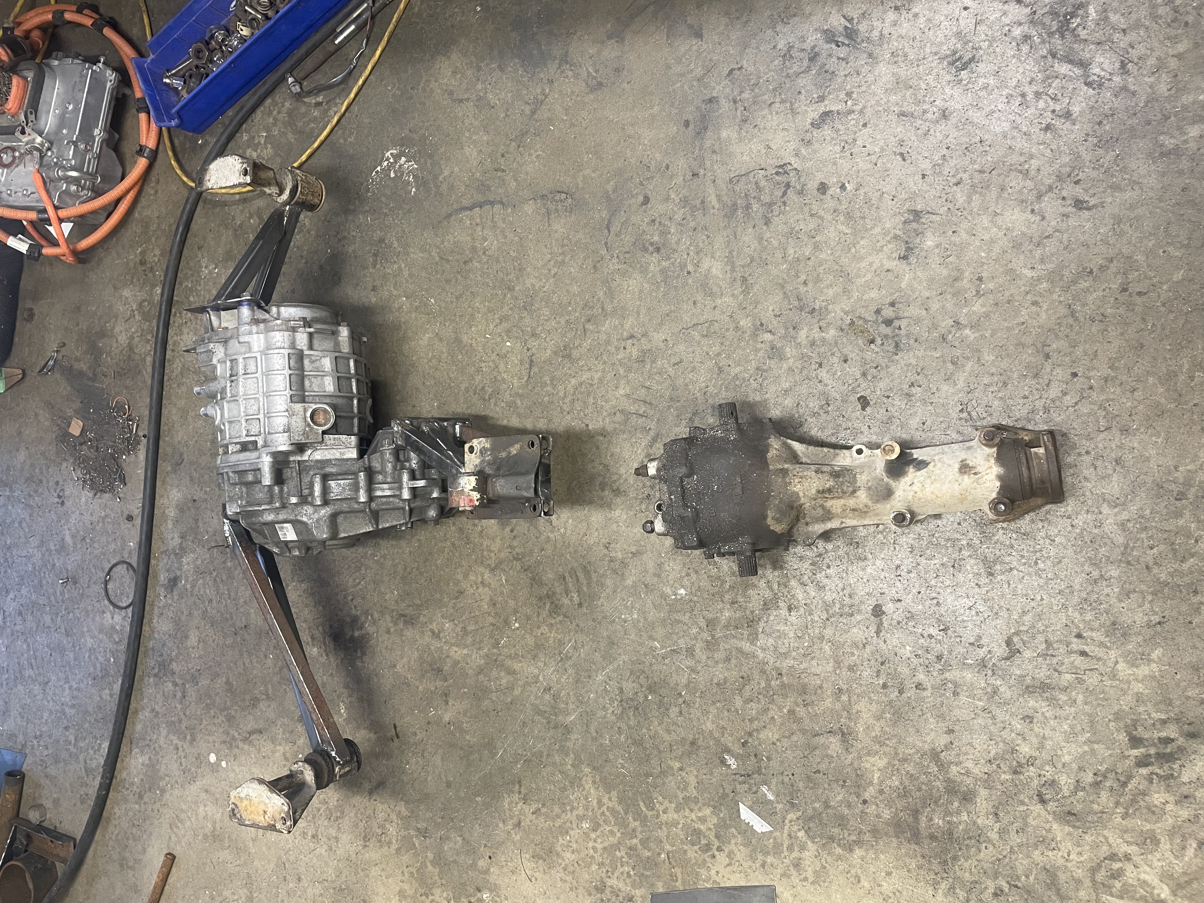

direct coupling from the motor to the brat’s 4spd d/r trany. I have connections to a few machinest, so I’m handing over the leaf motor to them to figure out the splines and mill a coupler. Hopefully all goes well and I can provide spline data on the leaf motor.

-leaf motor direct drive to 4wd gearbox

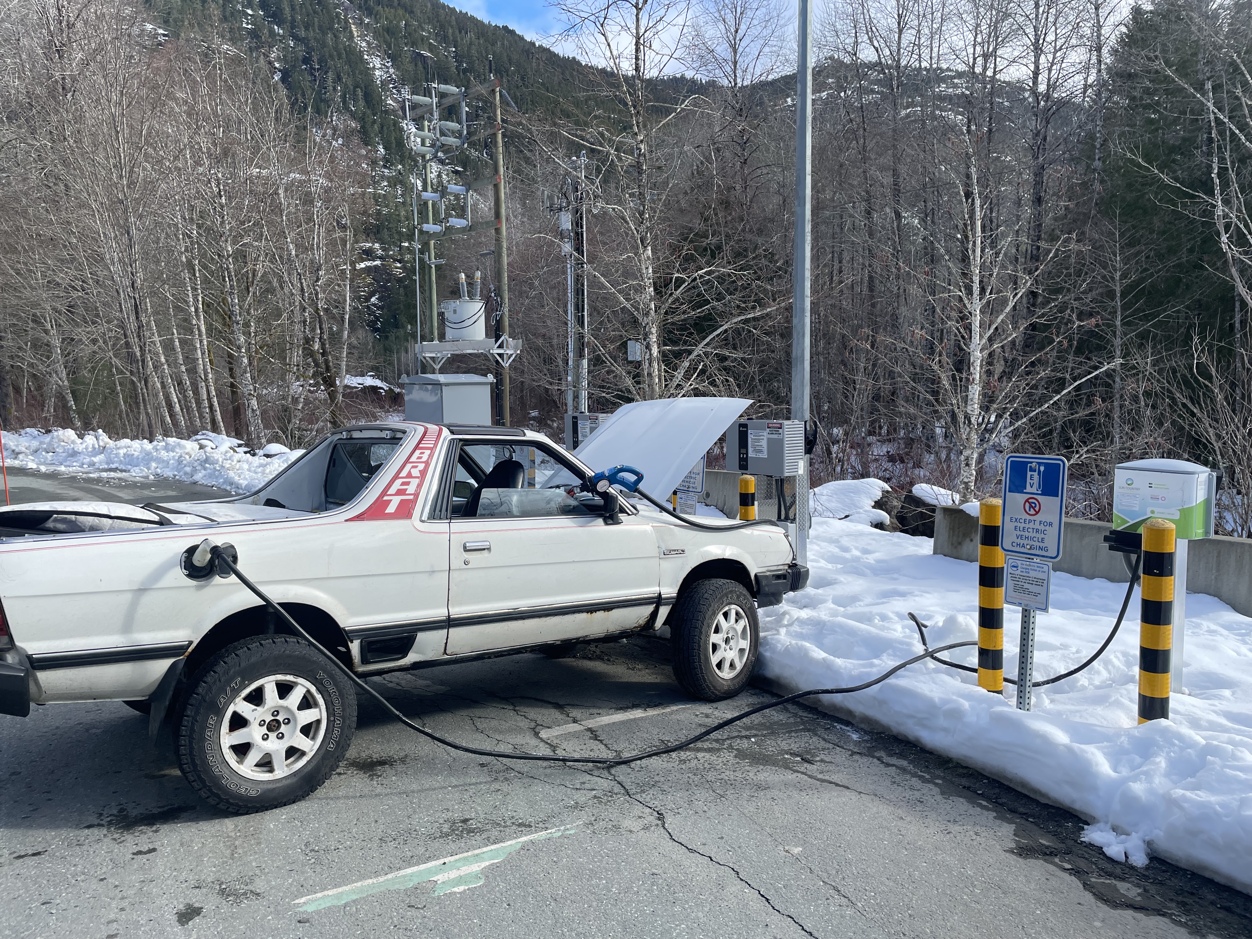

currently my only vehicle. i daily drive it. 60-70% of the time its off road (on logging roads, etc) its seen a lot of abuse!

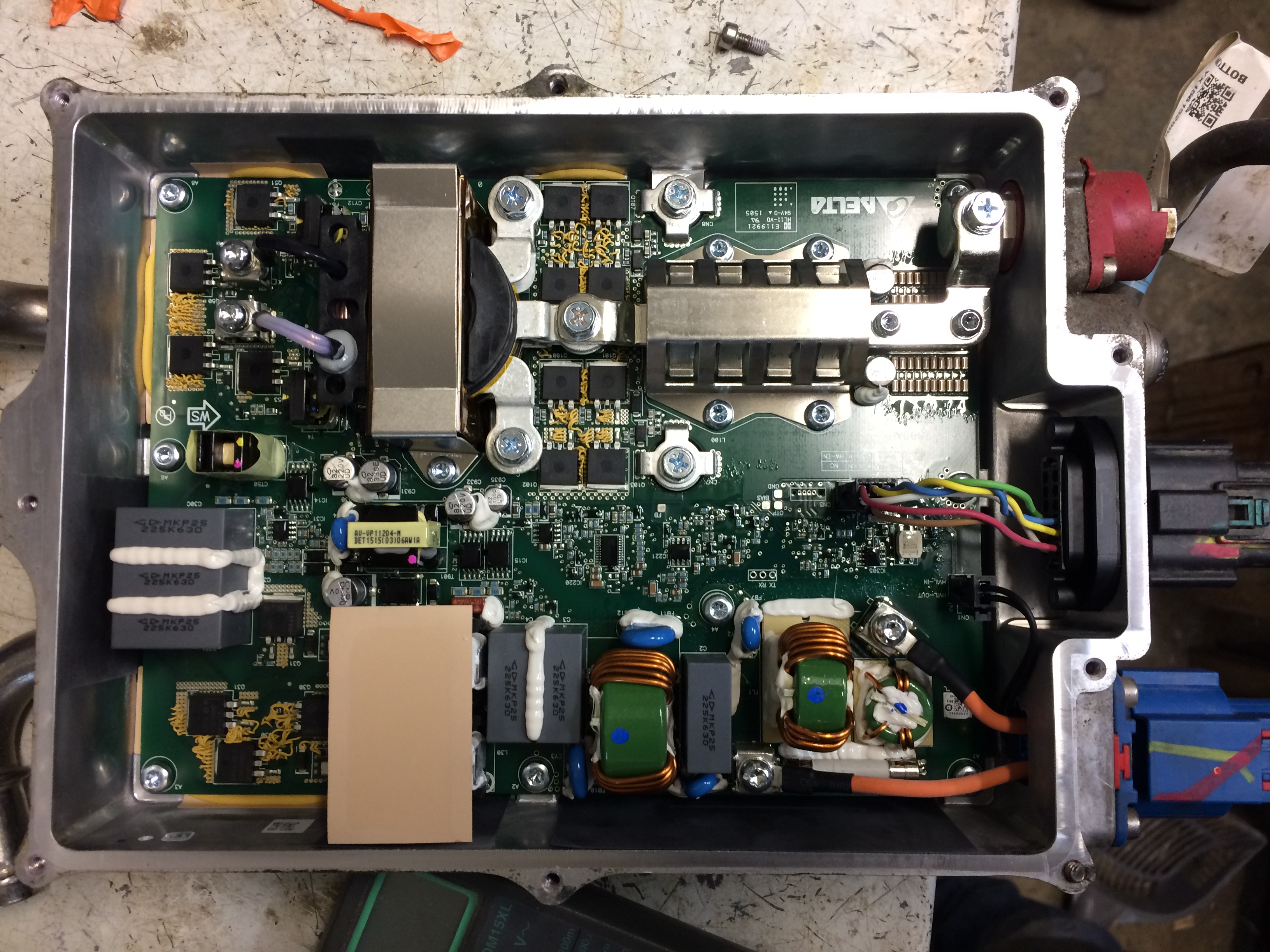

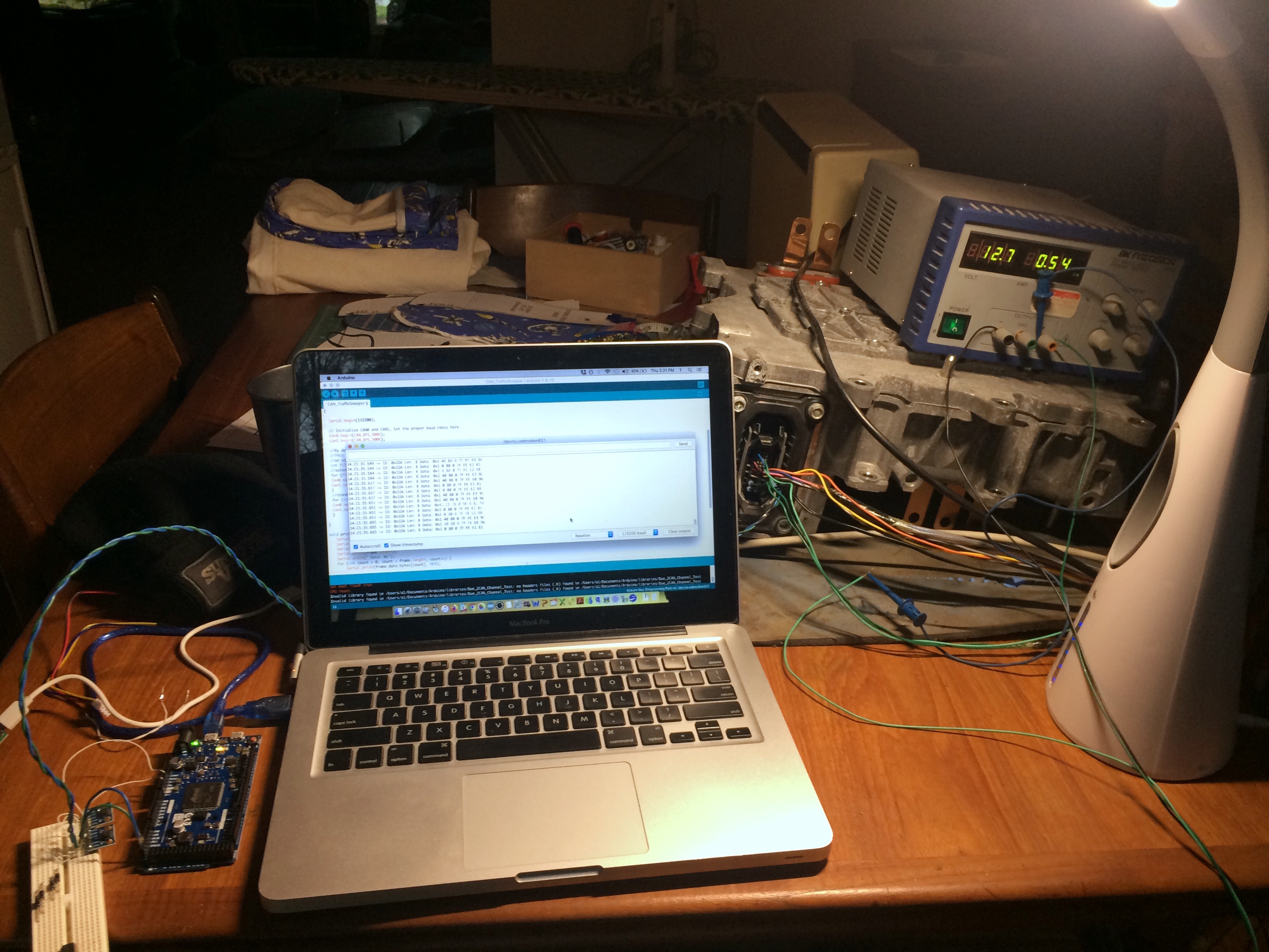

I have all of the main parts now, and some time off
First off:
Tesla model s dcdc convert, supply it with 12v to the enable pin/case ground and it starts spitting out 13.5v!
Established can communication between the Arduino due and the gen 2 leaf inverter.
First off:
- Posts: 3795
- Has thanked: 166 times
- Been thanked: 411 times
Re: Leaf powerd lifted Subaru BRAT
Can you post Tesla DCDC details with pinout diagram on car conversion hardware section?Bratitude wrote: ↑Thu Jan 23, 2020 10:41 pm I have all of the main parts now, and some time off

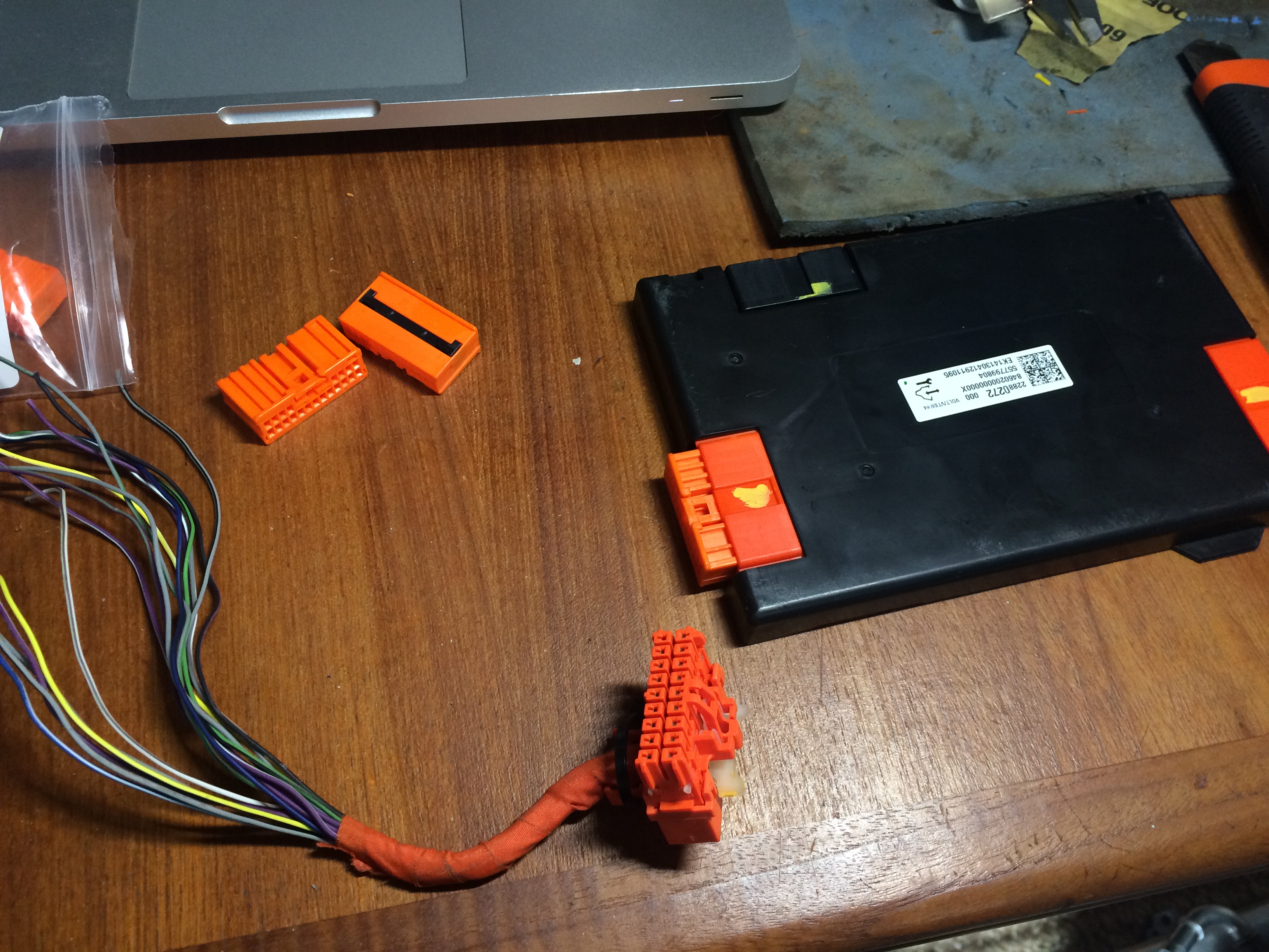

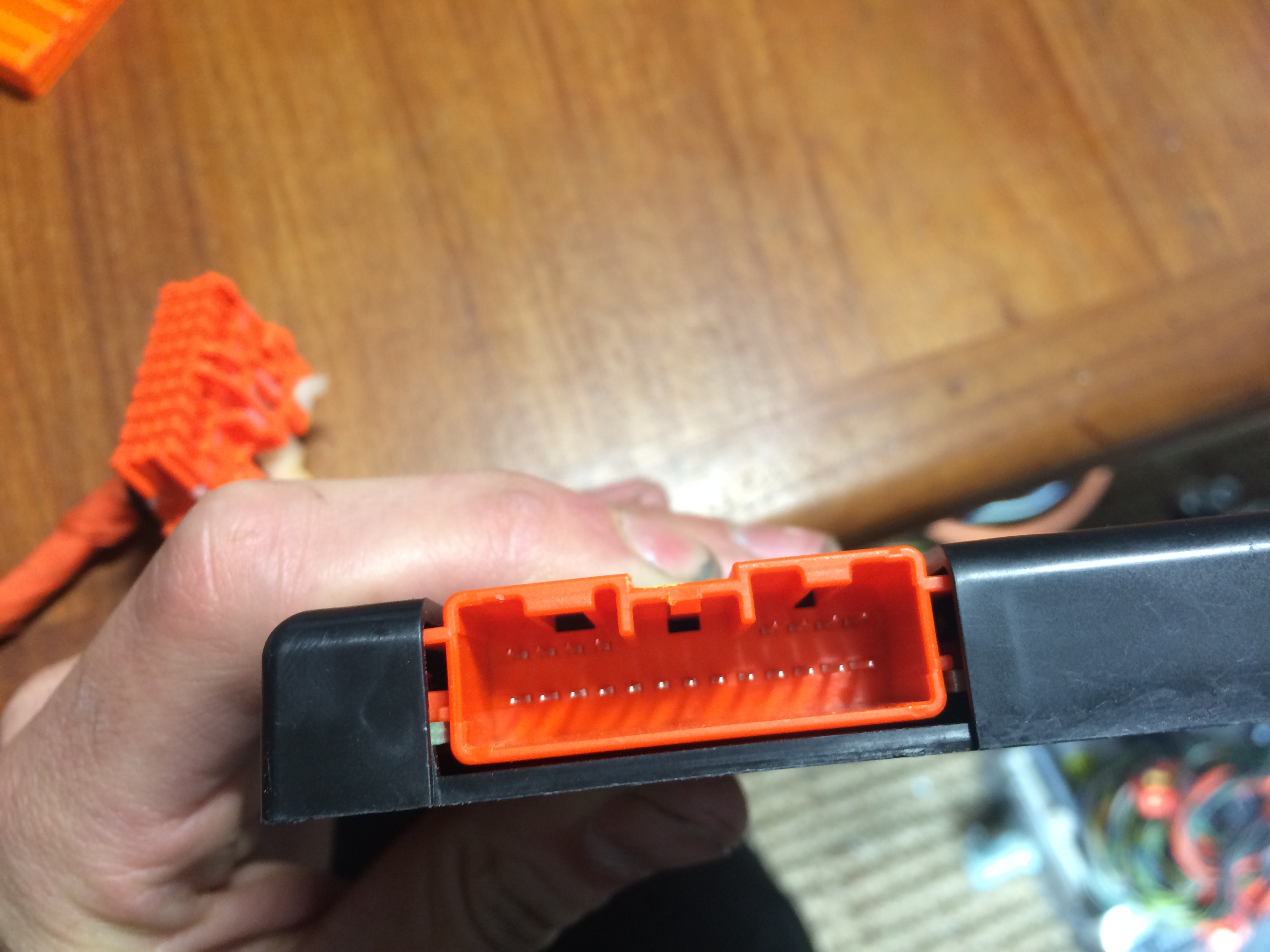

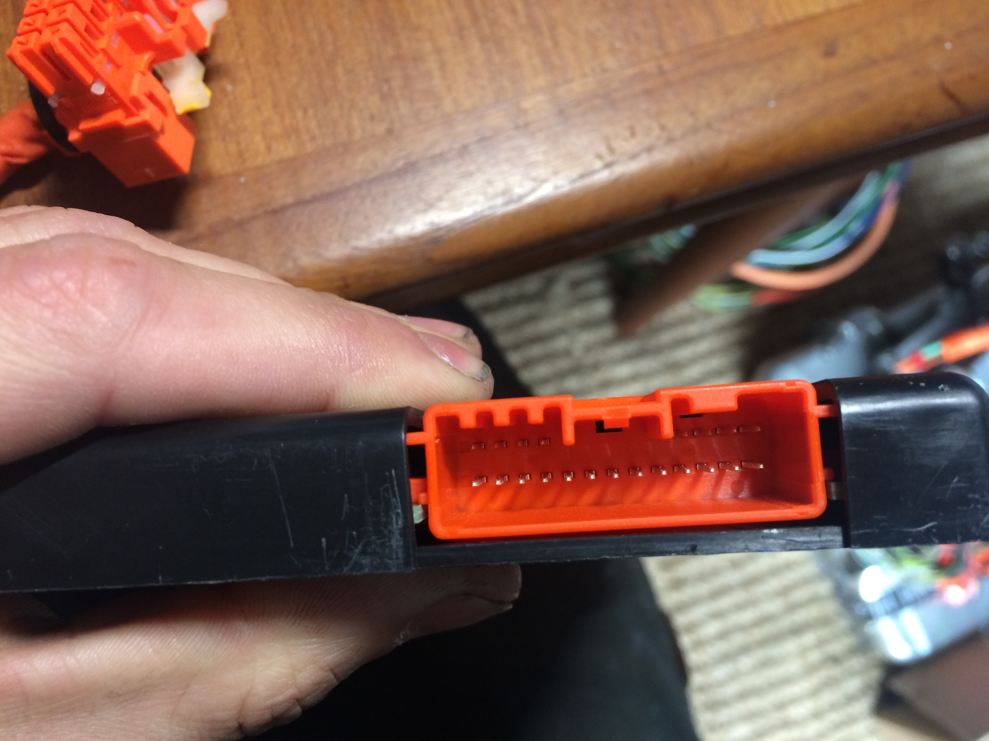

Being that I have a gen2 Chevy volt battery, and there’s no real good data on interfacing with it, I picked up a gen 1 bms.
I ordered 9 connectors that fit into the Chevy volt gen 1 bms and the the pins.
Part numbers:
ATLPB-21-2CD
SAIT-A02GF-M064
2 of the 9 connectors on the bms have a slightly different slot pattern, couldn’t find what part number they are so I plan on just shaving 2 of the new connectors down a bit. Striped the gen2 bms loom and got the battery side connectors.
I have the pinout data on the battery side of gen 1, but not the bms side.
Anyone have the gen1 bms side pinout info?
Looks like every bms-to-battery connections is the same (expect the 2 different slotted connectors) on the gen1.

- Posts: 2962
- Has thanked: 328 times
- Been thanked: 847 times
https://github.com/tomdebree/AmperaBatt ... slaves.pdf
This pdf should have all of the conenctors I believe.

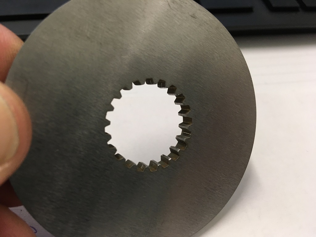

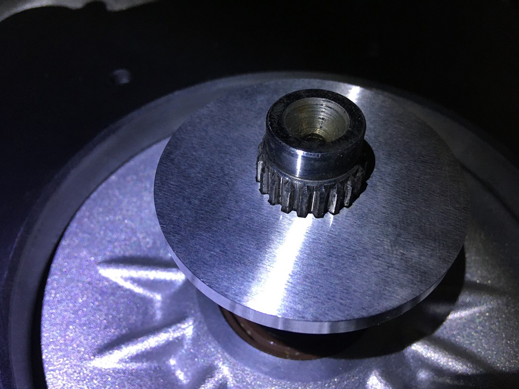

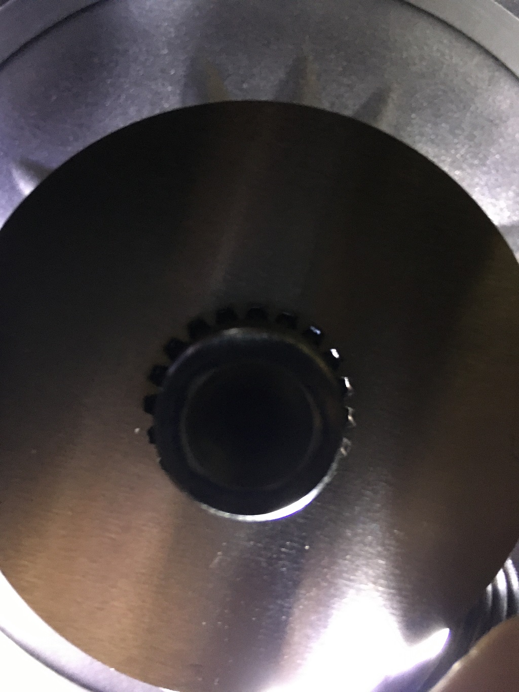

Still working on the actual splines but here’s what I have so far, this is a snug fit on to a gen 2 leaf motor. Mates with a rotex gs 38 coupler
https://github.com/angusjo/leaf-splines ... upler1.STL

how much to you think something like that would cost to machine ?Bratitude wrote: ↑Mon Feb 10, 2020 5:12 pm Still working on the actual splines but here’s what I have so far, this is a snug fit on to a gen 2 leaf motor. Mates with a rotex gs 38 coupler
- Bratitude
- Posts: 1156
- Location: Canada
- Has thanked: 246 times
- Been thanked: 469 times
Not sure, plan on getting it 3d printed out of steel or titanium and seeing how that Holds up. Which would cost around 30-50$ cad.zippy500 wrote: ↑Tue Feb 11, 2020 6:53 pmhow much to you think something like that would cost to machine ?Bratitude wrote: ↑Mon Feb 10, 2020 5:12 pm Still working on the actual splines but here’s what I have so far, this is a snug fit on to a gen 2 leaf motor. Mates with a rotex gs 38 coupler
Something much simpler that would bolt to a rotex coupler might be reasonably priced if machined.

I don't want to rain on your parade, but that drawing is meant for 3d printer. Is a bunch of triangles not dots. Did you by chance made an accurate machining part in Solidworks or other CAD software too? Can you export one?

soildworks file is in the repo.
Splines are currently “straight cut” not involuted yet. still adjusting mesh and pressure angle. maybe I’ll post just the spline renderings i print in plastic, used for testing.

Well I printed a plastic one from your STL and it is indeed a snug fit on the leaf shaft. Something like this might save me from having to butcher my leaf gearbox input shaft. I hadn't considered metal 3d printing.
- Bratitude
- Posts: 1156
- Location: Canada
Awesome, you print the full part? I have only printed sections of the spline for testing.doobedoobedo wrote: ↑Wed Feb 12, 2020 7:20 pm Well I printed a plastic one from your STL and it is indeed a snug fit on the leaf shaft. Something like this might save me from having to butcher my leaf gearbox input shaft. I hadn't considered metal 3d printing.
Did it seal nice over the o-ring on the shaft?
The idea is to oil up the shaft and have it seal, just like in the gear box.

Yes I printed the whole thing, not particularly solidly and at quite crude settings. I just wanted to see if it'd fit.
It will go over the o-ring, but I didn't push it on that far, like I said it's a snug fit, I had to knock it on and lever it off.
If I'd pushed it all the way on I would have had to destroy it to get it off. As it is the levering left dents. It's getting easier to get on and off though, as I'd expect.

Oh okay, yes I think the trough of the splines is catching the crown of the leaf, I’ll have an update next few days with it involuted as welldoobedoobedo wrote: ↑Wed Feb 12, 2020 8:55 pm Yes I printed the whole thing, not particularly solidly and at quite crude settings. I just wanted to see if it'd fit.

Hello,
I'm really happy, that Bratitude did his 3d model of spline in last days, because I was searching my way to replace my spline from Multipla 1.6 clutch disc. First I want to go to to Honda 1.8 spline, which like Zapatero said was a little to loose ( about 0,2mm) but then I was curious how will fit spline from You.
Result after wire cutter EDM is visible on pictures. Like is written above: higher diameter is ok, lower 19,22 is a little to small and was needed to brush a little with sand paper, so in next version first I will cut by wire and next make chamfer on end and clean inside on internal grinding machine. Everything will be welded inside of Rotex also with small endpoint for motor axis.
I hope this will good and will be not necessary to take one more time gearbox out.
Bratitude: thanks for Your job

Hmm. I know a place where they could laser cut discs like that damien.io just posted. Should I arrange for group buy? Postage from Finland is propably high though..
