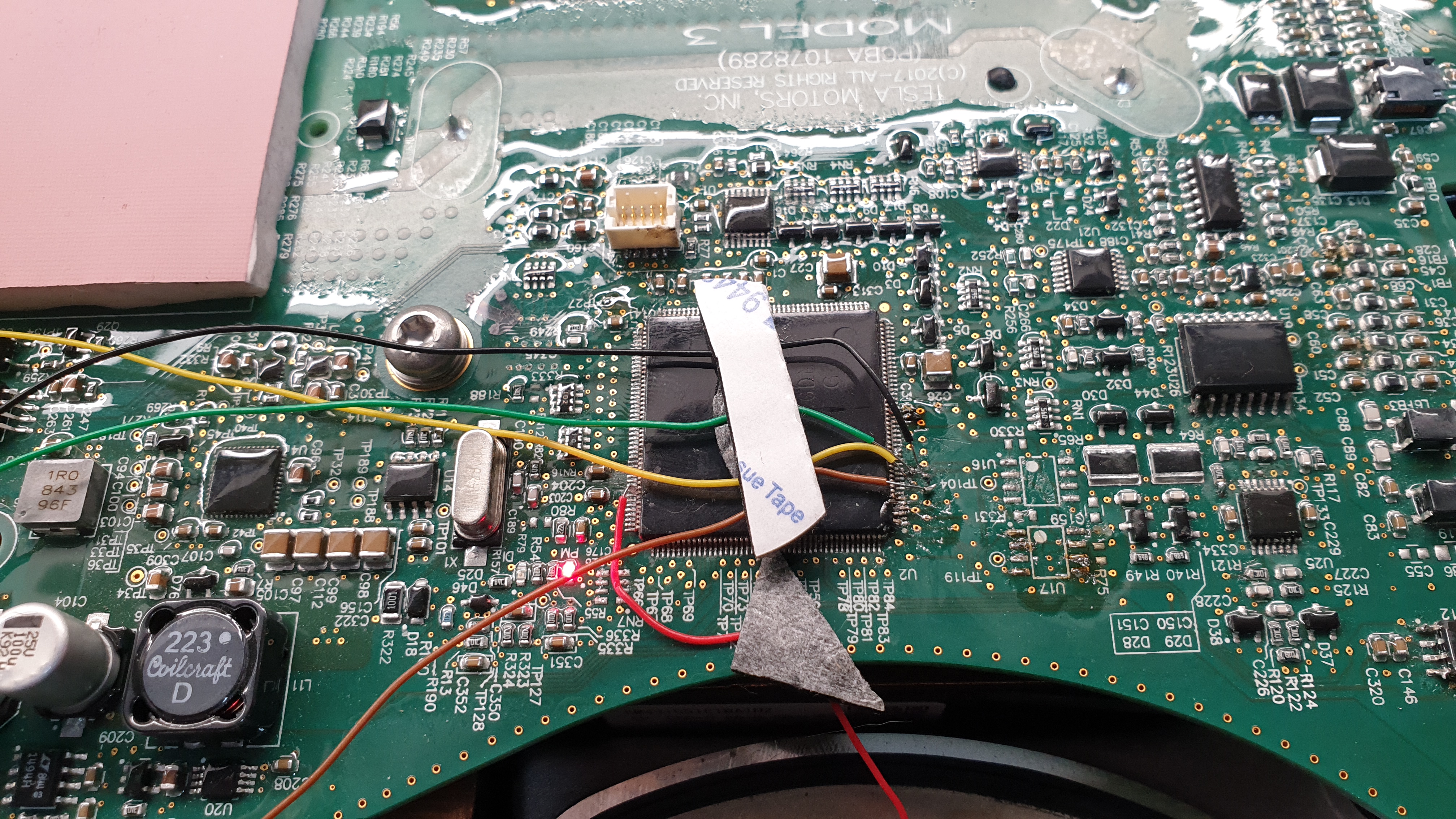

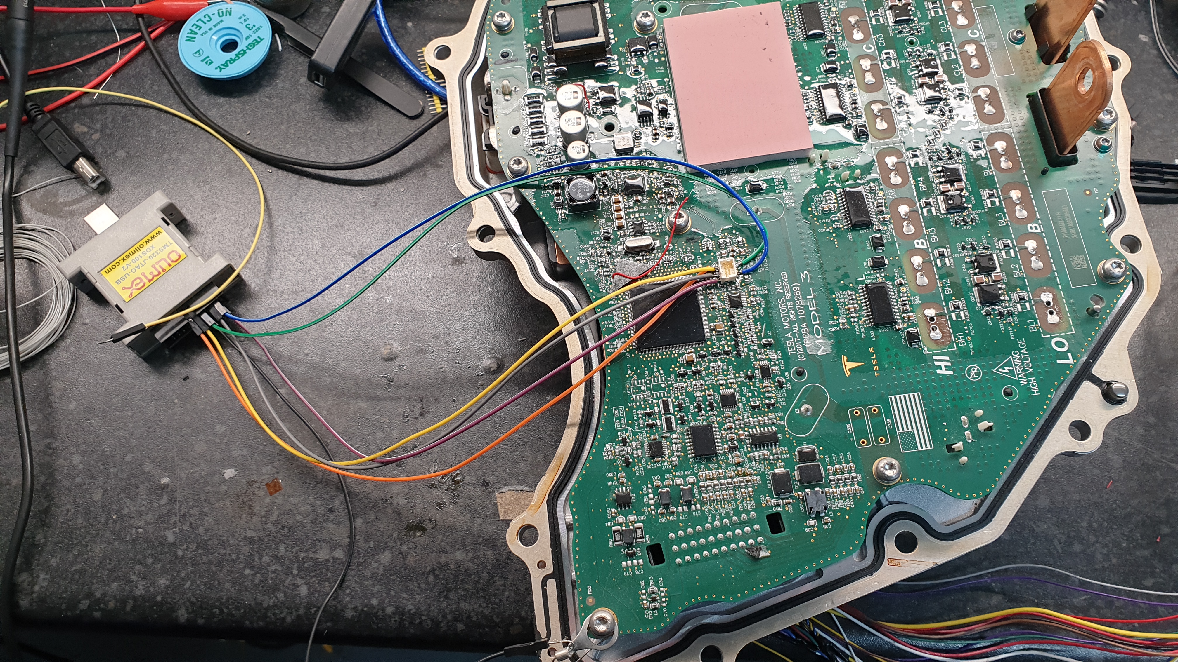

- Posts: 4007
- Been thanked: 1137 times
Scratched an itch and tried Jtaging the Musk brain. Imagine my surprise when it didn't work. Oh well, better give up and go home ....
Attached pinout (as best as I could make anyway) of the 10 pin Jtag port.
