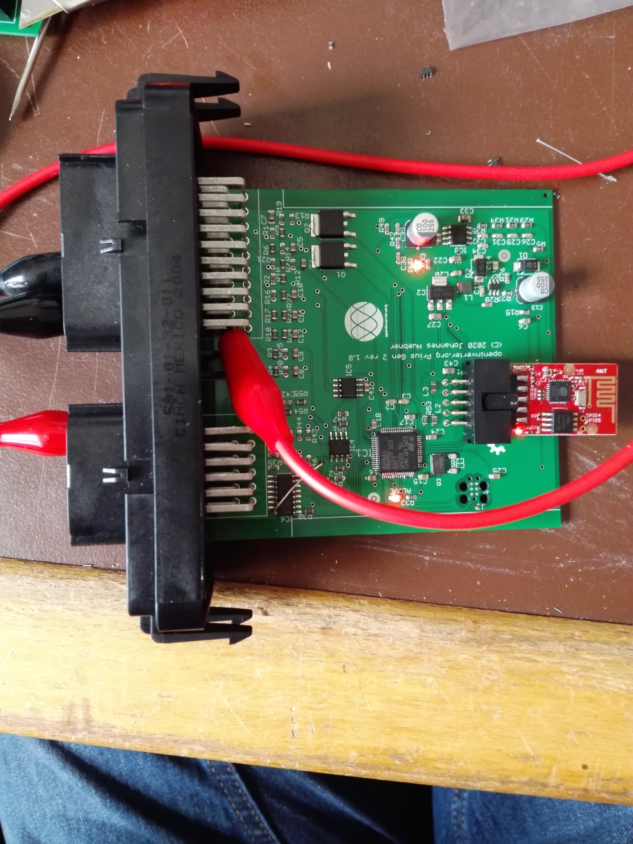

Finally I have on my desk what you've all been waiting for :) Almost at least. There are a couple of issues:
- The STM32 is rotated 90° :? It must be JLCs fault this time, the pin marker looked correct on my order
- The 3V3 pin on the programming points is not connected to 3V3 - my fault
- The reset pin on the programming is interrupted - my fault, but irrelevant, it is not needed for programming
The the last two items are easy fixed, the first one is a pita. Since I don't have a hot air station I cut the processor off and replaced it with a fresh one.
So far I've tested:
- new excitation circuit: works a treat! Even my 4Ohm (plus 10 Ohm resistor) test speaker doesn't make it run overly hot. Even though it consumes 1.4W. With the typical 30 Ohm exciter coil it should run cool.
- precharge and dcsw output mosfets: work, don't mind the turn-off spike
- Desat/power stage over current detection: at 5V5 it switches over to "all good"
- digital inputs: work
Will do more testing now, I think the current sensor circuit needs correction as I've upped the "5V" rail to 5.4V to have sufficient resolver amplitude but forgot to adjust the divider resistors for the offset voltage.

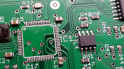

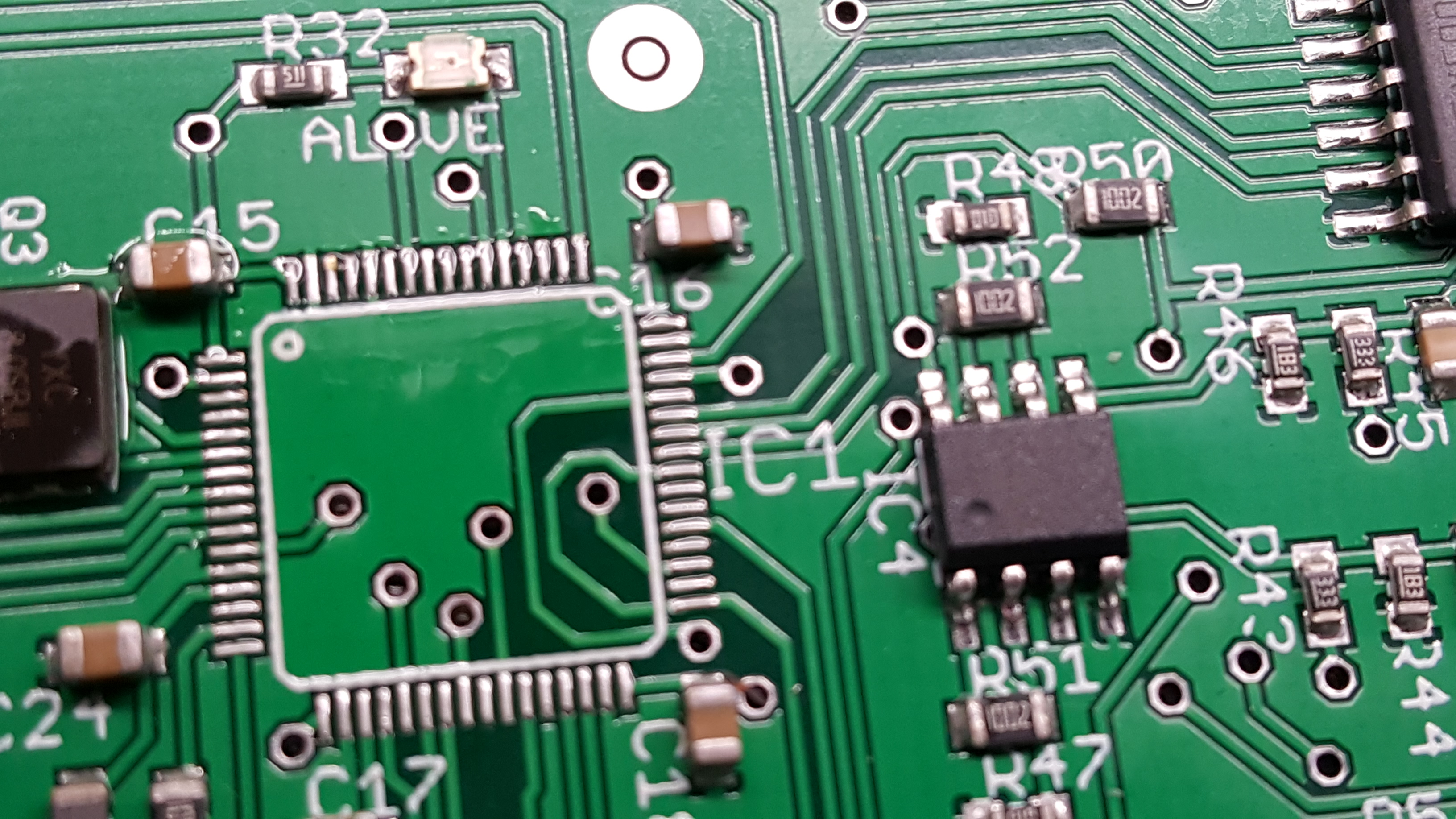

Posts: 4005
Been thanked: 1131 times
Johannes sent me one of the Gen 2 boards to have a play. So Colonel Kurtz and myself got to work. I think I see why JLC got the stm32 orientation wrong. The designator for C16 is just perfectly overlapping the stm32 footprint corner to make it look like a pin 1 mark!
Been thanked: 1914 times
Yes it really does! I hope they don't repeat this in the current order. I did notify them of the mistake though.
