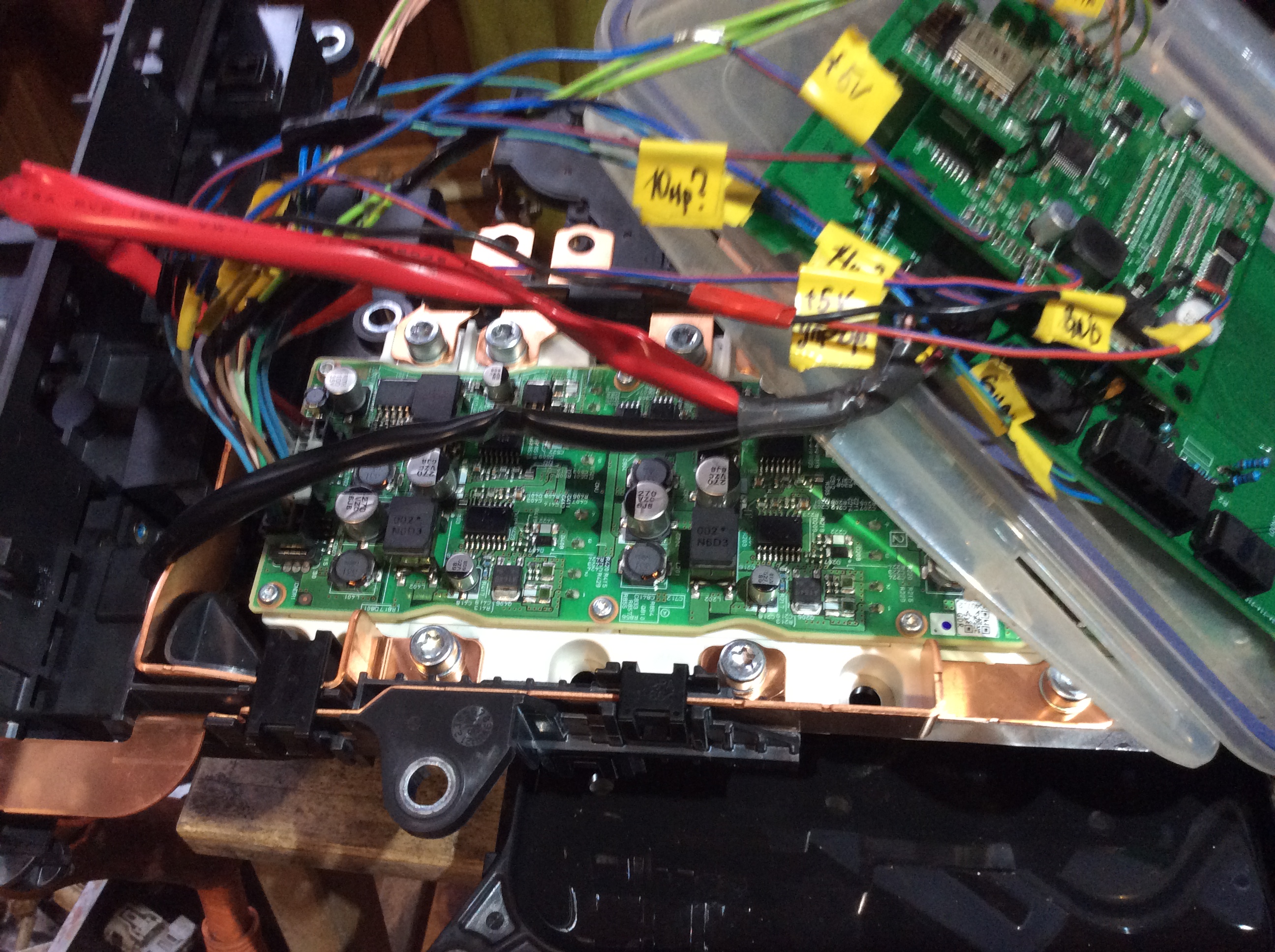

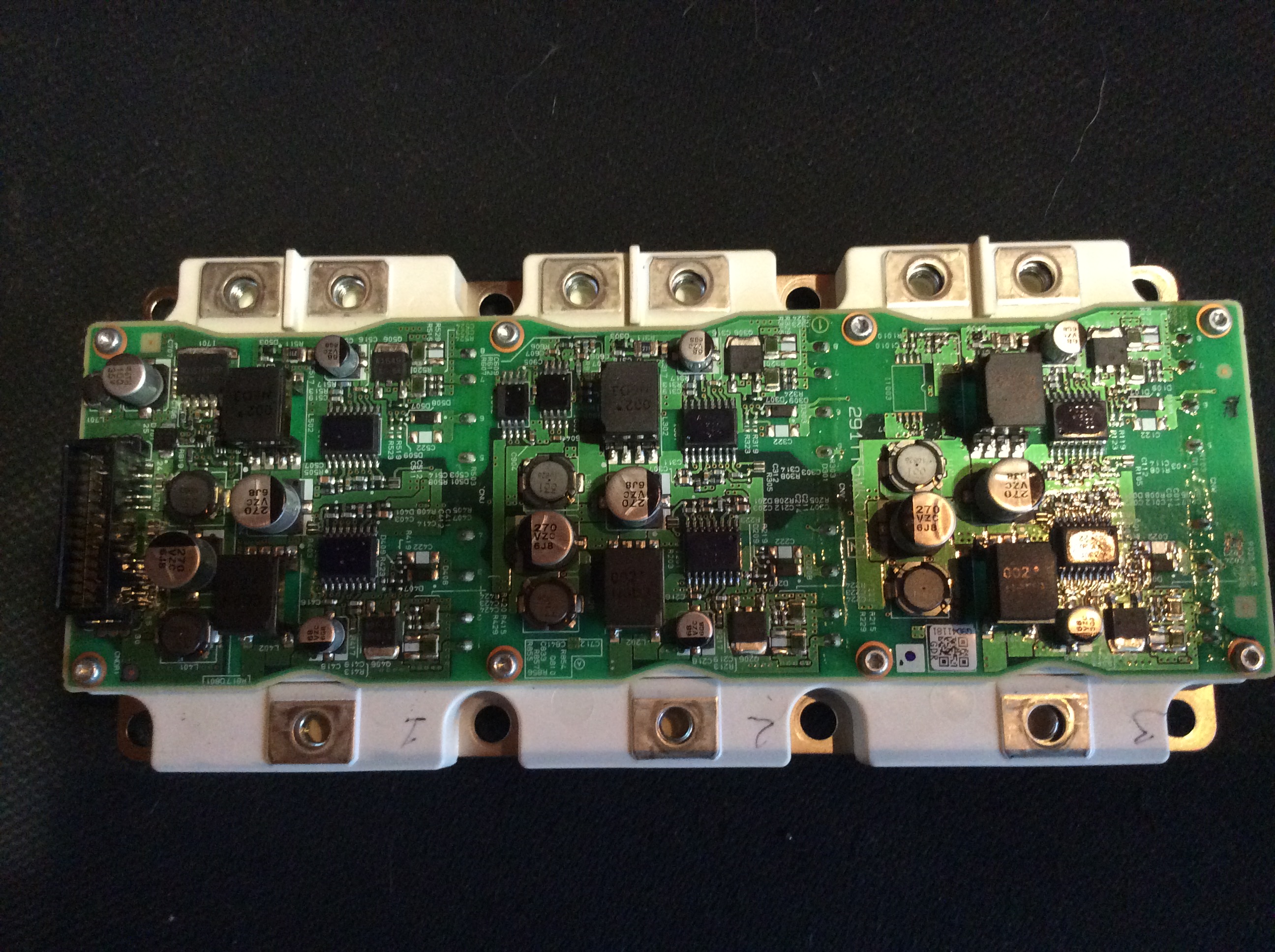

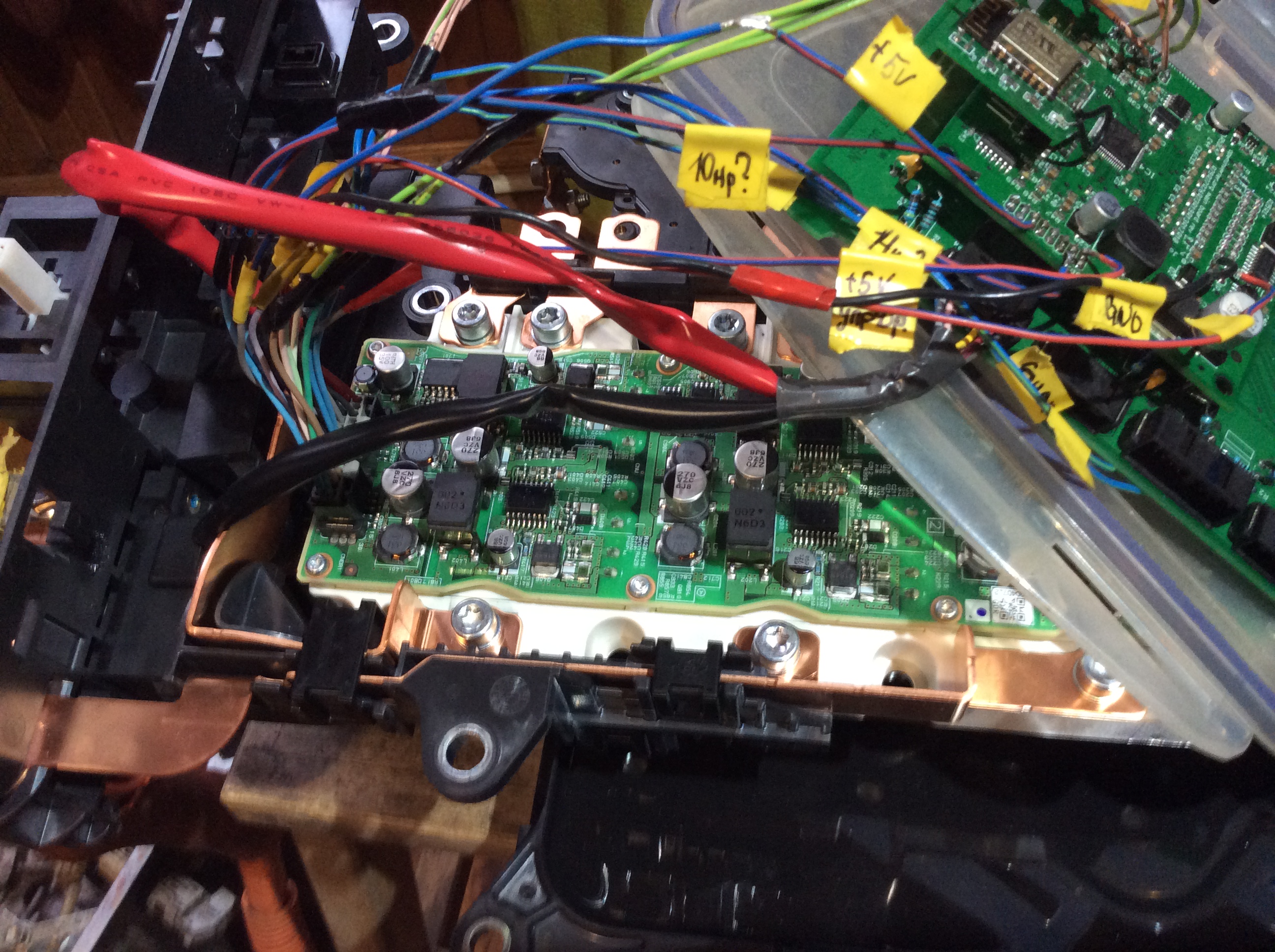

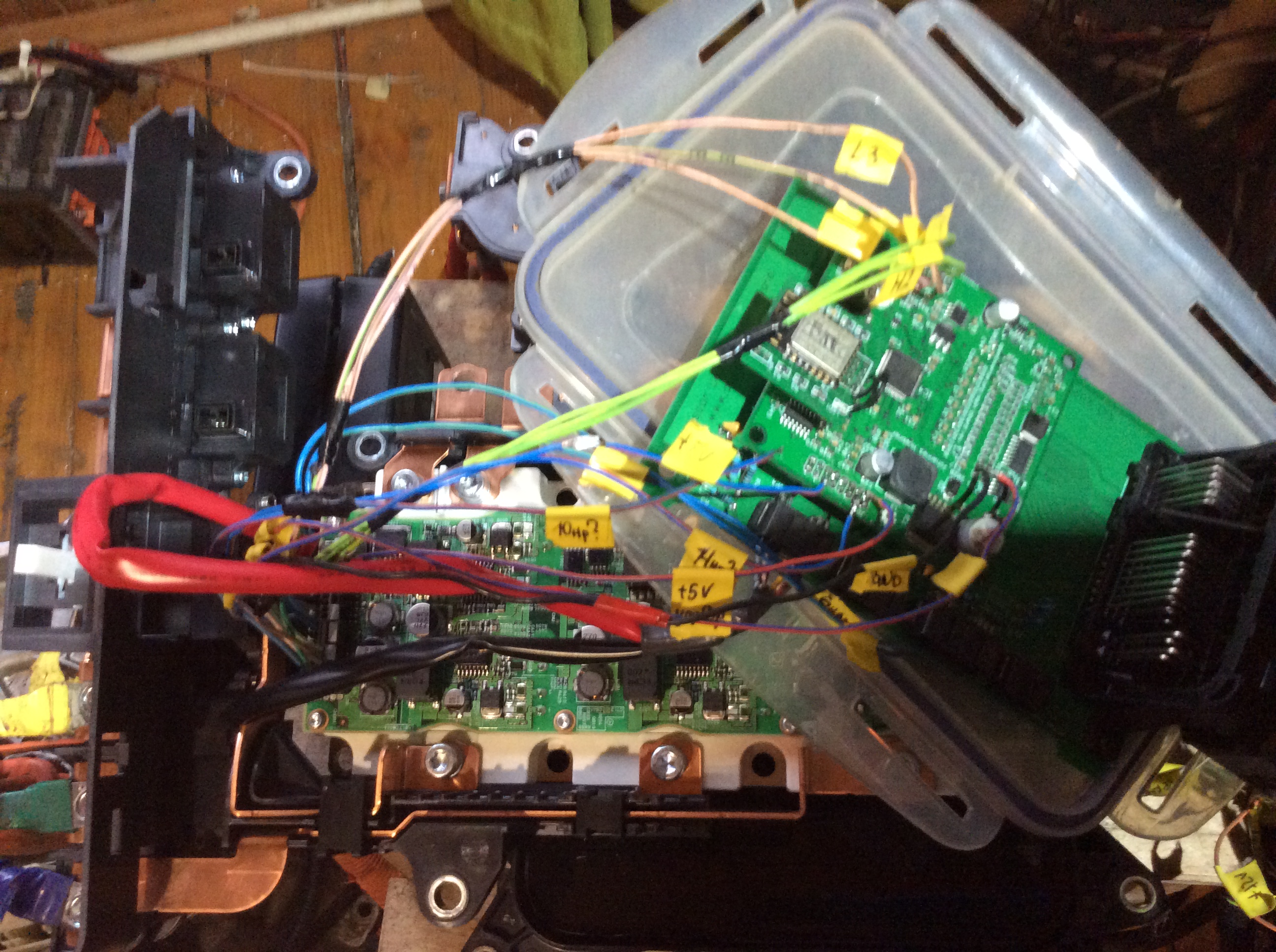

Post by Leo M »
johu wrote: Thu Sep 02, 2021 7:51 pm Early forum release, thanks :)
You can pull more than 225A short term. I've also tuned my inverter to about 120 kW (with the openinverter board) and ran it on the 24 kWh pack. Even went full throttle for a few minutes doing a speed not allowed in Finland ;)
Have you run it in reverse mode? My forward mode works fine, and in reverse mode there is an overcurrent. The settings are all working and tested on other inverters on GEN2 works perfectly! What could be the problem? Please help with advice.....Forward-great! Reverse - overcurrent....(
