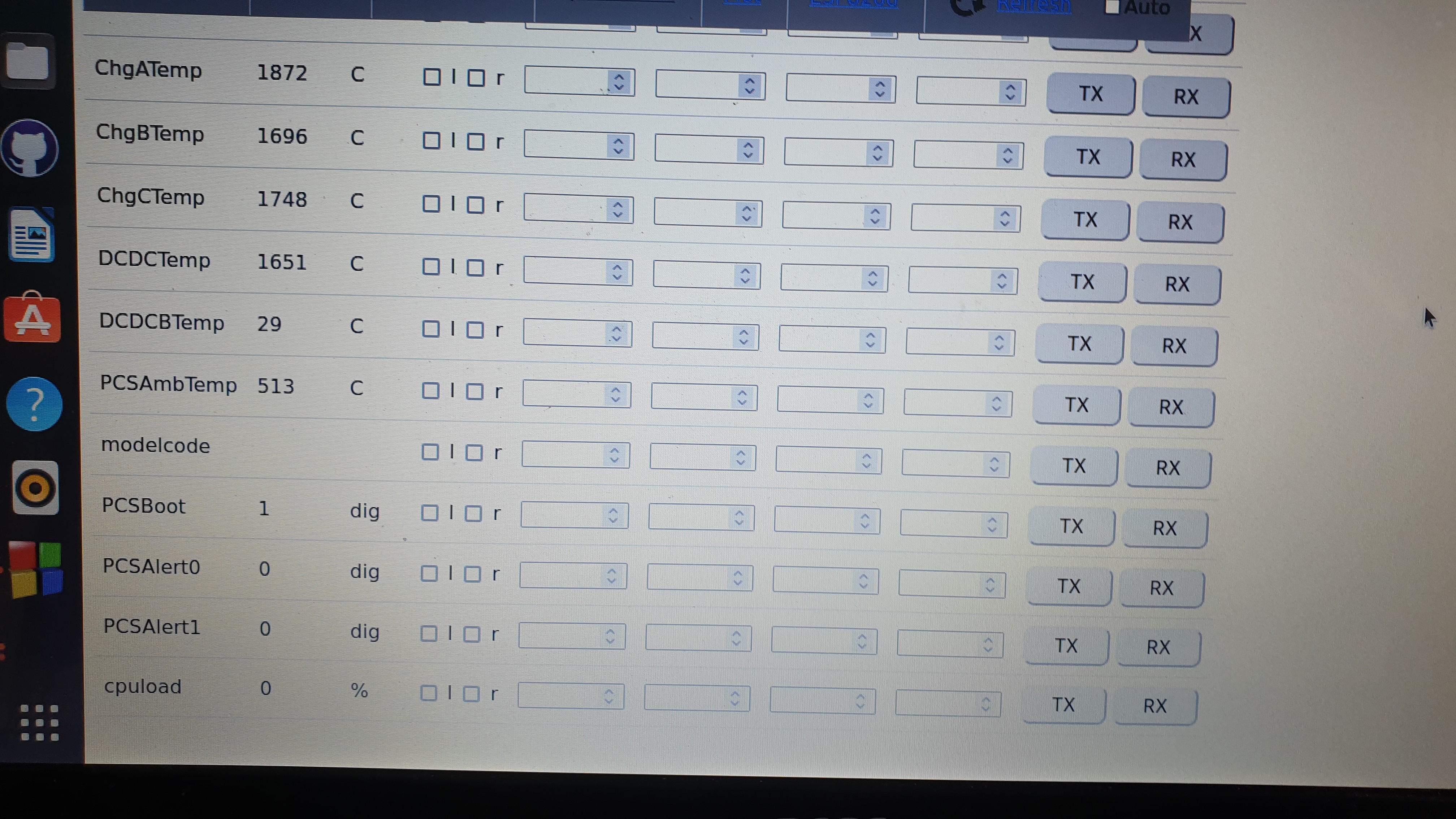

New STM32 software testing on bench. Basic functions all working. As you can see I'm having a "slight" problem with some of the temp calculations. Elon decided 11 bit signed ints are the order of the day and the STM32 (or more likely my lack of programming skills) doens't seem to like that. Anyway, work progresses with the aim of a beta release tomorrow.

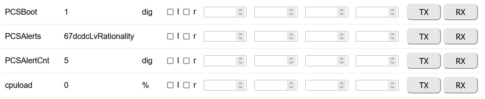

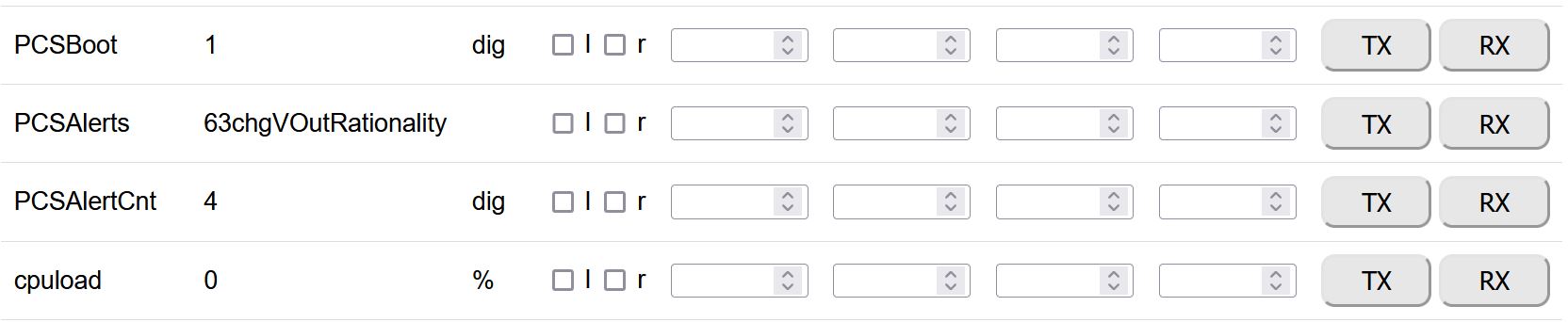

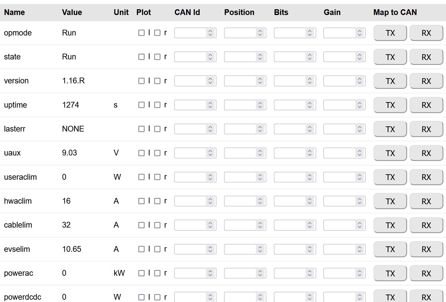

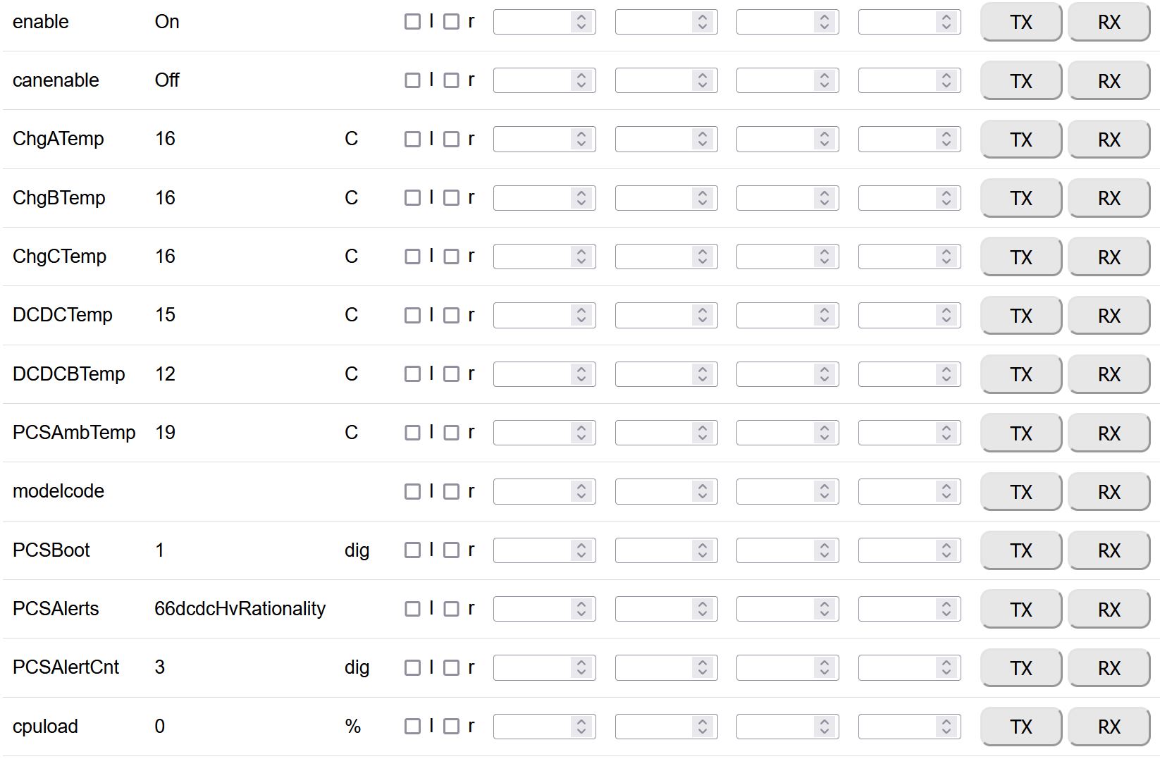

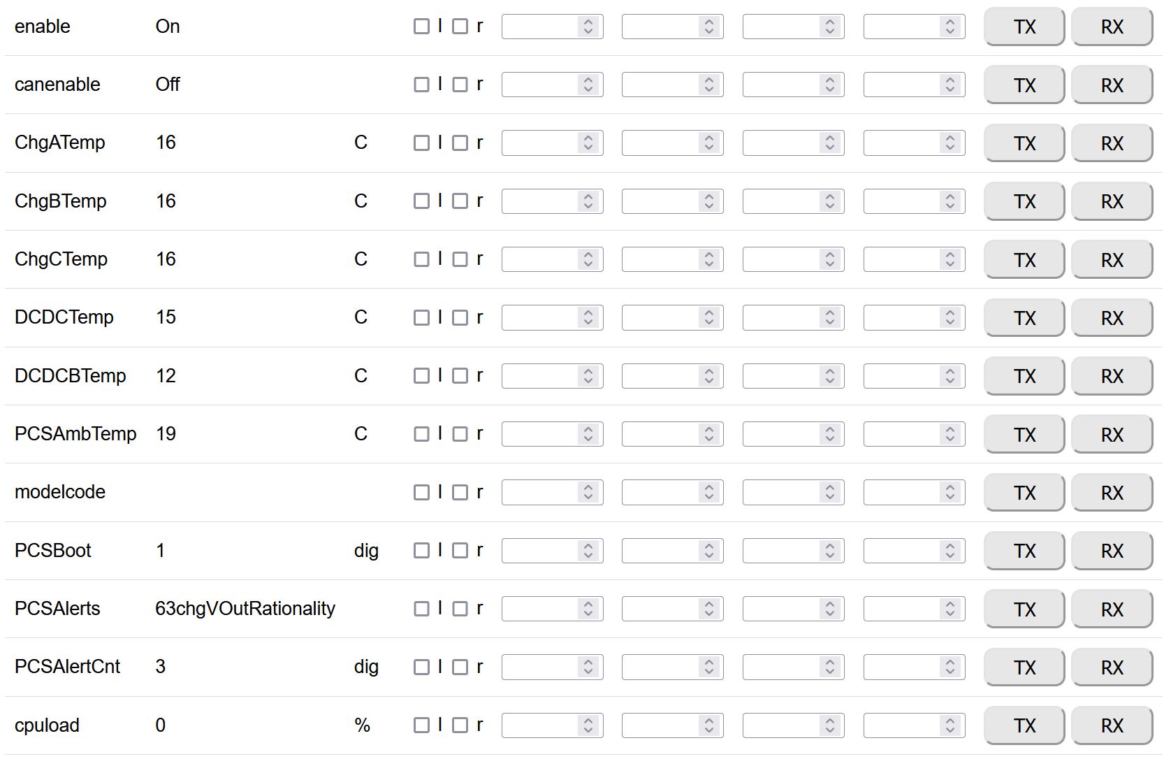

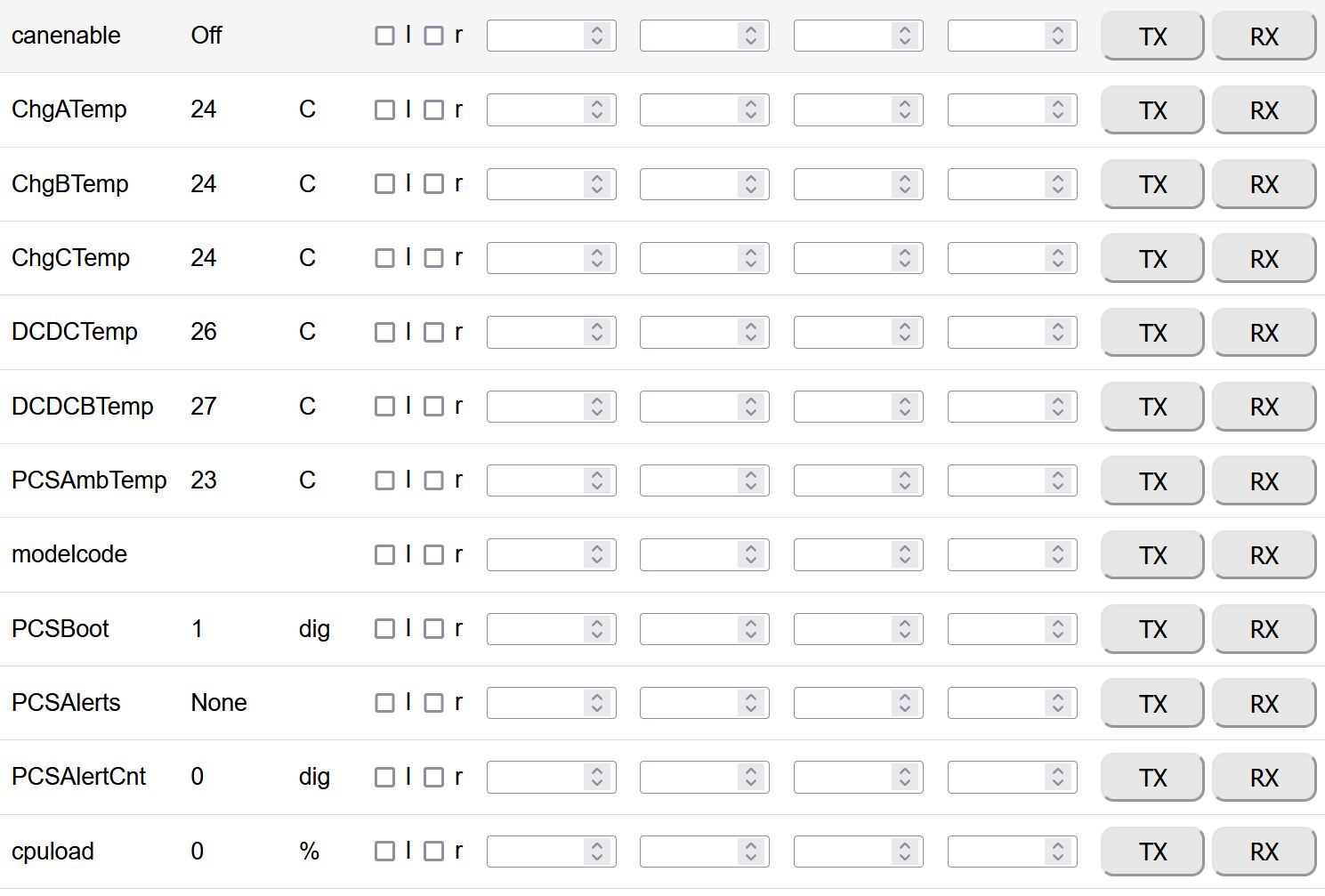

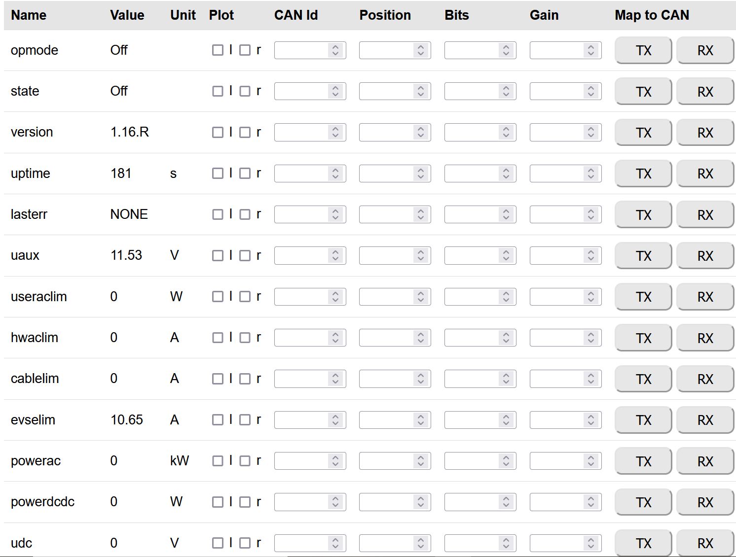

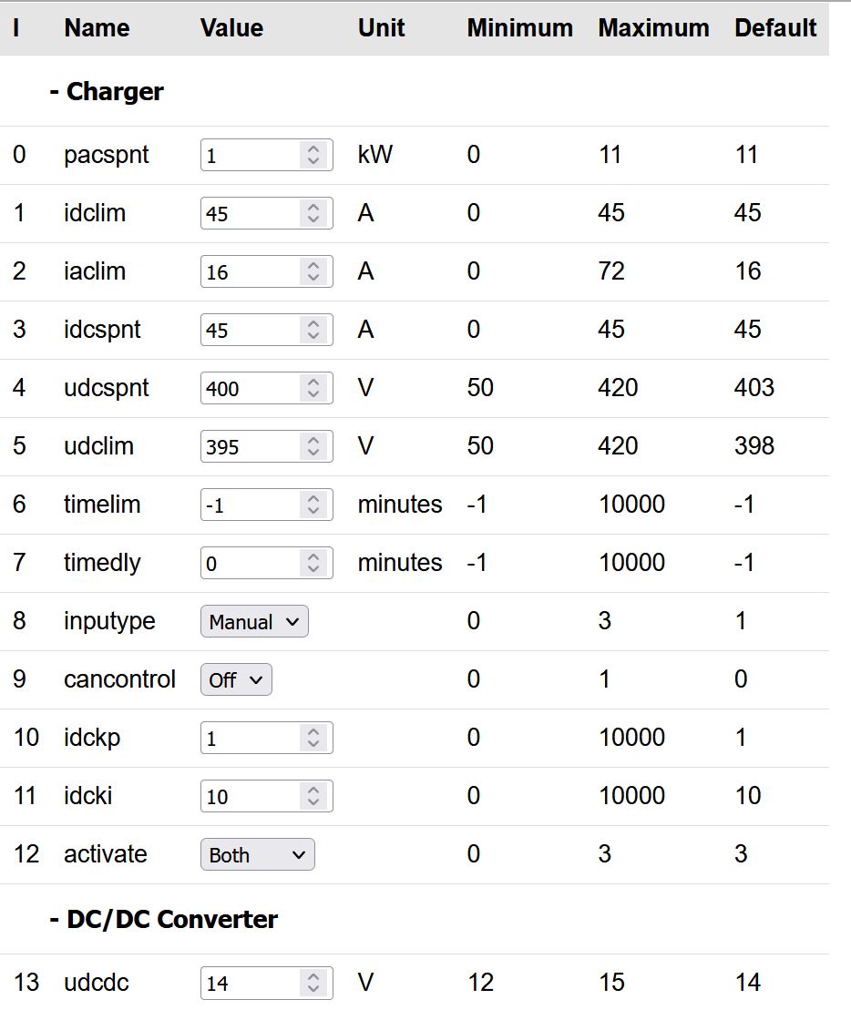

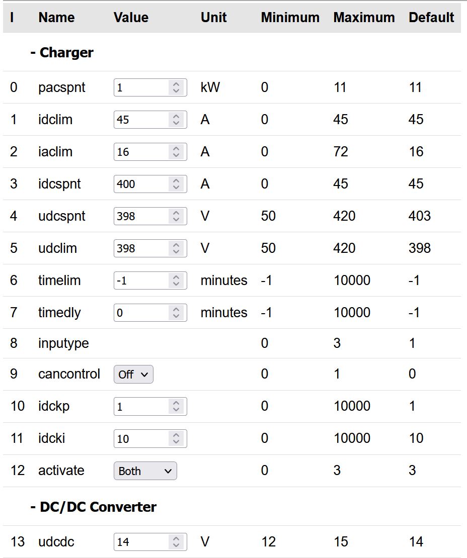

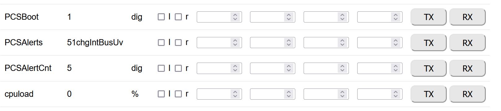

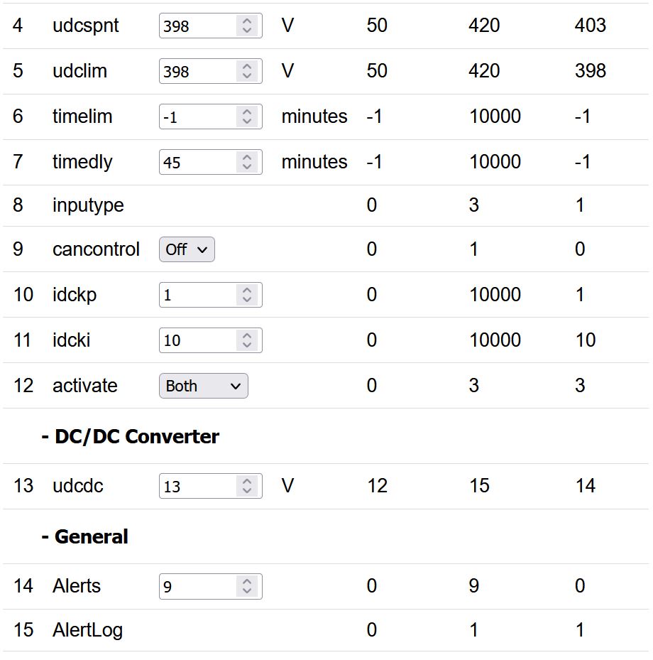

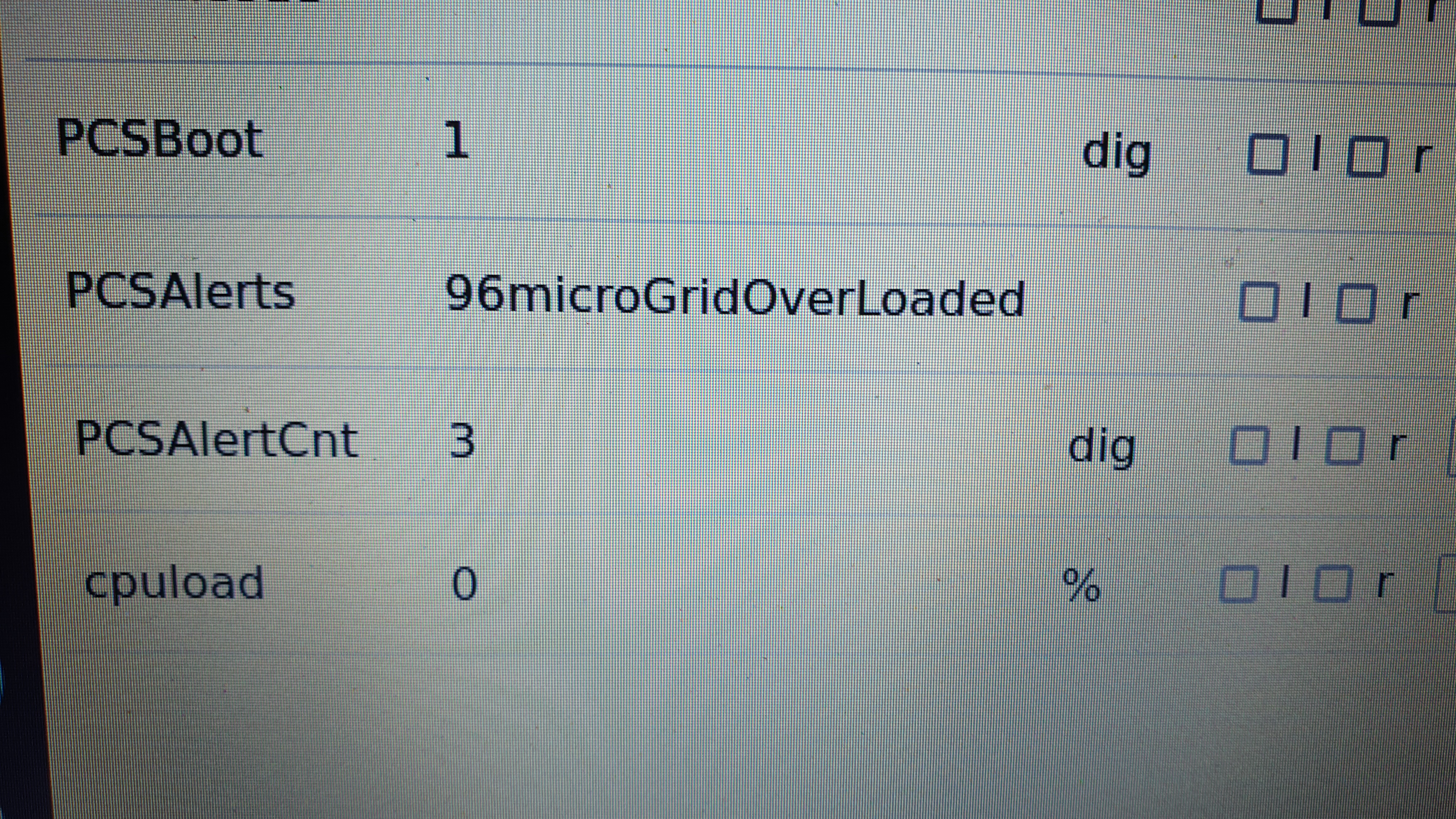

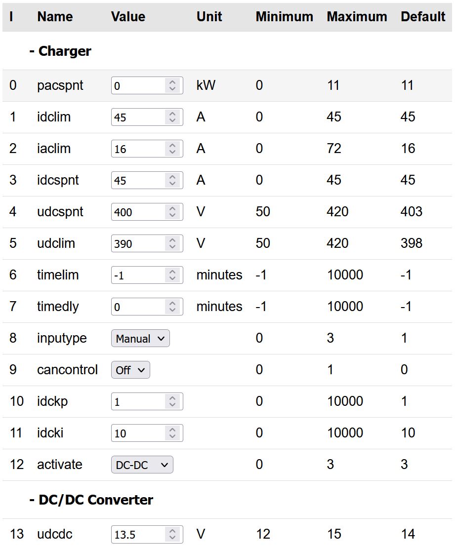

Got to give the Beta firmware a run this morning, nice work JB

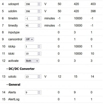

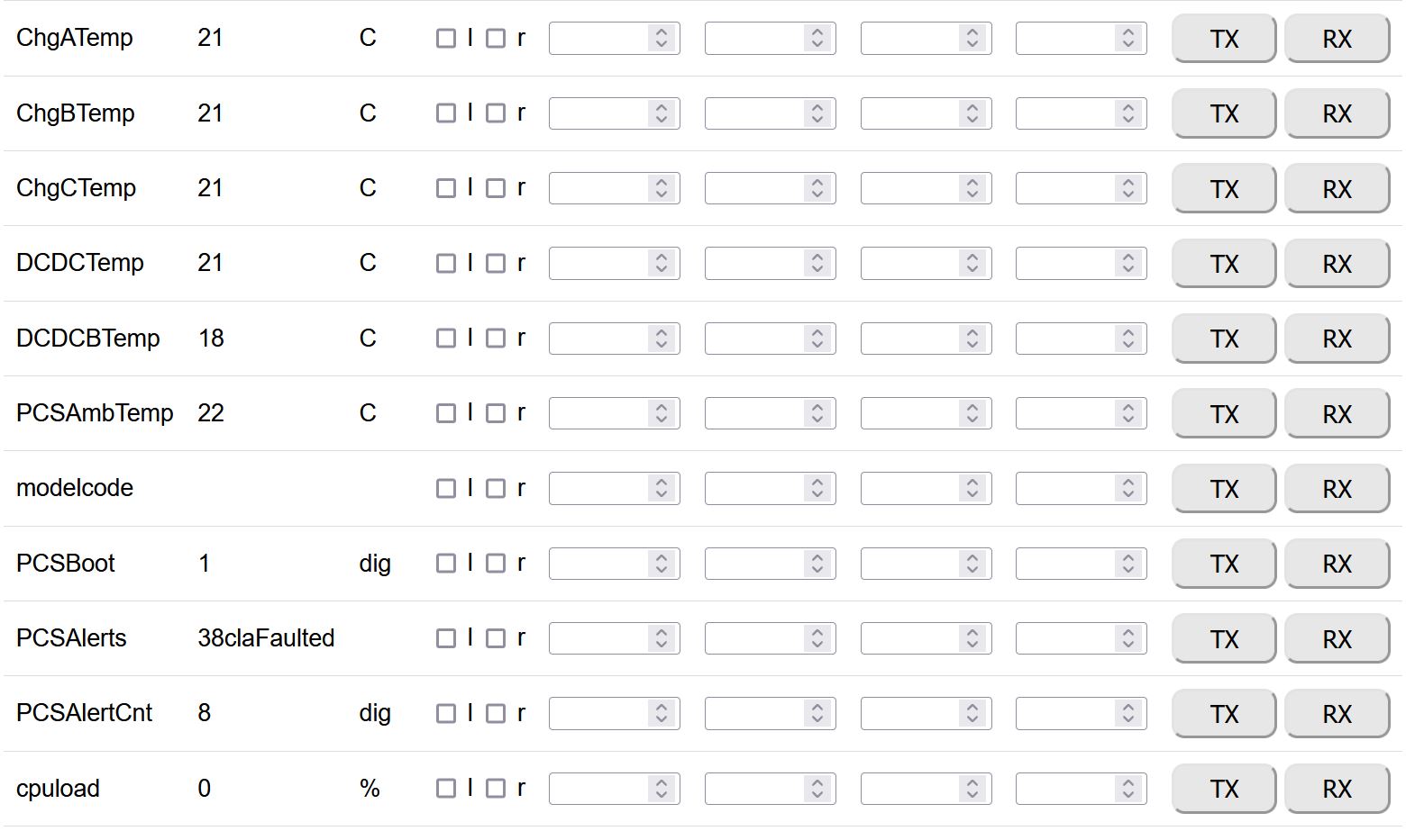

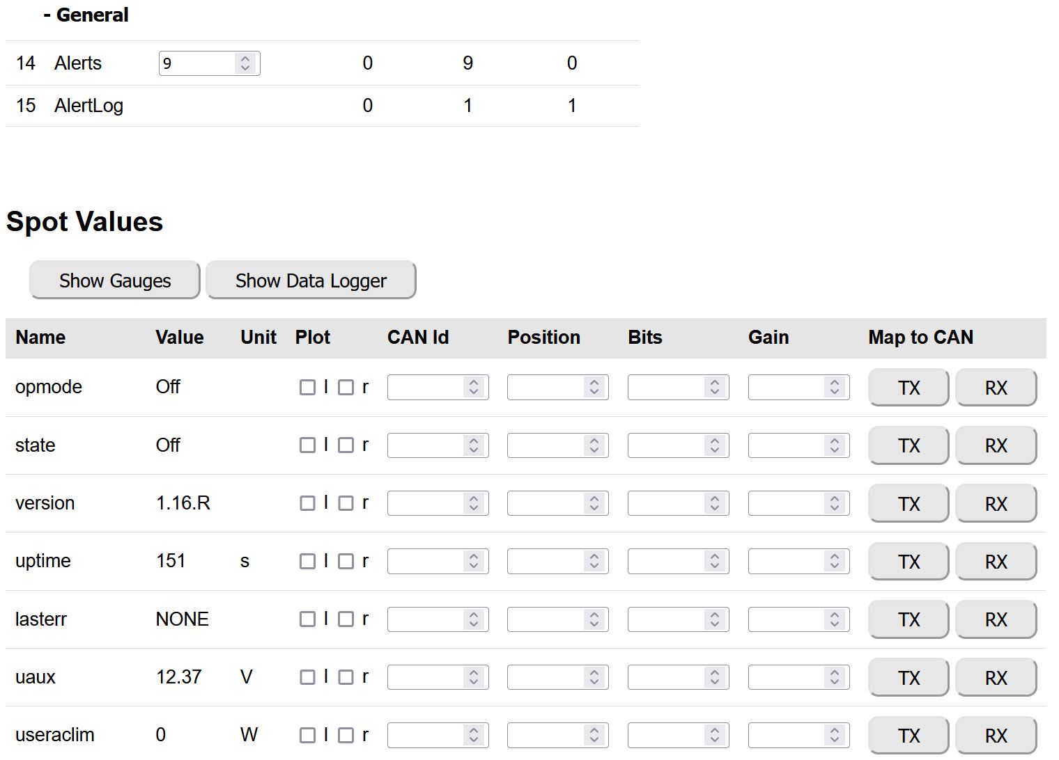

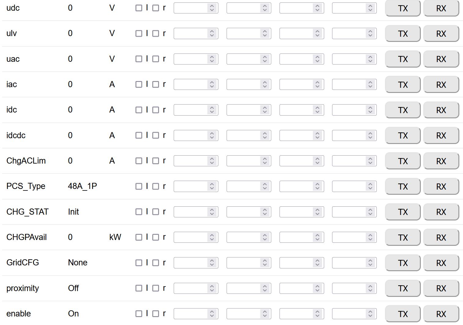

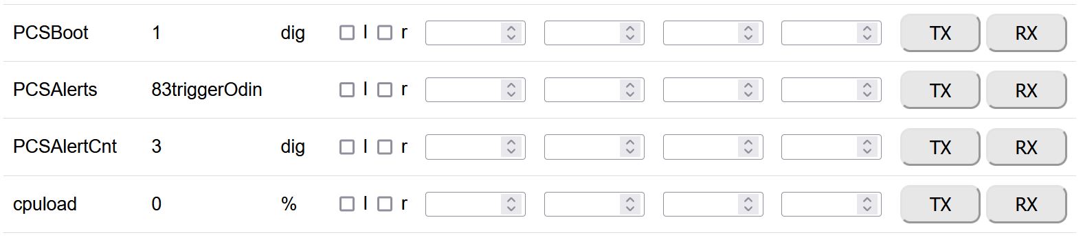

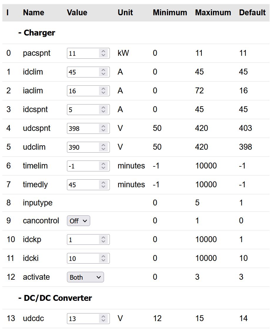

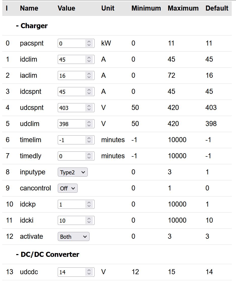

Couple of comments. Some of the default values set after firmware upload fall outside the min and max range for now. Look to be missing some of the drop down selection boxes such as 'inputtype' and 'Alertlog' so couldn't activate the error log test yet

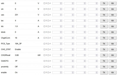

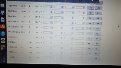

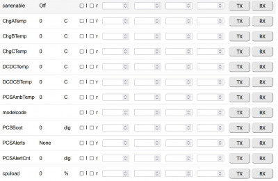

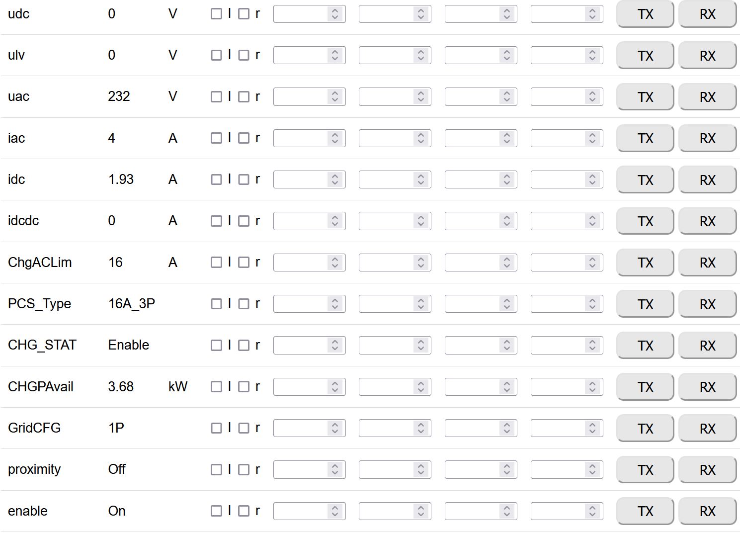

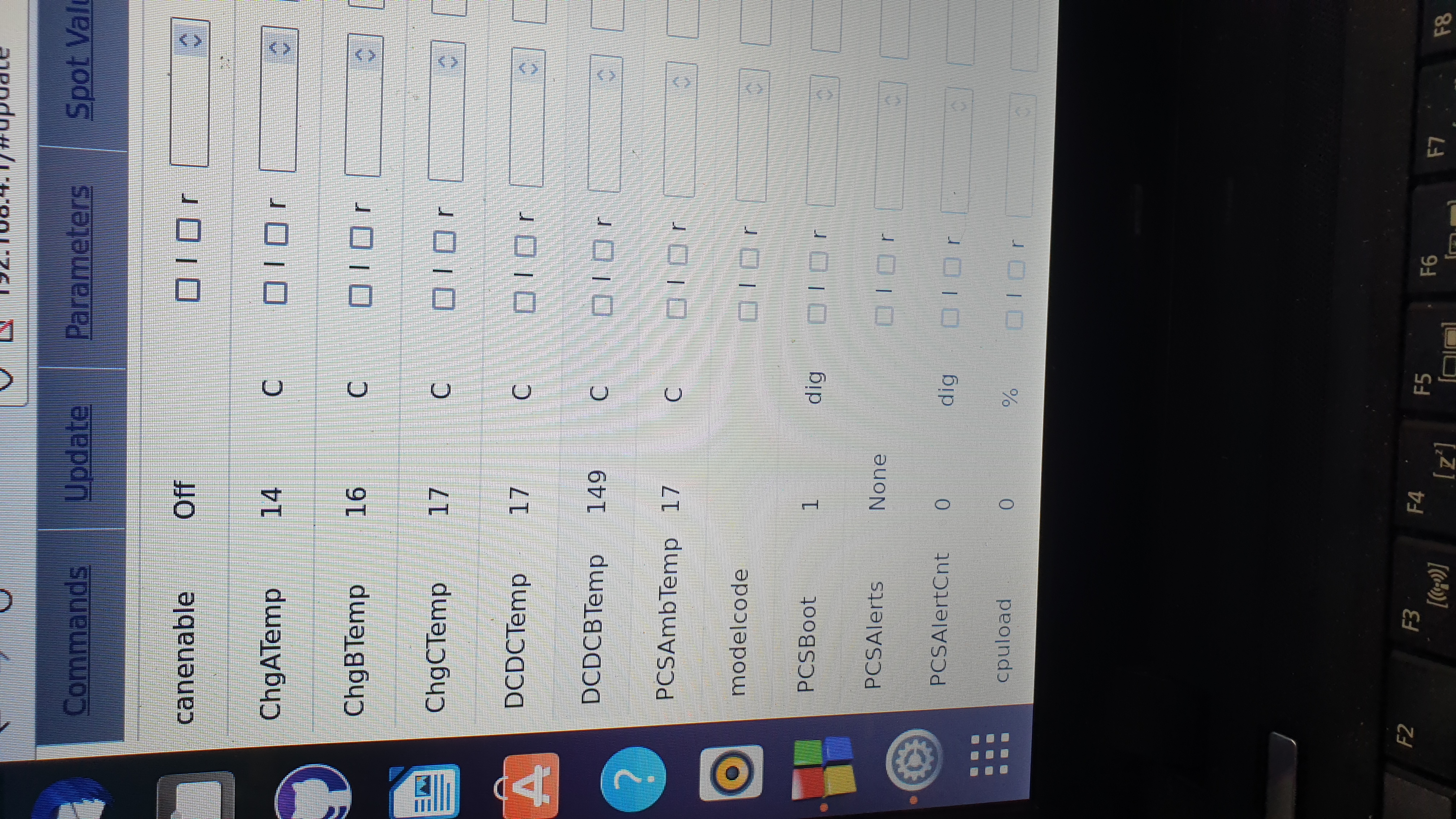

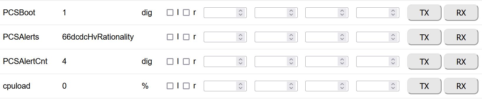

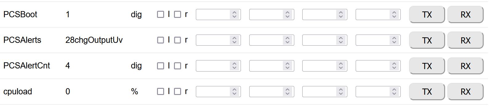

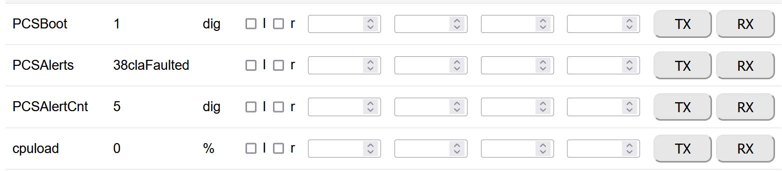

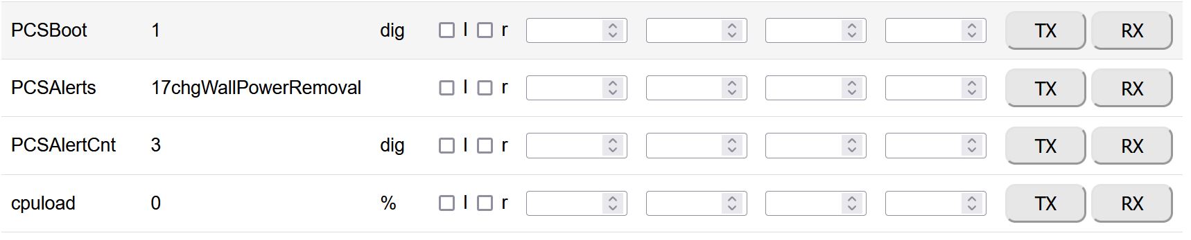

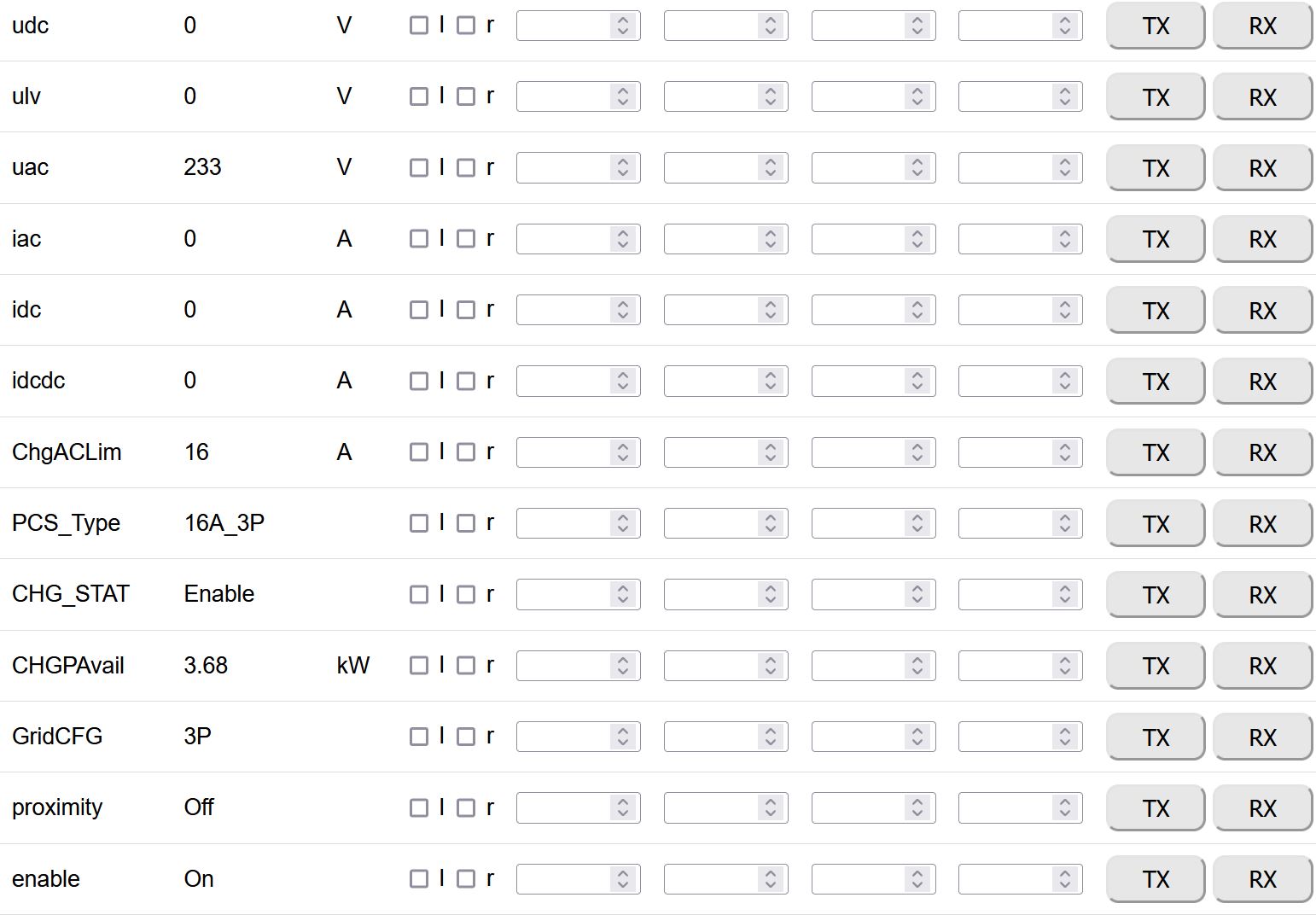

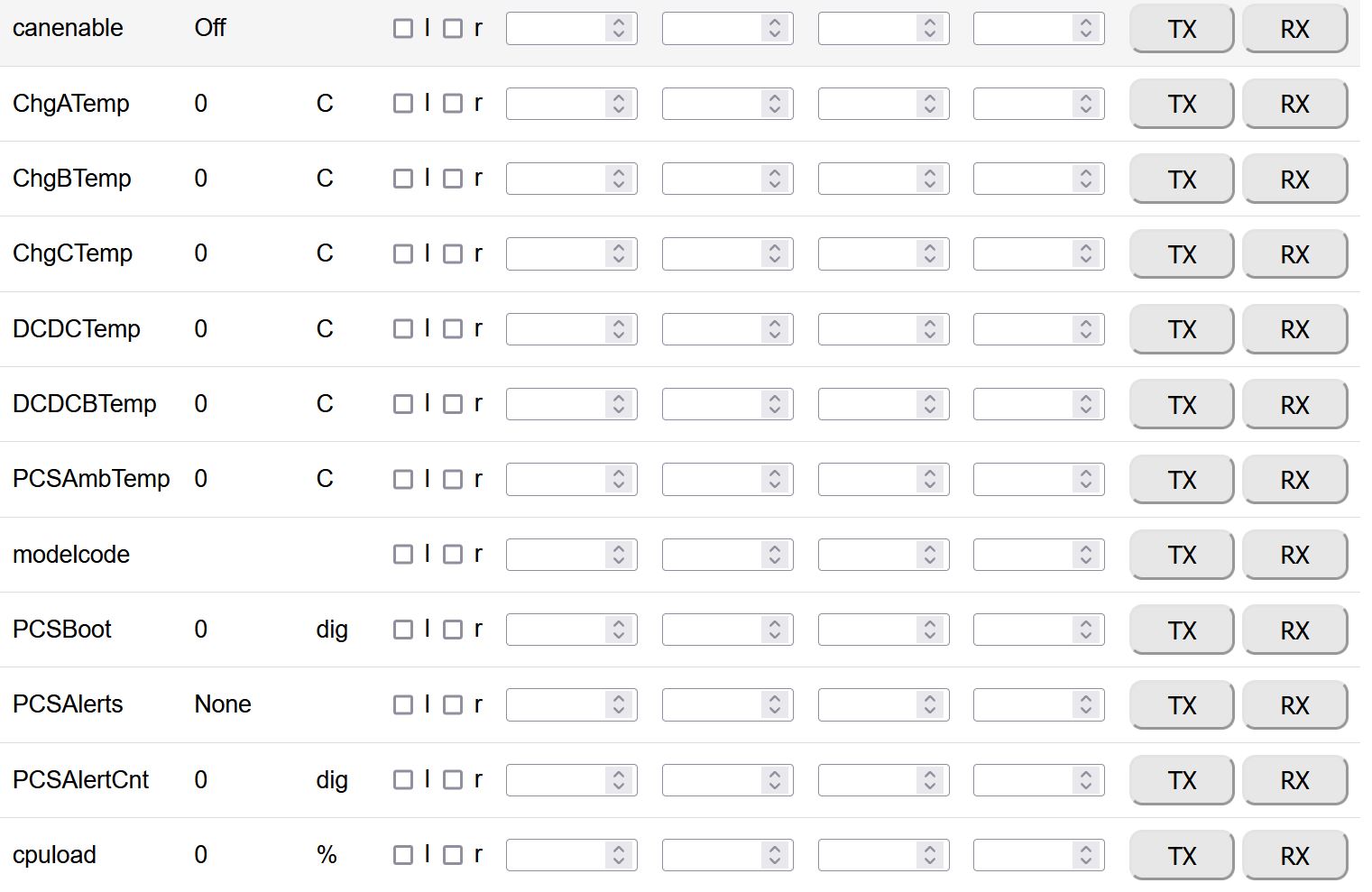

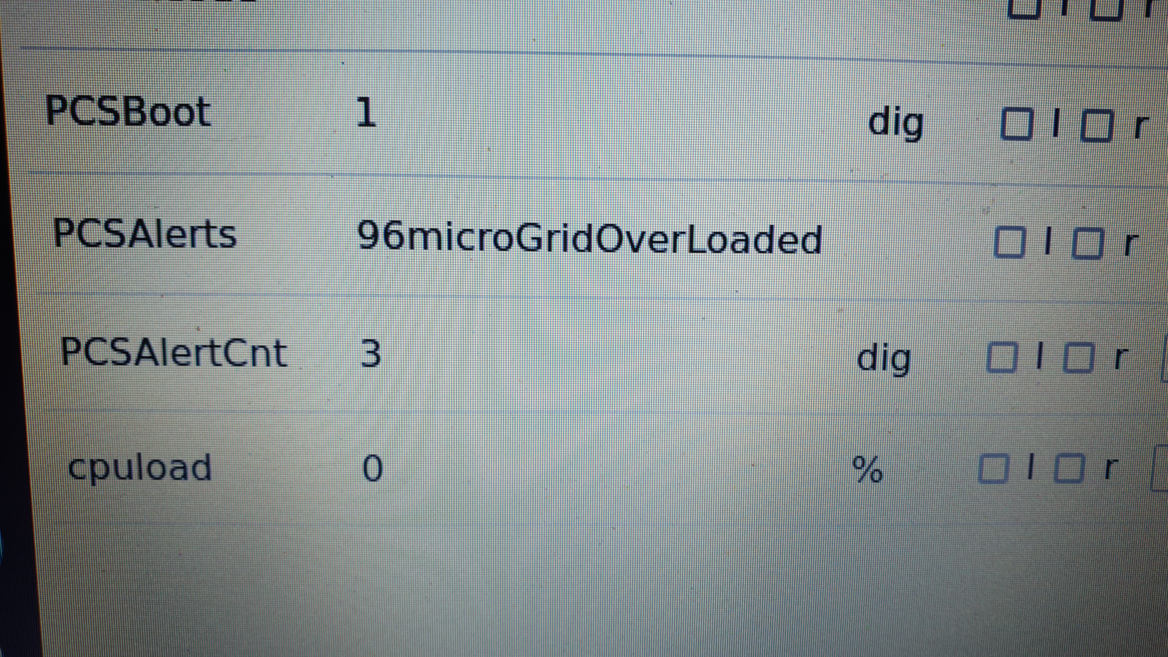

First two screenshots when PCS controller powered up but no enable signal. No AC or DC HV connected for either to match my earlier test above. Looking to get the same error messages.

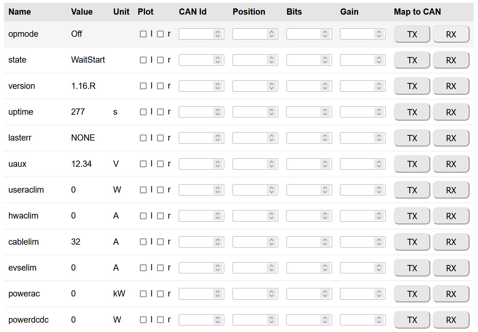

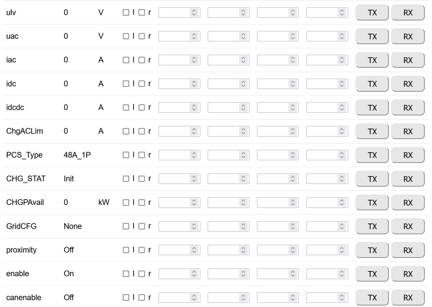

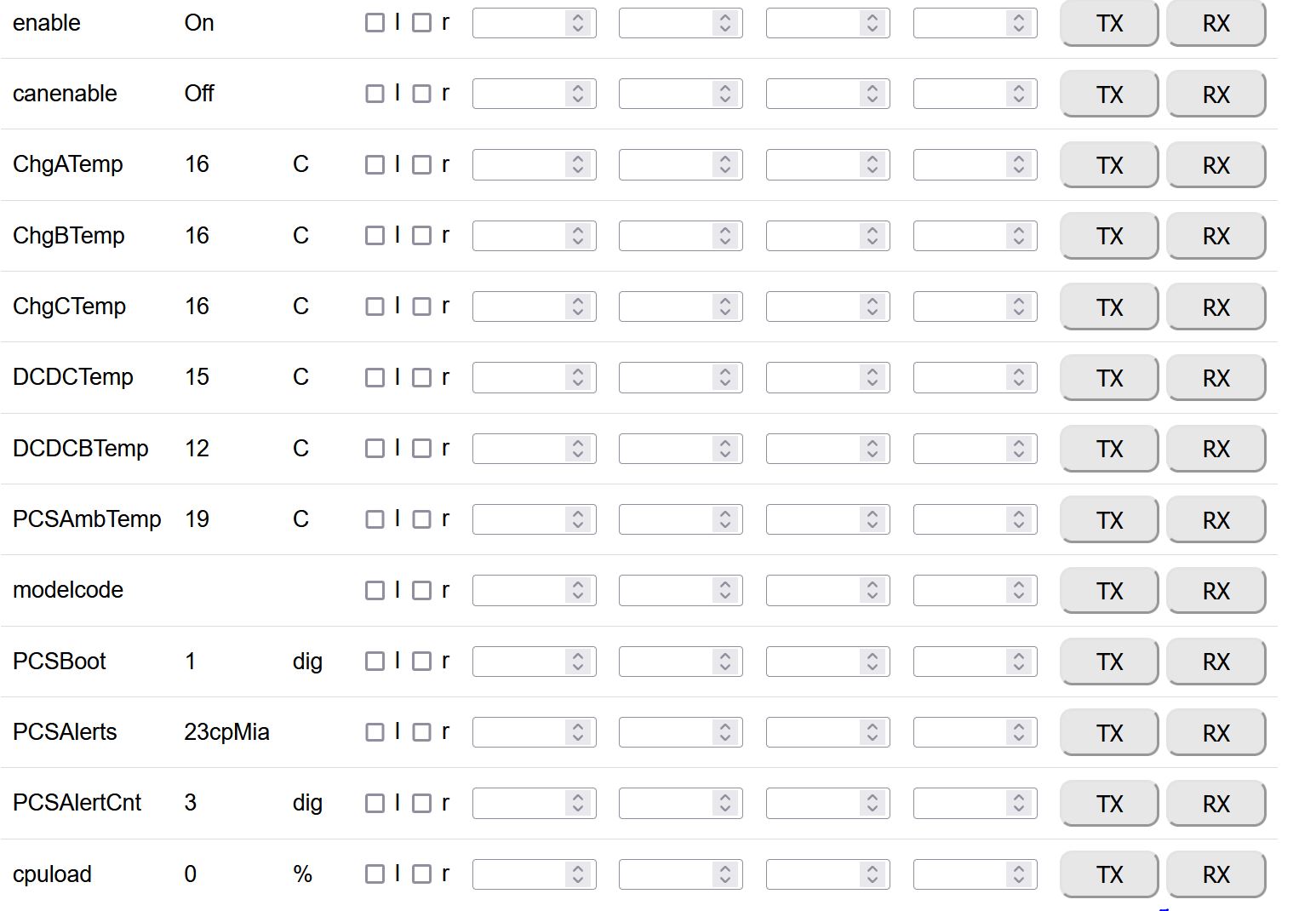

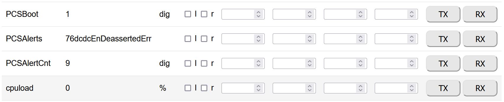

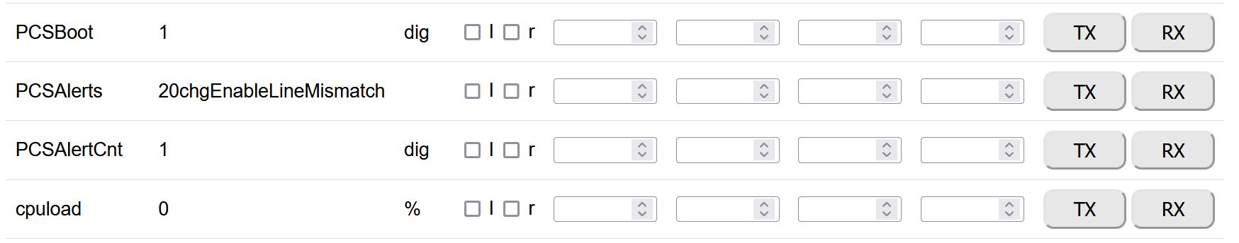

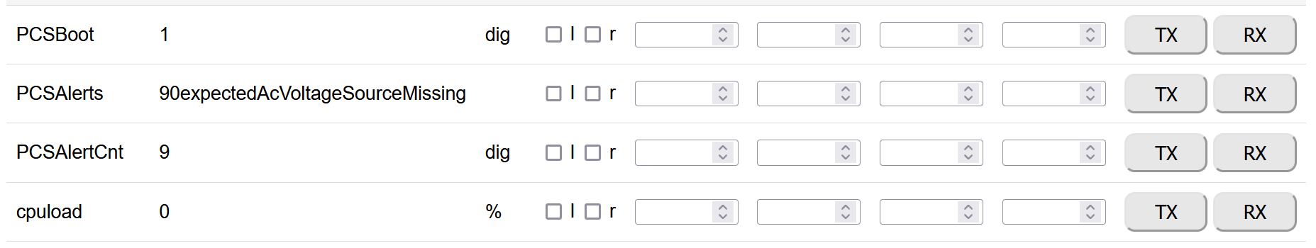

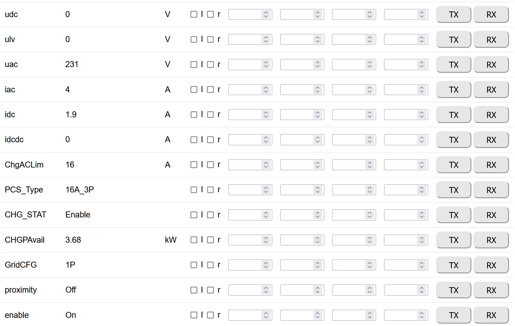

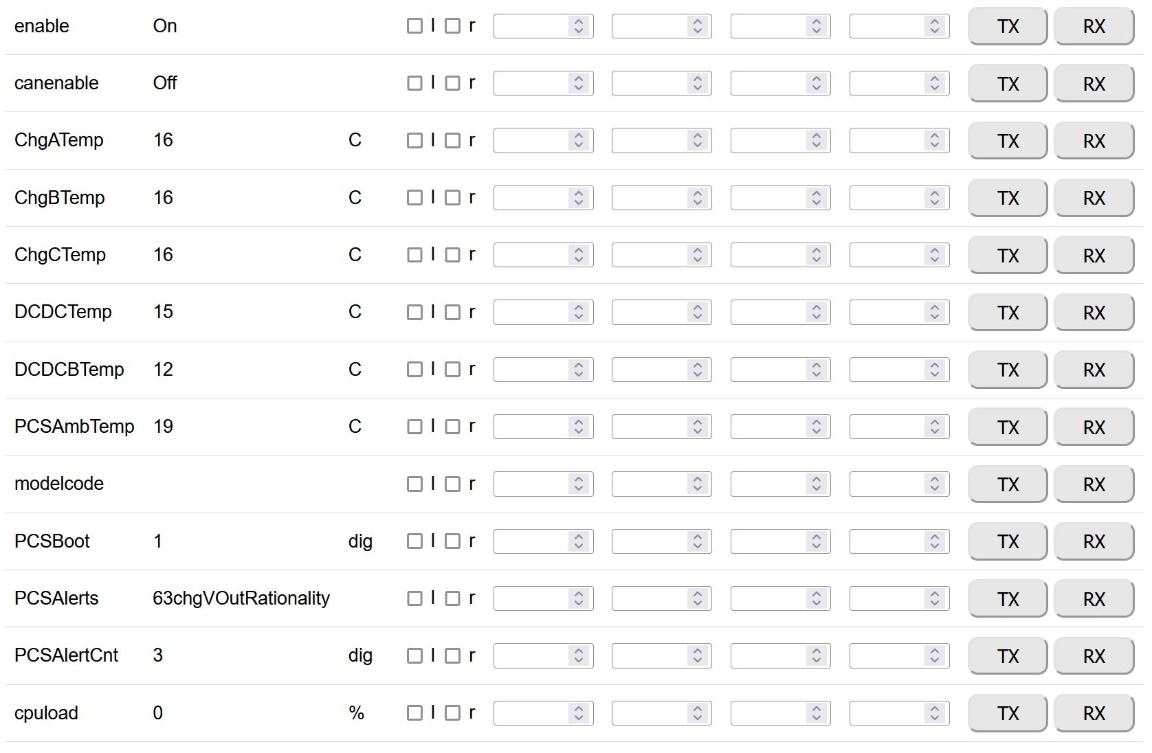

Next three screenshots when enable signal connected. On previous firmware with this test, PCS controller opmode changed to 'Run' at this stage, stays 'Off' here?
- Posts: 4000
- Been thanked: 1116 times
Ok I have no idea why the parameter database is doing that. Attached is my set so I'd load that in and do a reset and that should put things back to normal. Probably an artifact of me moving params around in the new code. The PCS will only respond to the enable line if in manual mode so I'd guess that's where the problem lies. Try those params and lets see if the interface displays properly.
- params_NewSWV1.json
- (264 Bytes) Downloaded 393 times

Tried the new release and now get three sensible/expected alerts. Uploaded your json file and looks to have fixed the drop down menus too

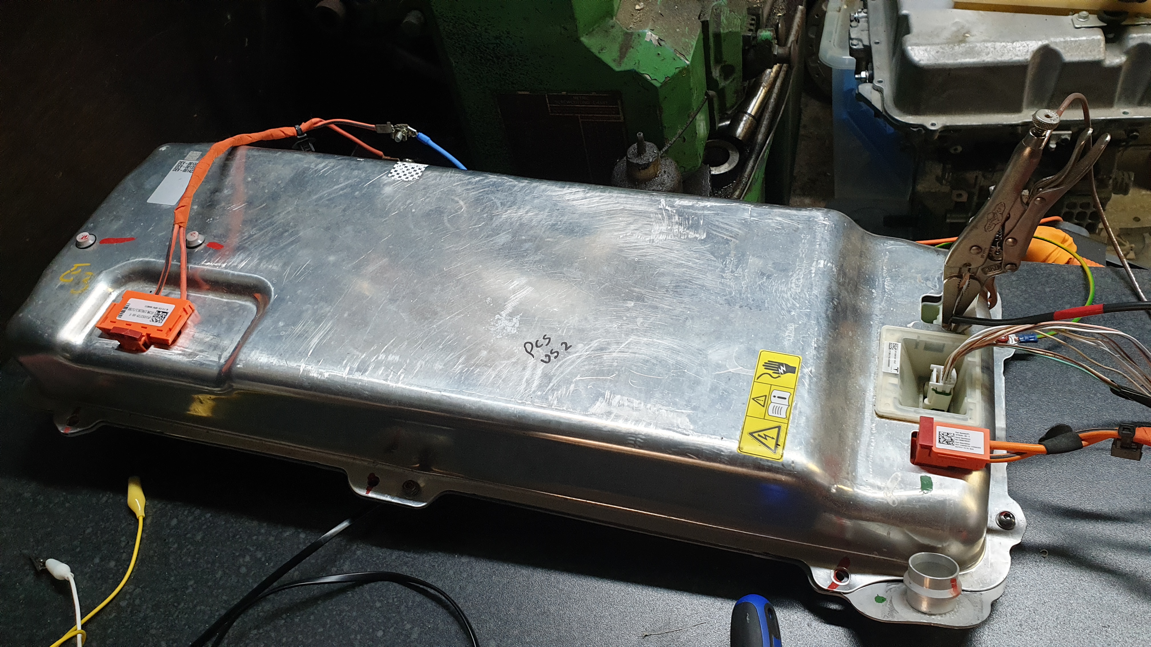

Just this morning received my second customer PCS for testing with the new controller firmware. At first power up we got a "30CanRationality" alert as this is a US spec single phase 48A model. Made some changes to the firmware to adapt the necessary CAN messages depending on PCS version connected and presto we are up and running. As of now the controller and firmware is tested working on :
1x 3p EU PCS from circa 2020 model year car.(customer sent to me for testing)
1x 1p US PCS from circa 2018 model year car. Running in my E46 touring.
1x 1p US PCS from circa 2020 model year car (customer sent to me for testing)
So as of now until I get some more feedback from customers / users of the firmware this is as much as I can do. Beta release firmware updated now on the repo :

@nkiernan could you test the new release on the repo please? should take care of your 23CPmia alert.

Yes, 23CPmia alert now goneJack Bauer wrote: ↑Wed Sep 07, 2022 5:23 pm @nkiernan could you test the new release on the repo please? should take care of your 23CPmia alert.
Couple of drop down menus were missing again after the upload, so loading your jsons again got them back

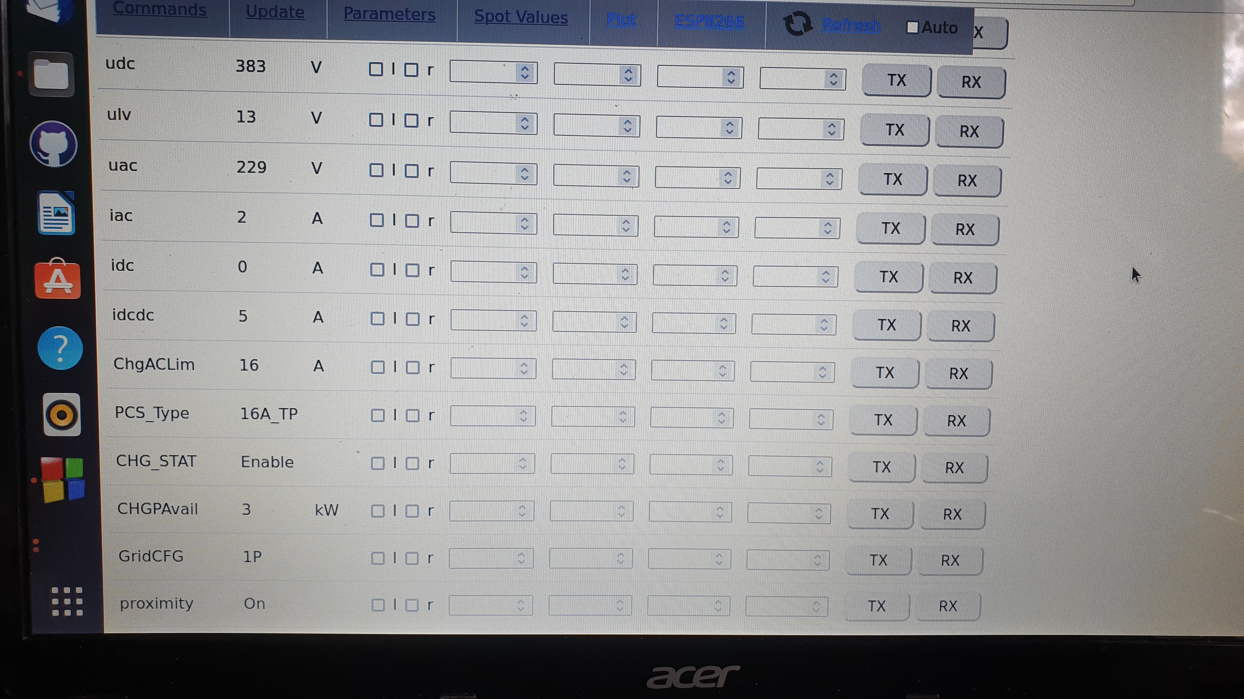

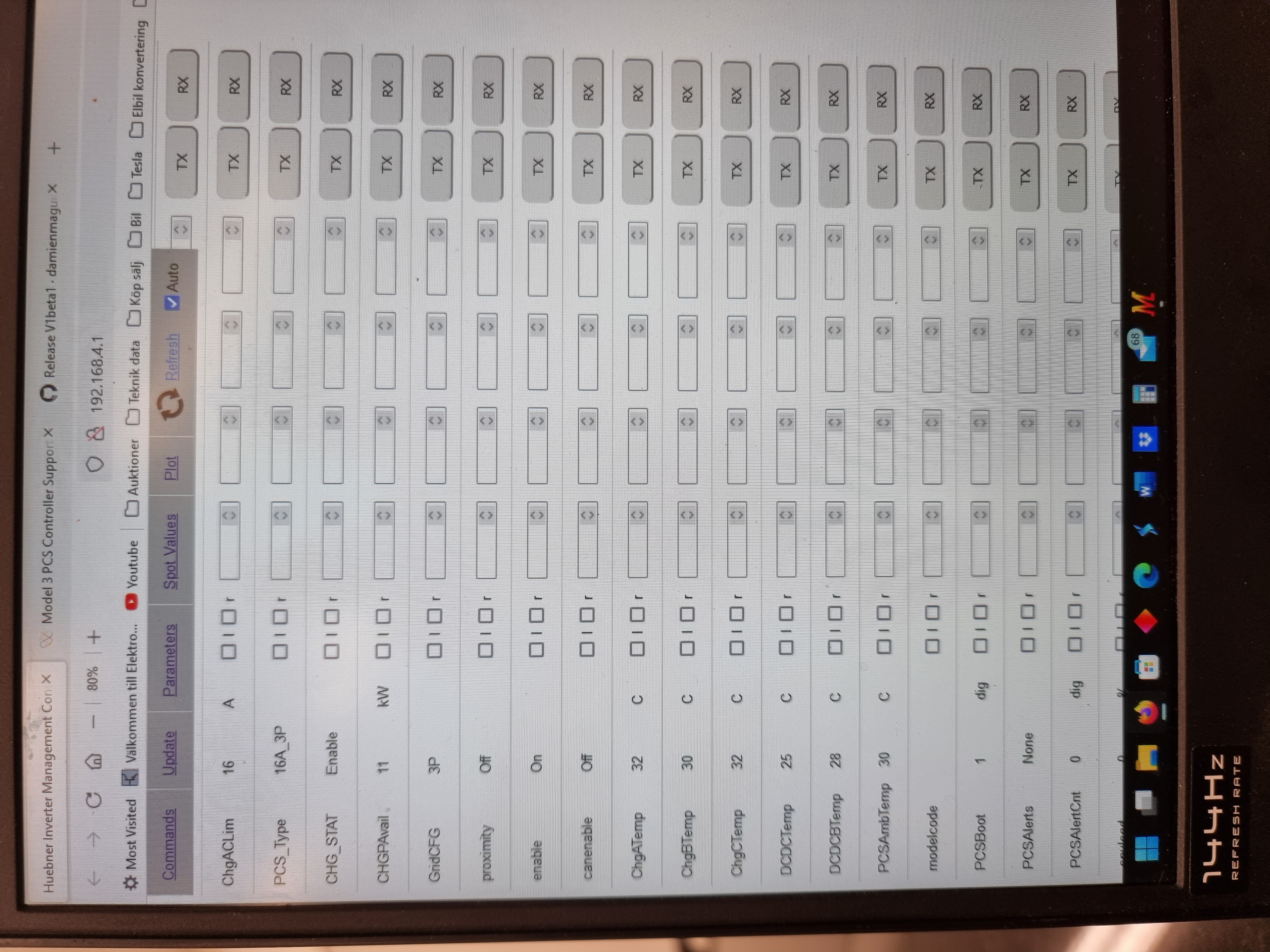

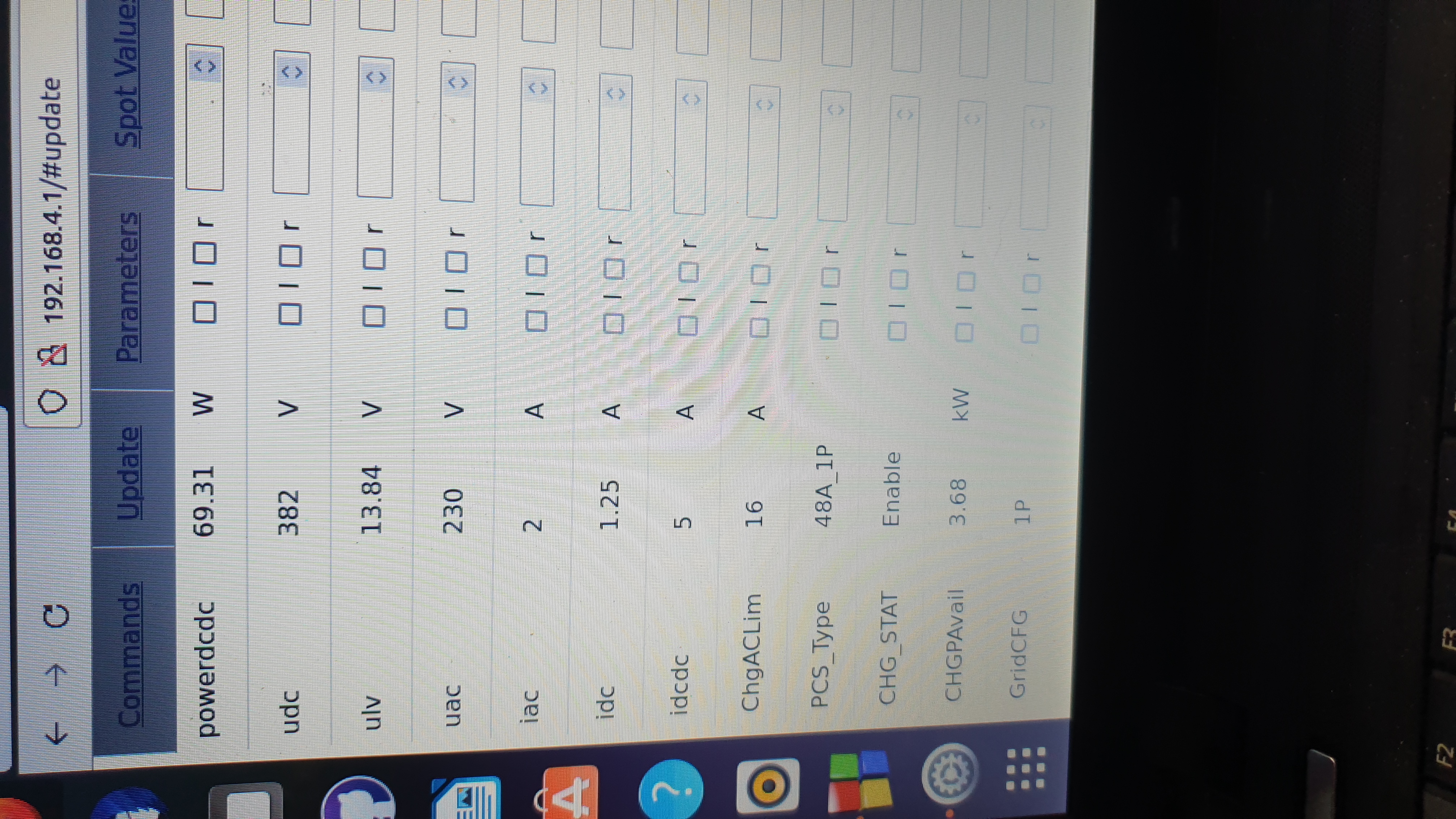

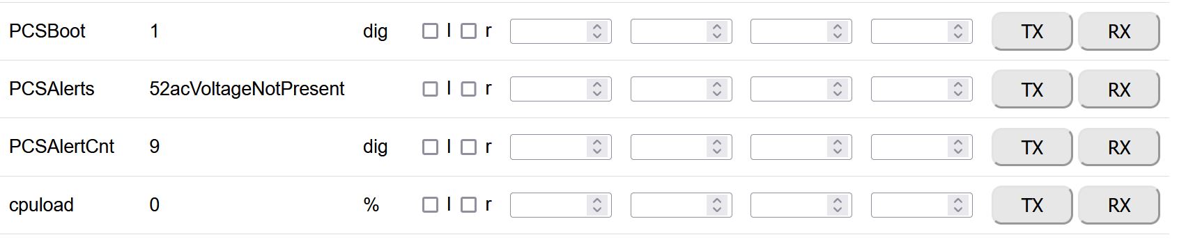

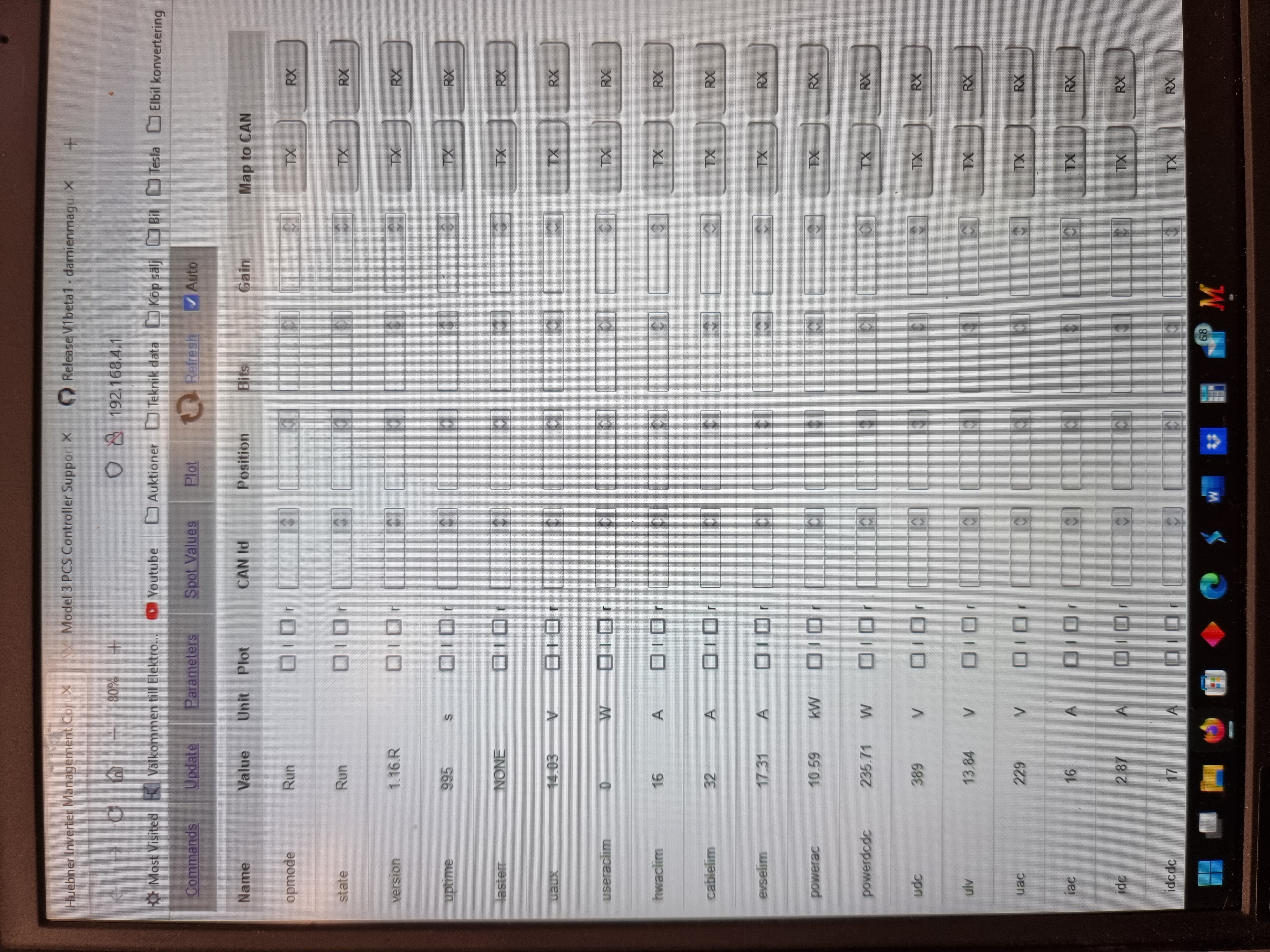

Hello, long time since i had my pcs connected, Did a quick test and installed the latest firmware. First i tested the dcdc and success then both and also success
Attached pictures from computerscreen.
3phase 400v @ 10,6kw I think every needed value is valid.
Amazing work
Amazing work

@fredd90 brilliant thanks for the test:) any ideas on age of your pcs?
My battery is from a 2019 Norway Tesla model 3, that's all I gotJack Bauer wrote: ↑Thu Sep 08, 2022 12:13 pm P.S.Mangelsdorf no problem. I have 2 ISO parts here if you cant find any pop me a pm.

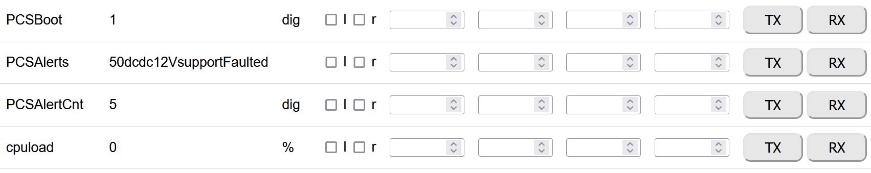

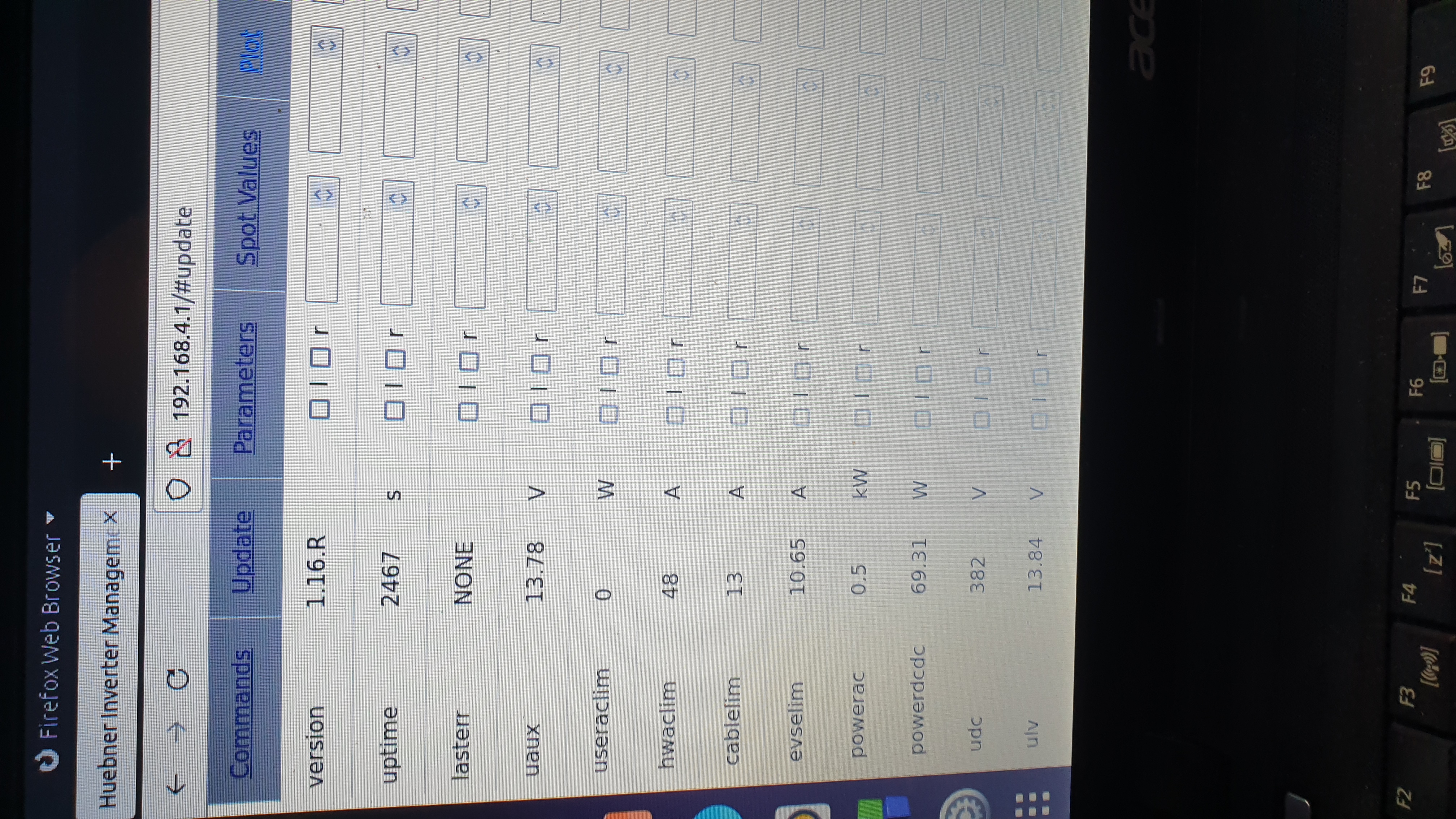

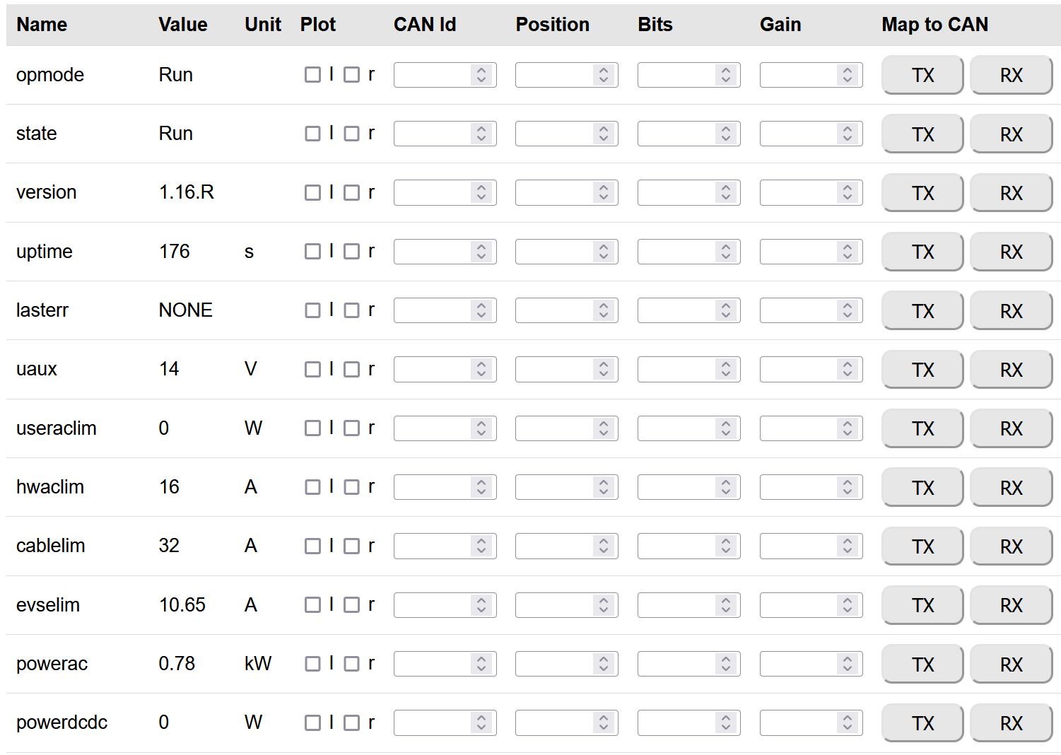

Got to connect HV to the PCS today and do some more testing. Manual mode and DC-DC option only to start. Applying enable generated a count of 5 alerts, but only three unique alerts. Not quite sure what they mean yet, and likely to do with my setup. Didn't get any DC-DC charging for the 12V battery. My 12V battery voltage was very low after a days messing about and I have a vague memory there's a minimum voltage required...need to check
Changed over to charge mode and was using a type 2 granny cable. EVSE unit clicked into action and green charge LED flashed away so appeared working. Starting HV was 381.2, finished 381.7 after 10 mins or so, but think the screenshots I captured changed along the way

In this case the Alerts tell the story. First DCDC. As you guessed your battery is too low as per 67dcdcLVrationality.
The charger in your PCS is a 3 phase unit so you have 4 AC mains inputs : N,L1,L2and L3. Its capable of running on single phase, 4 wire 3 phase or 3 wire 3 phase. Assuming you are running from single phase then you need to connect to N and...... not L1:) as that would be too easy. What happened is your PCS saw 230v between N and L1 and set grid config to 3 (3p) phase as you can see from your spot values. The Elon brain then got confused as it didn't see the AC on all 3 phases so gave :52acvoltagenotpresent and 90expectedacvoltagesourcemising. So you need to find the right phase to apply power for single phase operation and then gridConfig will show 1p for single phase and you will then need to ask elon nicely for some power using the pacspnt parameter.
Folks, there is a lot of info being dumped here and questions answered that I just know will pop up again and yet not a single word has been added to the wiki page despite my asking regularly. That's cool. I won't ask again but don't get all worked up in the future when I don't answer the same questions.

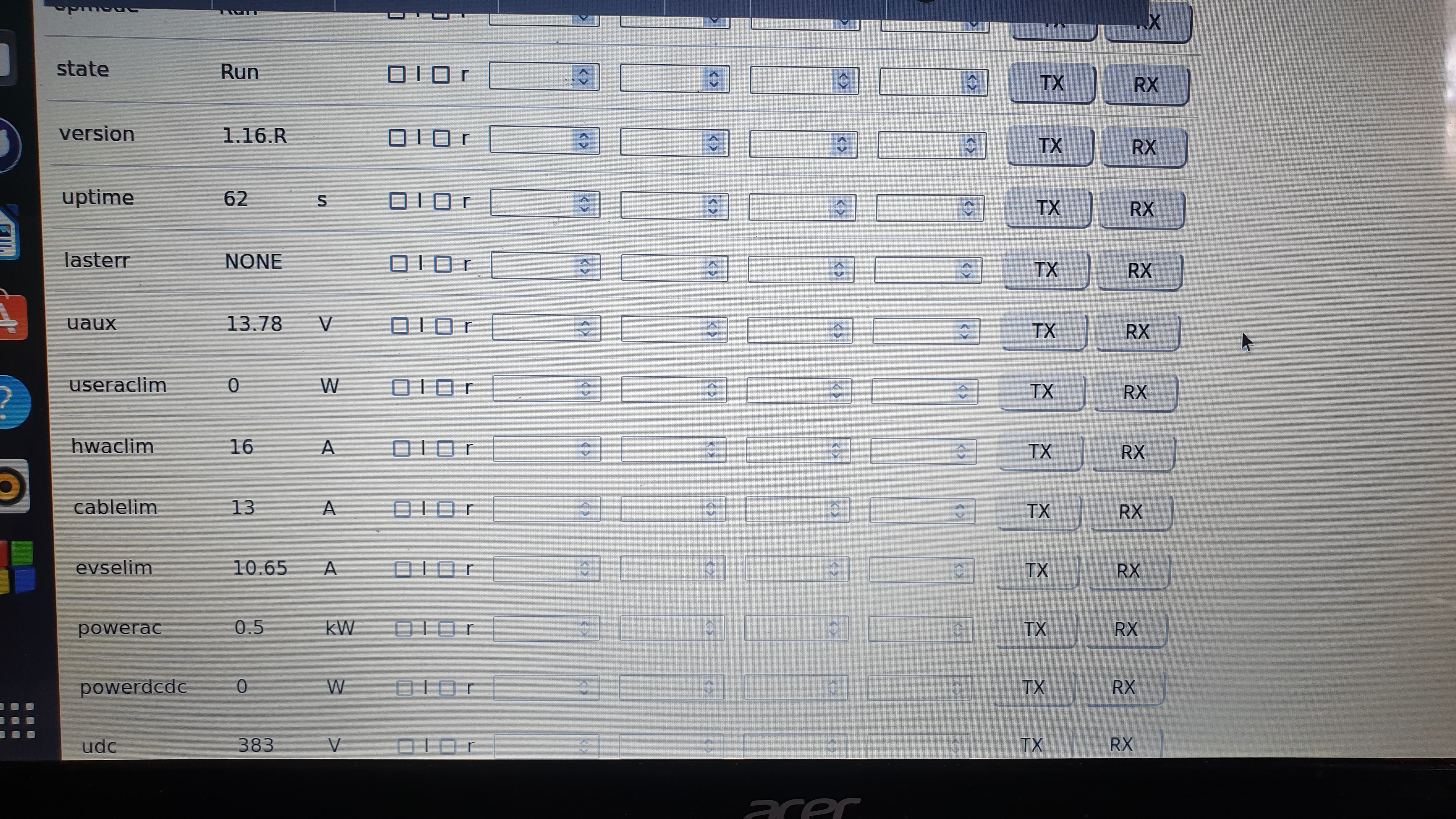

Thank you. So charged the 12V battery with a car charger and went back for some more testing. Cautiously setting some values low as I get familiar with things. Started with the DC-DC.
Set udcdc to 13.5V and apply enable in manual mode. PCS jumps into gear and 13.5V reported in the web interface. After a short time, a high pitched whine starts coming from the PCS (got excited thinking the GS450H inverter finally woke up
). The volume of the whine increased over a few seconds then stopped and the PCS shut down the DC-DC. This happened a couple of times and I suspected it might be that the 12V battery was still on the low charge side (alerts: 76dcdcEnDeassertedErr, 67dcdcLvRatuionality, 38claFaulted, 50dcdc12VSupportFaulted). After some restarts I changed udcdc to 14V and the PCS DC-DC worked away happily after that. It did happen once more later on when I was trying to test both DC-DC and Charging at the same time. But happily, DC-DC was working on the bench and I didn't blow anything up!
Moved on to testing the charging. Seems N and L2 sets GridCFG to show the correct 1P for my setup. Charging didn't work for me this morning but I know I need to watch back over the recent PCS videos, this is down to my own timing/settings. Manual, enable on, plugging in the granny charger and refreshing sets GridCFG, shows charge power available and the AC voltage available ok, the green charge light on the EVSE box flashes green for 10 seconds or so, but each time it seemed to fault out and show the red LED. The alerts were carrying over between tests so below is only for reference, I'll do a clean test later to capture the specific alerts

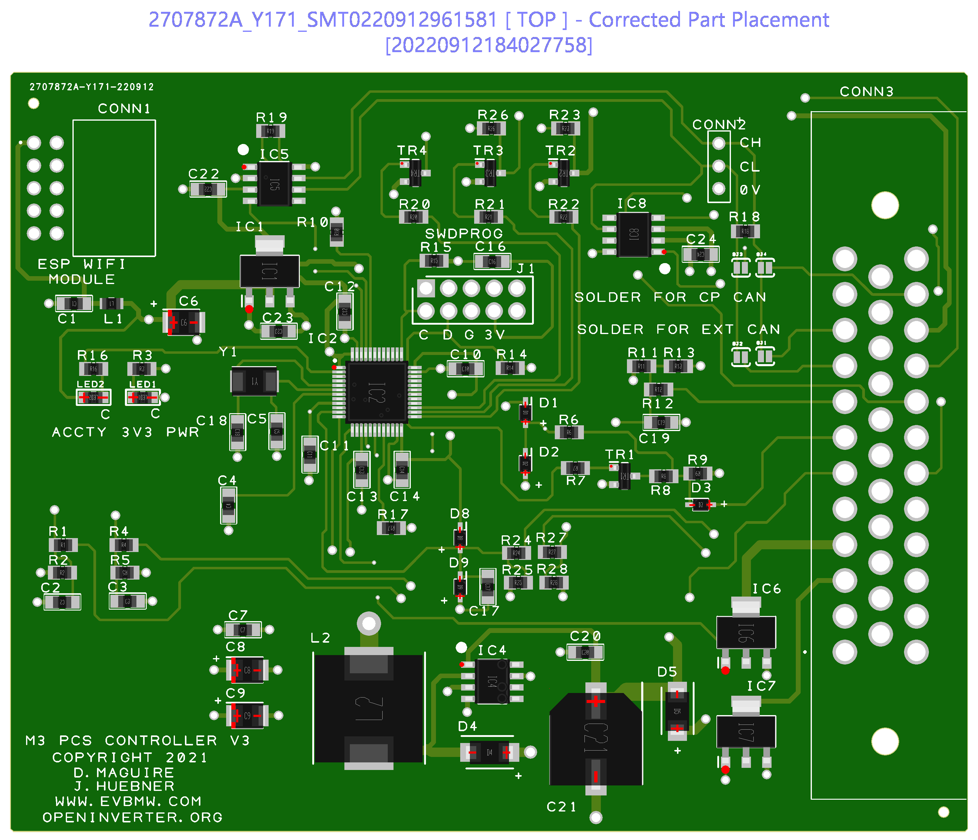

New batch of PCS controller boards ordered from JLC this morning. Pleased to say it looks like the chip shortage nonsense is easing up. All smd parts placed:)

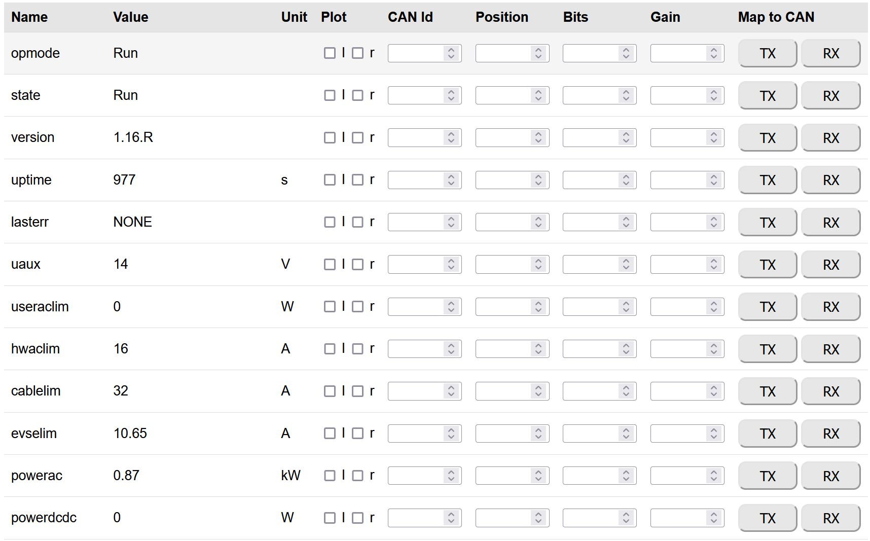

This was what I was expecting alright, once set up just apply enable and plug in the cable (type 2 granny cable in this case). I tried both with and without applying enable but the web interface shows the PCS stays off in both cases. Now with enable connected, I do get a value for evselim. You will notice the PCS_Type shows 48A_1P. This seems to be after I upload the json parameters posted here previously as a fix for the missing drop down menus. Each time I cycle the power, the menus are missing and I have to upload those params (I should create my own to match my setup). Is anyone else seeing the same missing drop downs? Happens on both laptop and phone for meJack Bauer wrote: ↑Mon Sep 12, 2022 7:56 am Appreciate the wiki edit thanks. Do keep in mind there is no need for any chicken dancing with enable lines,manual mode,evse etc. Just set inputtype to your evse type and plug in the cable.
In manual mode, things look to be working ok, DC-DC and 1P charge
So for a final test, I changed all parameters to the ideal setup, inputtype: Type2, activate: both, alerts: on. Power cycled the PCS controller and as before the drop downs disappeared. This time I assumed the settings I had before power cycling remained and I didn't upload any parameters file. Applied enable, plugged in the charging cable...I should have saved my parameters file at this stage to be sure what everything was set at (missing drop downs). Looks to be the manual input type after all. I have a suspicion not all parameters are saving when power is turned off and I need to test this
