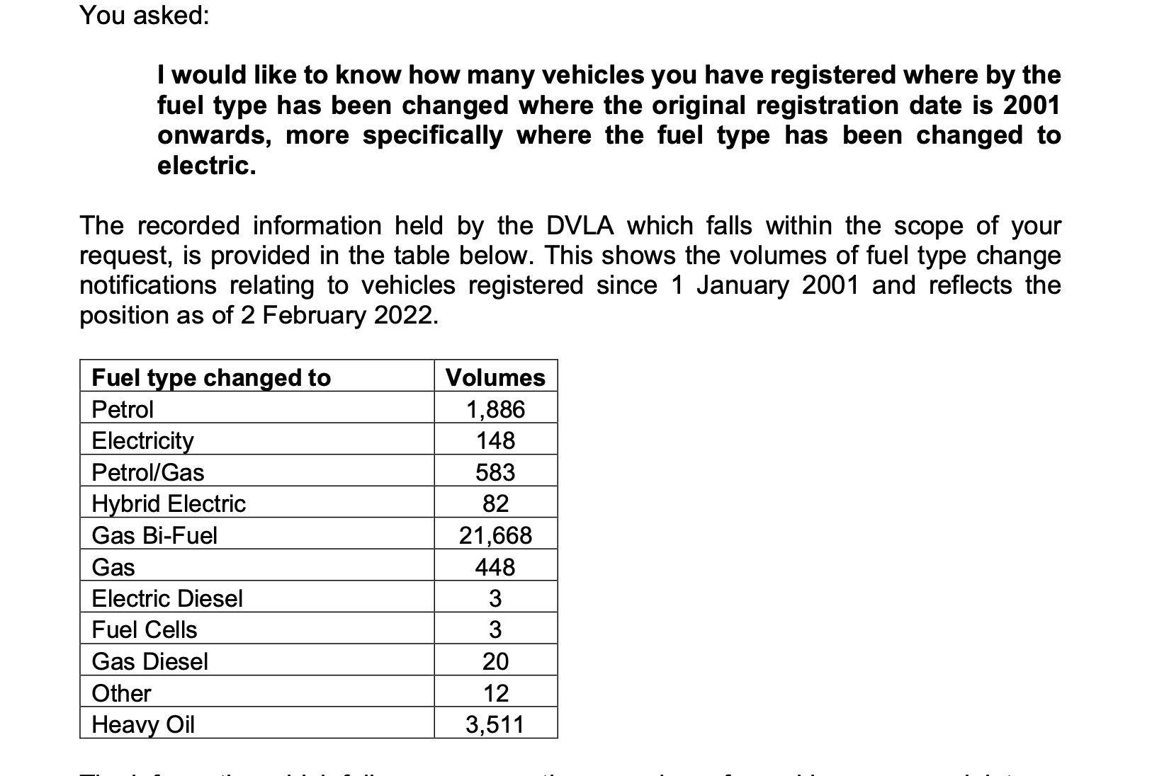

I put in a FOI with the DVLA for numbers of vehicles post 2001 originally registered vehicles. Their response is below.
It seems updating the Fuel Type isn't an issue.BMW E91 2006

Re: Registering and changing tax class of an EV conversion in the UK
That is exactly the point, the law already allows for such changes. It may be that the only final answer is to take DVLA to court so they will have to then follow the ruling. Having said that, the government should simply tell DVLA to allow (encourage even) these changes as it is part of their overall agenda to reduce emissions.
