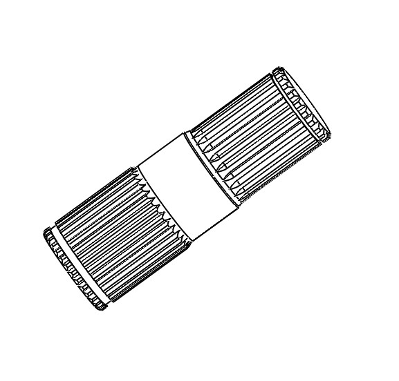

Bratitude wrote: Sun Sep 18, 2022 6:17 pm is there any particular CV you have in mind? i was just thinking of making a stub shaft with the 33 vw spline so all the VW flanges fit. apposed to doing a full custom cv, say one that works with a mini shaft, would be very expensive.
I would say 33 VW Spline is the away to go for now. I got some flanges coming to do some mock ups.
Posts: 1011
Has thanked: 180 times
Been thanked: 372 times
tom91 wrote: Sun Sep 18, 2022 6:46 pm I would say 33 VW Spline is the away to go for now. I got some flanges coming to do some mock ups.
makes the most sense. vw stuff is strong, cheap and abundant.
first mockup; vw beetle 33spline, outlander on the other end.
A few fillets to adjust, but backspacing should be correct. ill make some mock ups this week to check
