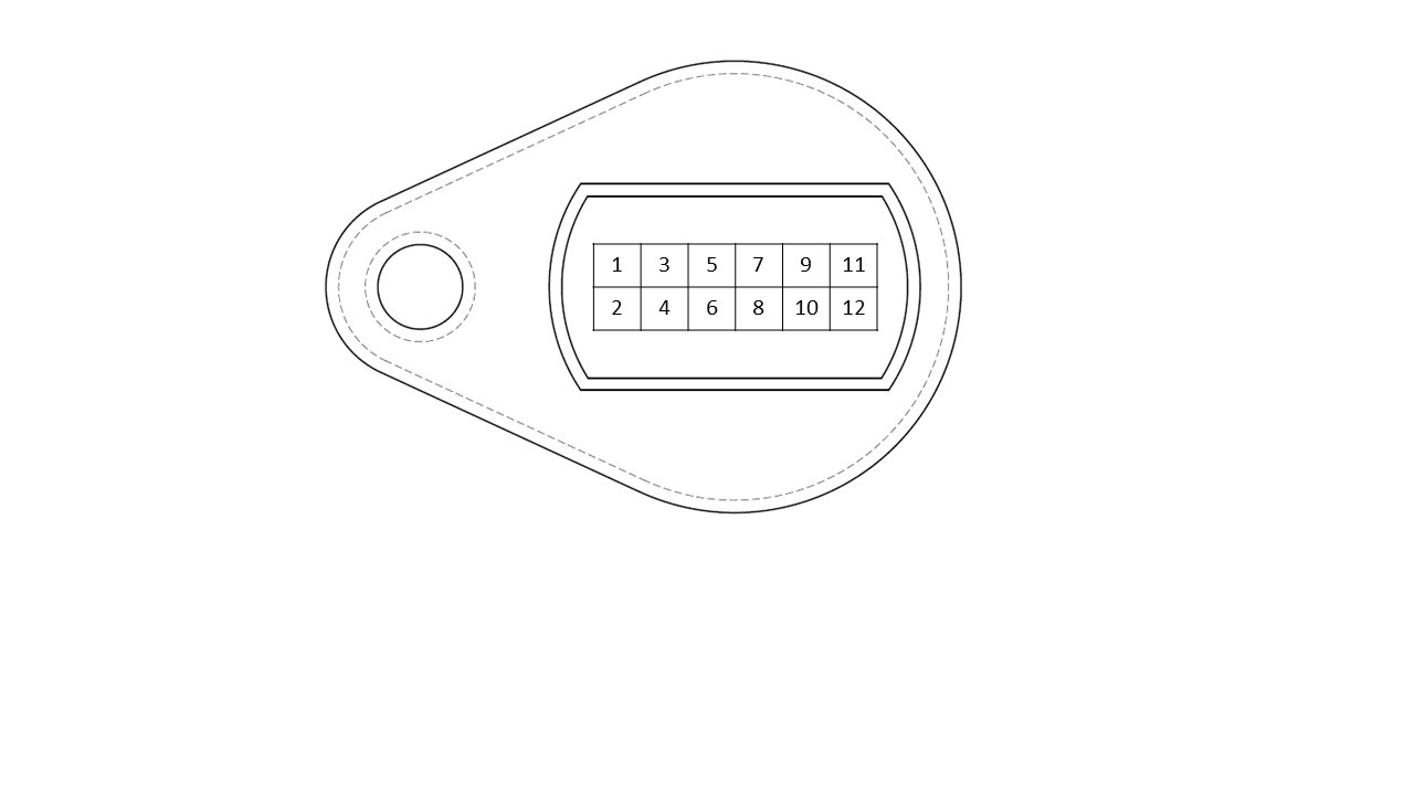

I'm trying to do a pinout for the wiki - and get ready to hook up my rear motor in place of the front one. Does anyone have a full pinout including the temperature sensor connections figured out yet?
Based on my little sketch below, am I right in thinking that 1-2 are EXC, 3-4 are SIN and 5-6 are COS?

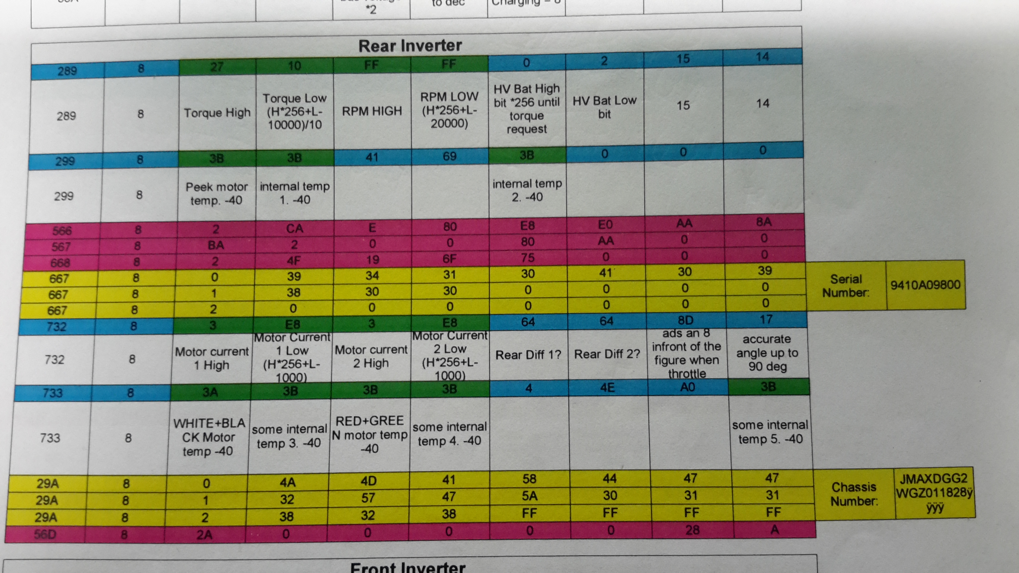

Here are my notes for the rear inverter / motor, I've not worked out which resolver wire is which as it's not needed to know with the OEM inverter.

Thanks for that. I saw the official pinout but that threw me as it has 14 pins and Tom's one only has 12?

I've added what I think is the correct pinout to the wiki based on the REMCU doc that @aot93 supplied (thank you). Appreciate if someone could check it: https://openinverter.org/wiki/Mitsubish ... Drive_Unit
Understand the 14 pin/12 pin thing now having looked more closely at the connector (2 pins unused). Doh.

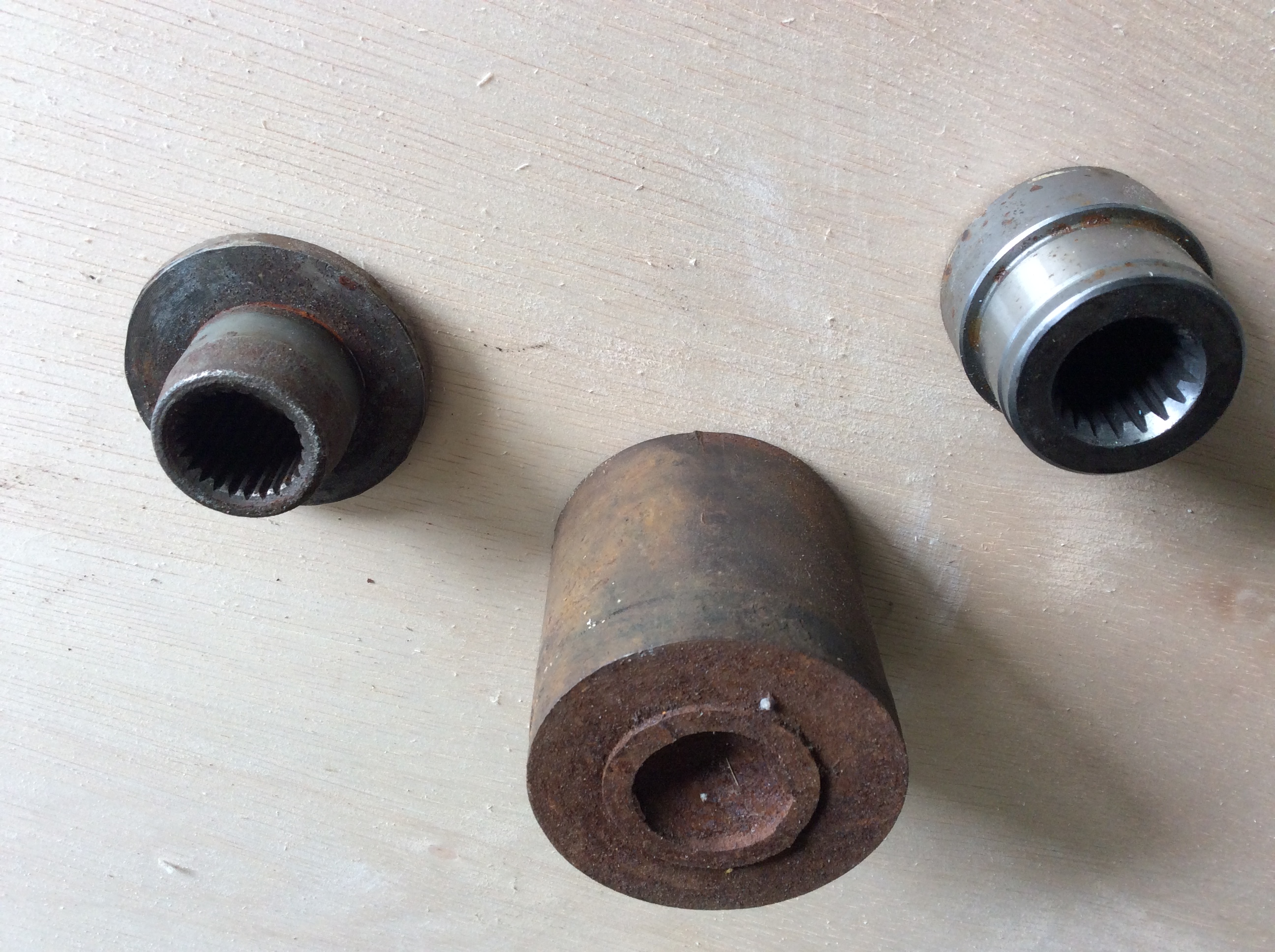

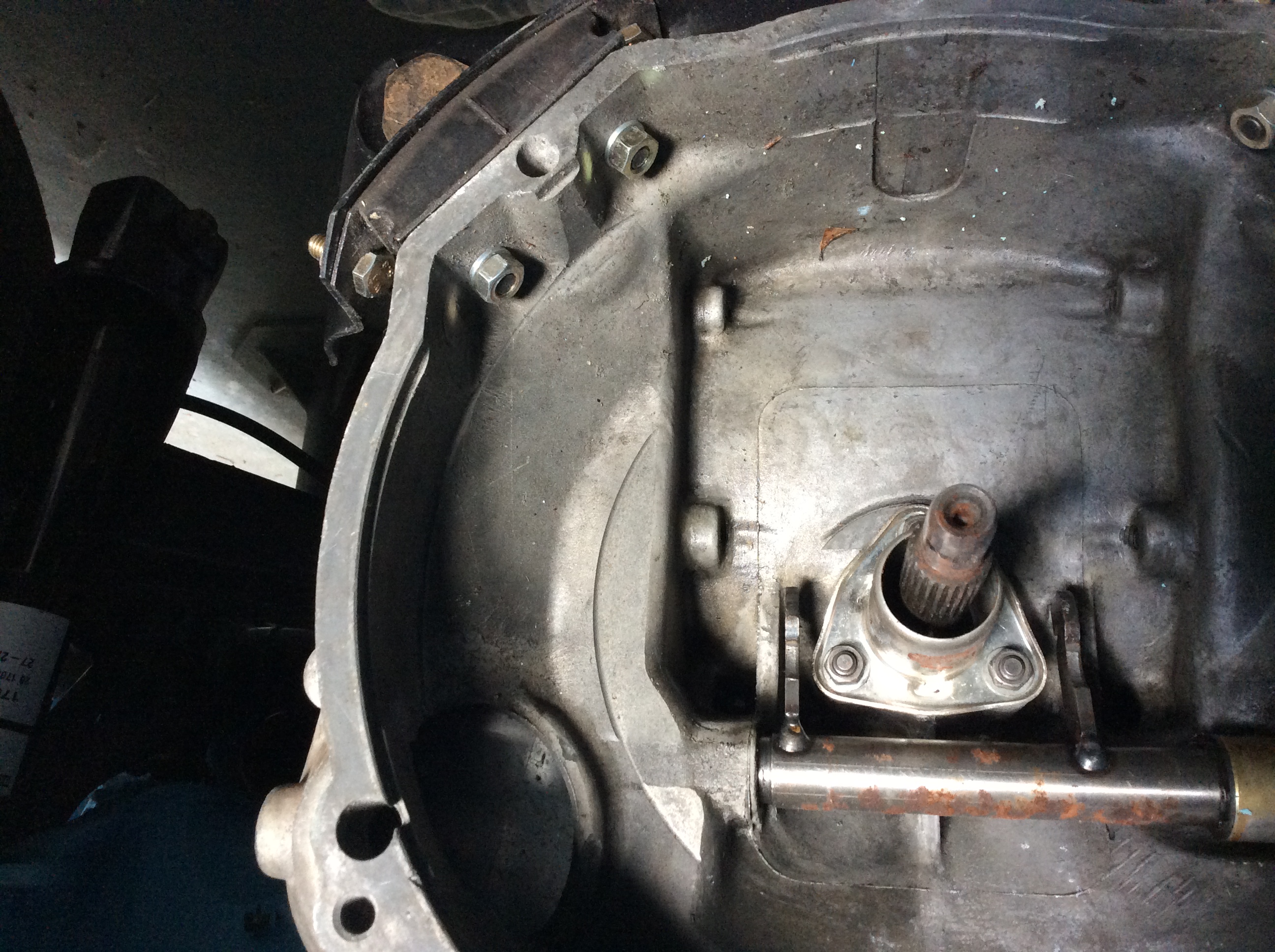

As I will not be using the native diff, due to difficulties acquiring suitable drive shafts, but using the original beetle gearbox, I need a motor spline, a gearbox spline, an adaptor plate and a spacer. The diff can provide the first and fourth. I used a worn out wood cutting bandsaw blade to remove excess material from this new ‘spacer’ and extracted and shortened the original spline. For the adaptor plate I am using a piece of 10mm plate that will have a 3mm deep by 283 dia spigot that will register with the recess in the beetle bellhousing. The gearbox spline obviously comes from an old Clutchplate.
As the beetle gearbox mounts originally supported the whole 100kg engine it should be more than adequate to support the 40kg Y61. Also the spacer to motor fit has to be perfect as it hasn’t been changed and uses original fittings. The spacer to adaptor plate may need an extra spacer or two to be added as the mounting surface doesn’t extend the whole way around. Most of the centre of the adaptor plate will then be removed to reduce mass.

RMCU is monitoring several temperatures. Those are which I was able to identify:
Motor T1 sensor overheat: STOP @ 170 Cdeg START @ 155 Cdeg
Motor T2 sensor overheat: STOP @ 170 Cdeg START @ 155 Cdeg
DC link capacitor Tdc: STOP @ 105 Cdeg START @ 95 Cdeg
IGBT T3: STOP @ 90 Cdeg START @ 80 Cdeg
IGBT T2: STOP @ 90 Cdeg START @ 80 Cdeg
IGBT T1: STOP @ 90 Cdeg START @ 80 Cdeg
TCPU/PCB - STOP @ ~107Cdeg. START @ ~87 Cdeg.
RMCU also recognize sensor failures (open sensor and short sensor). So it is well protected.

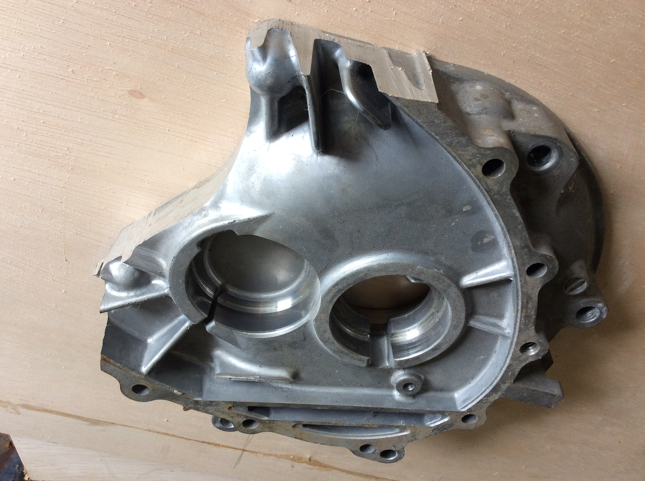

i have some Beatle adapter plates on the way. 17mm ali plate with a nema bolt pattern and some 30mm nema spacers.
Just ordered a outlander rear motor. so ill be measuring that and getting adapter pates made for it too..... aswell as making drive shaft conversion stubs...

Interesting, I know mine Deffiniatly works using 0x289 as shown above.
Possibly there is some different firmware depending on model years.
I took the values from a post way back.
Also here are some CAN logs from my inverter and from another vehicle.

To add some more to the above:
HV voltage at the inverter is only sent until a torque request is made to the inverter, so it's useful only for pre-charging.
Once a torque request has been made it looks like the byte order changes, I've not worked that out yet to get voltage reading from the inverter whilst it's running. The BMS take care of voltage limit and the charger reports HV from the other side of the contactors
