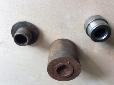

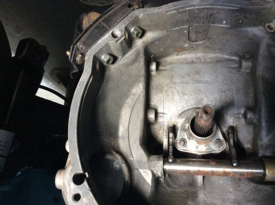

Scotts, Mouse and now bobby_come_lately (‘Upgrading the motor in my DIY EV: Part 3’ recently published on Youtube) have shared their systems for coupling and connecting their Y61 motors to various gearboxes now I’m adding mine:
As I will not be using the native diff, due to difficulties acquiring suitable drive shafts, but using the original beetle gearbox, I need a motor spline, a gearbox spline, an adaptor plate and a spacer. The diff can provide the first and fourth. I used a worn out wood cutting bandsaw blade to remove excess material from this new ‘spacer’ and extracted and shortened the original spline. For the adaptor plate I am using a piece of 10mm plate that will have a 3mm deep by 283 dia spigot that will register with the recess in the beetle bellhousing. The gearbox spline obviously comes from an old Clutchplate.
As the beetle gearbox mounts originally supported the whole 100kg engine it should be more than adequate to support the 40kg Y61. Also the spacer to motor fit has to be perfect as it hasn’t been changed and uses original fittings. The spacer to adaptor plate may need an extra spacer or two to be added as the mounting surface doesn’t extend the whole way around. Most of the centre of the adaptor plate will then be removed to reduce mass.

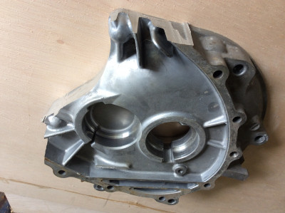

i have some Beatle adapter plates on the way. 17mm ali plate with a nema bolt pattern and some 30mm nema spacers.
Just ordered a outlander rear motor. so ill be measuring that and getting adapter pates made for it too..... aswell as making drive shaft conversion stubs...

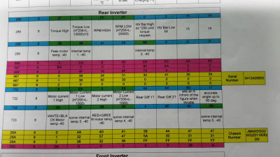

Could I double check what canbus messages others are using for getting the High voltage reading from the inverter?
I have used Aot93's code which uses canbus ID 0x289, HVvoltage = (msg.buf[4] * 256 + msg.buf[5]); This does give me some numbers, which do change when I precharge, but I haven't quite figured out what calculation I need to make to get a sensible value.
On the Zombie verter module, same Canbus ID 0x289, but with voltage = data[1] & 0xFFFF;
Obviously there are differences in code formatting here, but ignoring that they are using different bytes from the same frame ID to pull the same information. Surely only one of these can be correct?

Interesting, I know mine Deffiniatly works using 0x289 as shown above.
Possibly there is some different firmware depending on model years.
I took the values from a post way back.
Also here are some CAN logs from my inverter and from another vehicle.

To add some more to the above:
HV voltage at the inverter is only sent until a torque request is made to the inverter, so it's useful only for pre-charging.
Once a torque request has been made it looks like the byte order changes, I've not worked that out yet to get voltage reading from the inverter whilst it's running. The BMS take care of voltage limit and the charger reports HV from the other side of the contactors
