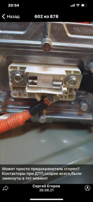

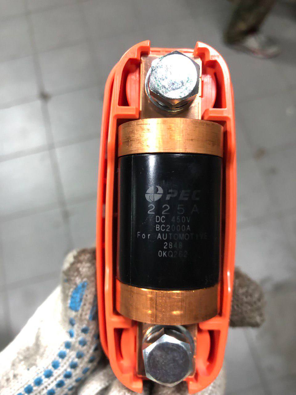

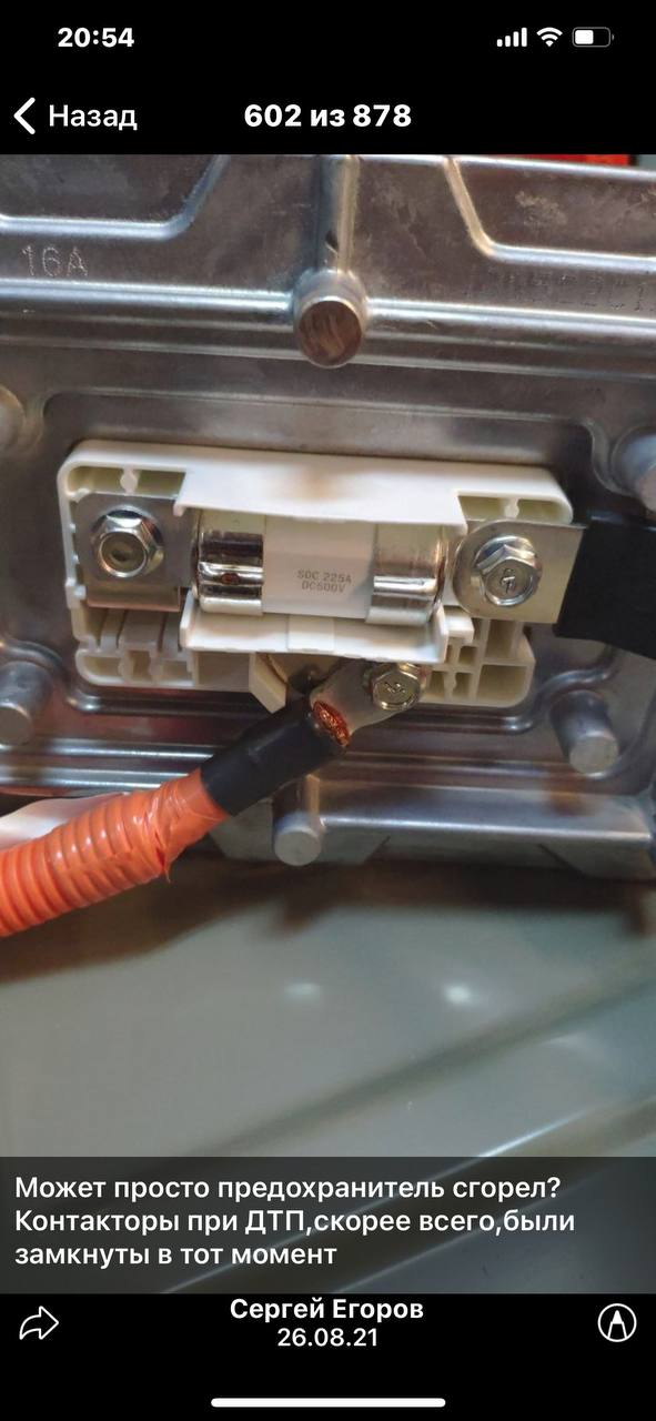

there will be no fuse problems. On all versions 24,40,62 batteries - 225A and 500V or 450V.
it is short circuit only.

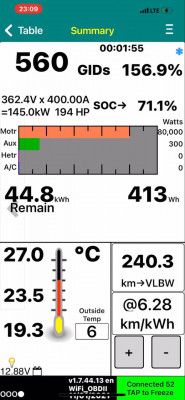

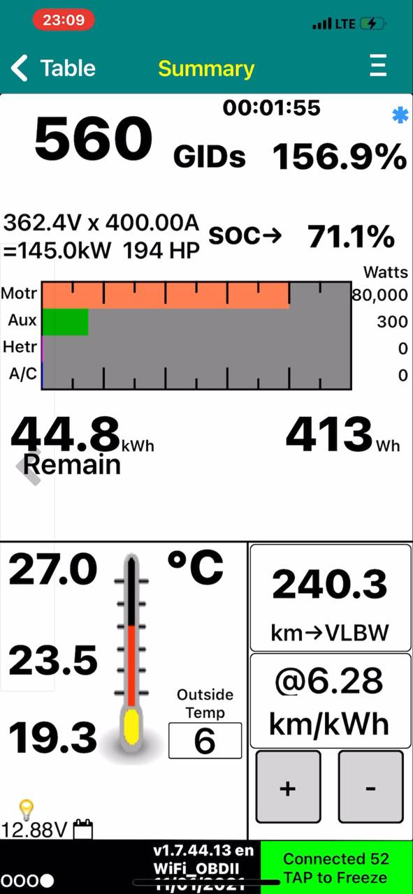

my 160kw inverter installed on leaf 2014 gives max 145kw and 400A, why is that? changed the multiplier and there is no difference at the maximum current.

Dala wrote: Fri Nov 12, 2021 1:11 pm I couldn't resist, so I installed the 160kW inverter with the 40kWh pack. No fuse problems so far :)
Fuse on 40kw and 62kw have same p/n.
