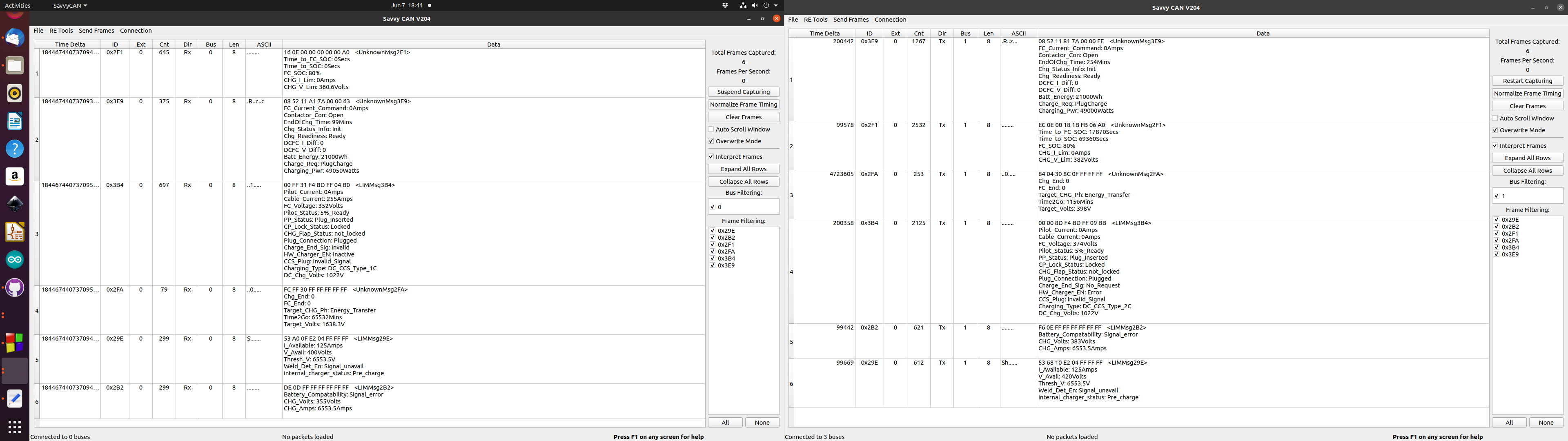

Thanks will try. So latest update : reviewing the ccs logs showed that during precharge the max v limit in 0x2f1 drops from 400.2v to 360v which just happened to be the value from the bms in 0x112 at that time. So I modded the code to transmitt batter pack voltage in 0x21f during precharge phase and bingo! ccs unit now puts correct voltage out and measured voltage at the contactors is only a few volts different from that reported by the charger. Still drops out as soon as attempt to close contactors. Also still unable to make either lim do a weld test which leads me to think there is some weird problem with the contactors. I'll do another can log at a ionity station later today. Its almost as if the LIM is perfectly happy right up to when we ask it to do anything with the contactors then it throws a fit.
Posts: 4006
Been thanked: 1136 times
Just added some logs from a UK 2013 i3 AC only REX model. Lock and unlock cycle and ac charging.

Uploaded latest ionity fail log. Its the same story. As soon as we go for dc contactors on it terminates the session.

Ok, so you are likely getting to the first CurrentDemandRequest. Here’s the things the LIM is likely to need in order to keep going: EV ready flag (may be built into the LIM), SOC, target current, maximum voltage limit (usually a few volts above 100% SOC), maximum current limit (sounds like this is built in to the LIM?), maximum power limit, and target voltage.
There is one message between precharge and current demand request called power delivery request. It’s sent by the EV, with a confirmation message sent shortly after by the station at which the contactors close. I think that is handled internally by the LIM when you command the contactors closed but do look closely at the logs around the closing time to see if there’s anything briefly changing state during this time that would hint that you have to do something special here.
But I think you may be missing a value or sending an incorrect value that the LIM only checks when in the current loop. Hopefully that list above can help. I wish that home plug green phy tools weren’t so eye watering expensive, I could help even more if I could see that side.

Much appreciate the support. The fact I can't get either LIM to do a weld test as per muehlpower's video tells me I'm missing something from my setup and that something is stopping charge contactor closure as well as the weld test.
Posts: 4006
More experiments. Neither of my LIMs will do the weld test. But both report test passed. If I disconnect the contactors they report test passed. So off I went back to my ccs station with the contactors disconnected. Guess what? Fails in the exact same way. I can sit there in precharge until the station times out but the second I want contactors its night night. Almost as if the LIM can't see the contactors isn't it?
Now if you were a paranoid oem and worried about someone swapping a lim to repair an accident damaged car would you do something like disable the dc contactors if say the lim sees a different vin or no vin?
The last 7 digits of the vin are transmitted in 0x380. Good news is I have the Vin for the 2017 LIM. Hey that rymes. Do you have a vin for your lim? Let's see what happens. Probably another blind alley but it feeds my paranoia so that's never a bad thing.

Let's play spot the difference.
bji900

Post by bji900 »
Target voltage 1600V VS 400V?
And a few other things.
