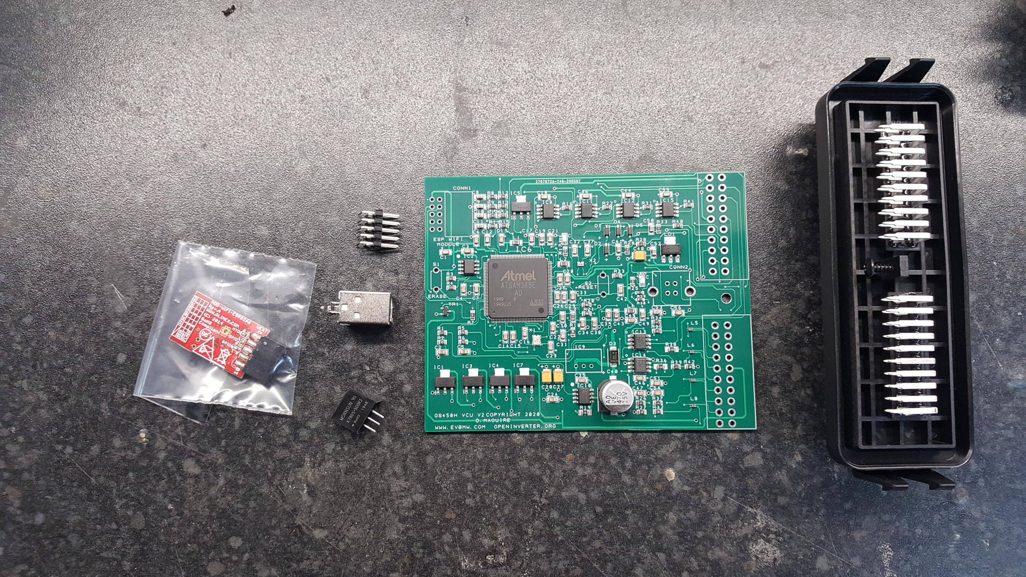

GS450H kit build video coming soon.
Posts: 3666
Has thanked: 12 times
Been thanked: 351 times
xp677
Posts: 441
Location: UK
Been thanked: 15 times
Post by xp677 »
Good to know that the JLCPCB rolls of electrical tape come in different colours!
