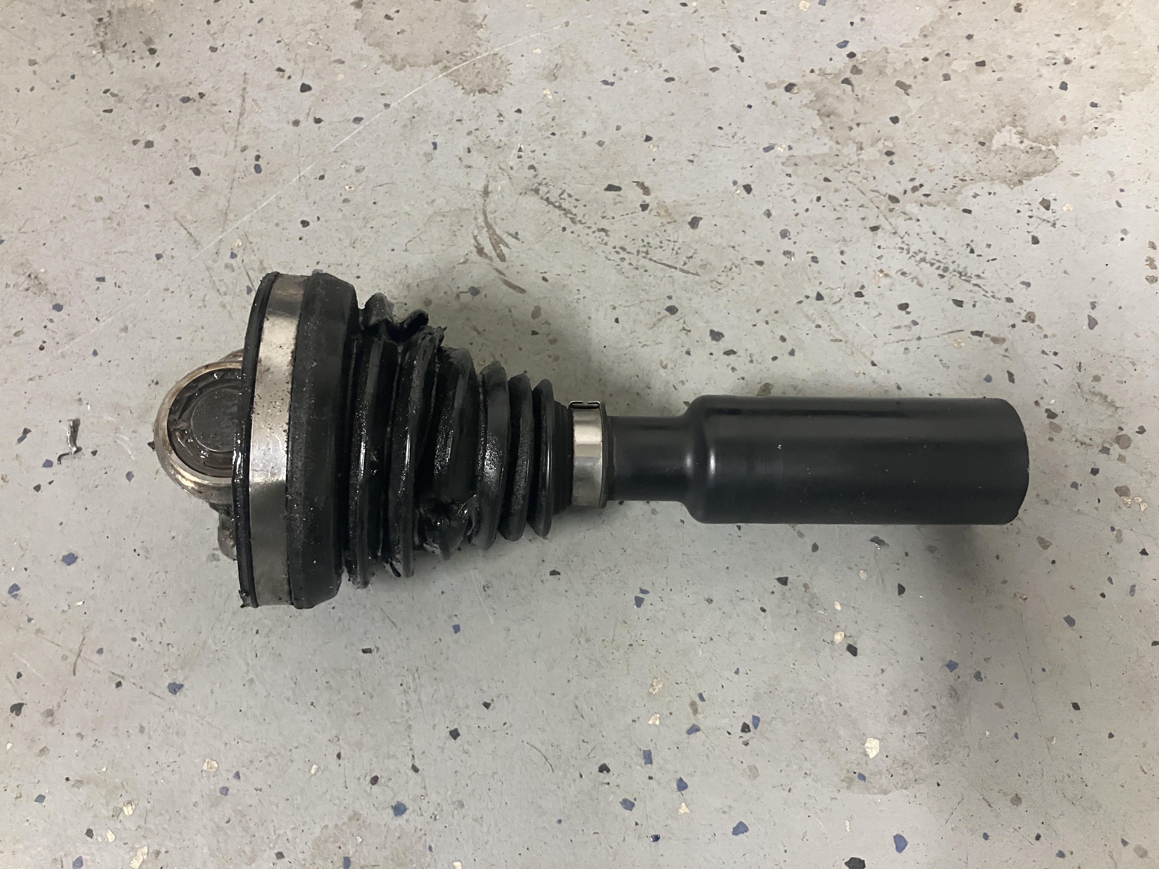

84 VW MK1 Rabbit CV Drive Shafts

uhg custom axles where not necessary!

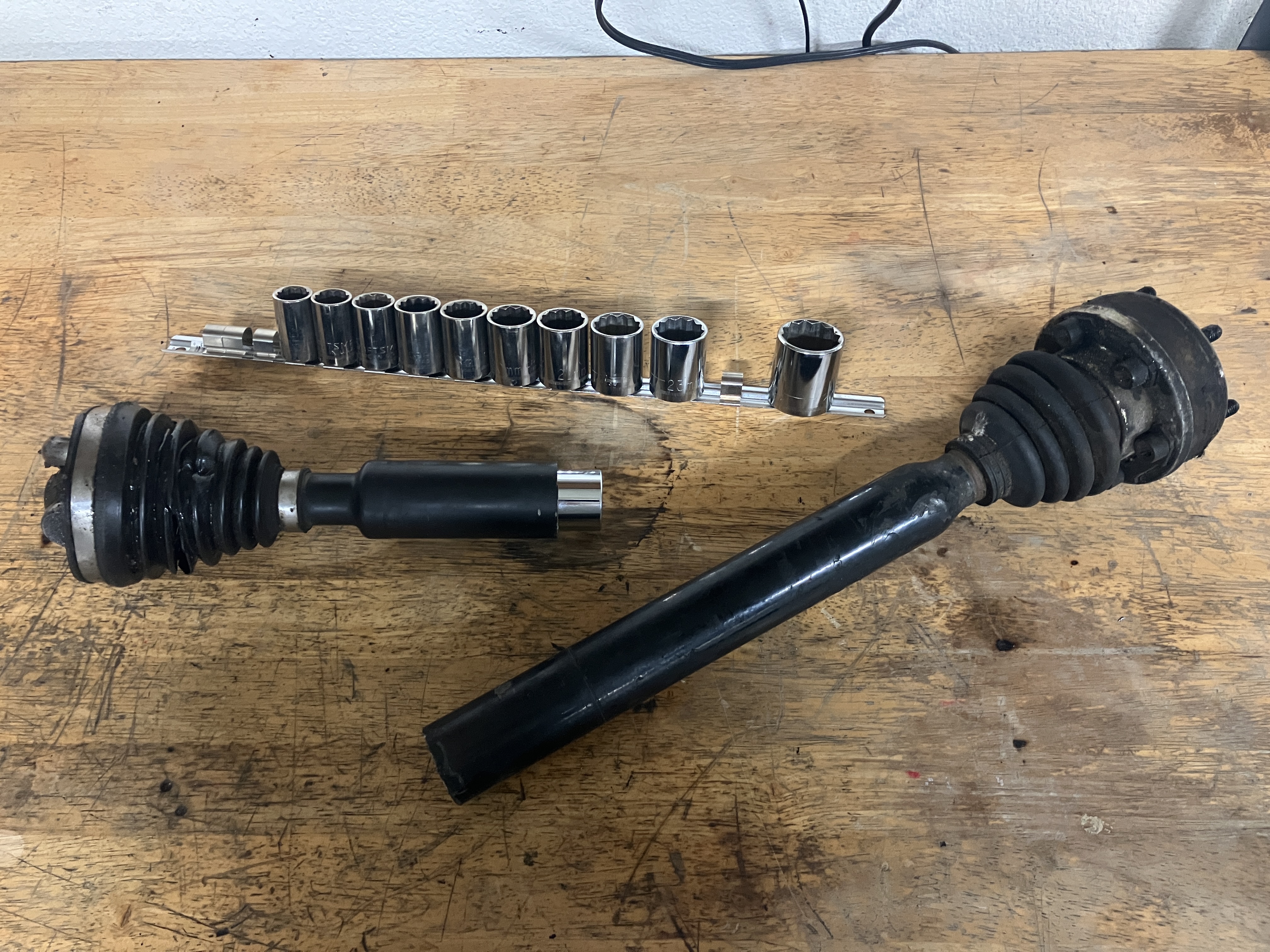

Re: 1984 Voltswagen Rabbit Prius Gen 3
Post by Gregski »
Bratitude wrote: Fri Mar 15, 2024 1:16 am :?

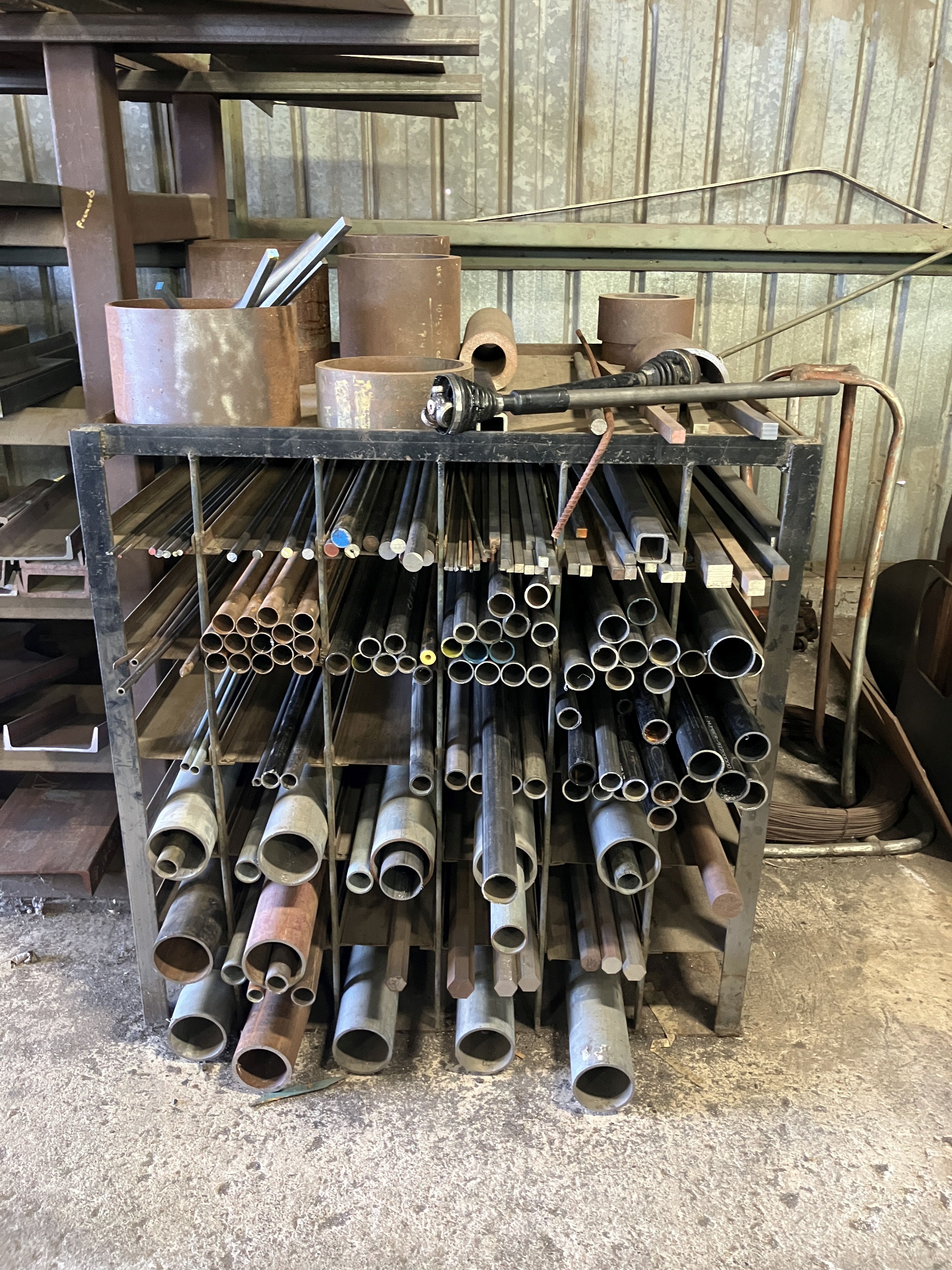

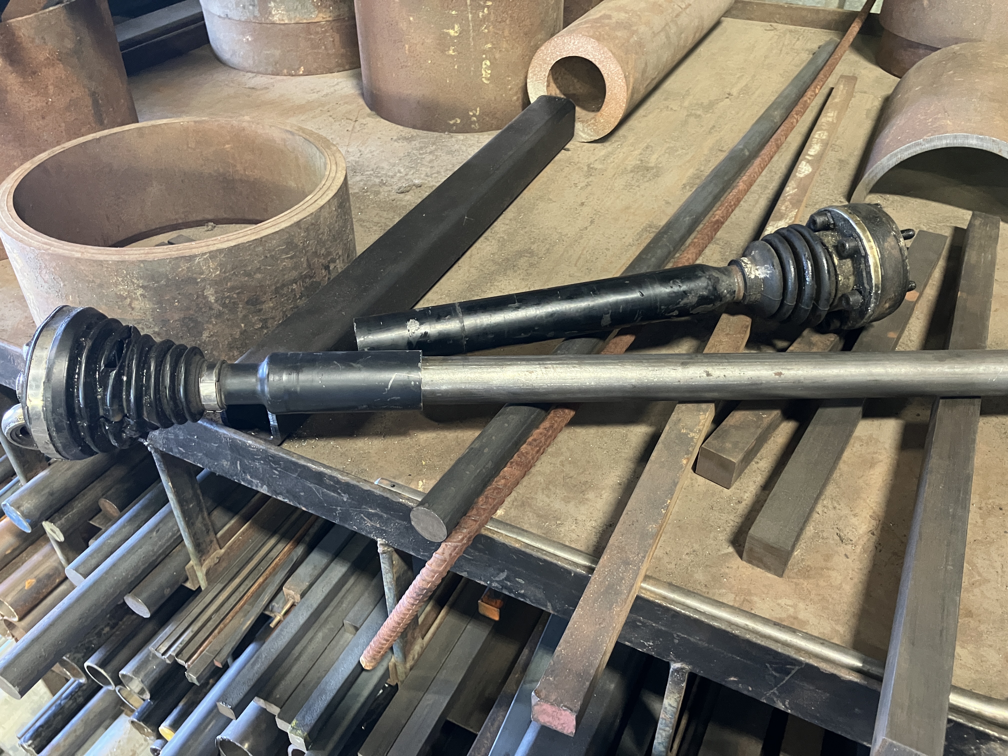

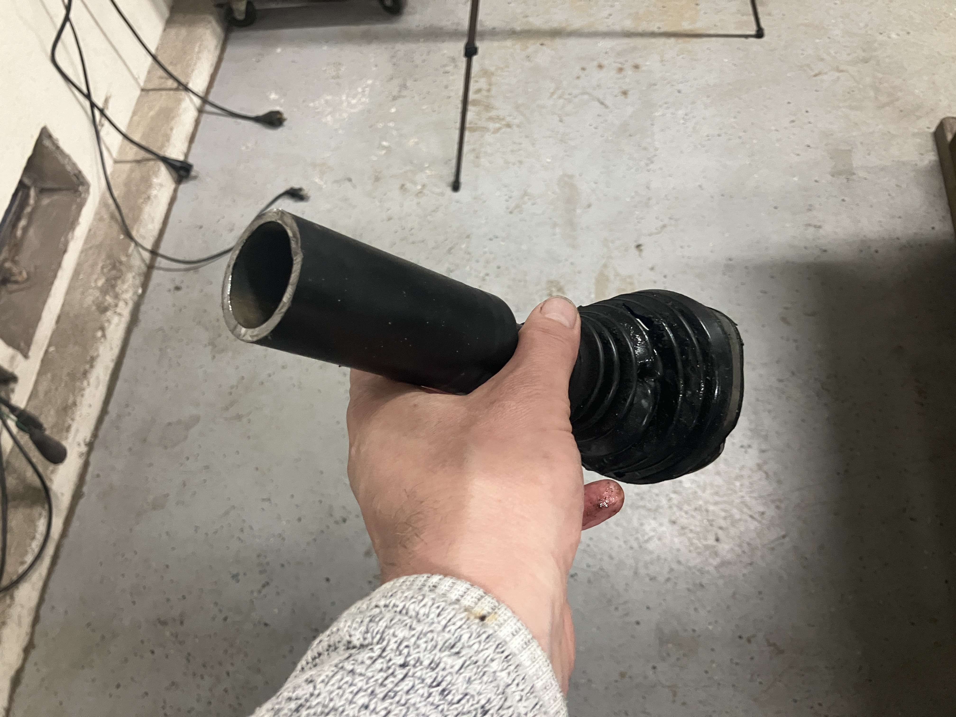

still work in progress, hit my favorite mom n pop steel shop today (not many of these left around these parts, these days, how about in your parts of the world?)
gonna slug one side and sleeve the other
that's a solid stock not a hollow pipe
Posts: 1156
Has thanked: 246 times
Been thanked: 469 times
Gregski wrote: Fri Mar 15, 2024 1:38 am still work in progress, hit my favorite mom n pop steel shop today (not many of these left around these parts, these days, how about in your parts of the world?)
It’ll work great, but I just don’t think it was the right route to go :) I just think making stub flanges for the vw axles to bolt to would be a better move. Makes the Prius more “bolt in”
Regardless:
custom complicated projects
Driving > perfection

Bratitude wrote: Fri Mar 15, 2024 3:42 am It’ll work great, but I just don’t think it was the right route to go :) I just think making stub flanges for the vw axles to bolt to would be a better move. Makes the Prius more “bolt in”
Regardless:

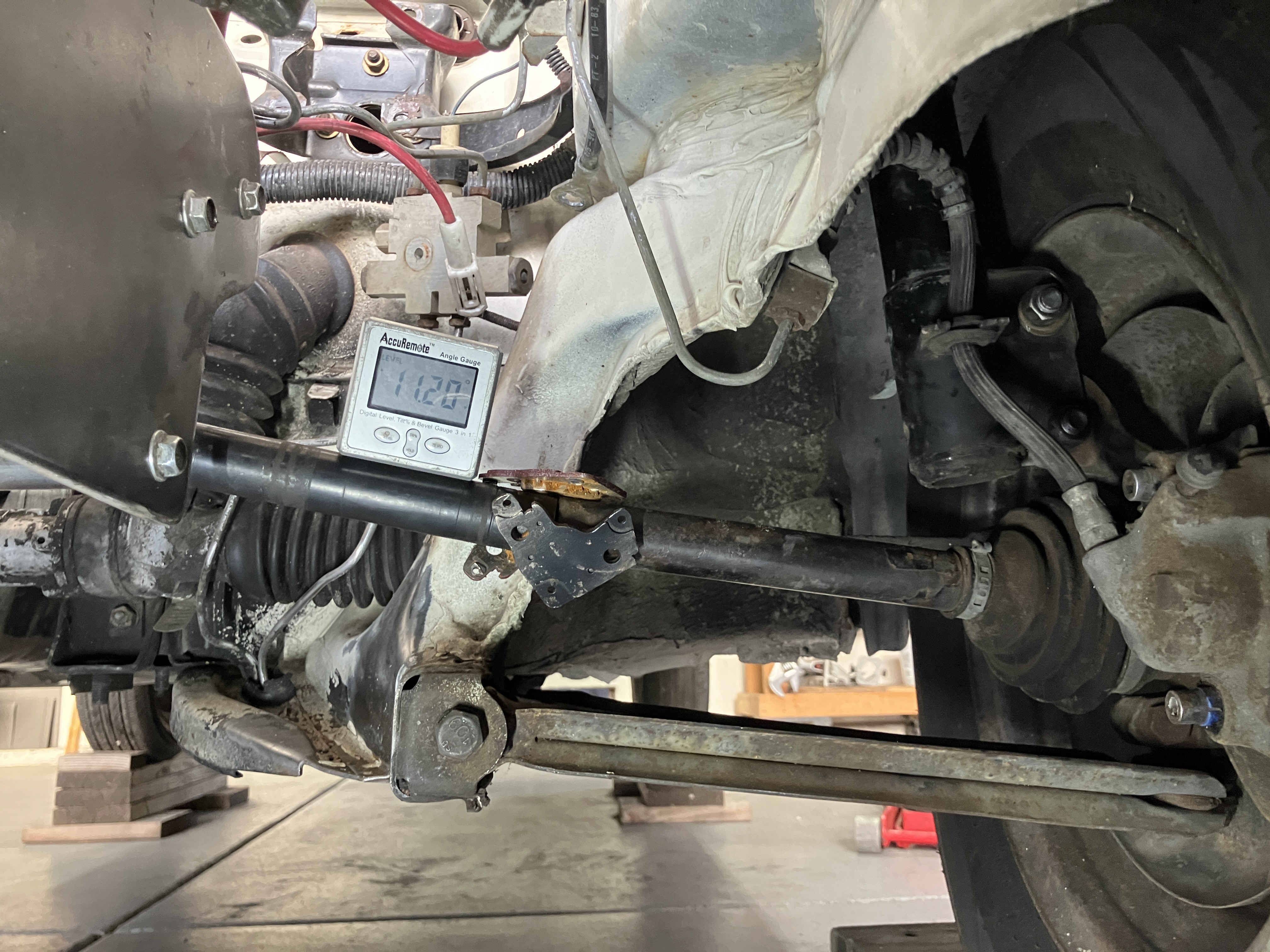

not sure I follow, since either of the shafts are way too long as they are let alone if we were to bolt stubs to them, can you explain what you mean

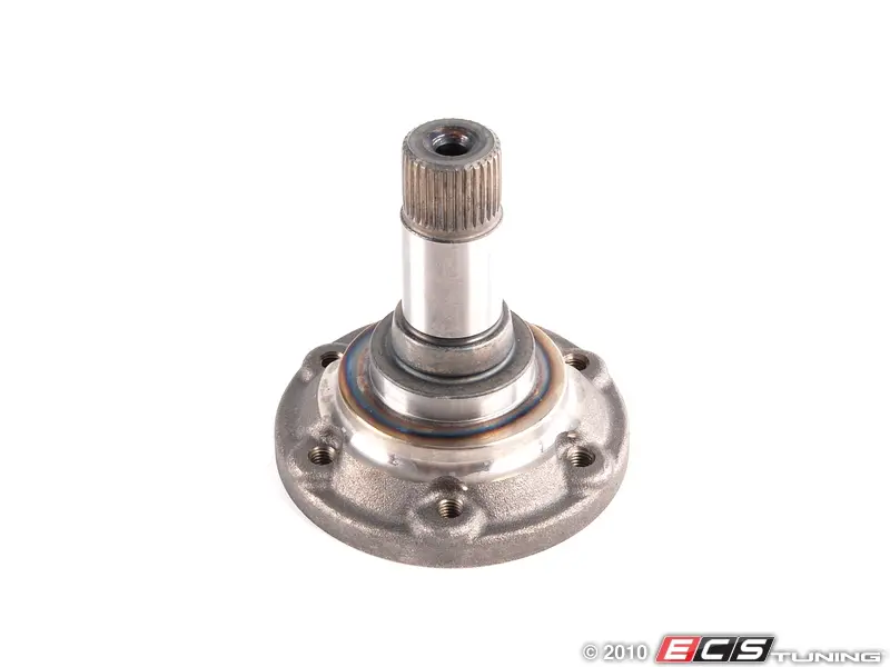

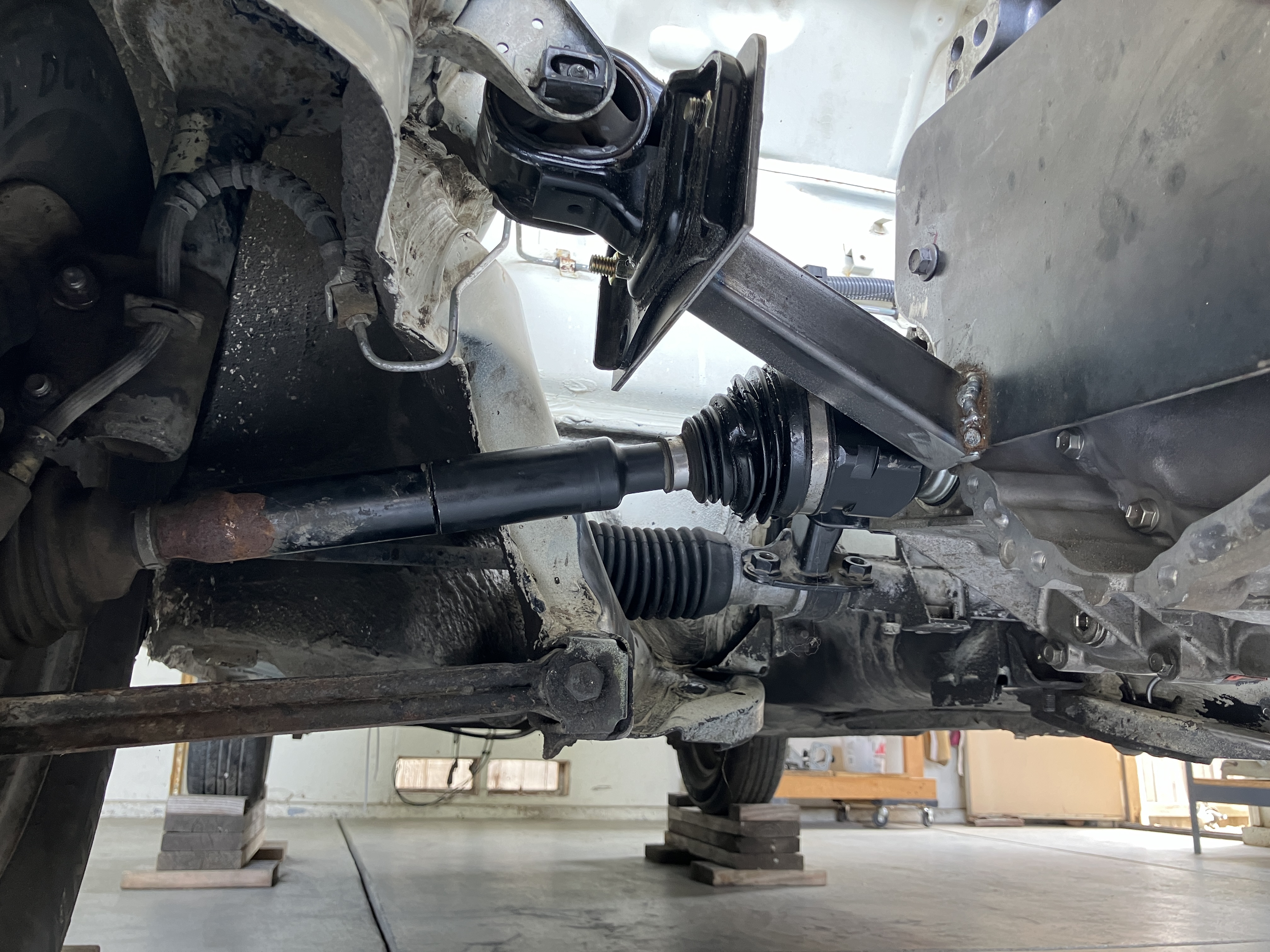

Bratitude wrote: Mon Feb 19, 2024 1:17 am Just some simple machining and welding.
you take the Toyota cv joint/stub and cut it down, turn it round on the lathe. then make a flange with the 100mm bolt pattern that the vw cv joints have, and press that on to the turned down Toyota stub. Then get it tig welded.
Heck you could use the old flanges off the vw trans axle, as you already have them!
now you have a stub flange with the Toyota splines and the vw cv joint bolt pattern.
Now your stock vw cv axles bolt up to the Prius trans axle.
this gets rid of the cup holders ie the articulation, the Prius stubs go in and out about 3" if I cut the cups off and weld on a rigid flange what moves?

The VW inner CV's are bolted, but they have a movable element in the CV itself.

VW box has two flanges in the diff as pictured for the CV's to bolt onto.
you take those stubs, weld them to the Toyota stubs and end up with something like this:
Which has prius on one end and VW flange on the other, and if its all measured up correctly, puts the flanges in the same place as the original VW flanges, allowing the original driveshafts to fit unmodified.
