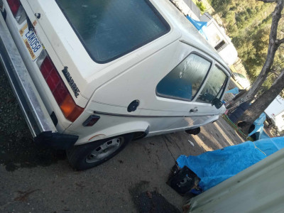

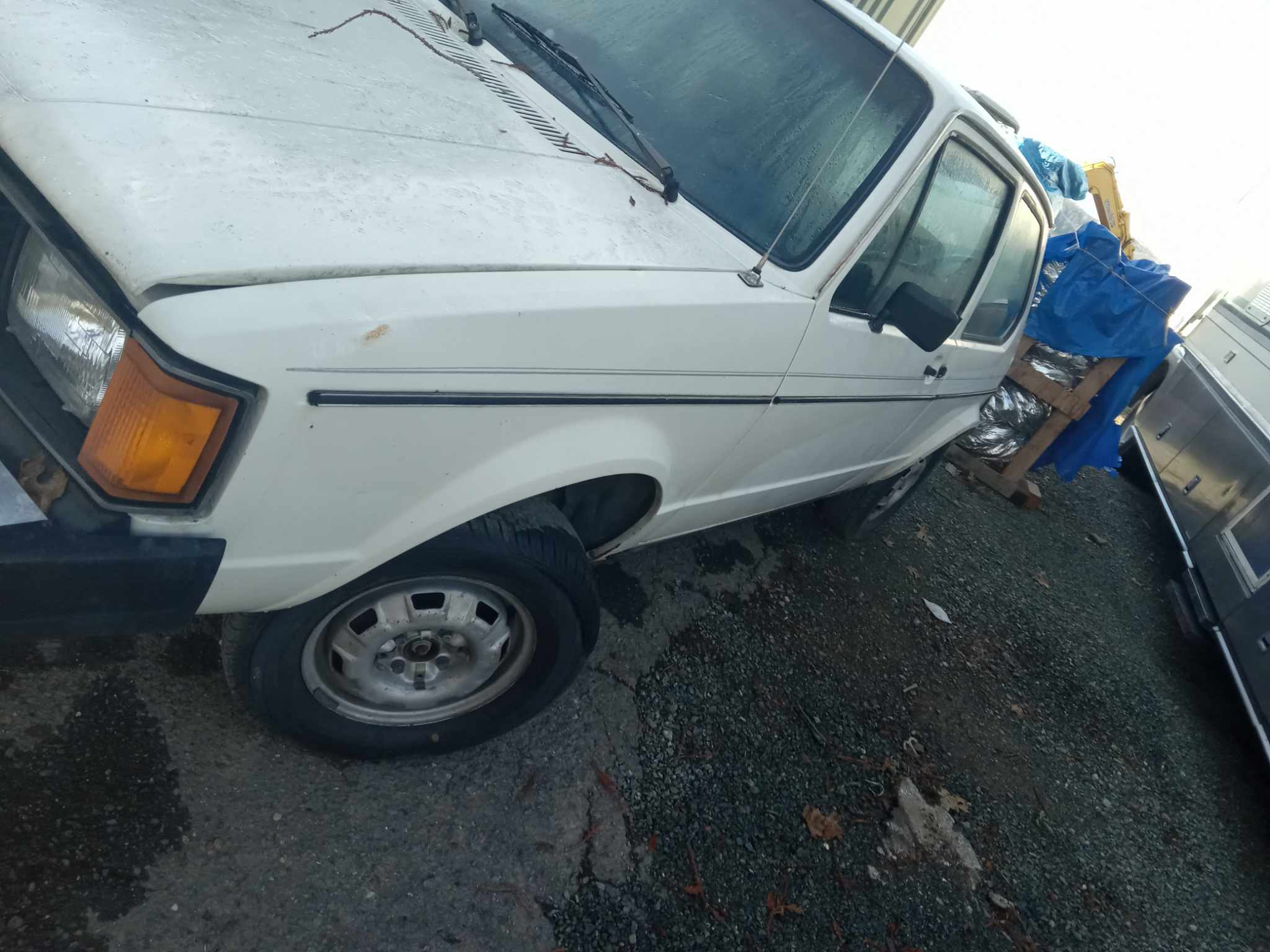

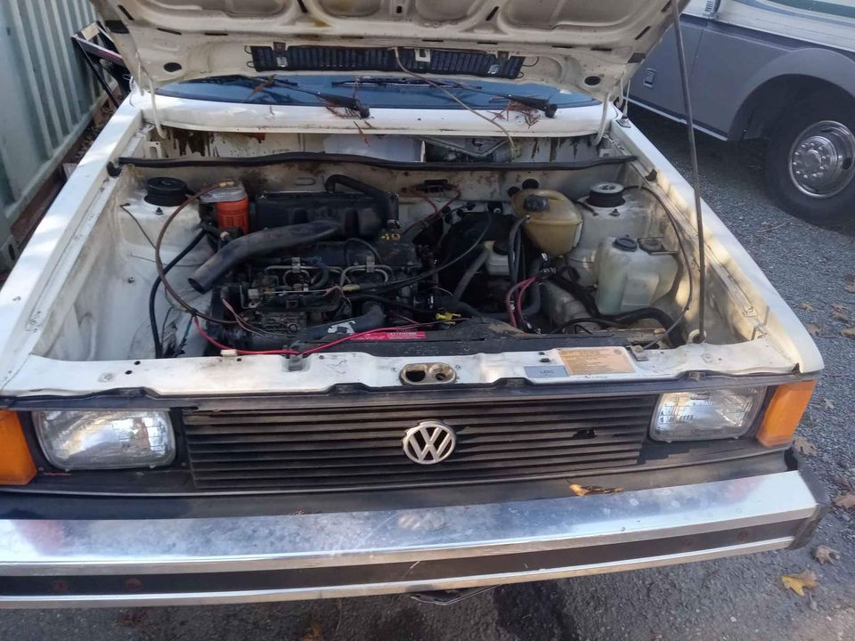

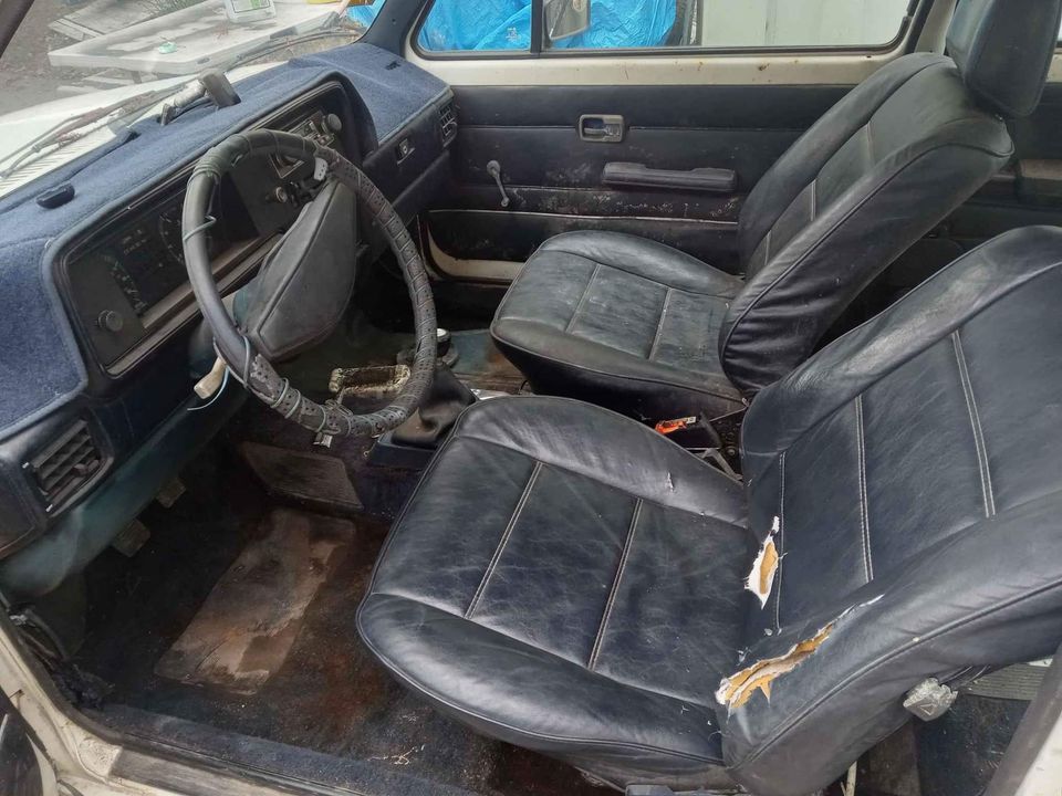

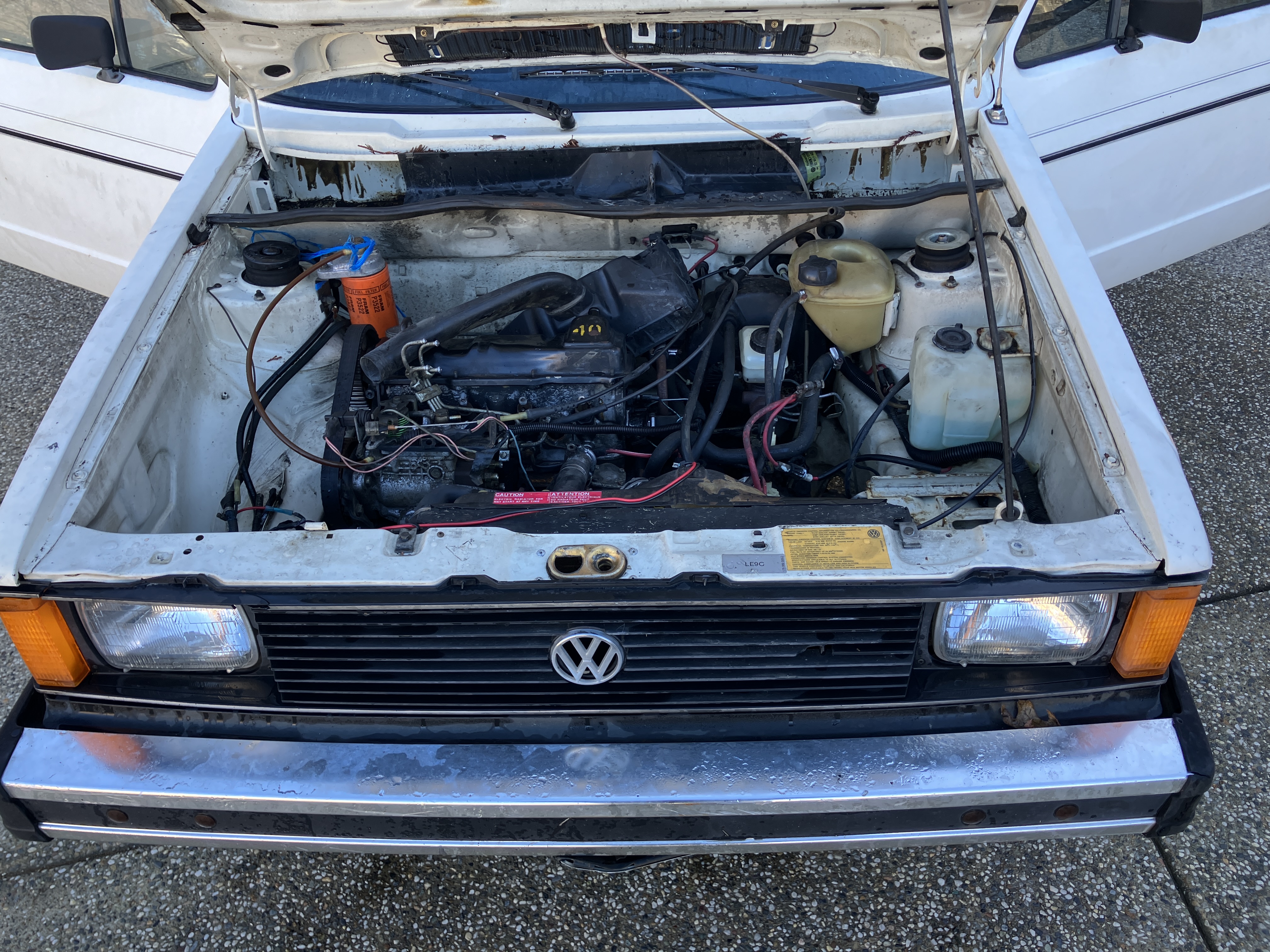

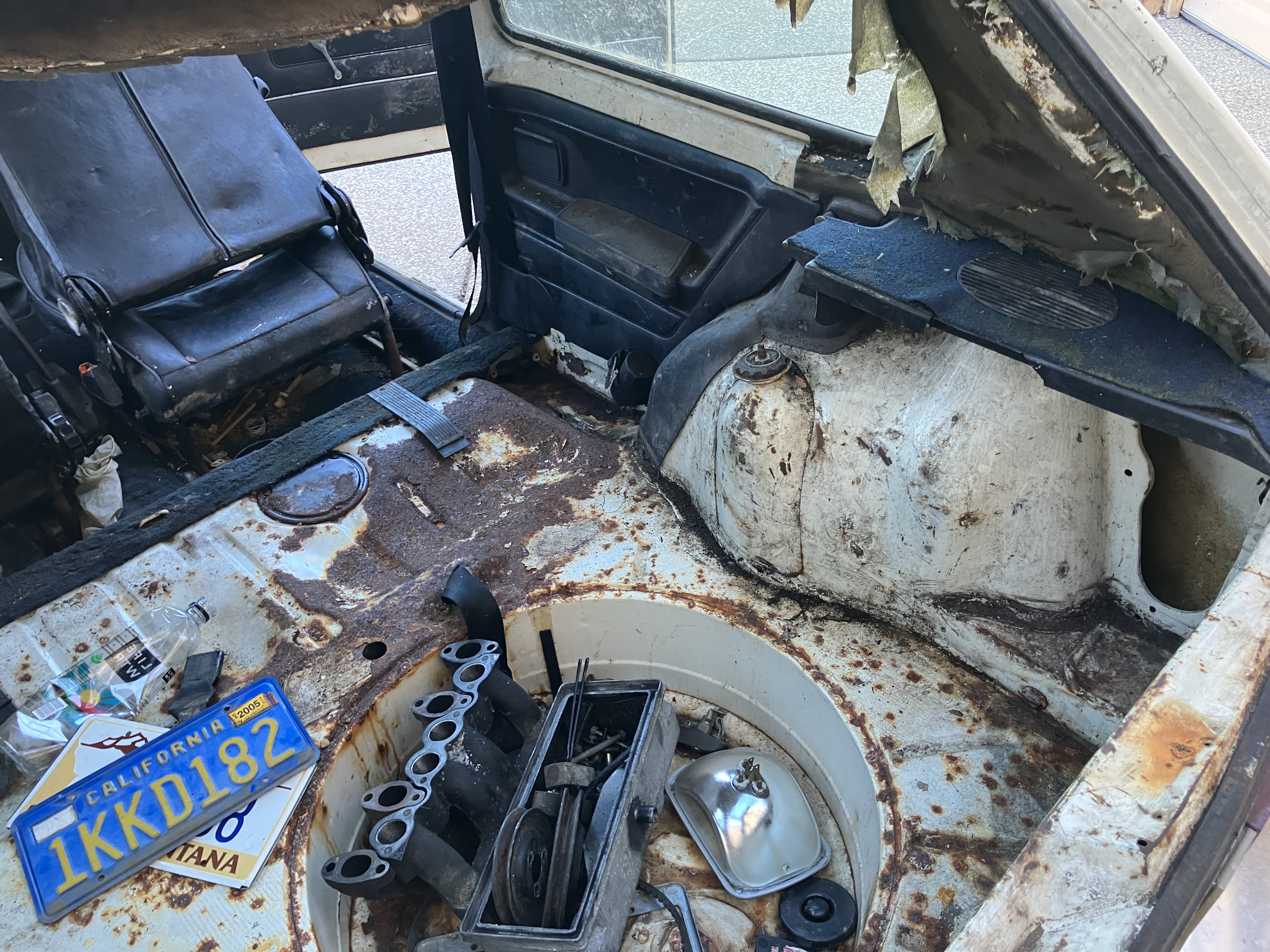

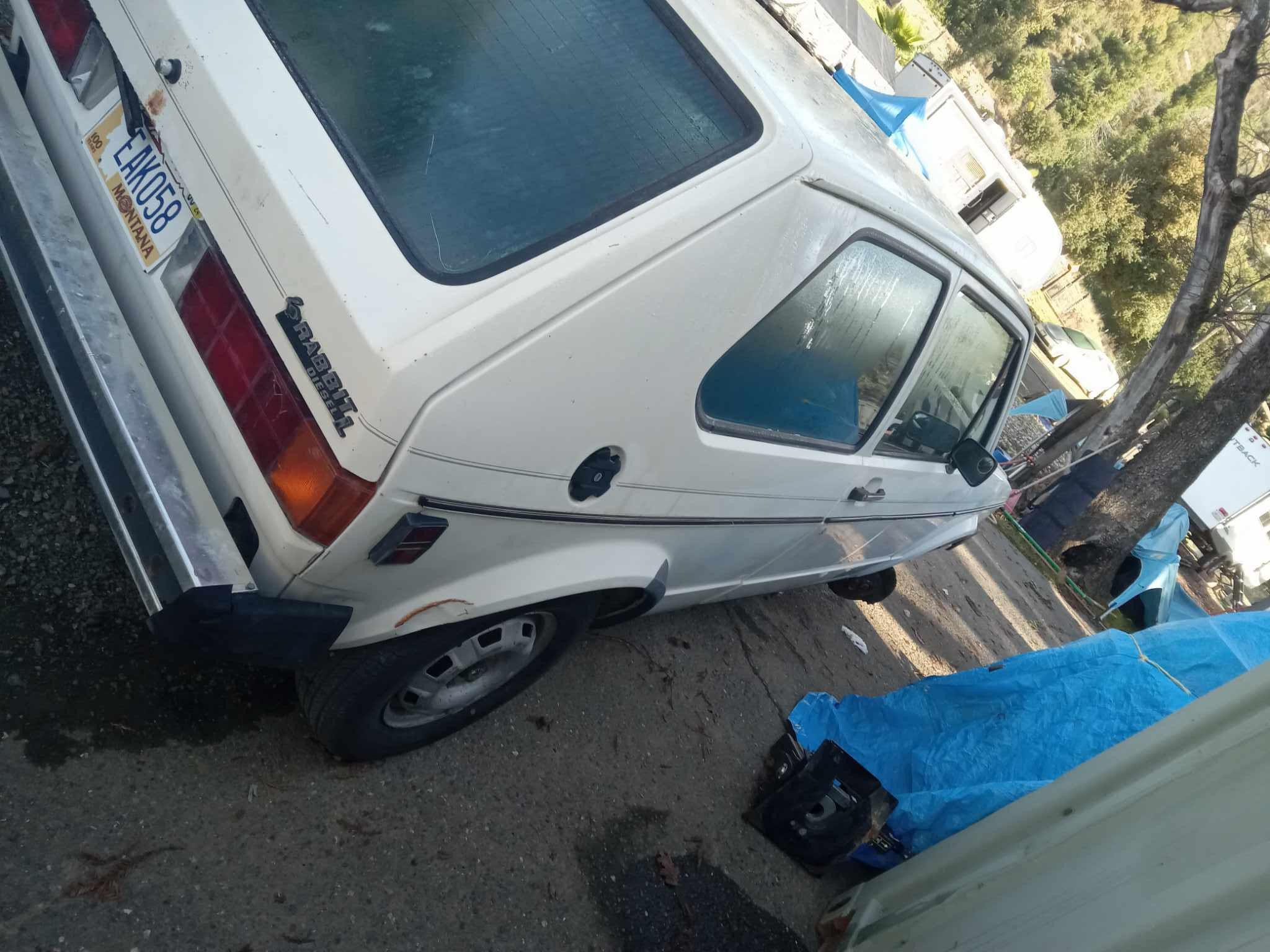

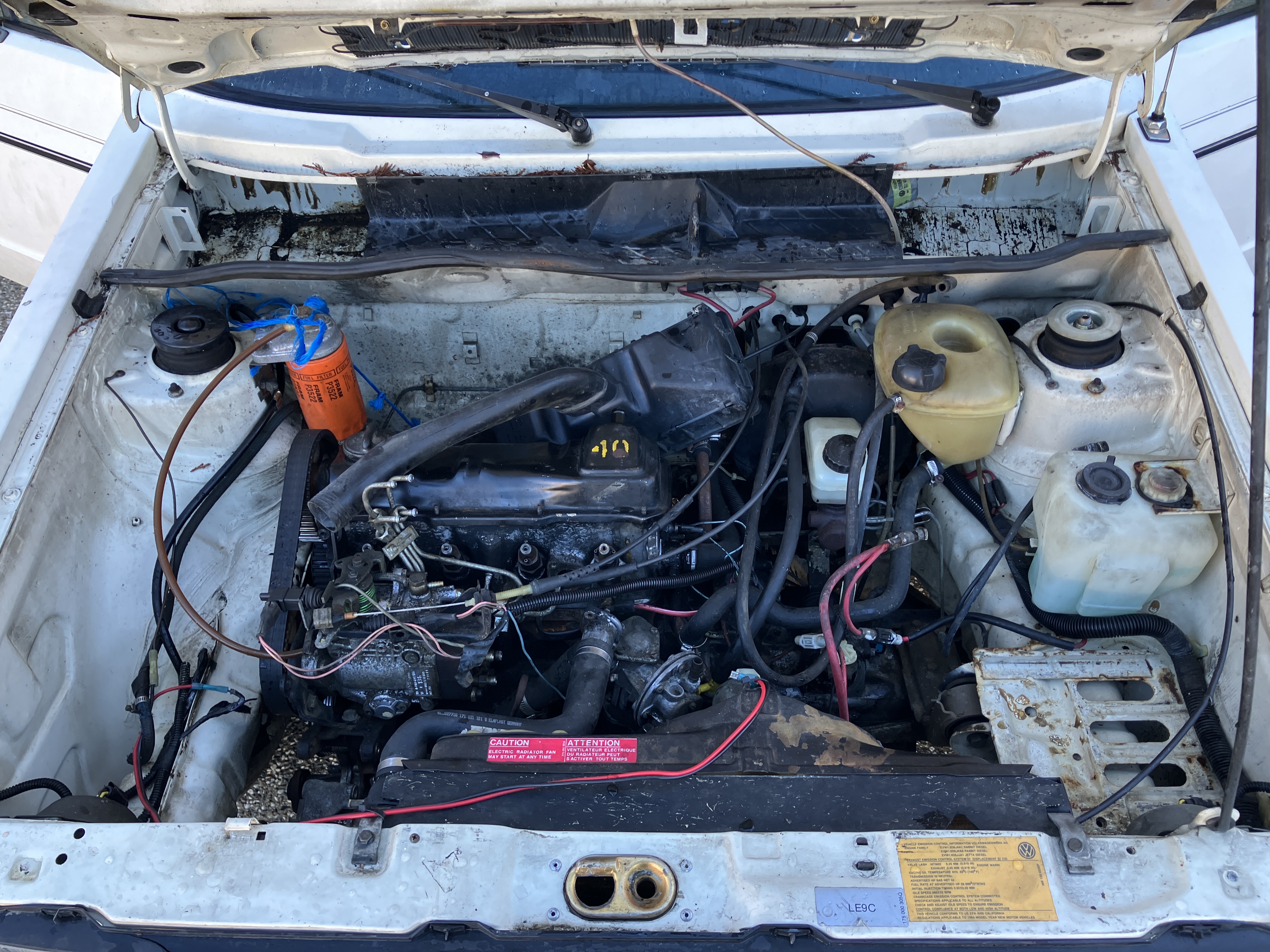

so there I was, left all alone unsupervised, "don't do it, don't you dare click on Facebook Marketplace" said the voices in my head, "go ahead, it won't hurt to [ahem] just look" they retorted - sometimes I talk to myself, cause I need expert advice, you know
at this time in my life I needed another car project like a hole in my head, especially yet another EV Conversion - I'm looking at you Damien Maguire you seed planter you!
... and there she was "Snow White" as I would affectionally call her [sometimes... among a million other things] and she was perfect, checked all the boxes too:
Not red... ✔
Not wrecked... ✔
Not running... ✔
Not gasoline powered (pronounced: diesel) ... ✔
Not four doored... ✔
Not rusted... (well let's not split hairs)
Not too far away... well... you get the idea
She was listed for $1,500 and I am not the type to negotiate over the phone, so I negotiated via Facebook Messenger, I hit him with $1,250 and he said he would do $1,350... I said maybe, then once there after a thorough 30 second inspection I pointed out a grapefruit sized hole in the rear floor pan and we shook on $1K provided I could get her registered back in California since it was a Cali car registered out of state [insert your favorite avoid registration back fees evil scheme here] many many hours and $264 bucks later at the local DMV I had an * INCOMPLETE APPLICATION * for the Title, meaning they would issue me one once I got the VIN verified, all vehicles entering or reentering California must get a VIN verification.

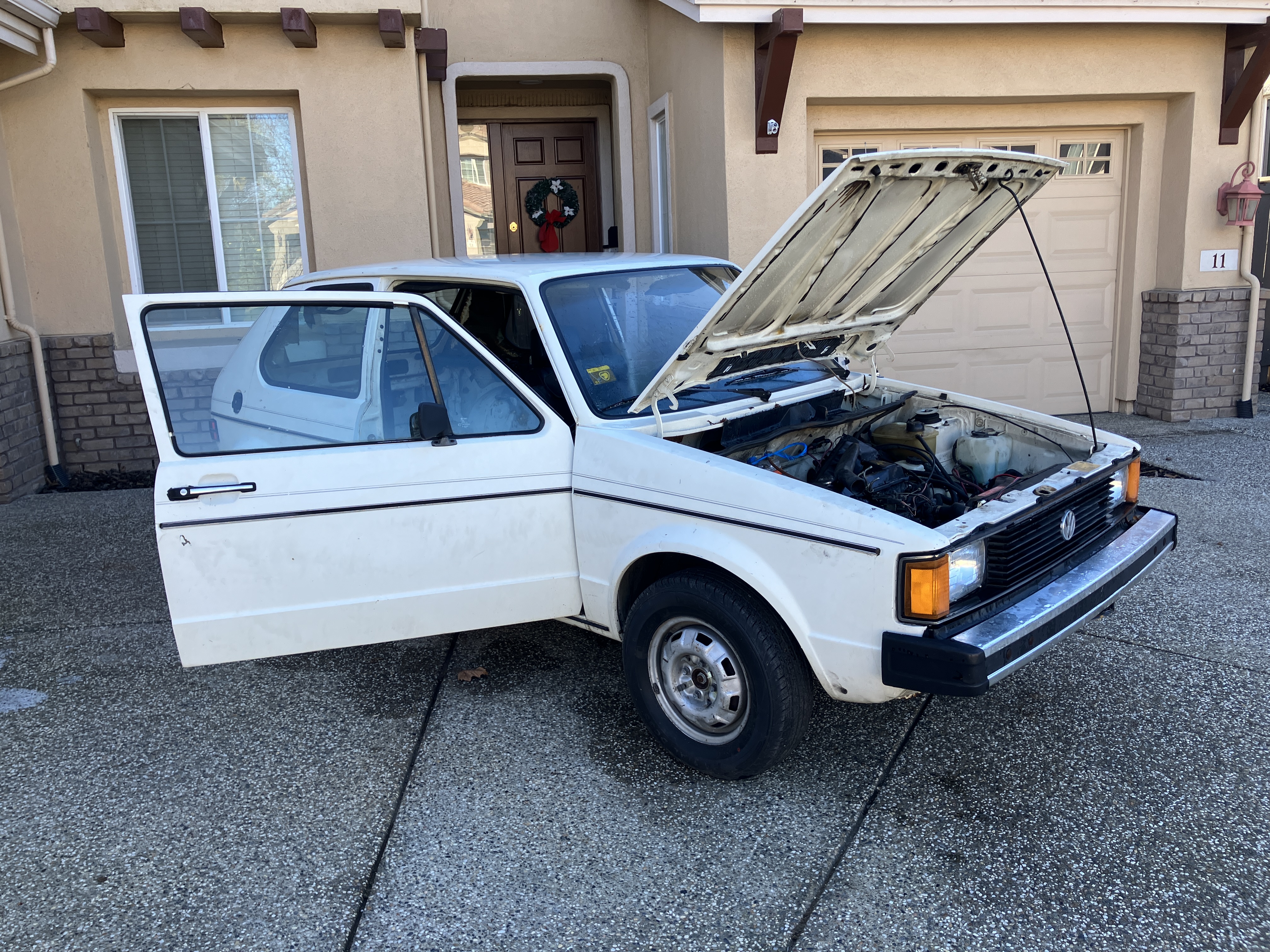

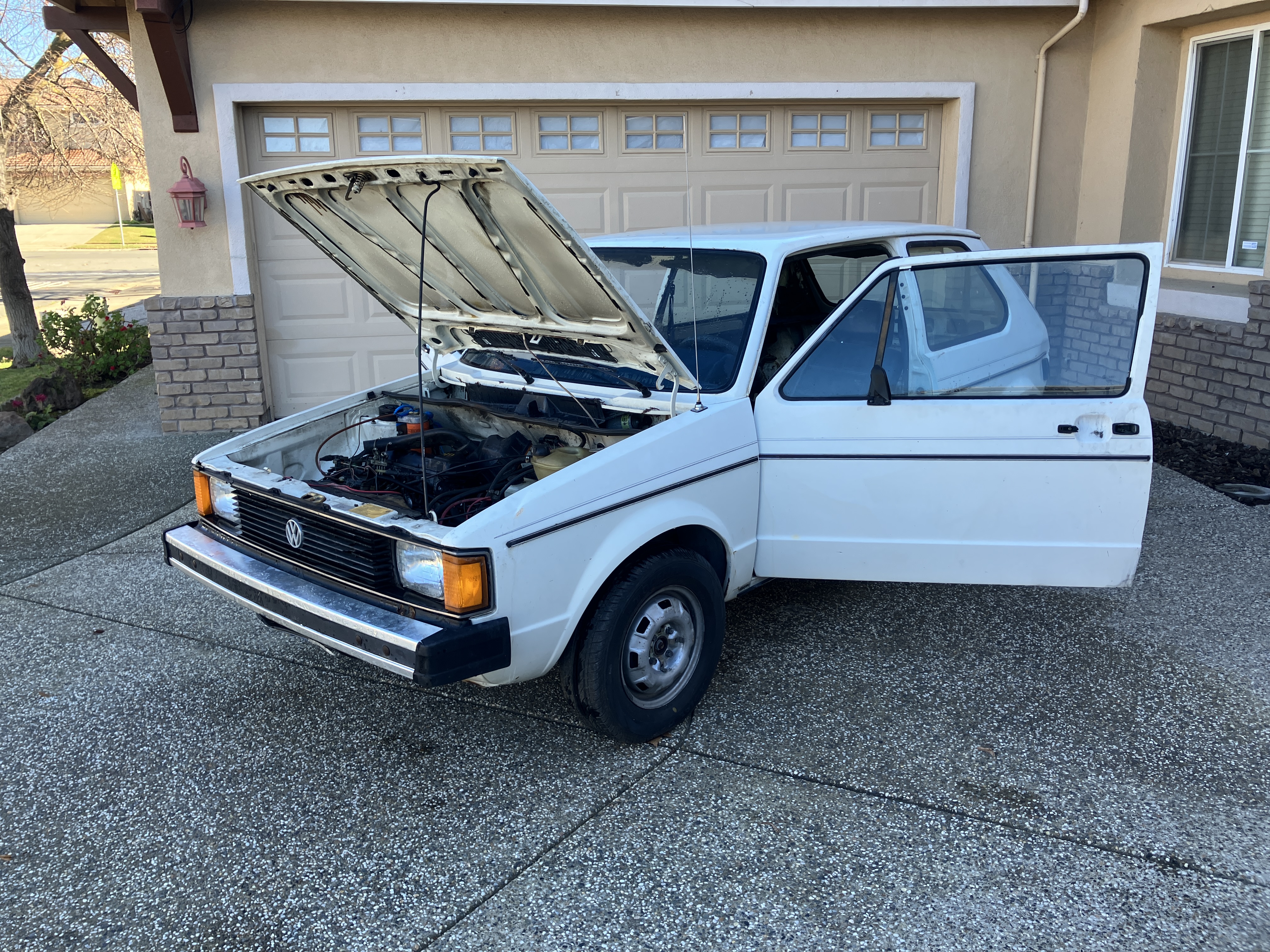

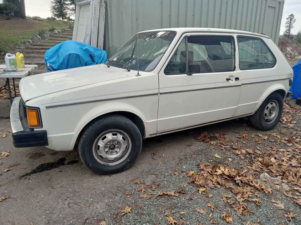

here she is as listed

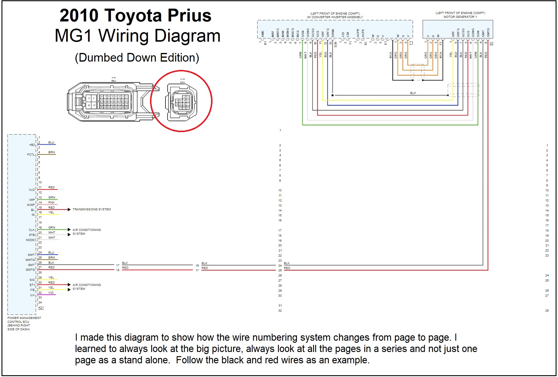

RESOURCES
I will try to attach as many files as I can to this post.
  • 2010 Toyota Prius Engine Controls - Hybrid System Circuit (Powertrain Management) aka Inverter Wiring Diagram
  • 2010 Toyota Prius MG1 Wiring Diagram Dumbed Down Edition
Engine Controls - Hybrid System Circuit (Powertrain Management) - ALLDATA diy.pdf
(335.25 KiB) Downloaded 381 times

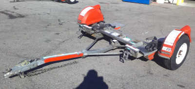

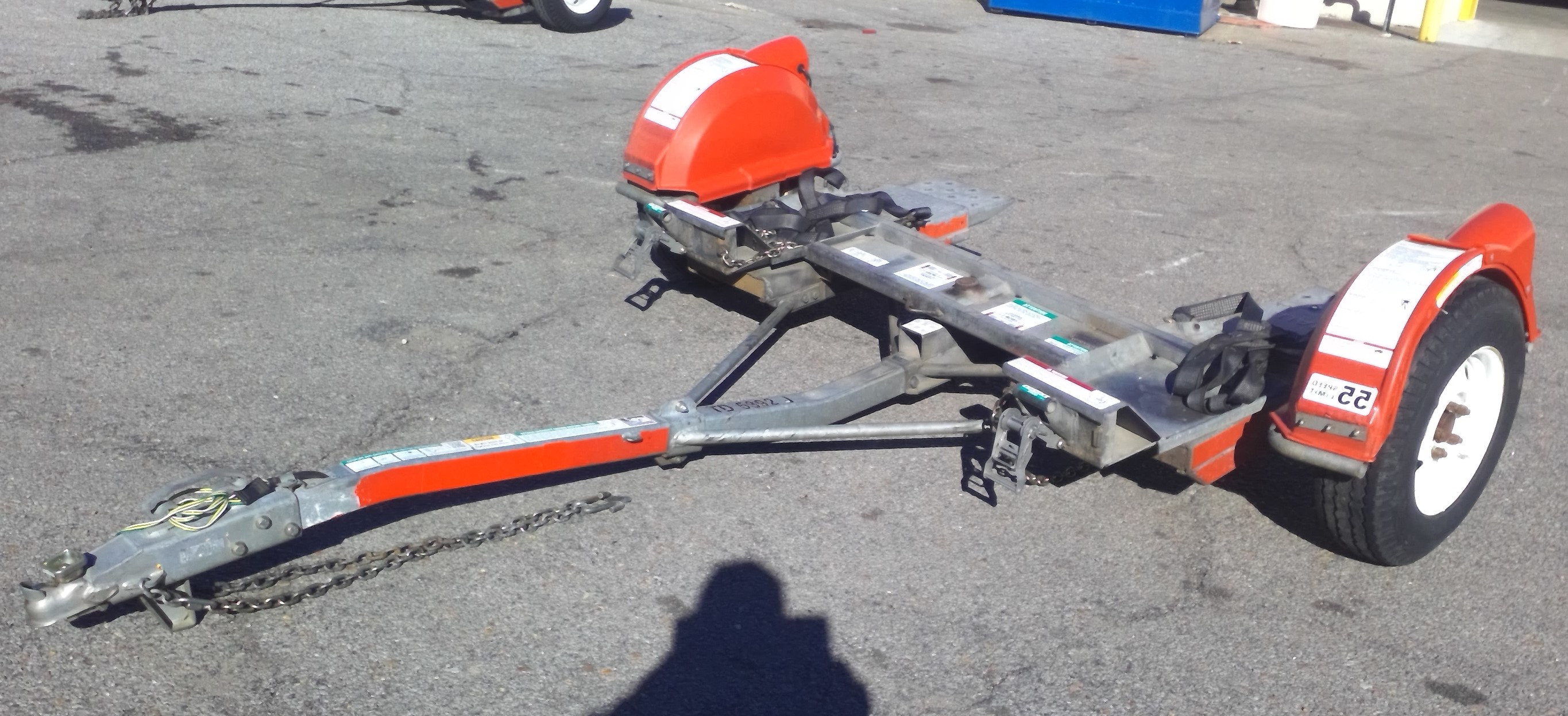

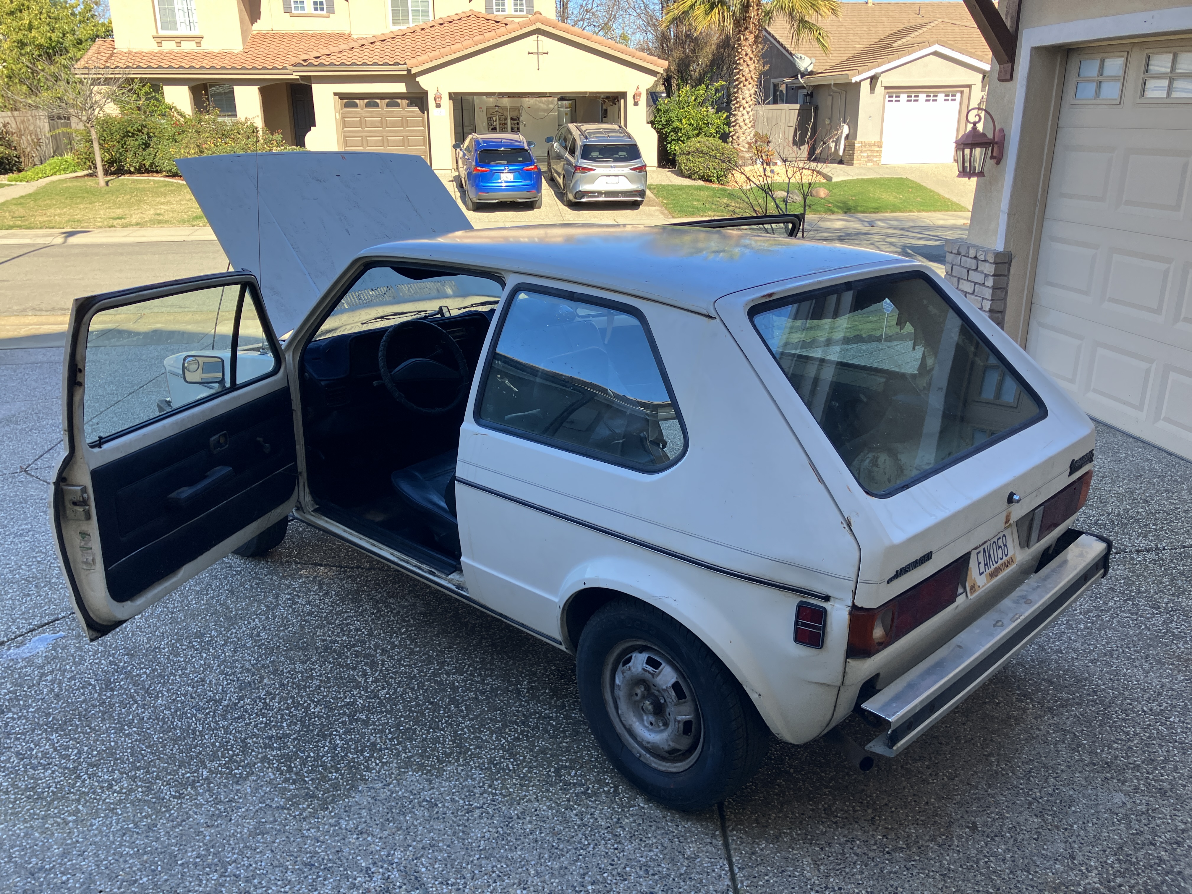

Lessons Learned: UHAUL Sucks !!!
so get this, after I bought the car me and the seller drove around his town and none of the UHAUL (U-Haul is an American moving truck, trailer, and self-storage rental company) places would rent us a car dolly to transport this beauty home. They said these dollys were only for people who would return them to the same UHAUL location they borrowed them from. Please make that make sense. So I want to move from California to Tejas and then I have to drive back to return this stupid thing?
Have any of youz had similar experience?

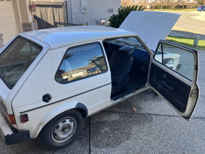

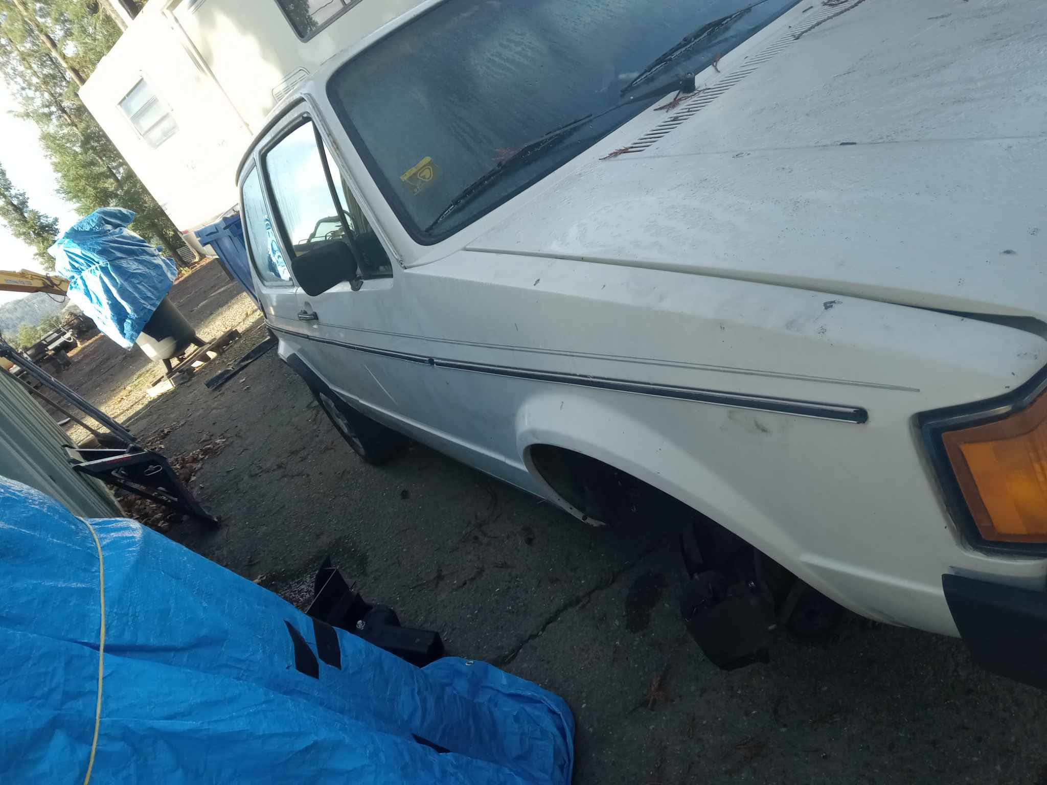

Top Tip: when buying a car on the InterWebs in a remote location tell the seller you live far away and can't see it in person and ask for more pictures, this will tell you two things:
1. How willing is the seller to work with you, is she difficult, does she have the personality of a serial killer?
2. You get to see more of the car!
and then you will get more quality vertigo shots like this:

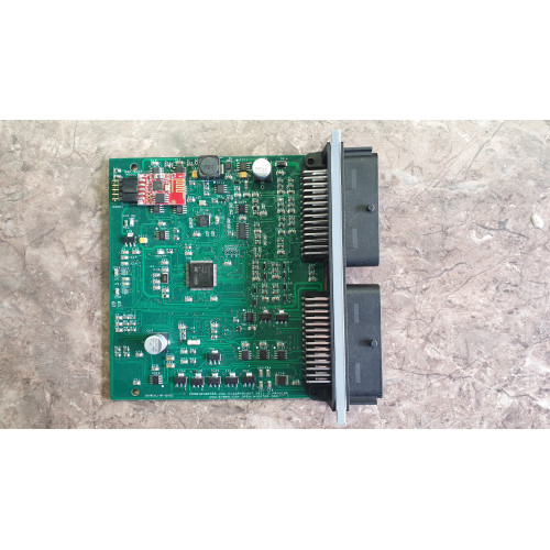

thank you for that info, yes I own two EVBMW Zombie Verters one will go in the car the other will be for bench testing, I learned this on my truck as it became a PIA to keep moving the GS450h VCU circus board back and forth and it really took a beating, I think I actually knocked the little resistor off of it cause it was sticking up like a foot off the board, ha ha
I used the "I already own all this extra EV crap" to justify buying this car so I might as well use it

I've had all sorts of fun with UHaul rentals. Typically I've gotten the full trailer not the dolly, but still plenty of difficulty.
What I have heard, and frankly I don't remember quite when/where, is that the auto trailers (and I guess dollys too) are owned and/or leased by the individual locations, and while UHaul does have a method for accounting for/transferring them when someone needs to move long distance, its strongly discouraged and there is a ridiculous rate attached.
I have also experienced that UHaul's corporate systems and customer service leave much to be desired, and if you get the right person at the location, and catch them in the right mood, they can help with things that corporate won't. There are still some things the system just will not let them do.
UHaul is a mixed bag.
There are some big corporate-owned locations, but like, 90% of the small locations are just run by whatever business puts them on their lot and staffs the counter.
They may care about customer service, or they may be surly losers that wouldn't lift a finger if it didn't benefit their specific location.
When I bought my cars in Arizona, my plan was to use a car dolly to tow them home. Didn't really think anything of it, there's usually a small relocation fee for not returning a UHaul back to the same location.
When I actually got to Arizona and called around, it was something like $25/day to rent the car dolly, and like $450 relocation fee to dump it in Canada as I'd planned to. It's all built into the UHaul website, it's certainly a thing you can do, but apparently expensive, maybe depends on traffic flows to/from those locations.
What I ended up doing was just buying an old car trailer, the one my car was already sitting on, for $500.
The thing about a car trailer is, it's probably worth the same amount anywhere that you buy or sell it. Plus, who couldn't use an extra car trailer?
In my case I could've flipped it for $3000 the day I got back, but, I sold it to a dollar to a friend who's always helped me in the past.

The 1.something fire breathing diesel enjin, coming to a Craigslist near you !
with more enjin crap in the trunk... [ahem, pardon me] the boot
