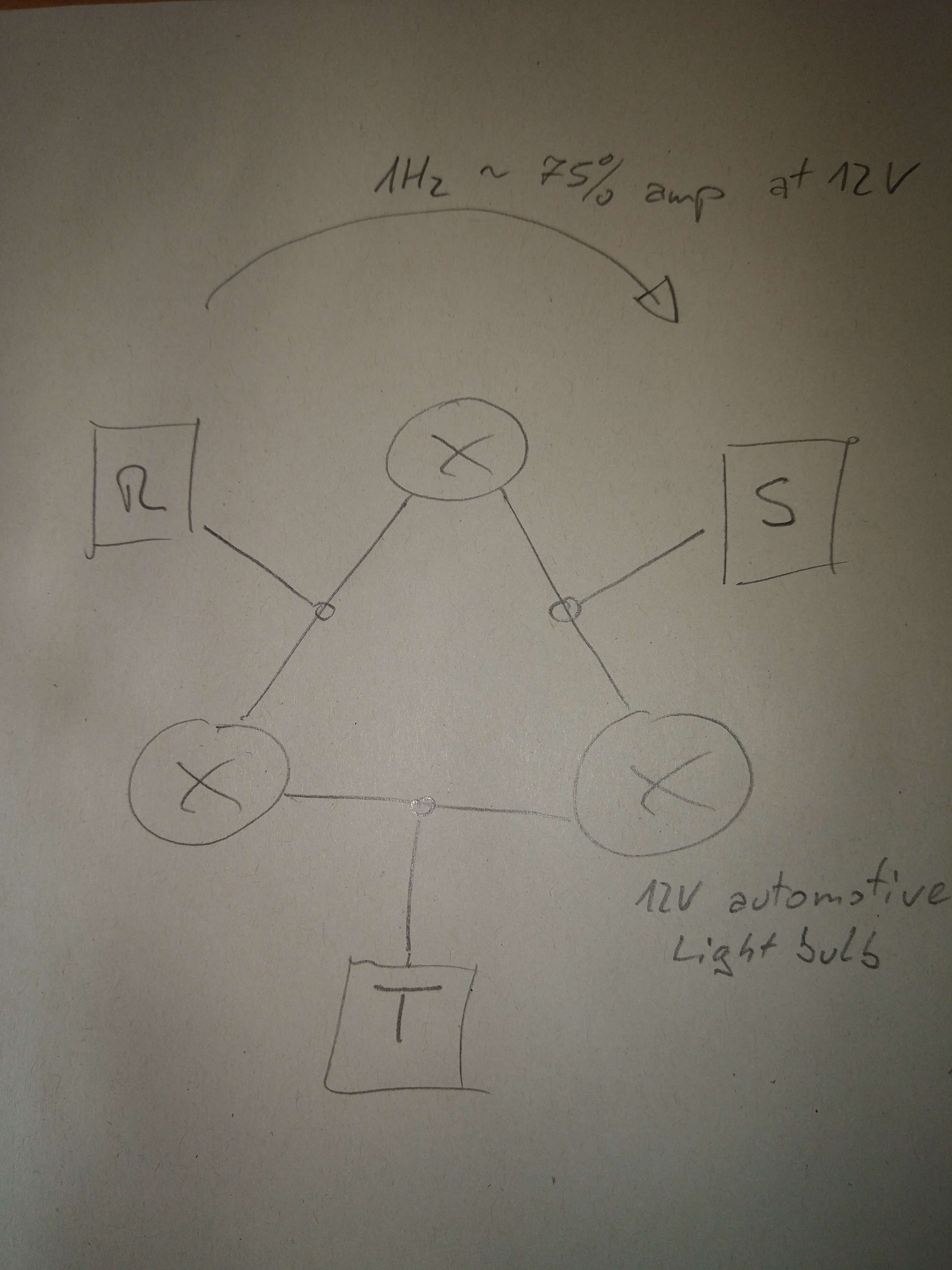

Shit! You are not seriously touching the casing with a phase return!!! Stop before you release the smoke... I guess Toyota engineers are not impressed by your attempt.RetroZero wrote: ↑Mon Jul 06, 2020 4:15 pm Doing the arber 'light bulb' test for pwm signal in manual mode
In actual values, I see il1 & il2 fluctuating between - 0,6A and +1A. That means pwm is doing something right?
However, with 12v on DC link, and light bulb on one phase and ground to inverter casing, there's no light bulb moment.
I have about 2V on the 3 MG2 outputs.
What am I missing![]()
What you want to do is wire three 12V car bulbs in a delta configuraton. Their links connected together one after each other so that you get 3 wire ends. Then connect this intersections to inverter phases.
If you now command 1Hz and some give some amps manually you should see them blinking in 1/3s succession.
Also since you use only 12V you should give amps about 75% to get any response.
EDIT: See the pic attached. Maybe you can get it to Wiki?

Thanks again arber. I'll do something for the wiki. I did some reading into difference between with and without neutral...
Ac is not my strong point, so I 'll have to go learning again...
Toyota boys happy today. No overcurrent message.
I only get 0,03A (idc) @1hz & 100% ampnom. No light bulb moment
Too scared to go giving more power after yesterday's scare....

I suppose this goes for all 'first start ups' of inverter boards...
I would strongly advise test with delta light bulb set up - thanks arber, I 'll get it onto wiki. And put 'dirmode' in Default Forward.
I have flashing lights
Now, would a Prius Ac motor spin?... One way to find out.
